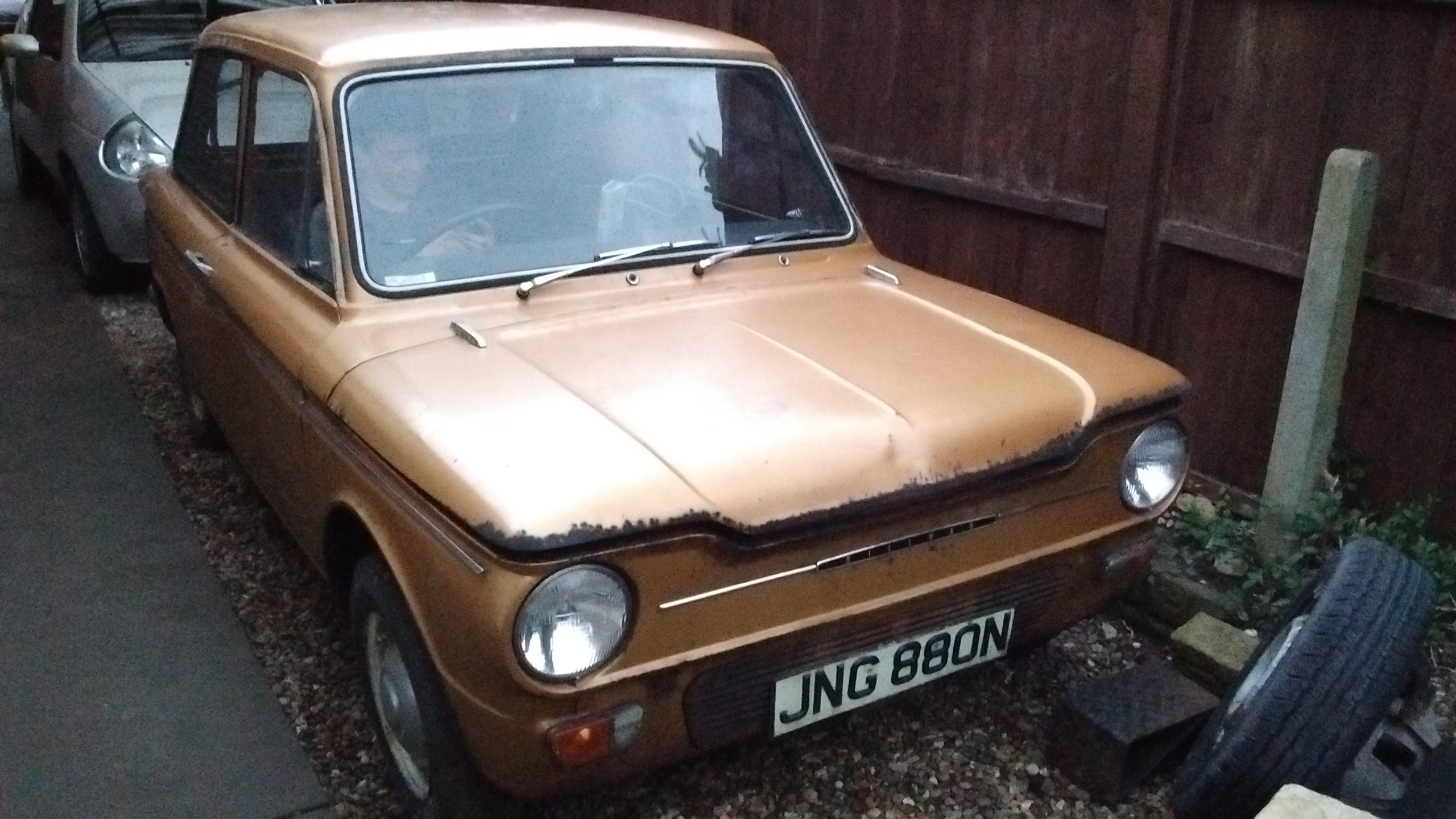

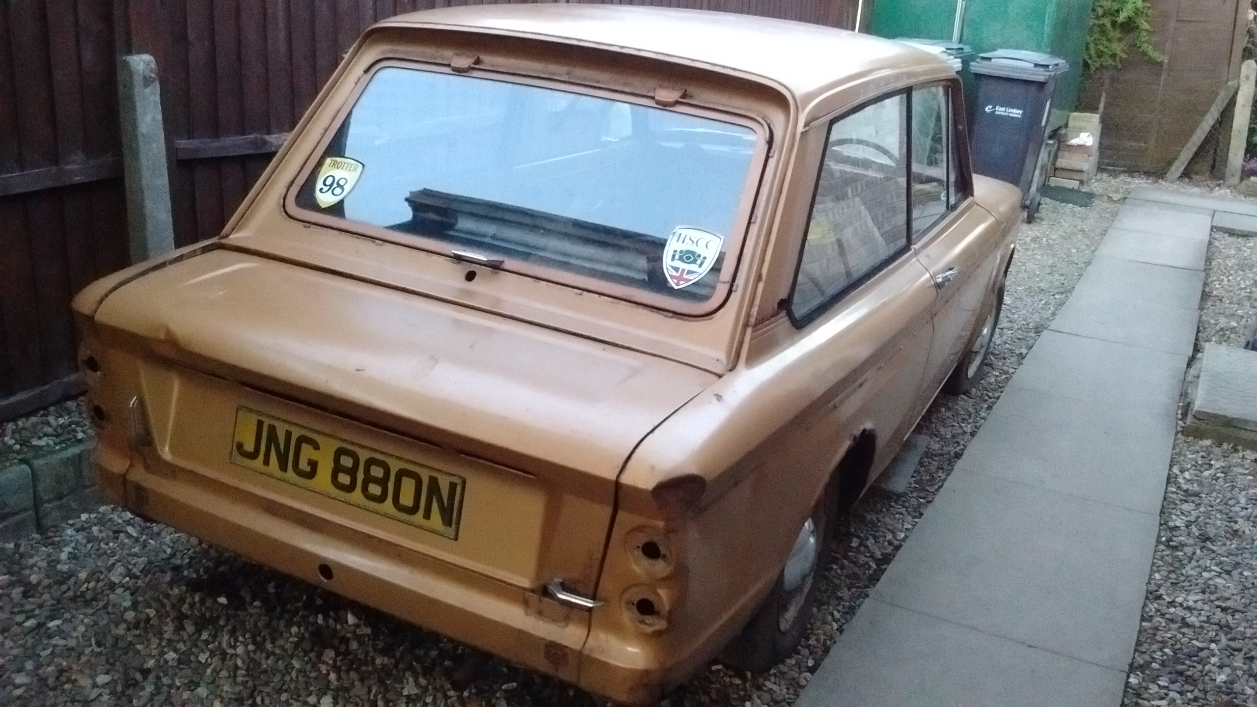

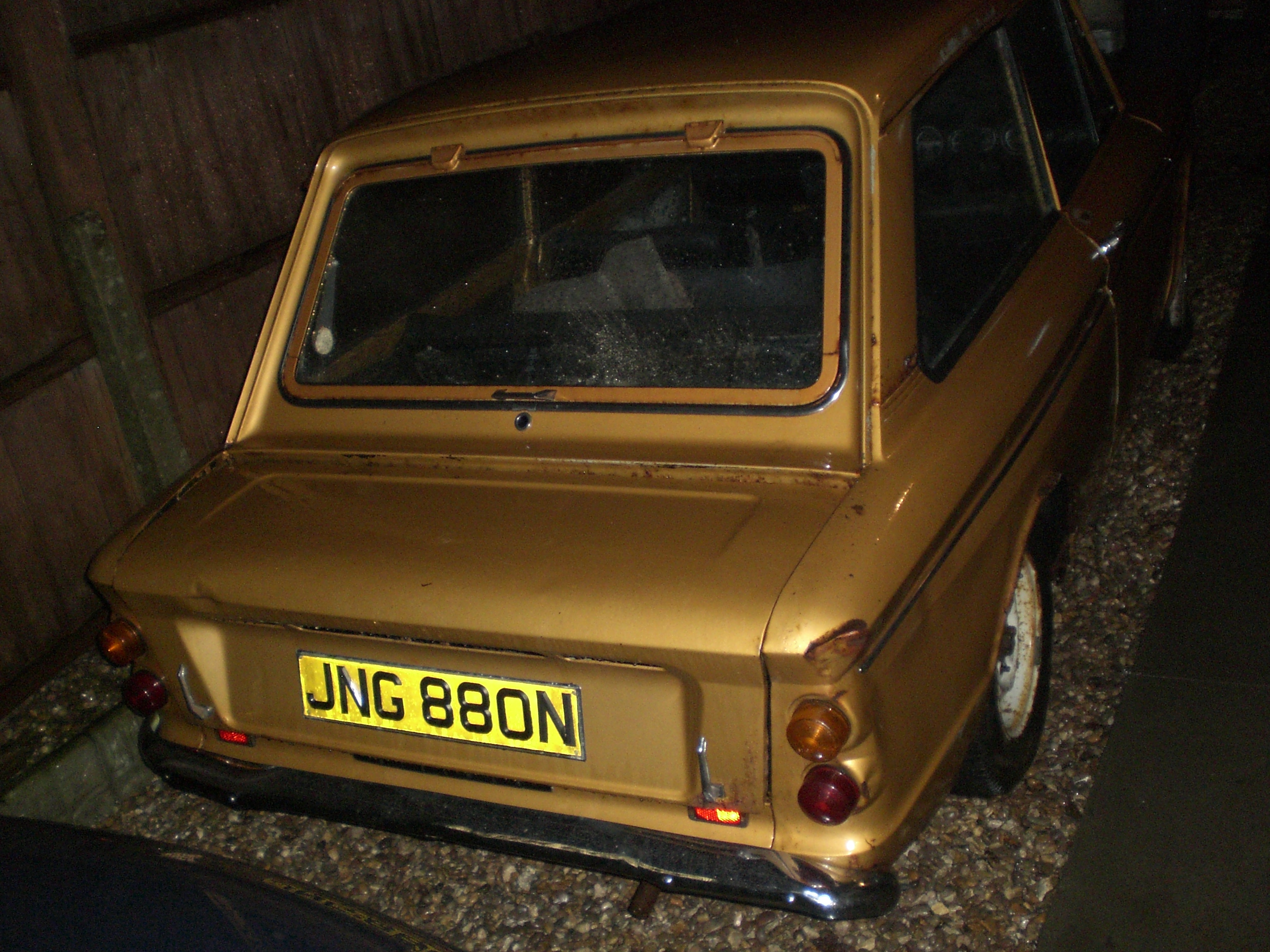

a new addition to the driveway today, my lad rob turns 17 in june so we've got a little project car for us to get sorted for him. give him some practical experience to go with the college work...

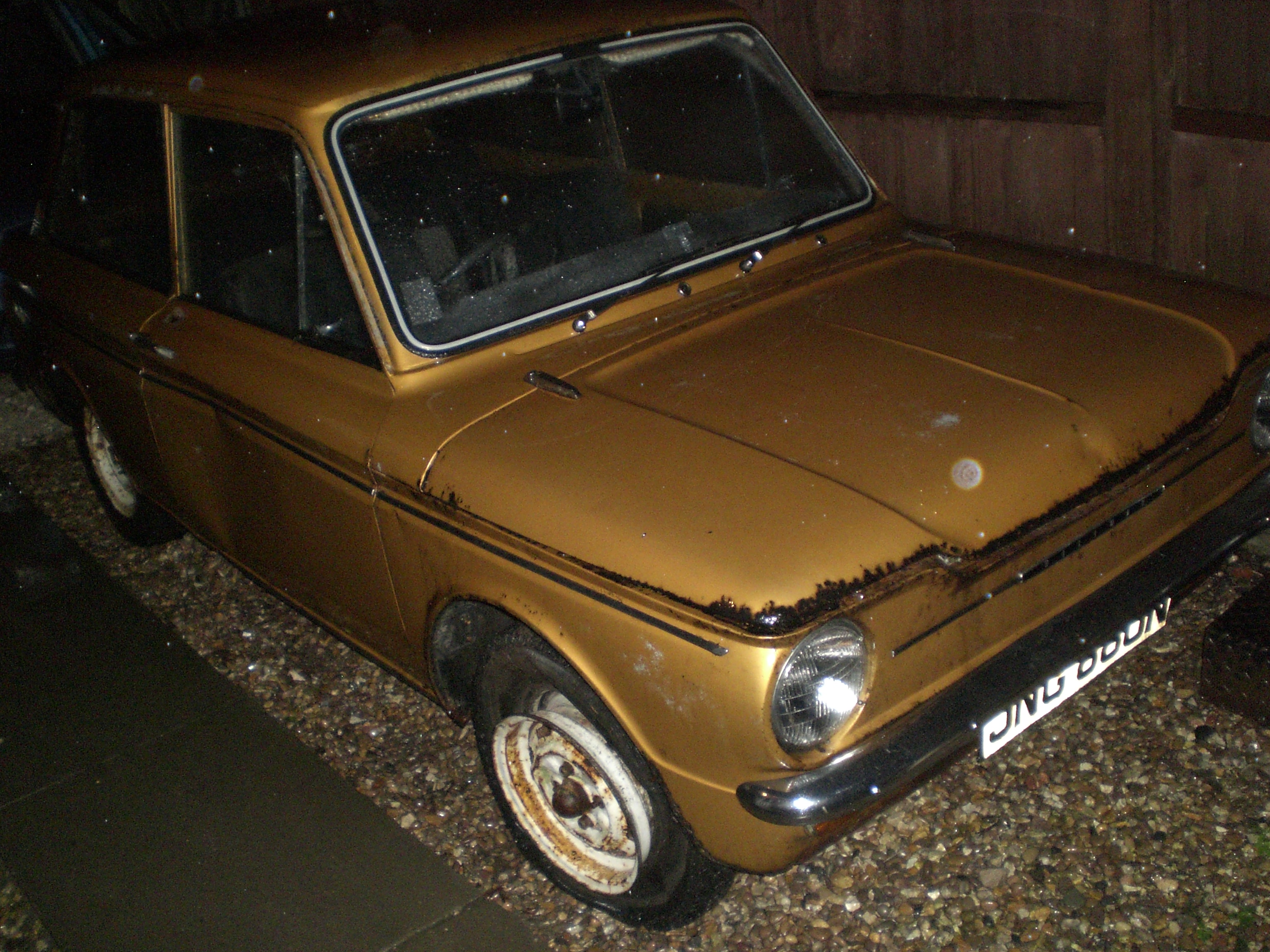

his 2nd car.......another driveway addition tonight, thanks again to the wonderful services of shrew ;)

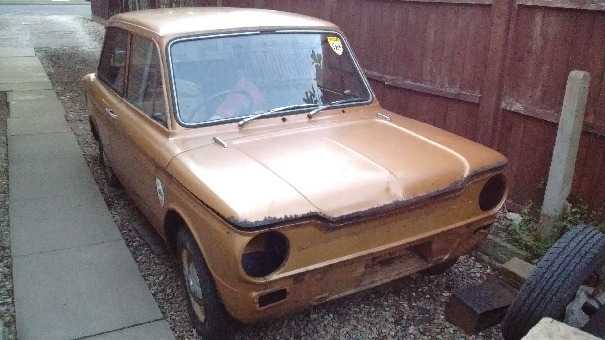

he's been having 2nd thoughts about the state of the imp, partly prompted by the Mrs who only sees doom and gloom with rust rather than the challenge of resurrecting another classic :)
so this afternoon we set to and made an attempt to coax it back to life
when I returned back from meeting Richard he was busy cleaning all the interior out having removed the rear seats and skimmed over the fact that it's a flintstones replica in the back! didn't stop him sweeping out the rust and dust from the floor mats, must say though the seats have come up a treat. being vinyl so easy to wash and make look better helps no end.
he'd also got the spanners out and was pleased to report that the engine wasn't seized up, a good sign!
so after a few checks I attached the integrales' battery to gain some power for the points etc. they looked fairly new so just took them out, cleaned the contacts and set them to what looked about right.
the throttle cable and linkages are seized solid so I just removed them and used the spindle direct.
replaced the fuel line to the carb and stuck one in a petrol can for the supply tank
starter solenoid wasn't working so a thick screwdriver was a decent substitute....first problem
starter just span over without engaging....second problem.
removed the starter and cleaned up the Bendix, it had stuck in position but came free easily enough. the old inertia ones throw themselves into the ring gear once moving, this one was just staying out
now we were cranking over I checked the outflow from the fuel pump, nothing......third problem.
stripped the pump down and cleaned out all the crud freeing off the stuck valves in the process
so with a squirt of brake cleaner down the carb we tried again and she fired right up!!
haven't run it long at all because of missing water pipes, a couple of seconds was enough to find out it wasn't knocking wildly or throwing clouds of smoke so once we get some water in we can be a bit more sure of its' health
all smiles from the lad himself complete with portable radio perched on the dash top :D

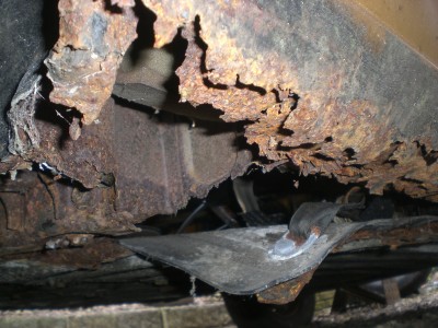

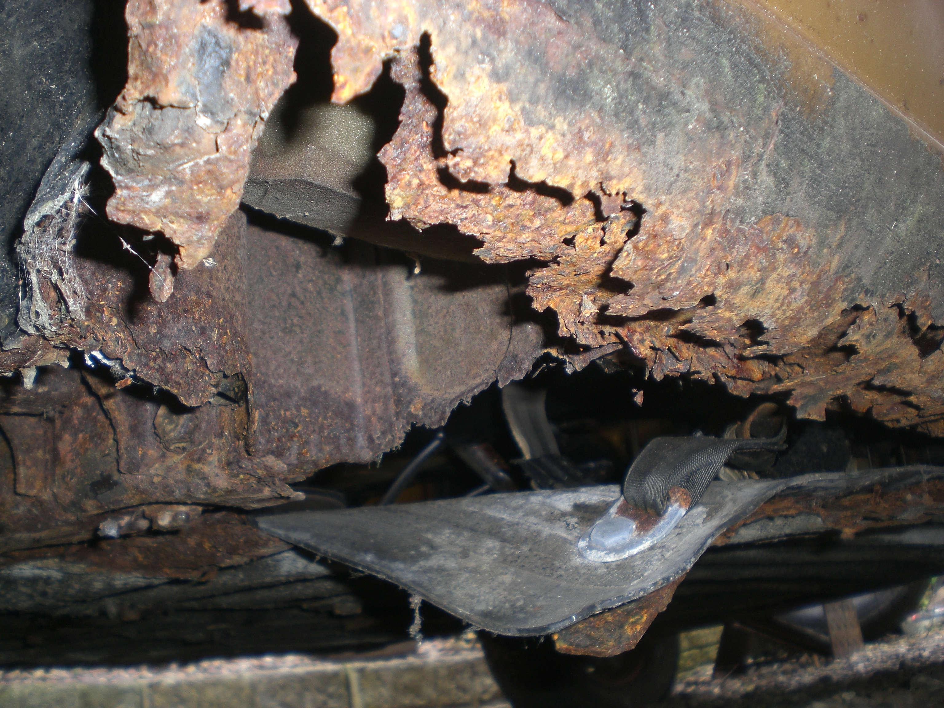

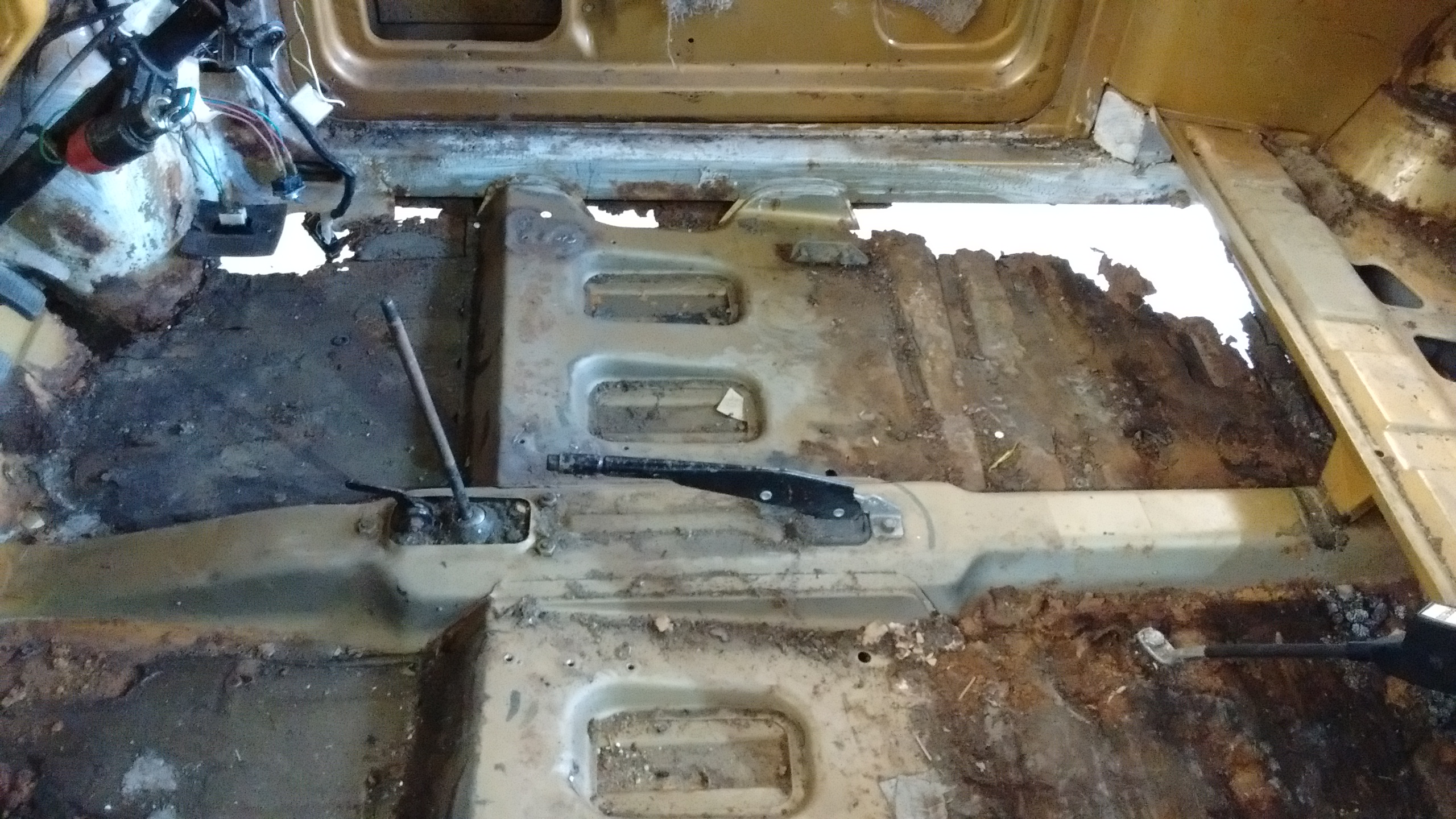

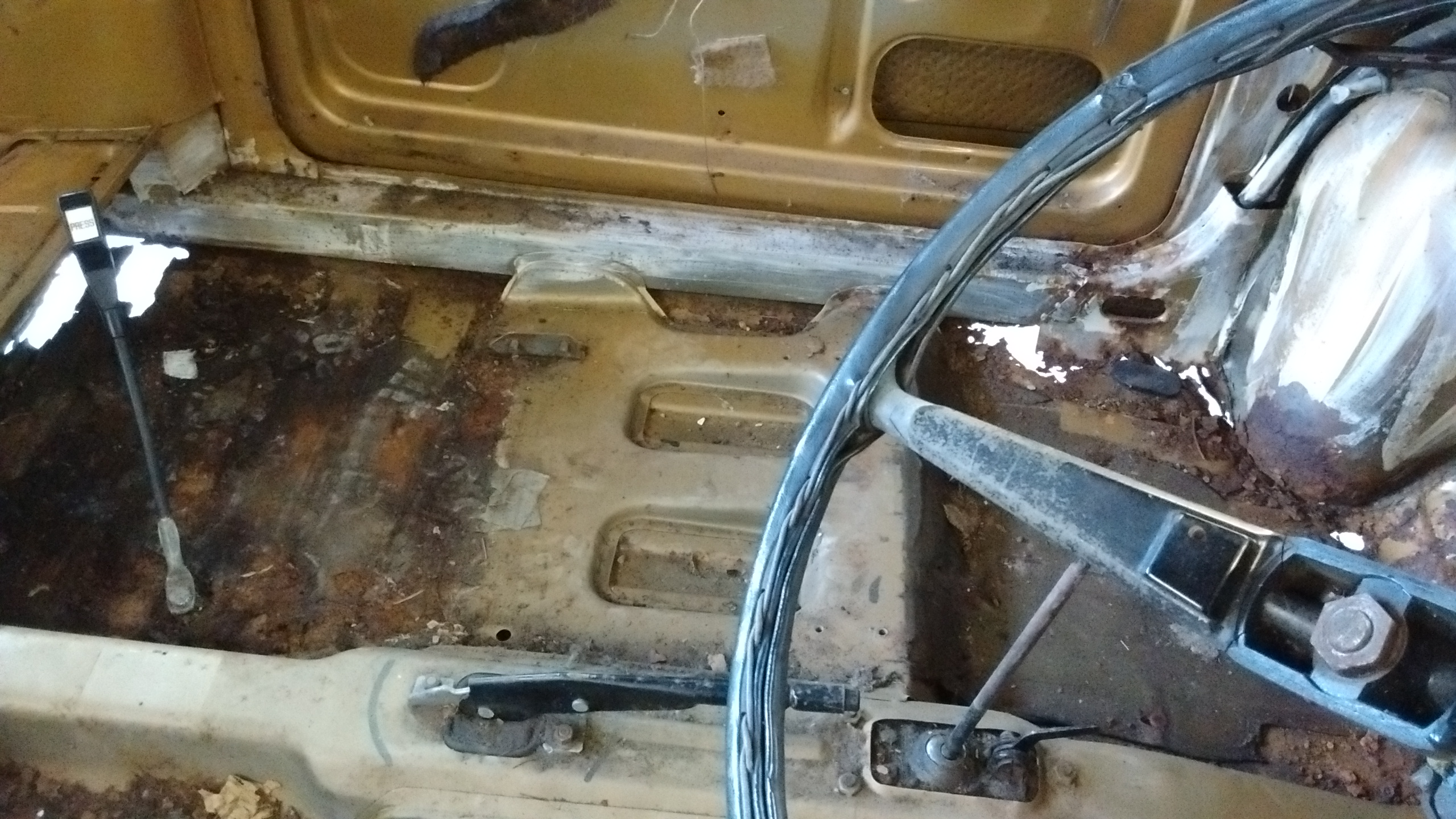

had a look under robs' imp this morning, not quite as bad as we thought...
inner sills we can save, repairs to the bottom edge lip should do it. saves a hell of a lot of extra effort chopping them out.
central sills will need repairing or replacing, outer sills are toast.
rear floors need chopping out
rear arches both sides, n/s/f one needs doing
rear 1/4 bottoms inner & out
battery tray area missing
new/used bonnet & boot needed plus a better rear window as frame has rotted out near latch
rear window opening has disappeared, will need reconstructing or replacing from another car...
a fair list of metalwork to do but not as bad as we thought

the imp is now pretty well stripped down, by rob I might ad. hope he remembers where stuff goes....everything is bagged and labelled so should be ok..
we have had it running, water pipes fitted up so we know the engine is sound despite appearances!
is an alarming amount of rust though so the welder will be kept busy...

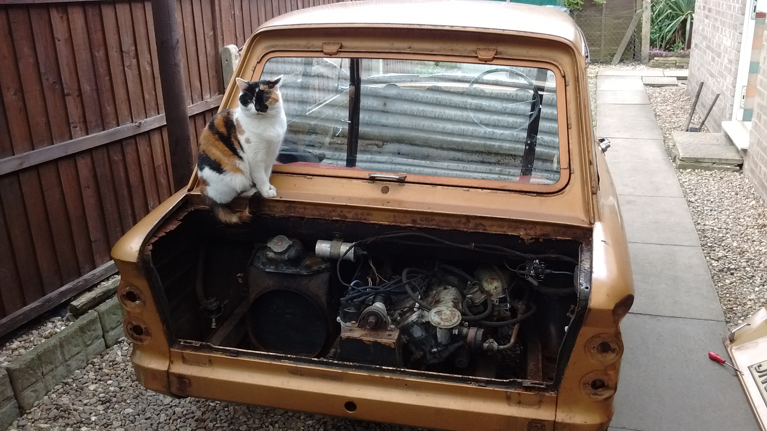

"oi, where do you think you're going with my digs?"
cat has been using the imp as an overnight den for the last few days :D

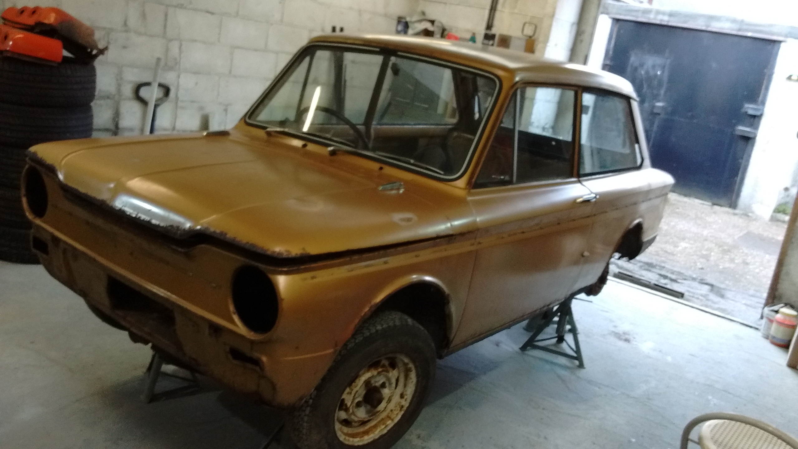

Re: robs' first car....

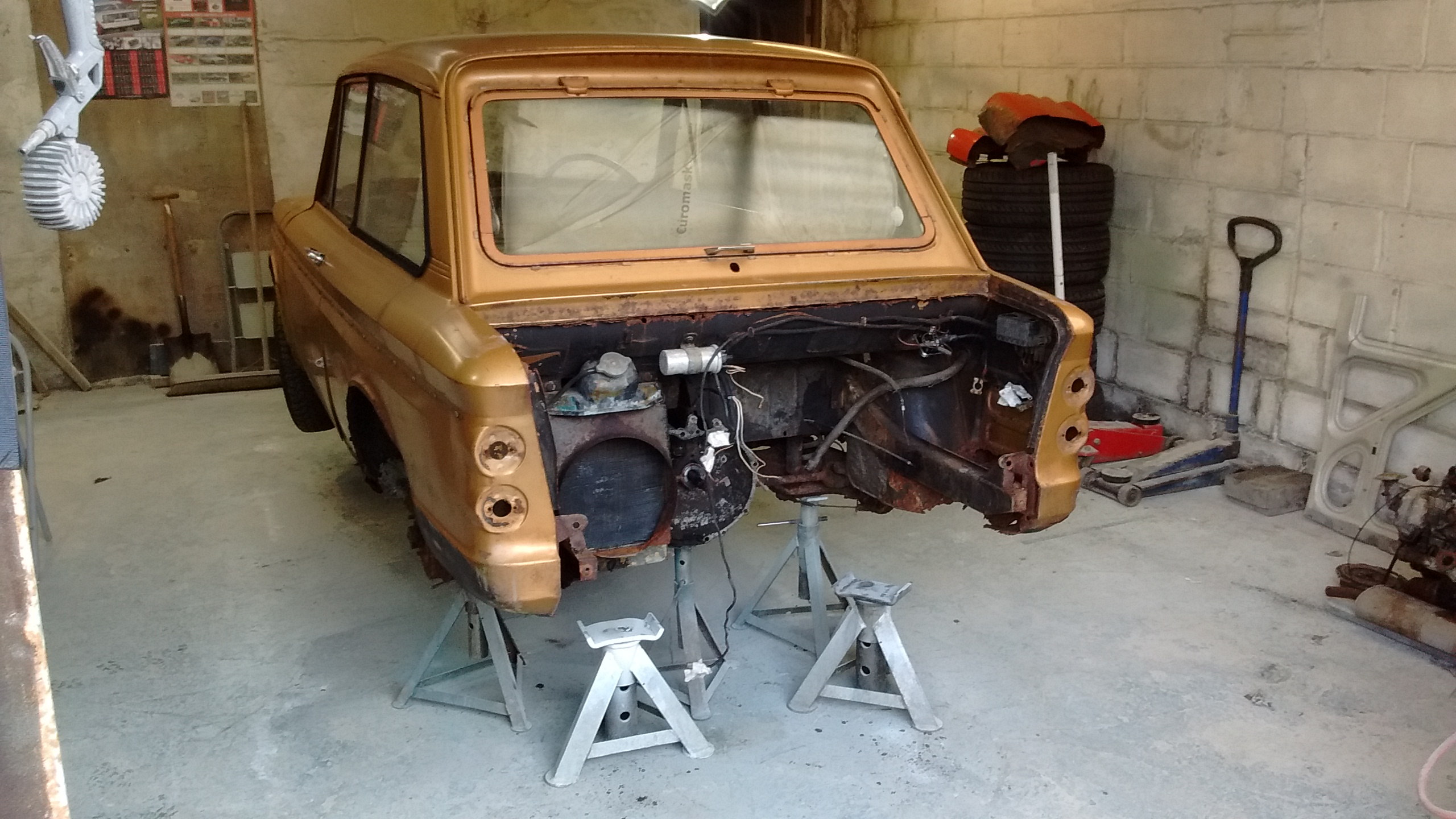

borrowed a mates trailer, didn't bother shrew as it's just a local trip ;)
got the imp up to the unit then met Kev to hand over the sud parts, sorry they were a bit dirty mate!
after a chat and a quick clean out of the unit we unloaded the imp into it's new stable then got it up on some stands.
beauty of the rear engine design is the back panel unbolts then the engine can be slid out on a trolley jack....so we did :D
up on stands now ready for the metalwork to start...
bit of rot to sort through... :D

cat walked out the door tonight then stopped in it's tracks, no imp there! you could just imagine the thoughts :lol:
