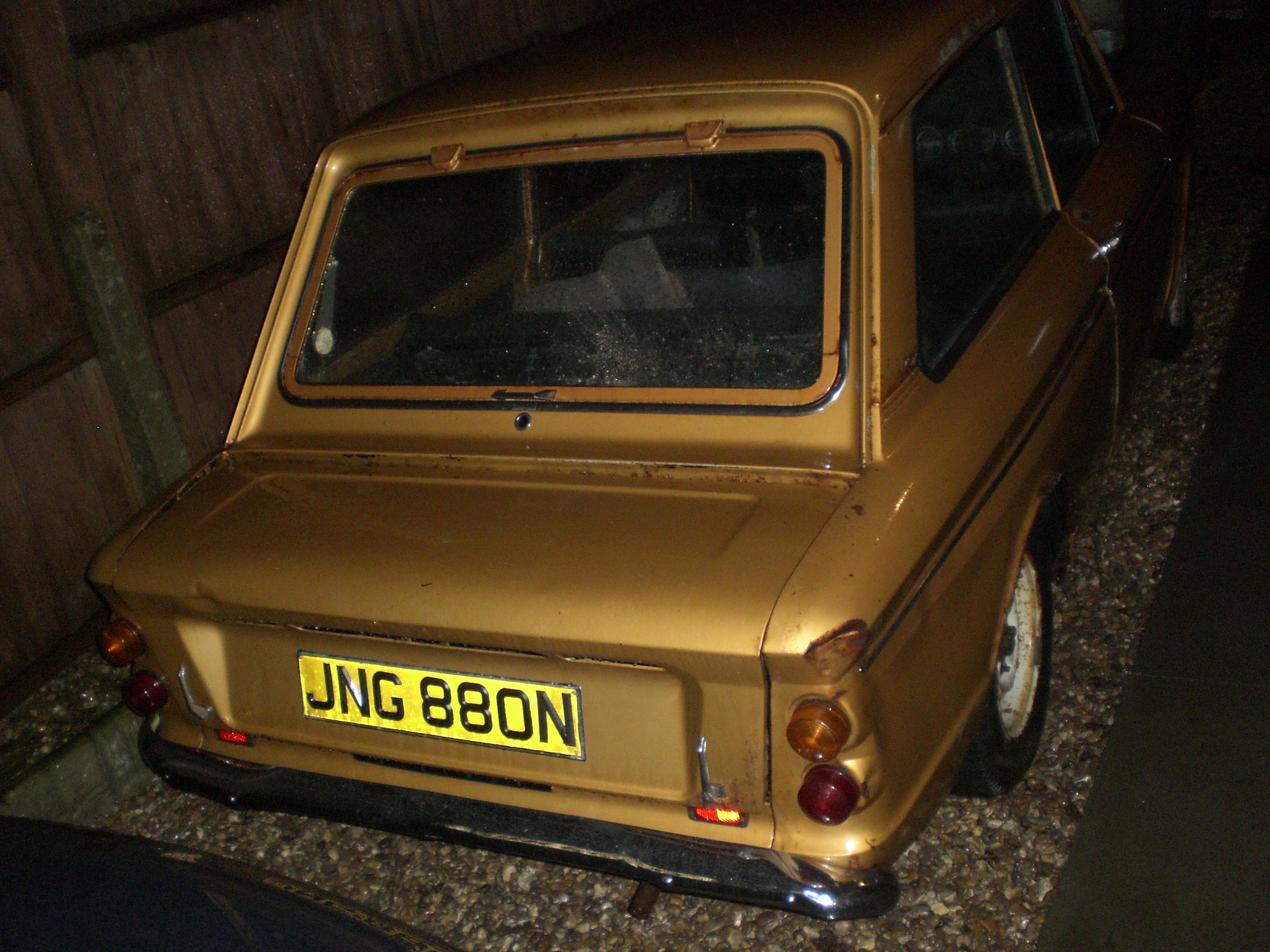

a new addition to the driveway today, my lad rob turns 17 in june so we've got a little project car for us to get sorted for him. give him some practical experience to go with the college work...

had a look under robs' imp this morning, not quite as bad as we thought...
inner sills we can save, repairs to the bottom edge lip should do it. saves a hell of a lot of extra effort chopping them out.
central sills will need repairing or replacing, outer sills are toast.
rear floors need chopping out
rear arches both sides, n/s/f one needs doing
rear 1/4 bottoms inner & out
battery tray area missing
new/used bonnet & boot needed plus a better rear window as frame has rotted out near latch
rear window opening has disappeared, will need reconstructing or replacing from another car...
a fair list of metalwork to do but not as bad as we thought

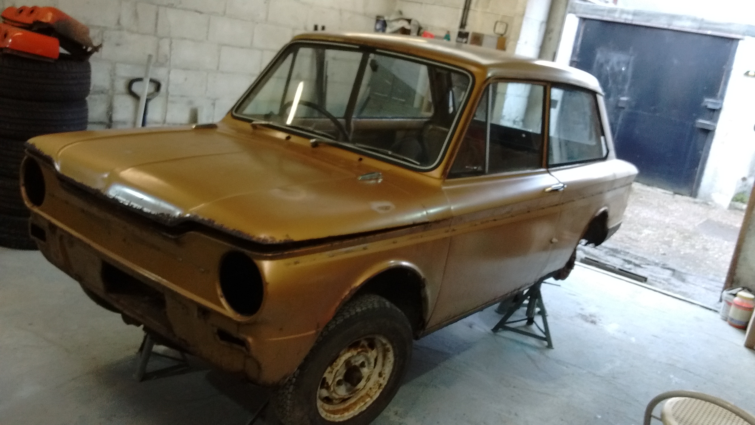

borrowed a mates trailer, didn't bother shrew as it's just a local trip
got the imp up to the unit then met Kev to hand over the sud parts, sorry they were a bit dirty mate!
after a chat and a quick clean out of the unit we unloaded the imp into it's new stable then got it up on some stands.
beauty of the rear engine design is the back panel unbolts then the engine can be slid out on a trolley jack....so we did
up on stands now ready for the metalwork to start...
bit of rot to sort through...

Re: robs' first car....
Don't you just love cats?
They decide where they want to be.
Looks like you and Rob have some late nights ahead.
