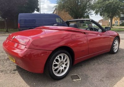

I thought I’d put a piece on the correct thread for our new addition (maybe we should have a 916 lounge) Charlotte wanted a modern classic ragtop and it came down to either a Merc SLK ?? Another MX5 or a spider. So here we have our 99 Spider 2.0ts. Bought as non runner due to a “Knocking” from the engine.
Price paid was proportionate to that diagnosis. (Given that prices for these seem to be on the up)
The car is generally very tidy but not concours. The paintwork is very acceptable with no signs of the usually lacquer peel or accident damage. I’m not touching it until I’ve got the turbo spider running again then this can go straight in the garage and I’ll assess the level of damage.

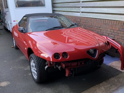

Big switcharoo done red spider in the garage and sliver one on trailer under a sheet (got no roof).

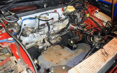

Managed to get the old Engine and gearbox out today pulled all the pistons and rods out and if it hadn’t been number one that went it could of been any of the other three as they’re all showing signs of starting to pick up on the shells. So next stop is a trip to Uncle Kev to reaquire a core lump that I’ll
go through and refresh. It’s should save me having to have the crank ground and hopefully speed up the rebuild
Re: My New 916 Spider
Oh yeah and the clutch was knackered aswell along with the slave cylinder so that would of been a failure waiting to happen . Obviously I’ll replace all knackered parts during this rebuild

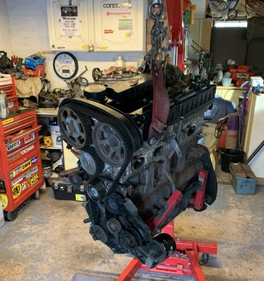

Engine refresh work started .got the sump off. So far it’s looks really good I’ve got to buy another engine stand tomorrow then i can get it off the hoist, remove the head and have a proper look
Re: My 916 Spider
After speaking to Nick Anderson (this is his old engine out of his race car). He gave me some background in the engines condition and mileage as a result I decided to restrict my efforts to a clean up and inspect instead of a full rebuild. This will allow us to start to use the car asap. So I’ve now got the it All back in. I’ve still got a few bits to finish like drive shafts, exh manifold and front pipe. Along with all the belts, lubricants and coolant all being well this time next week it’ll be a runner. I’ll now finish stripping the old engine and I’ll get the crank ground so at least It becomes a useable spare. But this can be done at my leisure
