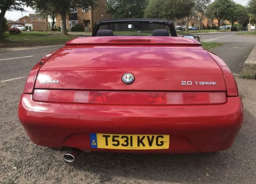

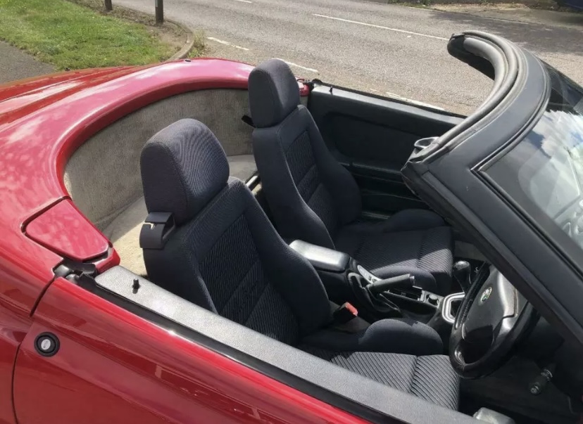

I thought I’d put a piece on the correct thread for our new addition (maybe we should  have a 916 lounge) Charlotte wanted a modern classic ragtop and it came down to either a Merc SLK ?? Another MX5 or a spider. So here we have our 99 Spider 2.0ts.  Bought as non runner due to a “Knocking” from the engine.
Price paid was proportionate to that diagnosis. (Given that prices for these seem to be on the up)
The car is generally very tidy but not concours. The paintwork is very acceptable with no signs of the usually lacquer peel or accident damage. I’m not touching it until I’ve got the turbo spider running again then this can go straight in the garage and I’ll assess the level of damage.
