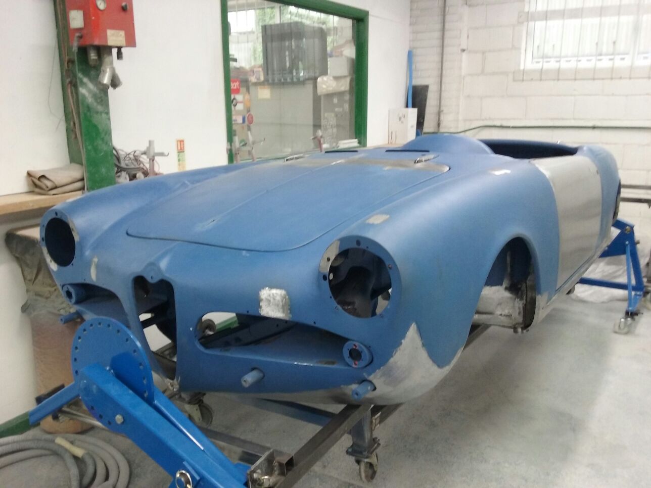

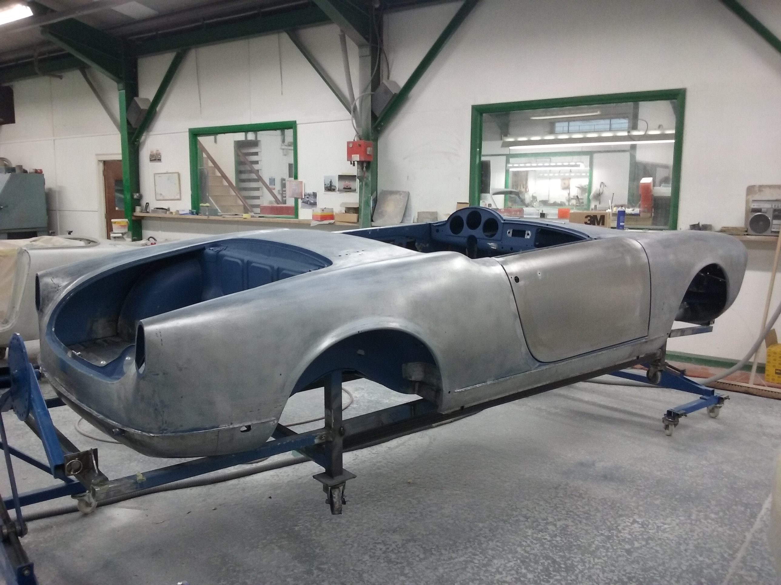

Hi guys,
I thought I would share with you a lovely project I have the pleasure of doing.
I want to point out that I can take no credit for the panel work, and the company I work for are only responsible for the preparation of the repairs , bodywork and paint work.
As the photos show, major floor and boot areas along with sill sections have been replaced, but the rest of the body is very good. It came to me on the frame with the use of rotisserie (never had use of one before, and it is fantastic).
The shell had been blasted and etched to protect while the metalwork was carried out but this was removed by me prior to my start.

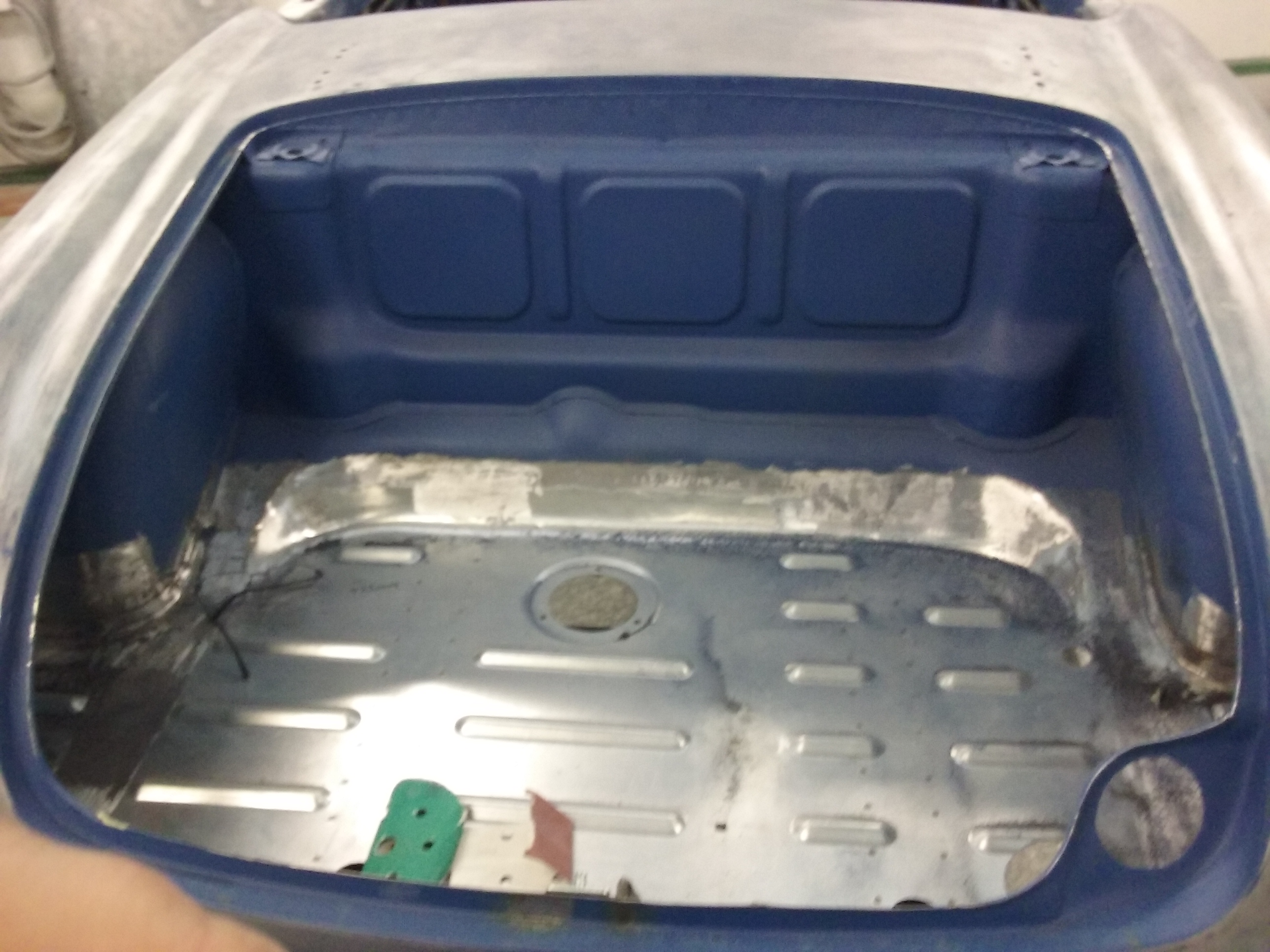

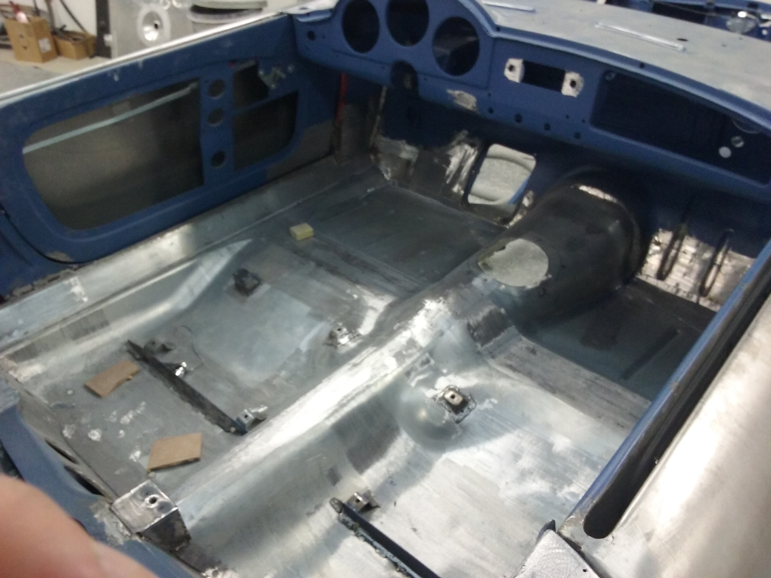

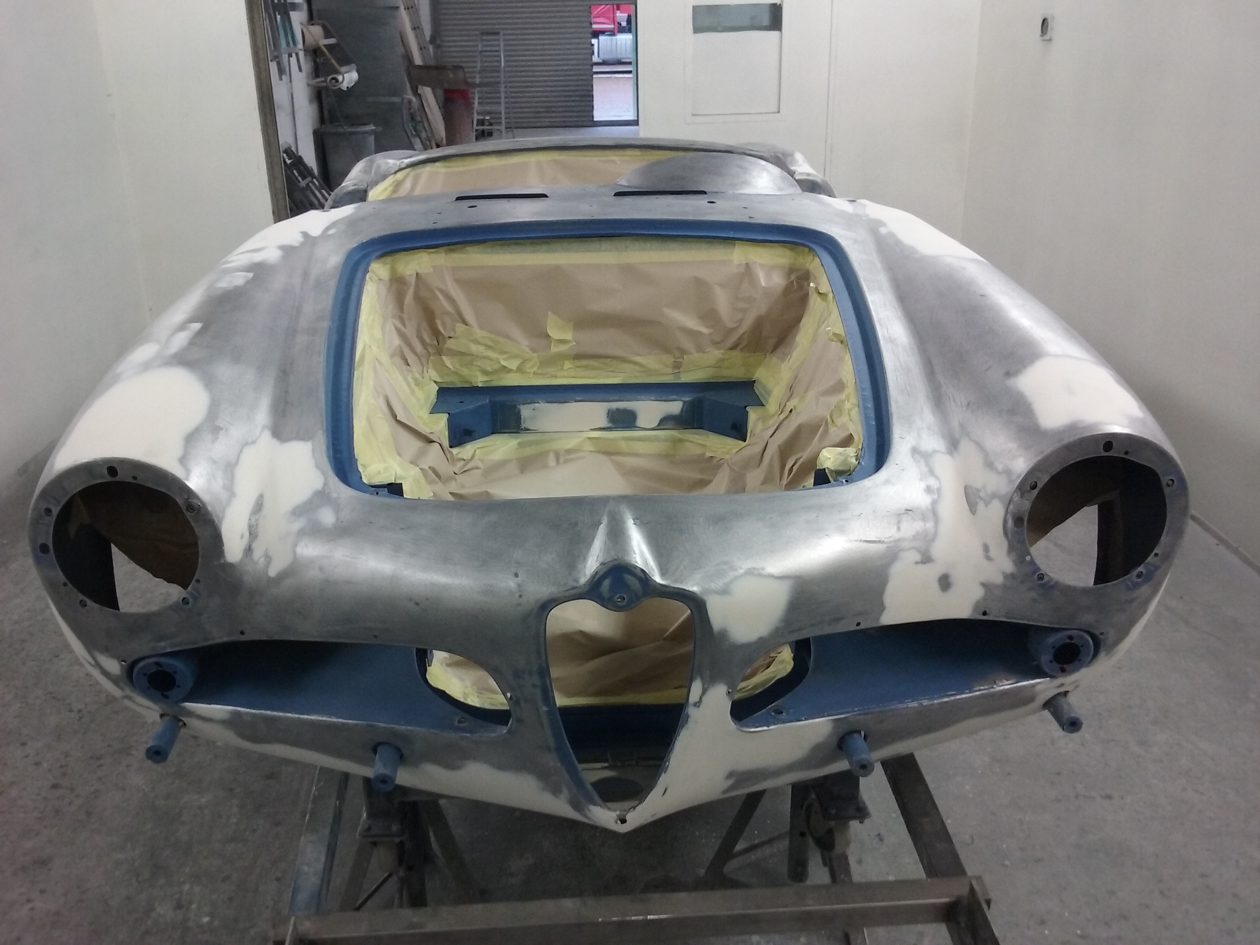

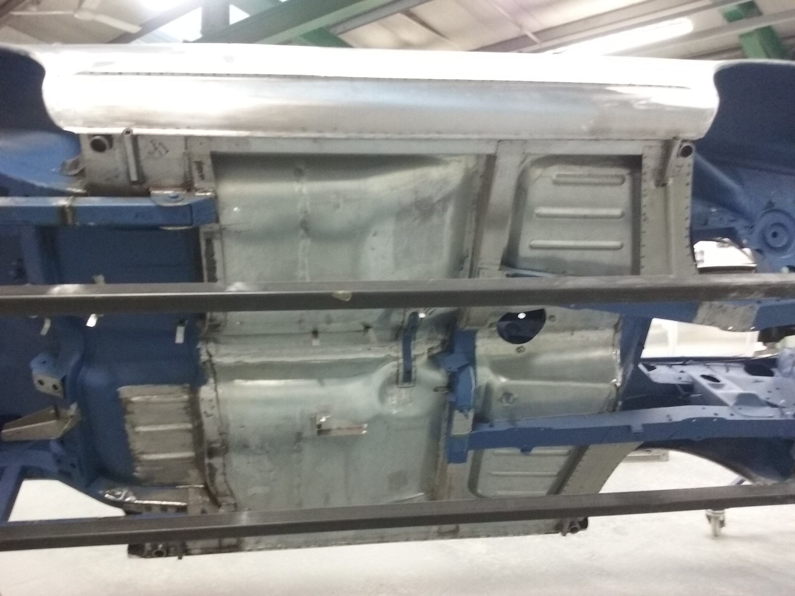

After sanding off the blue etch, I first shaped up some of the repair areas as they were buckled from heat and the new hand made door skins were in need of a bit of shaping along the bottom and corners.
As the car will be stone chipped and body colour underneath, I have also done some prettying up on the floor.
Re: Giulietta spider

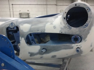

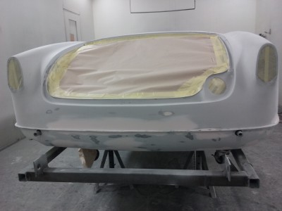

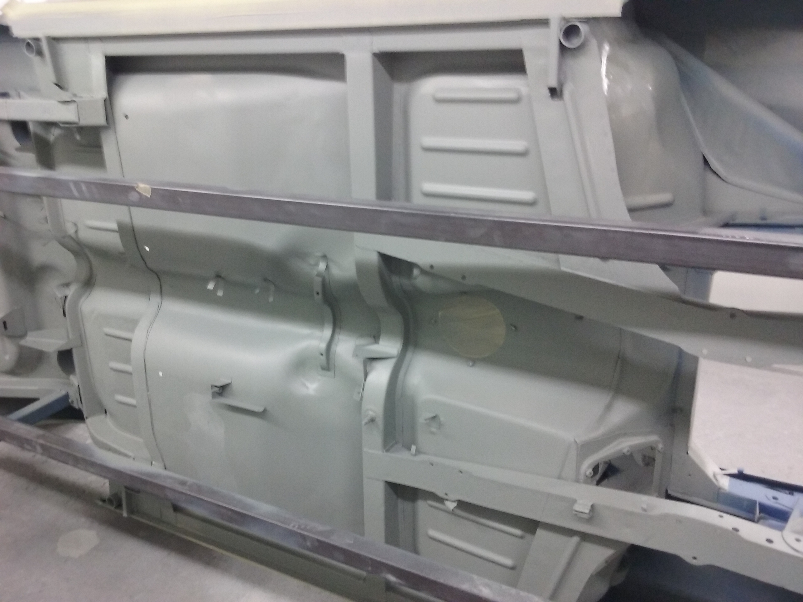

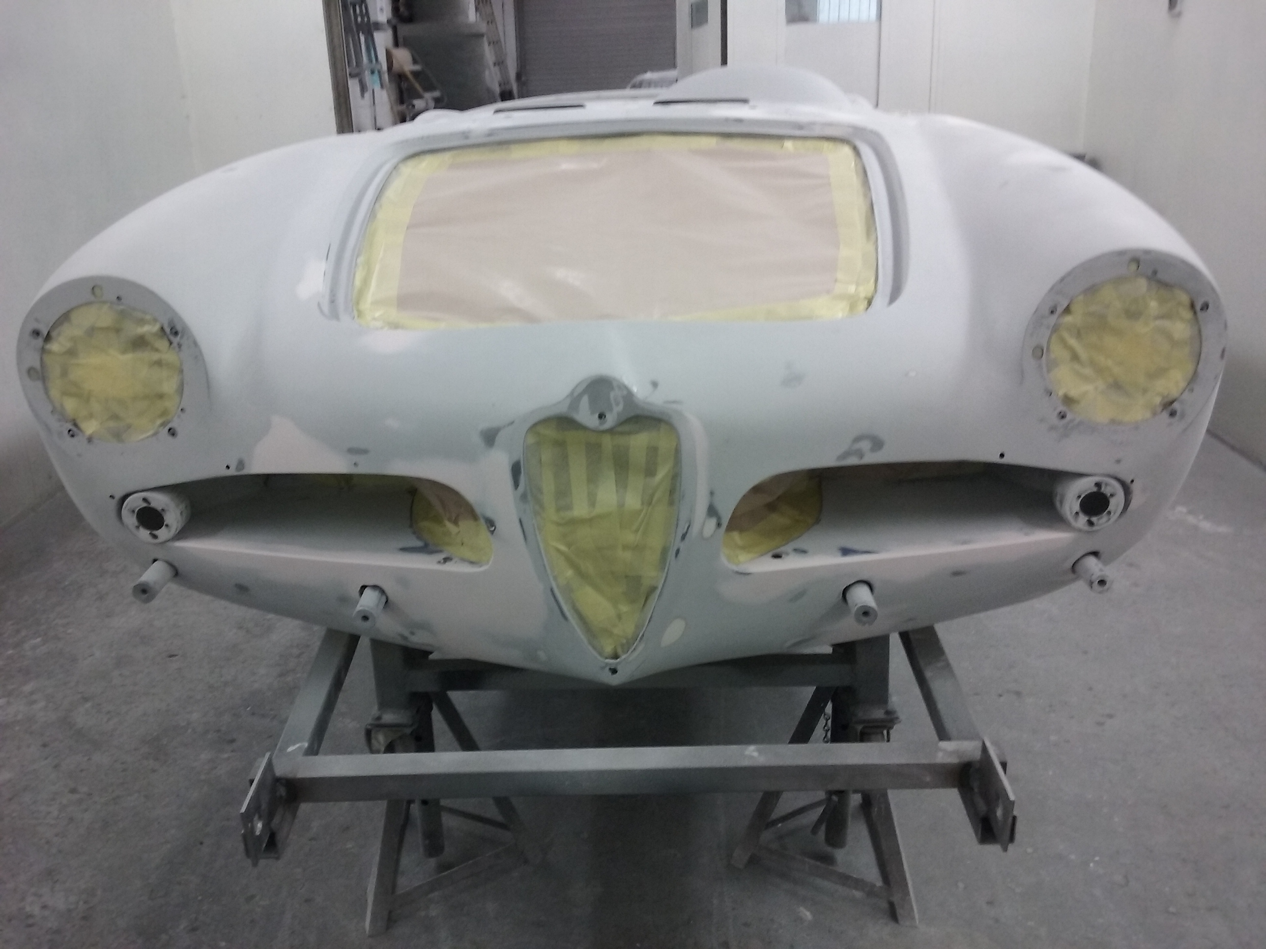

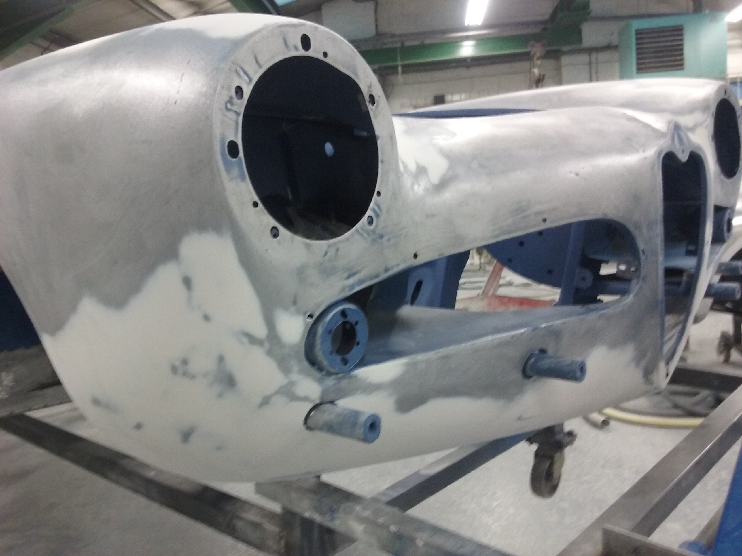

After the first prime up, the doors were re-fitted and adjusted so that I can shape the car so the body light lines flow as best as possible.
Using a long sanding block the shaping starts and low areas are built up with stopper.

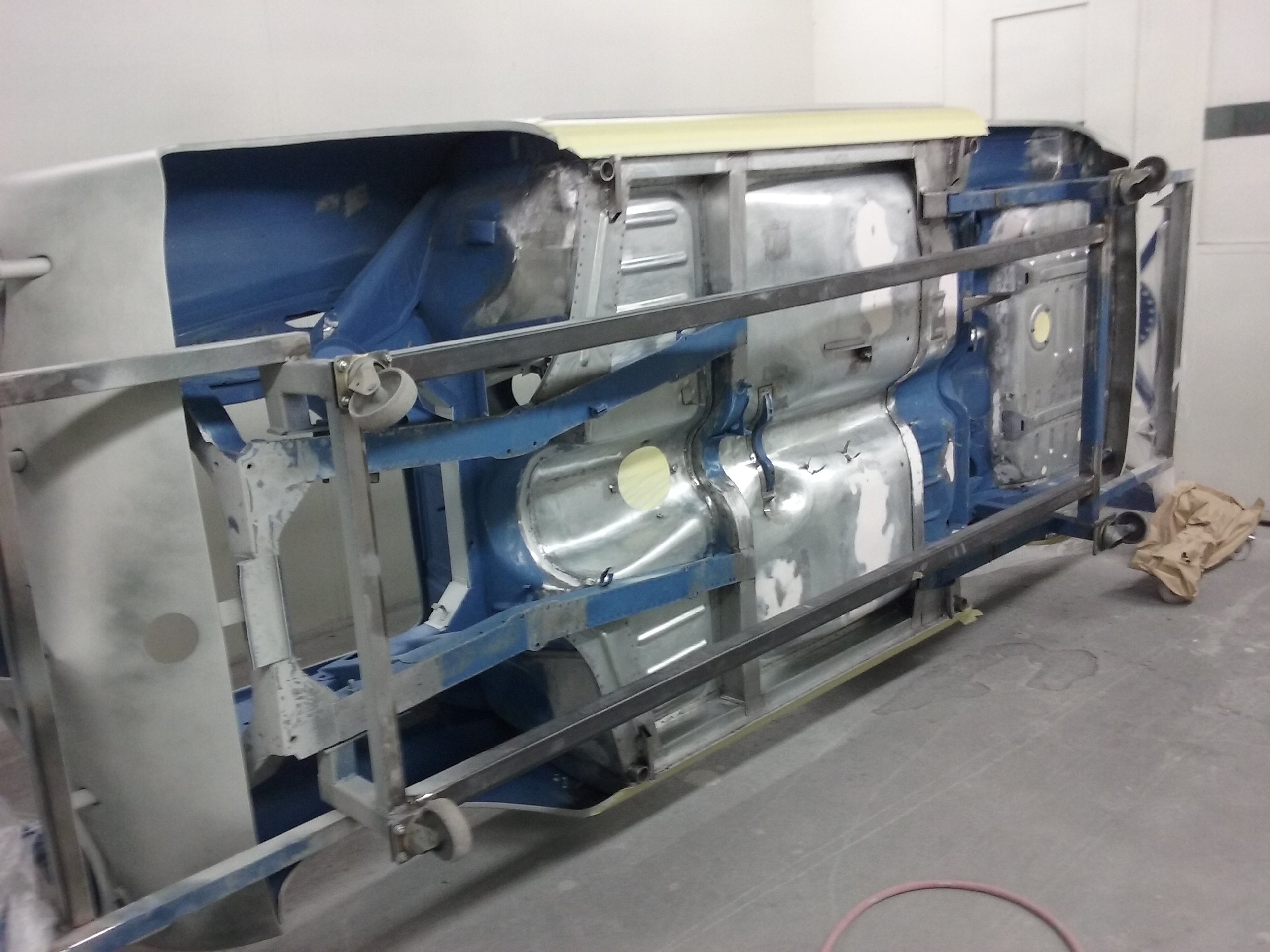

I have also primed inside the body tub as some of the body will be visible inside as well.

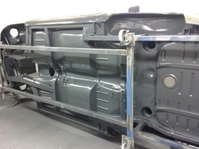

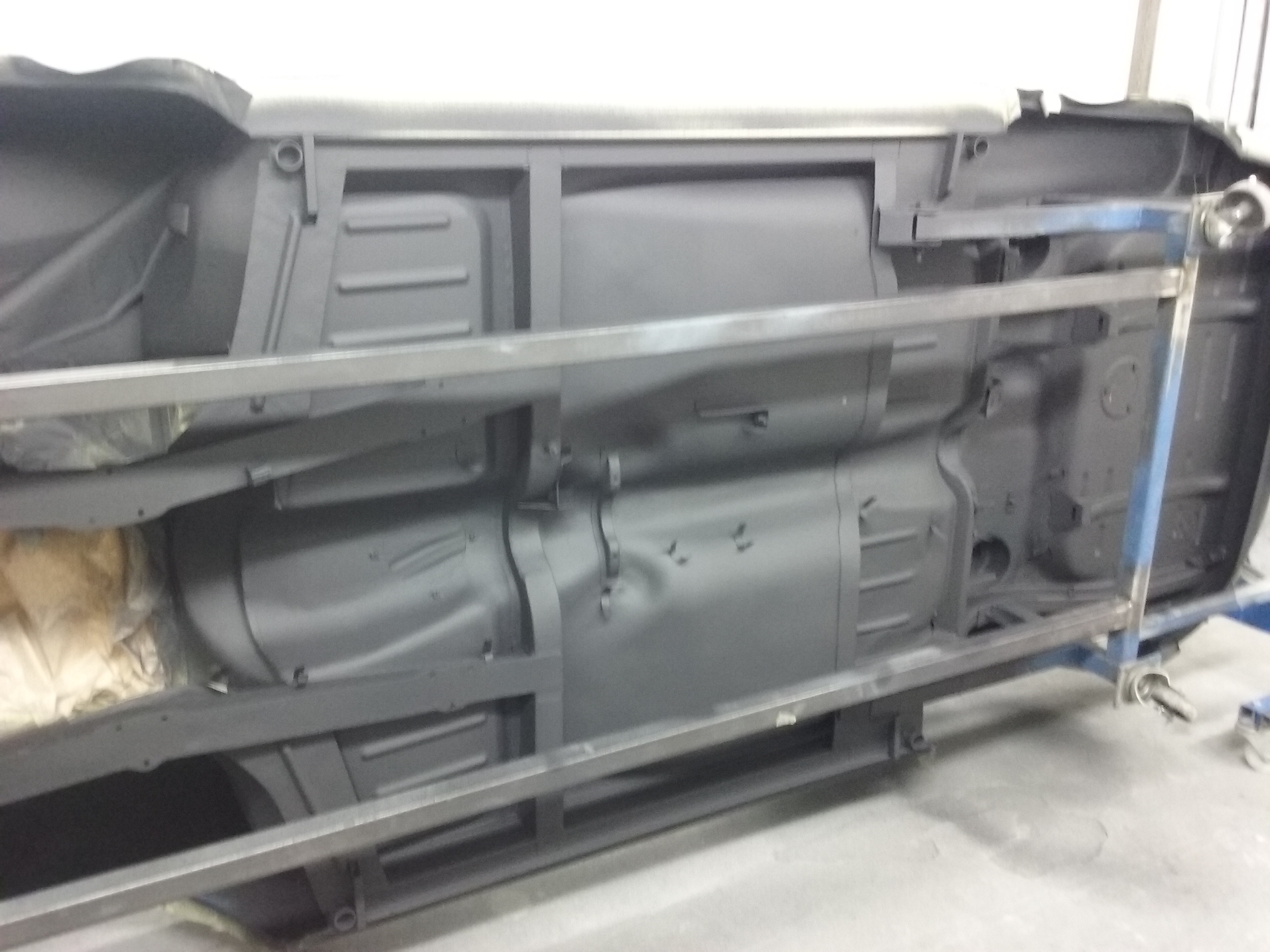

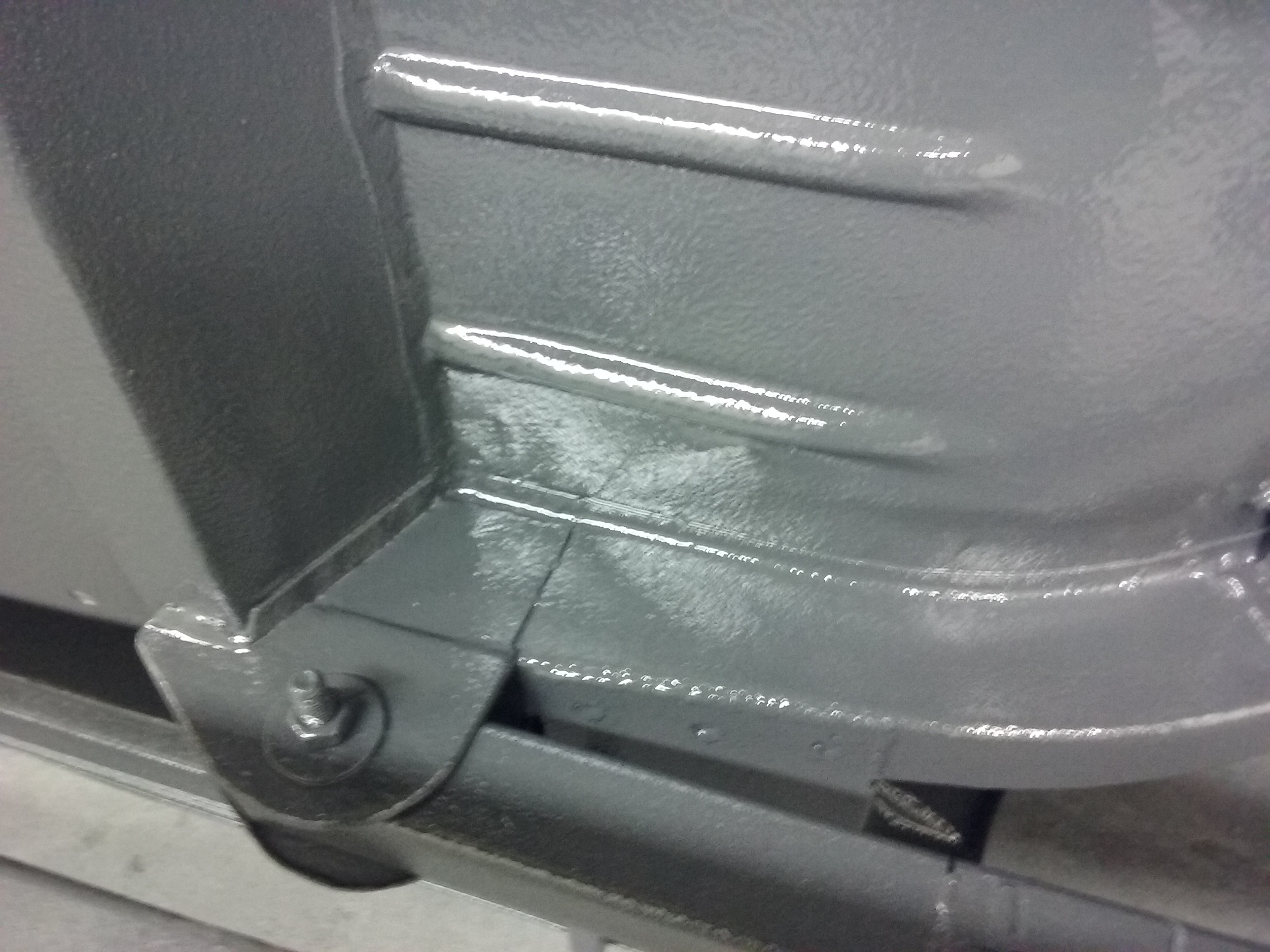

Underneath, the body has been prepped and etch, seam sealed and stonechipped.

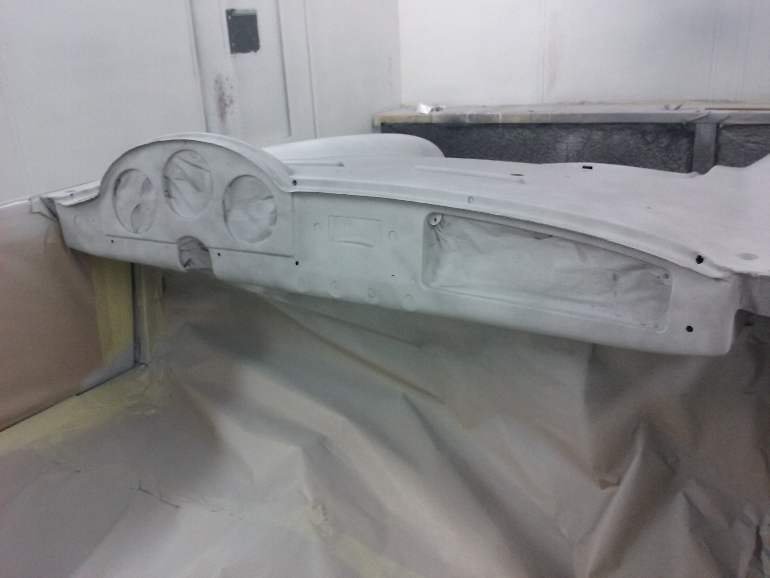

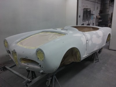

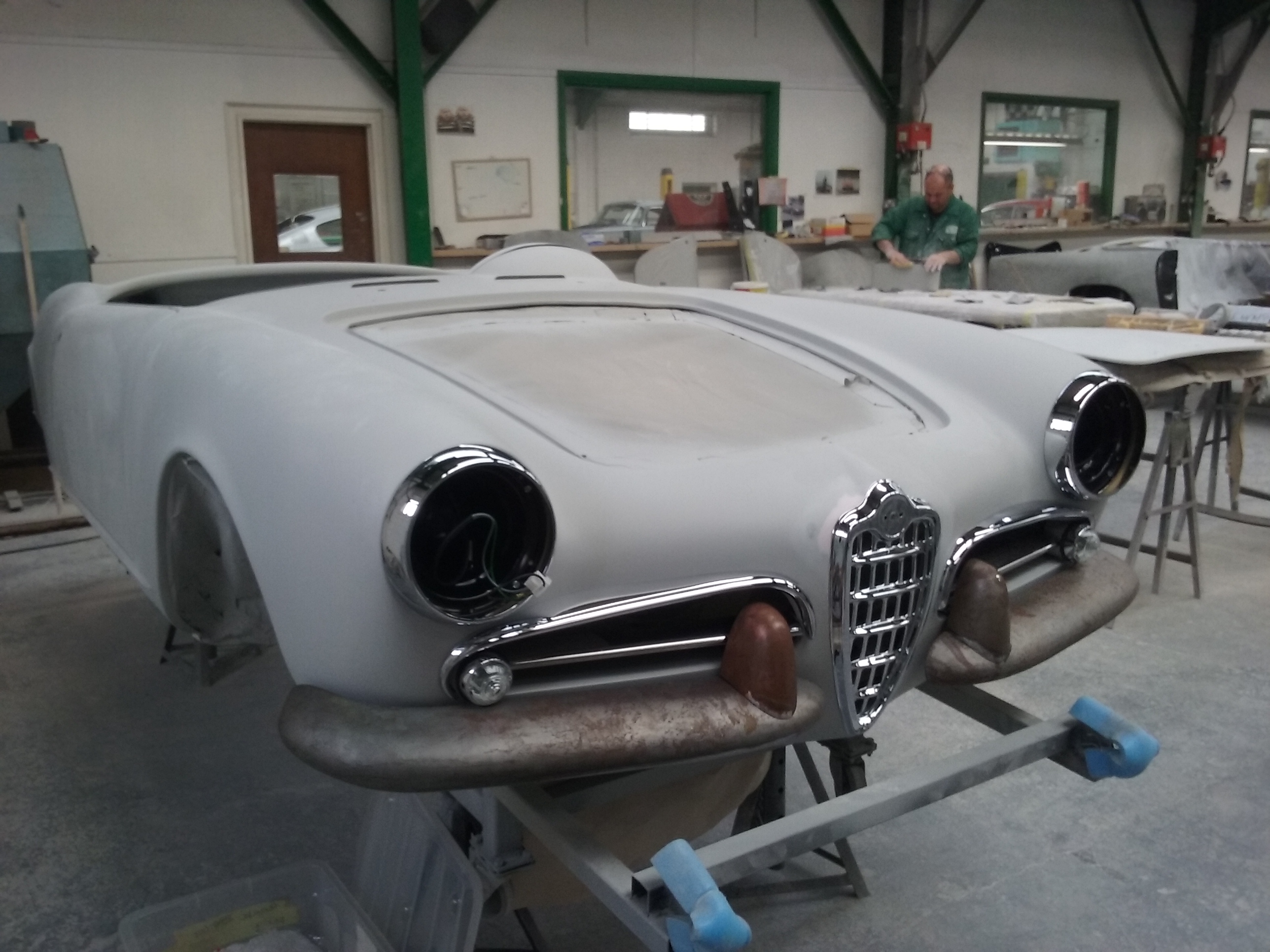

Here you can see where the low areas have been built up with stopper.
I have left the doors fitted at this stage so the adjustment isn't altered.

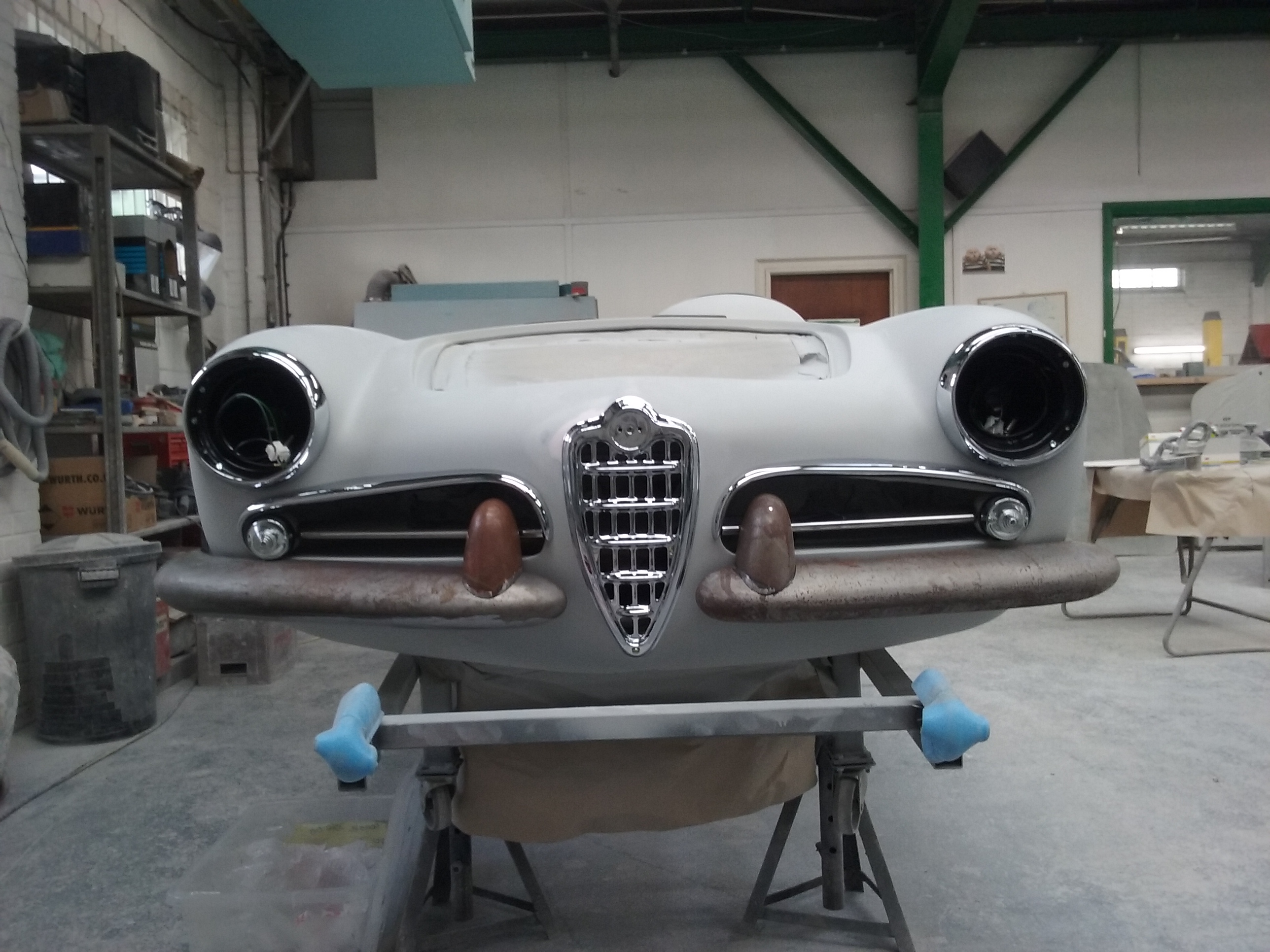

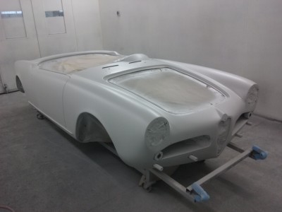

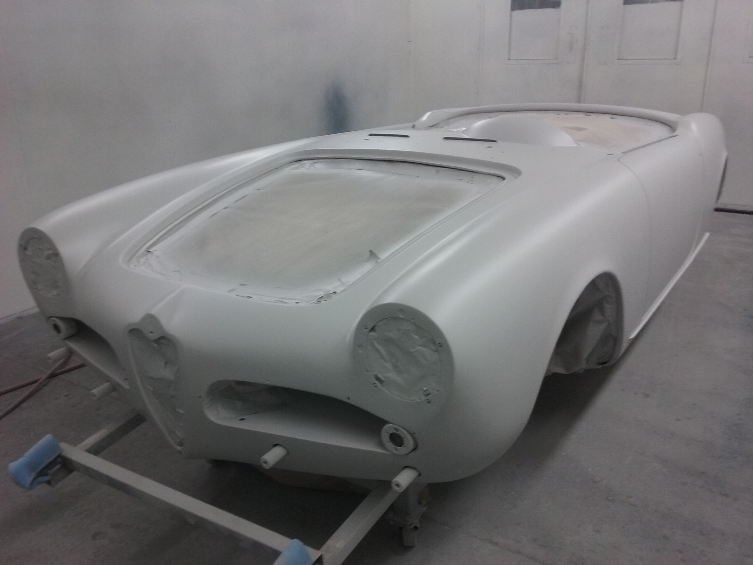

The car is then re-primed and blocked a second time with finer grade paper to continue the smoothing process. Again, any low areas are addressed with stopper.
Finally the third prime up was carried out and now the shape is about there.
We then did a dry fit of the bright work to satisfy ourselves that the critical points looked good.

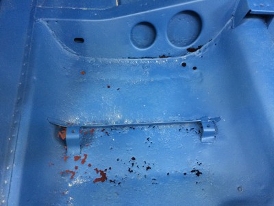

Thanks Lauren, yes pretty is the perfect word to describe the car.
Lots of water traps when you look at the underneath, so you can see why they rotted away in the day as protection would not have been that good.
Looking forward to the next stage as I will start throwing colour about soon.
I will do it in a few hits to keep dirt to a minimum. I will probably do the underneath first as the inner front valance is visible from the engine bay. Then the interior and boot, so that can be masked out to do outside. If the engine bay picks up any bad dirt, I can flat and re paint it. It is almost impossible to blow all the dust out and not cover everything in overspray.

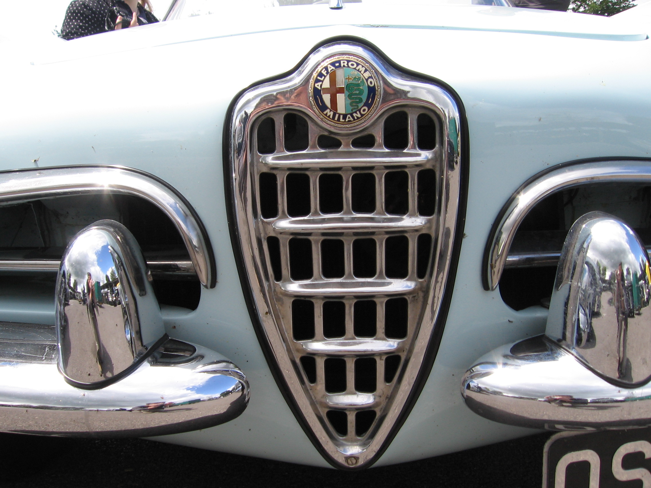

I'm guessing it will be the baby blue colour like this.Veesix75 wrote:Beautiful car, what colour will it be ? I can only dream of driving across Europe in a giulietta spider, such a pretty design.

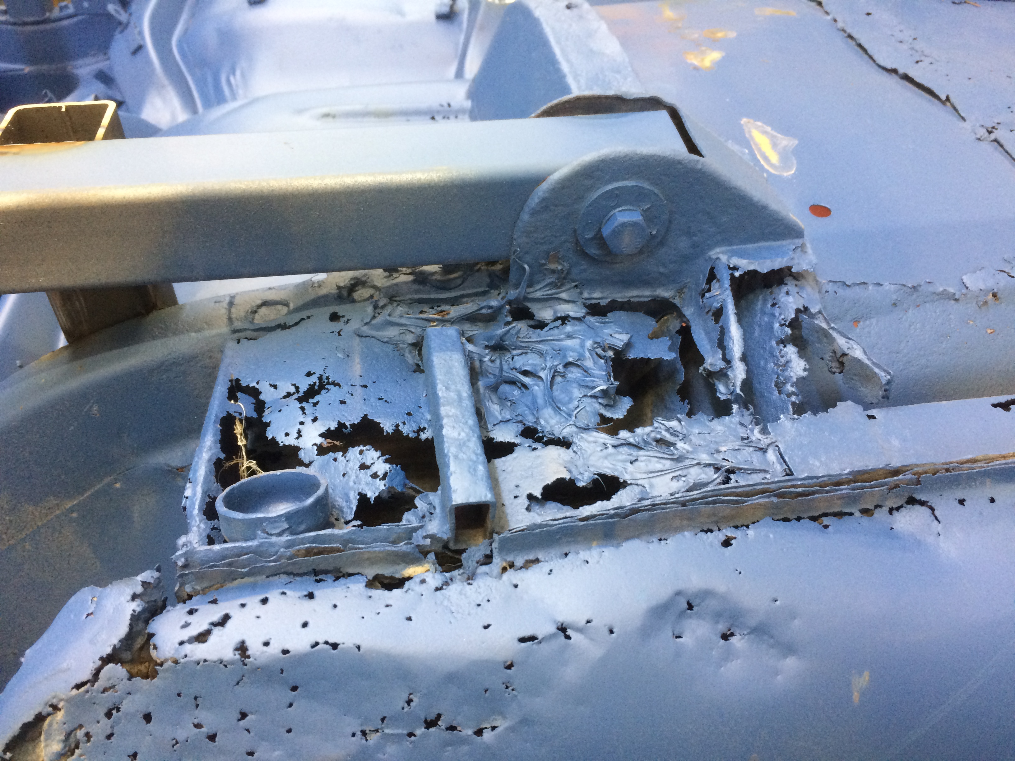

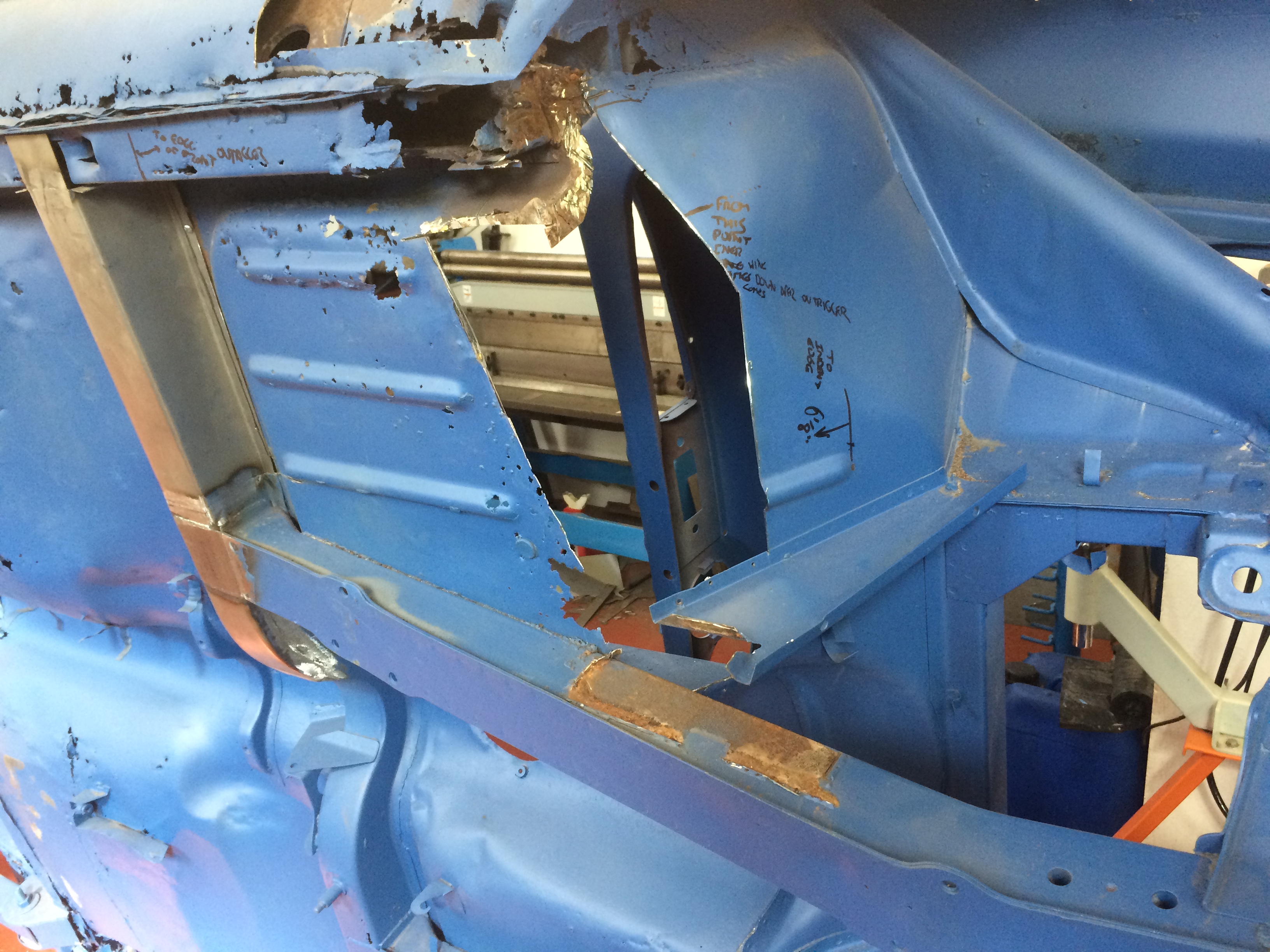

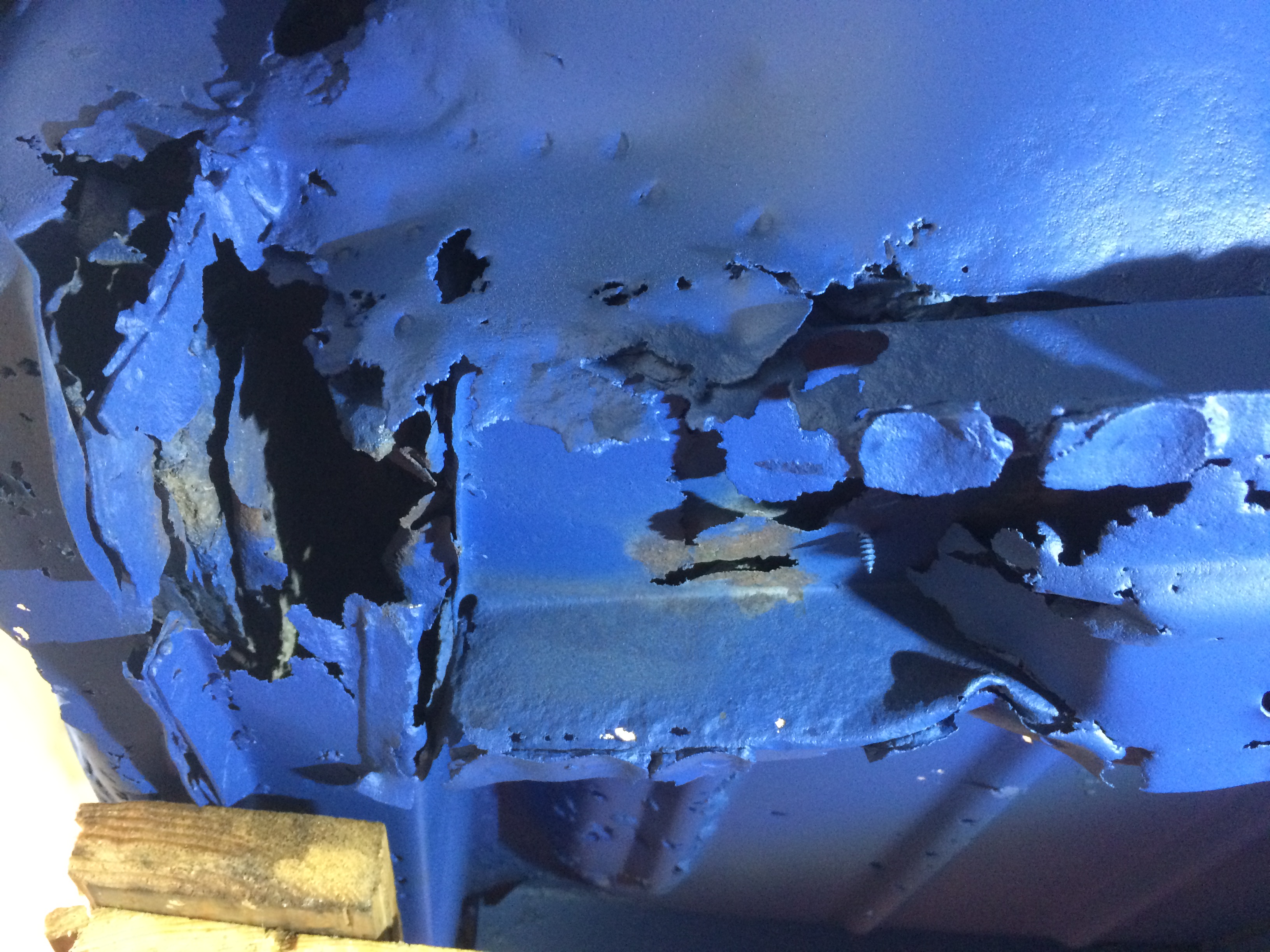

Thanks for your interest guys, And thanks Keith for your kind words re the metal work.

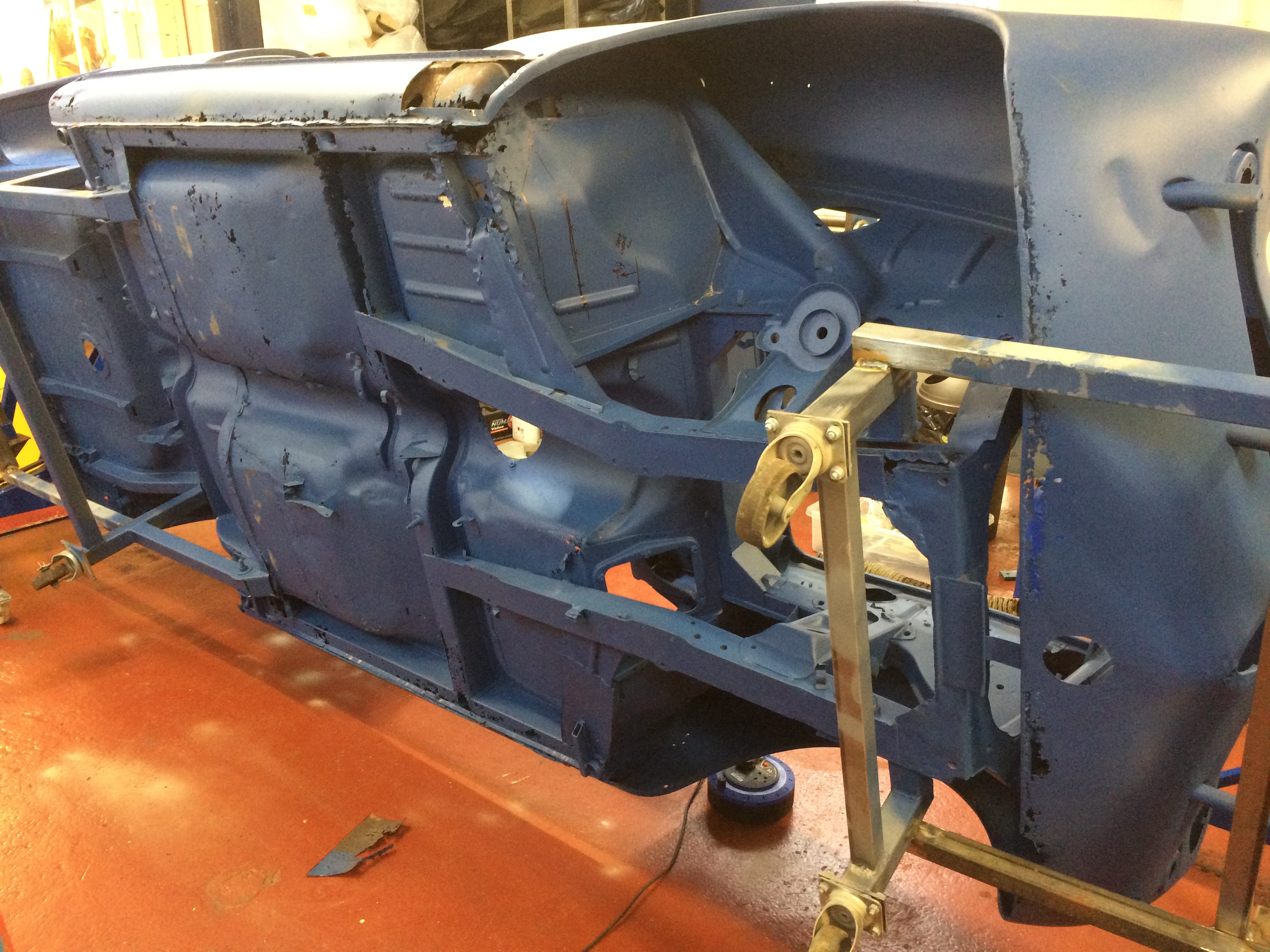

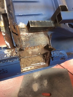

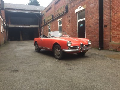

This lovely Giulietta s2 came in to us as a driver looking like this. So what did we do to this lovely patinated thing- take it apart.
But not before a test drive.
The test drive enables assessment of the car, and by driving it first you can pick up on all the inoperative features, gauges, electrical items, pull cables and levers etc. although everything will get attention, it helps if you are aware of its as found condition, especially if the repro replacement is poor, it helps with decisions further down the line.

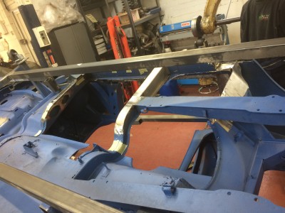

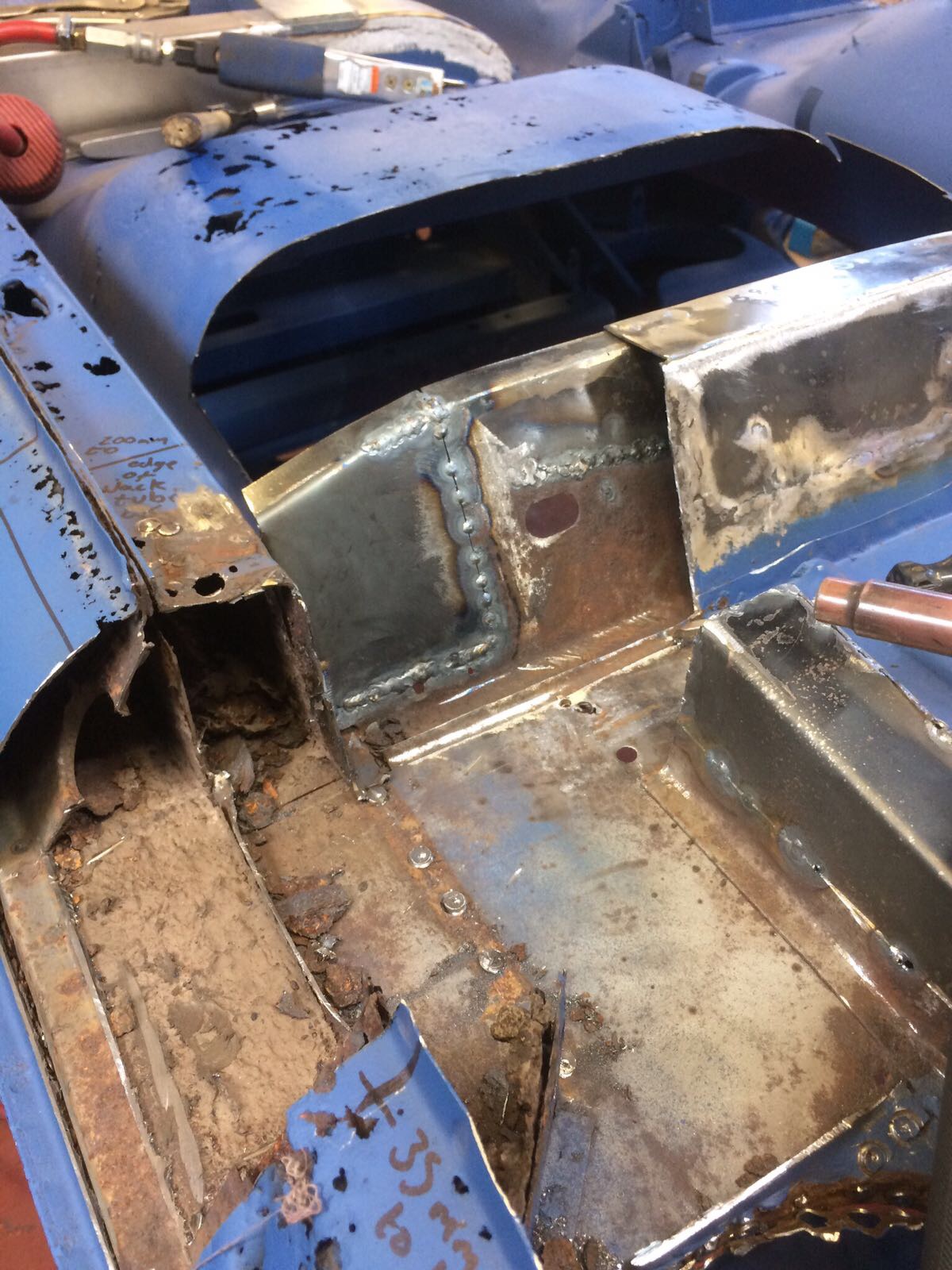

Right- metalwork.
So after blasting - and a coat of blue etch (our blaster is known for his blue..)
Right- metalwork.

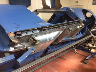

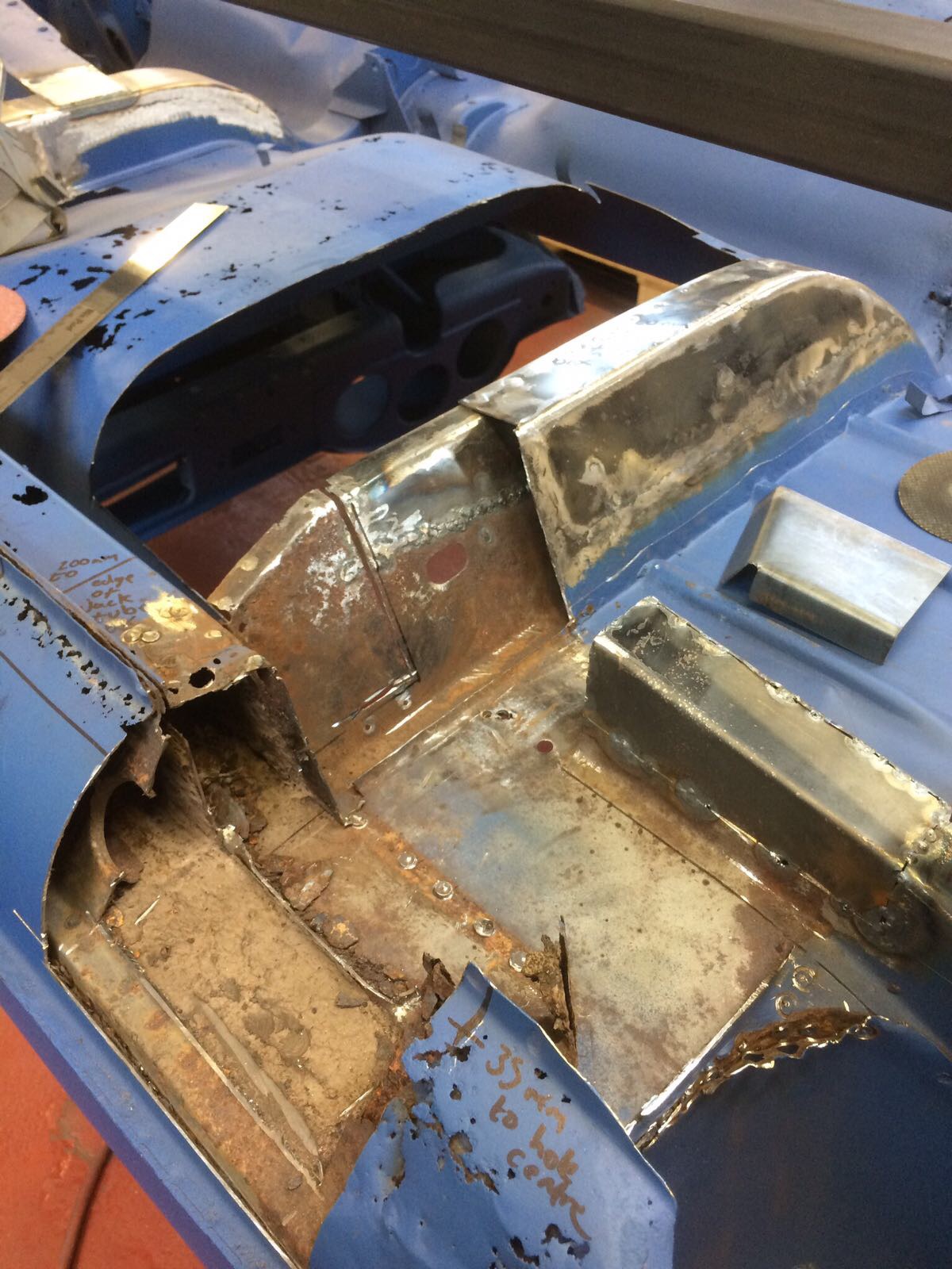

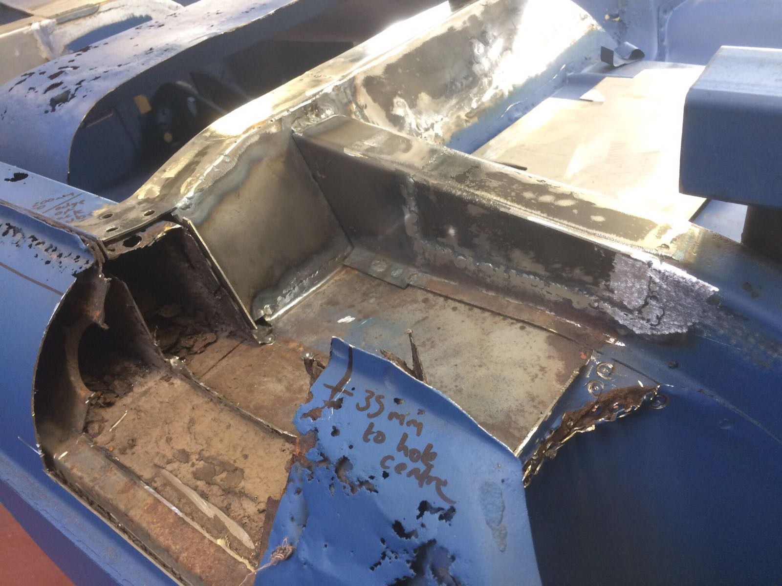

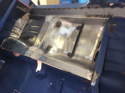

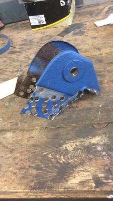

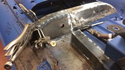

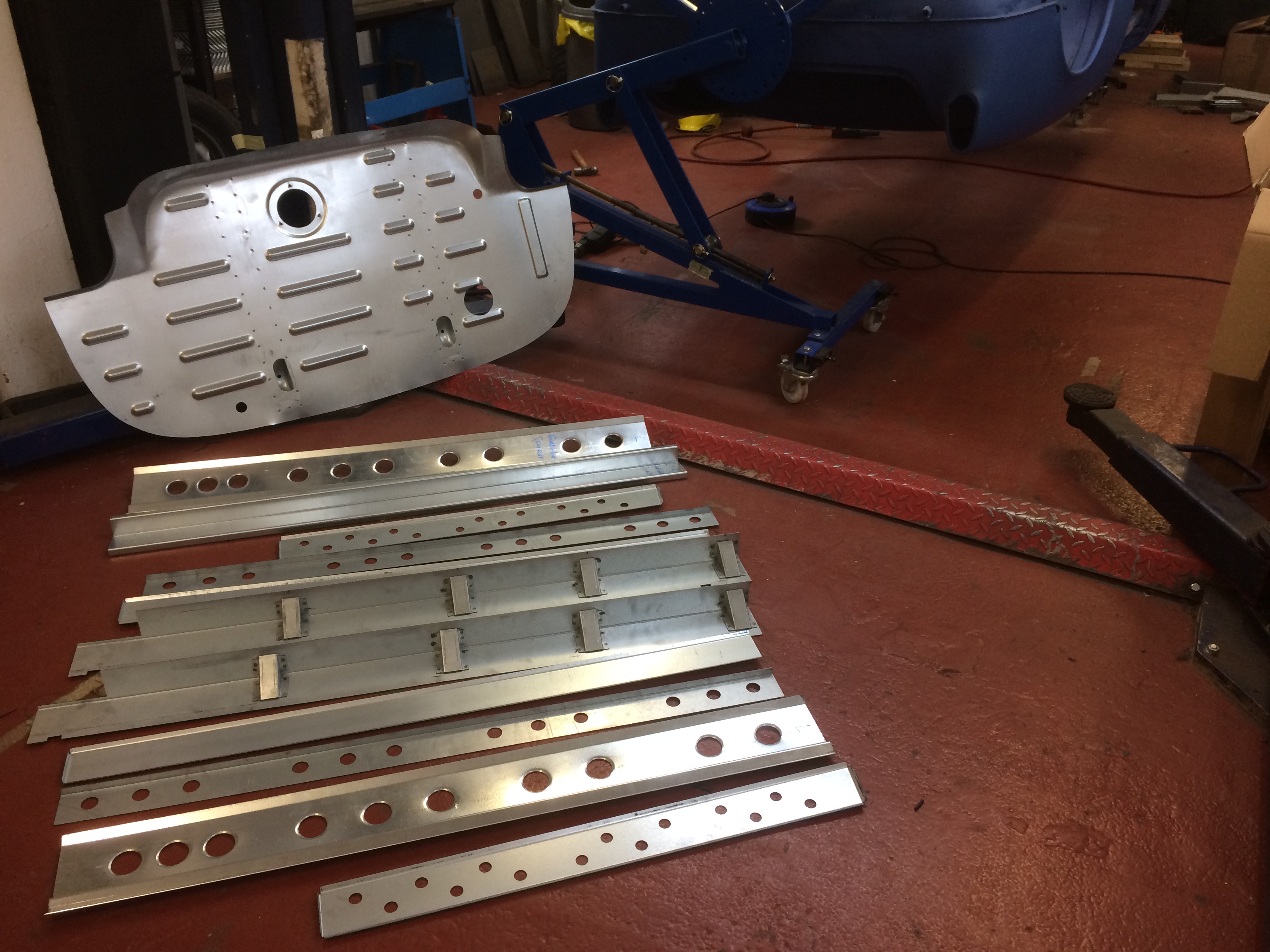

Although as u can see above the first section I made was for the mid chassis outrigger.
It is made to land to the old floor, but is only screwed to it. It will also help on gauging the fit and positioning of later lower sill sections.
Please accept my apologies I am still learning the interface, and struggling to edit etc.
It took me less time to remove cut and replace the footwell than it takes me to tell you about it

I can also see how the dash top rail goes now.
You really did have a mass of work there. Top job.

Bet that's a nice change to stand and spray the underneath mate, looking nice with the stoneguard

Thanks Keith, I noticed you posted a picture of the radius arm mounting area, i found a few pictures of the area while it was worked on
This repair has to happen before sills are removed as the old sill gives an indication to where the crossmember needs to come to and there is better access to the whole area as u can chop out sections of old sill wheras if u chose to do these peices after letting the sill sections in cutting the new one for access is not an option.
Thanks for the interest, i will try to keep the pictures coming in
That is a massive amount of structure building mate.
As Kev has said it is great to see how you went about this restoration. I didn't notice quite how thick the sill sections were, but as this is a spider I suppose it has to be to keep the car solid. You can see it has a double, triangular strengthener running through it.
I can not wait to see her all finished.
Incredible how bad the metal was after  the stripping process, first class work Gad and Keith to bring back to life, very impressive.
Thanks guys for your interest and kind words.
As Keith pointed out the sills are very substantial on this car (as on any car without a fixed head) and comprise 6 sections per side ( above are the sections less the outermost shaped section, and the boot floor is doing a first appearance too)
To make it even more entertaining the floor is sandwiched between the various sections.
The repro sections are of 18swg as opposed to the original 20swg, and galvanised too.
