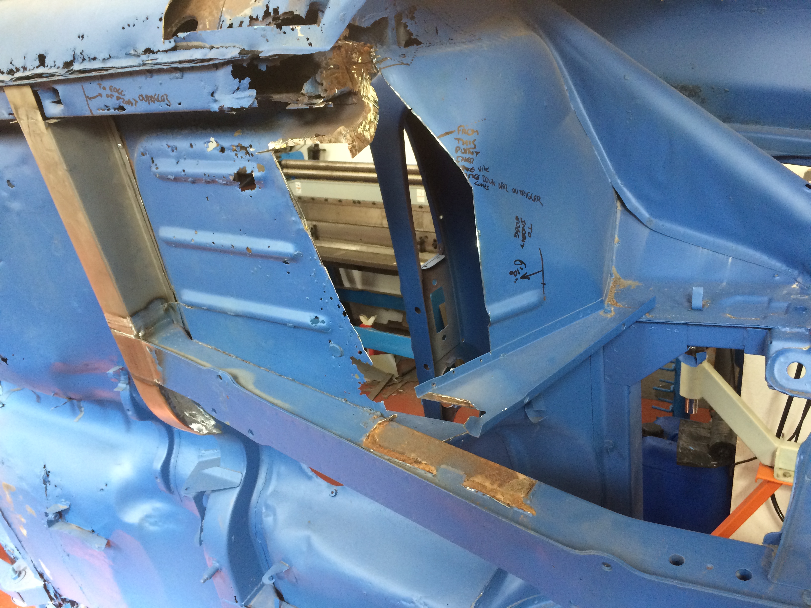

The front o/s jacking point was lost in the blaster...
Both rear trailing arm mounting points are not mounted to much at all
Rear heel board crossmember, made out of 16swg ie 1.5mm steel also showed weakness in its lower half
Rotten metal removal started at the o/s footwell/floor/sill/jacking point/a-post bottom junction.

Although as u can see above the first section I made was for the mid chassis outrigger.
It is made to land to the old floor, but is only screwed to it. It will also help on gauging the fit and positioning of later lower sill sections.
Please accept my apologies I am still learning the interface, and struggling to edit etc.
It took me less time to remove cut and replace the footwell than it takes me to tell you about it :)
