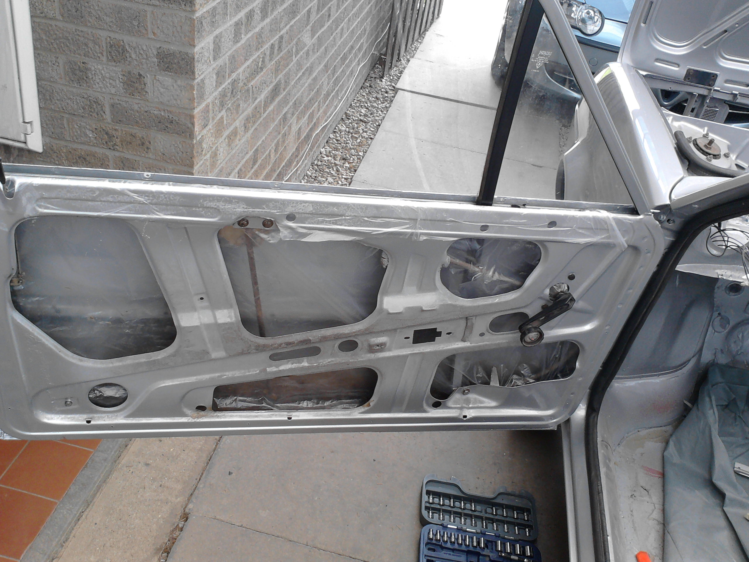

then decided i'd pull the sud out and fit out the doors, put the windows, regulators etc in.
into the loft to bring the glass down, knew i'd got some left over from the S3 cars.
boy does it get hot in the loft on a sunny day :shock:
realised then when offering it up to the car that depsite the grime and dust i could see a big problem. the rear side windows are clear and the S3 ones had a green tint to them :roll:
quick call to J and we went up for a look in the stores, found one. then thoguth i'd probably gone a bit senile and had already brought the correct ones home and stashed them away.

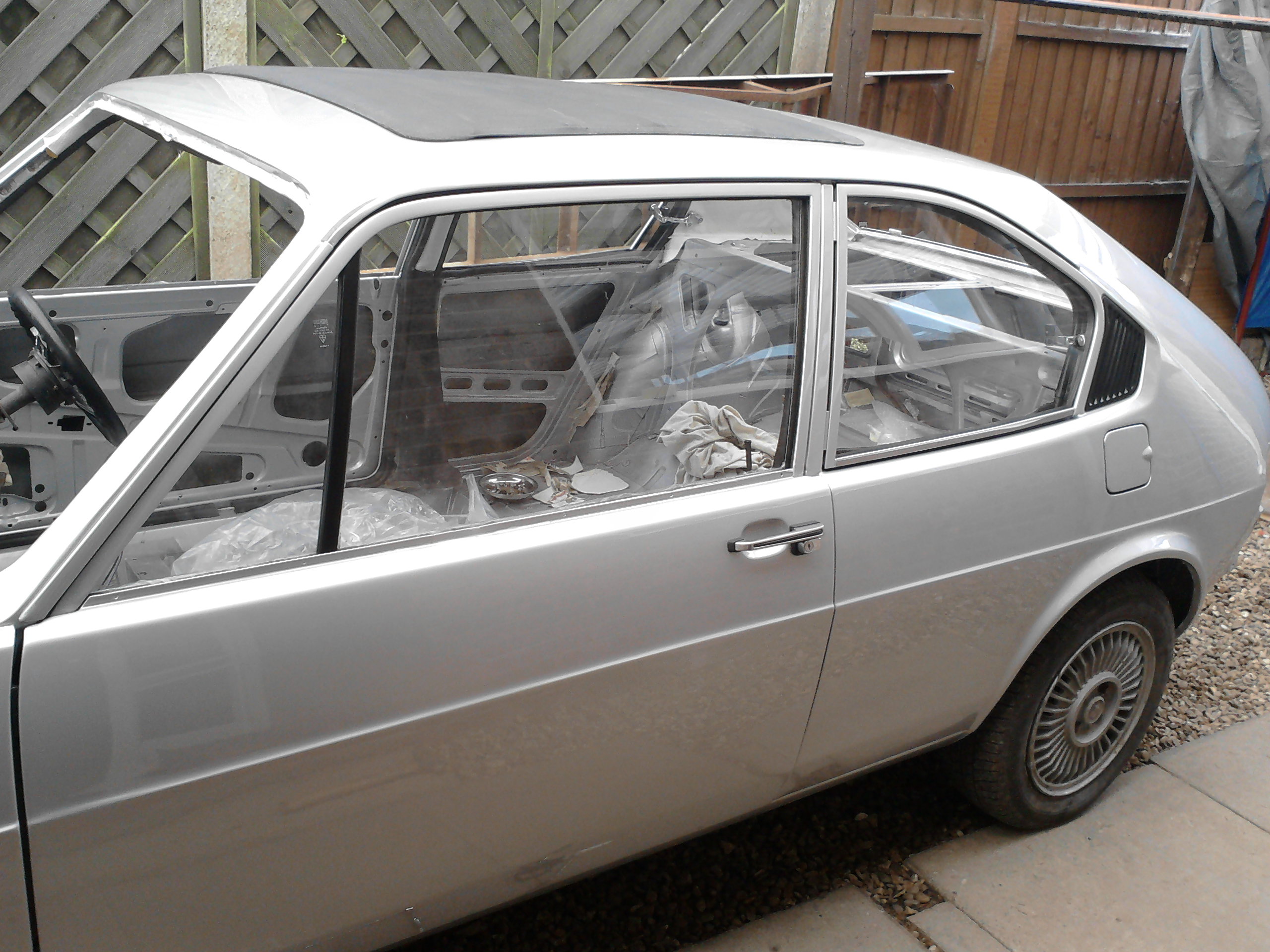

very busy weekend with the bank holiday and all, alfa mending but not my sud.
did get chance to do a little this afternoon though.
passenger side window and 1/4 window in place now.
made sure that some new plastic lining was installed first between the inner door skin and the window regulator etc, vital to stop the water that falls between the weather strip and window falling ontothe inside of the door card. far too many door cards go warped because of damp on the inside of them. helps to stop draughts too :D
few other bits and bobs done, peddle box being refurbed etc. nothing exciting.

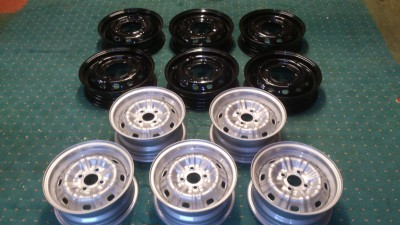

the wheels that are on it now are just rollers, as you say.
the original steel ti rims ave already been refurbed by shrew, awaiting me to get my hand in my pocket again to get some tyres :D
silver ones from shrews pix, can't believe i haven't taken any yet :roll:

The steel wheels on early series 1 Ti,s sold in the UK were light grey. I know the early brochures showed an early left hand drive car with silver wheels but both my cars have light grey steel wheels and I never saw a right hand drive car which originally had silver wheels. But you can of course paint them any colour you want.

Re: My S1 Sud Ti
There was also a choice of different j width, visible, only just, from a little extra dish and offset on the outer face.
But what wheels were fitted to what cars is a little more about how the customer wanted it to leave the showroom more than alfa's build list i think, and certainly some of kevs wheels were a positive silver colour which appeared to be their original paint from the age and condition of it.
I've seen the light grey coloured wheels before, in fact i think they'll be like the ones Yorksud has refurbished for on his Ti, but i have to say they look quite a lot like the "essential" paint covering that the spare steel wheels had.
Originalilty is somewhat debatable unless you saw it pulling away from the Forecourt i reckon, pretty much as it always has been with the italian marques! :D :D

Yes grey is the original colour on mine which is an early 1976 built car, I have seen them silver on 1977 cars though so not sure when the colour changed. Mine however are 4.5J x 13" so again at some point they went wider to 5J (not a bad thing as the 4.5j wheels I have limit tyre width TBH). The wheels are usually stamped on the rim with size and month/year of manufacture

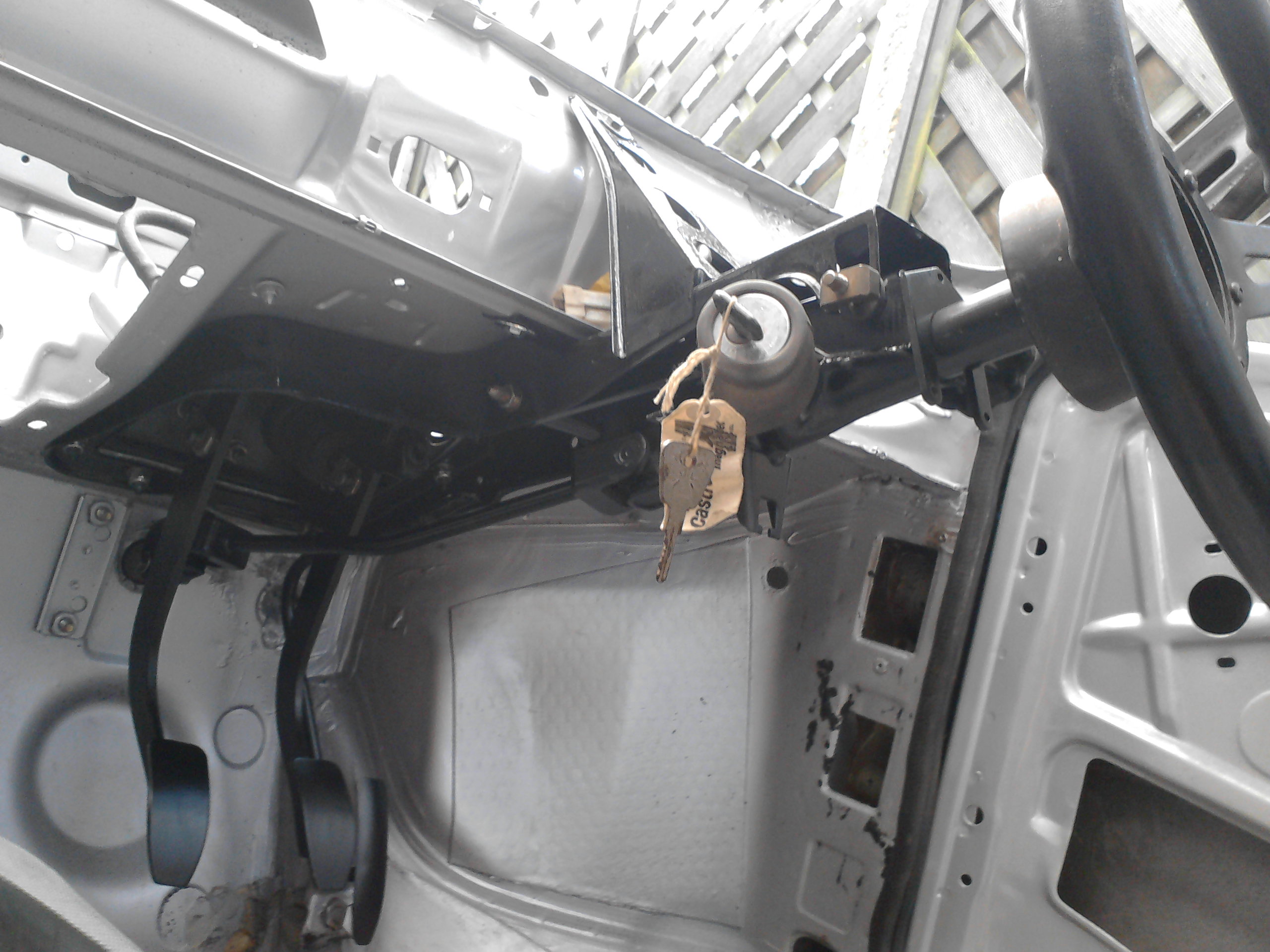

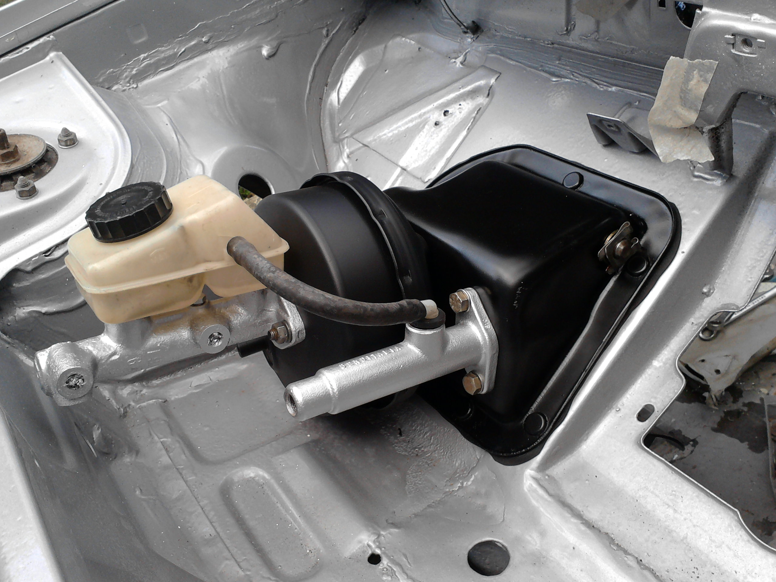

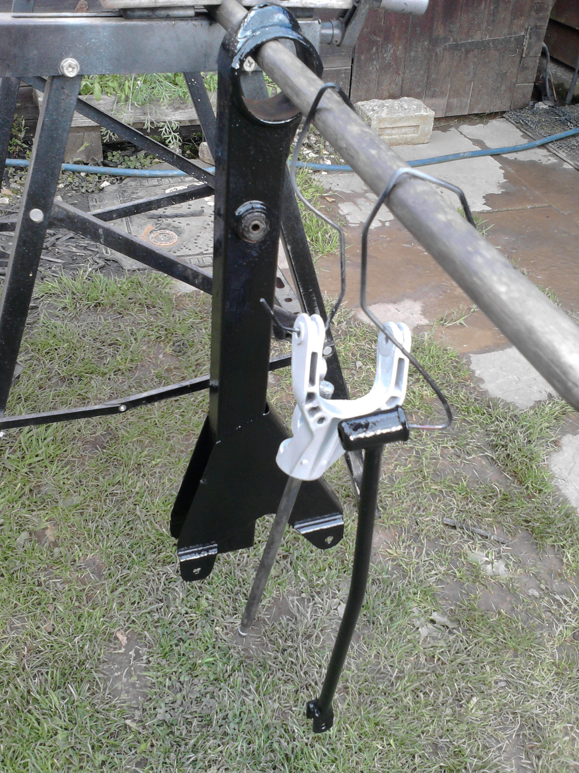

another steady weekend, a few little jobs done.
peddle box has been an ongoing refurbish job. brake and clutch master cylinders were stripped, new seals bought, inner bores honed, greased and re-assembled then painted.
pedals were removed, cleaned, painted and re-assembled with fresh grease.
servo likewise.
the rest of the steering column was removed, cleaned and painted. trying to get things installed in a condition where they can stay fitted now.
made a new gasket from neoprene and installed it with a smear of rubber grease, that should keep any water out.
finally got round to fitting the bonnet stay too. had refurbed one a few weeks back but when i went to fit it it was for the wrong side :roll:

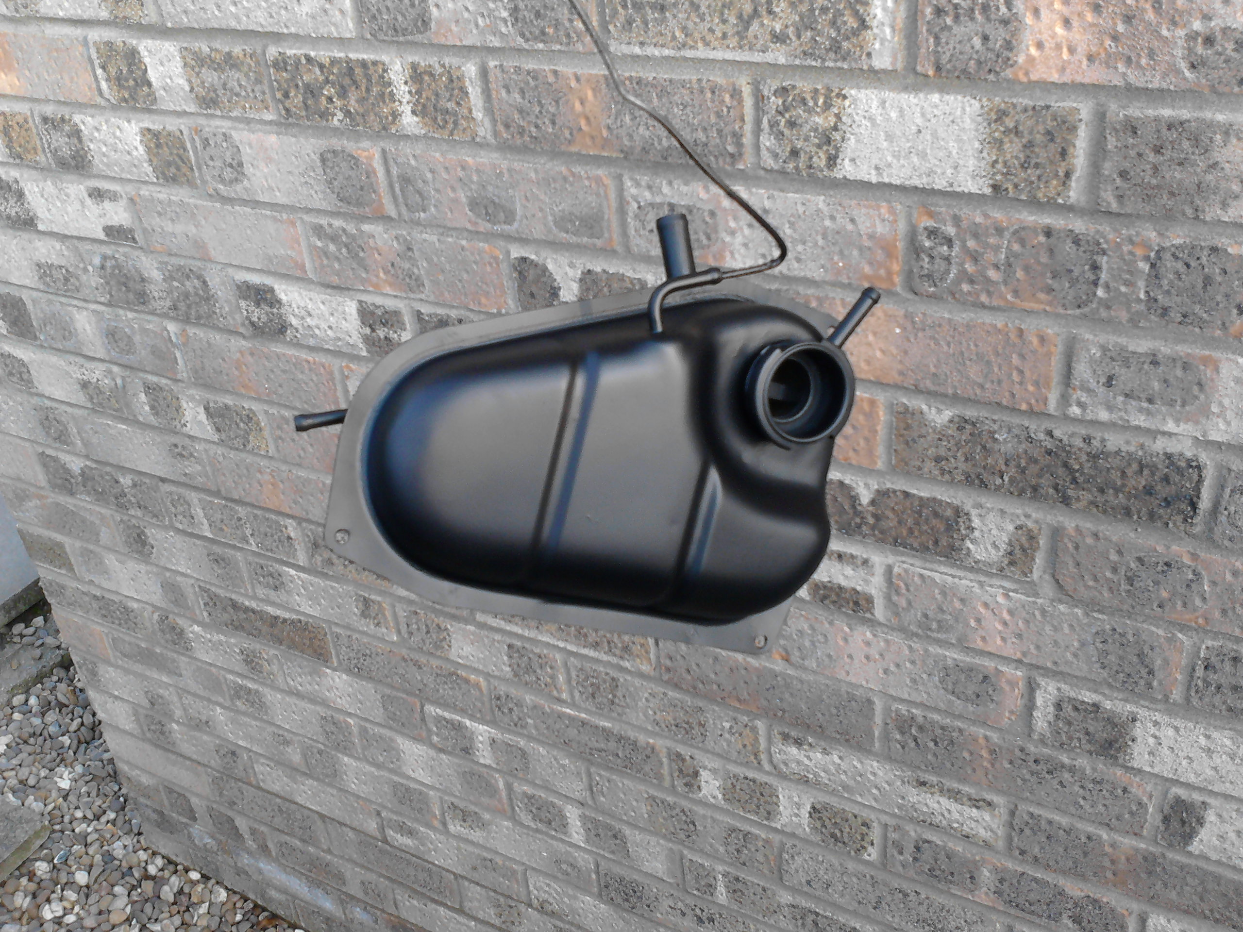

whilst the mood was good, not to mention the weather suitable, i cleaned and painted the metal header tank.
thankfully once stripped it looks in good condition, time will tell.....

I particularly like the header tank - so much nicer to look at than murky brown plastic :lol:
Re: My S1 Sud Ti
The header tank is metal then Kev. Would that fit a S3 or are they as rare as rocking horse poo?

Metal header tank? Well you learn something new, must be peculiar to the early ones as even my old S reg 5m had plastic.

Bluesuit wrote:Metal header tank? Well you learn something new, must be peculiar to the early ones as even my old S reg 5m had plastic.
think it was only the early S1 cars mate
