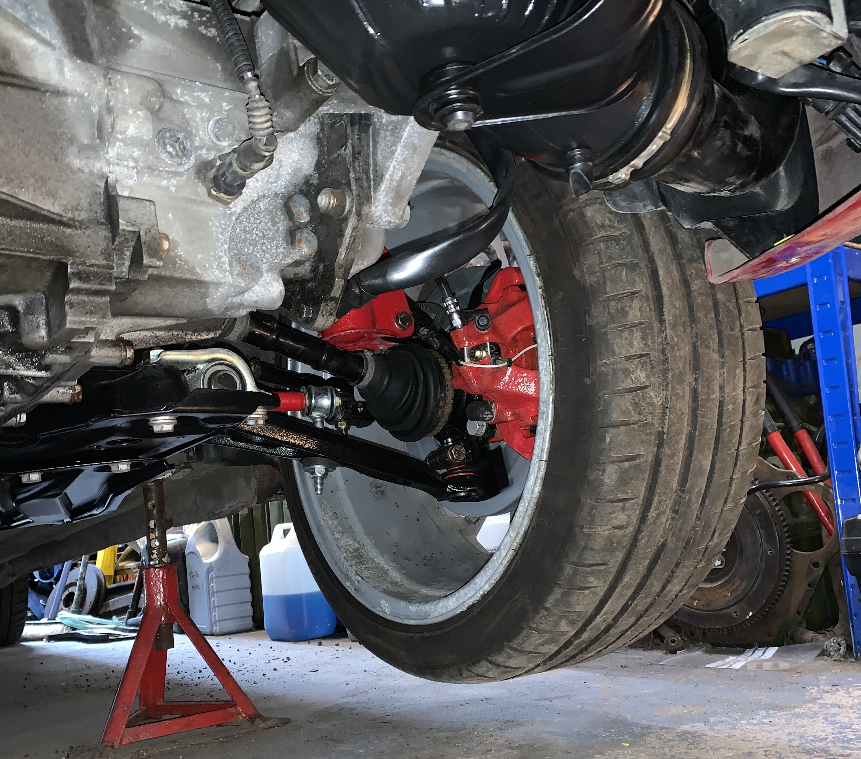

Spider Front end all finished at last. It Should last a few years before i have to do anything major on the suspension now.
The wheels do need a refurb but I’m skint at the moment so that may be next winters hibernation project
Still got a few bits to do at the rear and put the drivers door back together then I’ll tax it next month ready for summer

I presume you have to check the tracking after a front end rebuild.
Seems there are DIY laser tracking kits available for reasonable money......or do you go to a tyre place?

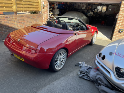

Spider passed its MOT today ready for the summer. You know it’s going to rain constantly now don’t you.
Btw yes the 18” wheels will be going back on as soon as I can find time. To swap the struts again. (Long story)

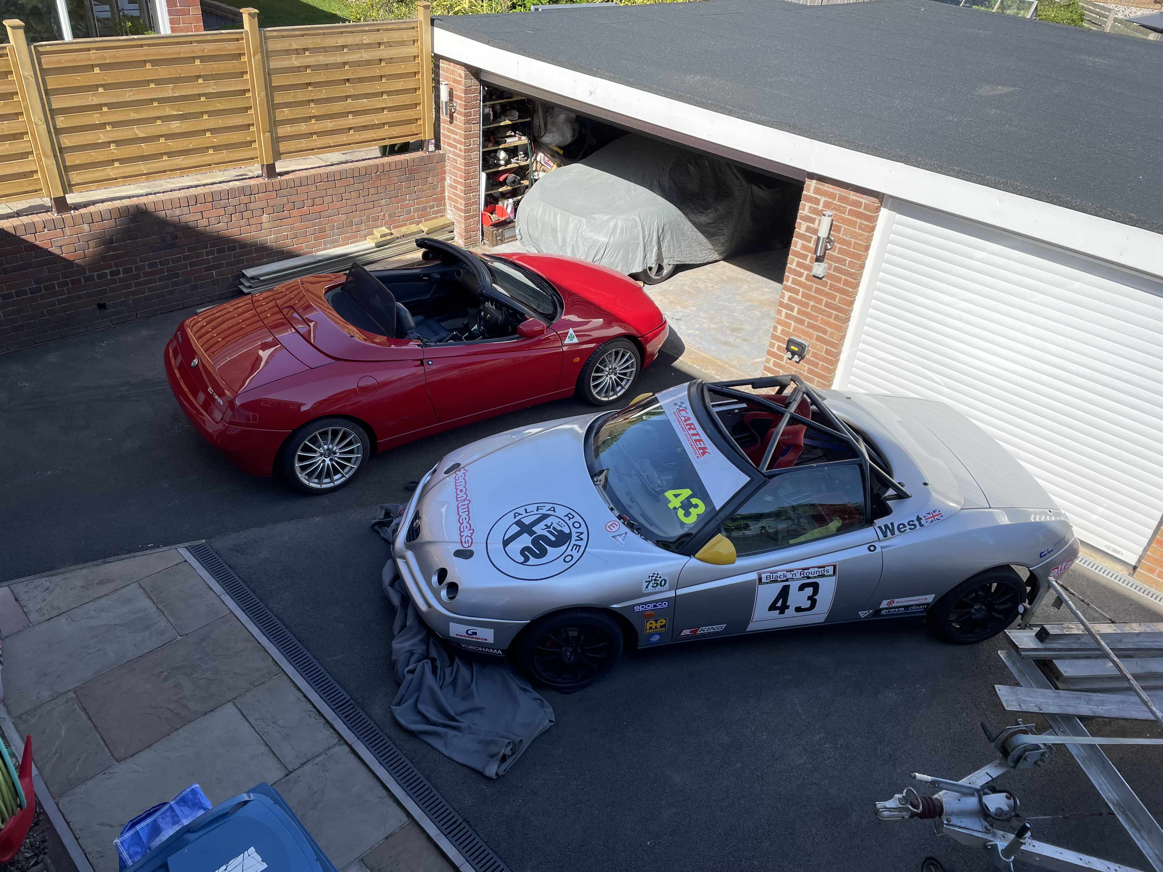

Finally back on the 18” and enjoying the summer sun next to the silver coupider.
Sadly the silver car is likely going to be broken up as I’ll never race it again
