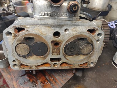

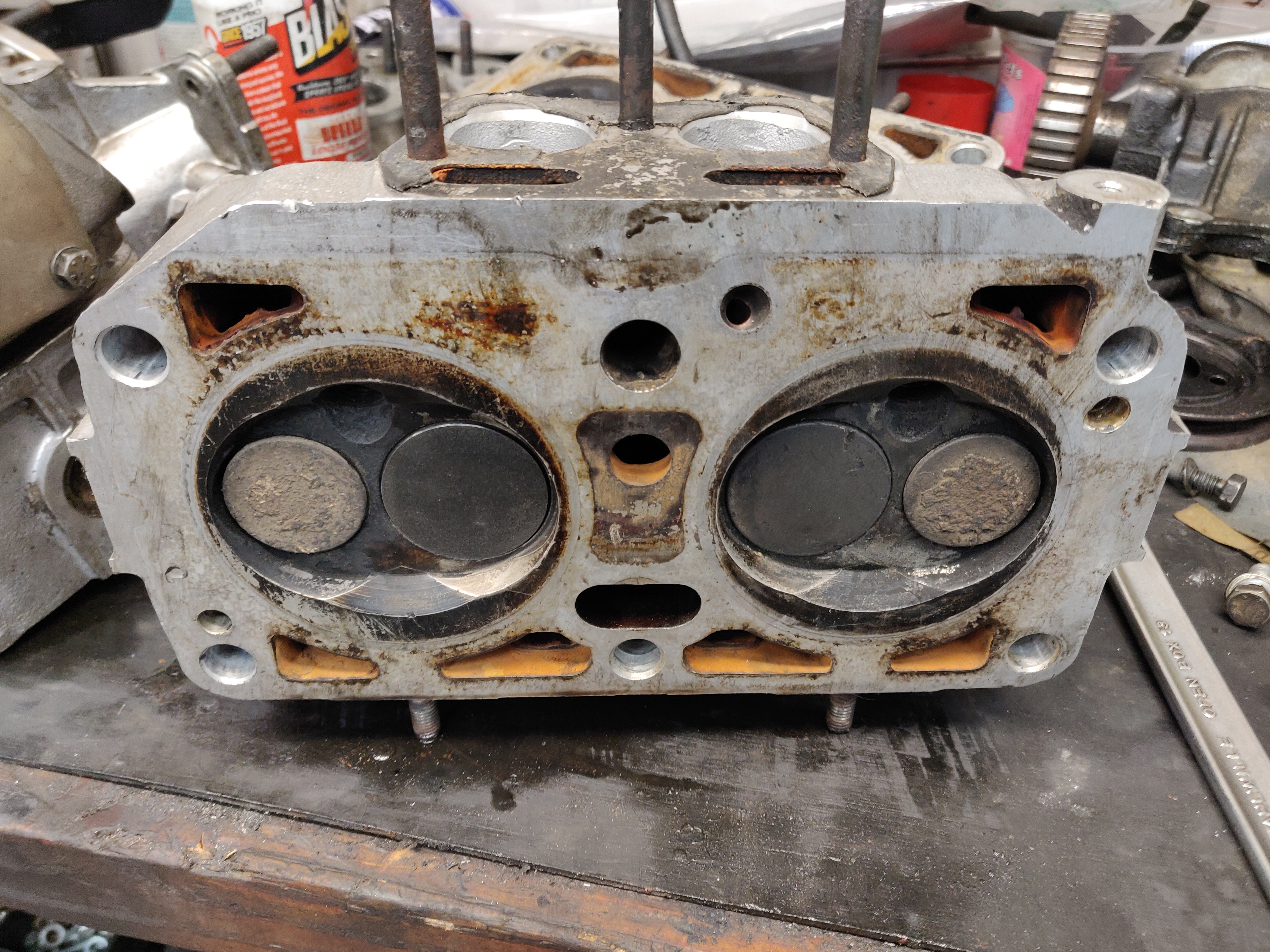

I'm having a 1500 engine fixed up. I have a number of engines sitting around so was just getting the best bits from each. Some questions are getting raised:
Are the heads on single carb engines the same as dual carb? I'd heard they were different but don't know what that might be?
I also have some heads that are quite different pics attached. These other heads don't seem to have any depressions - high compression heads?
Finally, I thought I'd check what the original engine was. Found it has engine code AR30588. That's not on the list! Anyone know what that means?

Ive got one of those aswell. Yes the SC heads are different to Veloce heads. If if I remember a 30588 code is a carbed 33 1.5 (102hp). I think it’s Basically a 1.5 bore and stroke but with 1.7 chambered heads valves are bigger too.

Single carb heads are different, I can’t remember how exactly. But if your heads have twin carb manifolds then they are twin carb as the manifolds don’t fit a single carb head.
The flat heads are the earlier sud heads, the chambered / domed heads came with later 33’s. The pistons are different for each head, with the flat heads the pistons are dished instead, for the chambered heads the pistons are not dished.
See pics ere of the dished pistons. You will need to use the heads that match the pistons on your block, and if std you won’t see and difference in performance between the 2 different combinations.

The main difference between the SC and Veloce (twin carb) heads is the port centres . If you sat a Veloce manifold on a SC head the ports are a clog out the chambered heads you’ve got appear to be the later veloce heads . as they have enough meat to allow machining of the little cut outs used with the injected 8v engines. That’s why you have the injected gaskets between the head and manifold.

As far as I can tell you have a 1.5 twin carb head and a 1.7 "chambered head". Looking at the inlet ports it looks like only the old gaskets have the cut out for the injectors. The inlet ports dont seem to have these injector cut outs? If so they look like mechanical heads rather than hydraulic from this side. If these heads have the same cam boxes as the 1.5 heads then youv hit gold...
