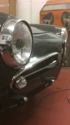

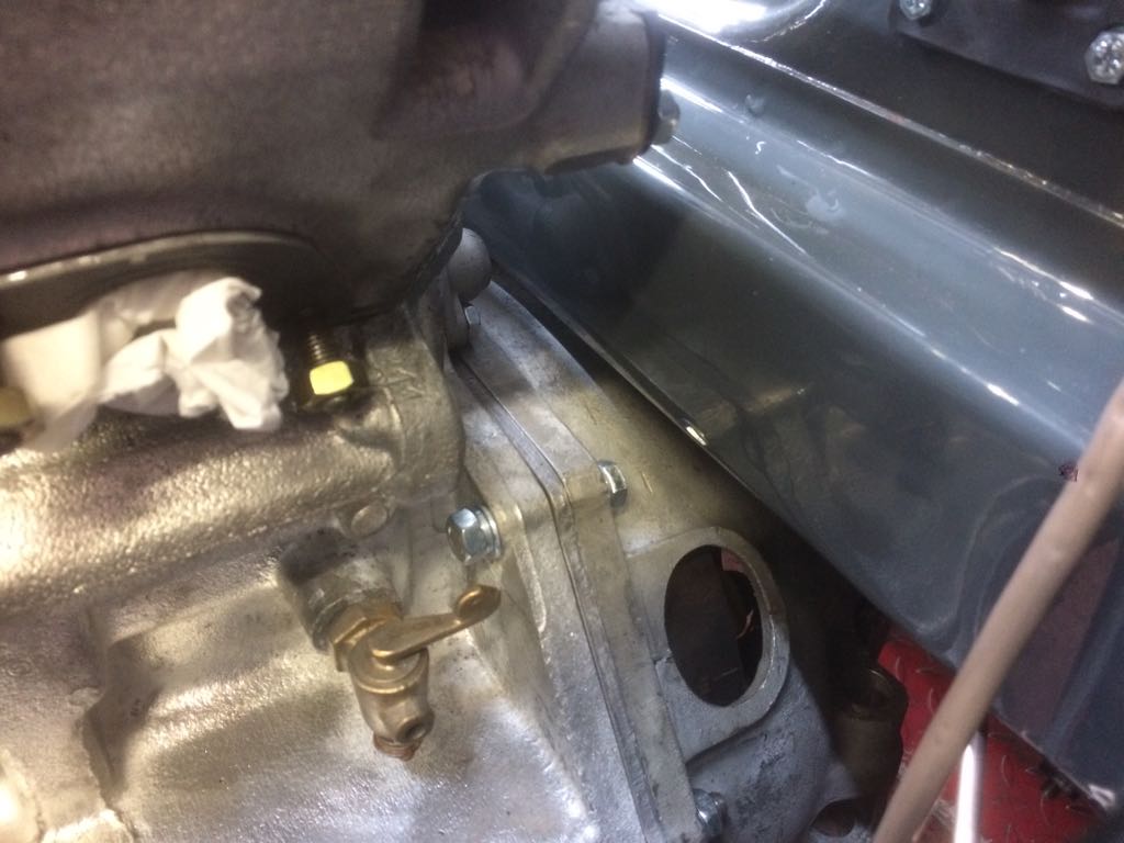

Here are a few more progress pictures.
The guys are really cracking on with the car.

A few more.

Well a final few photos to close this thread.
Gad bought the Giulietta down last Wednesday for a final polish and was also asked by the owner to give me a trip out in it.
It was a lovely day and a nice finish to the project.
Car looks fantastic, and thanks to Gad and Alex for taking so much care putting her all back together so nicely. :D
