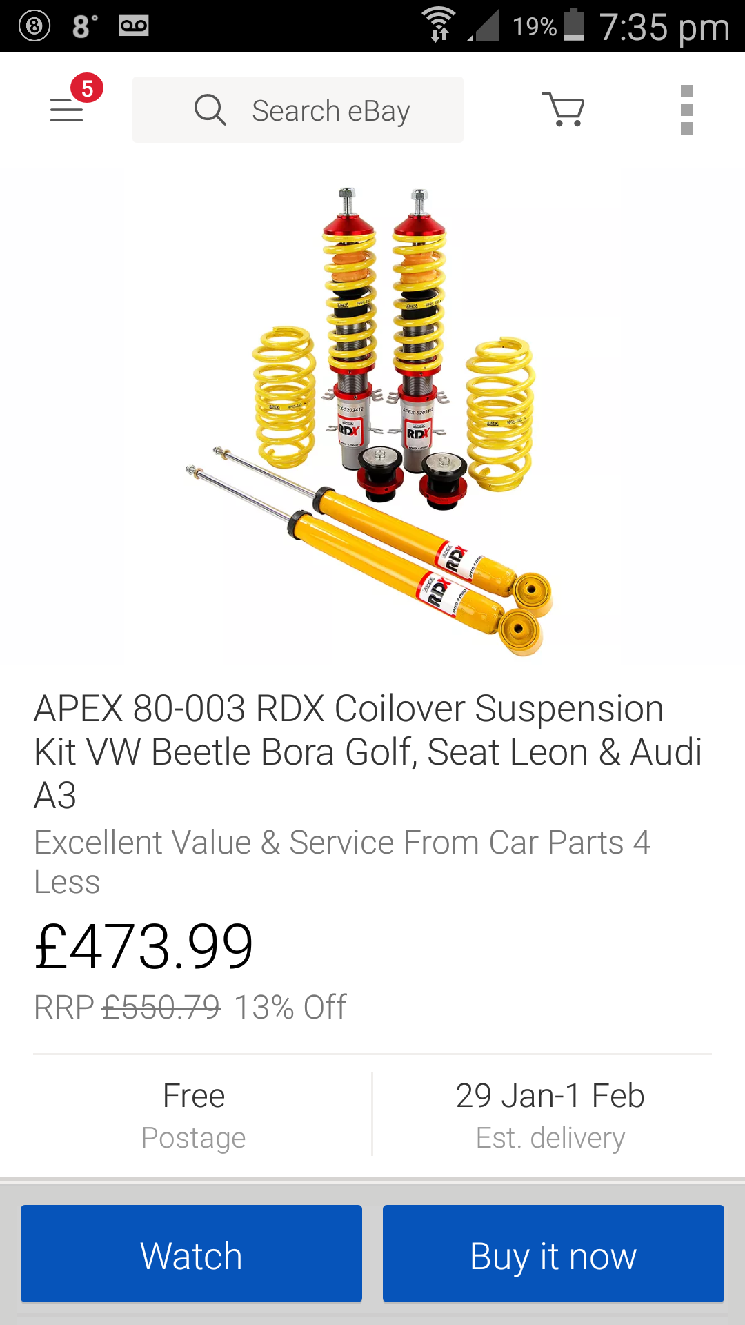

I fail to see how Smiffy, and even if they did i wouldn't be in a rush to fit them regardless of how cheap they appear to be.
The 80-003 number claims to fit Bora, Golf A3 etc etc, which is more likely, as they have a fork type bottom bracket onto the hub which these could slide into and nip up, but 33's have a fixed bracket, and need a pan of bearings to allow the steering to pull the strut within the spring, and these have no such allowance.
If they did a set to fit the bottom end of things, i.e with a 4 bolt bracket for the hub mounting, they would also need a steering arm connection point and a top mount such as pillar ball or bearing to allow it to rotate with the steering.
I'd say it looks doubtful mate
On the plus side, it may be saving you from your major dissappointment in a years time when they have shed all their paint and finish and rusted together like Titanics bog door!
These cheap kits really aren't worth the savings, they're generally crapped out once just out of warranty.
