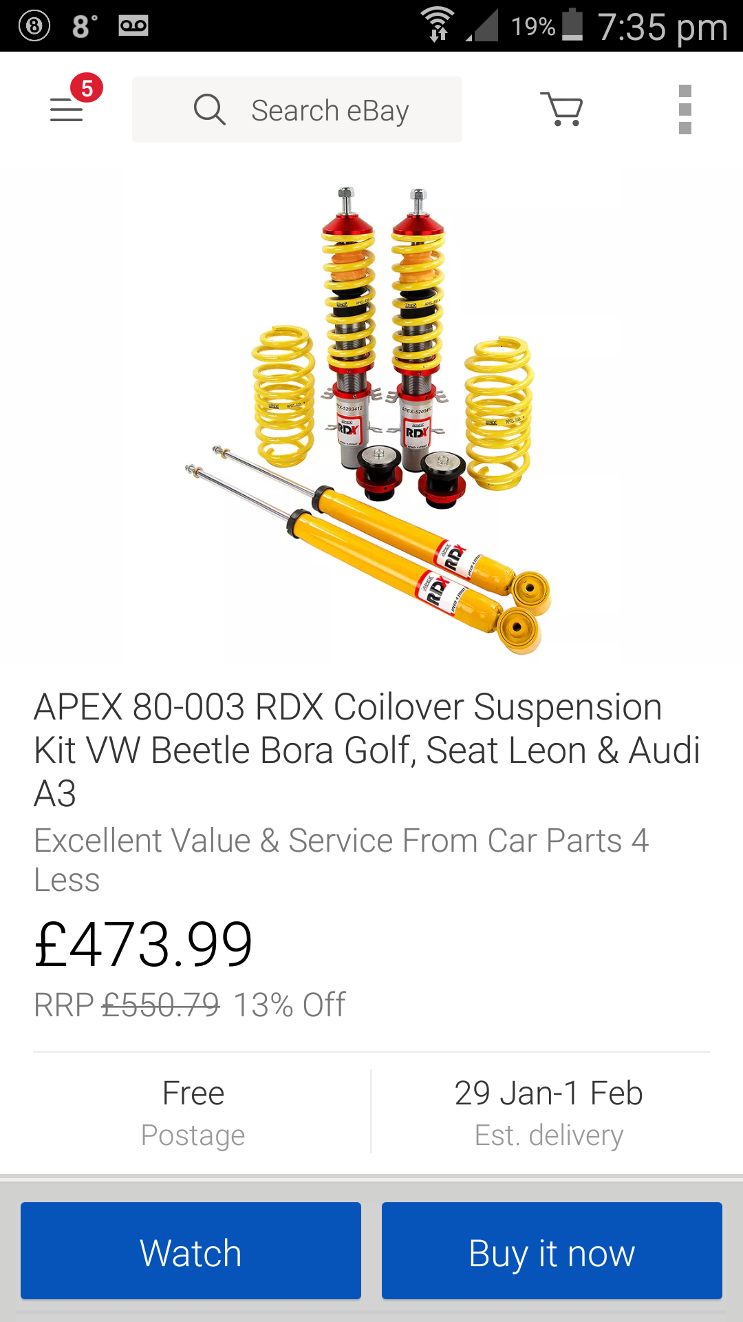

These say they fit a 33 is this true.
Ta
Re: 33 coilovers
I fail to see how Smiffy, and even if they did i wouldn't be in a rush to fit them regardless of how cheap they appear to be.
The 80-003 number claims to fit Bora, Golf A3 etc etc, which is more likely, as they have a fork type bottom bracket onto the hub which these could slide into and nip up, but 33's have a fixed bracket, and need a pan of bearings to allow the steering to pull the strut within the spring, and these have no such allowance.
If they did a set to fit the bottom end of things, i.e with a 4 bolt bracket for the hub mounting, they would also need a steering arm connection point and a top mount such as pillar ball or bearing to allow it to rotate with the steering.
I'd say it looks doubtful mate :(
On the plus side, it may be saving you from your major dissappointment in a years time when they have shed all their paint and finish and rusted together like Titanics bog door!
These cheap kits really aren't worth the savings, they're generally crapped out once just out of warranty.

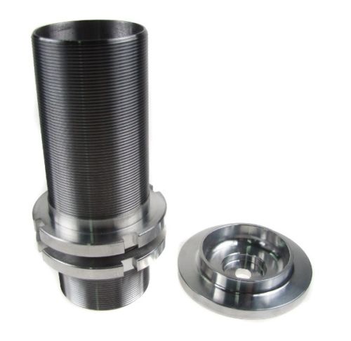

and the fronts can be converted into coilovers by the likes of Gaz, Leda, etc etc

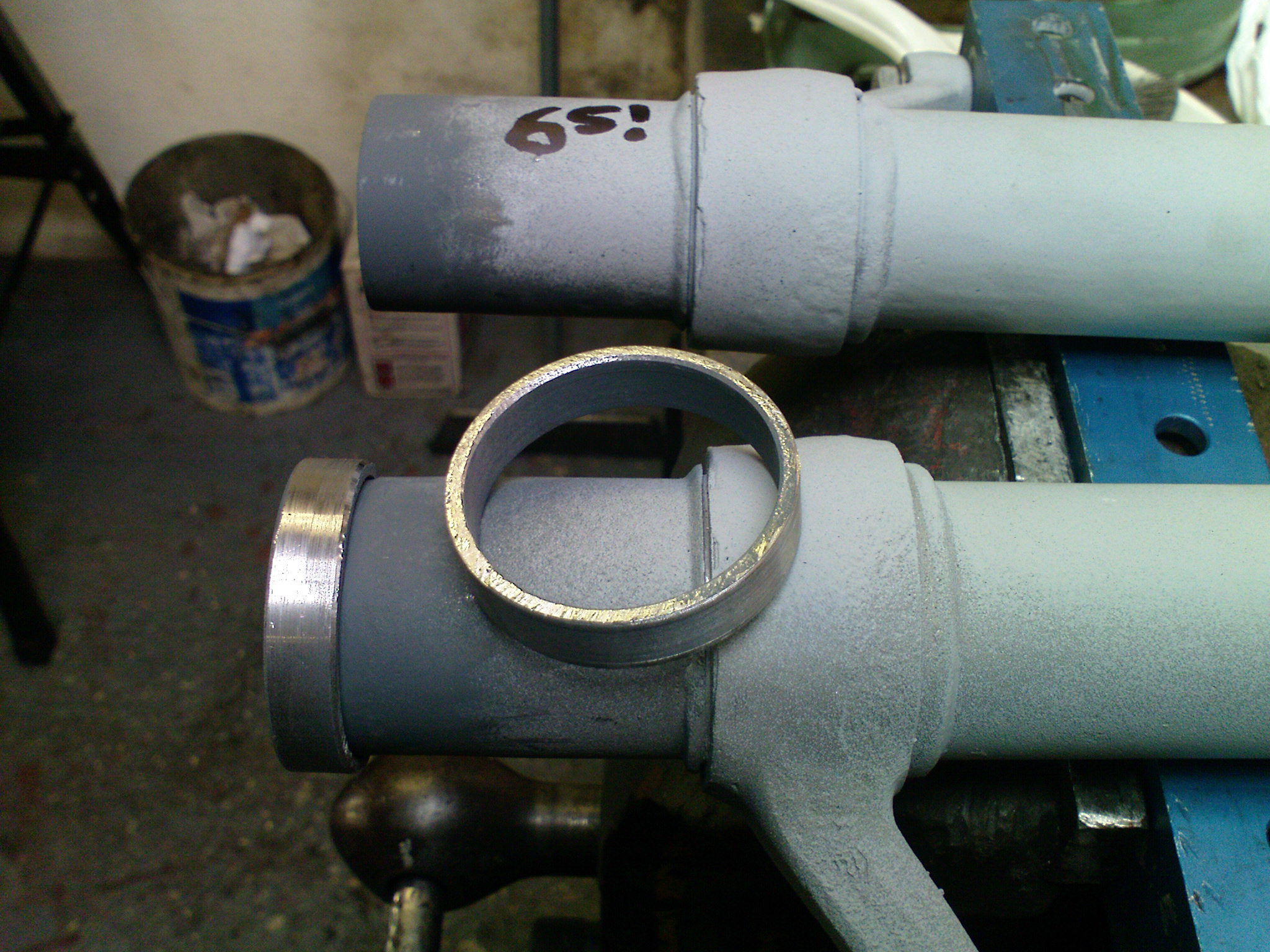

or even diy with weld on kits like this

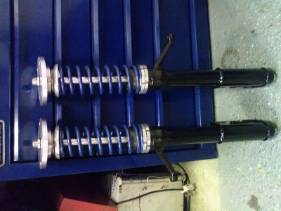

Shrew is right on these, tho cheap coil over kits are "ok" at very best..
the DIY kit is pretty good, you just have to take some time fitting to 33 strut as there is a bit of mismatch between strut outer diameter and coil over tube inner diameter,
im trying to find some pics of when I did mine years ago.. I will up load them when i find them
hope that helps. lib

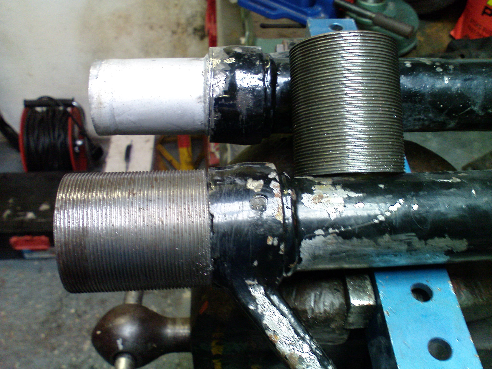

Post by kammatic »

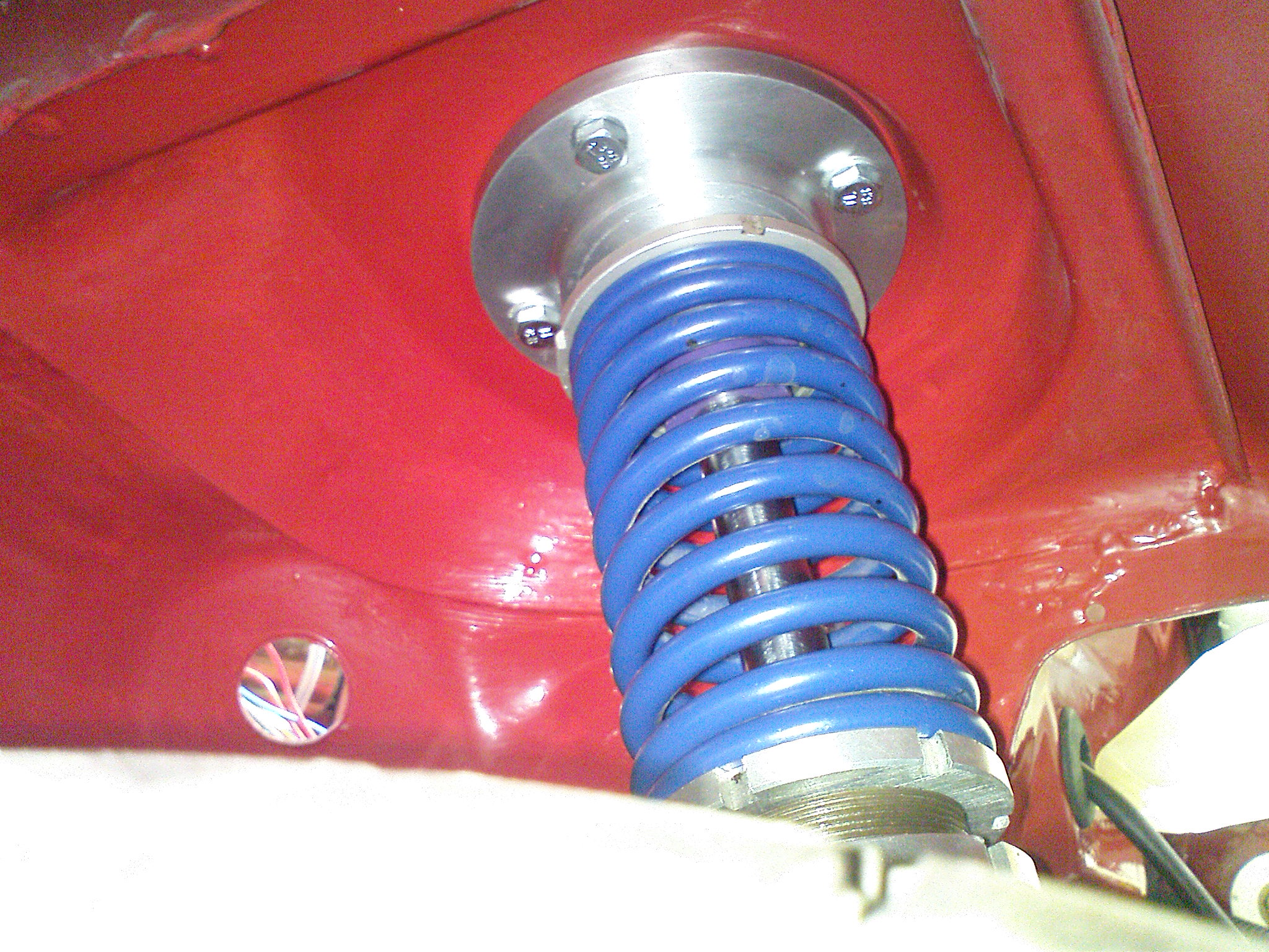

kammatic
Posts: 65
Location: Bedfordshire
Re: 33 coilovers
Post by kammatic »
As pics in last post and above,.. these are the first "version" of my coil overs.. not 100% how i want them but good enough to get going and teach myself what I needed to do. I have another pair of struts, im going to try doing the inverted steering arm trick to allow me to use a much longer threaded tube section - better ride height adjustment and spring options.

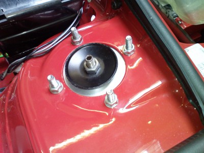

Thanks Kam, great explanation and good job! :P
I take it those solid top mounts are on a pillow ball bearing?

Yep, the top mounts have a HUGE rose joint bearing in there to allow everything to go lock to lock.
The top mounts were actually for a mk1 or 2 escort ( cant recall which now ) , I turned them down in a lathe to get the outer diameter correct, then uses the late to mark the hole centers before drilling out.
