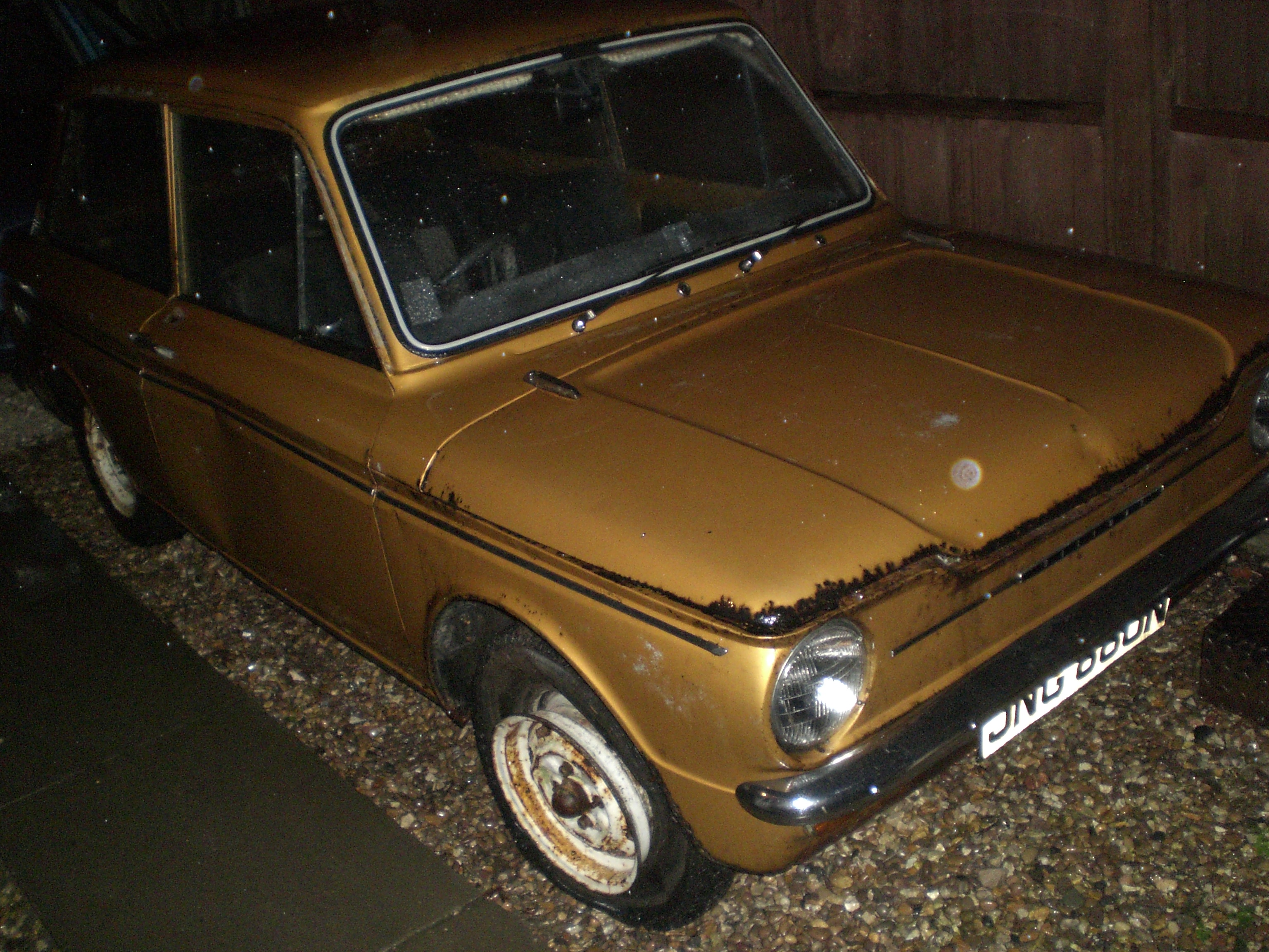

				a new addition to the driveway today, my lad rob turns 17 in june so we've got a little project car for us to get sorted for him. give him some practical experience to go with the college work...

				looks nice and tidy Kev.
