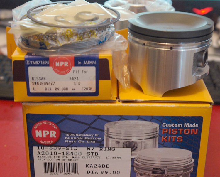

I found suitable pistons page 68, they are for the Nissan KE24DE engine as found in anonymous sedans and pickups that I don't think we appreciate here in Europe, but I think we know the 240SX.
Anyway they are normally 89mm with a compression height 1mm lower than the 1700 boxer 8v pistons. And the piston pin is the exact same 21mm. This is the Wiseco catalogue but I wouldn't want/need forged pistons as they are stronger but not lighter and piston clearance at cold engine needs to be greater and they make more noise then until they reach operating temperature. I searched Nissans forums and standard cast pistons are supposed to be good for 700HP in aftermarket turbo applications. So I looked for a set and found them at ebay, very cheap, here is were I got them from:
http://www.ebay.de/itm/200949279274
Only us$106 for a set with new rings&pins! With shipping and duties they cost me Euro 120 delivered at my door. And I researched the NPR brand, they are good and an OEM supplier, economics of scale probably make the low price possible.

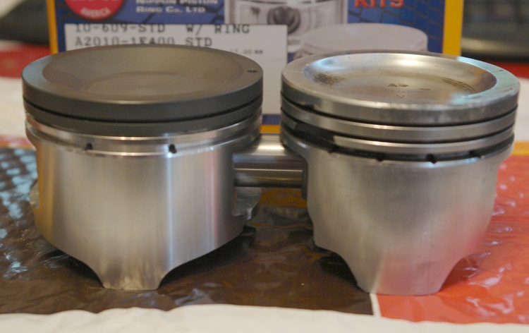

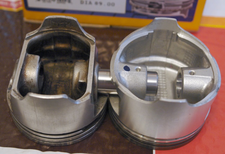

Some pics of the pistons and compared with a 1700 8V boxer piston.

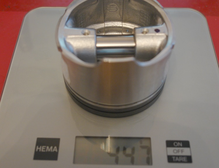

Despite being larger, they are also 40 grams lighter and the pins are 10 grams lighter (bigger inside hole)

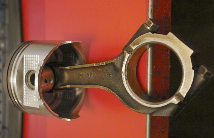

Fits an Alfa rod like it belongs there:

Hi all , what about the bottum end of the piston , its much wider than the original ?? (Berts pic 3 from the top) are you sure that it wont be a problem ? And why is the Alfa piston shaped like that then ...

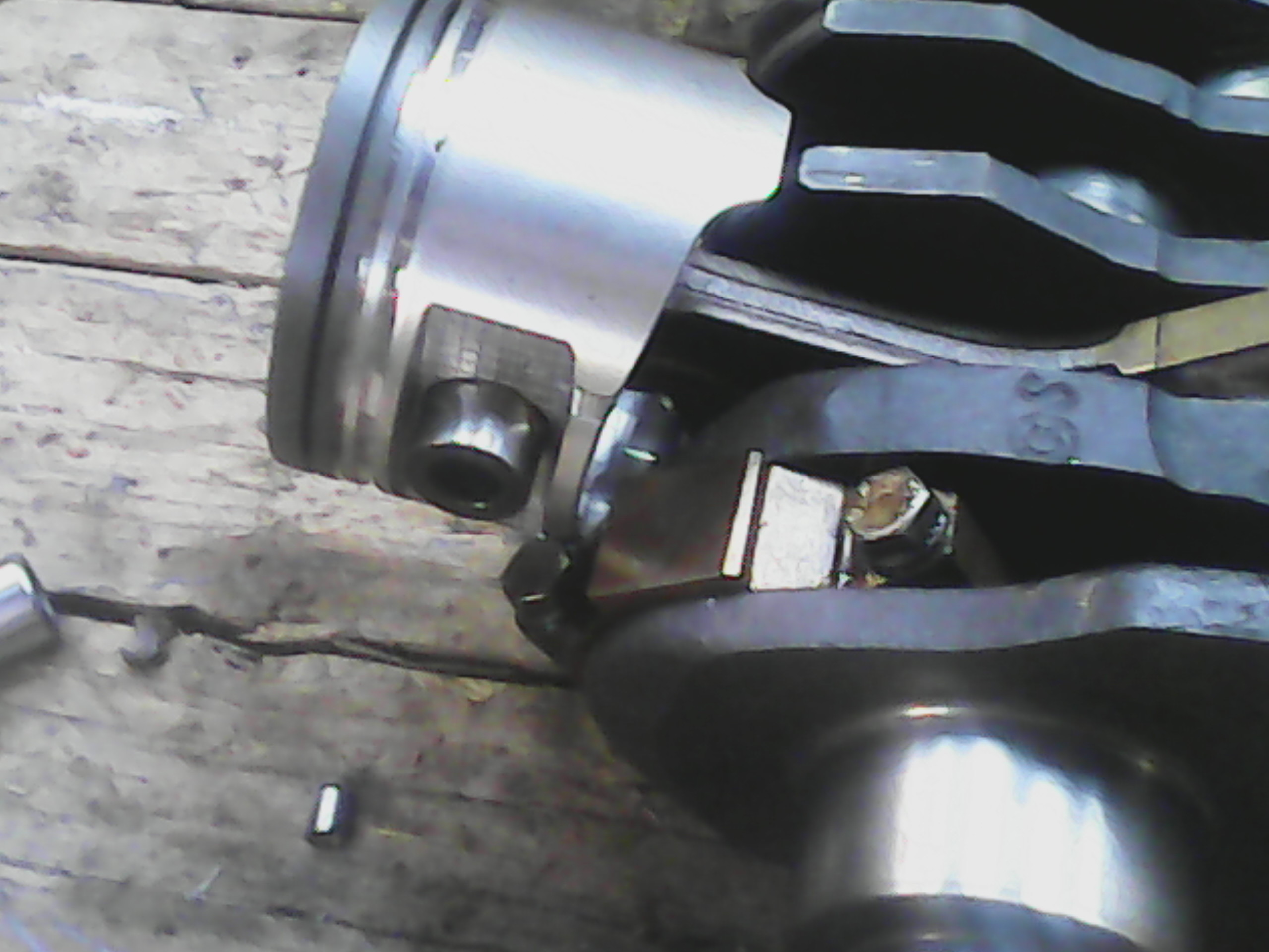

I did wonder if there might be some big clearance issues with these nissan pistons Junior. There's a whole world of difference in the back of the nissan ones when you look at them compared to the standard alfa ones. I even had problems with some 80mm pistons i bought for my 1.3 rebuild a couple of years ago. As they weren't original alfa or i guess a reputable make it turned out that there was too much metal inside the piston which meant there wasn't enough clearance in the back of the piston to clear the opposing big end bolt when the pistons were at the bottom of the stroke. Unfortunately the original engine builder hadn't realised and it had to be stripped again this year and some metal removed from the inside of the pistons to give the clearance needed.
Fortunately it was only a few mm's that needed to be removed and not a whole lot like these nissan's are going to need. Shame though, it would have been a fantastic cheap alternative to forged pistons!

I never realised the extra skirt on the Nissan pistons could be a problem, attached is a pic of the conflict. I guess the pistons should be modified to be like the Alfa pistons.
I also ordered a set of the Max Speeding Rods for the old Datsun Bluebird 1.8 as mentioned earlier, they were suddenly on their site for only $169 so I ordered but then they didn't want to sell for that price and had to pay $239. They will need narrowing on the big end side though. I will take the whole lot to the machine shop soon.
