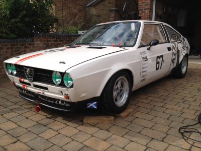

Some of you may know I bought the white Sprint racer that had been raced in the Scottish series recently by Rodger Motherwell's friend.....I'm hoping to race at Cadwell in it in 2 weeks time (27th) but as usual time is conspiring against me.
Here it is this weekend after fitting a new front screen (made me 'sweat' but went in well in the end), some different wheels, suspension adjustments and a few other checks and fettling.
We have rebuilt the brakes just to be on the safe side, but a rolling road session Friday highlighted a small oil leak and totally unrelated but sods law happenned on the rollers, a fuel leak. Neither are major but we have just next weekend to sort these out now but fingers crossed.
Ive only driven it once, so Cadwell will be as much about getting to the know the car as anything else (my excuse for coming last). Its running standard suspension config with Koni's all round, standard brakes with DS3000 pads (cant believe how small those discs are) and a 1500 engine with big cams so it revs high.
It is a good, solid car and should be capable in the right hands (which isnt me!). Fingers and toes crossed for a trouble free event in 2 weeks.

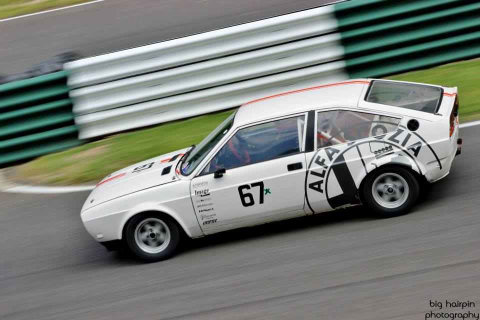

A few pics from the CTCRC Pre 83 race at Cadwell Park that I found online, credited to Big Hairpin Photography.

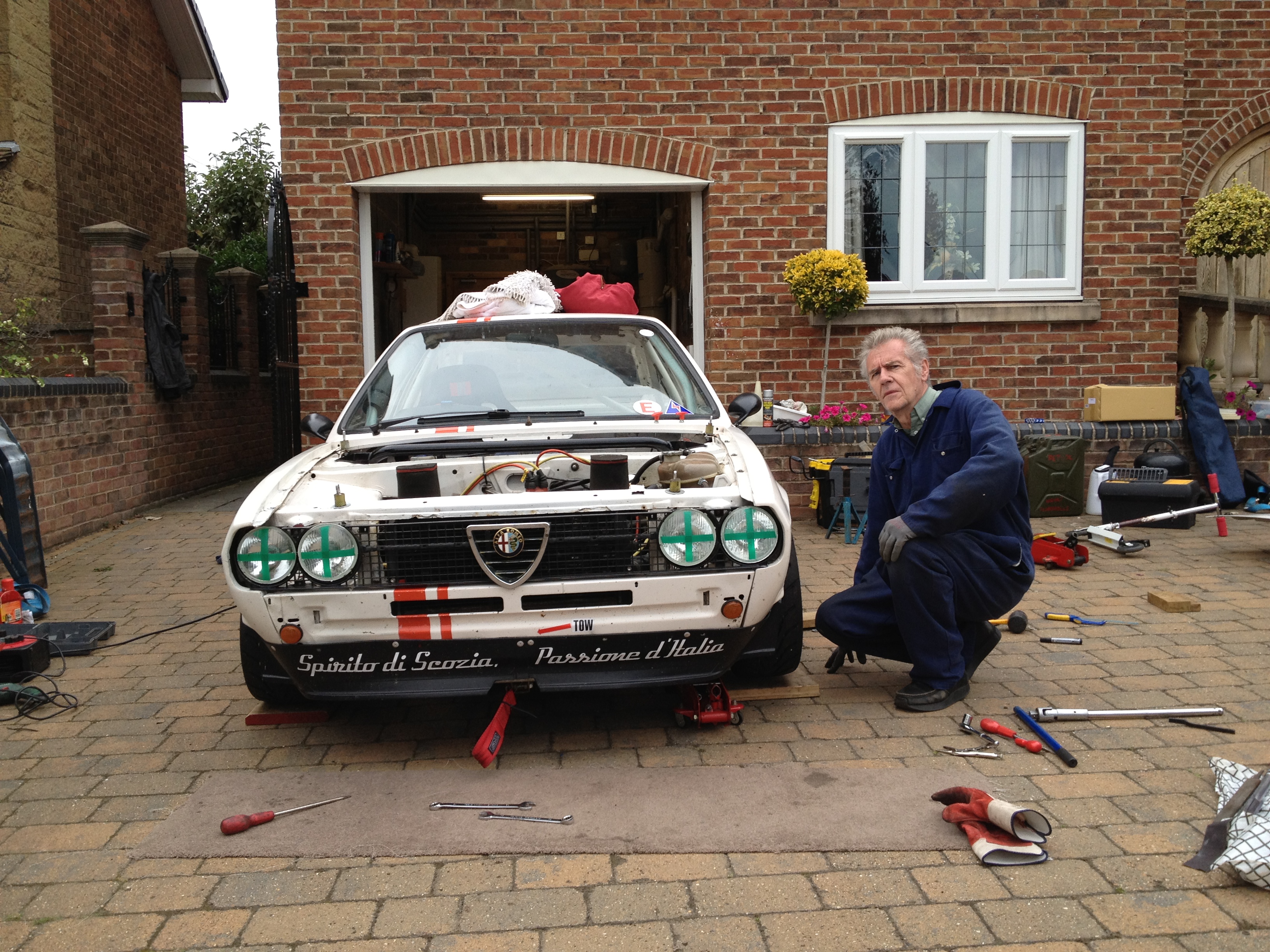

The pre Brands check over mentioned above ended up being 2 days of rolling around on the floor mostly with front suspension woes. I'd forgotten how much time the prep and sorting niggles and worn out bits and bobs can take.

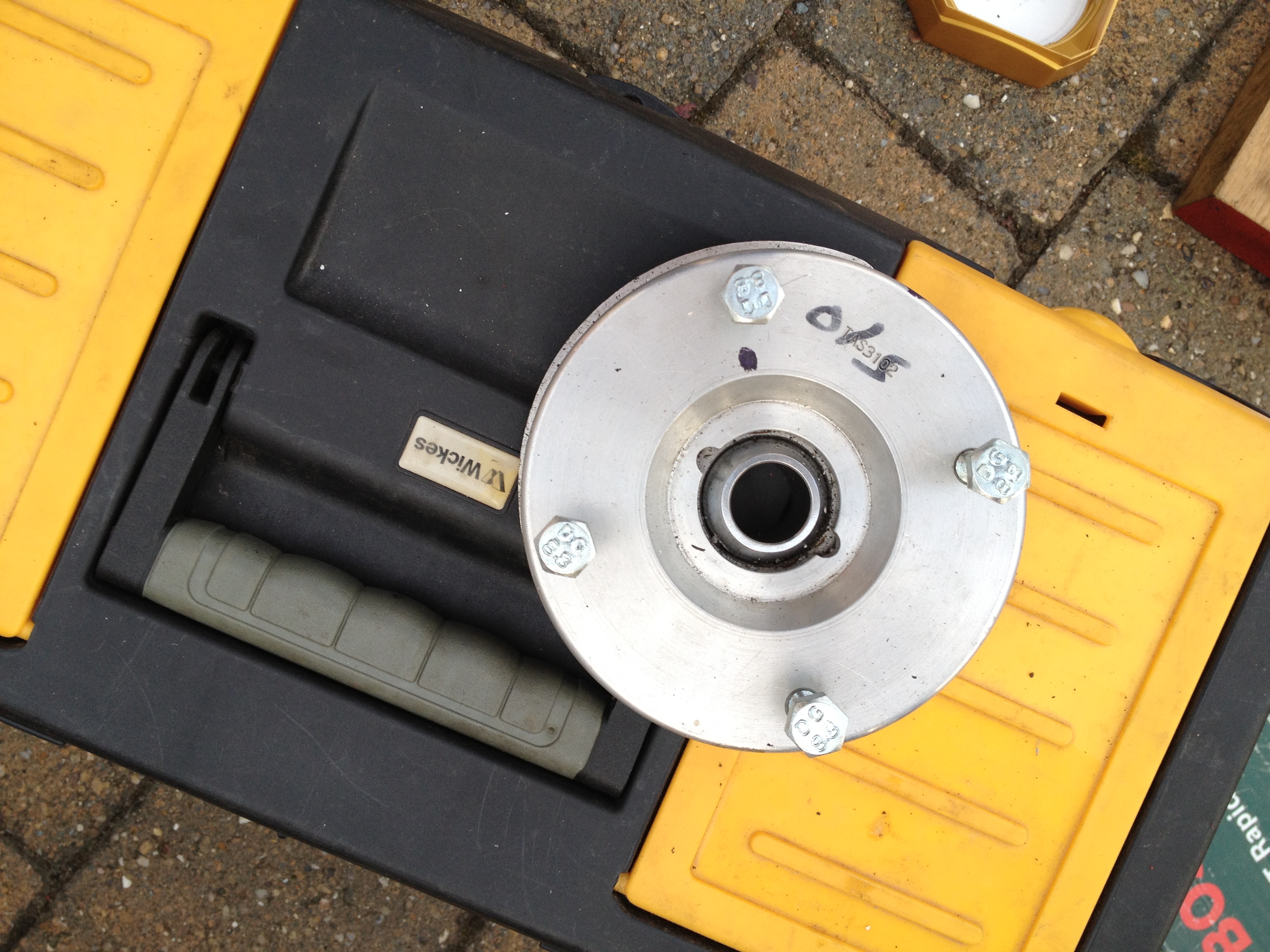

Anyhow, after taking a look a the 'leaky' front shocker we found quite a lot of play when putting weight on the front wheel (like when checking a wheel bearing for wear). With no idea what it was we decided to take the front leg off completely and have a better look. Turns out that the shocker is held in with a threaded top mounting that screws into the strut body (my other inserts are bolted in at the bottom).
It looked like it had come out while at Cadwell and shock was moving around in the strut body (and would pull straight out). All the movement had knackered / crushed the threads, or so I thought.
Anyhow, I went off to sulk and put the kettle on, while the 'chief engineer' got out his 45 year old needle files and proceeded to tidy up the threads, screw the shock back in and have it all ready before I got back with the tea.
With the strut off, we also decided to fit some rose jointed top mounts - bad idea! After taking everything apart, losing track of where the pans etc fitted, we realised that we had some parts missing and had to take them off again and go back to the old top mounts. Chief engineer is currently getting the missing bits machined up for next time
Day almost gone at his stage.
Next job was a new back box - the old one tested at 104.5db and I had another in the shed so we fitted that and we tested it at 102db so all good.
Finally the fuel leak came back with a vengance and this time it was the pump itself seeping at the joints. It was a Facet and sounded loud and awful so I assumed it was on its way out - we replaced it with a new Facet - which still sounds loud and awful!
Anyhow, we were finally ready to go .....
Chief Engineer after a long day wrestling with struts and suspenion parts. Rose jointed top mounts looking good on the tool box rather than on the car!

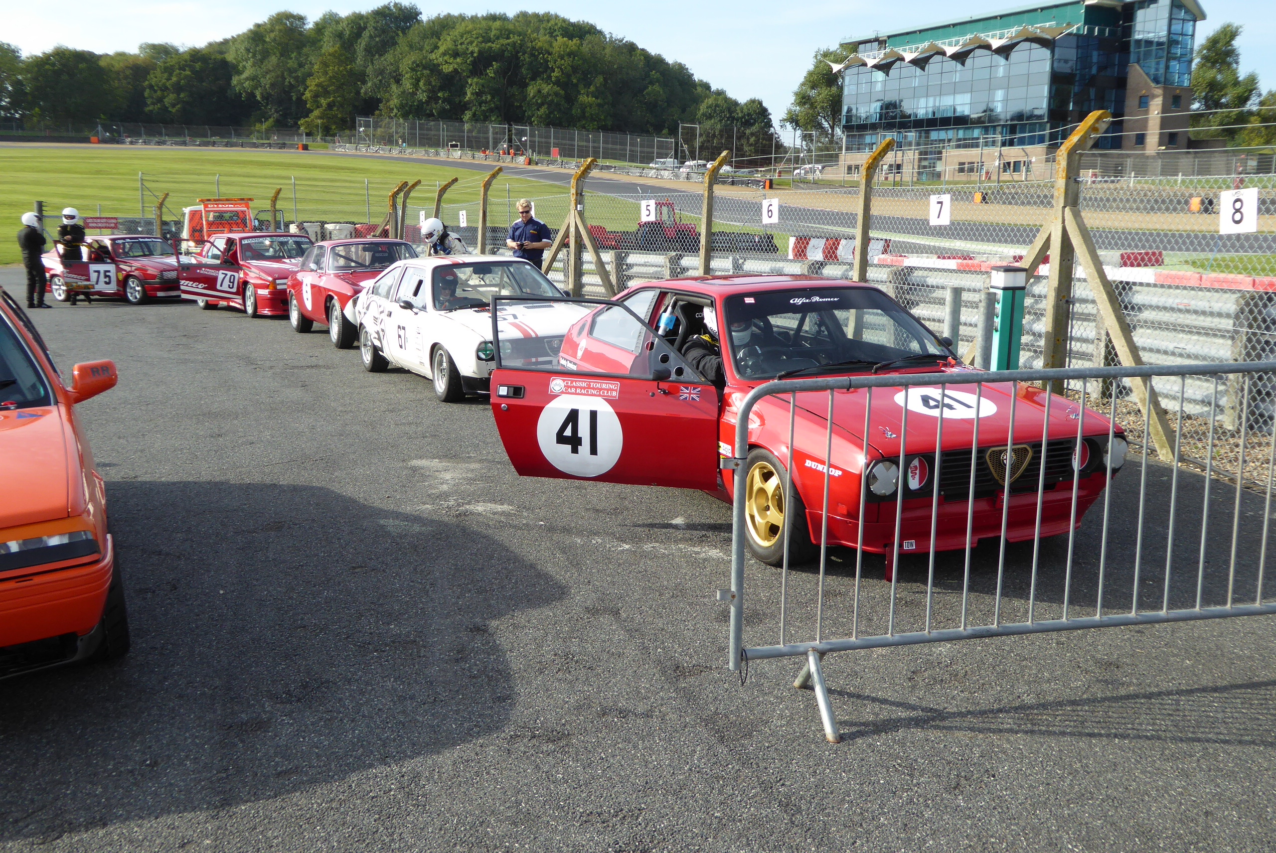

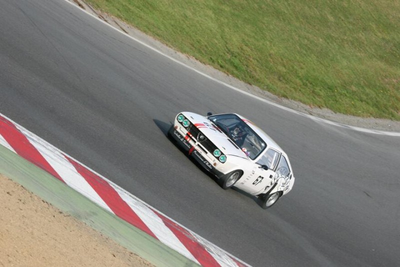

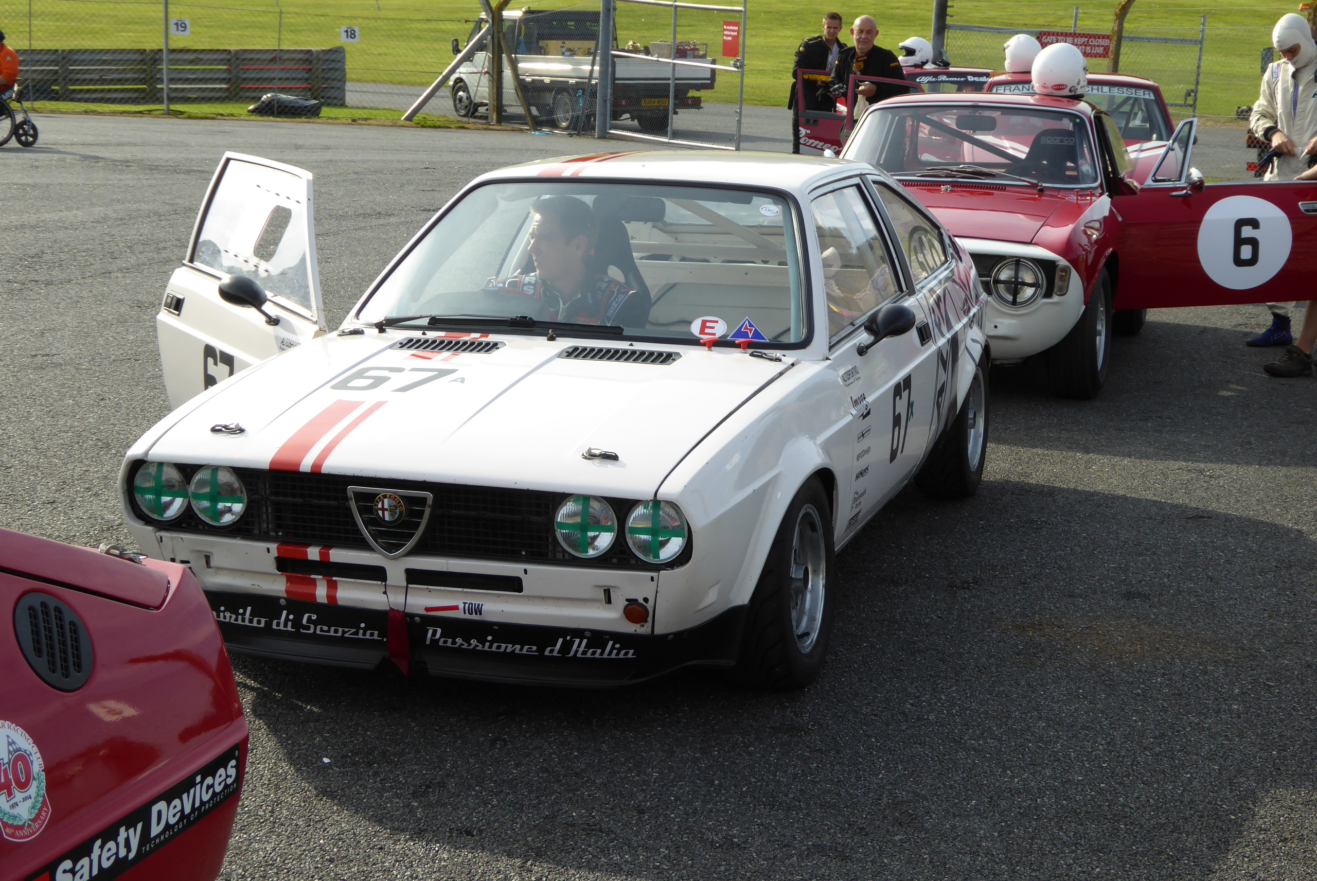

Racing was Sunday, but we went down Saturday, a really good run in 3 hours, got there just in time to see some Classic F3 racing.
Sunday we were met by just 6 other entries in the race, so 7 with me - not great for the spectator but 5 of us looked like we would be of a similar pace so looking good for some competitive racing for me at least (another Sprint 1.7, a 75 2 litre and 2 Bertone coupes). I expected to get left for dust by a 75 Turbo and a 3 litre 164
I'd only driven the Indy circuit once before 10 years ago so was all over the place for a couple of laps, then I managed to get on the back of a Bertone coupe and follow him for a few laps, getting quicker as we went on.
The 75 Turbo had a few issues and the 164 was out for the very first time (having been finshed the night before) so I was shocked to be fastest overall.
First race came, I had visions of stalling it from pole, but managed to get away well and pulled a small gap over the Bertone coupe and the 75.
About half way through I locked a wheel braking for Paddock Hill bend and thought my tyres had gone off, same happened again at Druids. I eased off mostly due to my self preservation gene taking over and the Bertone caught me up, at which point I realised it was oil covering half the circuit dropped by the 75 Turbo. So lead foot back onto throttle and managed to hold of the Bertone to finish 'first'.
Same routine for the second race, not the best start but once I got into second I managed to pull a gap while the other 4 cars tried to get past each other, and managed to keep the gap until the finish.
In reality, had there been more cars, and if the 75 Turbo had been running 100%, I would have been in my ususal position half way down the field. So the weekend goes down as both my first ever, and last ever, pole and race win - I'm not expecting to repeat this any time soon!
I still need to find another 2 seconds per lap to be on the pace in the pre 83 series.
Good news was the car handled really well after all the suspension fettling, and while I still cant quite get to terms with revving a 1500 cc to 7800rpm, the motor ran really well up until the last couple of laps in the second race - it didnt feel quite as sharp at the end (see next post).

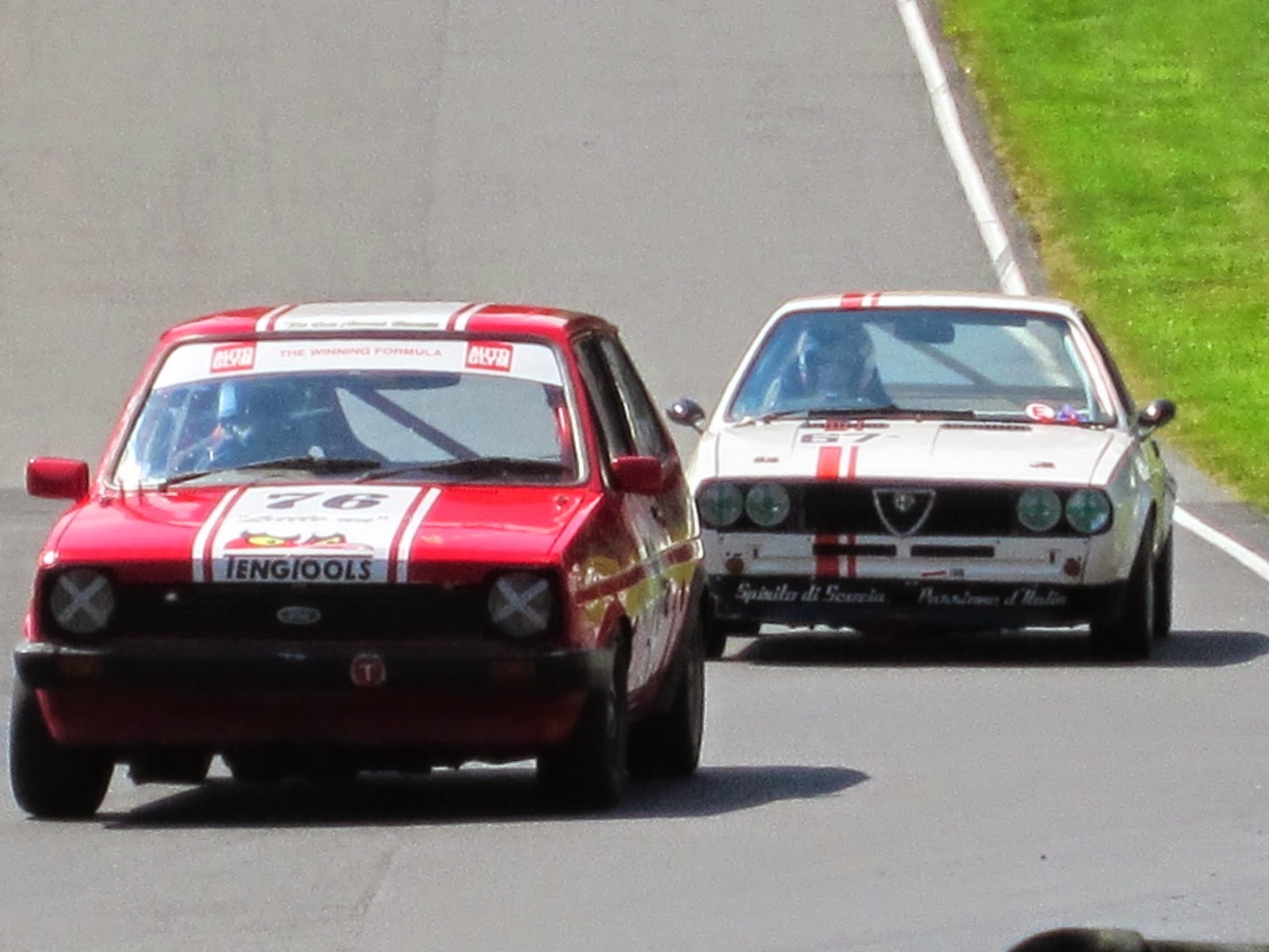

Lovely.....!! Also found a pic from Cadwell, trying to keep up with a quick Mk1 xr2

Three of us have just passed our ARDS and are sharing the car. I drove at Cadwell, Chris drove at Brands until his nearside wheel studs came out. Malcolm will be driving at Oulton Park.
We had the wheels re-furbished and the pictures show powder coating in stud locations. We think this allowed the studs to loosen. Compomotive have supplied new stud inserts and we will also be checking stud torque after each race.
