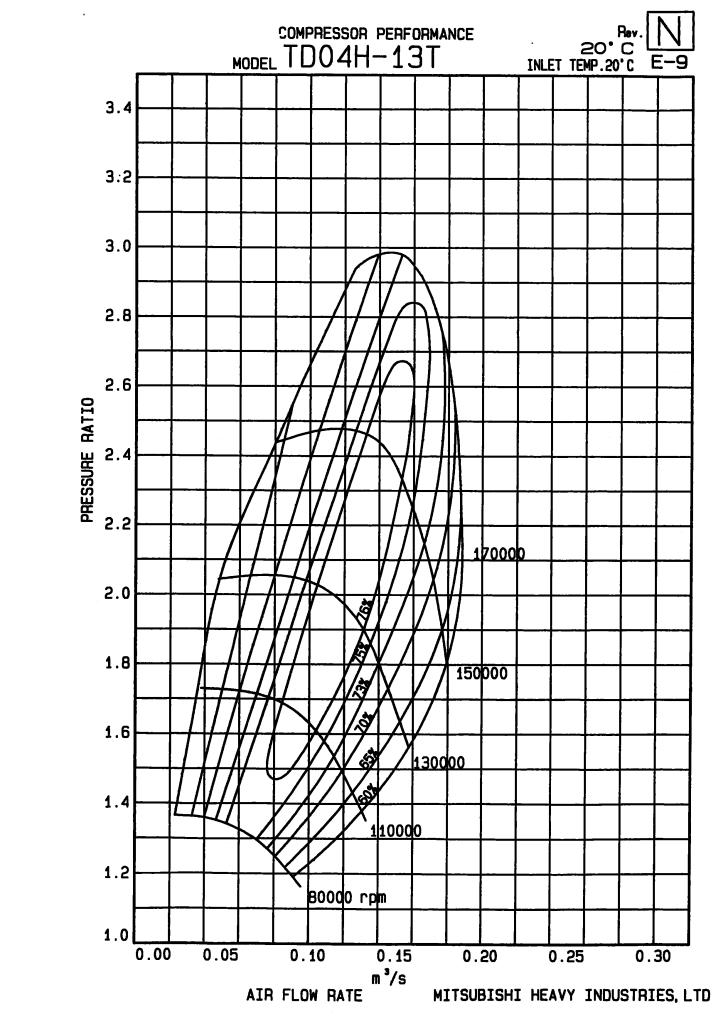

so, to echo the sentiment of a few on here, i'll keep this in the realms of reality and reasonable budget.
engine type = flat four boxer
litres = 1712cc 16v
rpm - 7000/7500 max
target = approx 200bhp limited mainly by drivetrain weakness
model/weight = alfasud/800kilo
use = fast road/occasional track
preferred method = Turbo, flexibility of boost control and choices, budget of parts, (i considered the WRX - TD04 a good choice?)
because the stock motor is approximately 135bhp in healthy form, running a CR of something like 9.5/10-1, i thought the target of 180-200bhp would be achievable with a stock motor and low boost levels, 7/8psi added boost, with a pretty good expected reliability.
controlled by a full stand alone ecu too i might add.
am i a mile off?
buzzed
Posts: 51
Joined: Tue Apr 01, 2014 11:17 am
Re: Turbo / Supercharging - Considerations
Post by buzzed »
Cool Shrew, I think your sugegstion would net a good end result. I will work through your scenario with turbo and a supercharger comparison. With such low Hp target, I feel supercharging would be a better solution...same top power, more bottom end. Is that engine 200hp or wheel?
I could get technical on you, but with the target in mind, there is little need, you can do it blindfolded haha, but the key will be for min cost and max spread of torque agreed?
Your turbo choice is good bang for buck (L-13t), it's possible you could drop the turbine combo for even more low end repsonse and retain top end requirements. I'll sniff it out.

Thank you Mike, nice to know i was in the ballpark! ha ha!
There were other factors leading to my choice that may affect your engineering perspective.
The horsepower figure, whether wheels or crank really, has been set so low so that initially, i could use a stock motor, not lower the CR, or get into steel internals etc, so budgetary and simplicity for starters, but primarliy because there was little point aiming for more when the gearbox simply won't stand it.
So a tdo4 was a bit of a plan for the future too.
If we bottom a design plan for reinforcing the drivetrain components without the need for a lottery win, then the td04 still has plenty of room left for more. It works well and remains cool at 250+ hp in the Subaru, so should have an easy life making in excess of 200hp if we get the chance to tweak further considering the above.

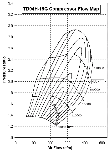

Can anyone supply a dyno chart for their non turbo 16valve setup? I would like to calibrate my model to the engine's efficiency, If I can get a curve showing rpm and power/torque I can do this. If you have a turbo map, even better. Just have to let me know if it is wheel or engine power, and I would prefer no bullshit dyno runs that have been meddled with :-). Will just make my end number more accurate.
Oh, and SHREW, which turbo? TDO4 13 or 15? I can check both of course, but just wondered which one you were interested in.
TD04 - 13T
TD04 - 13T
TD04 - 15G
TD04 - 15G

Shrew,
I had a look at your setup.
Target: 200Hp@engine
Stock max rpm: 5500
stock compression: 9.5:1 correct?
Allowable boost: 8psi (on 9.5:1 gives static compression ratio of approx 11.7:1 when boosted)
A factory MY97-98 WRX makes 155KW (aprox 208Hp)@engine at 5600 with 1994cc, almost 300cc more than you have. It runs 8:1 static compression and 13.5psi which is about 11.7:1 static compression when boosted. So our total static compression ratios make sense so far.
Scenario 1: Sensible boost
Intercooling reccomended, but perhaps not mandatory.
Comp: 9.5:1
5500rpm
8psi (reliable boost)
148Hp@ engine (approx)
Scenario 2: Max boost
intercooled!! water/methanol 50/50 perhaps as added safety.
Comp: 9.5:1
5500rpm
10psi (max boost for street fuel on this comp)
160Hp@ engine (approx)
Scenario 3: Maintain valumetric efficiency post 5500rpm
Comp: 9.5:1
7500rpm
211Hp@ engine (approx)
Scenario 4: My mad Alfasud
Fuel = toluene/98 octane mix
Engine capacity (2 liter with custom forged piston and crank)
Turbo Head work
intercooled!!
Lots of other support stuff...custom liners, crank, cams, etc.
Comp: 9.5:1
8500rpm
35psi
550Hp@ engine (approx)
Realistically, I think you could hope for Option 2:160 engine Hp on stock compression. If you can increase boost post 5500rpm to fill the torque curve and streth out the usable rpm, I think you can come darn close to wrx peak power, which in these cars would be pretty silly fun. It is worth noting that Option 1 nets you the same power to wieght ratio (what really matters) as a WRX. That is about as far as you would probably go without opening the engine. I suspect you would end up opneing the engine after a blown headgasket, and a decent tuner would eb required, but this goes without saying for all engine modding.
I've used TD04 for these calcs, but it matters little for this discussion, ultimate turbo choice will come down to mainting flow requirements with decent efficiency, and not keeping too much in reserve. Get it right, the result is mind blowing, get it wrong and it's a bit ho hum, and annoying between gears. I still maintain that for the flow we will need on this scenario, the turbo may be a little large still, as it is capable of some 250Hp, and realistically, we are hovering around 150-200 MAX.

as for the TD04, i was actually considering the even smaller 11g for my 200hp engine target.
different markets may label, and certainly get different turbo's i know, and sadly i don't have a flow chart for it, but does that figure in the sums any more suitable?

Without a flow chart it is hard to say. Indirectly you can make an assesment based on what it is strapped to. I also could not find a flow chart for it. I was thinking something like the CA18 Nissan turbo engine might be an option. They are old now though so most if not all are probably stuffed. Perhaps a turbo off a much newer model car to get the benefit of better turbo design. Try something like the turbo mini turbo, or other 1600-1800cc engines that produce your target Hp. Stay away from turbos that have the turbine glued on, overboosting these tends to see them end up in the exhaust somewhere near the first muffler :-).
