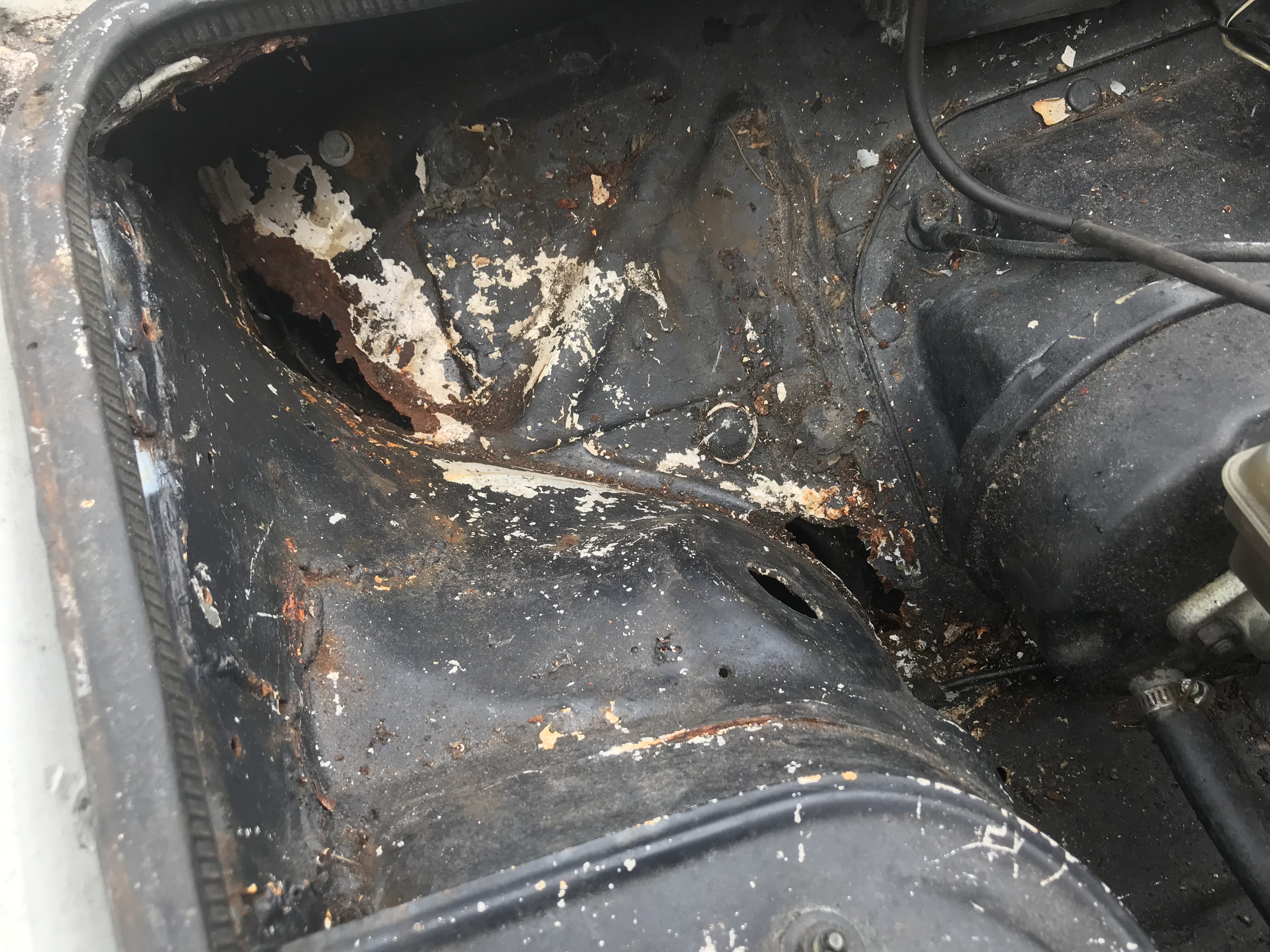

Another pic of Dave’s problem. attachment=0]IMG_5650.jpeg[/attachment]
As I suspected the rot has spread across the entire service bay.  Sadly there is only really one way to deal with this level of corrosion and my approach would be do it right or don’t do it.  Doing right however this is likely to become a very big job as you’re almost certainly going to uncover further problems the more you remove bits.  Start with wings to inspect the length of the wing mounting rails.  I’d then strip everything out of the entire service bay.

Re: Rust
RH side.  Sadly more of the same
Whichever way you look at it it’s going to be a big job.

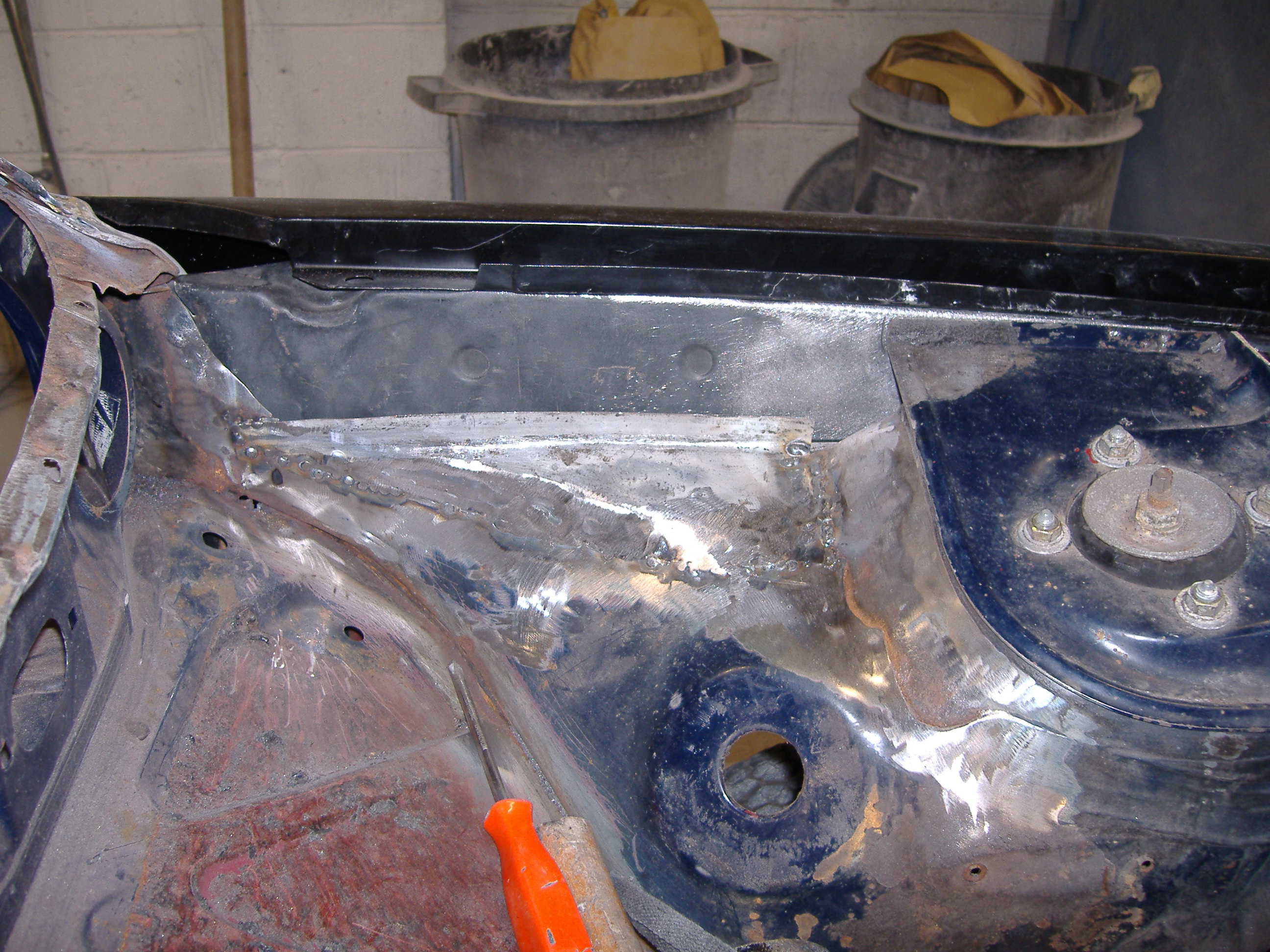

						Re: Rust
Well to be honest they tie the strut top mounts to the windscreen base and bulkhead as they are a box section. The front bit is more to support the wing but it all adds strength. Can you do any fabricating yourself or do you know someone who could make something?

Re: Rust
Personally I’d say the top rails are most certainly structural as Keith said they tie the strut tops to the top of the bulkhead and inner wing.  The repairs are relatively simple if you just want structural integrity however cosmetic authenticity that’s when it can become a much more involved and time consuming job.
						Re: Rust
Totally agree with Lou on that one. Like i said , not sure of your background Dave but structural repairs could be made relatively easily if cosmetics are not too important. flat steel sheet and a basic box section.

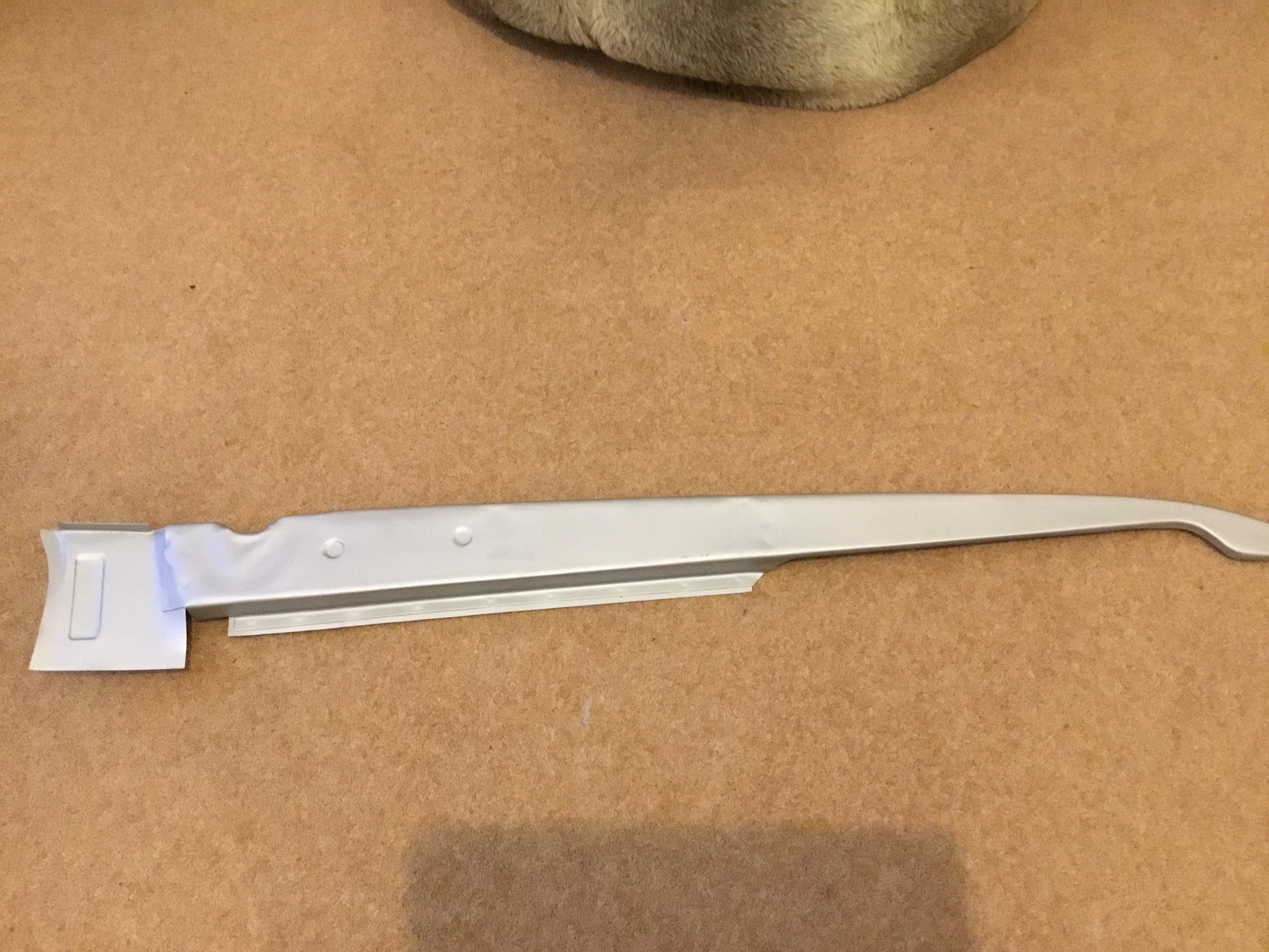

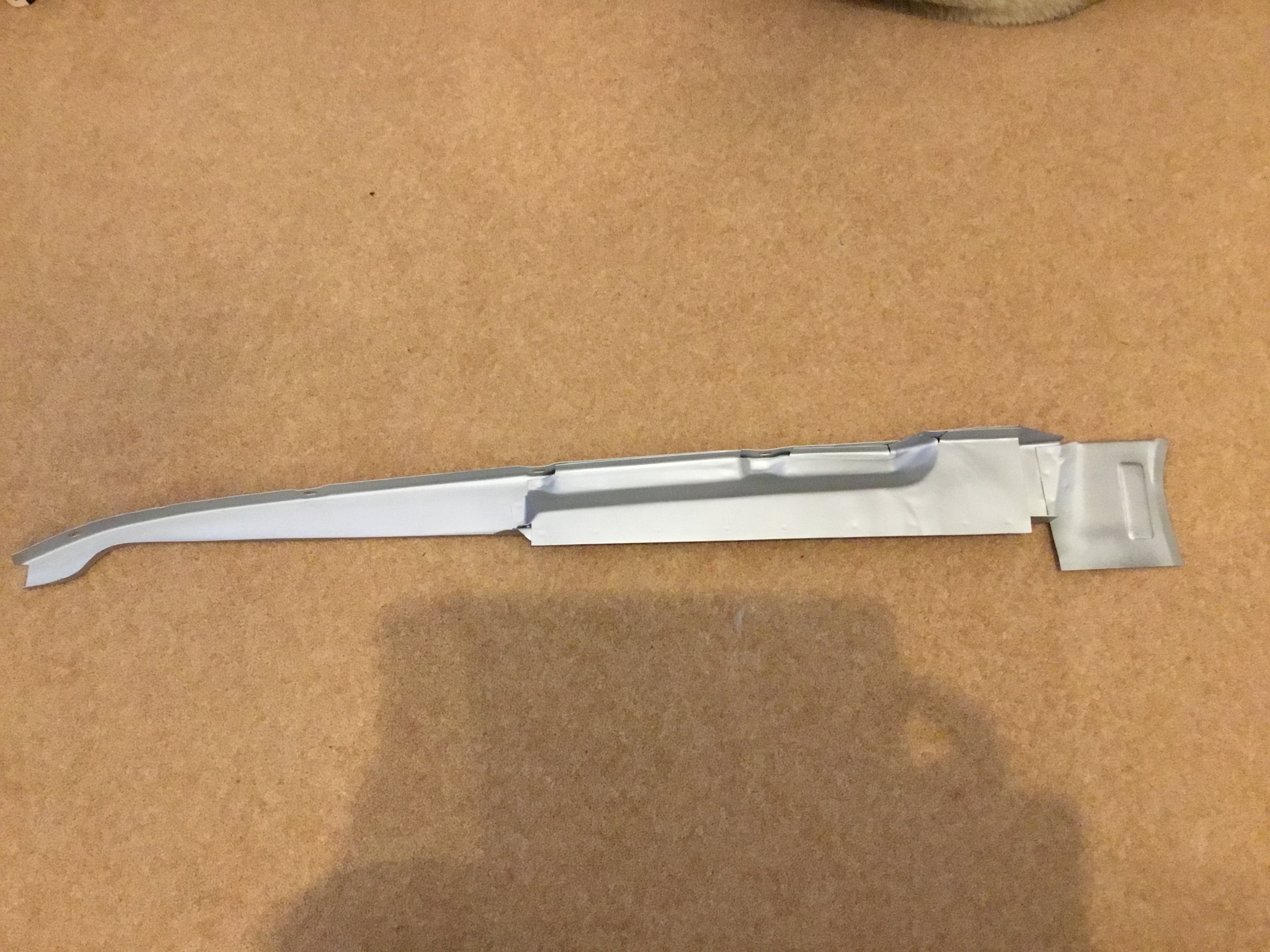

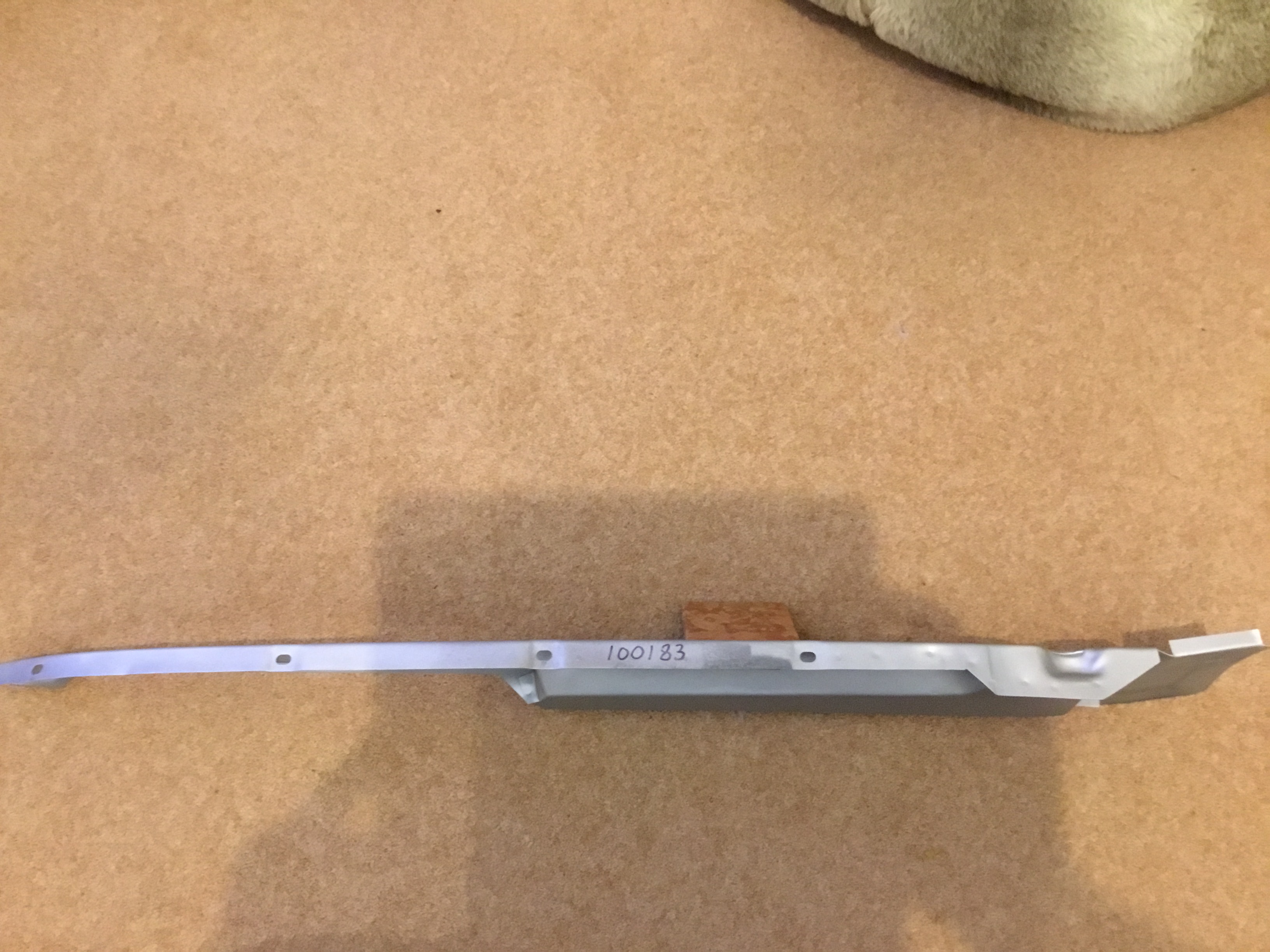

						Re: Rust
Hi Dave, I hope John can get this sorted for you, there is a considerable amount of work though which will take time.
You mentioned not being able to locate any replacement wing rails. I happen to have an aftermarket one which I don’t want to part with but will post a couple of images here so anyone wanting to reproduce them has an idea what they should look like.
