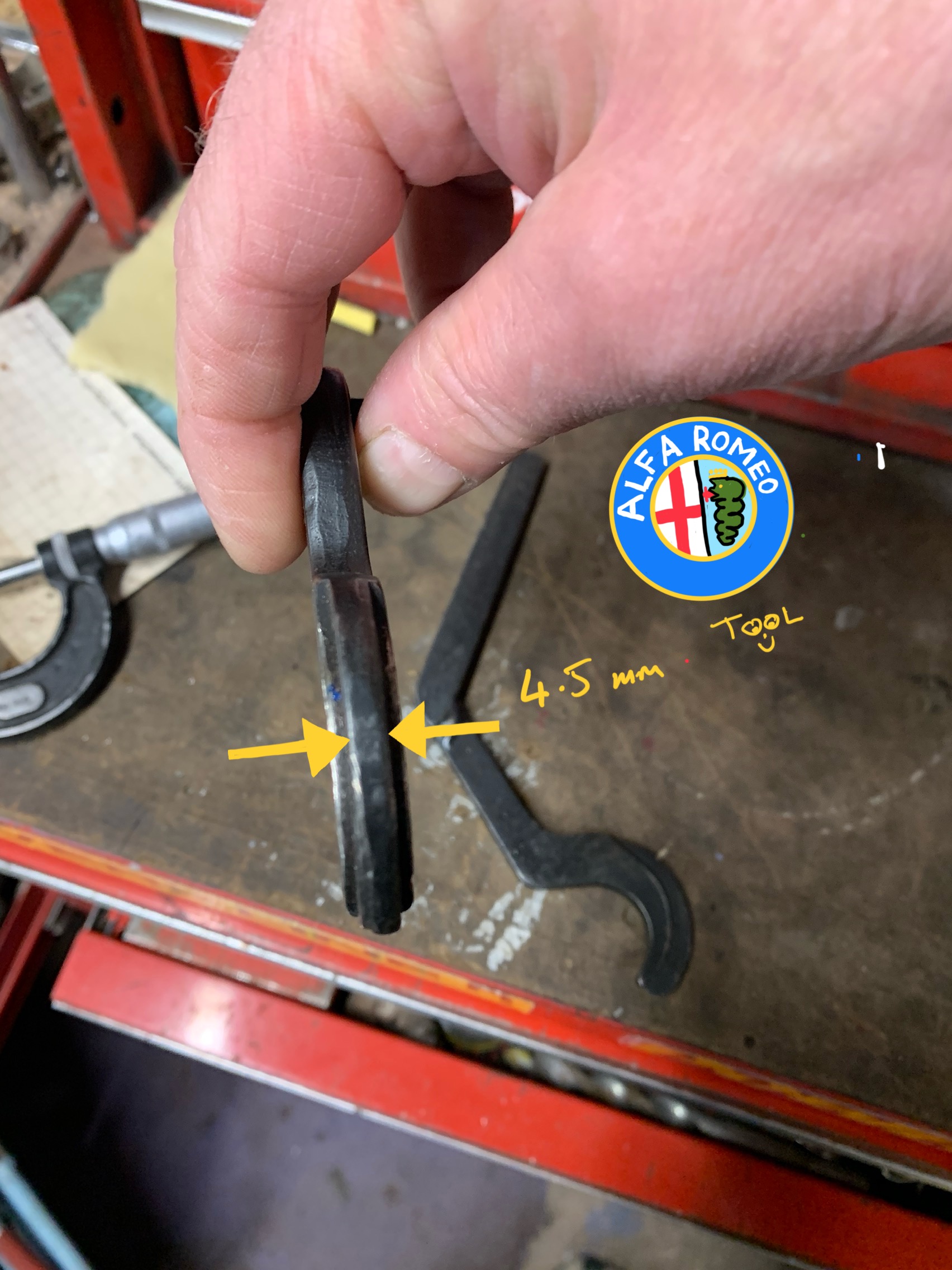

I’ve got that one . I’ve also got this one which I seem to remember being the correct one. I can’t just put my hand on the other one so I’ll have to dig it out

LooLooSud33Spider wrote: Sat Apr 06, 2024 12:48 pm I’ve got that one . I’ve also got this one which I seem to remember being the correct one. I can’t just put my hand on the other one so I’ll have to dig it out IMG_2075.jpeg
Thanks Lou - that looks like the one in the Alfa 33 manual, with the hex head for putting a socket and tommy bar on to.
It seems to be very similar (if not identical) to the Fiat X1/9 SOHC shim tool:
https://www.eurosport-uk.net/shop/image ... 41_med.jpg
Similar application, I wouldn't be surprised if Alfa and Fiat shared the same tappet buckets, even if the 'Sud engine is a pre-Fiat takeover design.

Hi again Lauren. I’ve just checked and whilst both tools look similar they’re actually different thicknesses.

OK, thanks Lou. Hmm. I wonder if the Alfa tool is designed to depress both the inlet and exhaust buckets at the same time? In which case, the shoulders bear on the bucket edge and the centre ridge locates in the gap between the two. If that is the case, I will have to use the Fiat tool to depress one bucket at a time, but that is no worse than using the Haynes tool.
