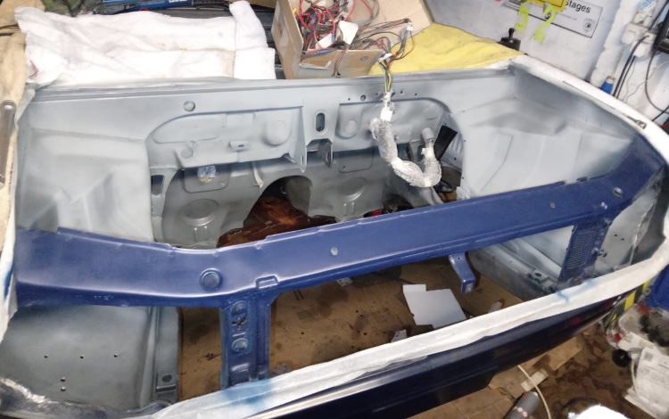

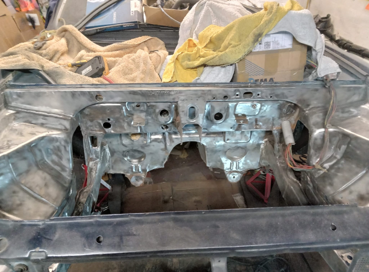

Still got this car. Ended up doing a load of engine bay paintwork. Not from rust but previous owner had coated it with something and it looked awful.
Just started to refit wiring and starting to sort out drive train.

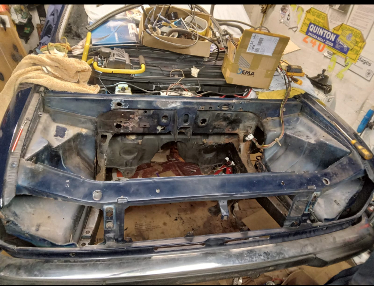

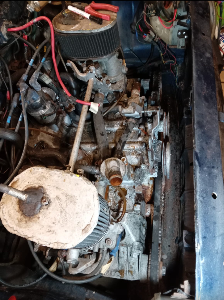

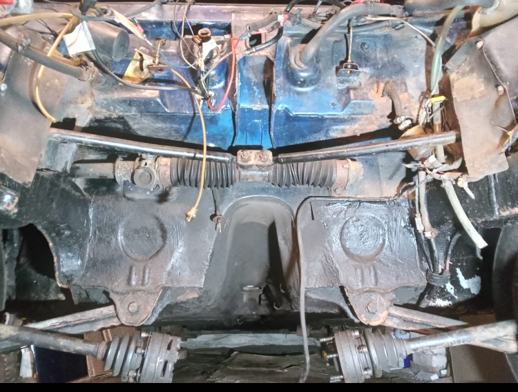

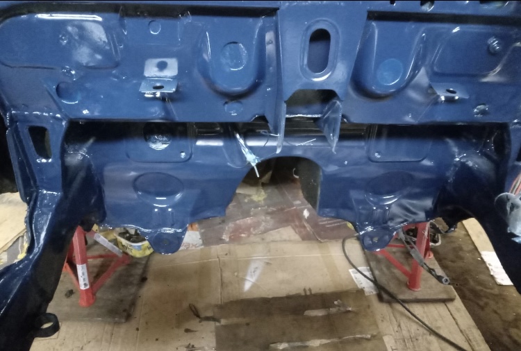

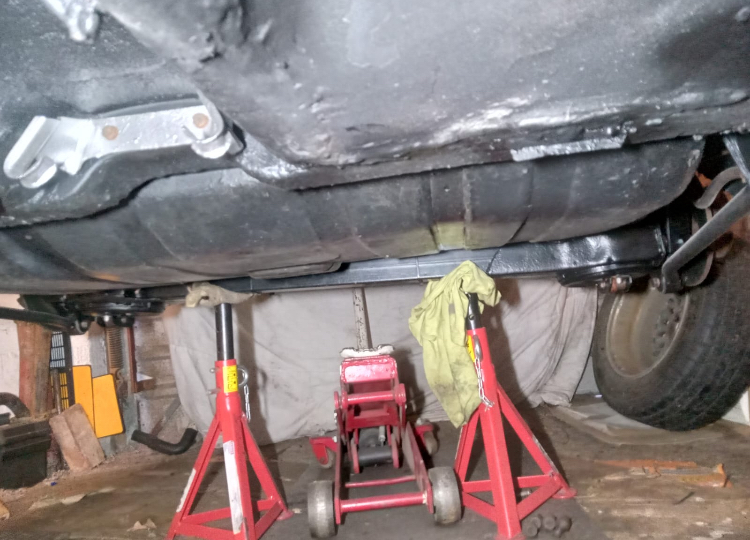

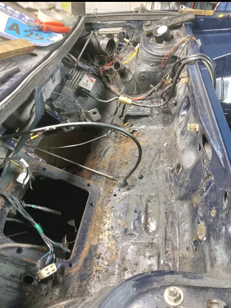

Posted for Ade.
I think these are all before pictures.

So is the twin carb engine a 1.7 ?.
Would that head be ok with new valves and guides or would there be other damage?
Looks the same colour my Sud started out with.

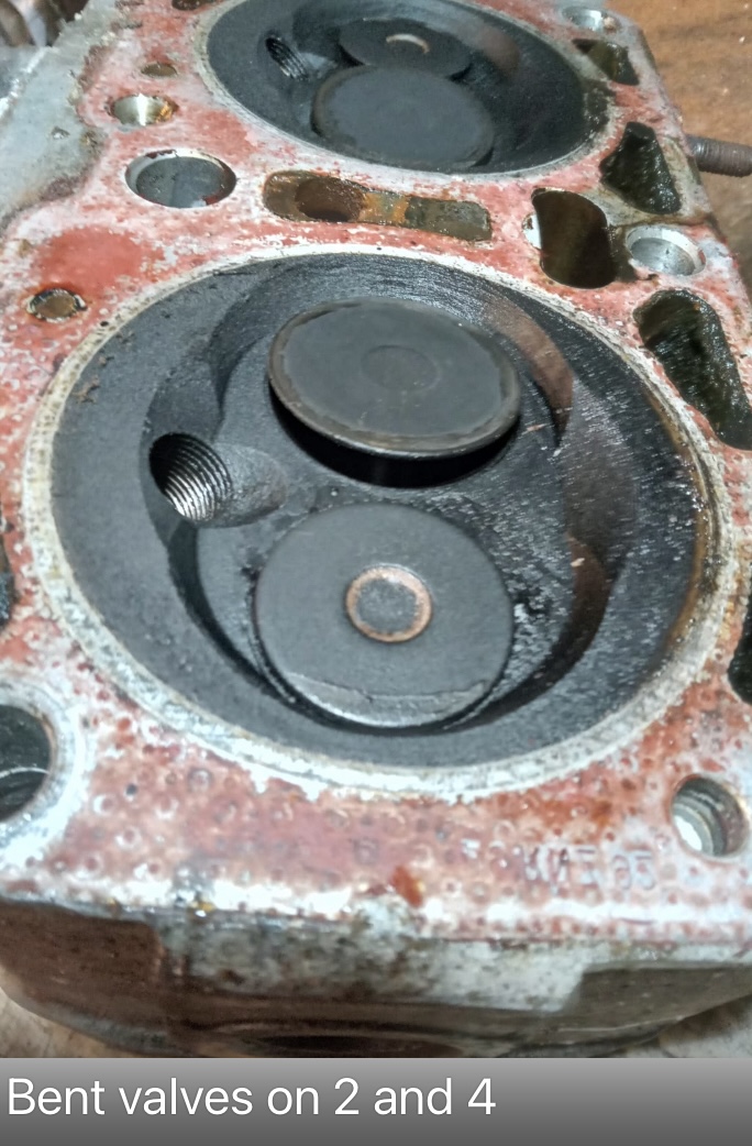

The car came with a 1.7 twin carb that hadn't run in 20yrs. Turned over ok though. It was only when I tried to time everything up to do the chambers I found out timing was all wrong. Took the head off and found the bent valves.
At the moment plan is to put a single carb 1350 back in. I have the option of 1490 fast road engine, 1600 rally engine, 1712 8 valve. I've probably got enough bits to build a 16v if someone was that keen.
