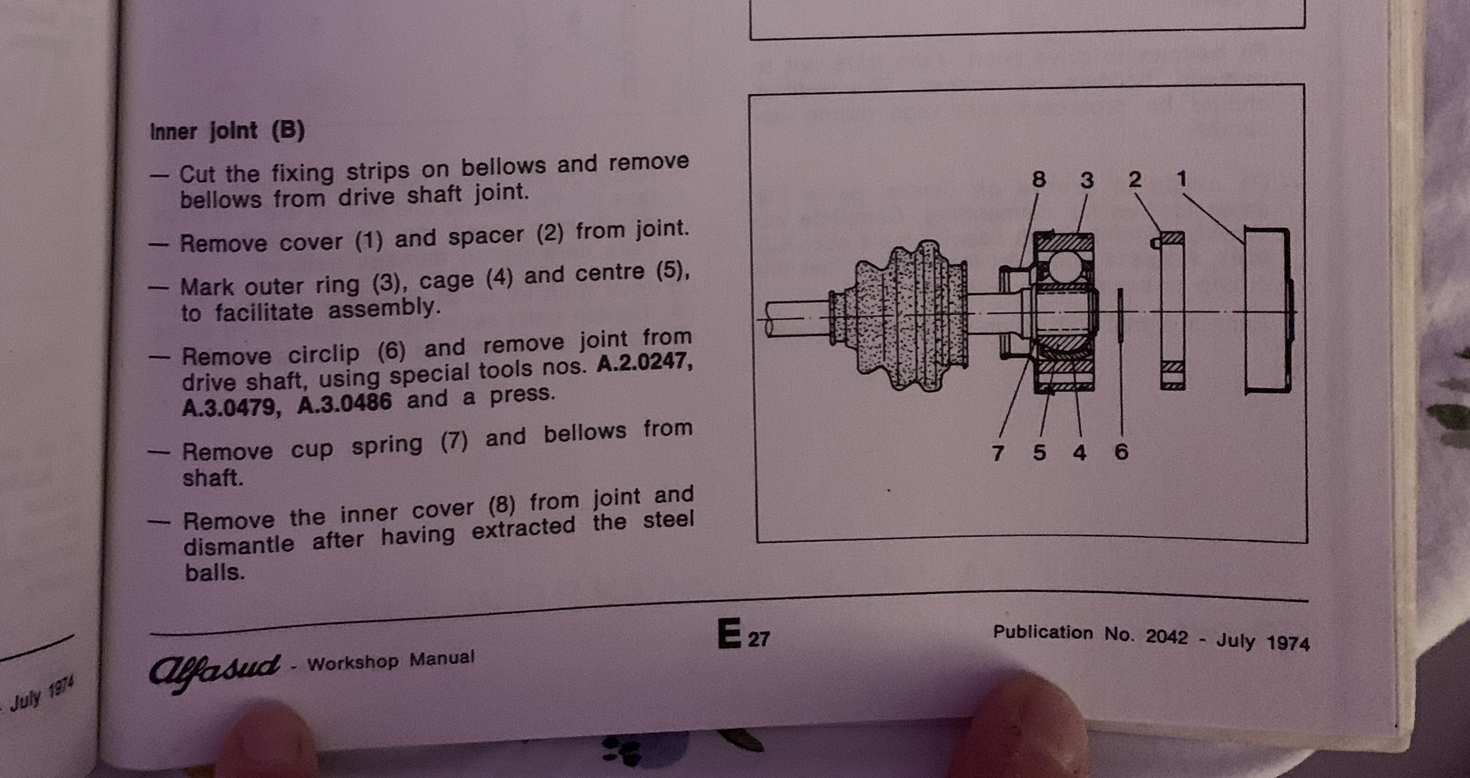

Hi Chris. To replace the outer shaft boots on Sud shafts the best way is usually to remove the inner end. Start by removing The shaft from the gearbox. Then prise off the steel cap that covers the cv joint. Inside you’ll see the end of the shaft and a circlip. Remove the clip and any ties holding the boot to the shaft. You should then be able to remove the inner cv joint with its boot from the shaft. Beware that there is. Concave washer that sits on the shaft before the cv joint ensure you refit it when reassembling. Once you’ve got it all apart simply slide your old outer boot off and your new one on remembering to repack the joints with fresh CV grease. See my sketchy picture for a general idea of the build up as described.
1). Steel cap
2). Circlip
3) inner joint
4) concave washer
5 ) inner boot
Hope this helps
Re: How to remove a CV joint

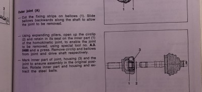

I’m a little concerned about your use of a bottle Jack ! There is a circlip holding the outer joint on. But they’re such a pain to open reliably we found the aforementioned method the best and quickest way I’m just hoping you haven’t knackerd it by using the bottle Jack !

Please refer to the attached pics taken from the official manual. The manual covers the original shafts from 73/4 but they are basically the same. As the shafts on later cars
As I previously mentioned there is a circlip in the outter shaft but they are such a
Pain to get open to allow the shaft to be removed I’ve always done them the way I explained previously
