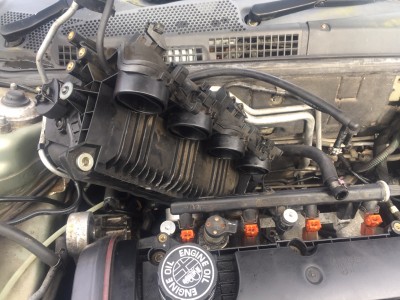

Well it came off eventually. What a crap job, I think I will raise the Titanic next weekend as that will be easier.
Heres a photo of the angle you need to get the plenum at for it to be pulled out. Note the damage to the plastic fins as thats how tight the gap is if you don't loosen the lower engine mounts.

Hi Cranky. OOPs. I should have said it’s easier if you feed the plenum in from the gearbox end and then do a rotatey sort of motion to get the plenum on to the inlet rubbers. Soz !!!
