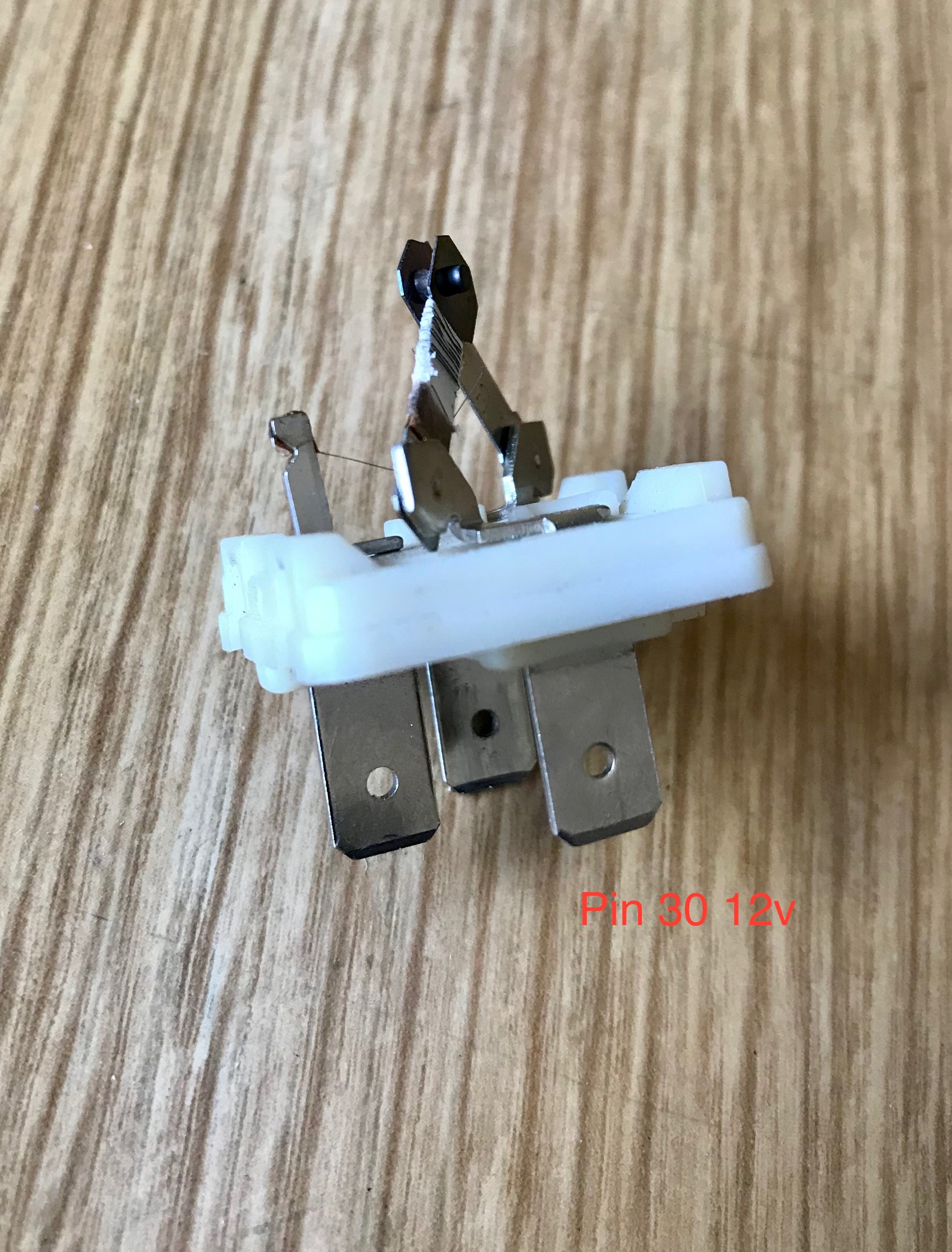

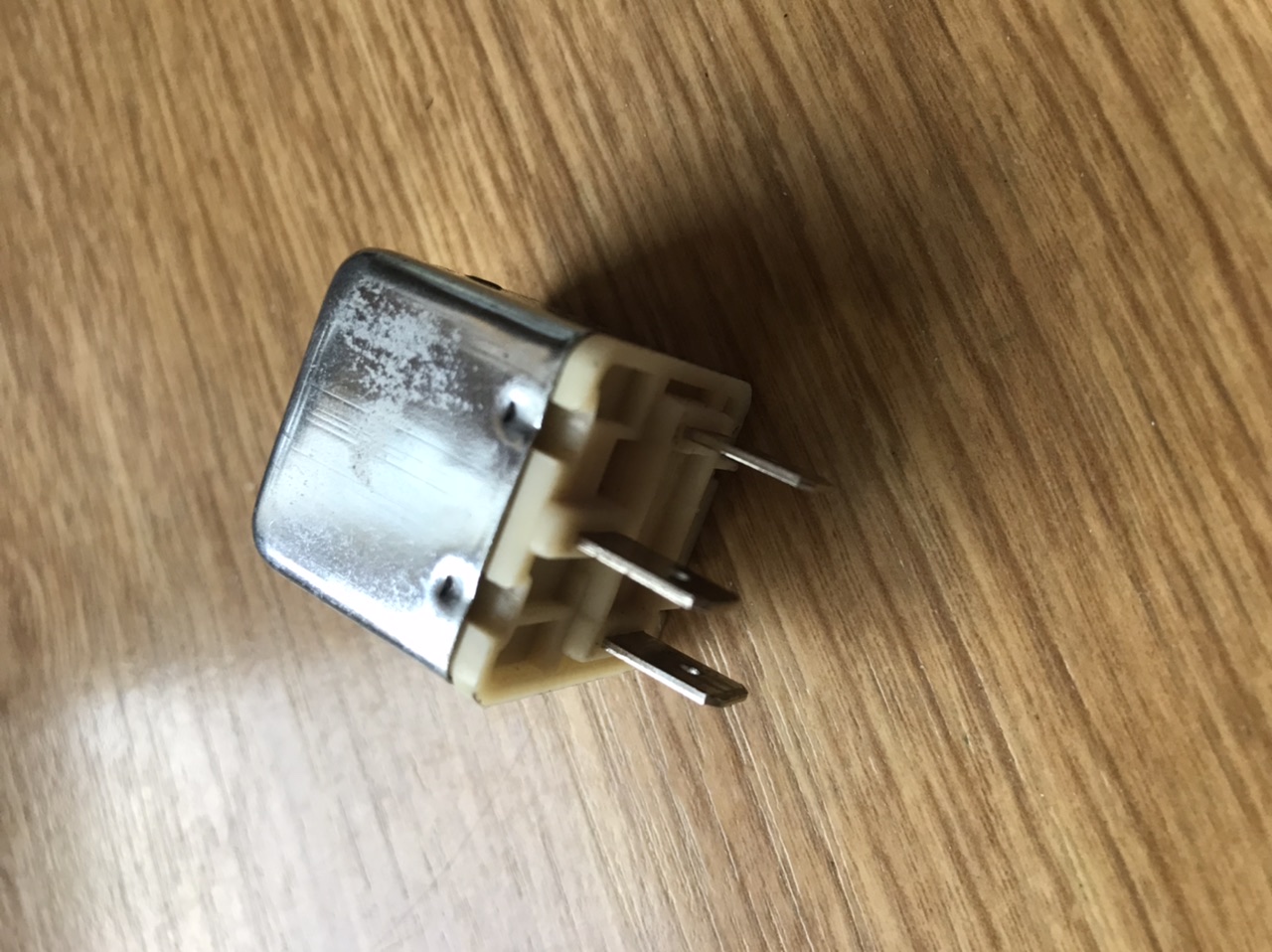

Does anybody have or know where I can get a replacement interior light relay from? It’s a Sipea 0948 3 pin relay, thanks!

Can you post a photo Neg . I’ve got a bucket full of relays so I’ll have a look

Thank Loo / all, pics attached. I saw the one on on ebay yikes!

I’m sure I’ve got some of those. I’ll dig my box out and see what I can find

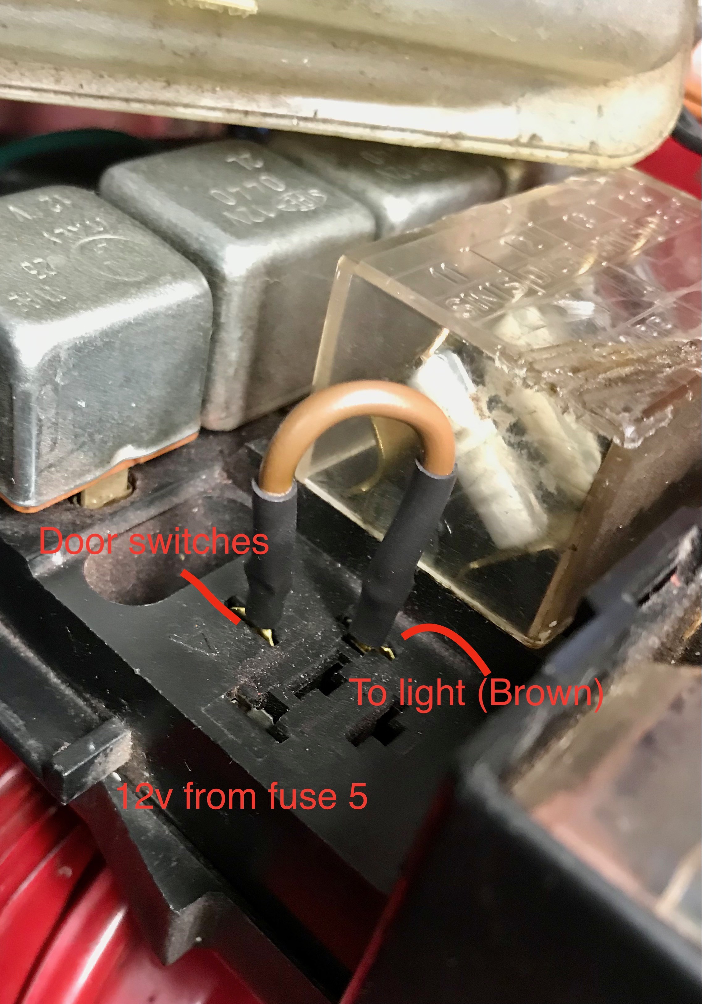

I’ve not done it yet, just worked out how to re jig the wiring in the fuse box to accommodate Type B 4 pin relay. There’s another quick and dirty way to simply jumper from the terminal that goes to the door switches over to the terminal that goes to the light. You will also have to re jig the wiring at the light itself. Both lose the delay function and the last will also disable the bulb in the ignition switch.

I figure there are 3 ways to fix the interior light, replace the hard to find 0948 relay, re jig the fuse box wiring to support a Type B 4 pin standard relay or simply jumper the connection in the fuse box and re jig the interior light connections.
The 0948 relay has a bimetallic strip and a heating wire wrapped around it, when a door is open it grounds one side of the heating wire heating the bimetallic strip and closing the contacts turning on the light. Shut the door the heating wire is disconnected, the bimetallic strip cools down over x amount of seconds and the light turns off.
All good, except that every time the door is open even if the interior light is set in its off position the relay is active and switched on, eventually it burns out.

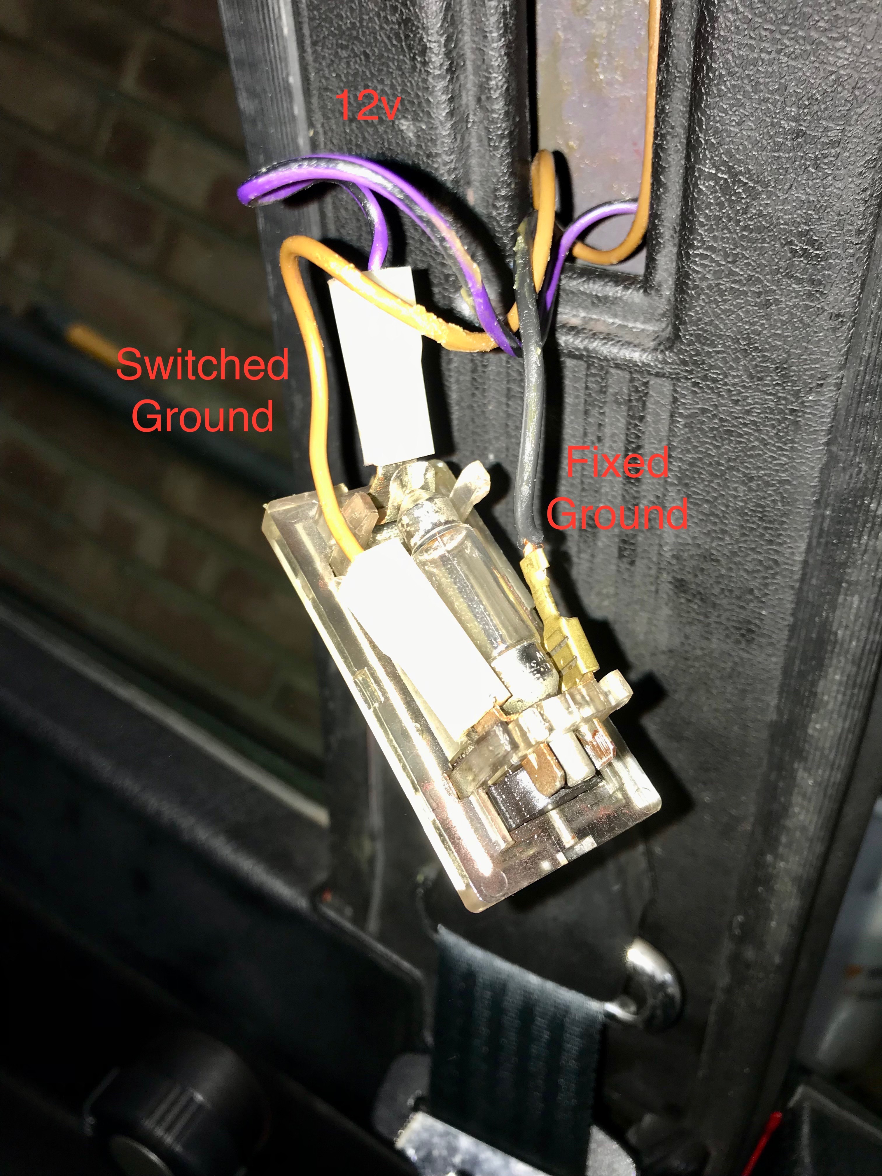

I’ve gone with the quick n easy option and made up a jumper wire to connect the door switches to the brown feed wire that goes to the interior light and the bulb in the ignition switch, turning it into a switch ground instead of a switched 12v feed.
It means you have to swap the connections over at the light itself, move the permanent 12v feed (purple wire) to the top connection of the bulb and move the permanent ground connection to the remaining connection.
Naturally you lose the delay function and the ignition light doing it this way.
If you go with re-jigging the wiring to support a standard relay then you get the ignition light back. I’ll write up how I think you can wire it like that later.

I actually once repaired this relay. I bought from local electric supplies store a couple of very cheap ceramic resistors with different resistance values which I then broke to get the resistor wire out. I had a couple of trials and errors but then I found correct wire which has right resistance and now the delay works as supposed. Unfortunately can't remember right resistor value :-/
Resistor was something like this.
https://www.triopak.fi/fi/tuote/21611W10R
Replacing the resistor wire was fairly simple job. I removed the old wire, then wound new wire on place and solder the wire ends on terminals.

What’s the correct wiring configuration on the light with the relay in place?
I have wired the light as pictured above as I figured the common connection is the 12v positive, the two negatives - one switched one permanent - should be at the opposite end. I have the relay in situ, so am I correct?
