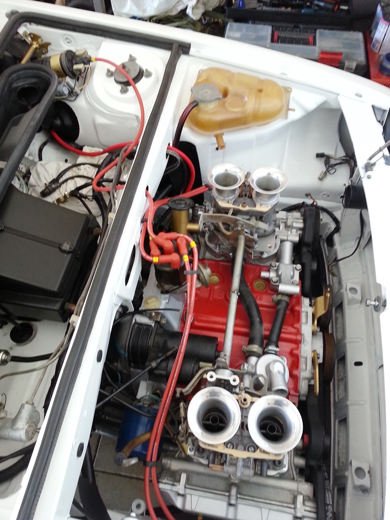

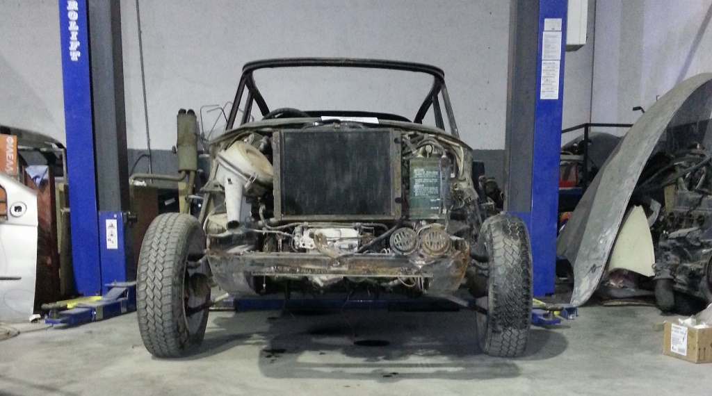

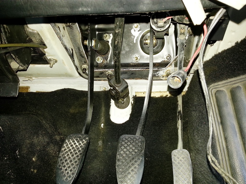

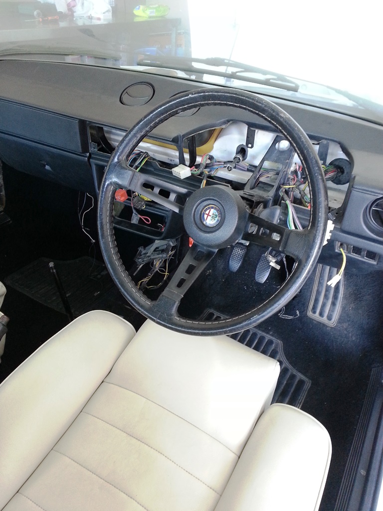

Yesterday I was working on my S3 Sprint for a change !
Fitted the ignition and calbes, steering column and steering wheel, pedals and pins, secured the dashboard in place, and I was trying to figure out what to do with the radiator.

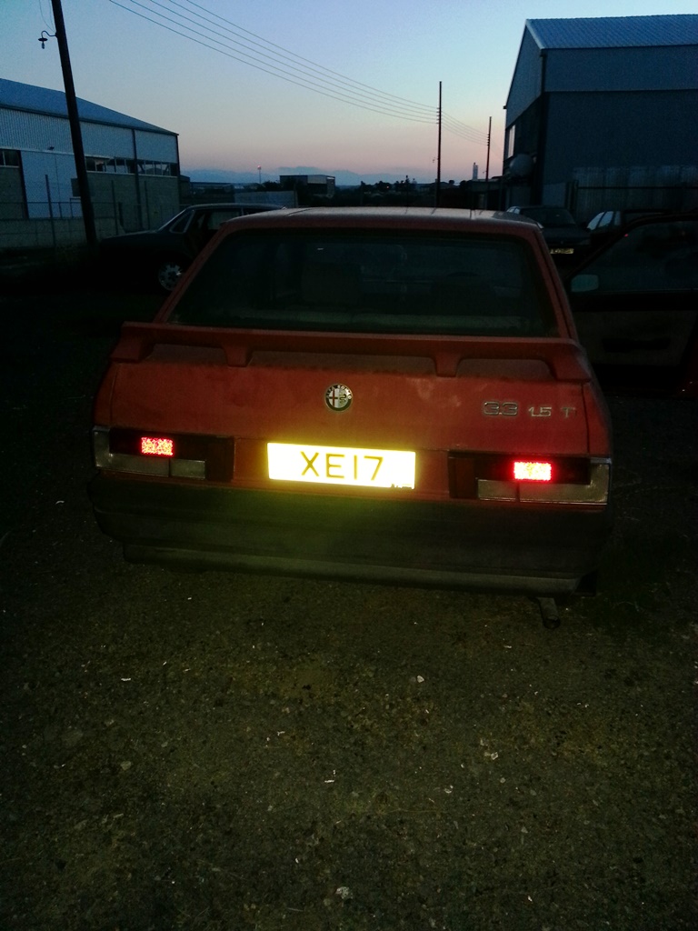

Then, I got excited and I stepped outside to work on my 75TS which had no dashboard or wiring.
However, I've got no pictures of that, so I'll just post pictures of my Sprint's work and some bacon instead of the 75 ...

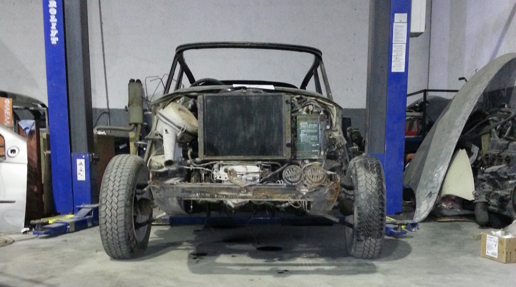

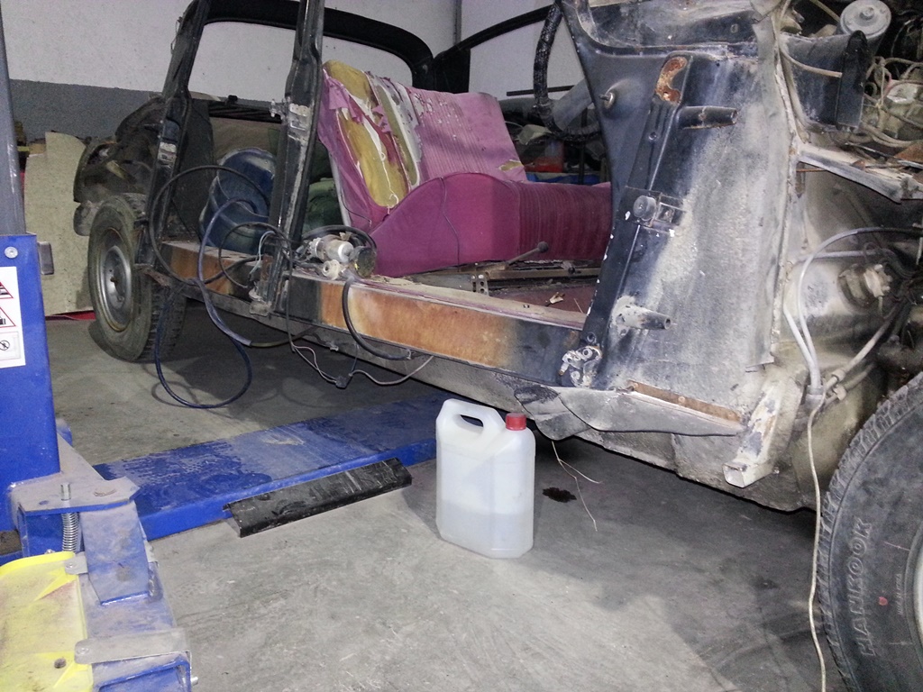

And yesterday I was working on a citroen ds21
Managed to start the engine last month, and last night I managed to get the suspension lifting and lowering as it should
Woah it's being held up by a plastic bottle. :lol:

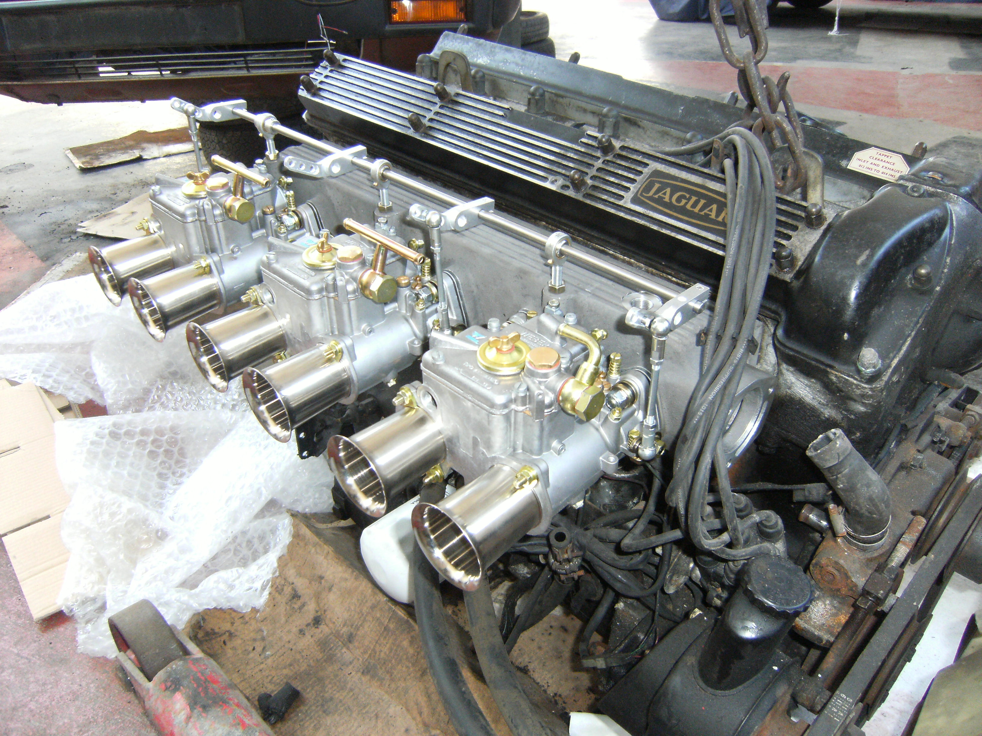

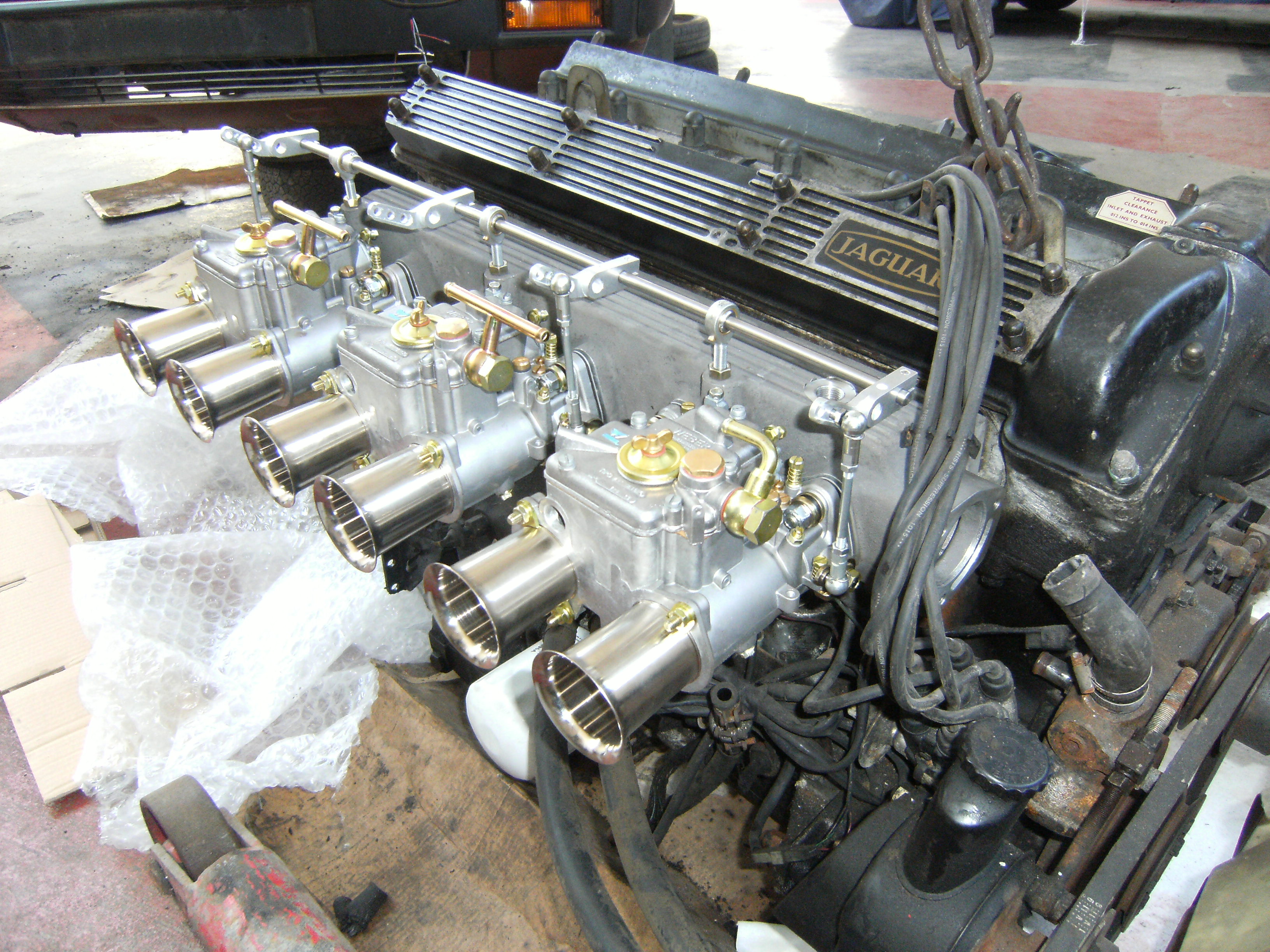

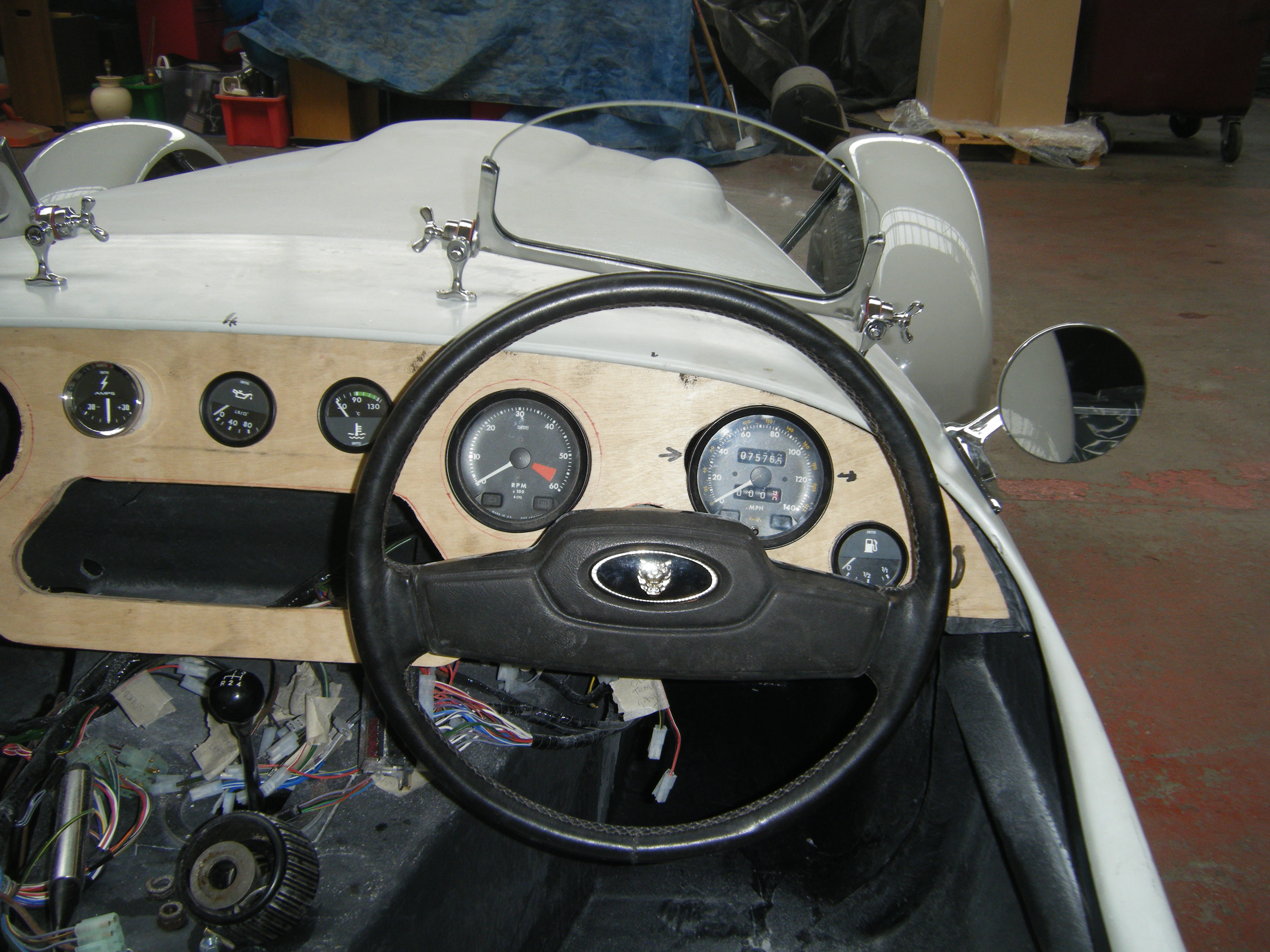

Yesterday I was buying parts for and working on this........
AlfaCorseChris
Posts: 634
Location: Cyprus
Post by AlfaCorseChris »
what is this ?
jag based kit car? 3.8? 4.2? 6 pot anyway, old smiths gauges, XJ6 base?
Ronart W152?
Not seen one of those for a while.
Lauren and Kev are correct - Ronart with an XJ6 3.4 Jaguar running gear - and yes triple Webers with ram pipes - Do I have a thing about these??

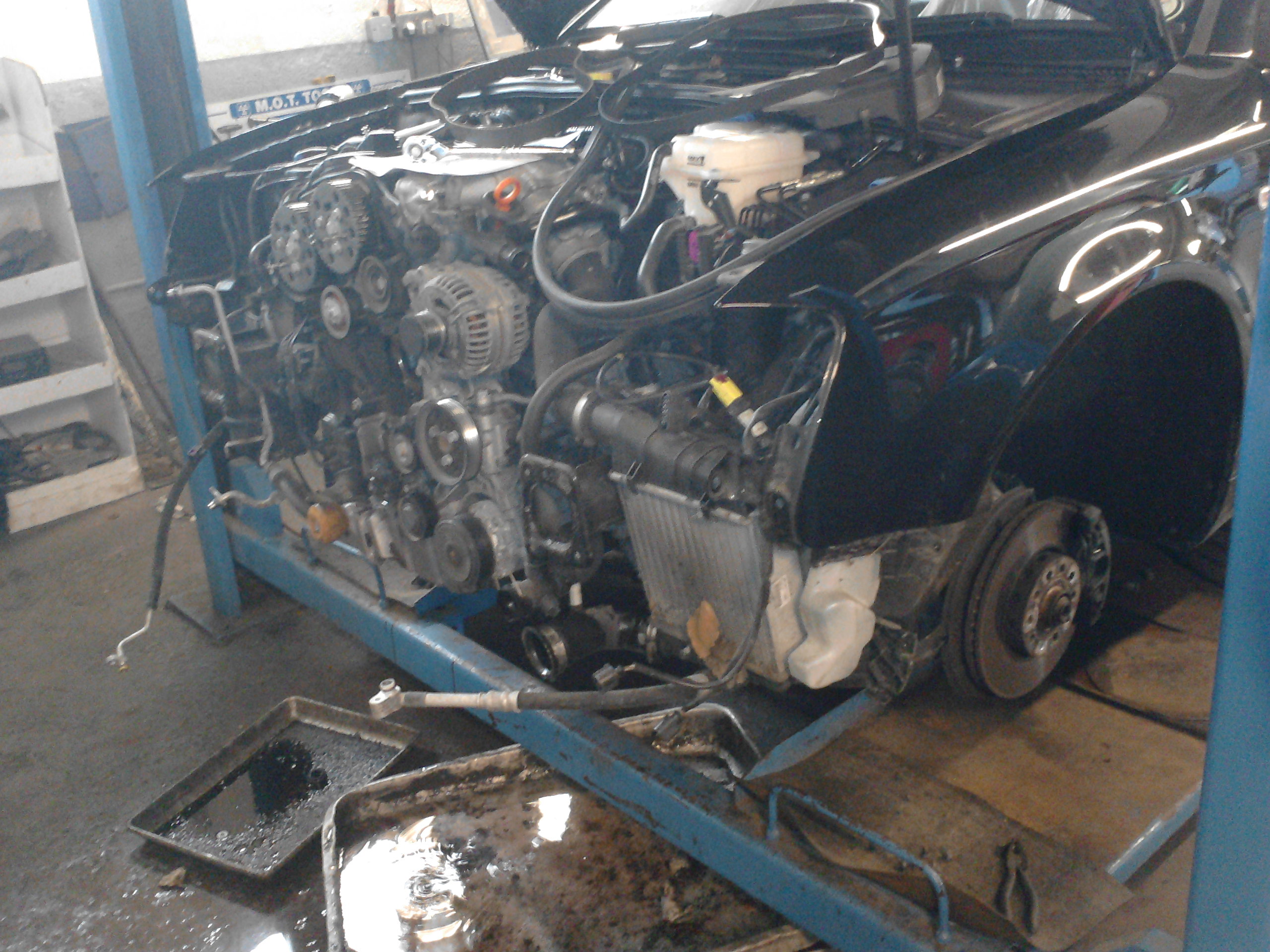

not strictly yesterday, as it was tuesday, but i was doing this.
can anyone tell me the car, and what the front end was taken off to do....
AlfaCorseChris
Posts: 634
Location: Cyprus
hmmm....
well as far as I can tell, you removed the front end so you could do the belts, but what car.....
... it actually looks .... GERMAN :o
Joe1968
Posts: 289
Joined: Mon Jan 27, 2014 9:37 pm
Location: South Yorkshire
Post by Joe1968 »
VW Corrado ?
Change lightbulbs ? :lol:
yes chris, whole front end off to do the cambelt.
that's bumper skin, headlamps, A/C rad, water rad, powers steering cooler, front panel etc etc
just to do the ruddy cambelt :x
also right on it being from the "best" car makers, german.
an audi A4 2.0 tdi
at least once everything was off access wasn't an issue :D
good guess on the head light bulbs jo, some cars are not far off as silly! :D

That pic of the A4 has confirmed that I will never again consider buying an A4 2.0 diesel. That's bonkers.

think it was a 2008 from memory
Bonkers. You can see why servicing costs are so astronomical. Another good reason not to buy a modern car!

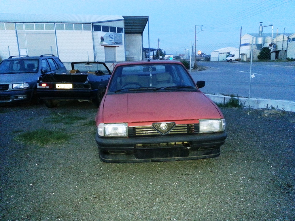

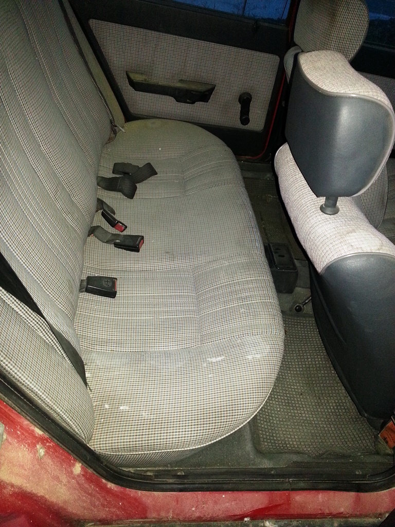

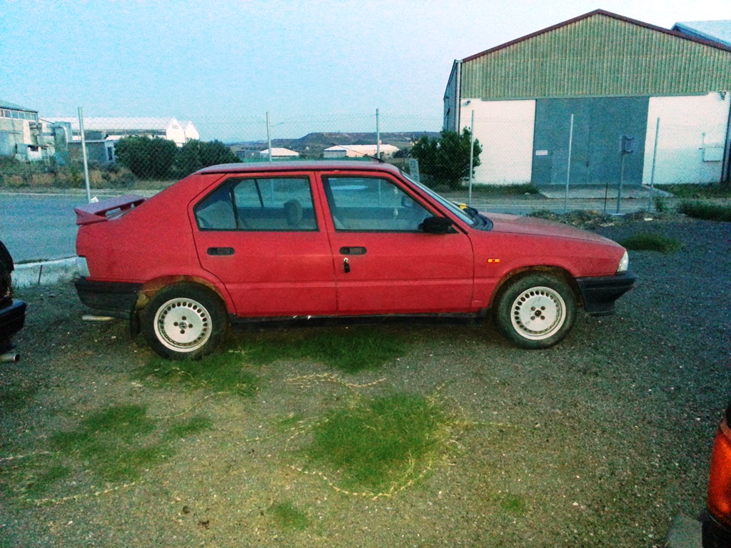

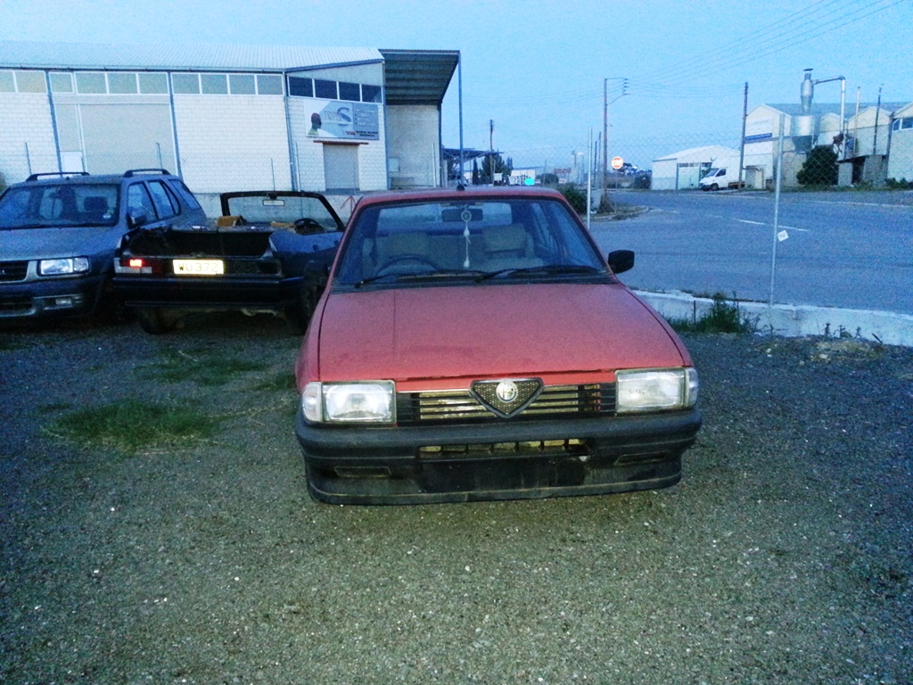

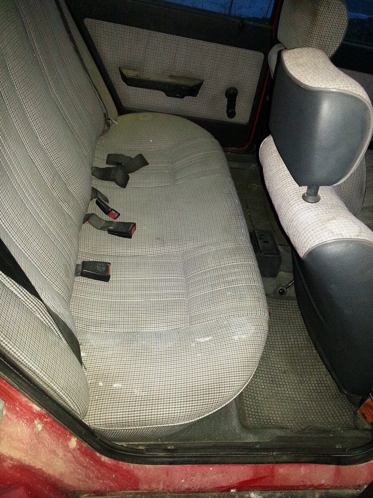

Well, yesterday I started working on the S2 33 I got last week...
First thing's first, I swapped the ugly metal wheels with the alloy ones of the convertible one and blew some air into the tyres.
Overall condition of the car seems to be in good shape, but the rear wheels are pointing at the wrong direction :/
I hope its just the rear hubs or even the complete rear axle for that matter, instead of being something bent on the chassis underneath...
Next step will be to replace the fuel tank and some fuel hoses, put some petrol in it, and see if I can save this engine.
Been told by previous owner that this engine has no compression, but still.... I got to see for myself :)

Bit late now but you don't have to remove front panel and rads you get two long m8 bolts and put them in were the bumper bar bolts and slide it all forward same for Vw passats and most audis I've done to many to remember

did see that but couldn't see why you'd want to leave the front panel there after taking everything off and still struggling with access.
for a little more effort the belt change was a doddle, time saved that way.
Simonsud
Posts: 331
Post by Simonsud »
Agree to some degree but it can take just as long to get air out of cooling system and regas air con than doing whole job
Simonsud wrote:Agree to some degree but it can take just as long to get air out of cooling system and regas air con than doing whole job
fair point, was doing water pump too so draining/filling the cooling system was gonna happen anyway.
stil a pita job though :D

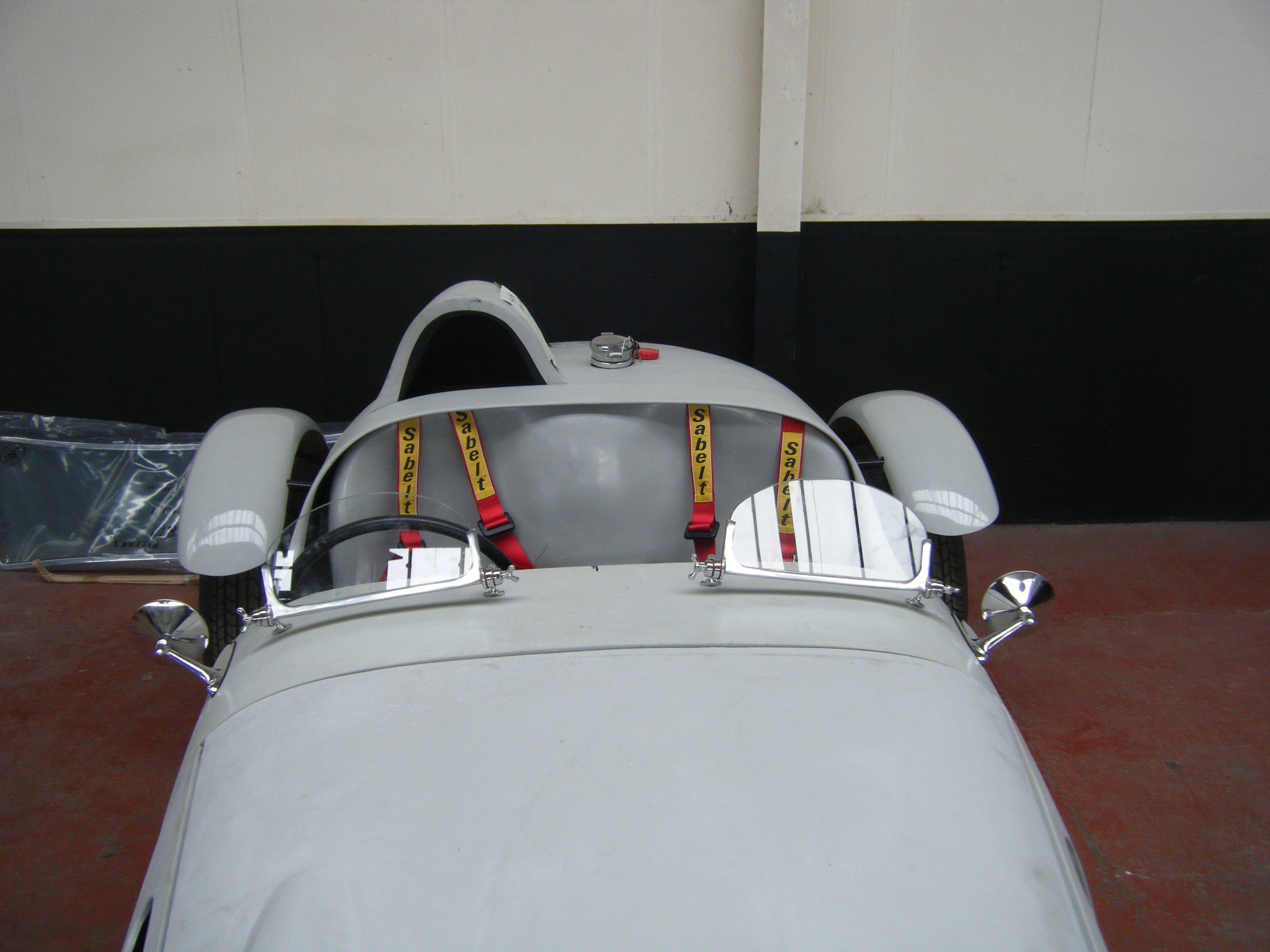

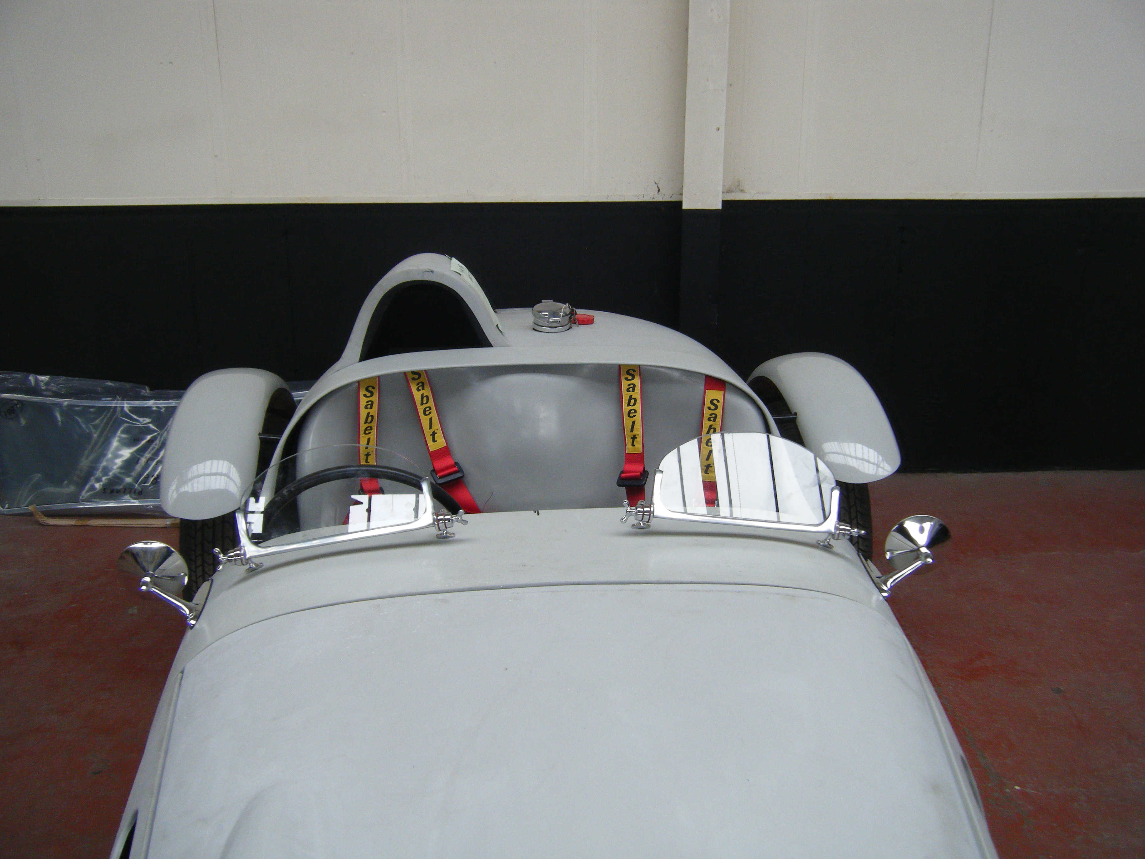

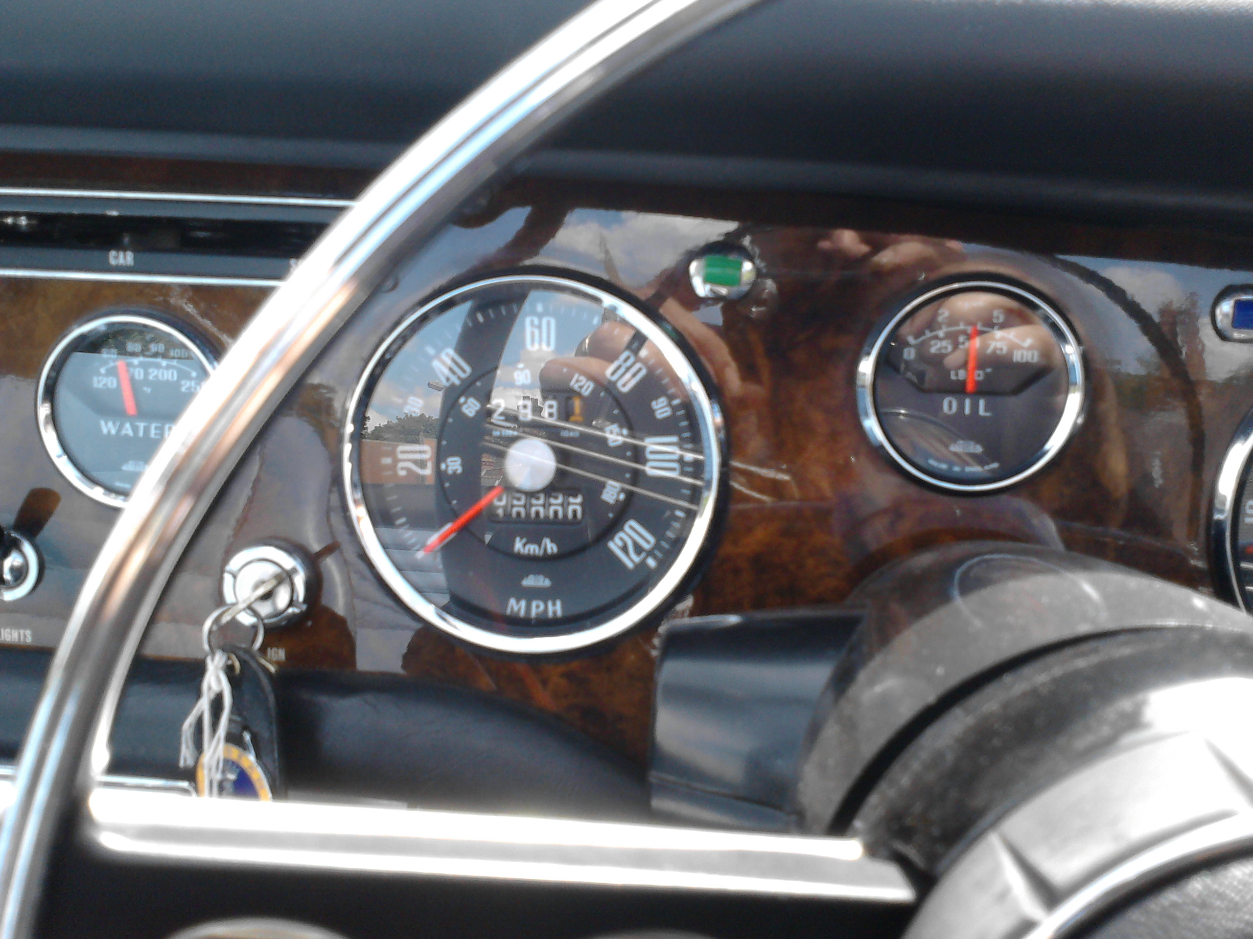

Yesterday I got the Ronart back from the spray shop.

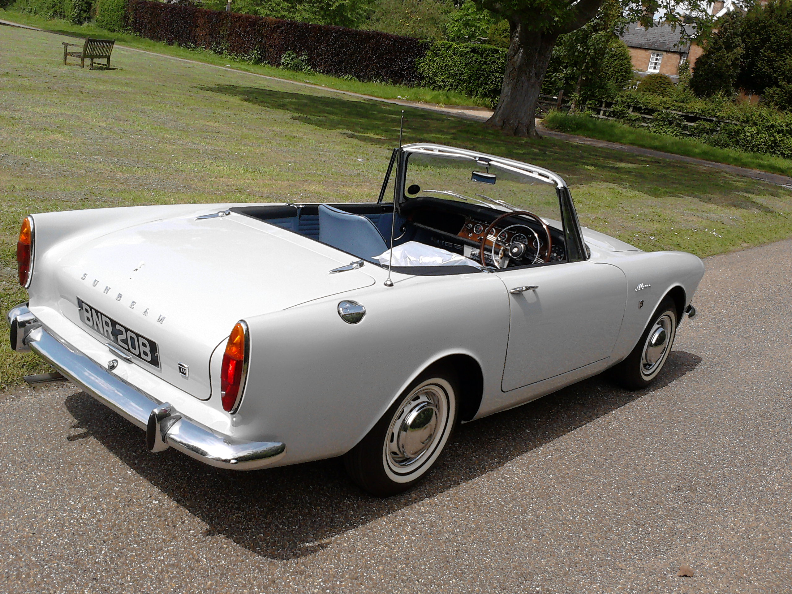

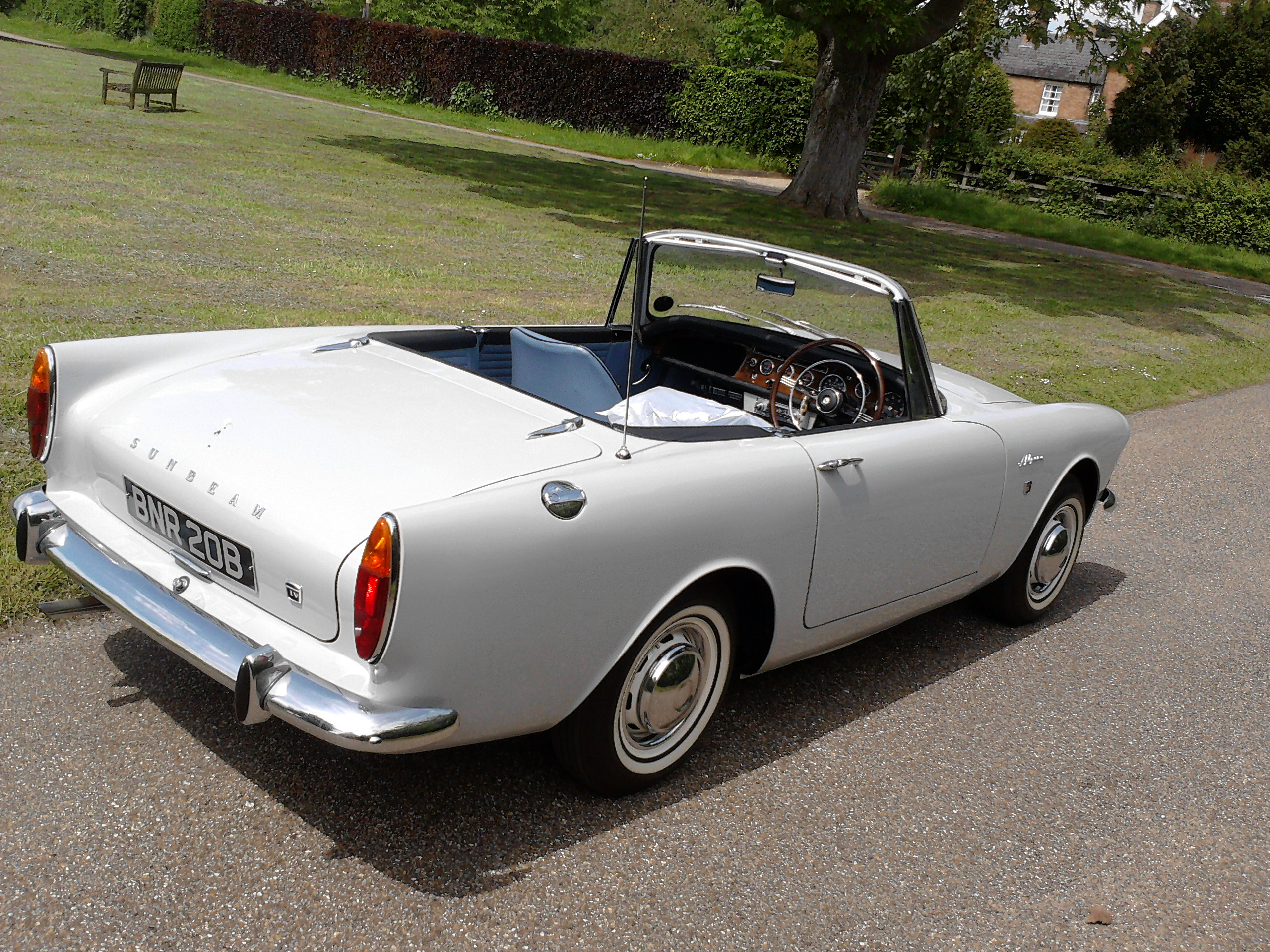

not as nice as yours phil, but not a bad one for me to mot yesterday 8-)
lovely condition
a 1964 model, very low mileage. just turned a milestone with me at the wheel :D
