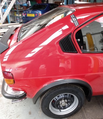

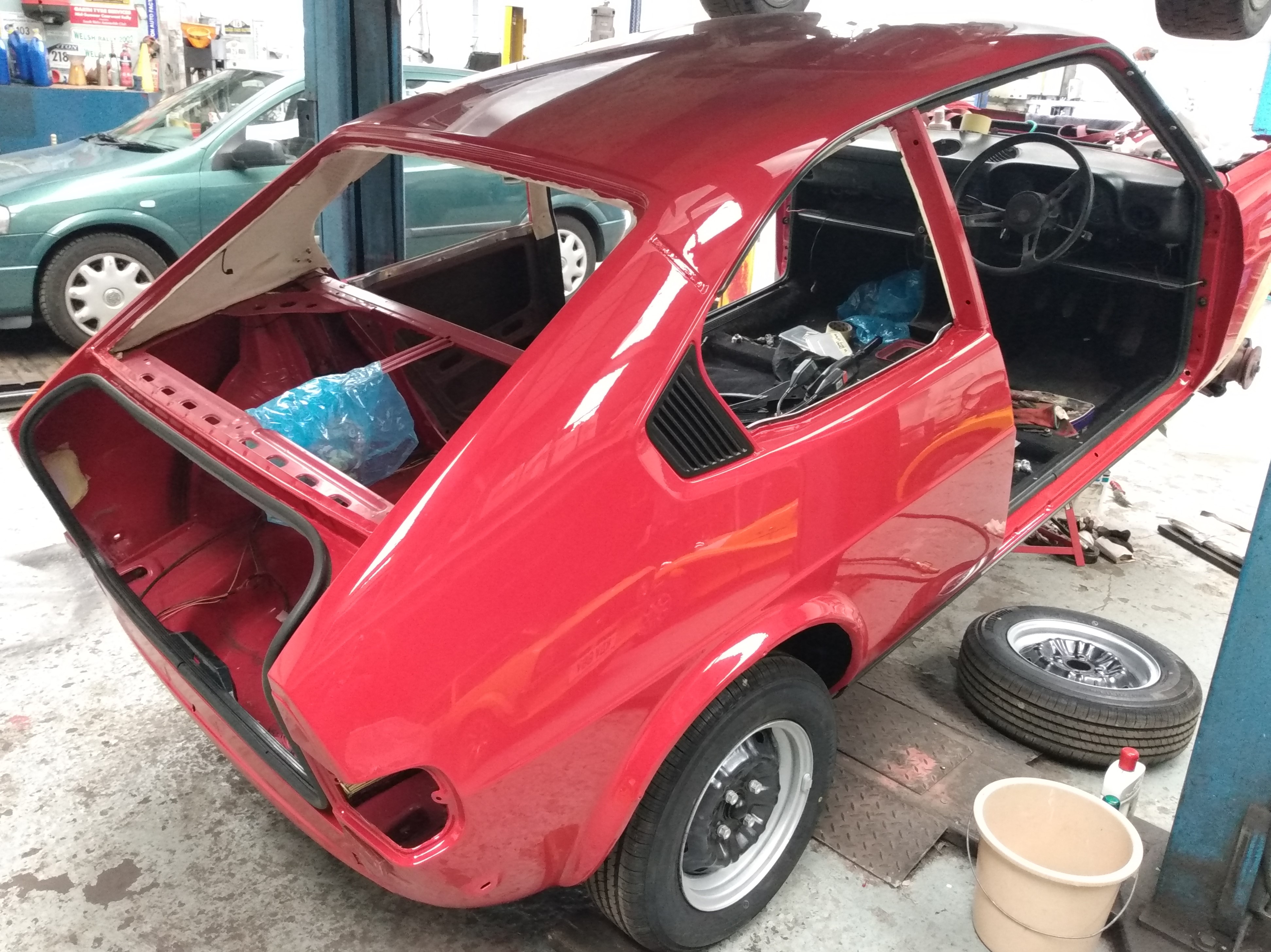

The paintwork is superb and very well prepared so should last exceedingly well. The aim is for it to be original and perfect and I think they will succeed.

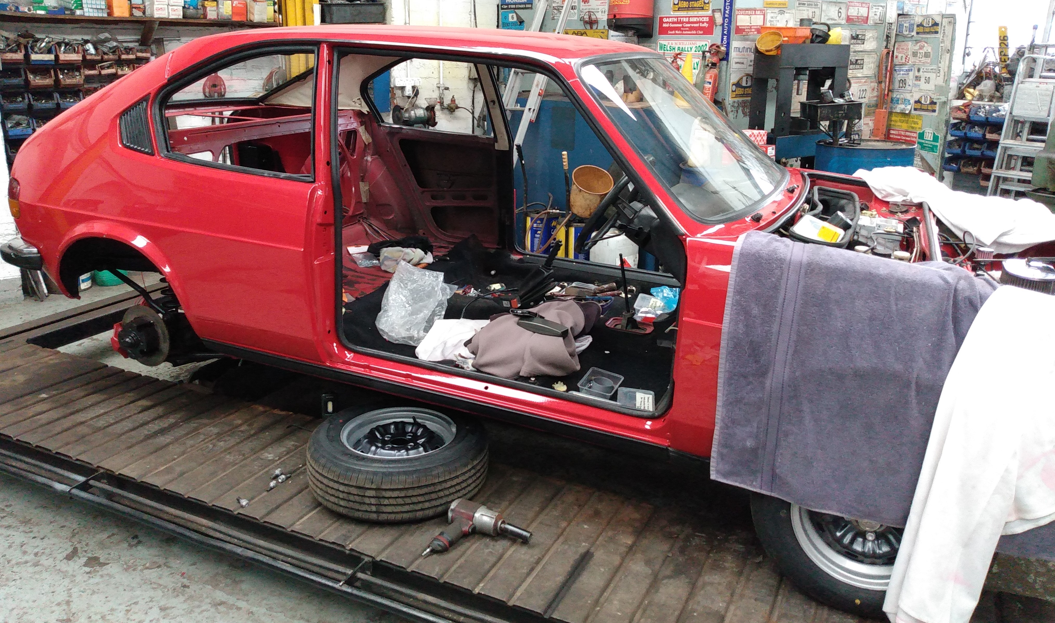

Another one coming back from dormancy

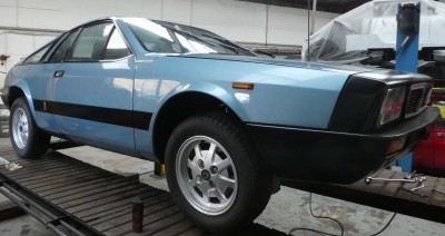

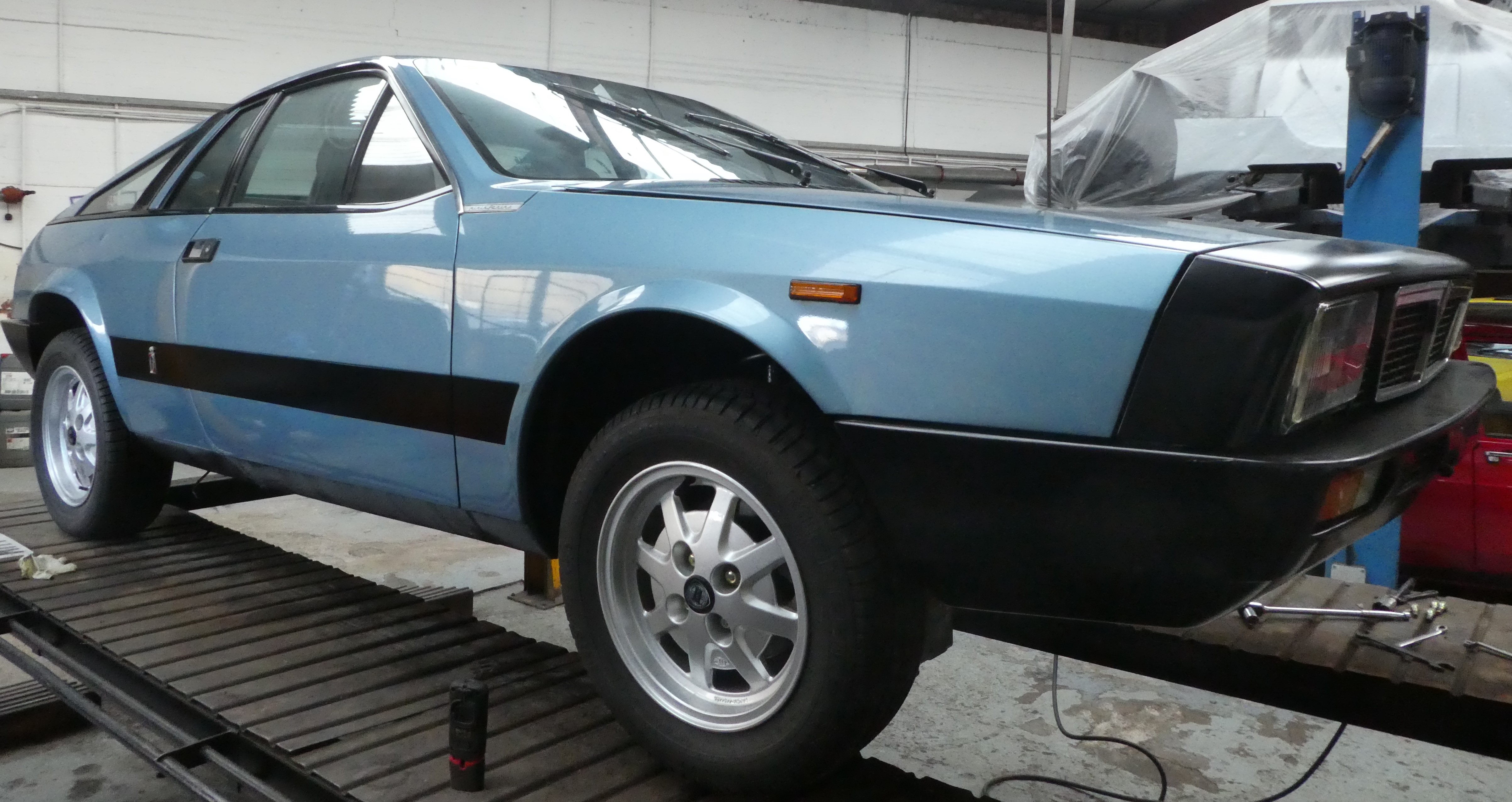

This is the car I have been assisting with by making comments and drinking tea.

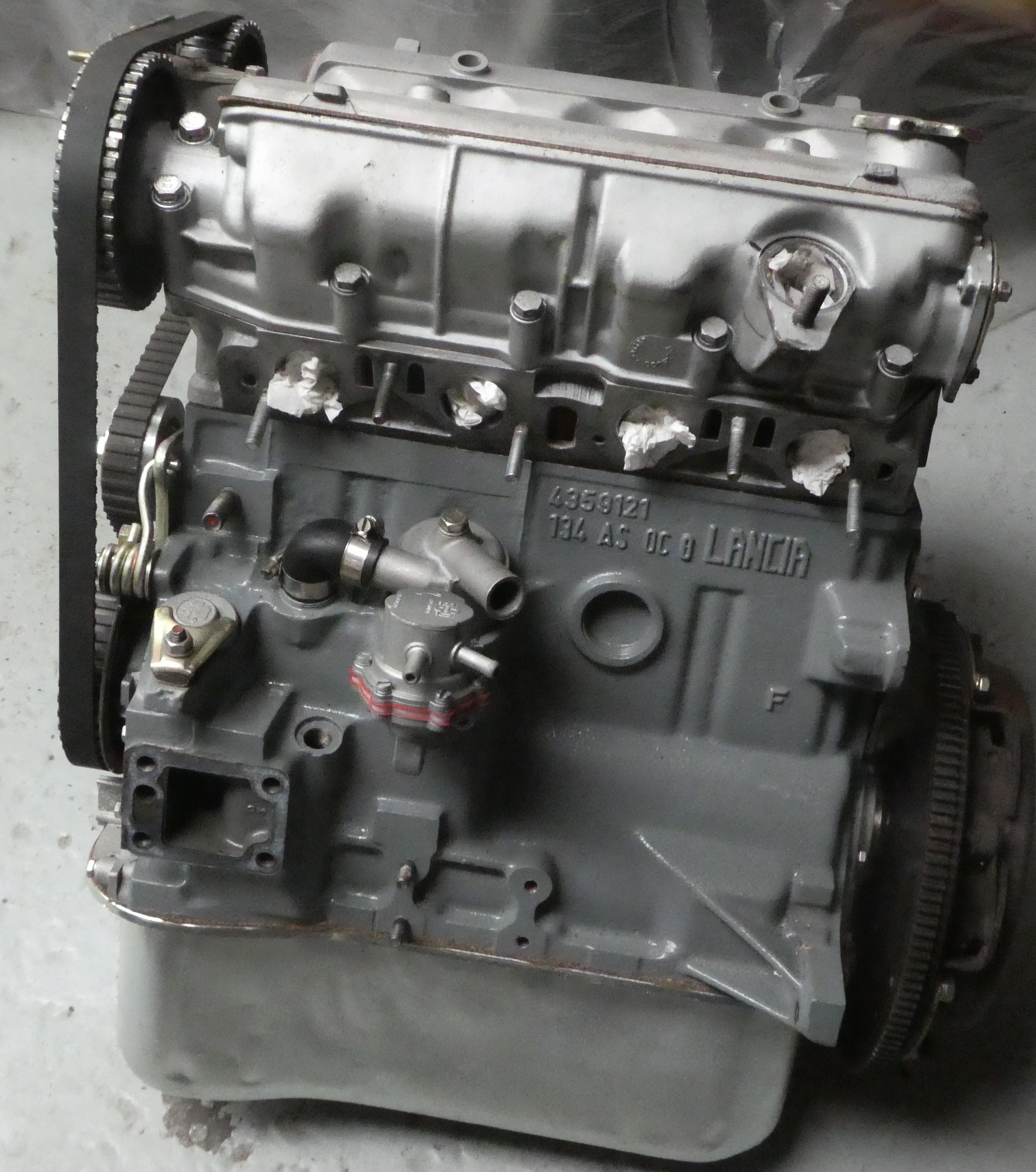

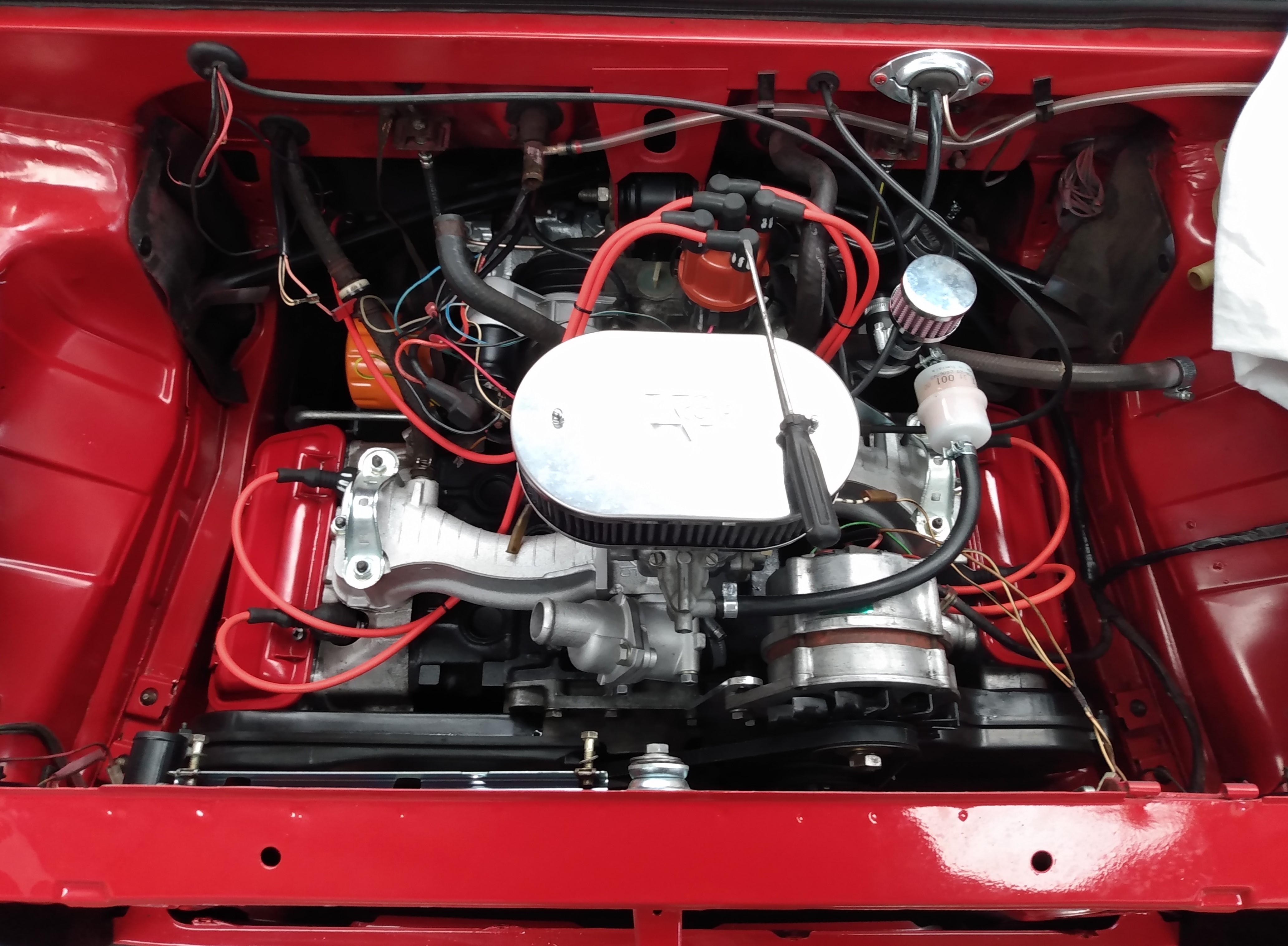

Engine in now.

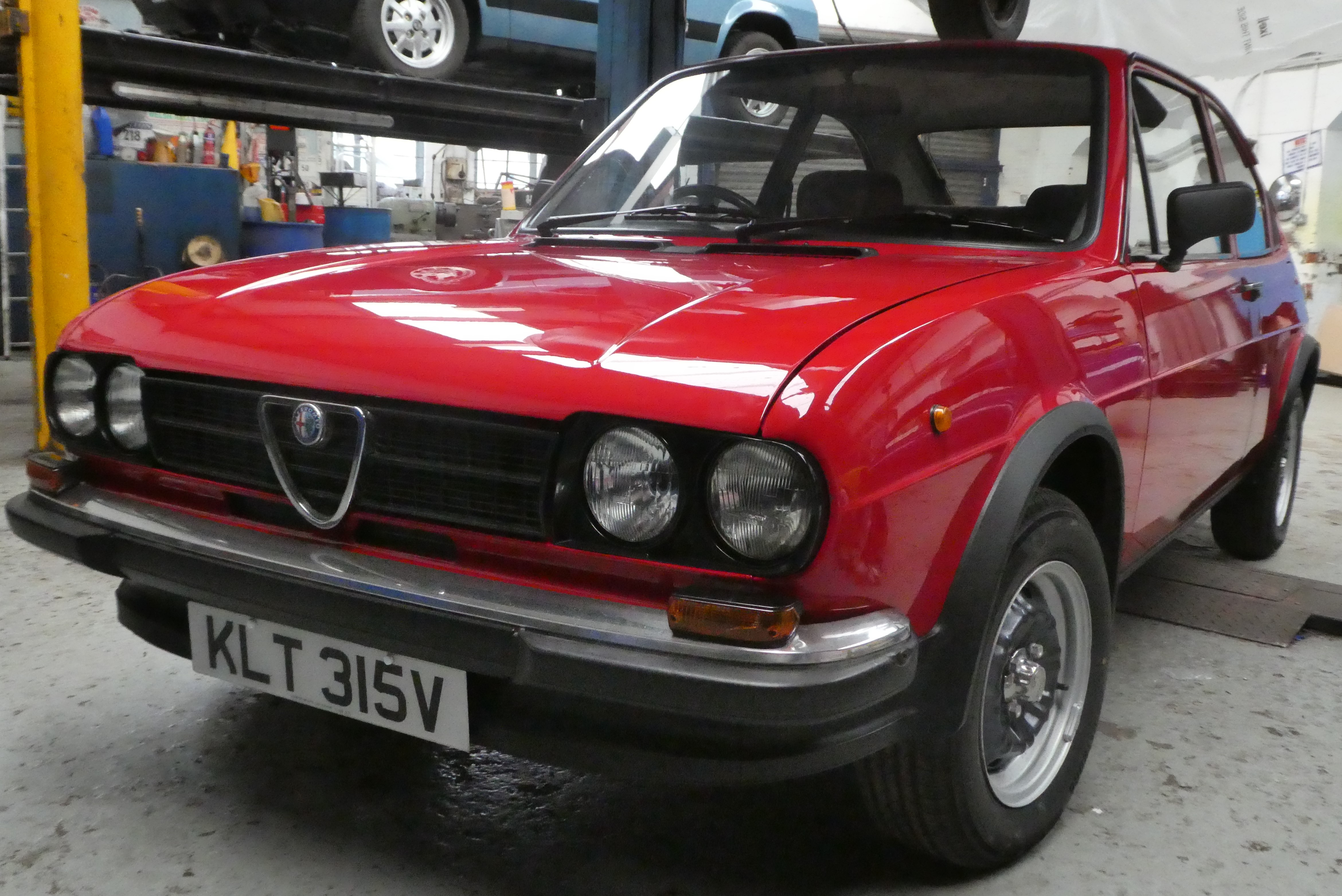

Looks nice
Rare as well being a S2 Ti
Re: Another one coming back from dormancy
Looks immaculate!
I'd be scared to own and drive it!

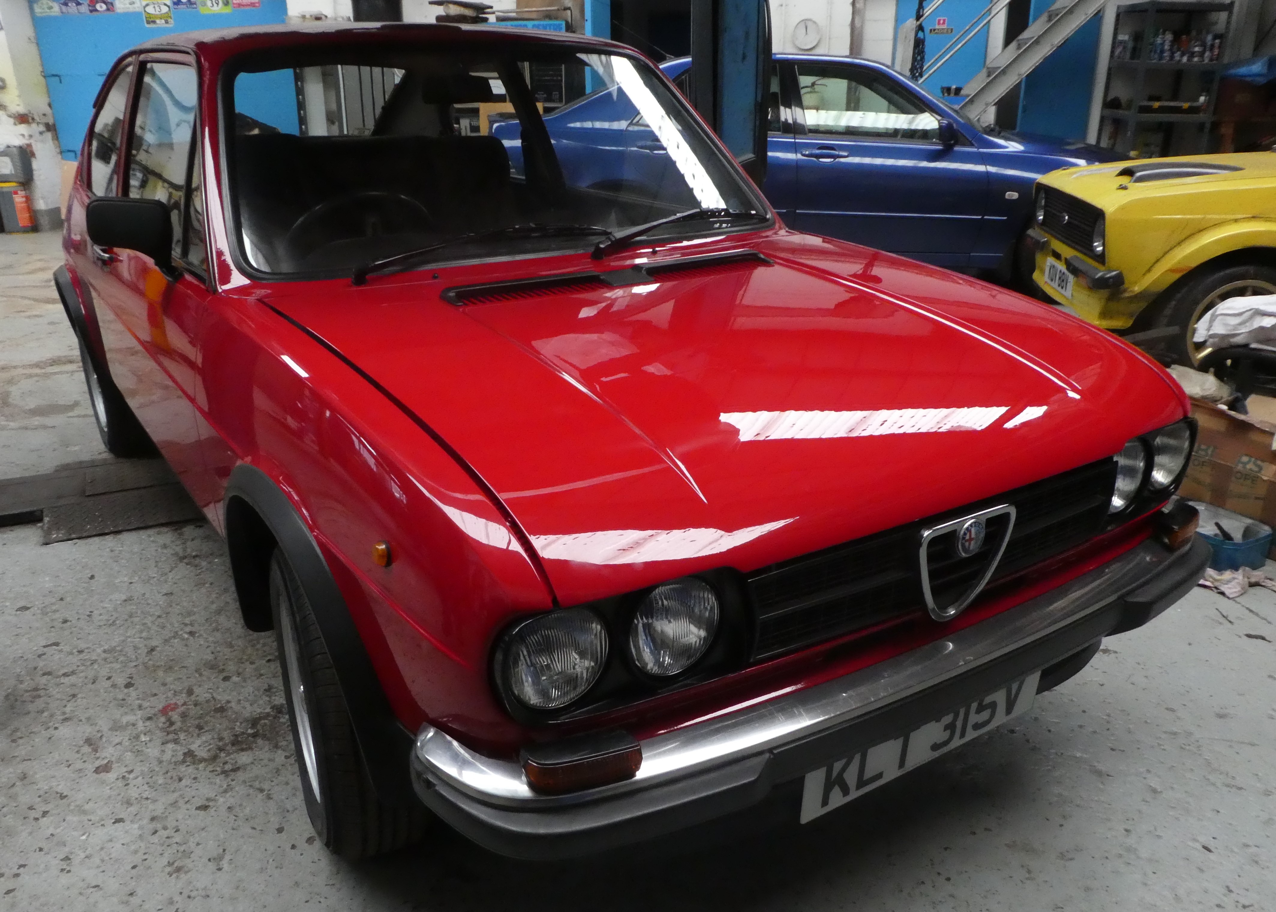

Yes it looks very good and is being very carefully put together.

Coming on well.  The radio gave up, but I am so impressed with how well they are doing I gave them one as it just seemed like a good home for it.
Will post better pictures when the headlights arrive and its finished. So with brexit that will be about 2025

And its done......They have made a superb job of it.
Good tip, thank you and just bought a couple of oil filters.
No oil pressure from the engine as we spin it on the floor so a bit worried.
Oil pump off and no oil in the pump at all. It rattled !  Why would you do that on a rebuild ?
Filled it up and its working . Phew. Just hope the mains and shells are fine.
