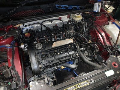

I finally got the spider back together and running. Initially it started fine but was running a bit rough tbh but after a few moments it settled down to a normal idle and sounded ok. With no lights on the dash or any other odd signs. The lifters Weren’t Totally silent (but it has stood for 3-4 yrs) I’m hoping that after a good road test They should settle down.
Then the weird started ! I was just tidying my tools up and letting the car warm through. When after about 10 mins it just shut off no noises or any bad sounds just as if I’d turned it off with the key. Tried to restart and it turns but No vroom vroom . Pretty sure all my earths are ok but I will check them. So not quite there yet . (Yes the code light goes out) I’m thinking it’s a duff sensor probably the TDC sensor or fuel pull relay but anyone got any other Suggestions.

so after the engine cutting out issue last week I left the car all weekend (it’s been too bl***y cold) I went in the garage this morning and tried it. The car started straight up with no problem. But then again just as it started to warm up. Bam it stopped. This was a good thing as it meant the problem seamed to be repeatable at a set temp.
So I disconnected the fuel pipe from the rail and popped in in a tub turned the ignition on and fuel pumped for the usual 2-3 secs. But then I cranked it and NO fuel. This lead me to conclude the issue was the TDC sensor as the ecu needs to see engine rotation to trip the pump relay again.
So As I had another TDC sensor i quickly swapped it over and hey presto car started straight away.
(As the spare is a S/H one i might treat it to a new one to try to avoid a problem in the future)
I’ve since run the car up to temp 3 times till the fan cuts in and all seems well. Even the odd noisy lifter has shut up. So all in all a good day .
Next stop finish putting the remaining bits back in including all the plastic bits and then get some insurance and tax then a a first road test

Is it worth cleaning up the duff TDC sensor?
Dirt on them can make them malfunction.
Re: My 916 Spider
Posted: Mon Nov 29, 2021 9:40 pm
by LooLooSud33Spider
Dave. The TDC sensor on the TS engine actually fits through a hole in the block and picks up in a phonic wheel on the crank so it doesn’t get rust and crud on it. (Or should I say if you get rust and crud on it you’ve got bigger problems !! ) tbh It’s not uncommon for them to fail And they’re only about £30 so I’ll get one from Alfashop tomorrow
