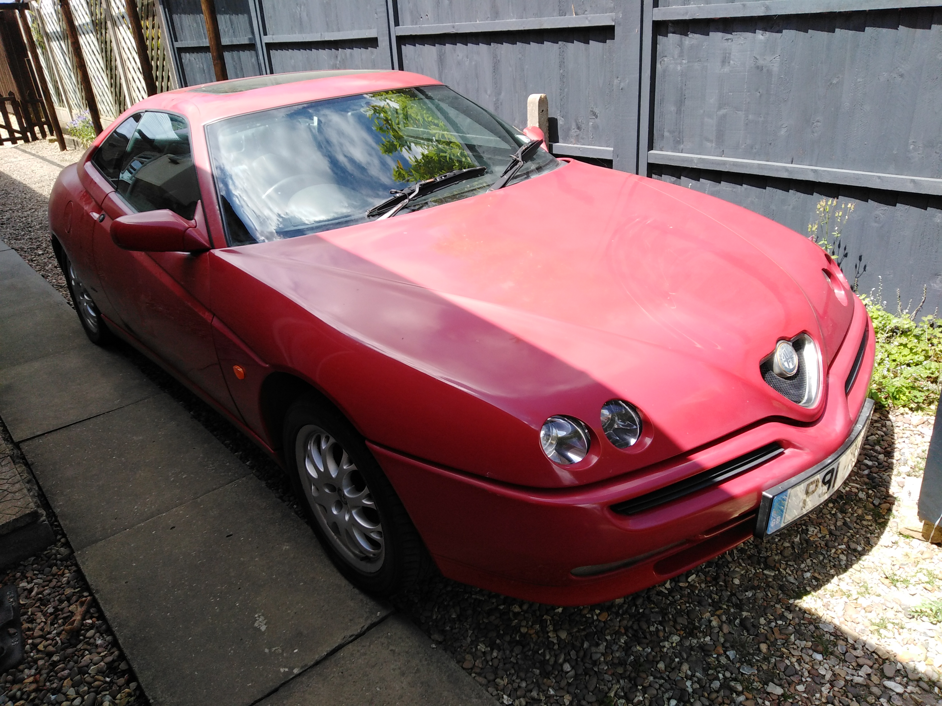

I bought this a week or two ago, needs a bit of TLC so as I have the car at home to tinker with of an evening I figured a little mini project thread is in order.

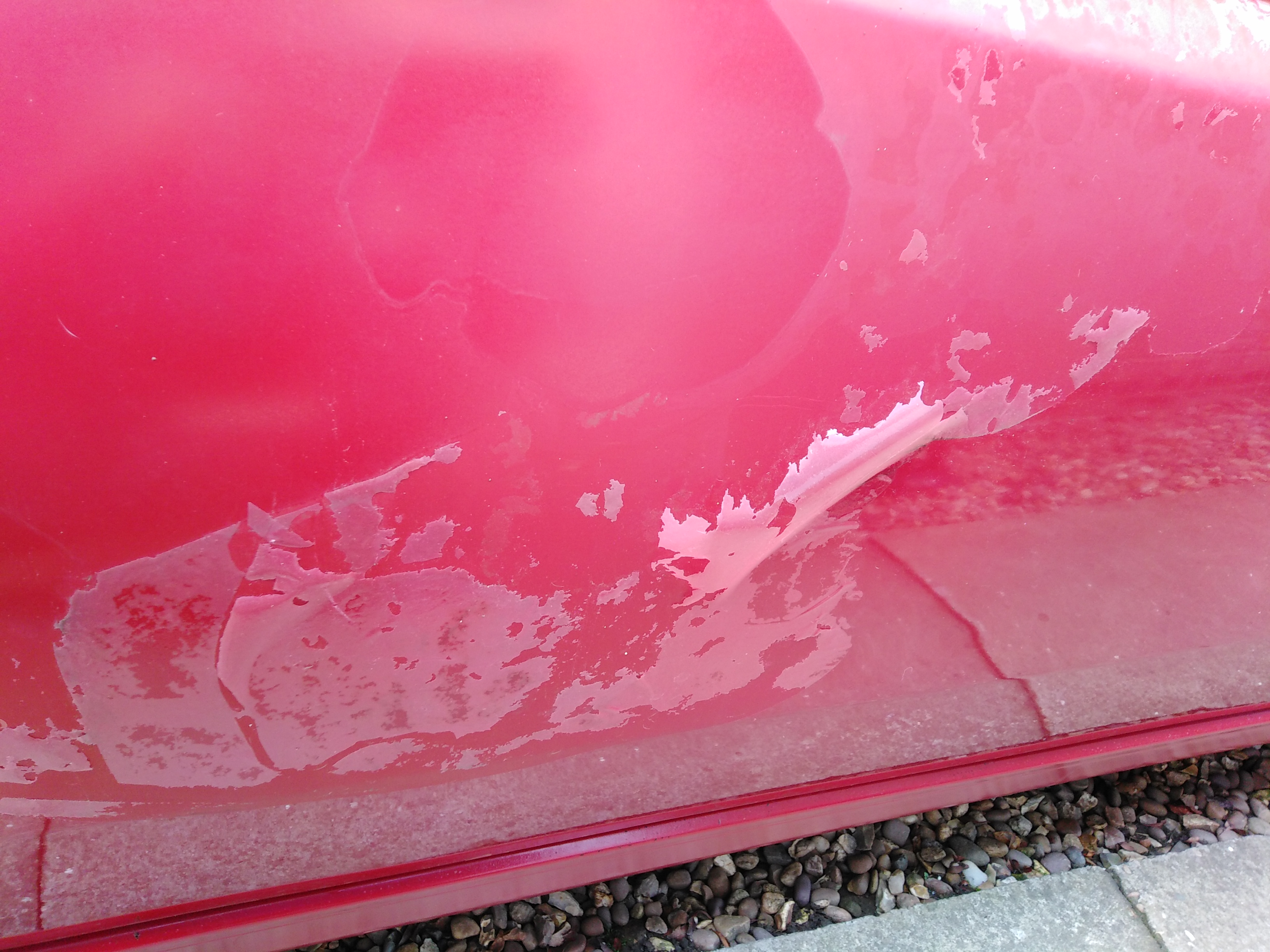

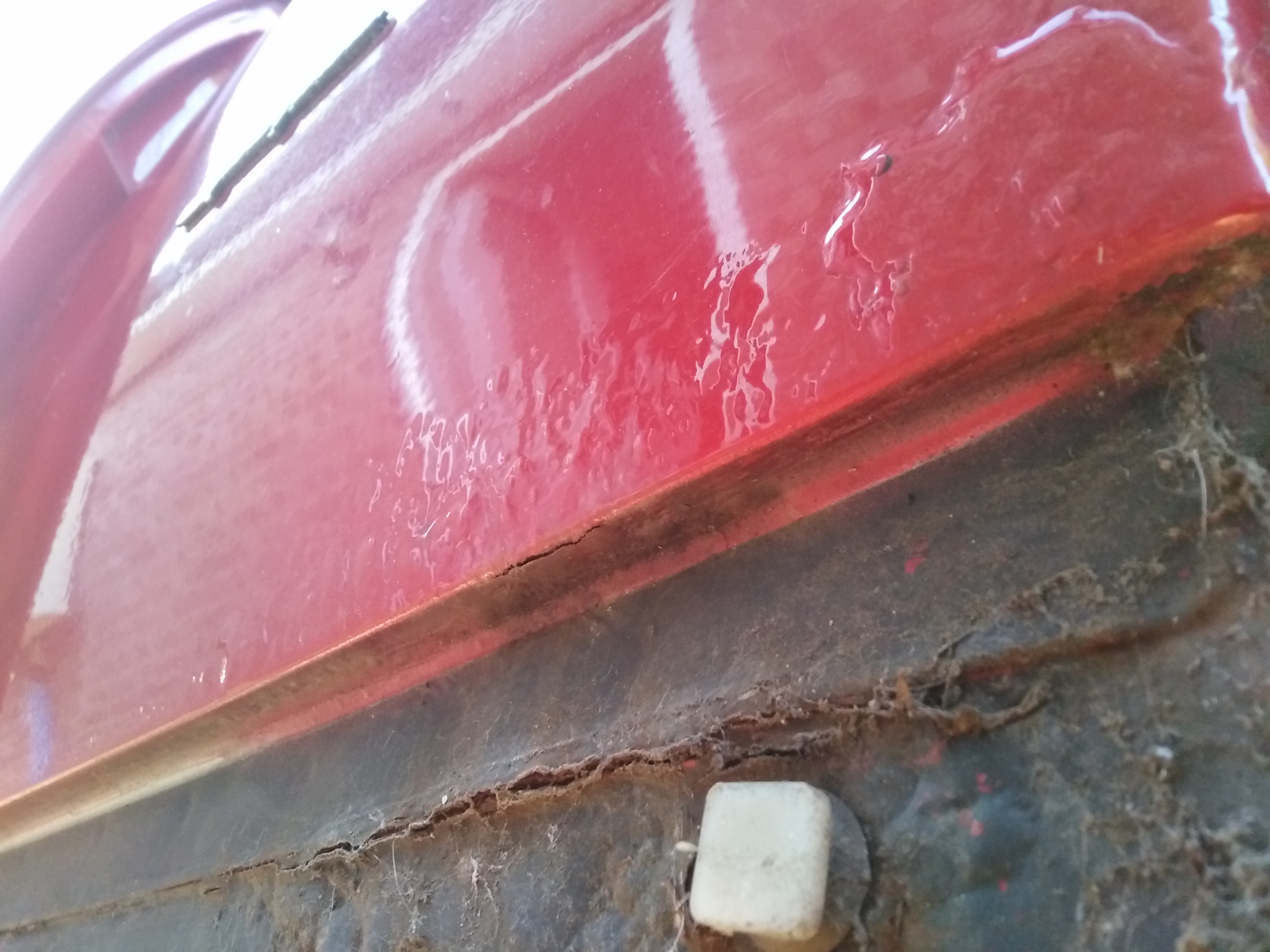

As can be seen, it's a little faded, or more like its' sunburnt and now peeling!

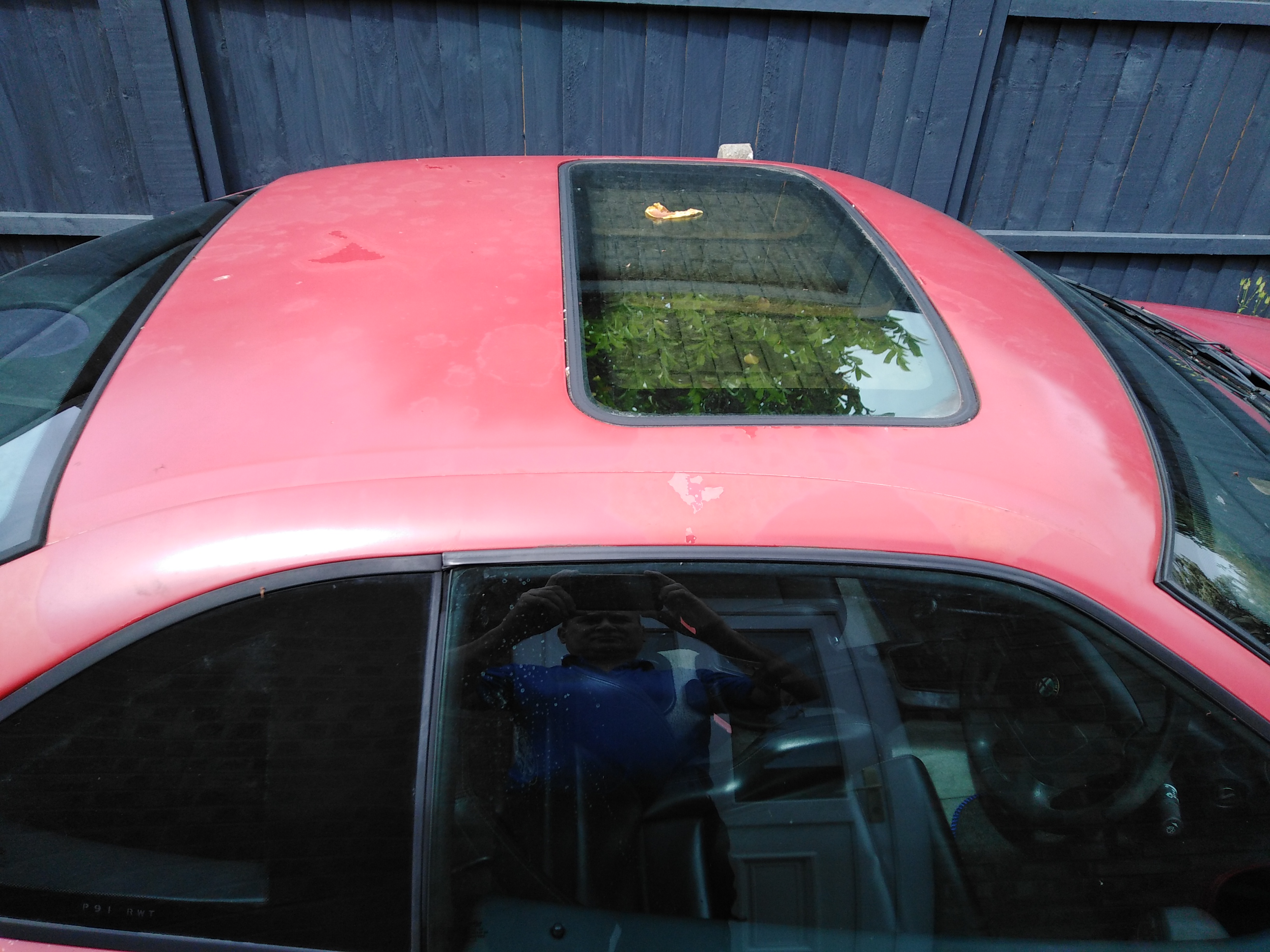

It does have the electric sunroof though as you can see, but that is making some graunching noises when raised and lowered....

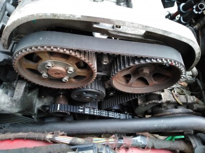

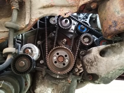

First job as ever is to sort the cambelt. It had actually been done not that many miles ago but near 5 years ago now, it's been stood for the last 3 years or thereabouts I recall.
Got a reasonable deal on a cambelt/balance belt kit, SKF brand so decent quality. Did the water pump too for good measure.
A few bits of old damage to the belt guards to sort, gotta make it right.

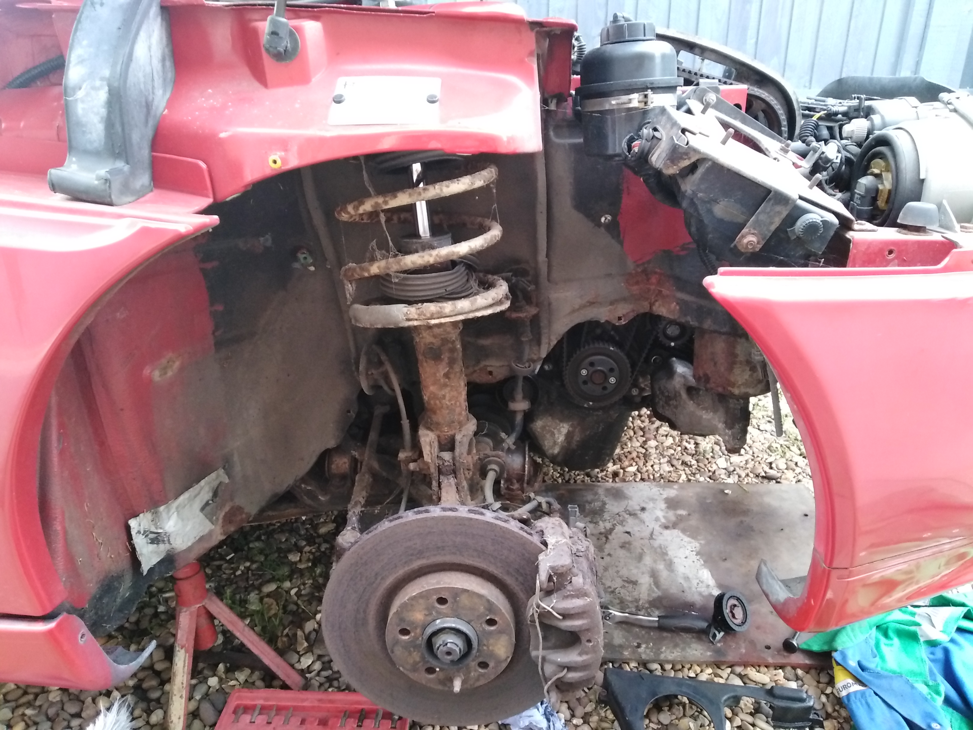

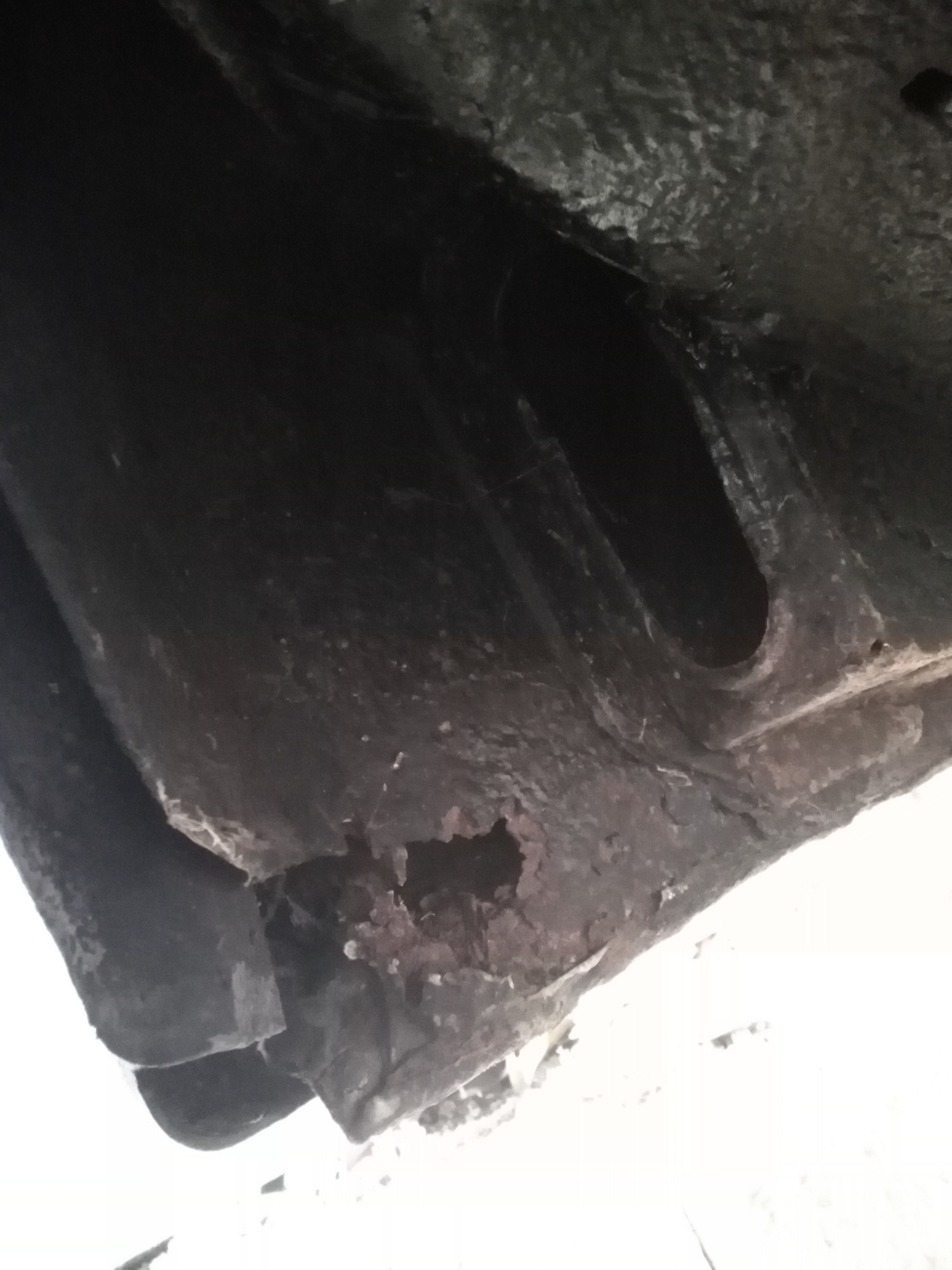

There's plenty to be going at, some rot around the inside of the sills/rear arches.
Plan is to get it ship shape for an mot then use it a bit, brakes all need a going through of course and the exhaust is making a racket but confident a ticket can be got without too much hassle.....

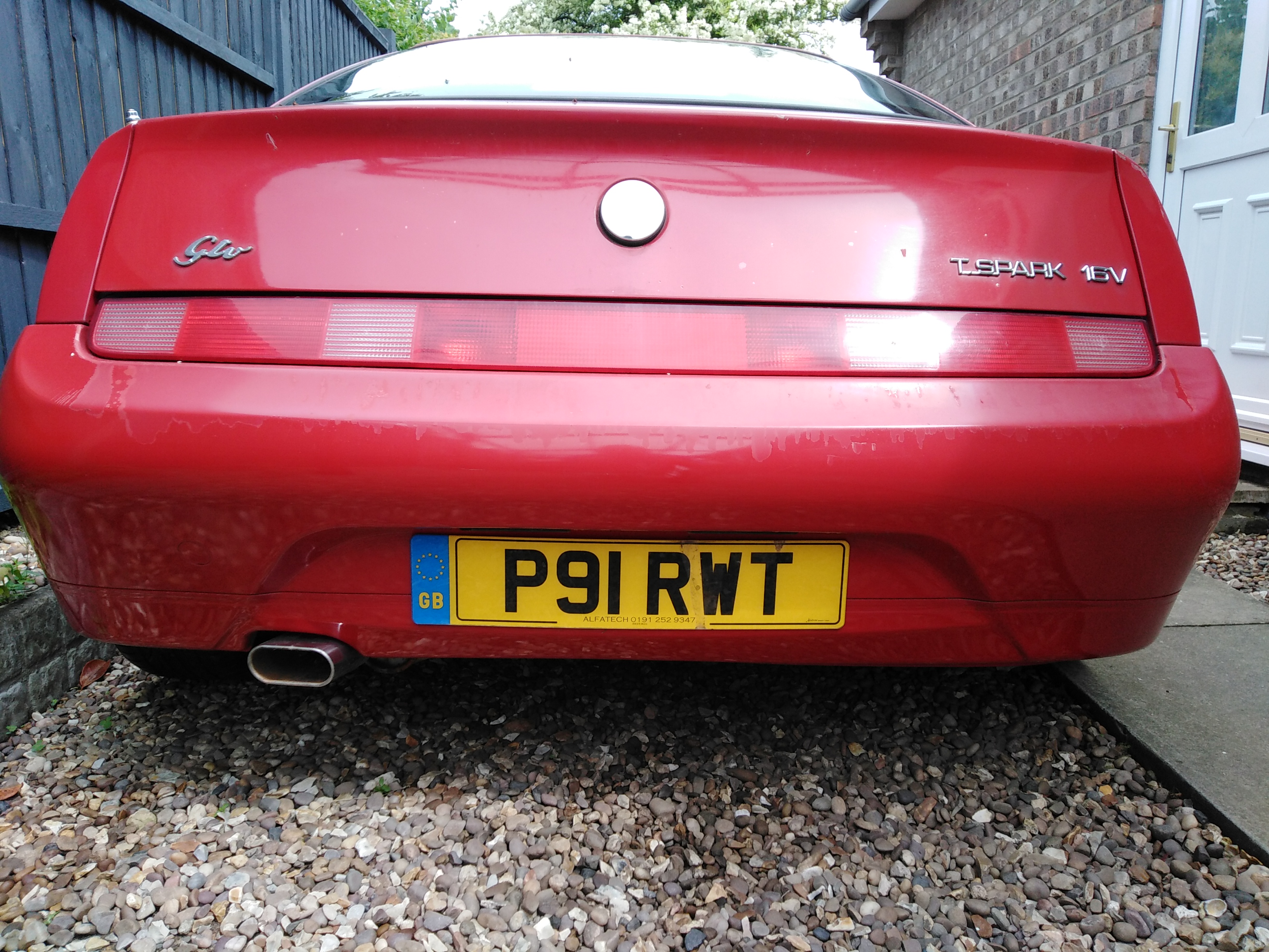

A new middle and rear exhaust was eventually found and ordered, who would have thought that it would be so hard to find one?! Rear box came from Germany! Still cost be over £150 for the pair which hurts...

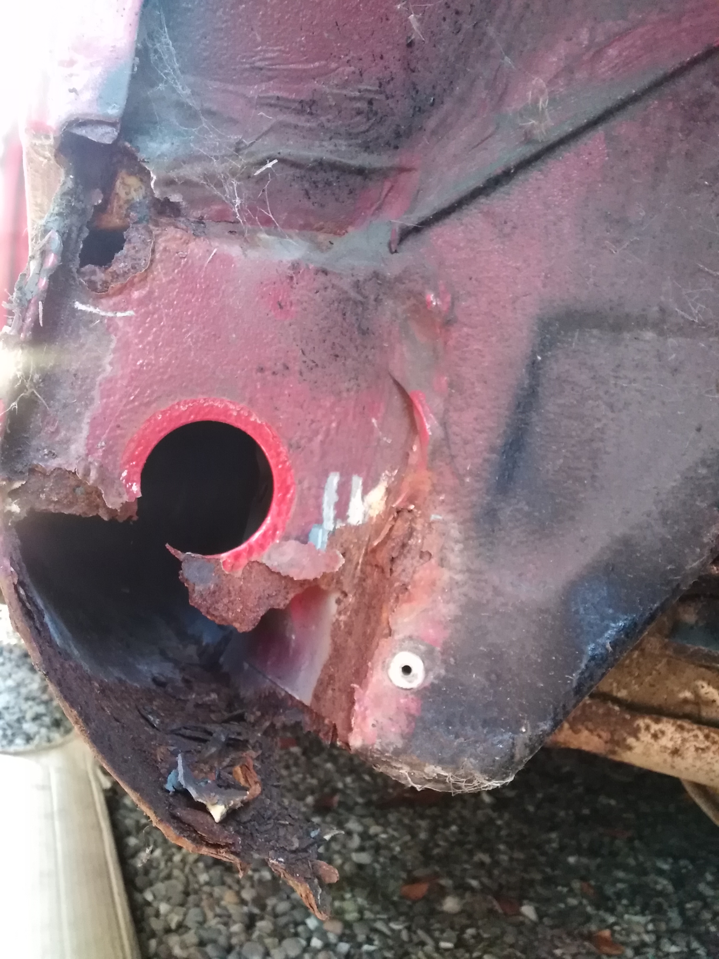

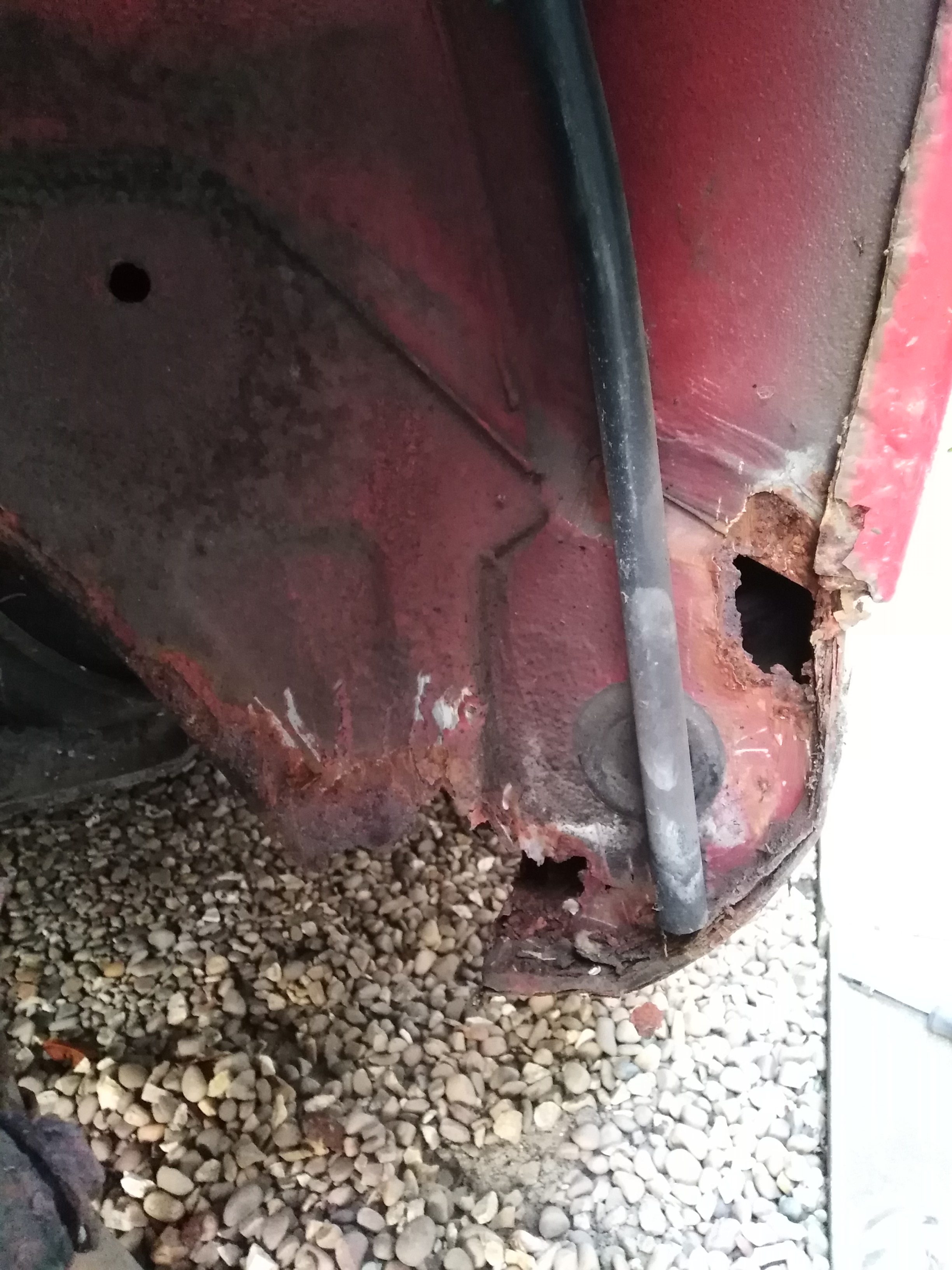

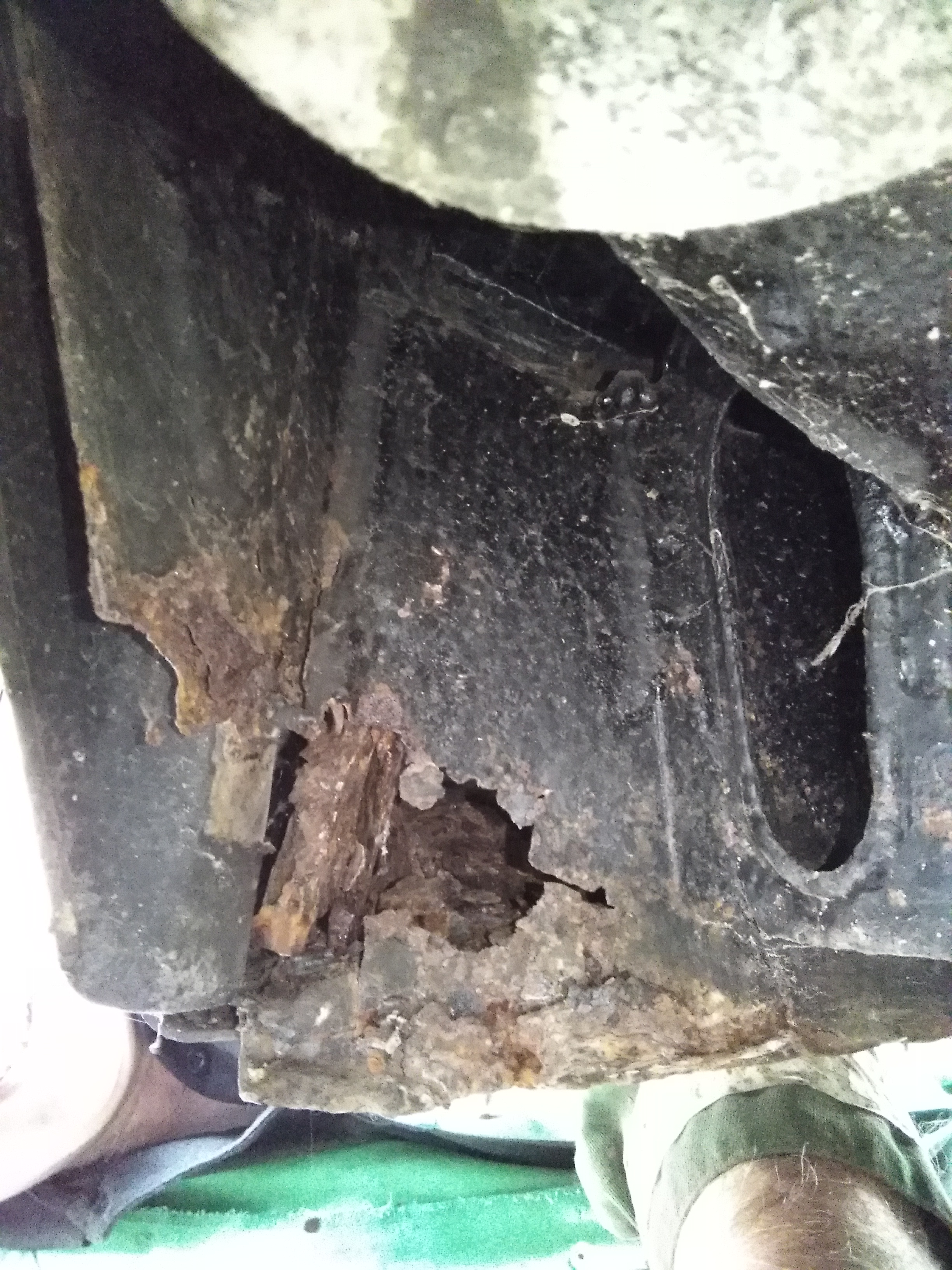

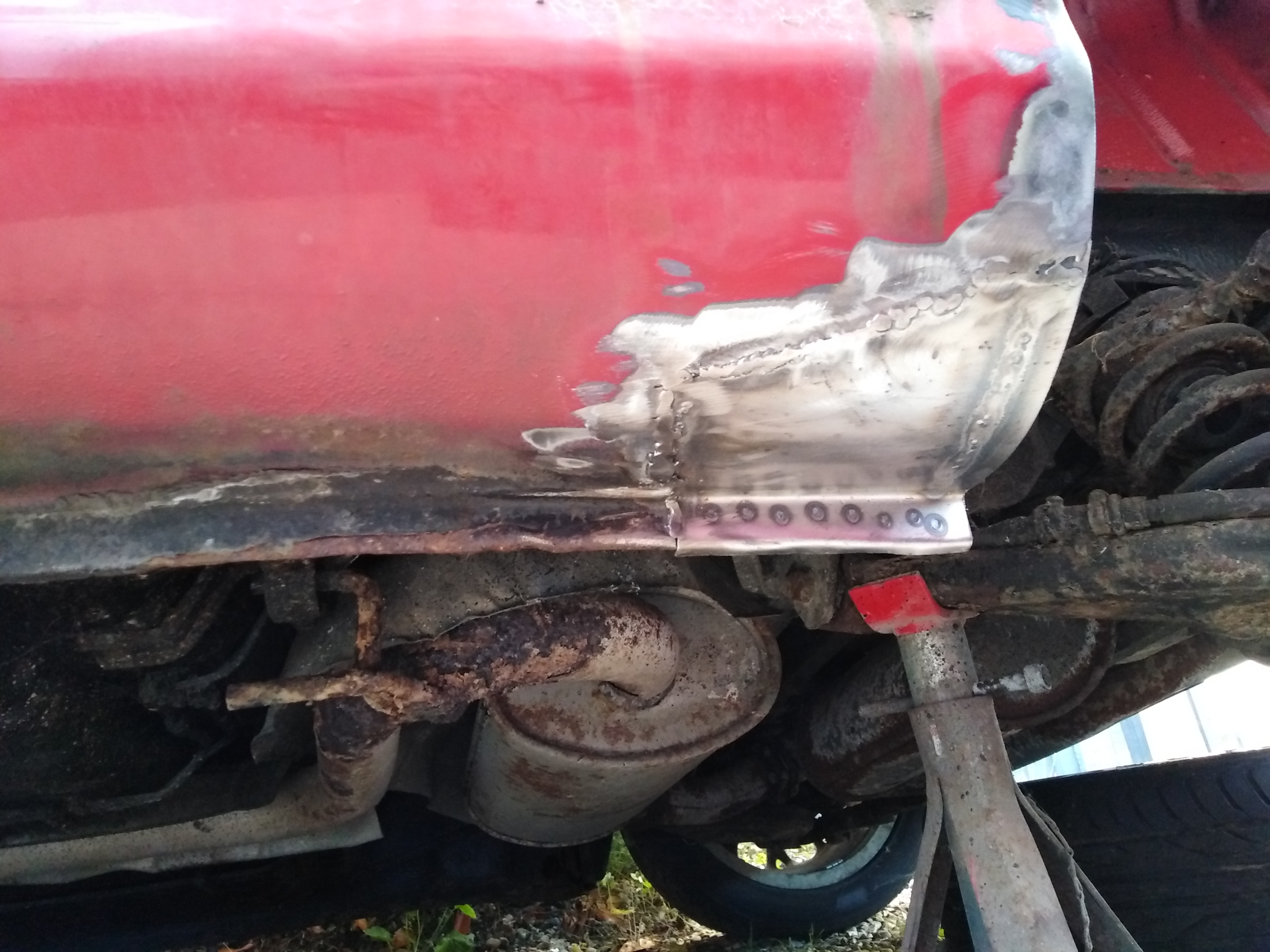

Got the car parked ready for the welding to the ends of the sills where the jacking point is near, knew it would need a bit of fettling but thankfully it's not that bad.
End of the sill will need a bit of chopping out but it's fairly localised.

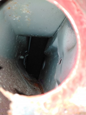

Seems Alfa were still in the habit of inserting stuff in the sill sections that really ought not to be in there... Back in the Sud days we moaned about the foam in there!
The car will eventually need some bodywork attending to but for now I'd be content to get it to an mot pass standard.

I welded the rear end of the sill on my 147 earlier in the year . When I cut the rot out I found a large piece of foam sat in the sill exactly where the rot was .KevJTD wrote: ↑Mon Aug 23, 2021 10:08 pm Not done a great deal to the GTV lately aside from collecting all the parts from Lou and then fitting the brakes to the front in place of the heavily rusted discs on the car, some as new discs and Carbon Lorraine pads will be a nice upgrade. New hoses were in the car so that's the front end sorted. I also got some Koni Struts for it but I'll aim to get it up and running first.

My sons 2007 Brera had a front undertray, with foam on top.
Wet foam caused the subframe to rust.

I know, it's madness isn't it!
I had a GT a while back and that had foam insid ethe sills, but to make matters worse the foam was wrapped in plastic!!!
Can only imagine it's for sound deadening, or to kill the cars before the electronics give out!

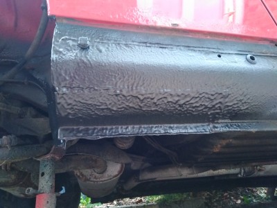

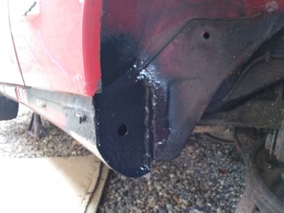

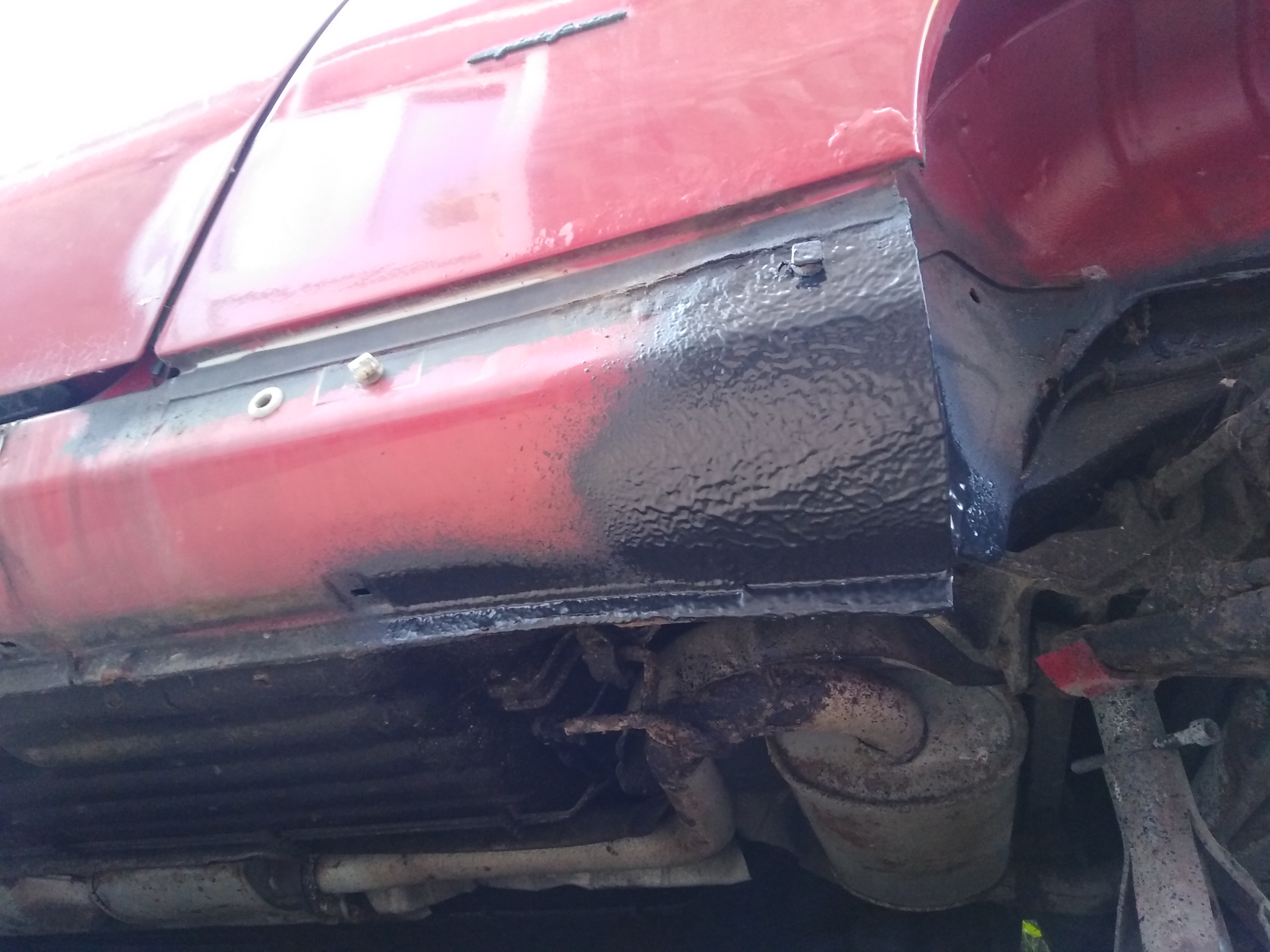

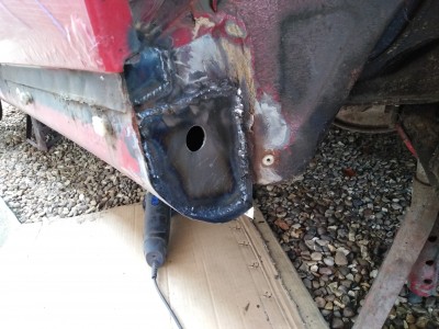

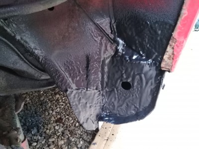

Passenger side all welded up now, strange to be doing it at home again, brought back memories of the suds that've been done here.
Primer and stonechip will suffice. Its  all covered up by the sill cover and wheel arch liner so no need to go crazy. I'll let it dry off for a week or two before putting the arch liner back in, some cavity wax over and inside the repairs before the liner goes in should keep it good for a few years.

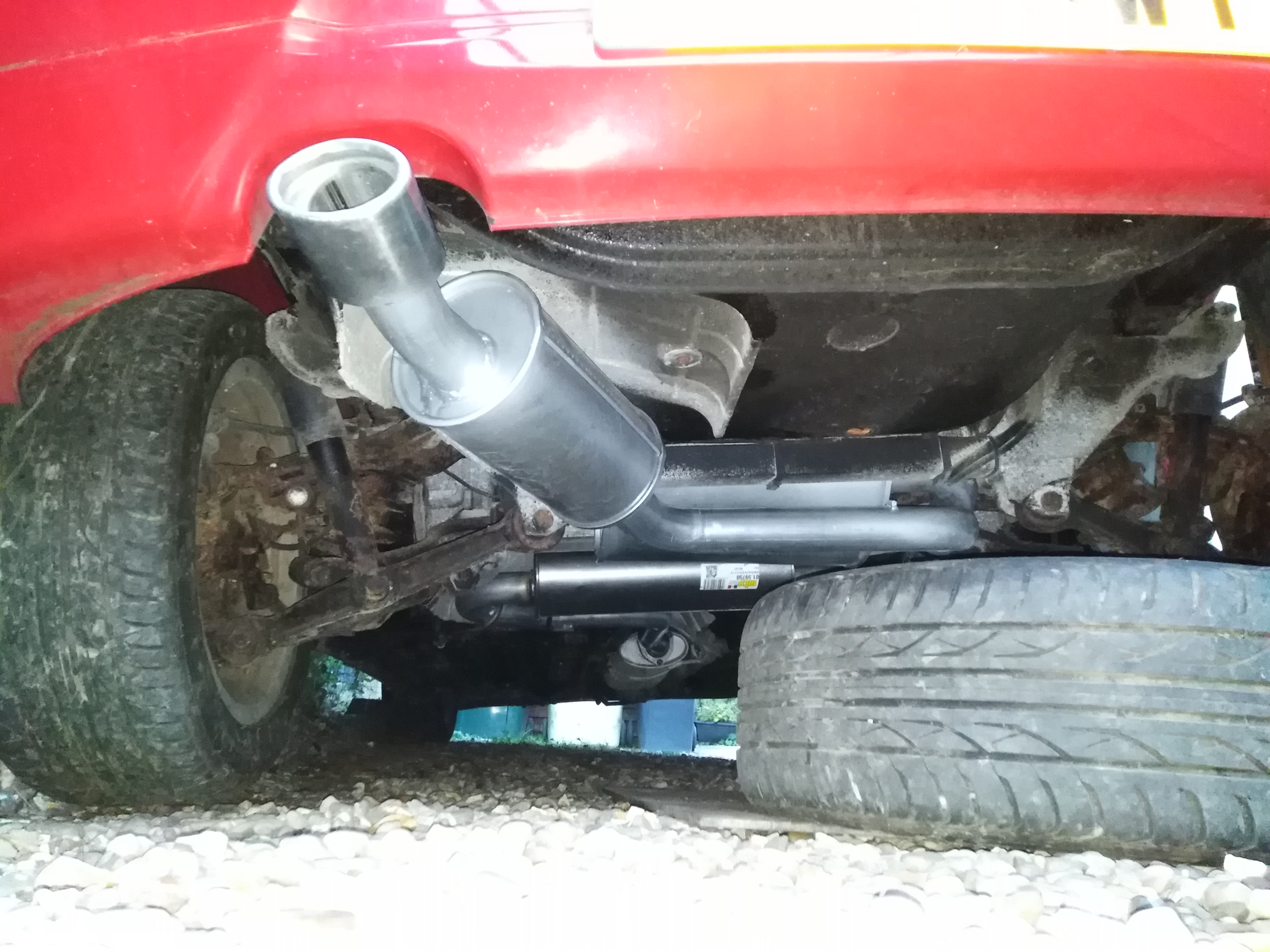

Whilst the repairs dry off I can get the new middle and rear exhaust sections fitted one evening or next weekend. Then it's just the rear brakes to change and it'll be about ready for the MoT test. The Y10 is on ebay and has a bid so that should be going soon... Albeit at the mercy of the hassle of ebay with people bidding and not turning up, I really do hope the sale goes smoothly.. Then the GTV can have the insurance transferred from the Y10 and I may actually get to drive it...

Nice repair . What spot welder are you using ?
						Re: GTV TS project
Cheers, thanks. Happy with how it went all things considered.
My spot welder I bought from Machine Mart a few years back and actually didn't use it for a while as I thought it'd be too much of a faff. But it's one of the best bits of kit I own really. Got it on one of their VAT free days that they often have s not quite such a huge sting but even now they're more expensive, econ I paid around £400 for mie, pre VAT price.
Makes a neat job and best of all there's no weld cleaning to do!

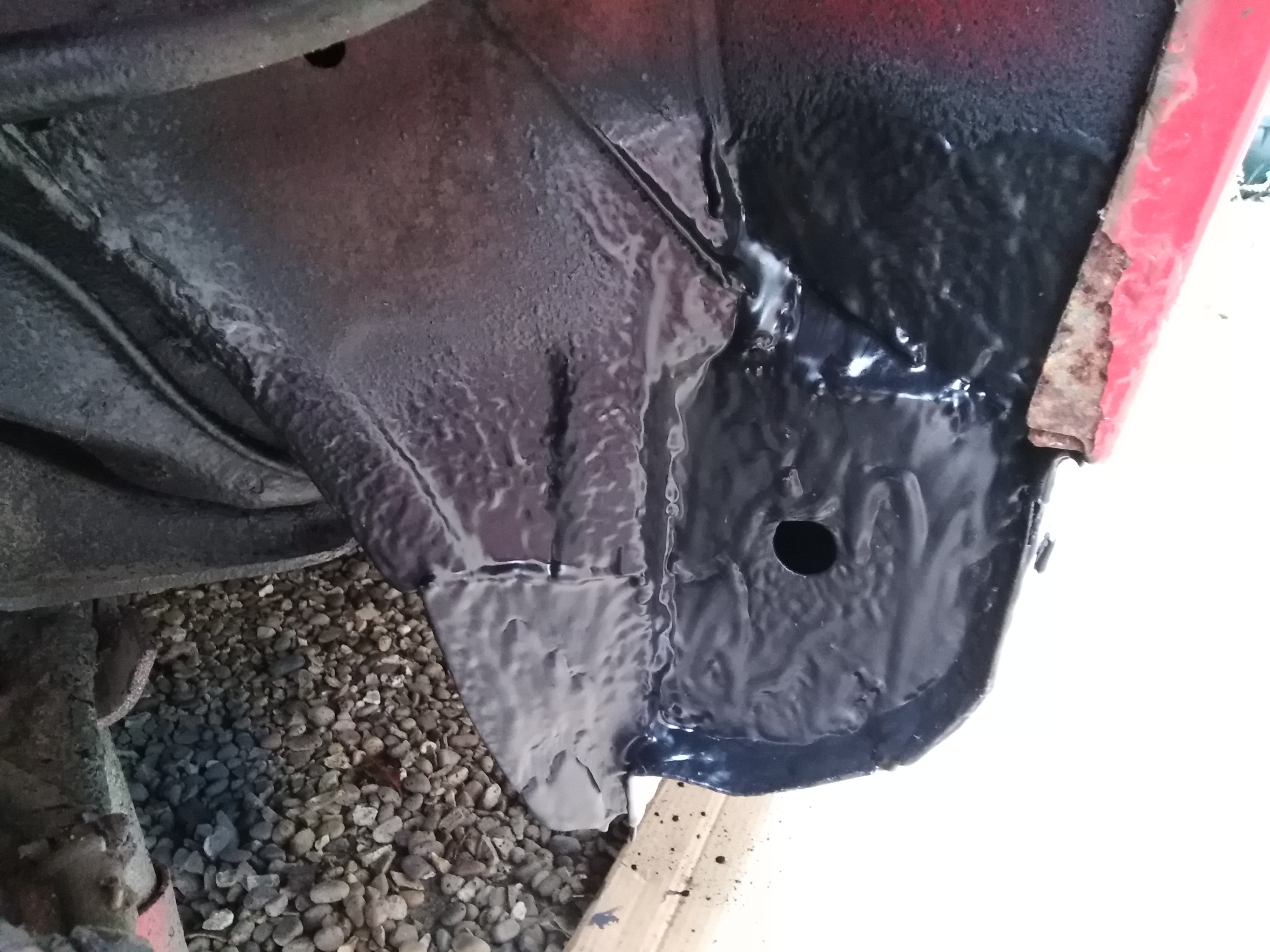

Did the drivers side this afternoon, was a bit worse than the other side as predicted but that just meant bigger patches!

I didn't know they did one with a 13 amp plug fitted. Looks like a nice bit of kit . I'm not sure it would work with the 25 m extension cable I'm using for power at the moment. No grinding has to be great and it looks original .KevJTD wrote: ↑Sun Aug 29, 2021 7:55 pmCheers, thanks. Happy with how it went all things considered.

I've just read the description . It doesn't work on a 13amp plug . It would definitely fry an extension cable !Alfastrut wrote: ↑Sun Aug 29, 2021 9:10 pmI didn't know they did one with a 13 amp plug fitted. Looks like a nice bit of kit . I'm not sure it would work with the 25 m extension cable I'm using for power at the moment. No grinding has to be great and it looks original .KevJTD wrote: ↑Sun Aug 29, 2021 7:55 pmCheers, thanks. Happy with how it went all things considered.

It does say in the instruction manual "miust not be fitted with a 13A plug"......which I did imediately!Alfastrut wrote: ↑Sun Aug 29, 2021 9:10 pmI didn't know they did one with a 13 amp plug fitted. Looks like a nice bit of kit . I'm not sure it would work with the 25 m extension cable I'm using for power at the moment. No grinding has to be great and it looks original .KevJTD wrote: ↑Sun Aug 29, 2021 7:55 pmCheers, thanks. Happy with how it went all things considered.

I've used it in my little unit without issue, the electric supply in there isn't great.
On the GTV today it was plugged into a 25M extension reel, which was plugged into my garden shed....all worked fine

Yes, they must have a huge current draw so I did expect it to trip out the shed at least, but it worked so kept going!
The copper arms do get very hot though so you have to be careful where you grab it or put your forearms across it!

When it said 6kw that's nearly 30 amps. It must not be blowing the fuse due to the short duration of current draw.

Amongst other weekend tasks I finally got the middle and rear exhaust boxes fitted, pleased to have the space back in the shed! Kept tripping up on them.
I'll try and get the rear brakes sorted this week in the evenings, then about ready for the mot. Have got the front pipe to change too I reckon, now the din that the rear sections were making has gone I can hear a little blow somewhere although I can't pinpoint it, probably within the little flexi section on it. Have one in stock so just a new gasket to buy, so not the end of the world cost wise.

Just to prove it has actually left my driveway, some pics of the car viewed from its best side taken at my regular scenic shot location.
