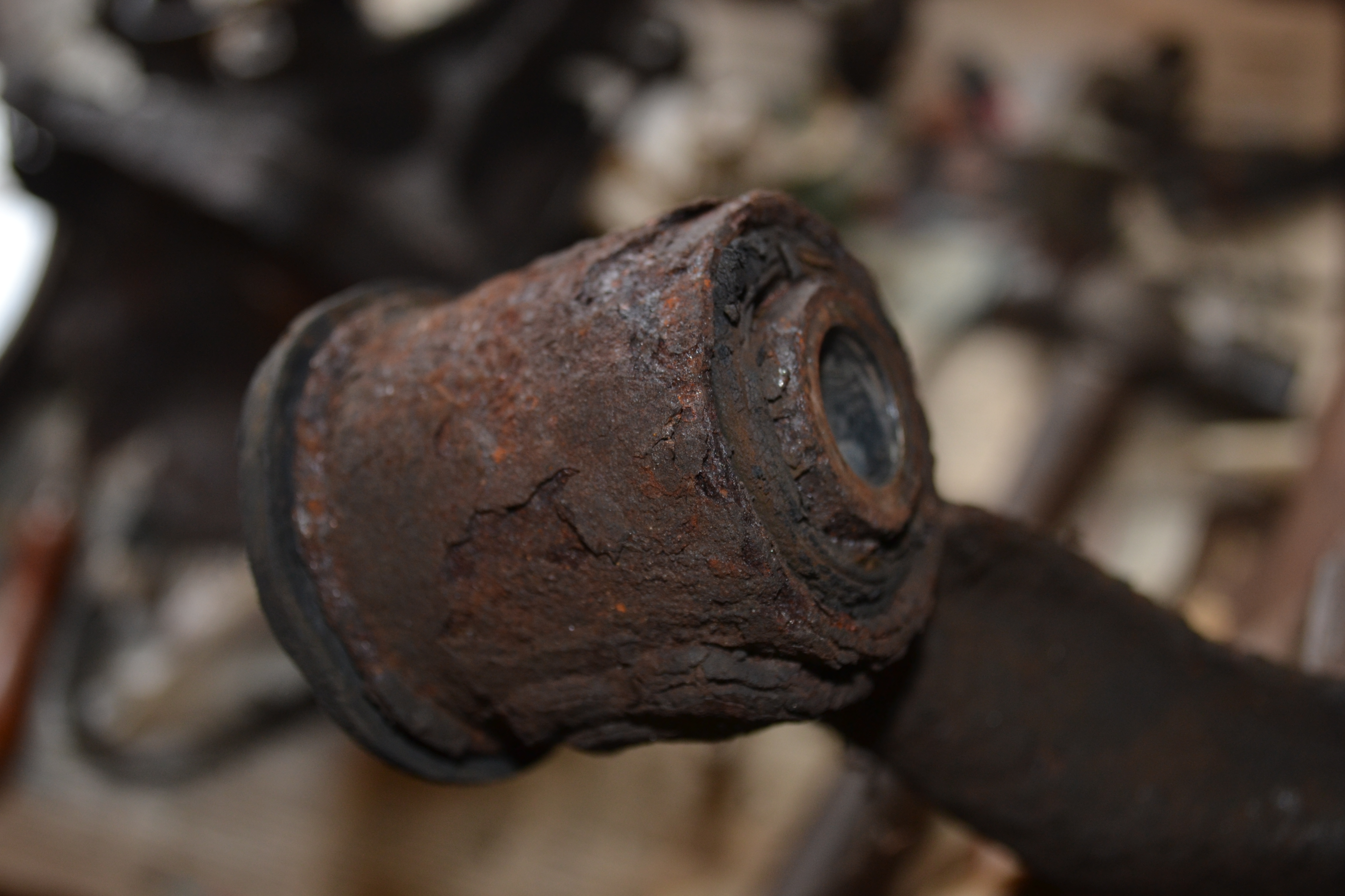

The polly bushes are yours Loo, if you can wait a year or two. I have just started sorting out my 2004 MX5 1.8S and I think thats going to keep me busy for a few months. I didn't realise how well they rust when I bought it, and apart from all the welding I need to replace all the suspension arms. One had split along the length of the bush mounting on another the bush mounting was starting to come away rom the arm, due to corrosion. After the MX5 then I want to finish my 75TS. The Sud with the polly bushes is on a hard standing in my neighbours back garden, where they used to keep their camper van and is wrapped up in several layers of waterproof materials which will hopefully keep it dry for a year or two.
