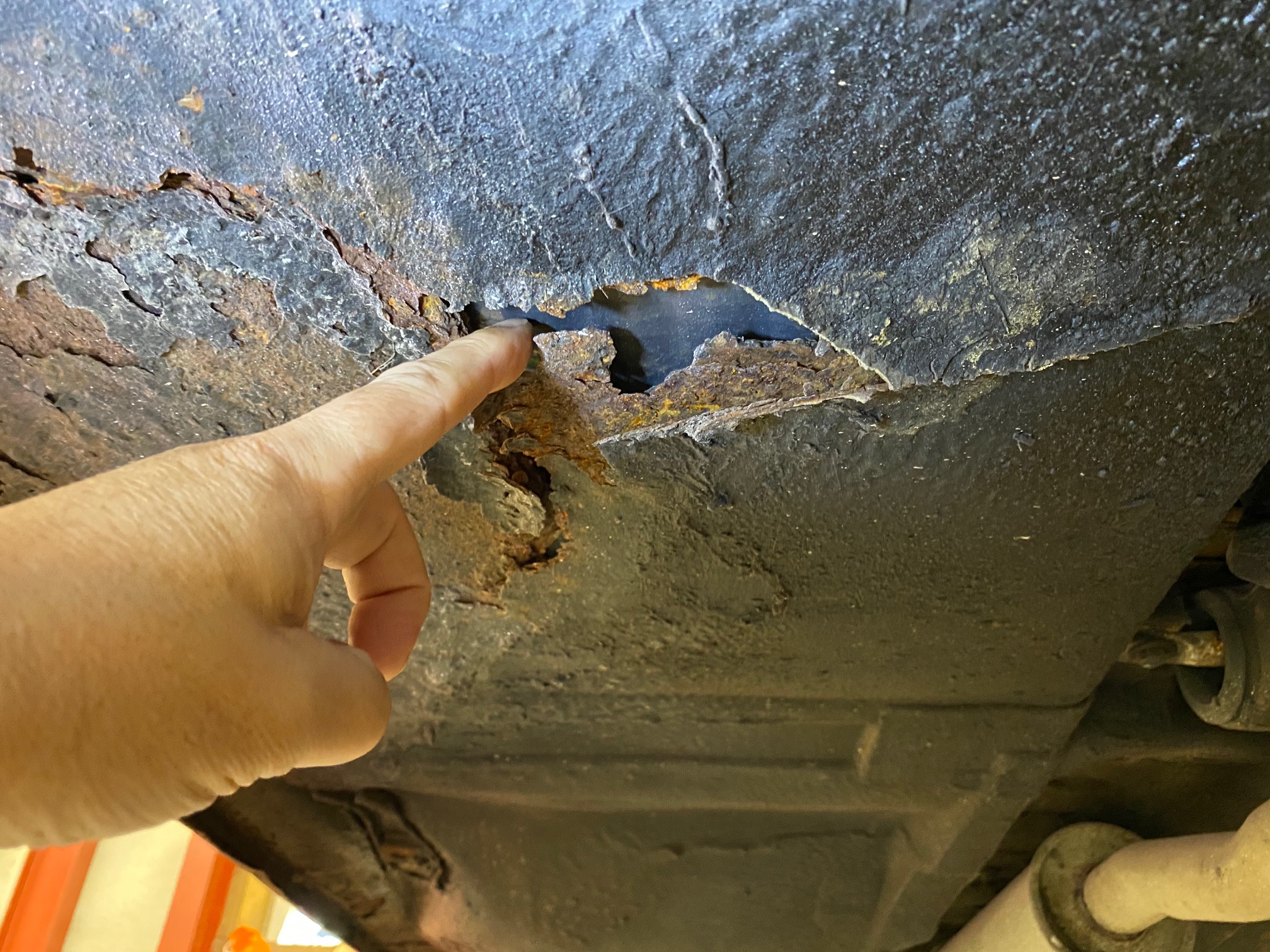

Hi Dave, yes I bought this from the guy, who bought it from the guy, who bought it from Steve! :D
It has had quite a lot of (proper) body restoration along the way, including a change of colour. The respray (and prep underneath) wasn't great sadly and its in thick acrylic 2-pack, so my ultimate plan once the mechanical work is done, is to strip and respray the car in original black.

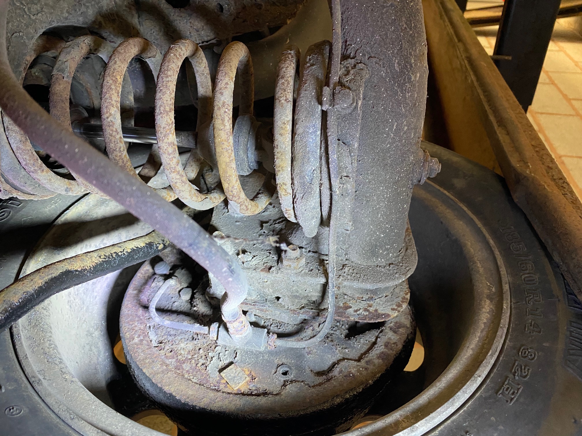

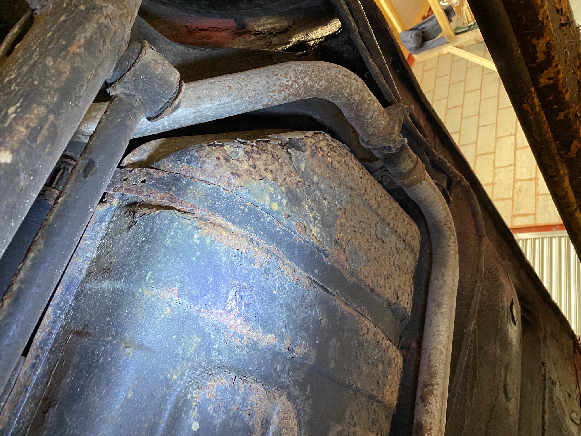

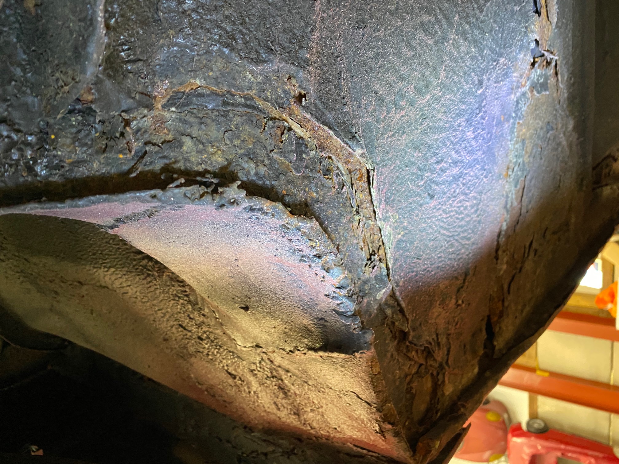

I took these pics last night whilst underneath the car.....it's a bit "crispy" :cry:
Yes, that is the underneath of the carpet!
Fuel tank will probably have to come out....
Lots of areas I daren't poke with a screwdriver!

Welcome along Chris. Knew you'd make it along here eventually - its a treasure trove of knowledge, information and masochism............
Si puo diventare Alfista
Re: New Sprint owner but definitely not new to Alfas!
Just goes to show looks can be deceiving, looks great in the pix but as you say, a bit crusty underneath :lol:
All good though, metal is metal. It's easier than trying to find a decent interior, which it looks like you've got 8-)
Quick word if you remove the tank Take it easy they are almost impossible to find now So take care with it and tank straps are also Quite rare. I do have plans to have new straps made I’ll be posting details when they are available

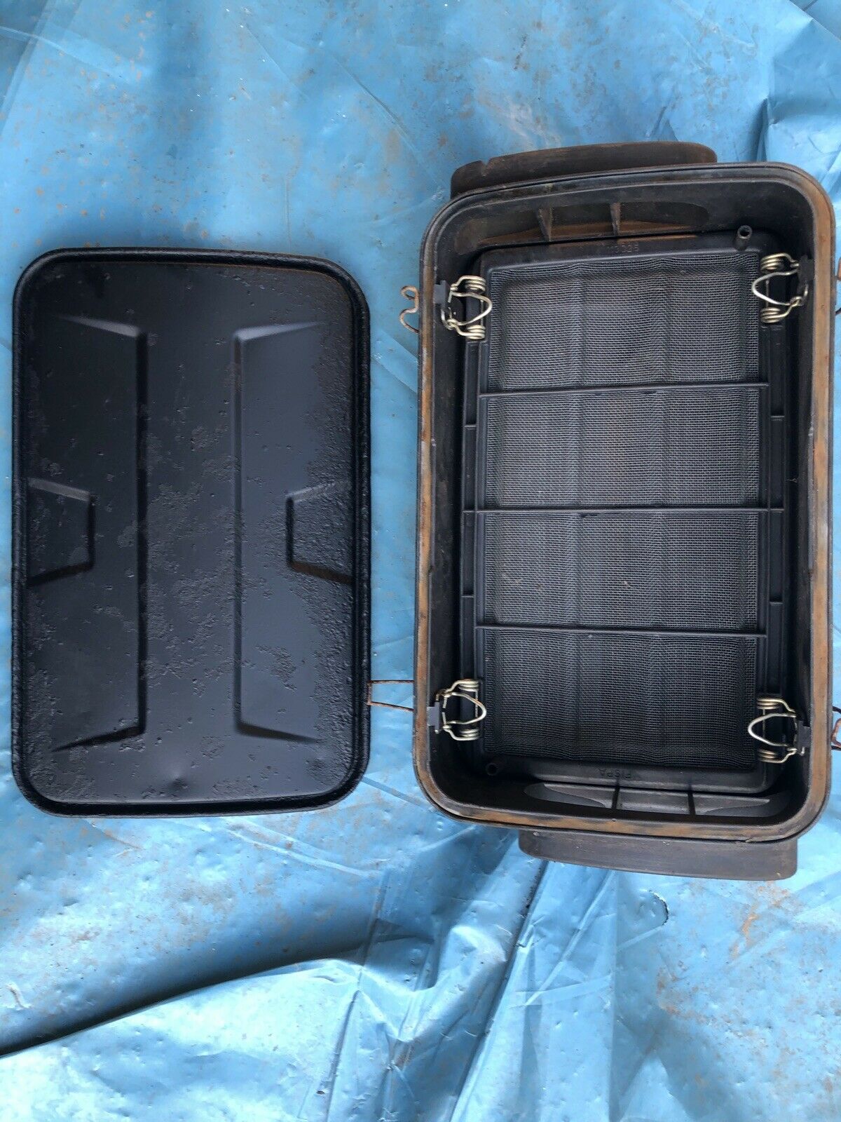

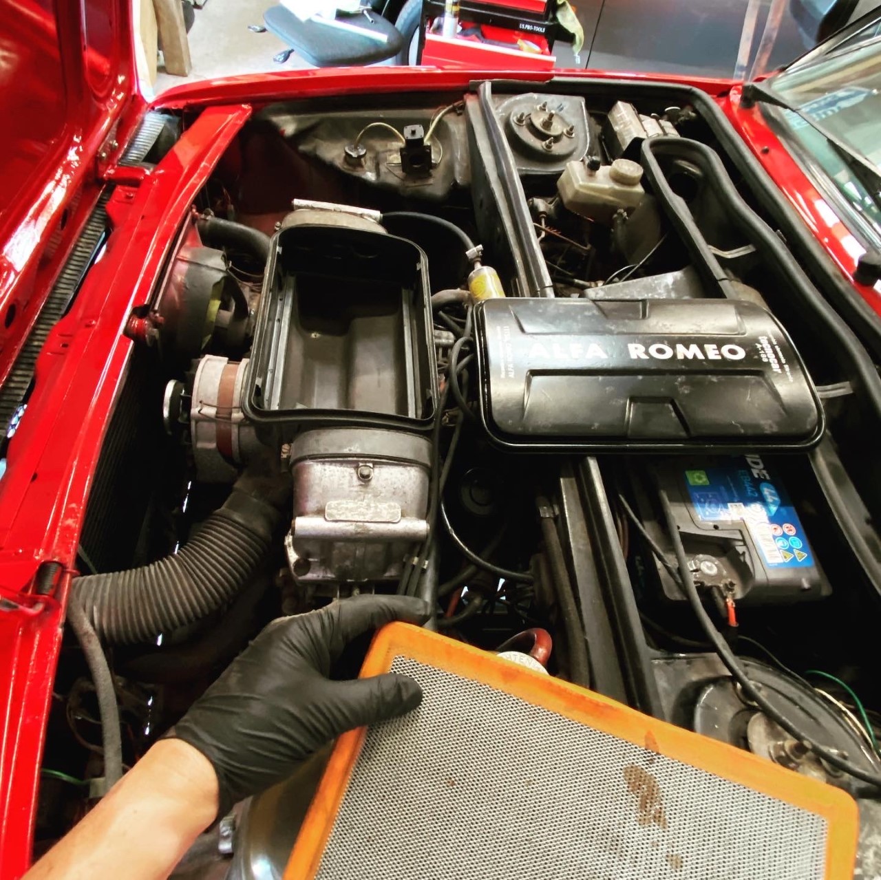

Quick question for anyone who may have the answer: On removing the air filter housing cover, my (dirty) filter panel was just sitting inside, with no apparent means of keeping it in place. Is this right, or should the filter element have some sort of clips or retainer?
There’s 2 types of filter assembly one has a plate attached to the top lid that holds the filter in place the other has a separate panel that Sits on top of the filter and is held with 4 clips It looks like your lid is the Latter. So you should have a separate bit. I may have one but need to look through my junk first

Thanks Lou - that's what I was thinking - it didn't seem right to have nothing stopping the panel from jumping up and down!
The inside of my lid is empty - just concave. Thanks in advance if you can find me one - I'll pay for it of course.

LooLooSud33Spider wrote: Sat Sep 26, 2020 10:54 pm There’s 2 types of filter assembly one has a plate attached to the top lid that holds the filter in place the other has a separate panel that Sits on top of the filter and is held with 4 clips It looks like your lid is the Latter. So you should have a separate bit. I may have one but need to look through my junk first
Like this?
That’s the fella .

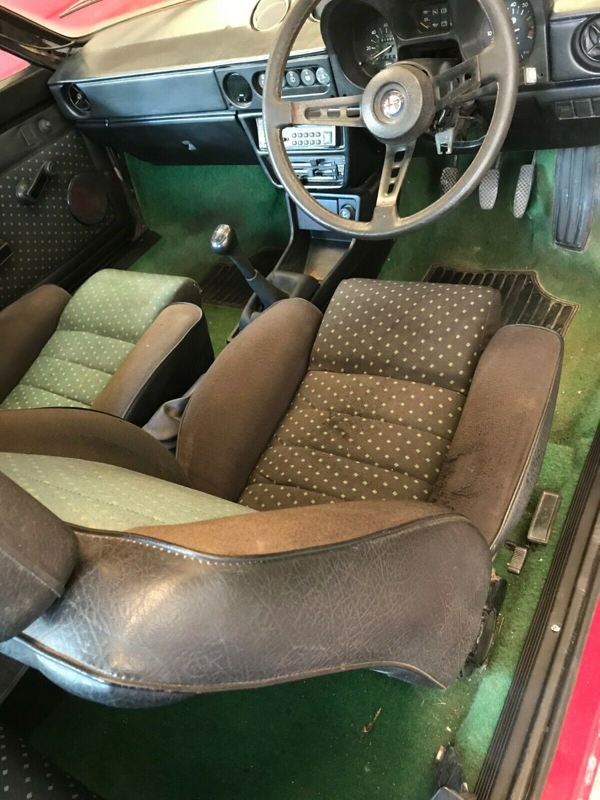

Splant
Posts: 142
Post by Splant »

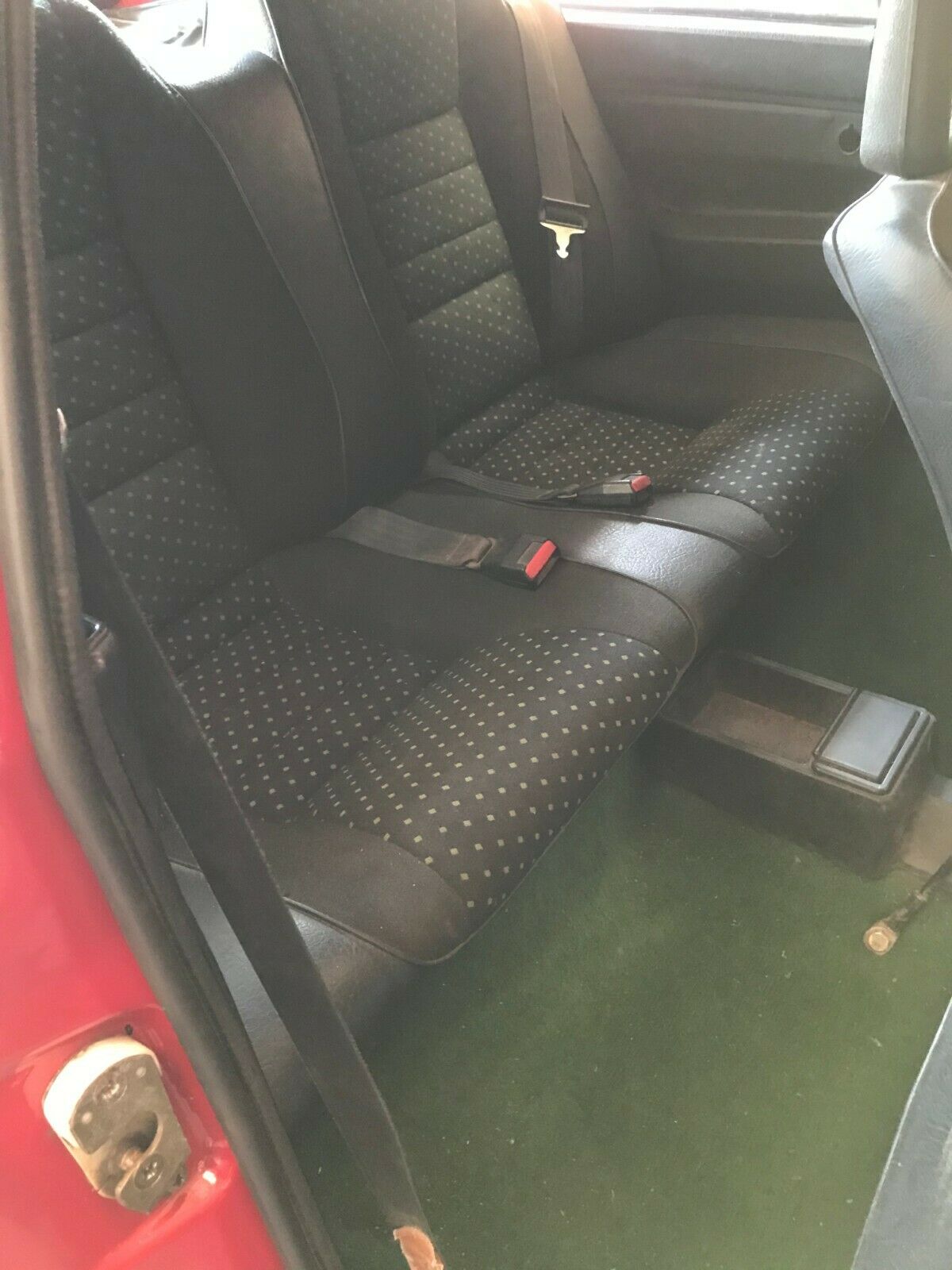

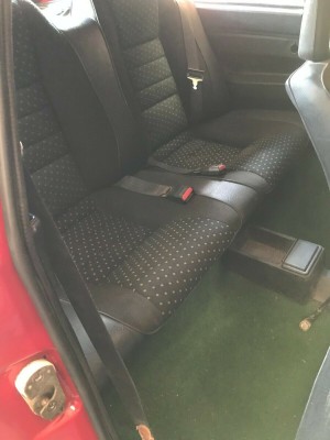

That photo of the interior makes me realise my accelerators been bent away from the brake pedal ,which I'm glad of ,as I still sometimes hit it when meaning to brake! Be nice to be able use the resting pad next to the clutch also ,I wonder if that can be bent across?
AlfaNut
Posts: 33
Joined: Sun Sep 20, 2020 8:54 pm
Post by AlfaNut »
Yes, the pedals are VERY close together! Ideal if you have hooves like a goat but not so great for "normal" sized Human shoes! :lol:
