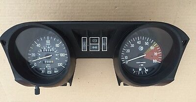

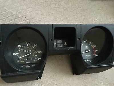

On the earlier ti’s it’s the water temp light itself , bottom of speedo left hand warning light. Bottom pic.
Just found a later binnacle pic and it has a Water temp Light in the middle section, top pic.

Water temp light but not normal to have it on later cars unless you’ve replaced the sender with an early one

On early cars running thicker mineral oils the warning light comes on until the cylinder head temperature hits 30 degrees C and then goes out. This was so that you didn't blow out oil seals when revving the engine from cold. Both my boxer engines (the '78 Ti and which I stripped for parts and the current 1980 engine) have this sender unit which I have wired into the dash. I quite like the sense of theatre that it conveys, although it can be a pain at car shows when kids ask you to rev a cold engine!
I have also read that the light will come on again if the temperature exceeds a certain threshold, but this may be confusing the early sender with the later ones, which with modern semi-synthetic oils no longer need the "thrash light" before giving it a bootfull.
