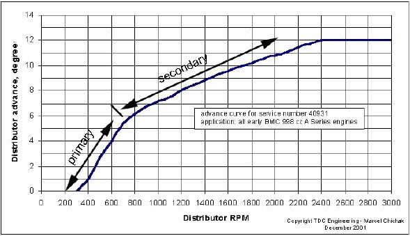

This type of system replaces the vacuum or mechanically advanced distributor and amplifier coil, with an electronic box, and typically a wasted spark coil pack and Edis unit from a donor car, commonly a ford fiesta type thing (Urghh!) Once all loomed up and plugged in, you can adjust the pattern of ignition advance via connection to a computer/laptop, preferably on a rolling road, and therefore maximise your spark timing for your given engine spec, fuel, and driving load and engine conditions etc.
It does this so much better because instead of a 2 dimensional fixed graph line,
made up of fixed parameters such as vacuum or mechanical advance mechanism against rpm, resulting in one line of advance pattern, the Megajolt picks up load signals from precise crank position (CPS), and throttle position (TPS) or manifold pressure (MAP) to measure what the engine is doing currently and reacts very quickly to what you want it to do next, and how the ignition advance needs to match that, with a 3 dimensional ignition pattern.

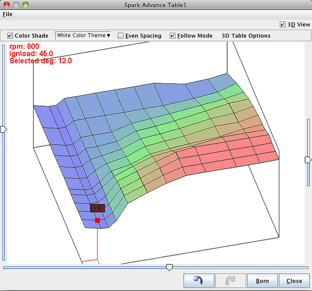

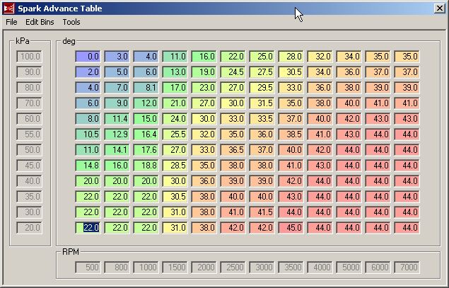

The ignition pattern is almost indefinitely variable, by altering values of exact degrees of advance, by entering the figure itself into a 10 x 10 table (maybe a 12 x 12 now). Experienced rolling road operators and live mappers will be able to maximise your ignition curve for snap response, driveability, flat out wide open throttle acceleration, even economy and best of all reliability too.
looking at similar information formulised into 3d

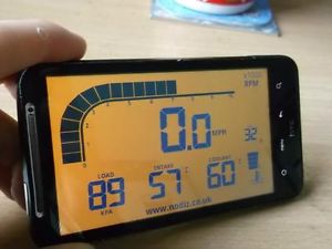

Its also got some great gadget value too (gotta Love a gadget!) in that it also comes with a bluetooth interface, allowing you to not only set up, program and map the thing without having to connect to it with a cable, meaning a more discreet install for the concours lads possibly too, but it will also allow you to display a dashboard of vital info, calculated from a mixture of the engine sensor info that supplies the NoDiz brain with its signals and gps i should think from your phone/device,
such as this
Looks pretty bloomin awesome to me!
