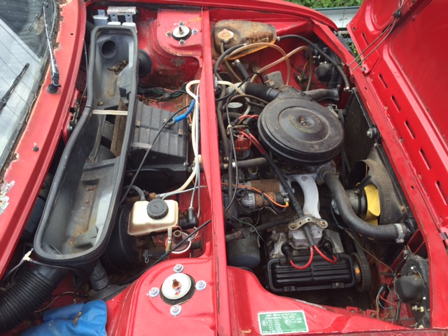

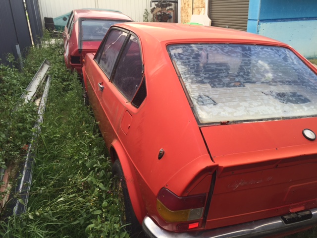

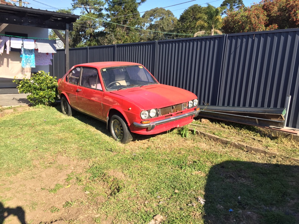

As promised here is the thread for my Alfasud race car build. After much searching I found a 1974 1200ti in Sydney. The guy who had it is an enthusiast and had good intentions for it but had found a better one and this one was left standing in his garden where bits were slowly disappearing off it. I bought it without seeing it, but from the photos it looked fairly solid and was assured that it was. A deal was done for 750 quid and I shipped the car to Dave at Brunswick. Believe it or not this worked out cost effective due to the price and scarcity of early suds in the UK and the fact that I shouldn't have to pay import duty on the way back down under. Plus the cars over here don't rot quite as fast as they do in the UK. I plan to build it for a series over here that basically runs similar rules to the old AROC class C rules. So heavily modified but keeping glass and steel panels. The plan is to fit a full race 16v. Dave promises to send photos of the build which I will post here.

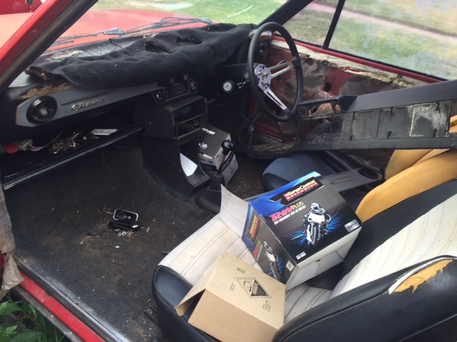

Off to a slow start. The bulkhead was muntered. Cage next.

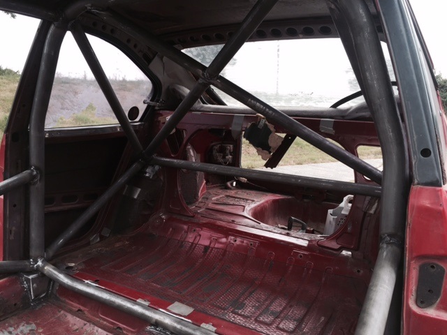

Post by garygecko »

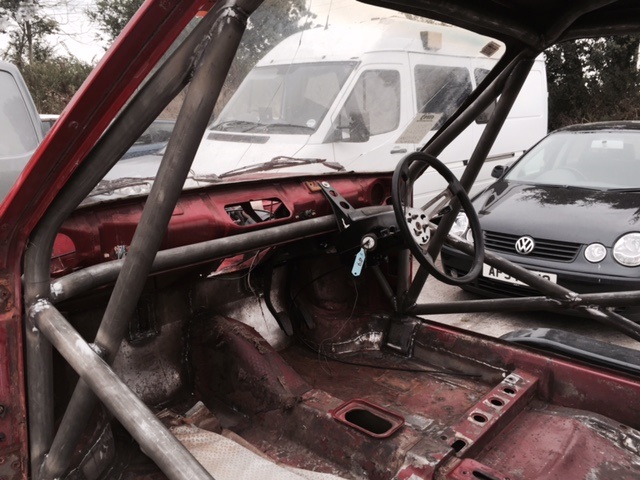

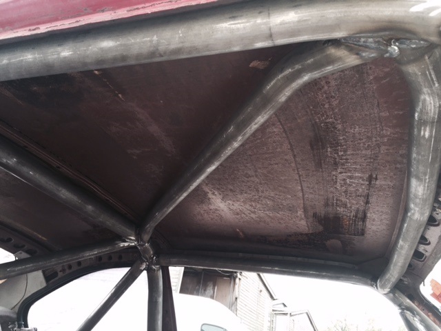

Roll cage in. Paint next!
Re: Alfasud racecar build
Top notch cage Gary, looks a good, tight fit......

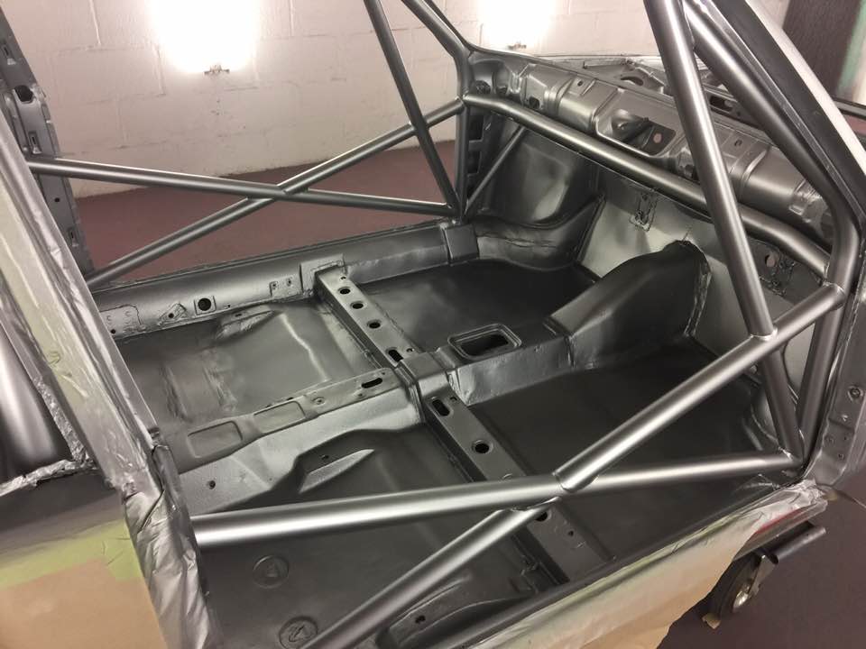

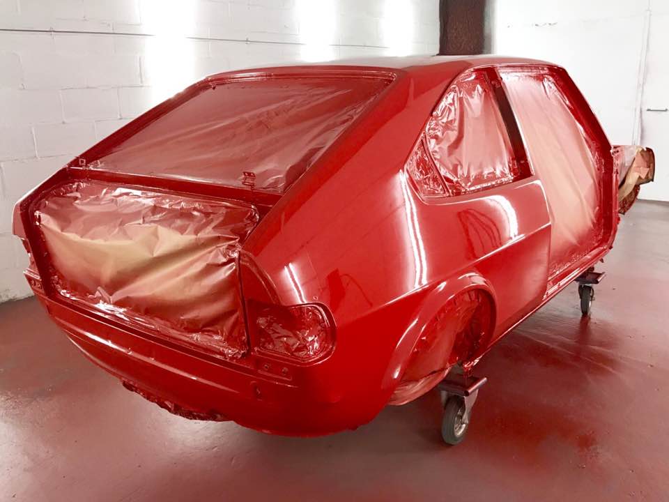

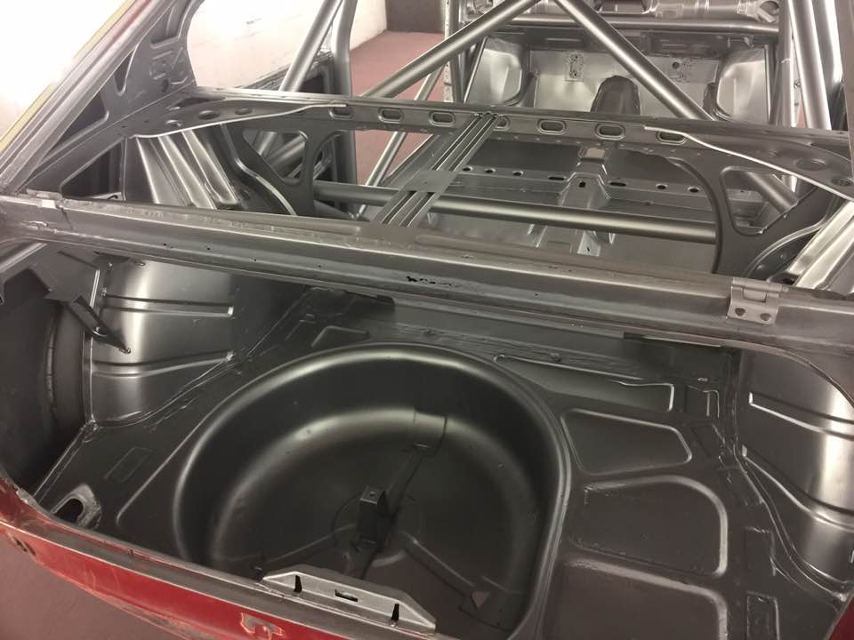

Post by garygecko »
Now with paint:)
That looks superb! Well done sir 8-)
Very nice .top job 8-)
love the finish on the inside 8-)

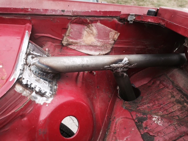

Marlow Sud wrote:Lovely job. The tubes through the bulkhead got me scratching my head. I have not seen those before. It seems they effectively put the front struts under the corners of the roll cage?
Basically stiffness and safety.
"Allows the front suspension loads to be fed into the whole cage structure; provides protection for occupant's feet. It also improves side impact protection and increases the load capacity of the 'A' pillars/lateral hoops."

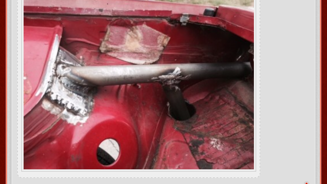

Simonsud
Posts: 331
Post by Simonsud »
This is were it joins

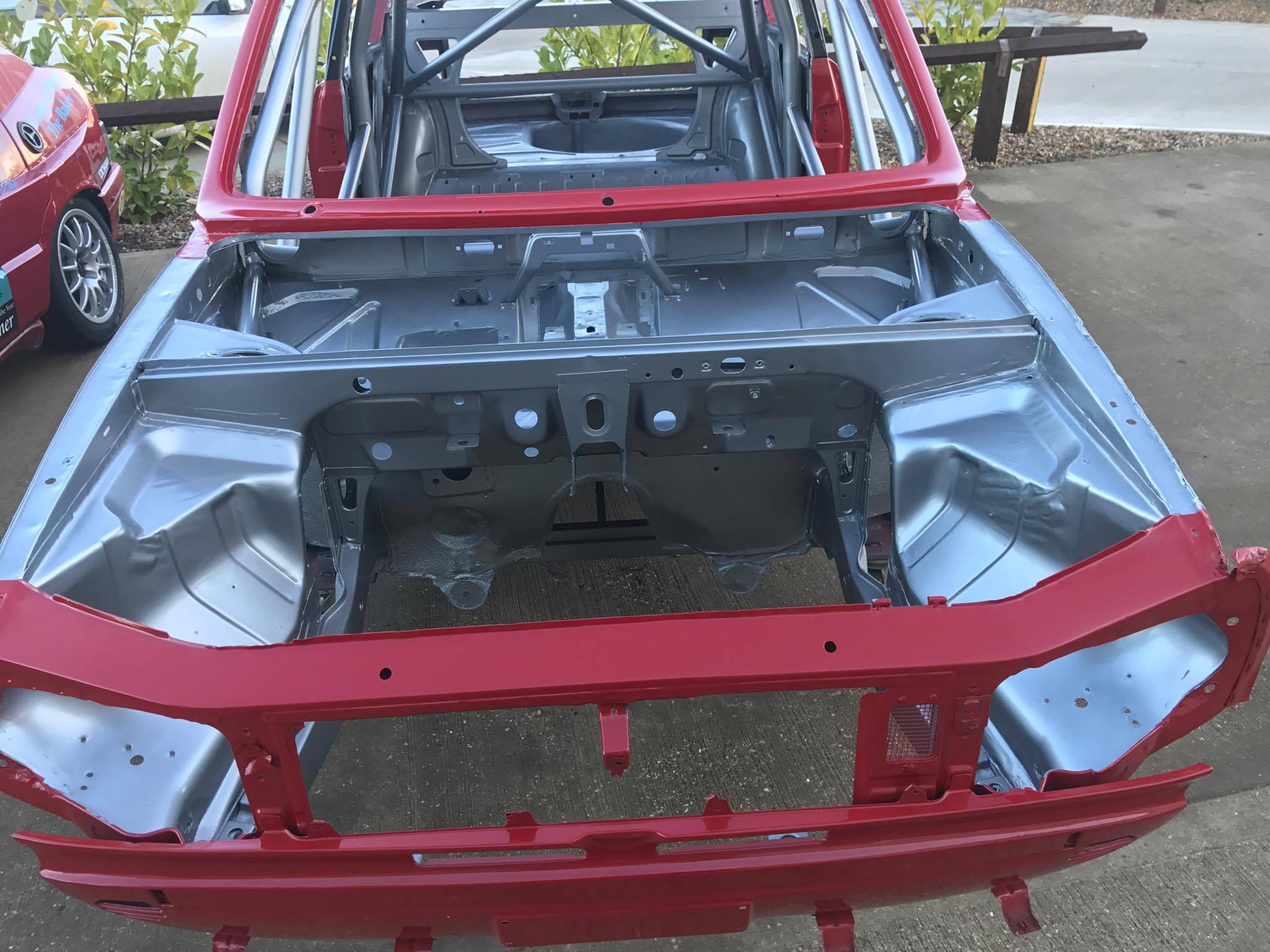

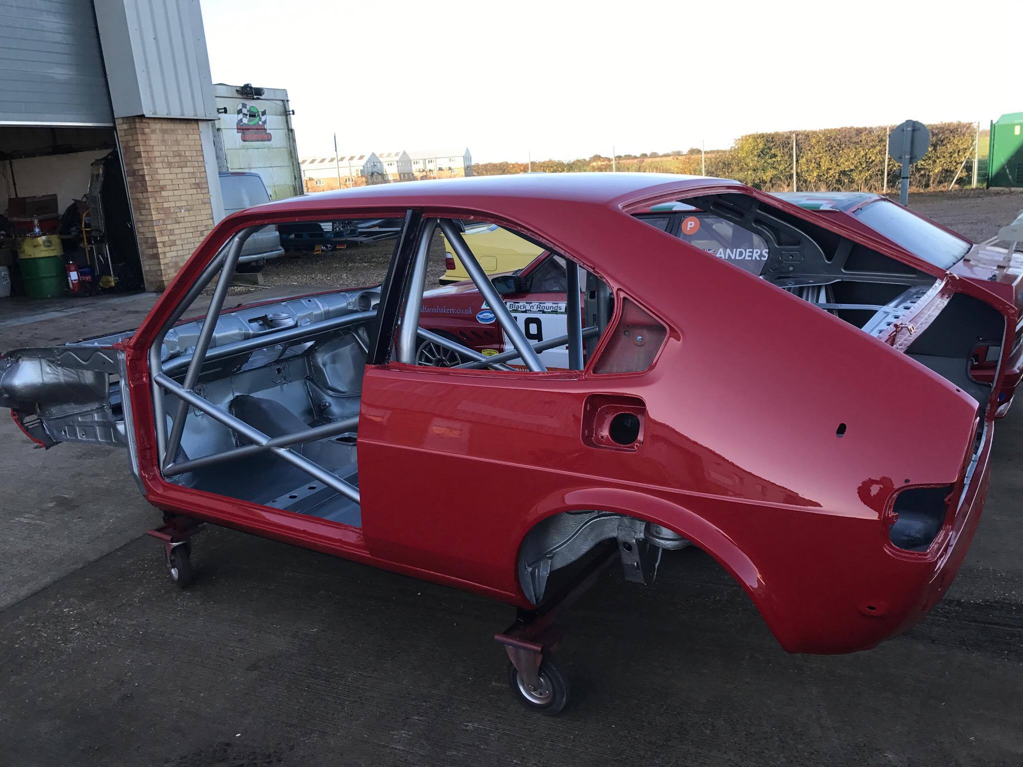

Post by garygecko »

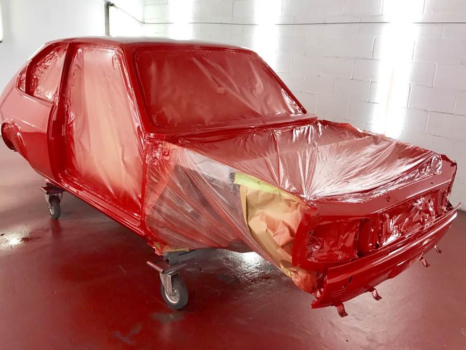

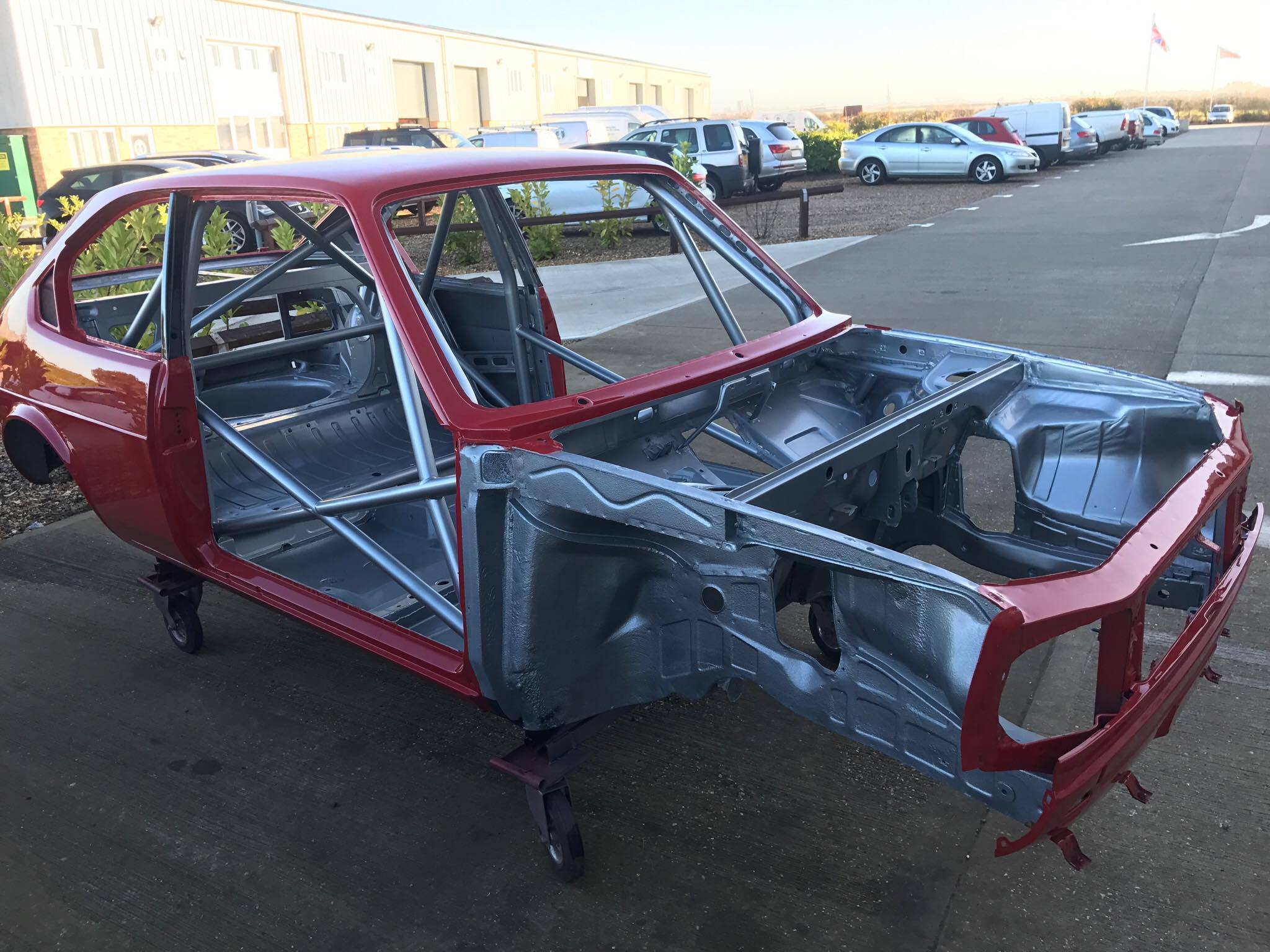

Back from the paint shop!
Good choice of red.
Won't be too long before its up and running now ?
