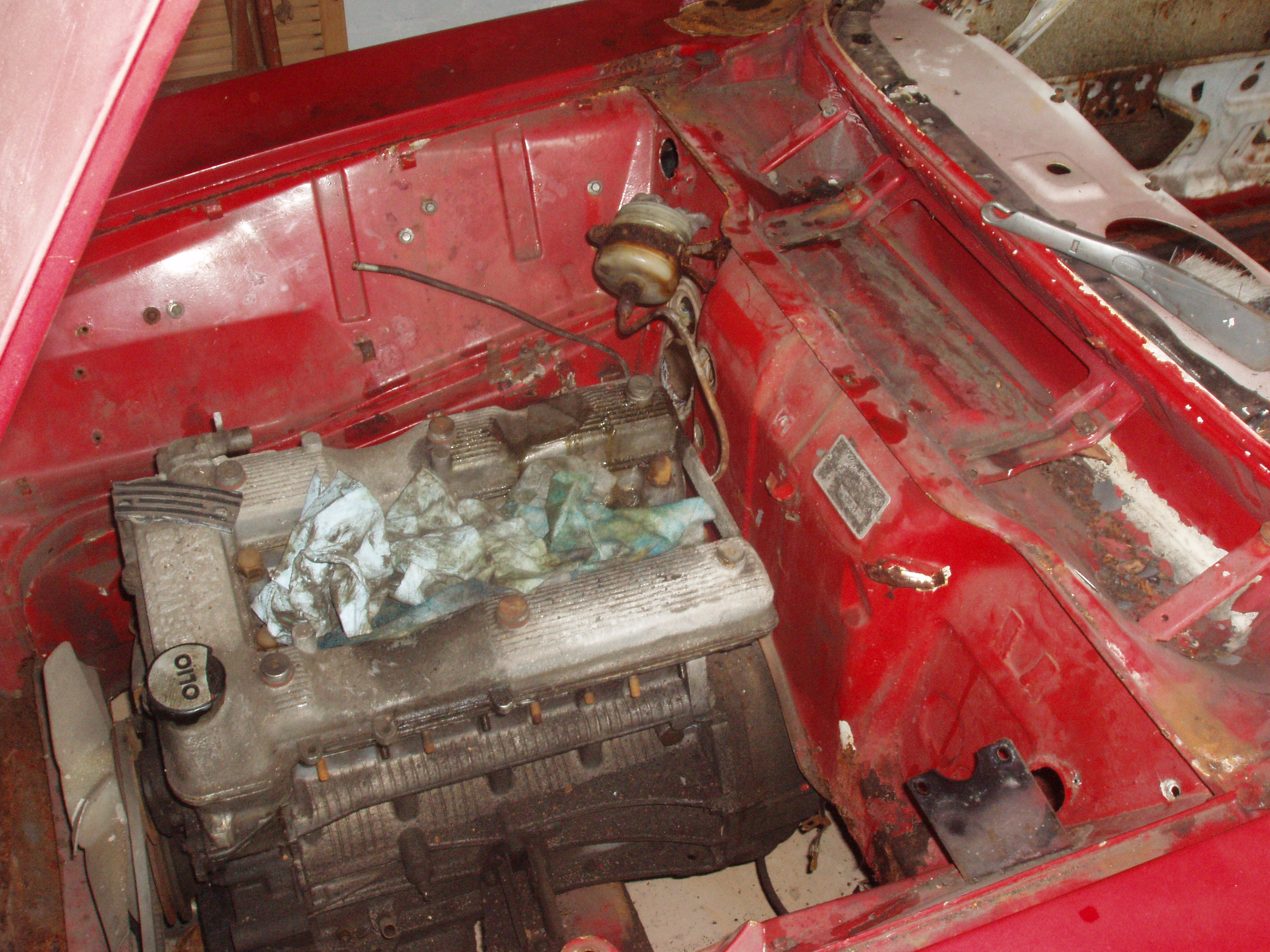

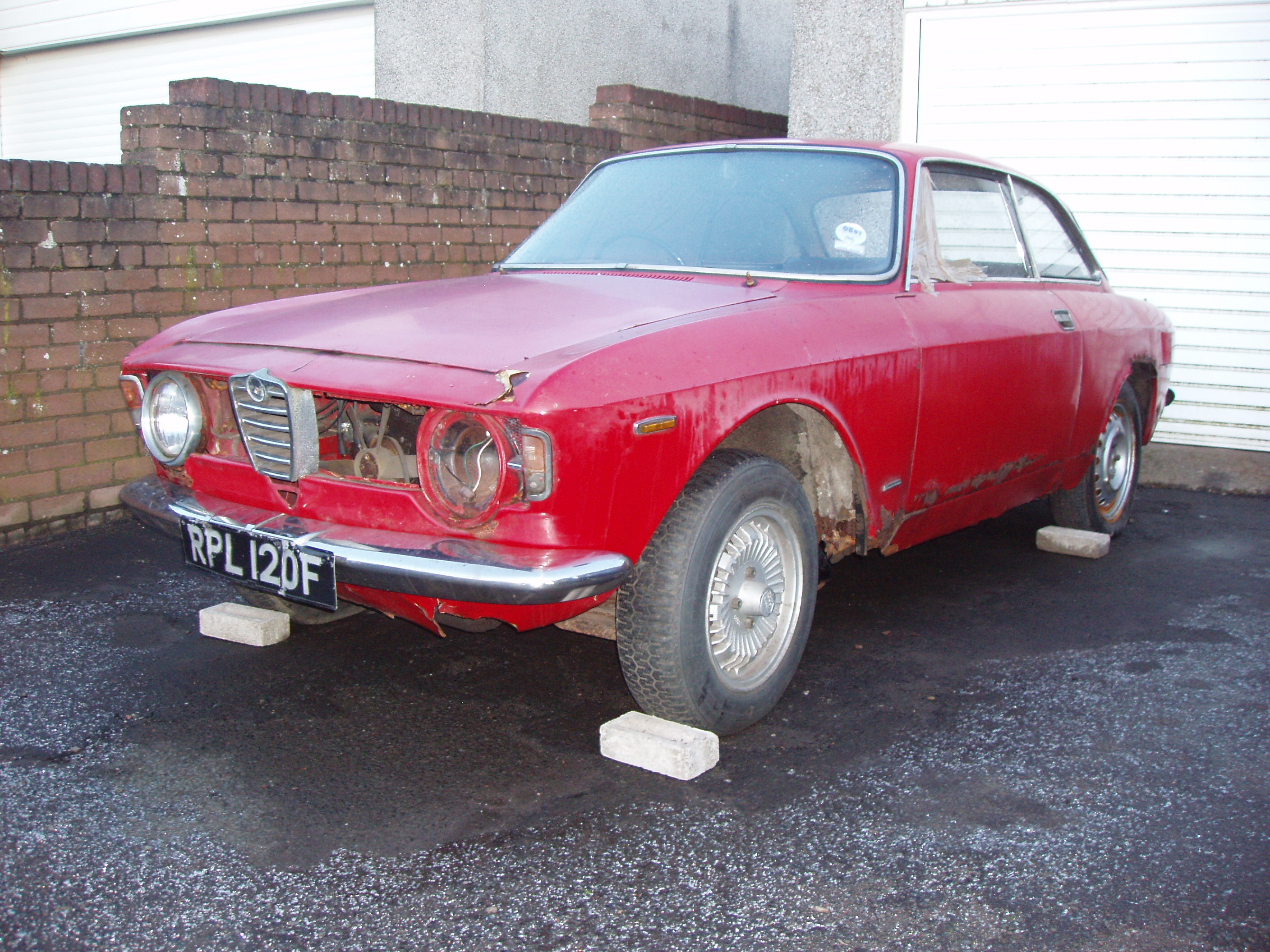

I got this via ebay from Classic Alfa in December 2011. Funnily enough they had bought it as part of small job lot from Mclennans in Loanhead (Edinburgh) a couple of years before, so it ended up travelling the length of the country twice. It's originally from Essex but came to Edinburgh in the early nineties. It sat unused at Mclennans from about 2000 onwards, not sure exactly why but I think it was due to unpaid bills. It was orignally white, it was yellow for quite a while and was painted red when it came up to Edinburgh. A chap in Glasgow actually knows quite a bit about the car during it's Edinburgh period, the work done to it and about it's colourful owner.
Pictures of the car on arrival:-
After spending several months get the 'workshop' ready with fresh paint and new tools I got it stripped down to a rolling shell:-

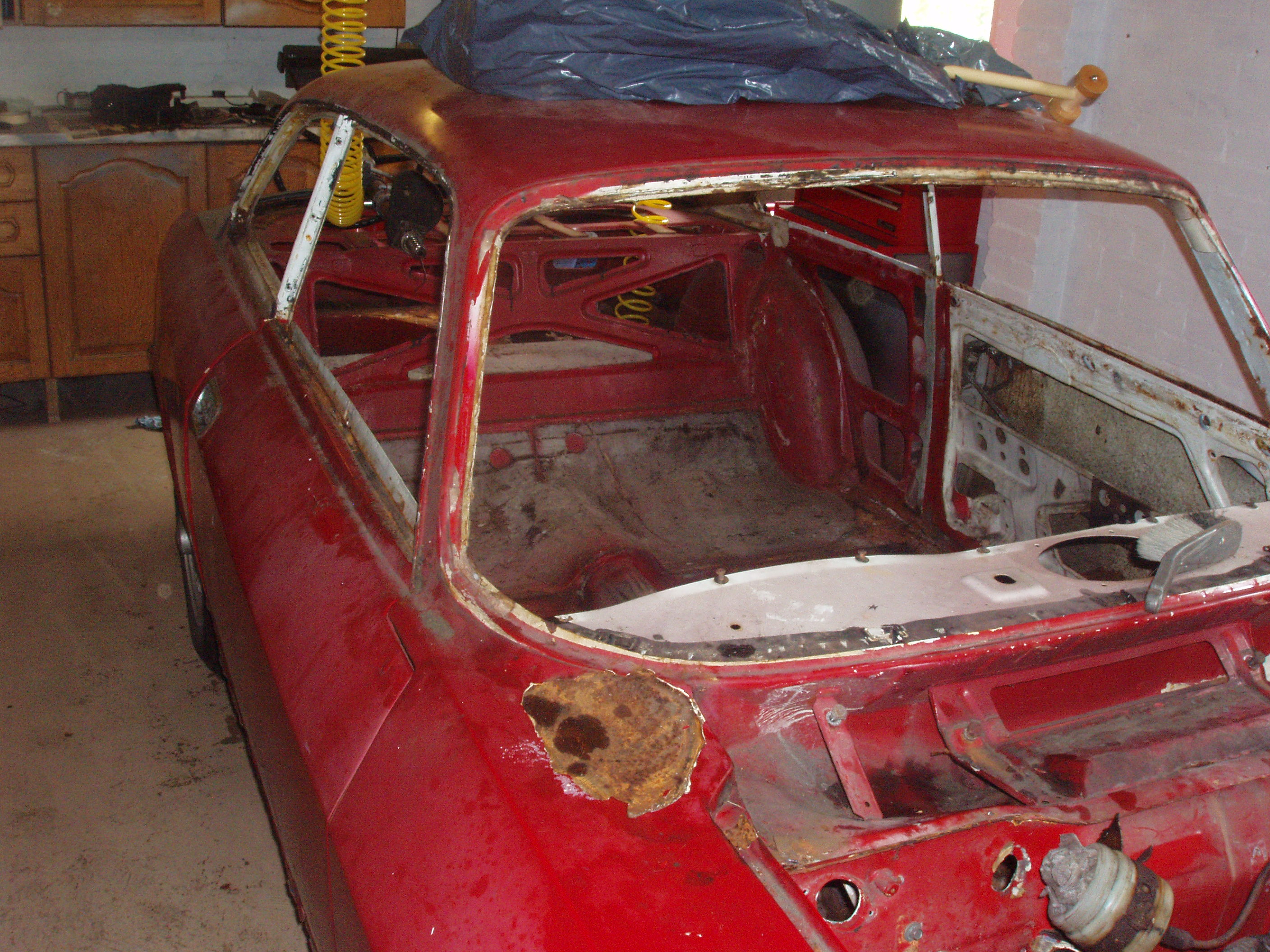

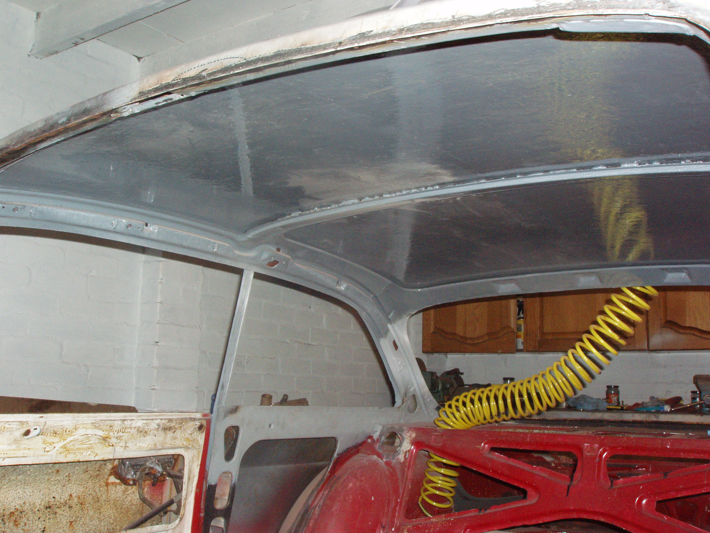

First phase was the underside of the roof as there was a lot of surface corrosion under the headlining. It's painted with POR15 as it shouldn't see any direct sunlight.
Next I moved onto the rear windows:-
It was at this point I discovered die grinders and tungsten carbide bits

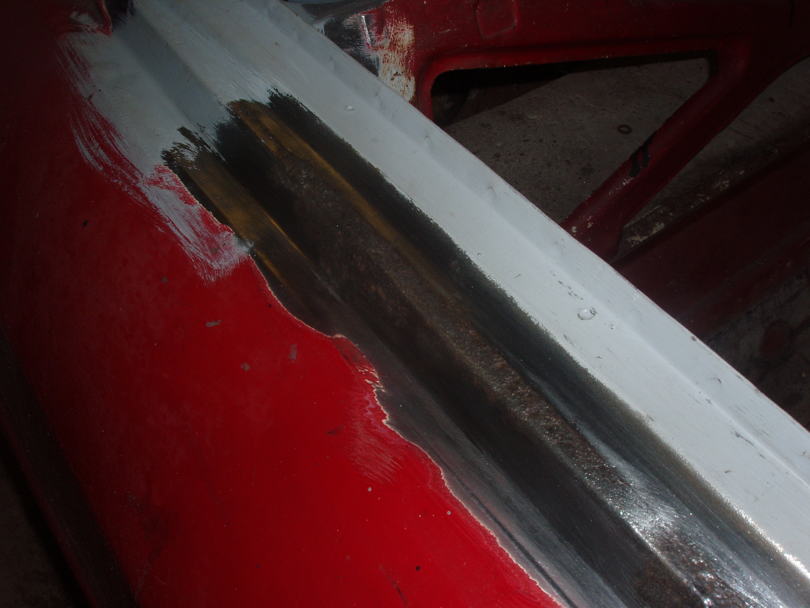

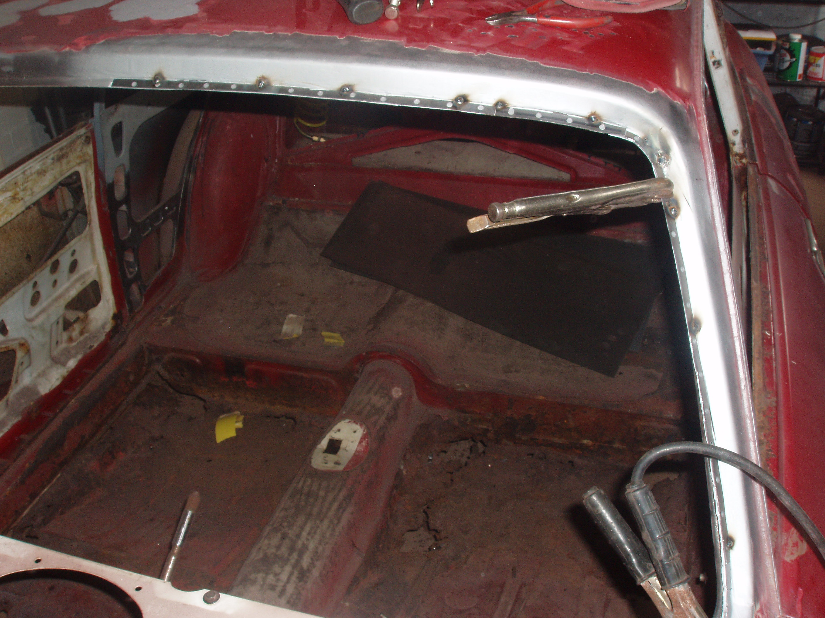

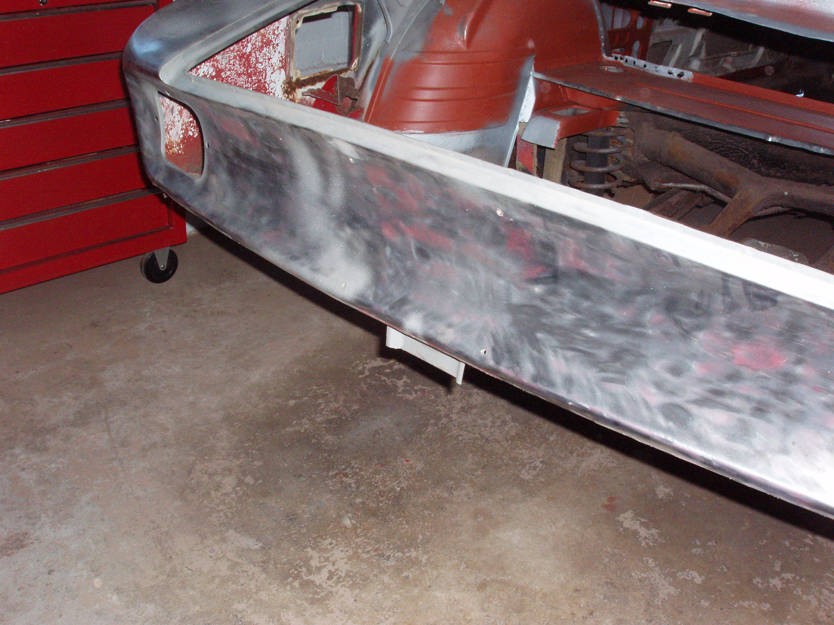

Next phase was to sort the lip around the front and rear screens. I didn't look bad on the outside but I was concerned rust had started between the spot welds so I decided to cut of the the outter side of the lip which would allow me to de-rust properly. It was about this time that I bought this:-
http://www.machinemart.co.uk/shop/produ ... andblaster

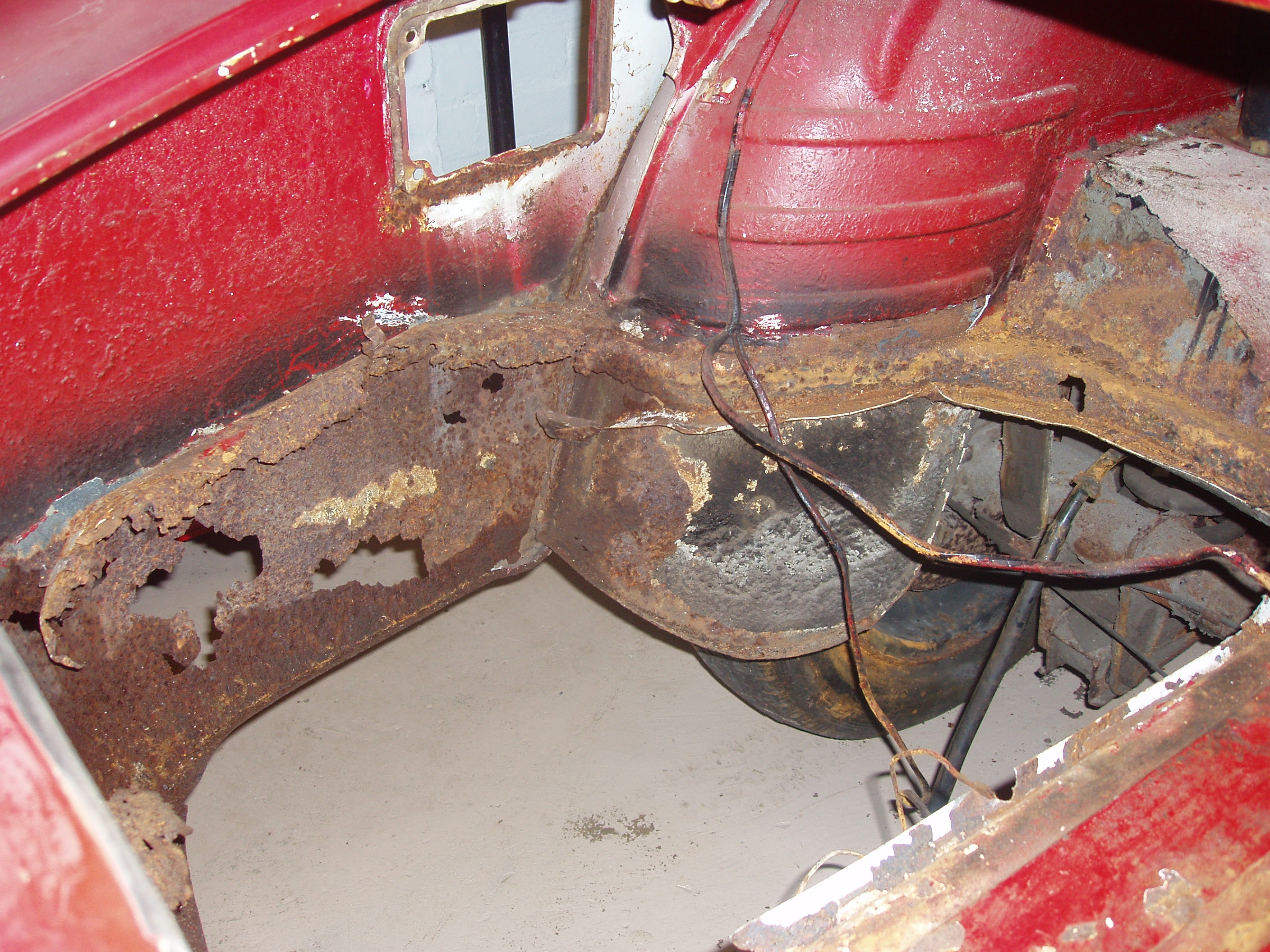

Next was to tackle the boot floor, this is the before:-

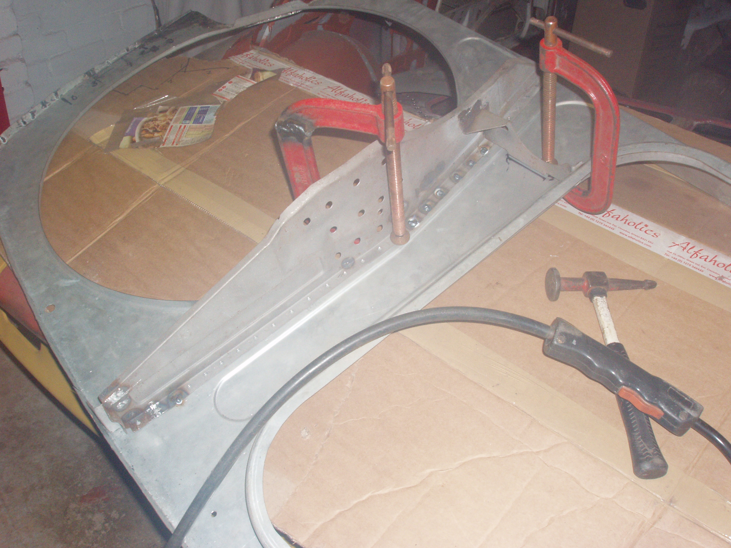

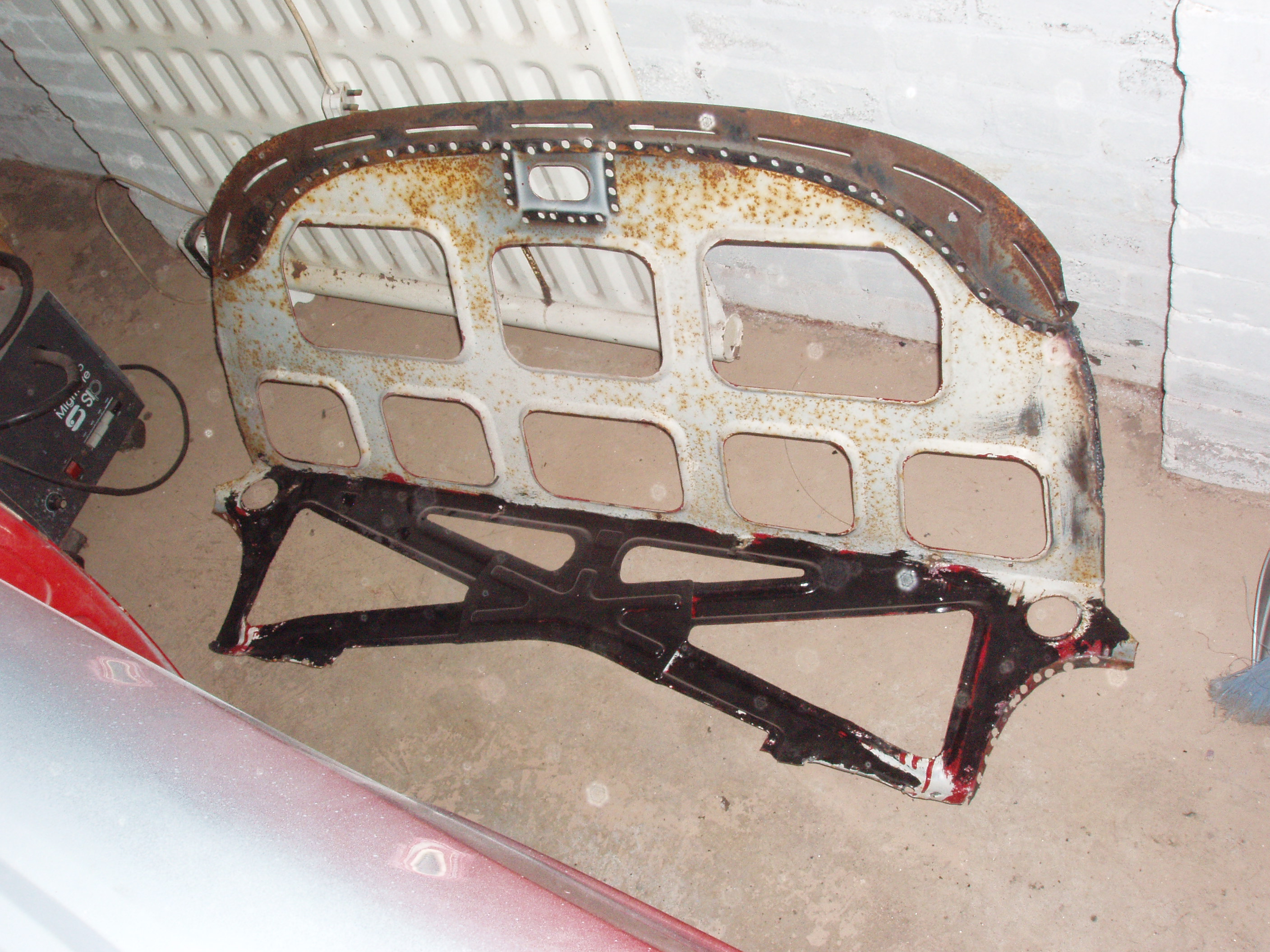

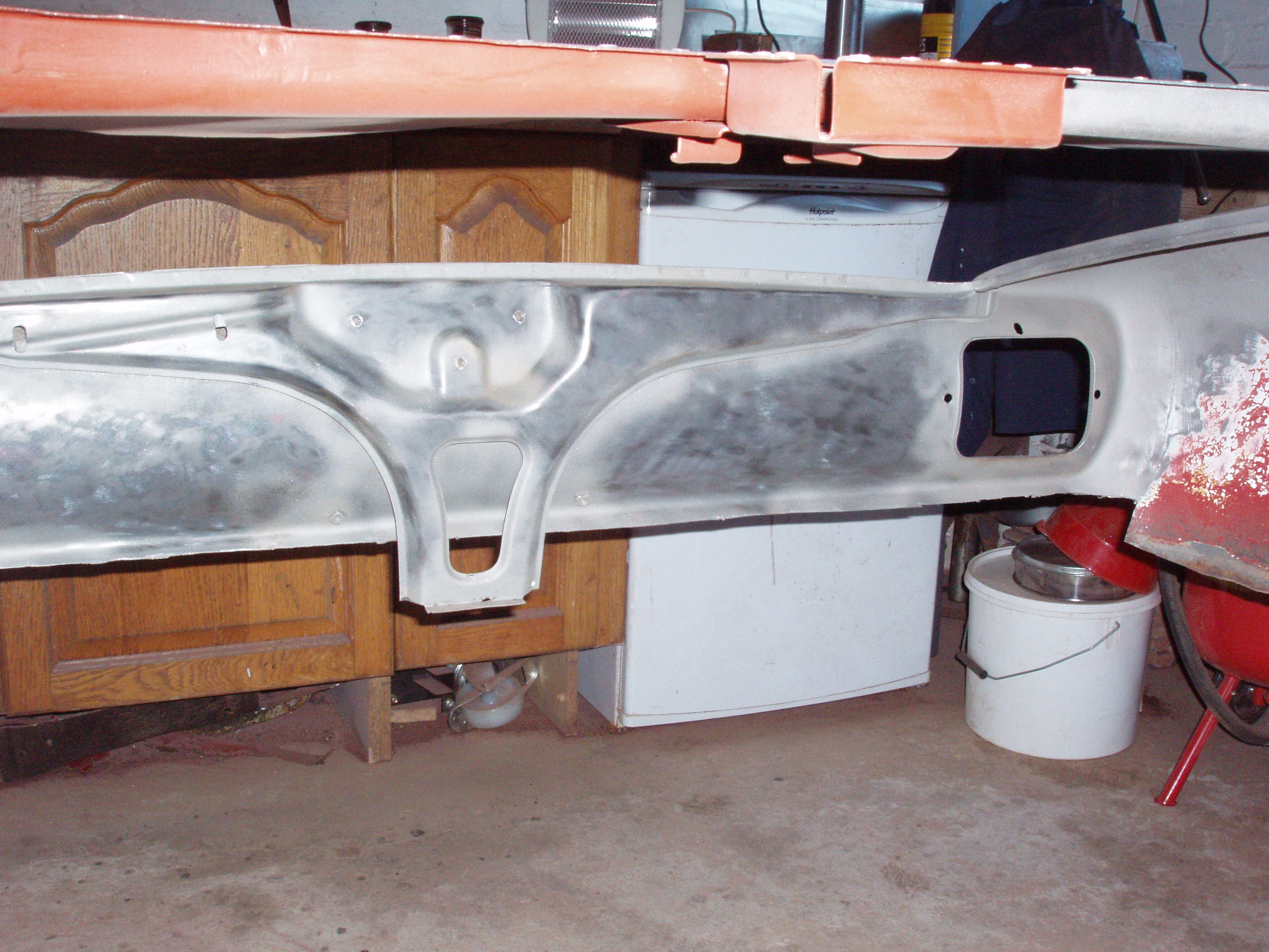

The replacement boot floor panel is a bit of a nightmare. When it arrives it isn't a fully formed panel, the side and rear edges are not formed, you need to trim and form it yourself. Also it's really made to suit the later cars and to fit in mine I had to add some metal and reform the shape around the wheel arches as they are a completely different shape. I made a full size template out of cardboard, transferred that to 12mm MDF and then clamped the MDF to the panel to form the lips. Sounds simple but there was much fitting, removing and adjusting until I was happy. Even after it was welded in it still wasn't right but I will come back to that later. Here's a piccy of the offending item getting the centre brace from the old panel fitted, it was weirdly rust free - maybe the heat of the exhaust protected it?
Before I cut out the old panel I thought it would be a good idea to remove the panel the supports the rear seat and forms the parcel shelf as it would give better access and it had some heavy corrosion along the back edge that would be tricky to fix in situ:-
Many, many spot welds. rust clearly visible on the underside of the parcel shelf. This is half off the bottom lip of the rear windscreen. Repairs started, cut of the the bottom edge and seam welded it so it can't happen again.

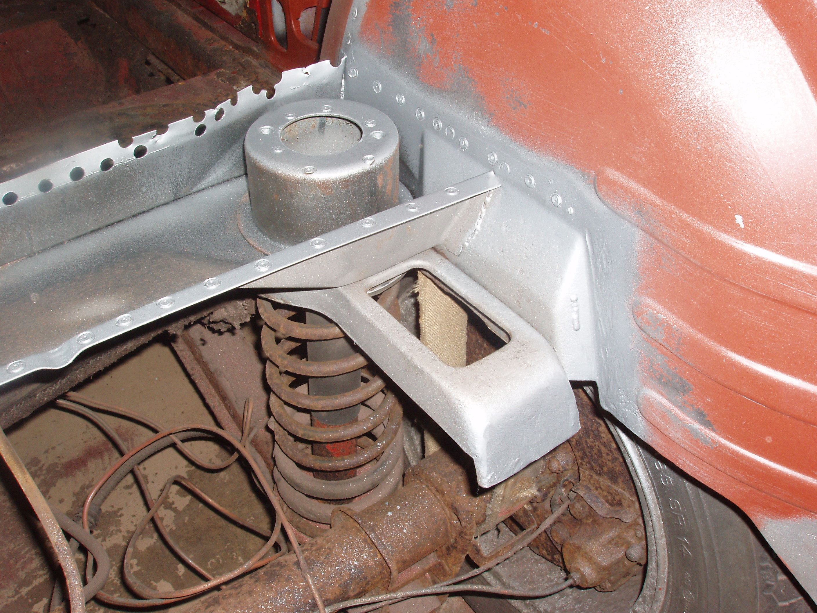

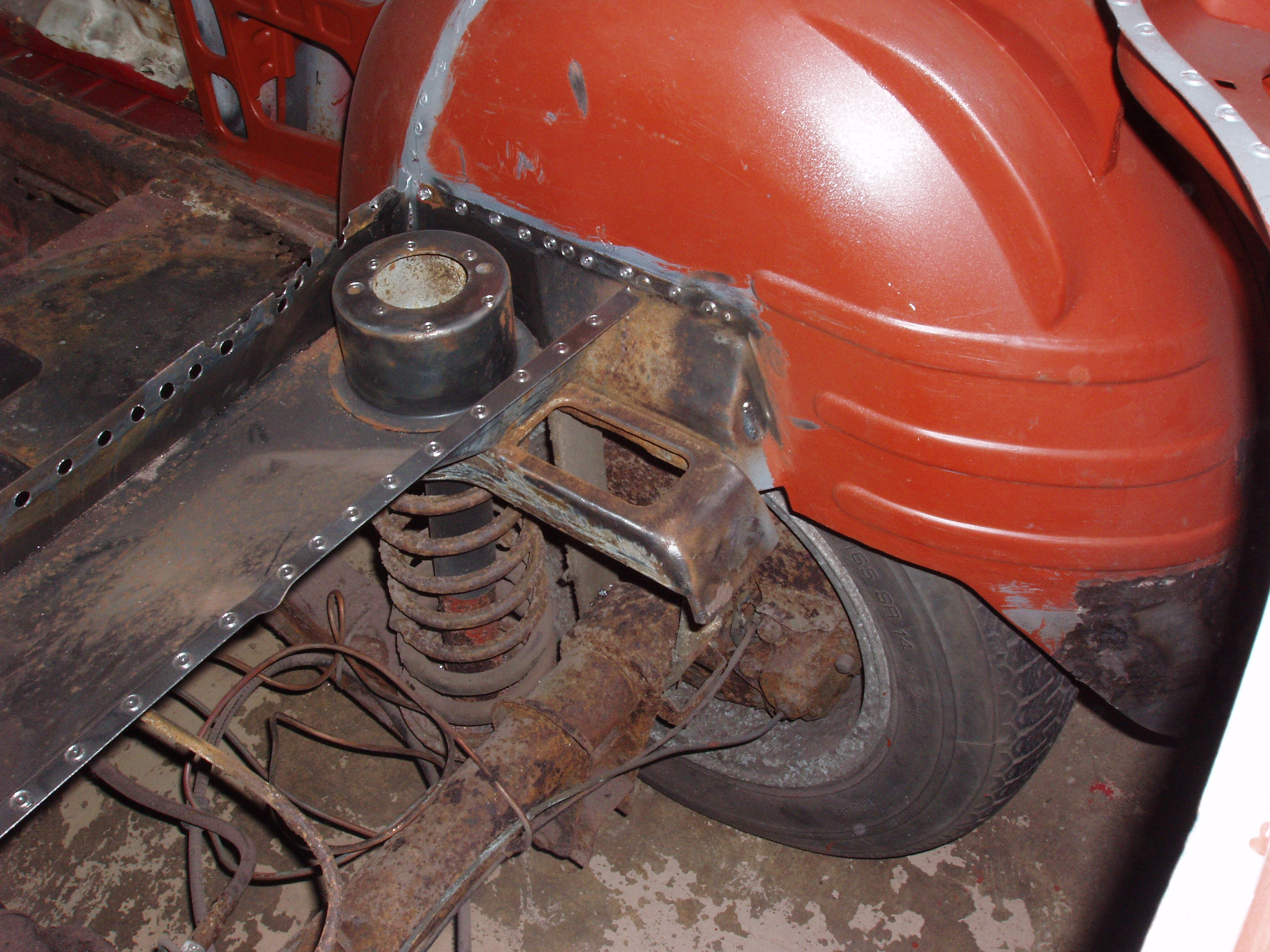

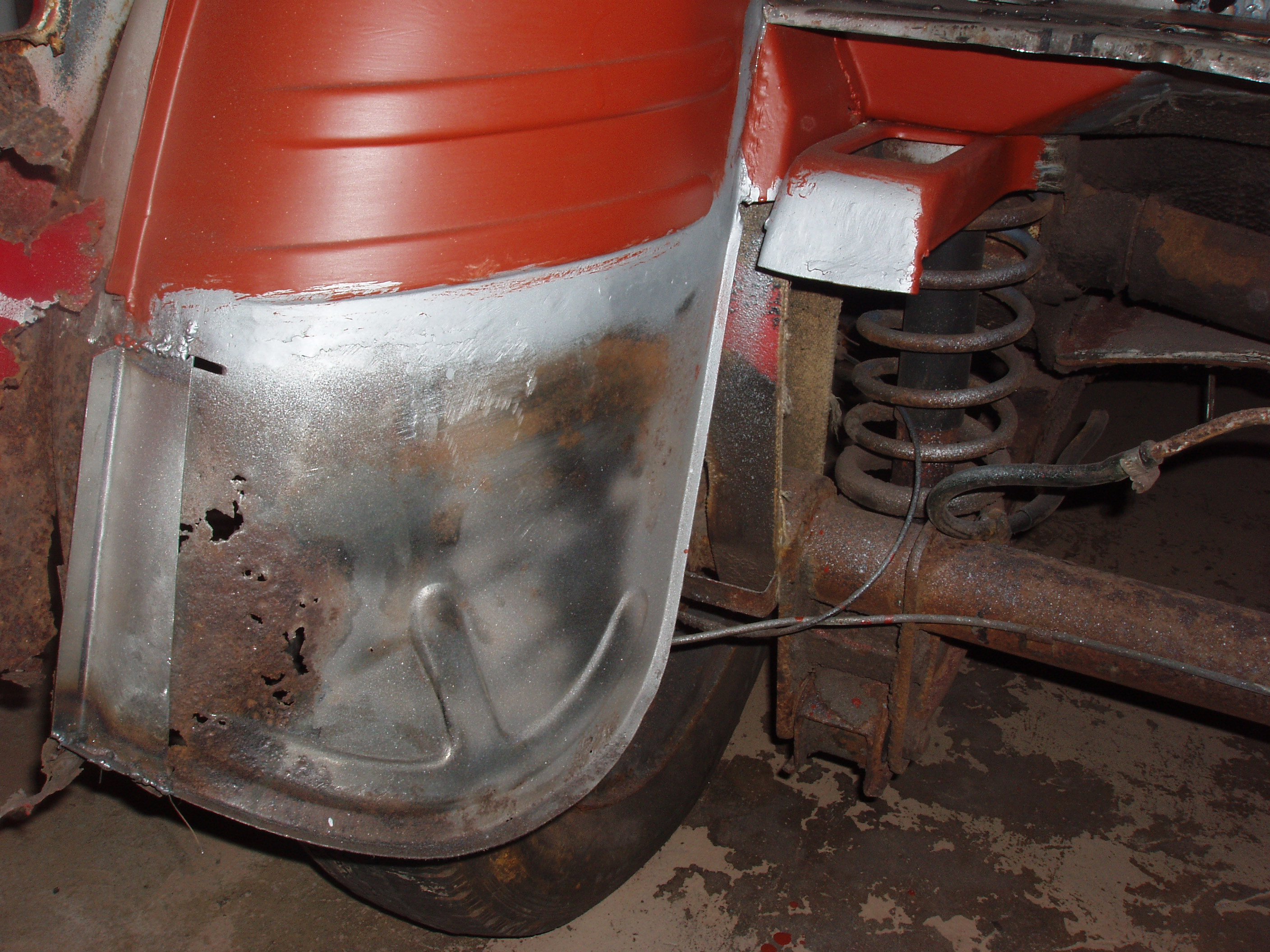

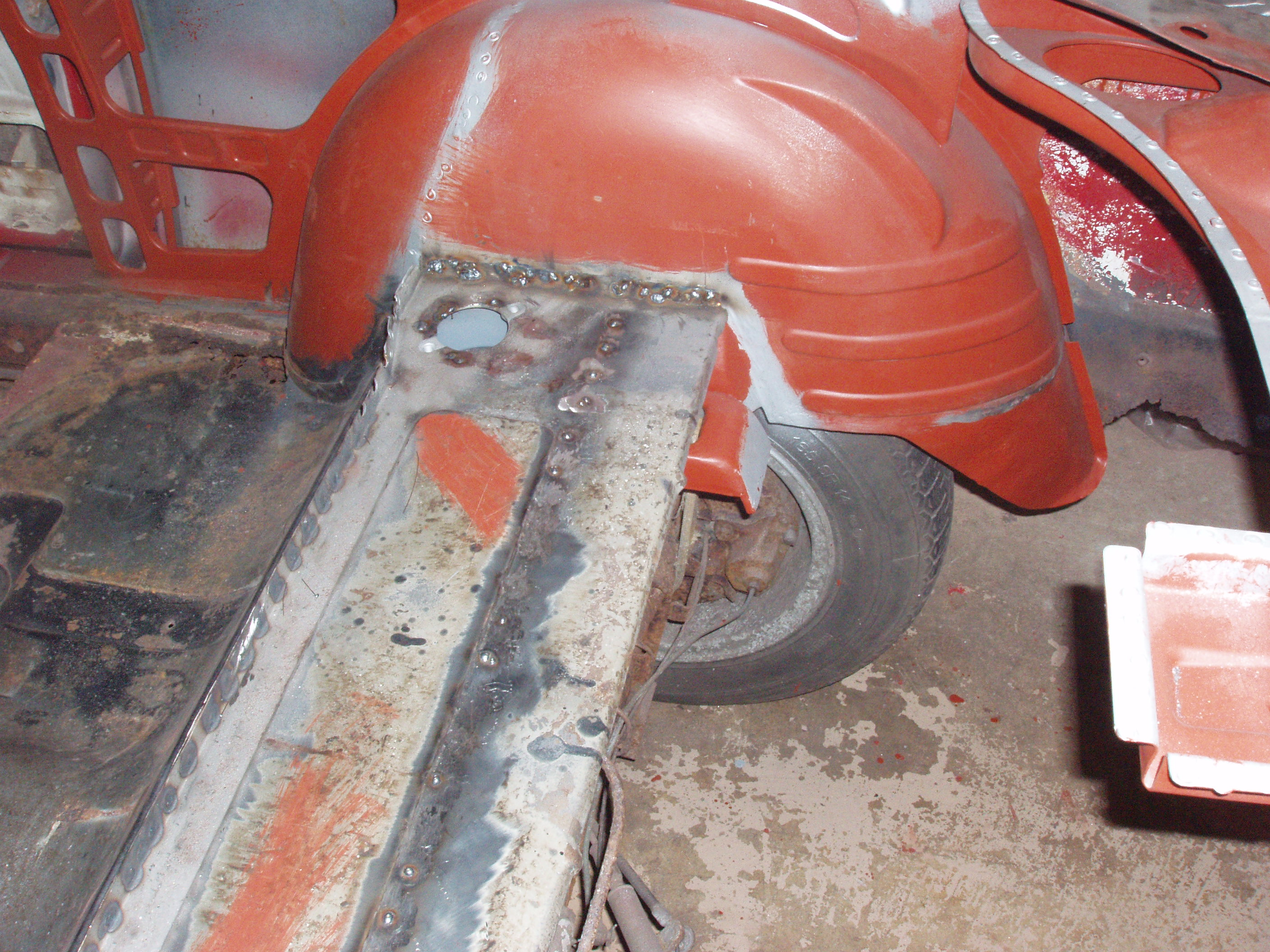

Once the rusty old floor was out I had to repair the bottoms of the inner wheel arches:-
Drivers side was so far gone I have had to guess the shape based on what was left and a friend's 2000 GTV until I can get a look at another car of the same age. Passenger side was still all there. With the boot floor out I decided to take out the top part of the box section between the wheels so I could remove any rust that might be hiding under it, as it happens it was pretty clean inside:-
Everything blasted and primed. Panel back in place.

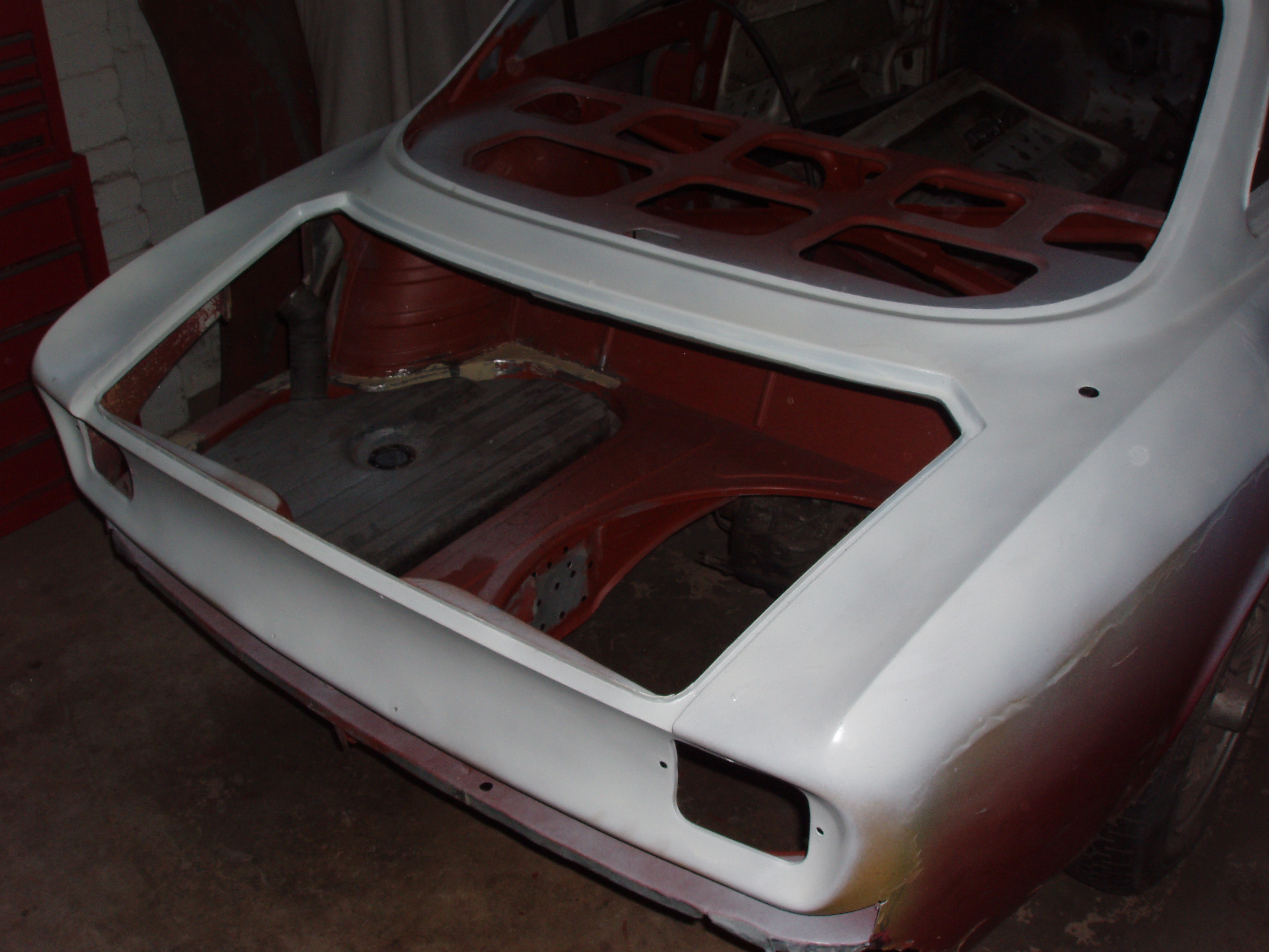

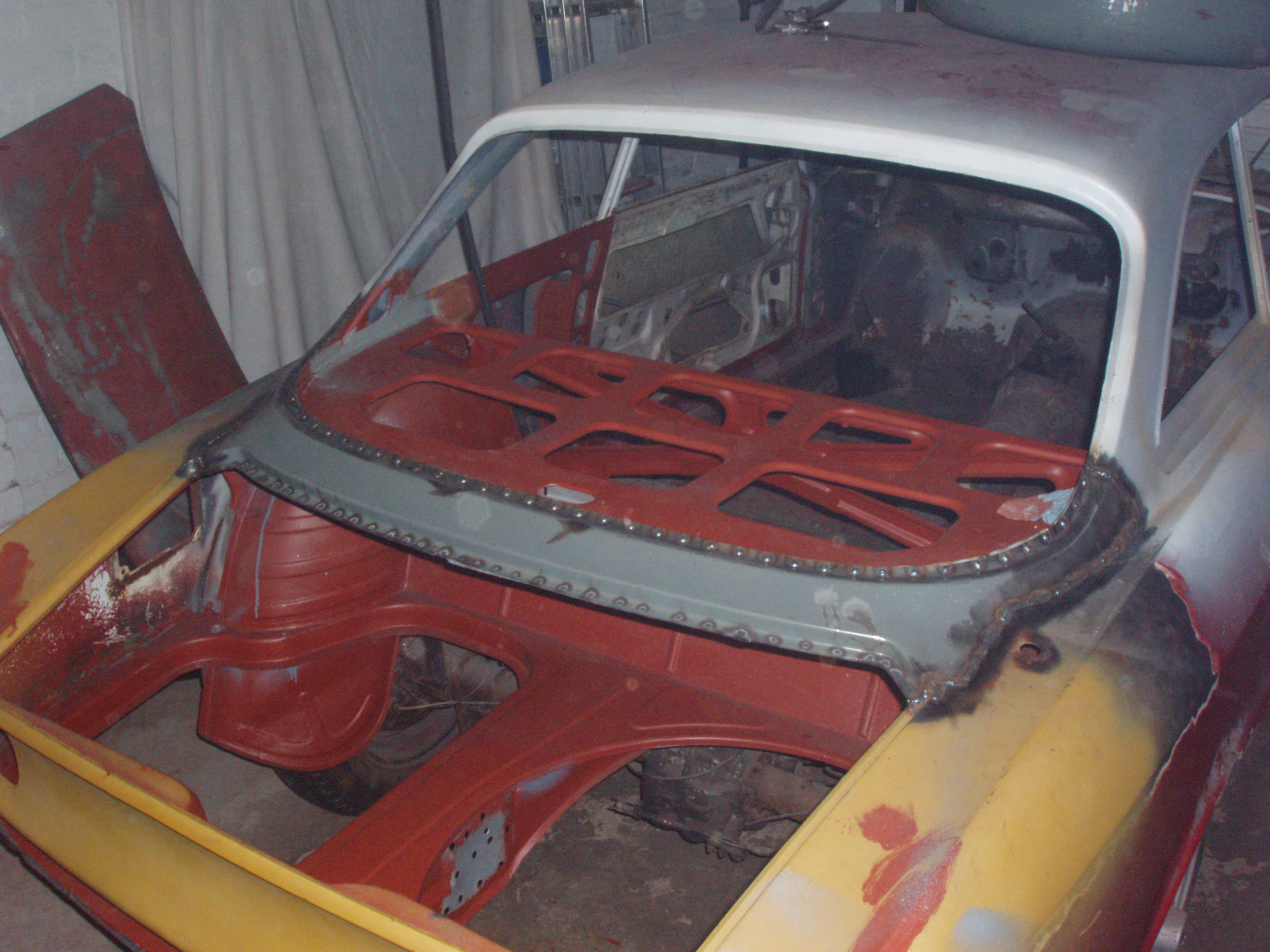

Rear panel stripped/blasted:-
Parcel shelf/Rear seat support back in:-

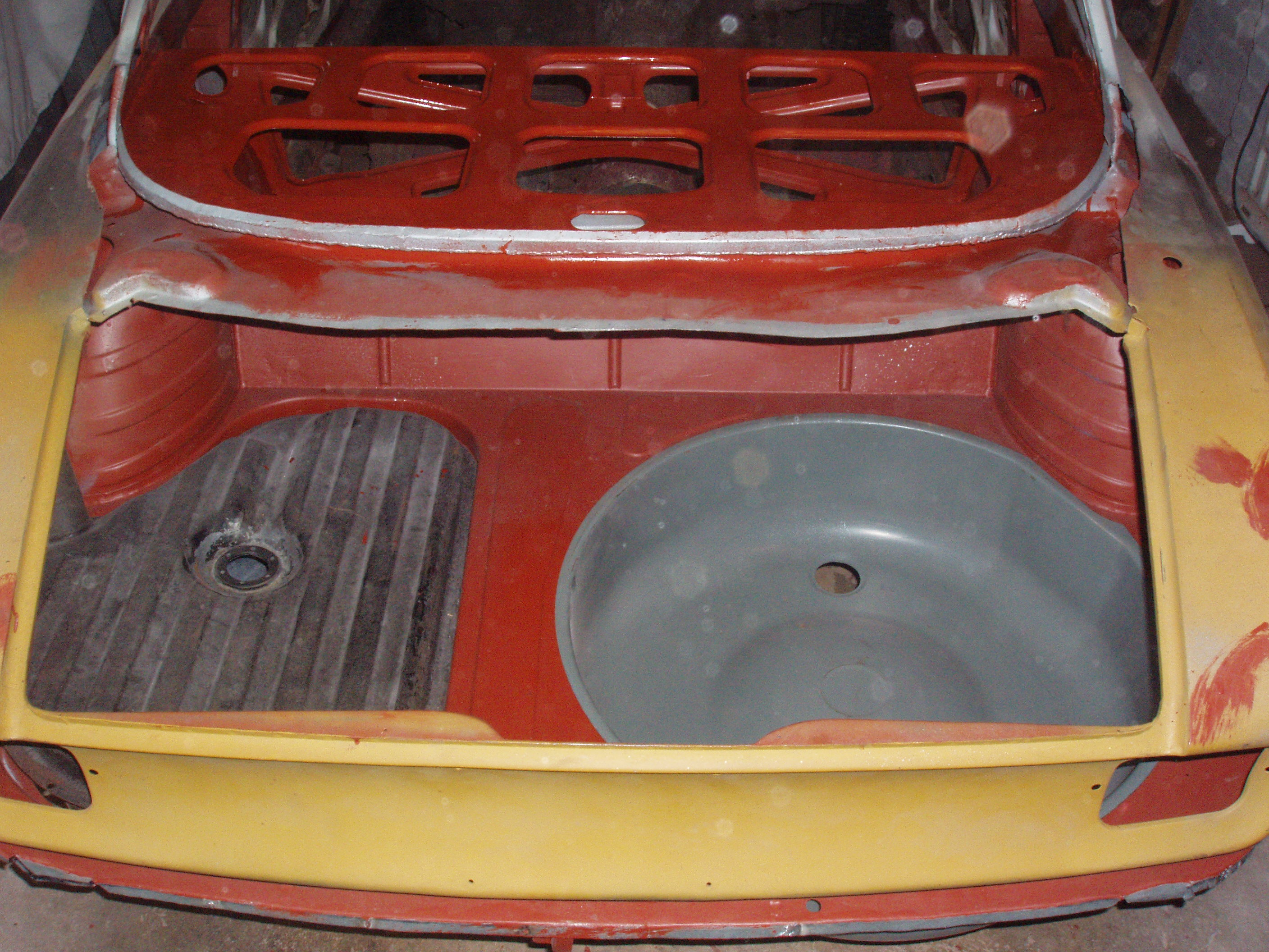

Boot floor in, primed and seam sealed so time to test fit the fuel. Doh! It doesn't sit all the way down onto the supporting lip.
After a phone call to Classic Alfa they confirmed them some adjustment is required to get the tank to fit. Some serious bodgery required and now it fits. Would have been much neater and easier if I had tested it before I welded the panel into the car

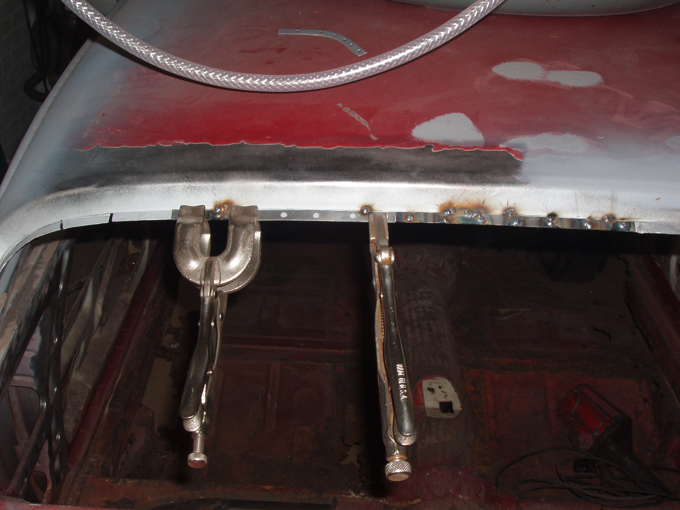

Rear windscreen scuttle repair panel in place:-
And finally how it looks today, not finished paint by the way just a temporary protective coat from an aerosol:-

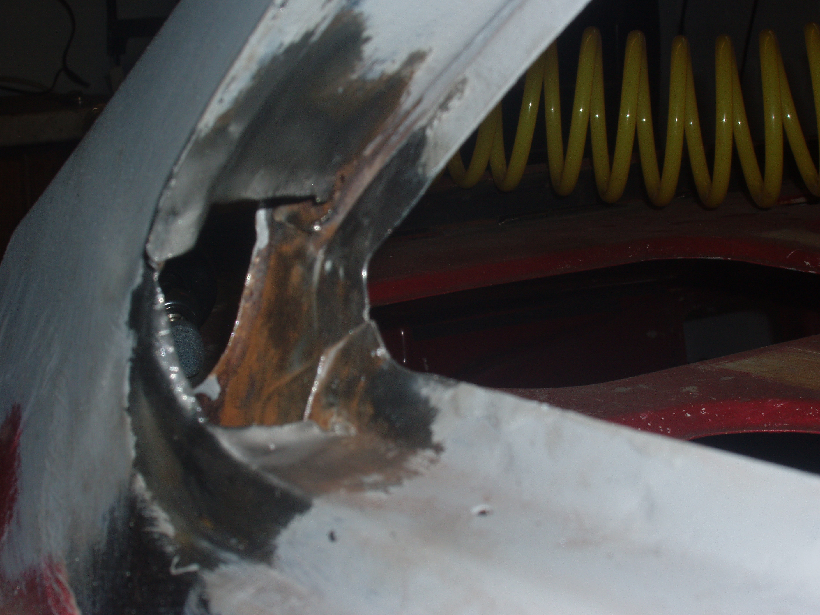

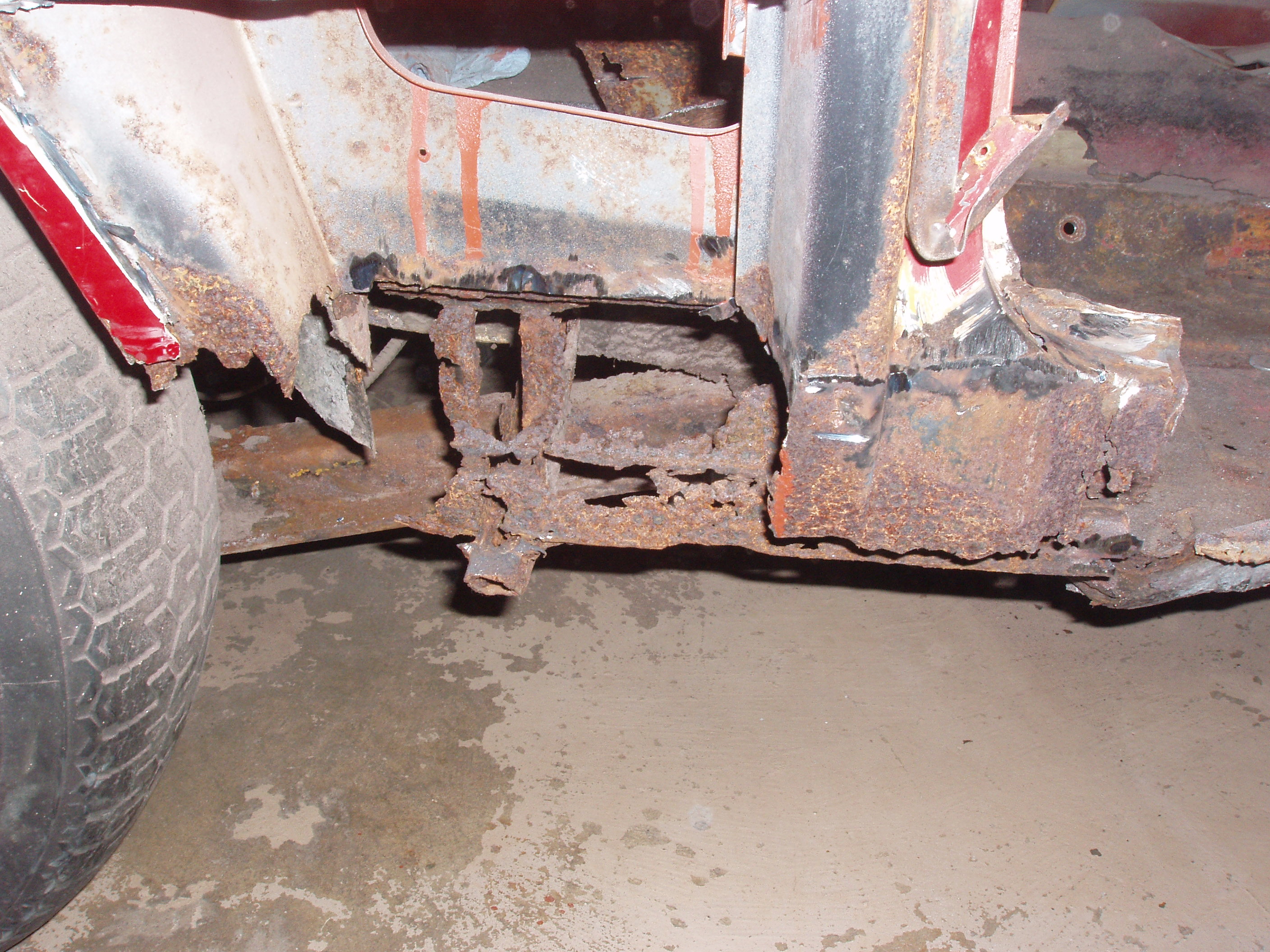

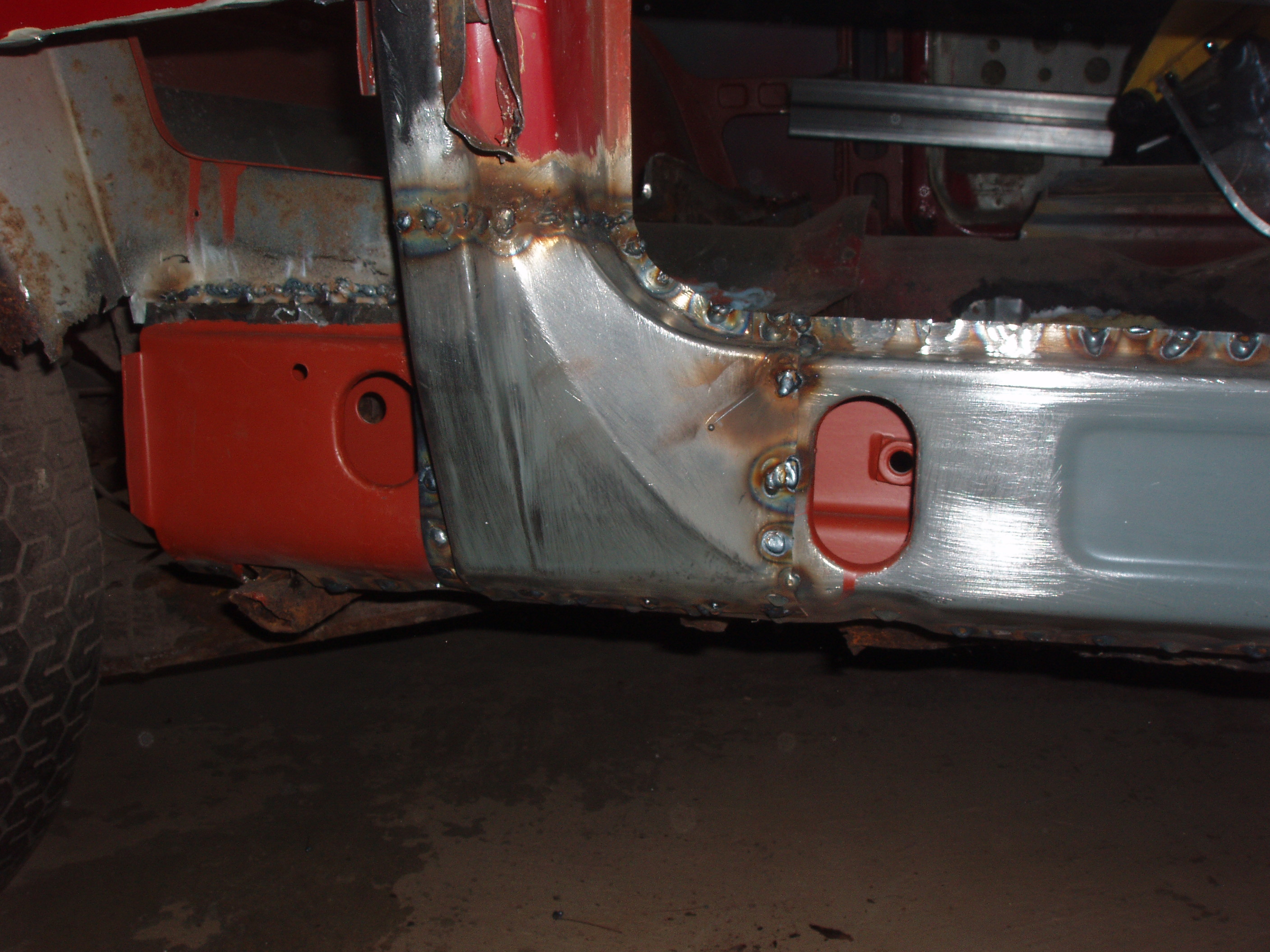

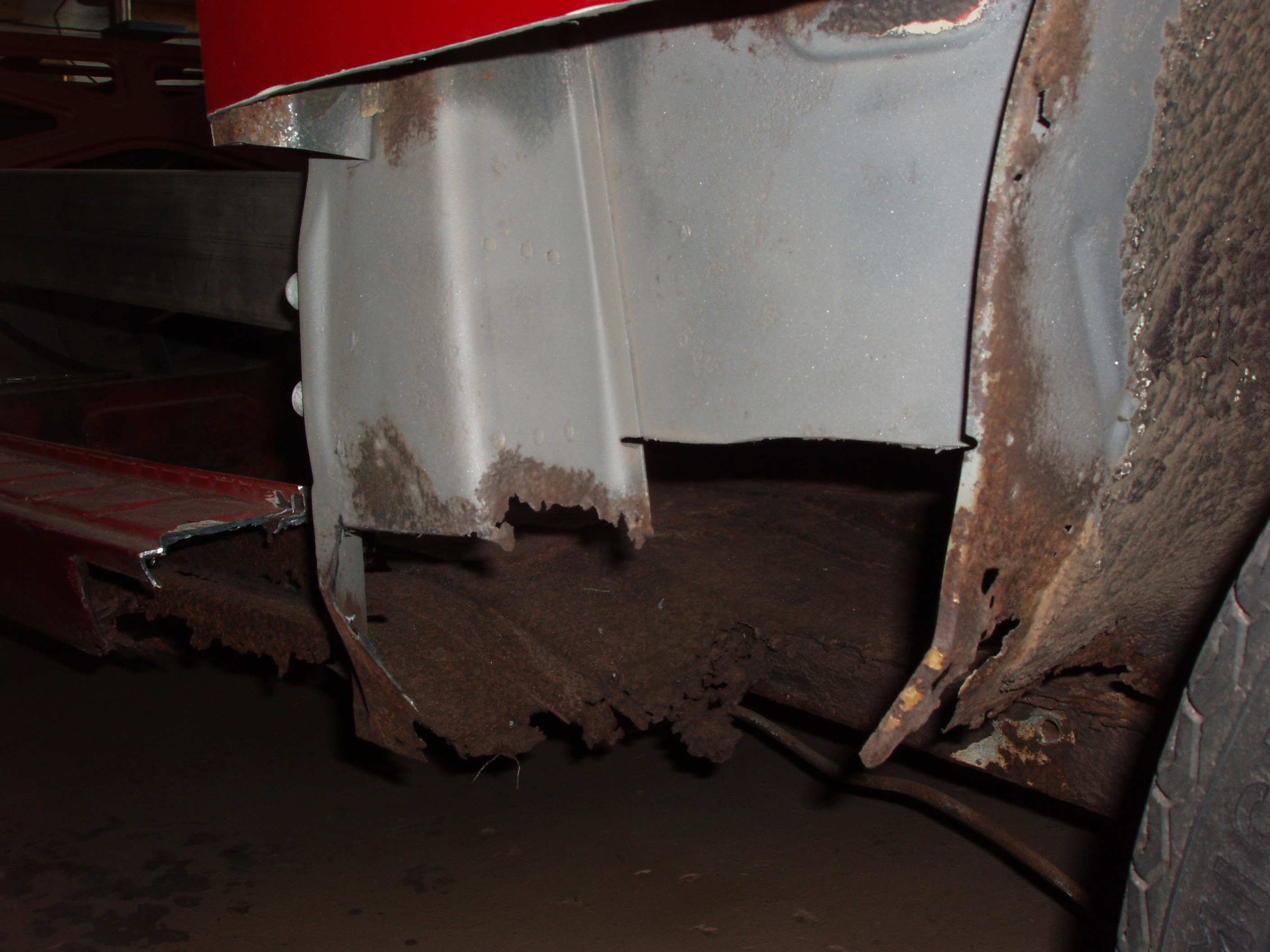

It's true that panel supply is great for these cars, a lot of cars that would be scrapped are restorable including this one. I don't think the prices are all that bad though when you actually see the quality of them. The six panels I have just fitted to repair the cill on one side have all gone on with the minimum of 'adjustment'.
I'm really impressed with the original design in this area, the A and B pillars fly through and weld to the side of the middle cill rather than just sitting on the top of the cill structure.
Remains of the bottom of the A pillar after shot blasting, still a bit more to be cut away. Shot from the inside shows the bracing I put in to maintain the door alignment. Remains of the bottom of the B pillar. Both A pillar repair pieces in place. Inner and middle cills in and B pillar repair piece. Some scruffy welding here because part way through my trust old welder dieded again and I bit th ebullet and bought a new one. It took me a few hours to get to grips with the settings on the new one. Outer cill is now on but no picture yet.

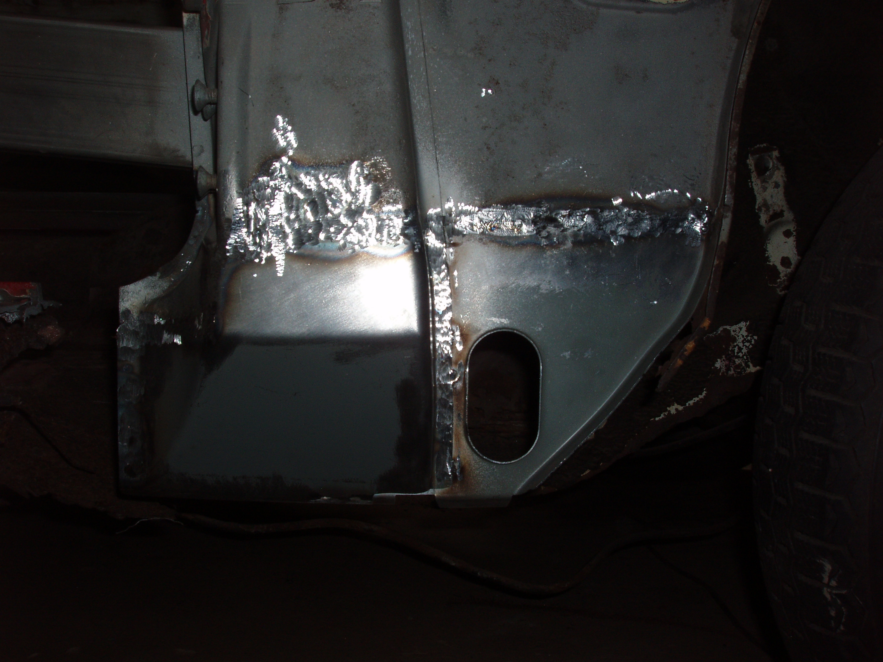

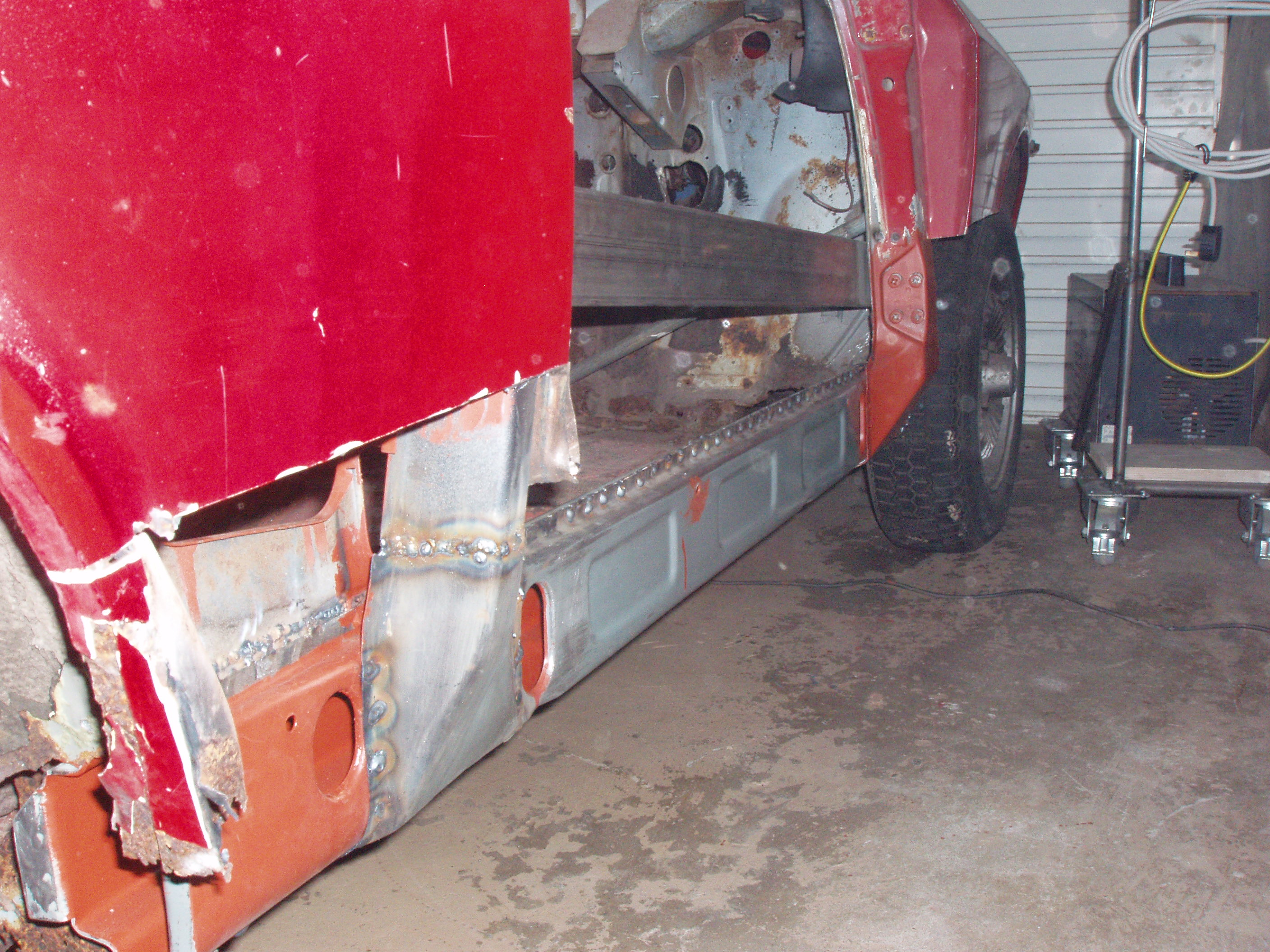

I've had a bit of time off the car to do some major work in the Garden, but got started again this week. I've begun work on the other sill now, starting with the A post. I removed a small section of the sill structure here and found it actually has 3 outer sills at the moment
This is the first sign of previous bodgery I have found so far, the other side was just the one panel that looked original. What's your personal best in terms of layers of outer sills?
