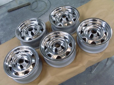

This is what mine looked like.
I saw those as well.
As Shrew says, it is possible to bring them back.

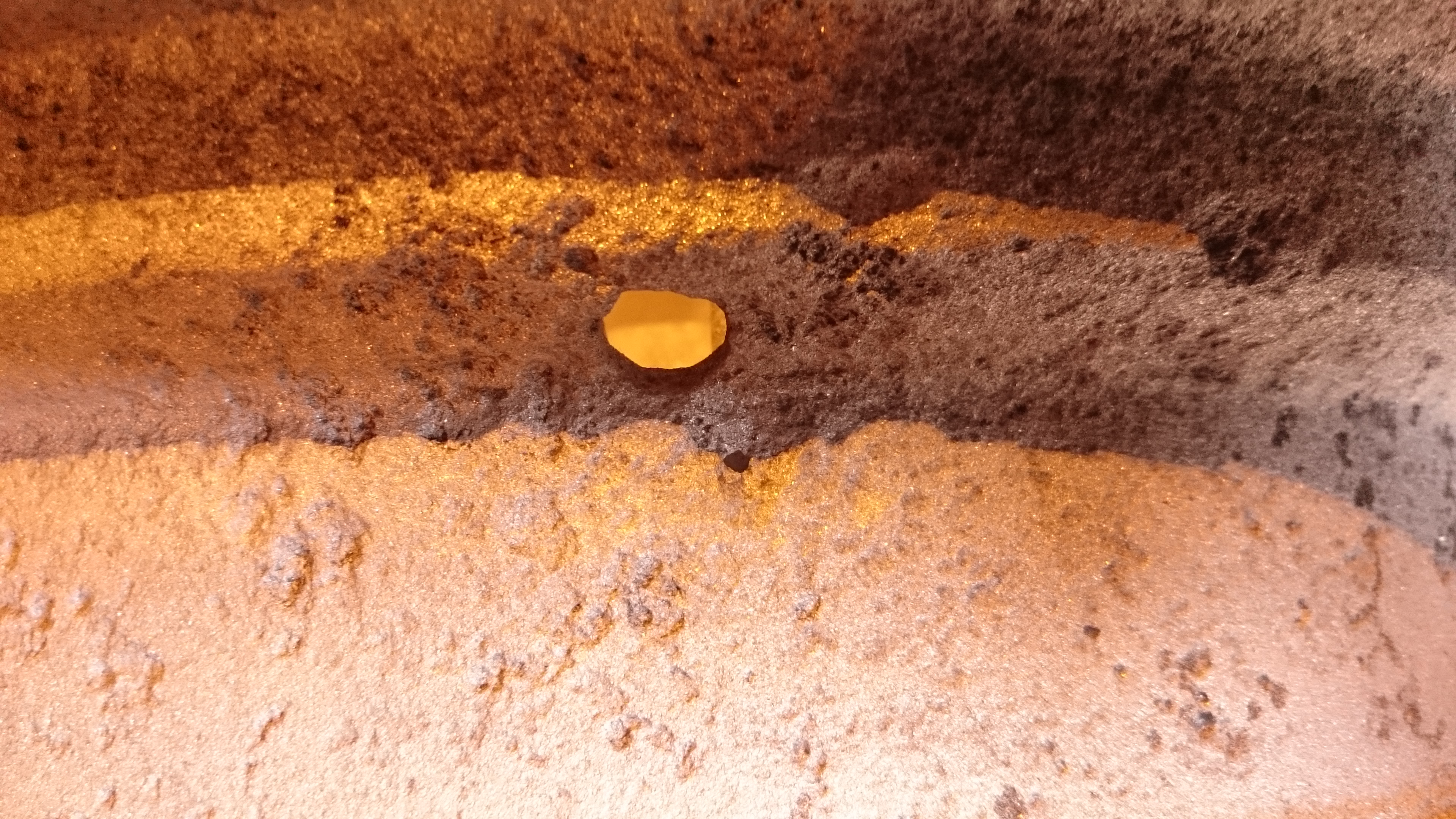

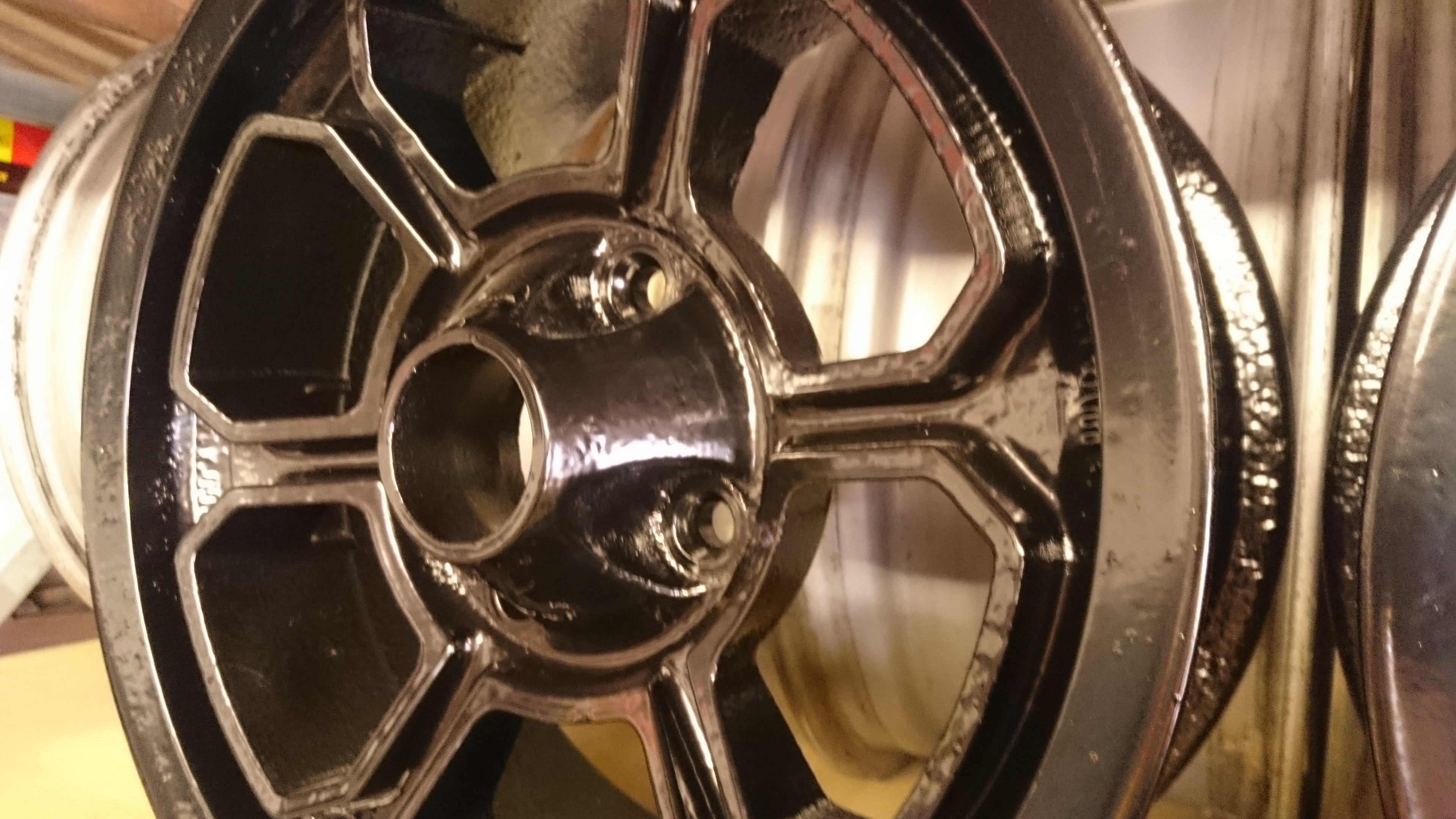

I'll let you have a little peek at just what grotty and corroded can mean.
There's going to be a thread on these so that i can disprove some of the horror stories surrounding Magnesium Alloy wheels, but this is just about as tough as this job gets.
Remember the Momo Vega's discussed a few months back?
Underneath the surface paint, they were corroded so badly that they've actually rotted through!
But after much hard work we're currently at this stage
Theres more work to do, this is still all undercoat and prep, and the final finish will be silver, and i hope that now my hand is returning to some semblence of usefulness i can get cracking again!

Shrew, I take it that undercoat acts like a primer.
They will look nice wheels when they are finished.
Pleased to hear the hand is fixing now.
Re: Alloy Rims on Ebay
Thats it Keith, a bloody tough primer!
Start with a high zinc content plain black, and apply coats with sanding in between until the lows gradually fill up.
Can't keep going forever, and there's always a lot to sand off again, because if powder coat builds up too thick in general, and cooked over and over it will eventually go the other way and become a poor substrate with less adhesion to the base meterial, so when wheels are really bad and the corrosion really deep, there has to be an acceptable level of compromise with the final finish.
That said, there's nothing stopping us getting it as good as possible with powder coat, and final imperfections can be traditionally filled, sanded, and wet painted over the top.
Wet painting over a good powder base can look stunningly good actually
