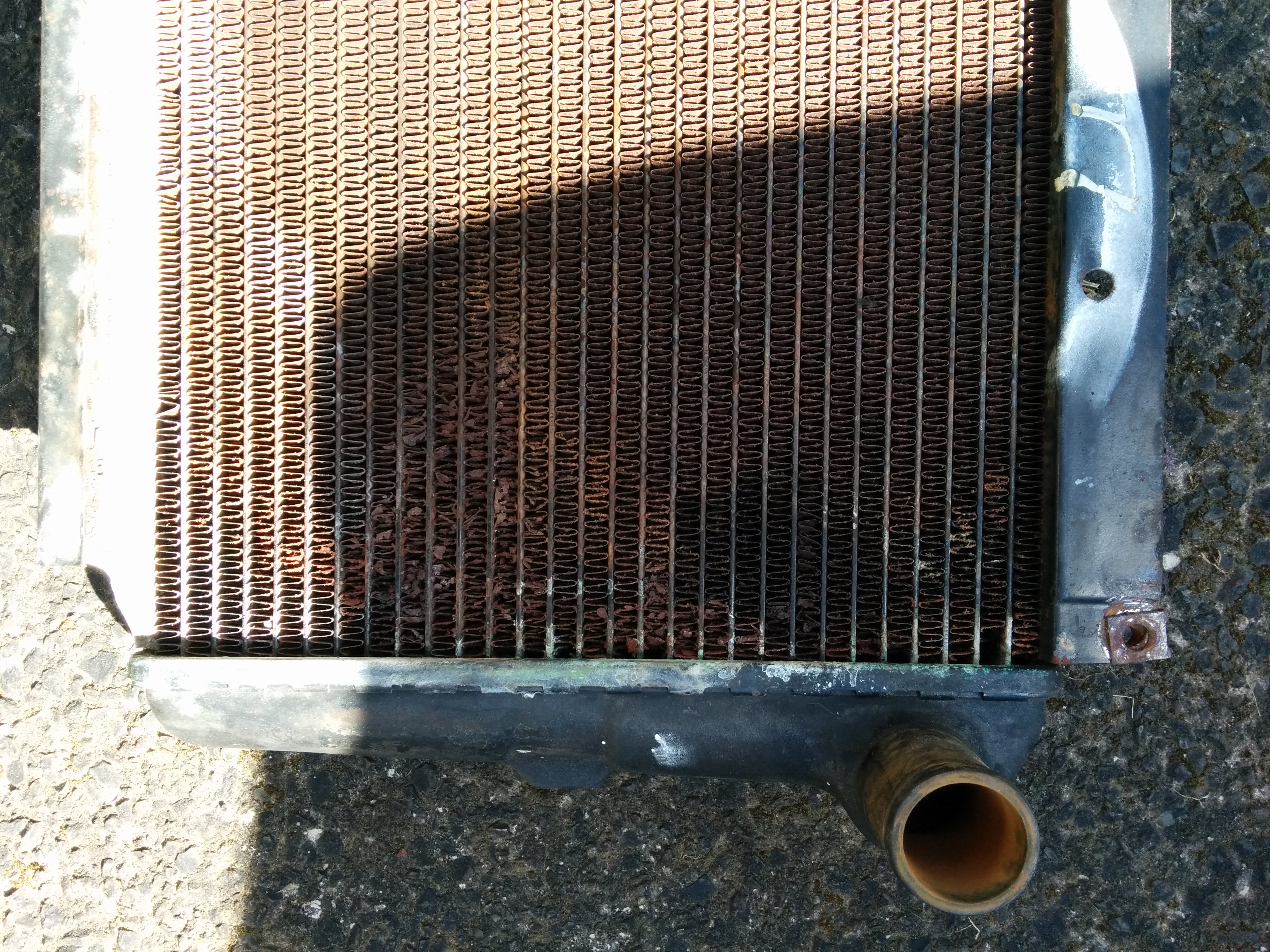

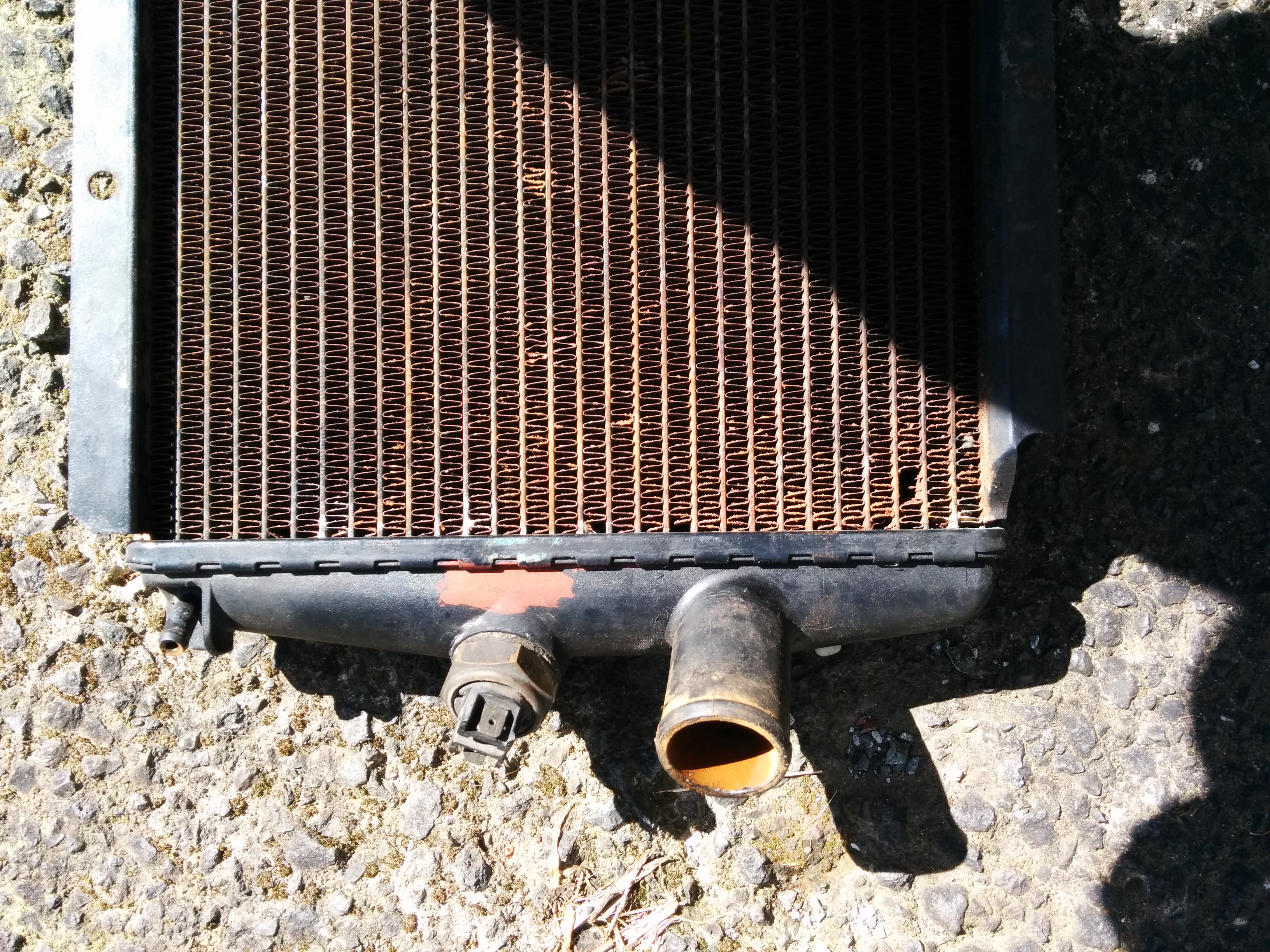

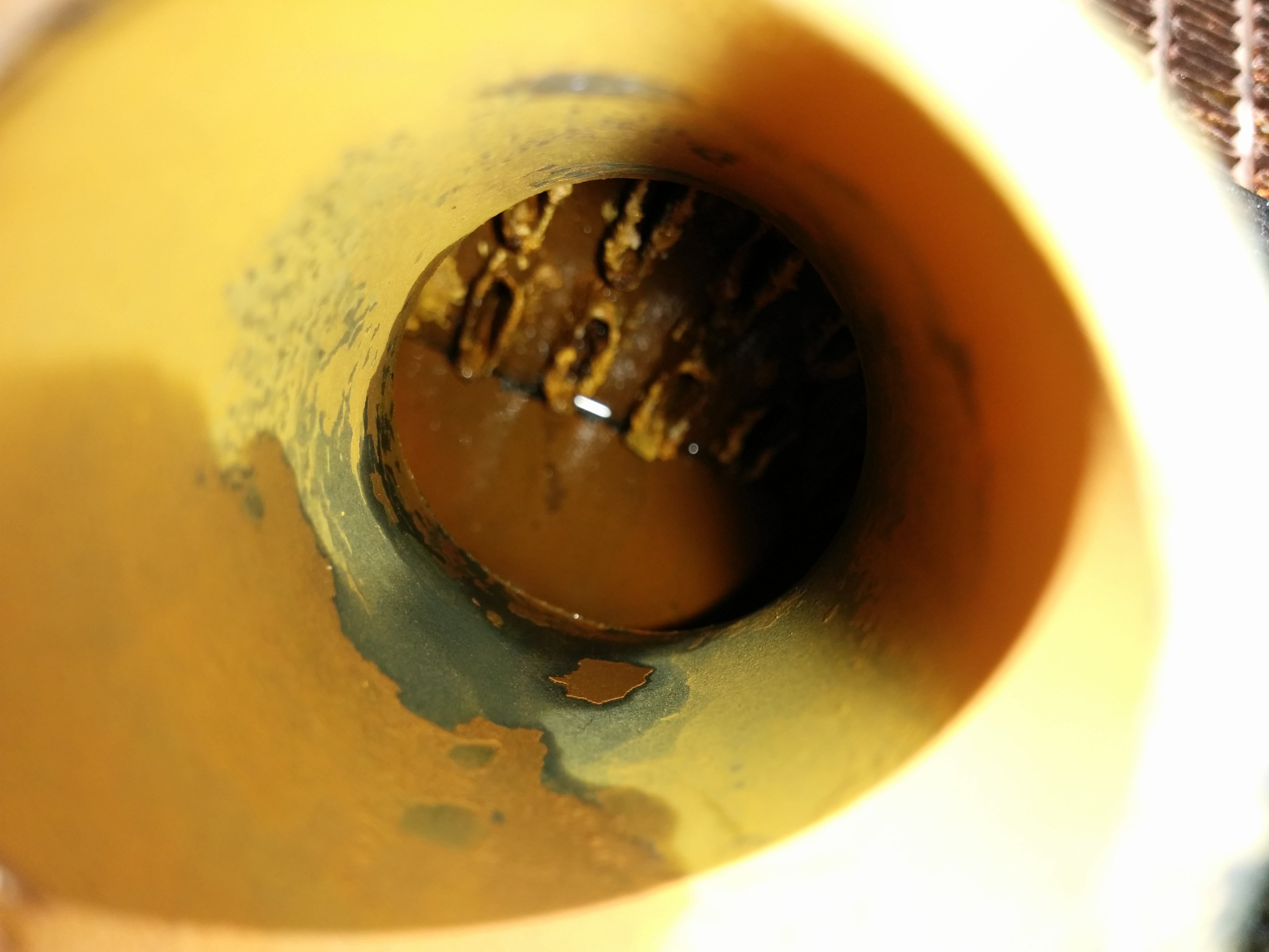

Having a look today I could feel a mist of water in the engine bay. It seems the radiator has a few pinholes. I took it out and it looks very rusty inside.
Time to find a new radiator i suspect. Is it worth getting recored or replace with a new one?

photographic evidence
Re: My sud overheats
fins look a bit beat up too, that loses a fair amount of efficiency in the rad.
