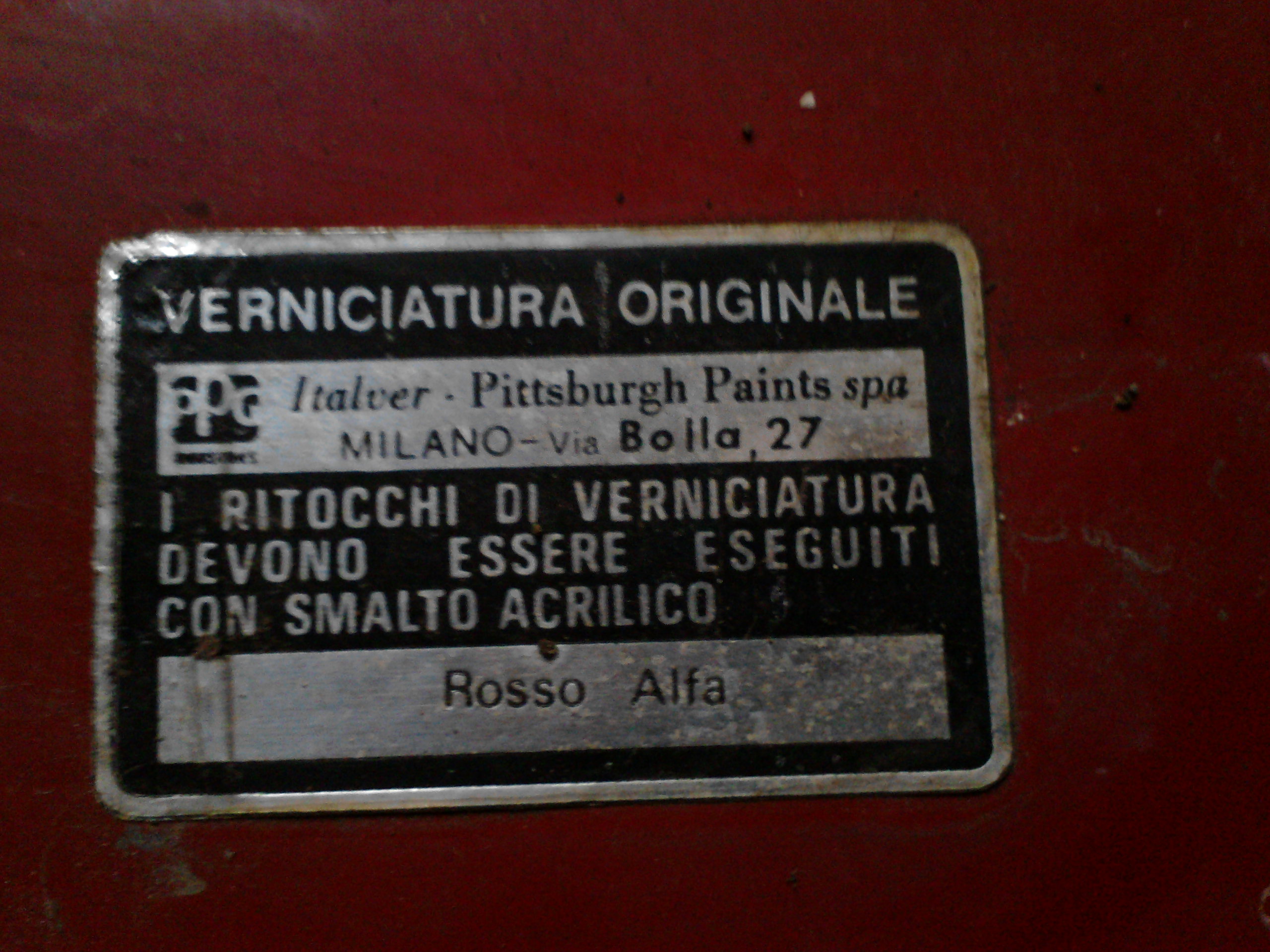

Any more of you got an original one ? I have a feeling on the cars with a boot i.e. pre hatchback the sticker was in the boot
Yes Series 1 cars had the paint code decal on the inside of the bootlid, all the series 1 cars I have every owned have always had either Magneti Marelli or Ducellier ignition coils, never a Bosch so it must be the SIII car that had Bosch coils maybe, anyone got a SI car with a Bosch coil?

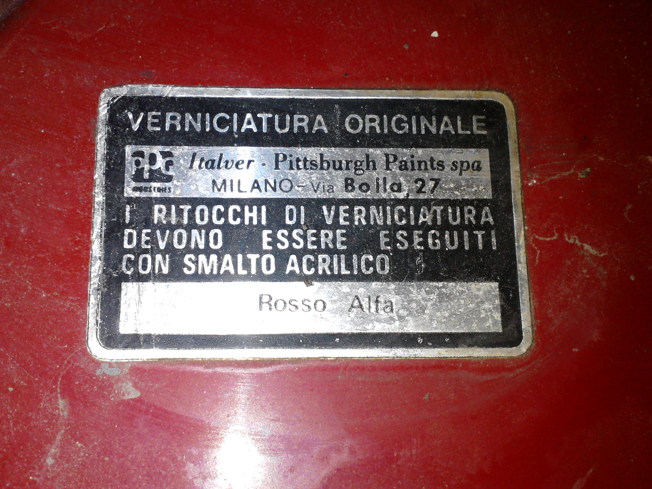

this is the sticker on the boot of the S1 sud ti, seem to remember john saying it was a '75 or '76 car.
vecchioalfa
Posts: 433
Re: TIx Restoration Project
Post by vecchioalfa »
That's the same as on my car Kev, may 1976. I think they may have varied a bit depending on who made the paint at the time, PPG / IVI etc.

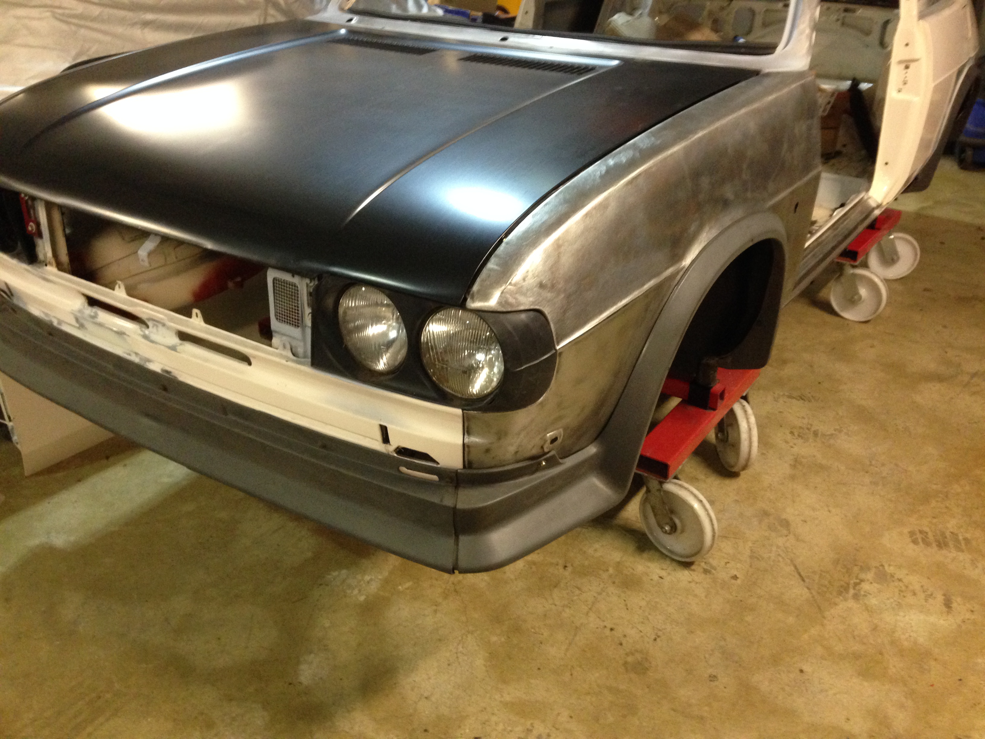

The shell went to be painted last Saturday - before it went has quite a few trial fits of all the panels and in the end I had to fit a new wing to the left front as well but not the new door - saved the original left door
Looking back at the pictures of the dent repair to the left front wing that was on the car I wonder now if the car has had a new wing before and it is a pattern wing - the primer is not the same as the rest of the car - it just would not fit properly to the front panel but as soon as I tried the new genuine wing it fitted fine - this was ok apart from having to then make all the holes in this wing as well and also strip it back to bare metal on the outside due to surface rust in storage

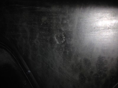

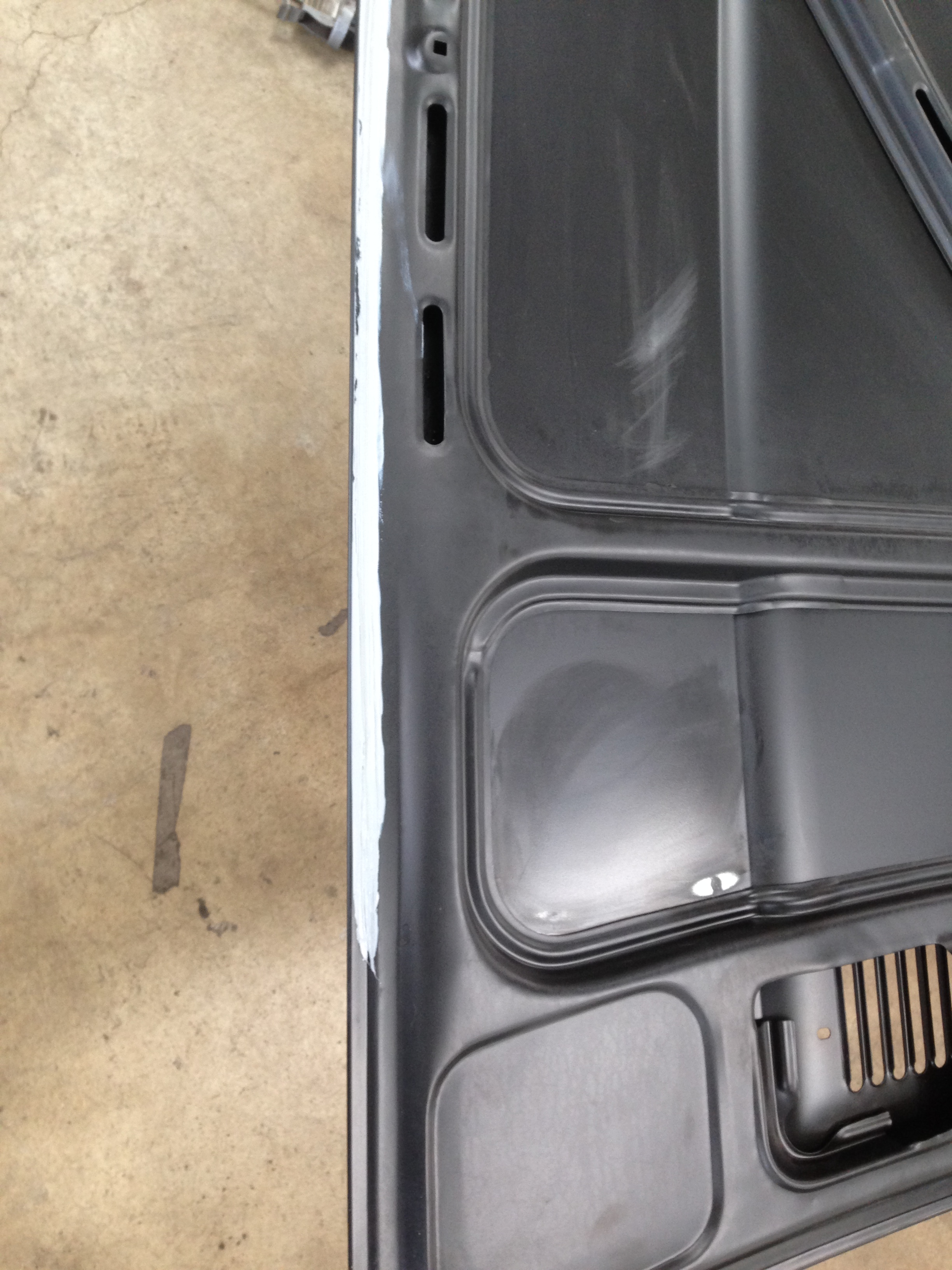

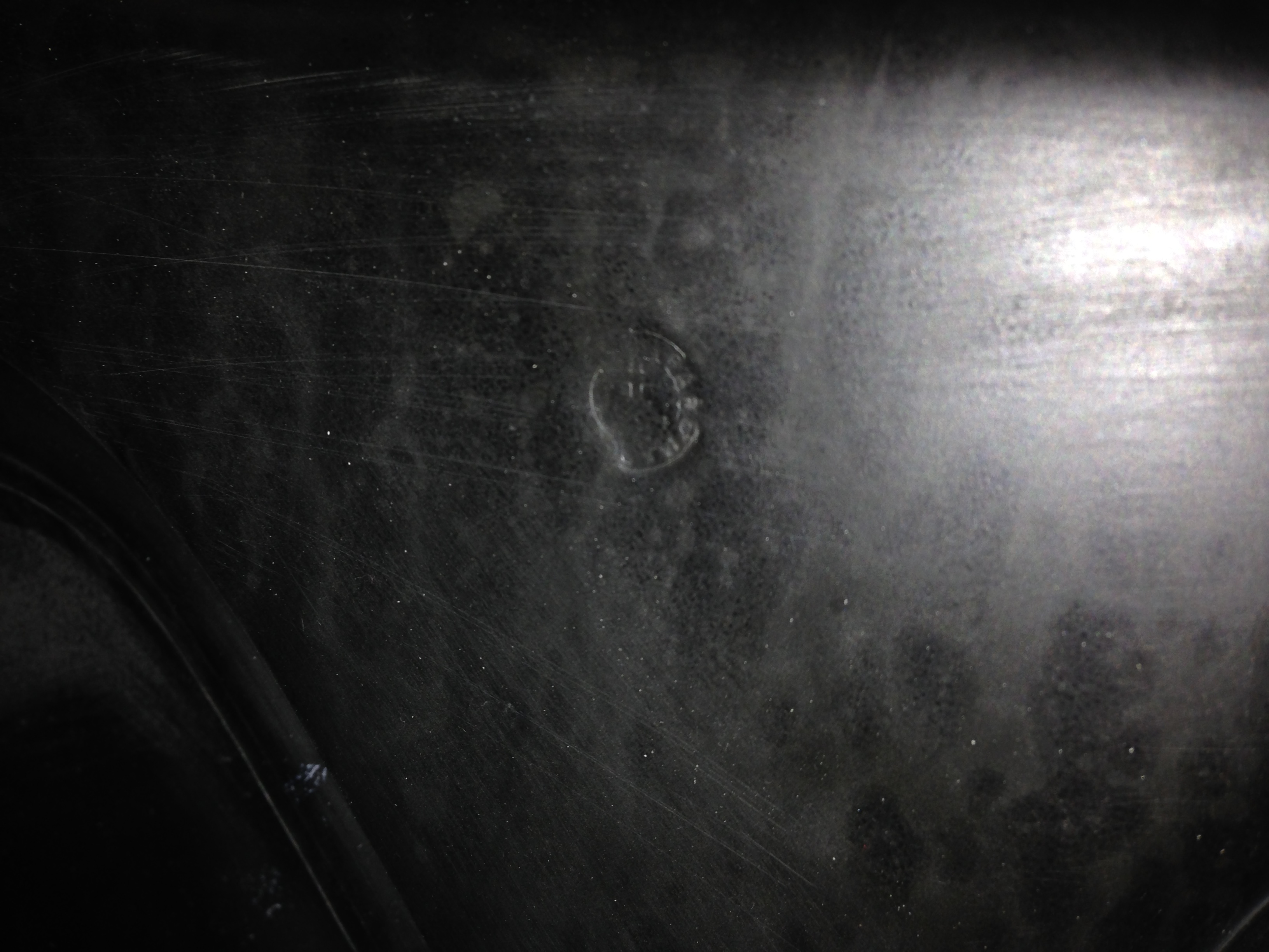

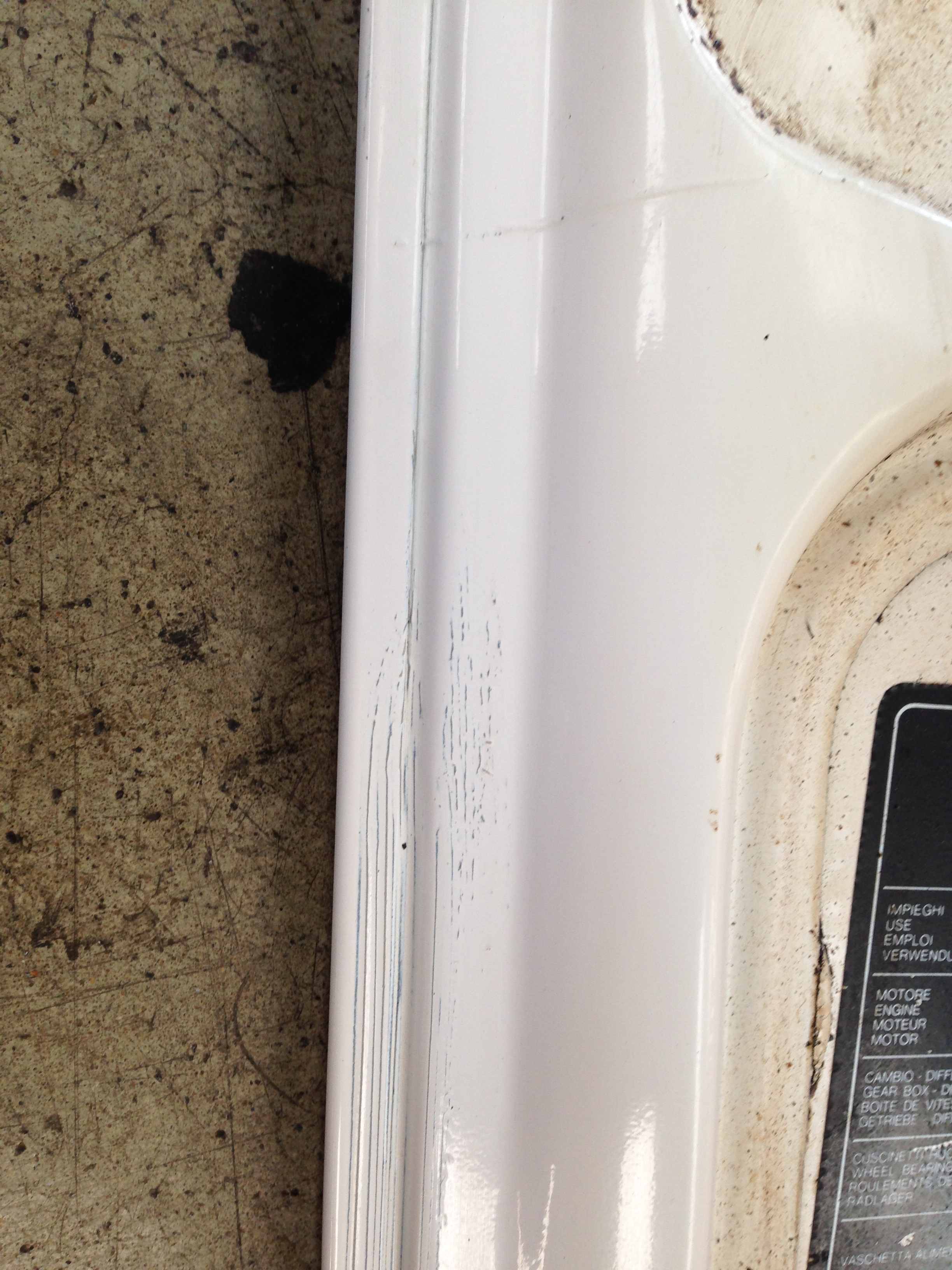

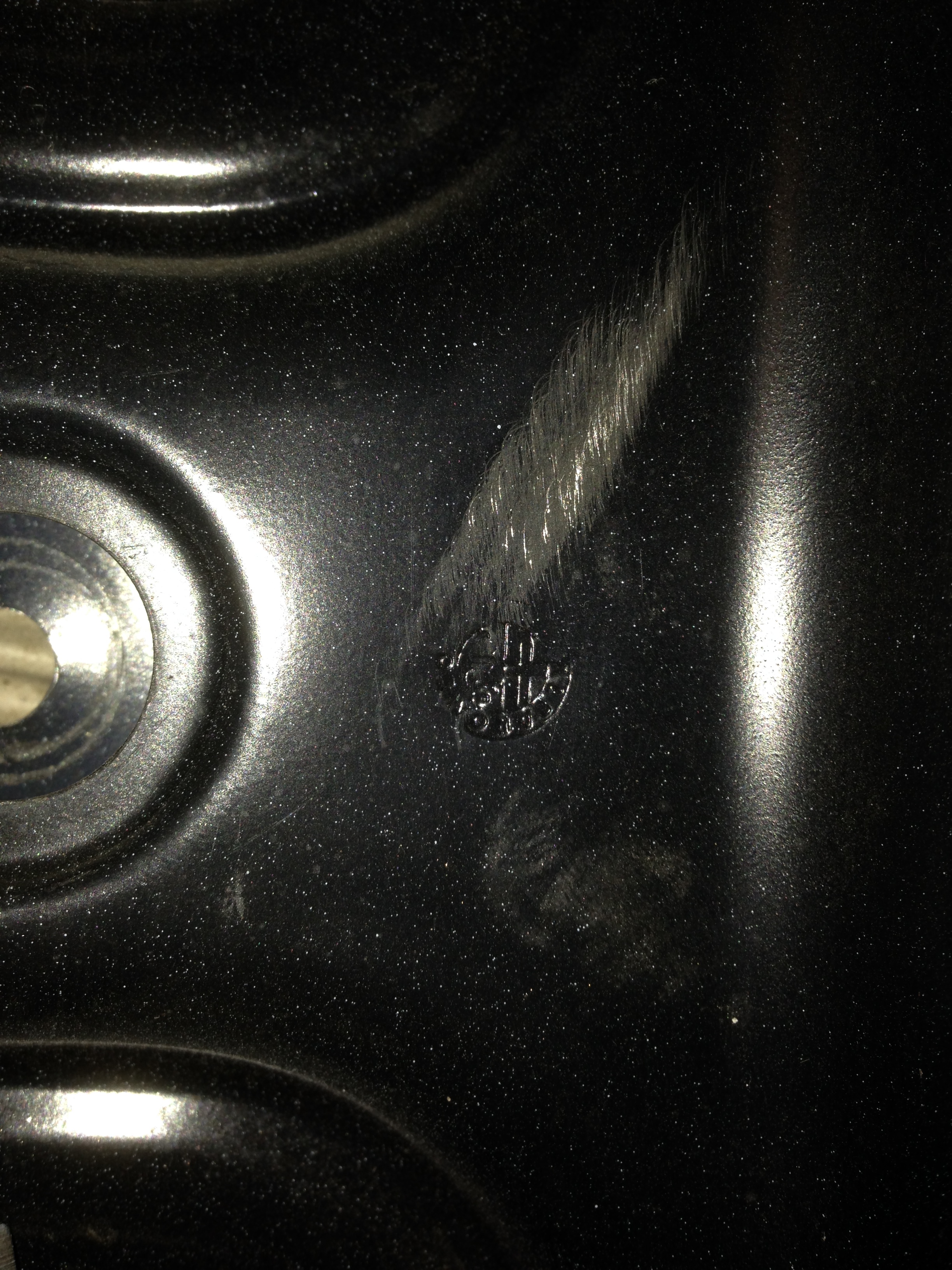

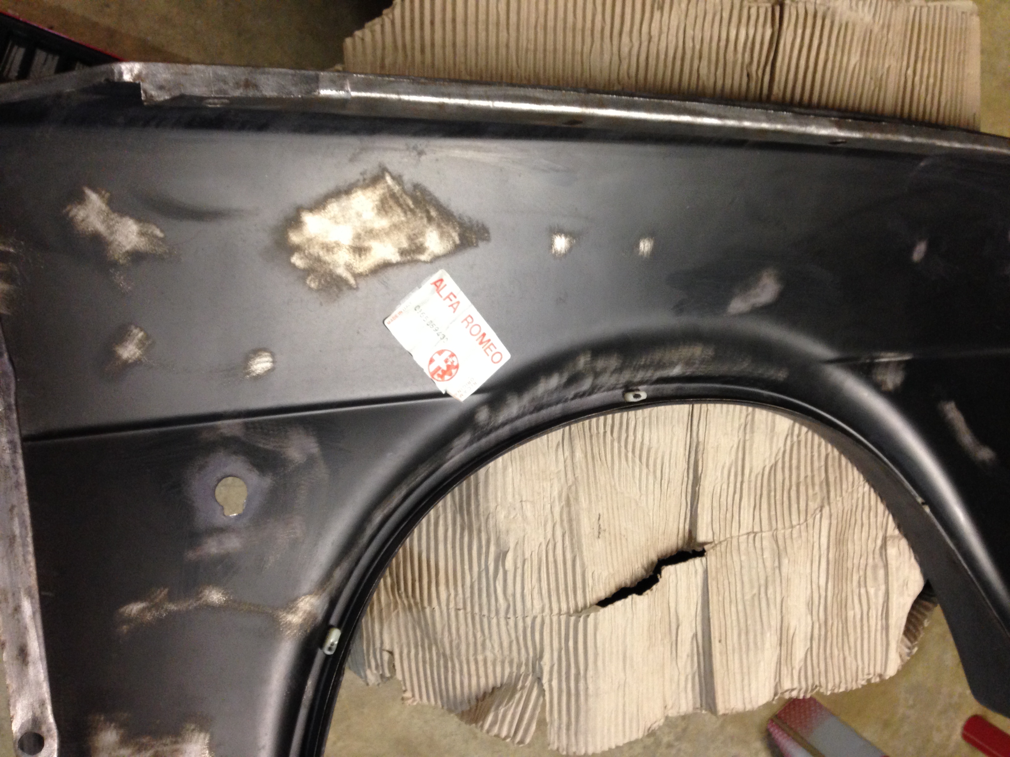

One thing I did notice on both the new wings and the bonnet and tailgate is that the new panels have the alfa logo stamped into them - this was not on any of the originals so maybe this was only on panels supplied as spare parts ?
Not sure if anyone ever made pattern bonnets or tailgates but if anyone is looking to buy a new wing and is not sure if it's a genuine one or not this may help

Left front wing fitted on with nice even gaps now

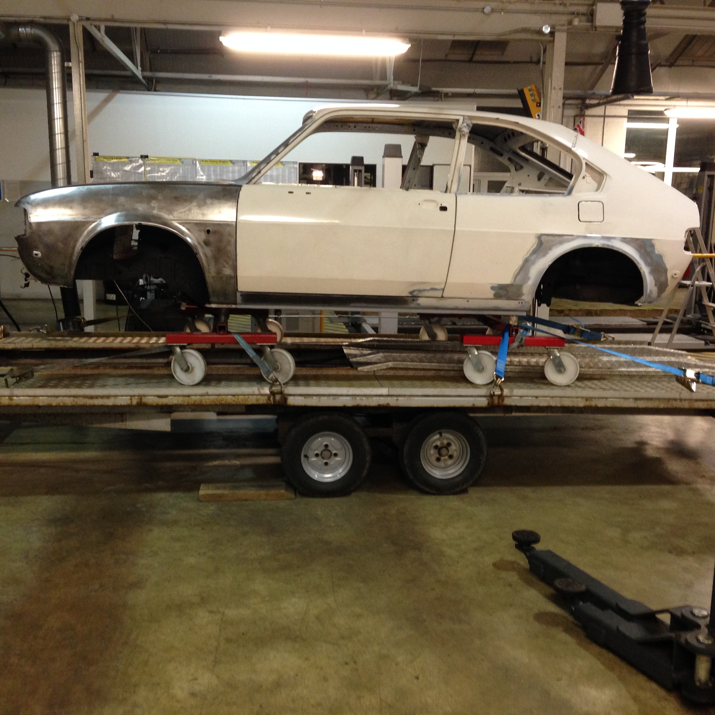

All of the panels will be removed again for painting of the edges etc. but at least I know that they do fit now

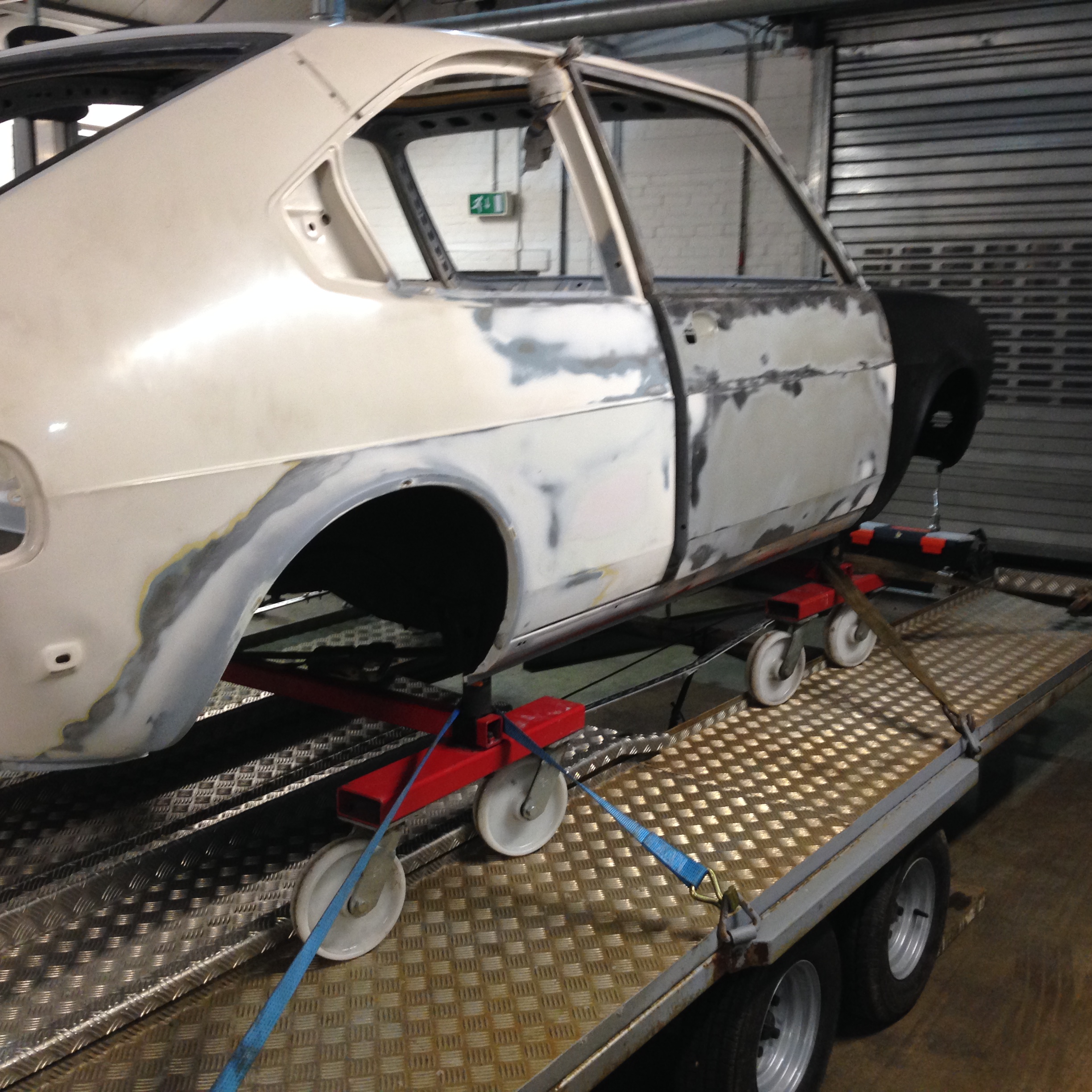

All loaded up and ready to go - Shrew may recognise the trailer !
Good job last Saturday was a nice day and not raining as is was stressful enough hoping that the shell would not come off the dollies or move around too much on the trailer but it was all fine

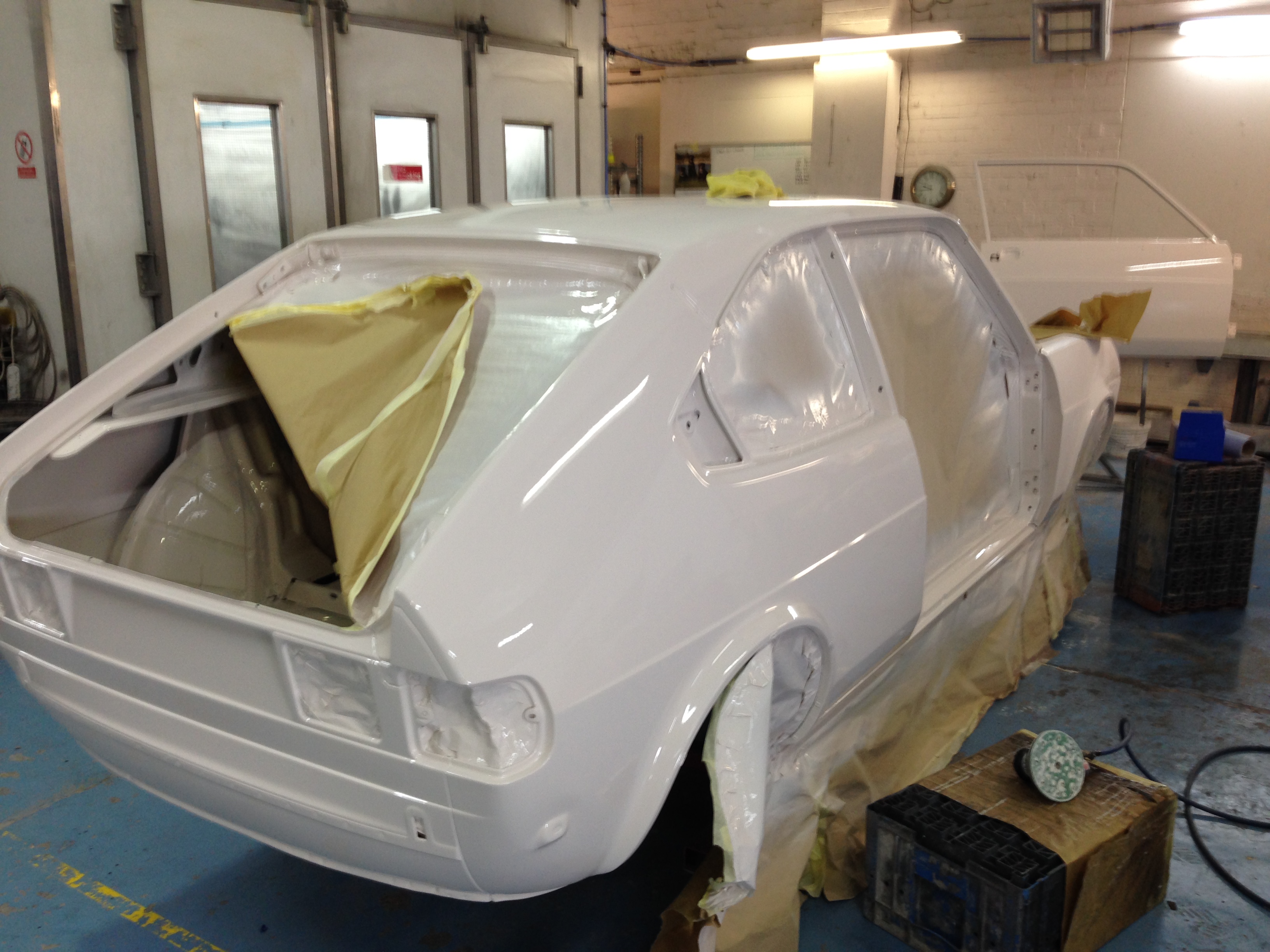

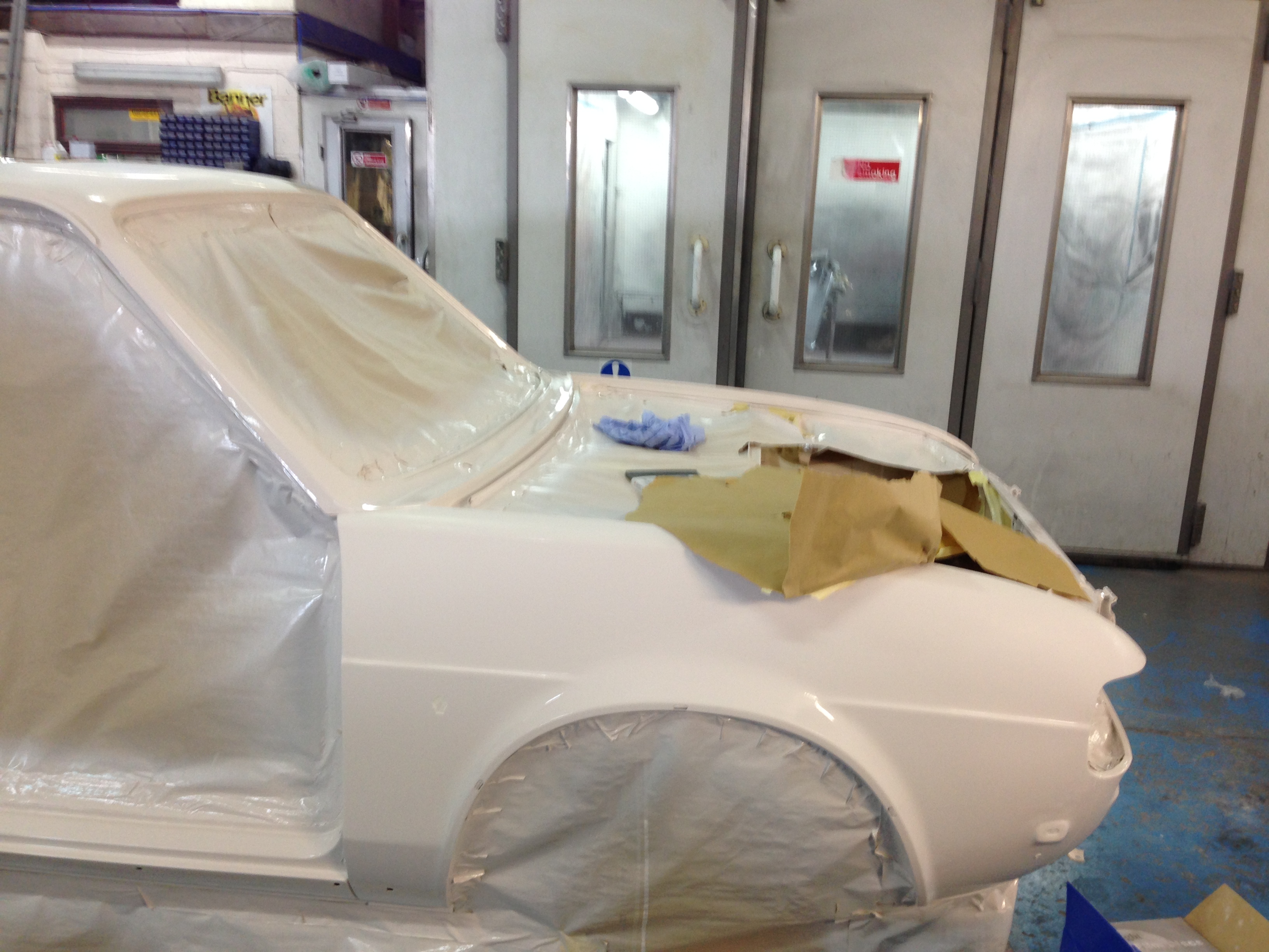

Not too sure how long the bodyshop will have it - there was quite a few other projects in there when I dropped it off - 2 Ferrari 330's, a Testarossa, Jag XJ220, a very early Countach, 2 1960's Lotus F1 shells + a pre war Bugatti of some sort - nice to know the Sud is with some good company while it's away !

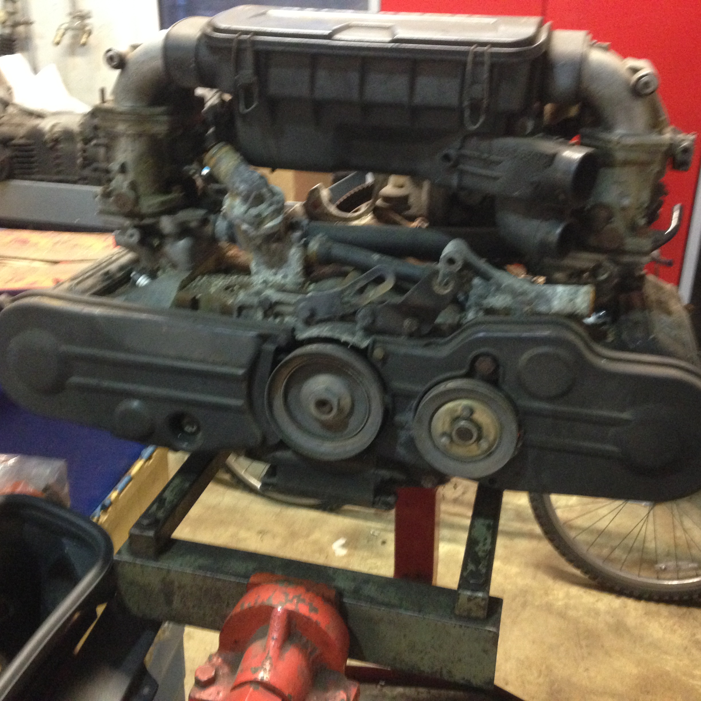

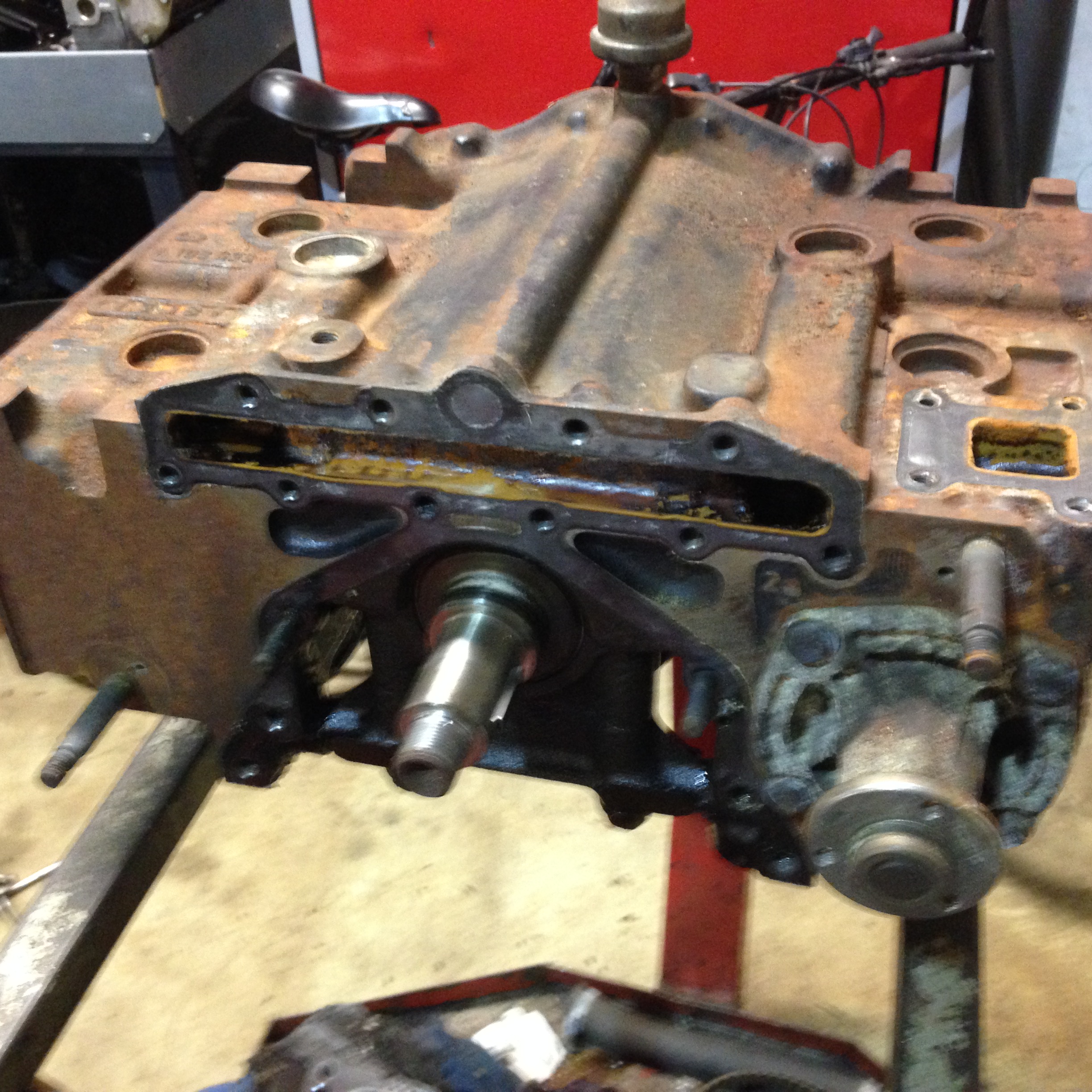

Had a couple of hours to spare tonight so decided to make a start on the engine - went from this
To this quite quickly

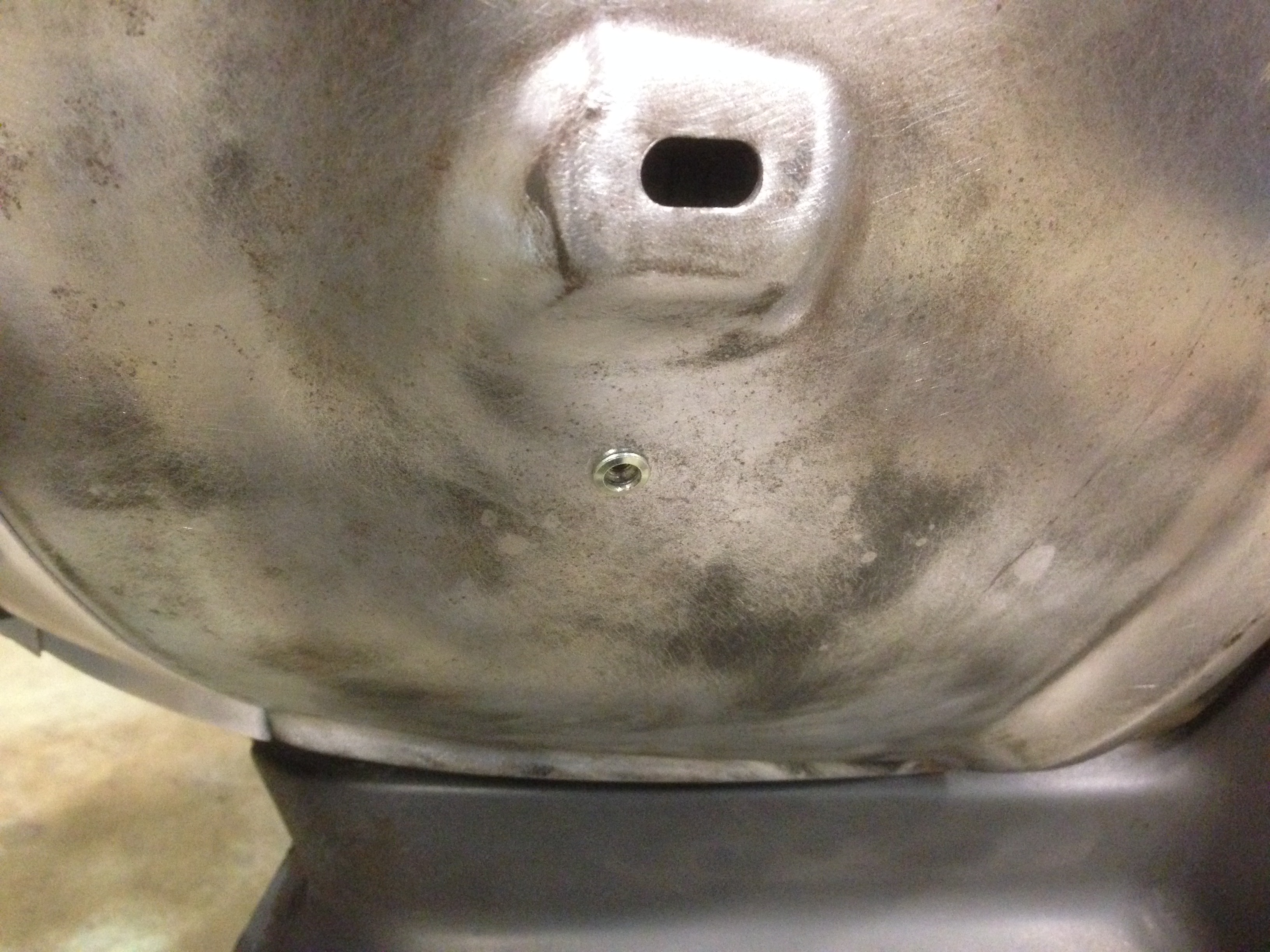

The inside of all the coolant passages look a bit rusty but no sludge or bits in the sump or on the oil pump foot and with a quick look at the bores and piston skirts all looks good so far
The inside of the sump has the paint coming off it a bit as you can see in the picture but is quite clean so looks like the oil had been regularly changed

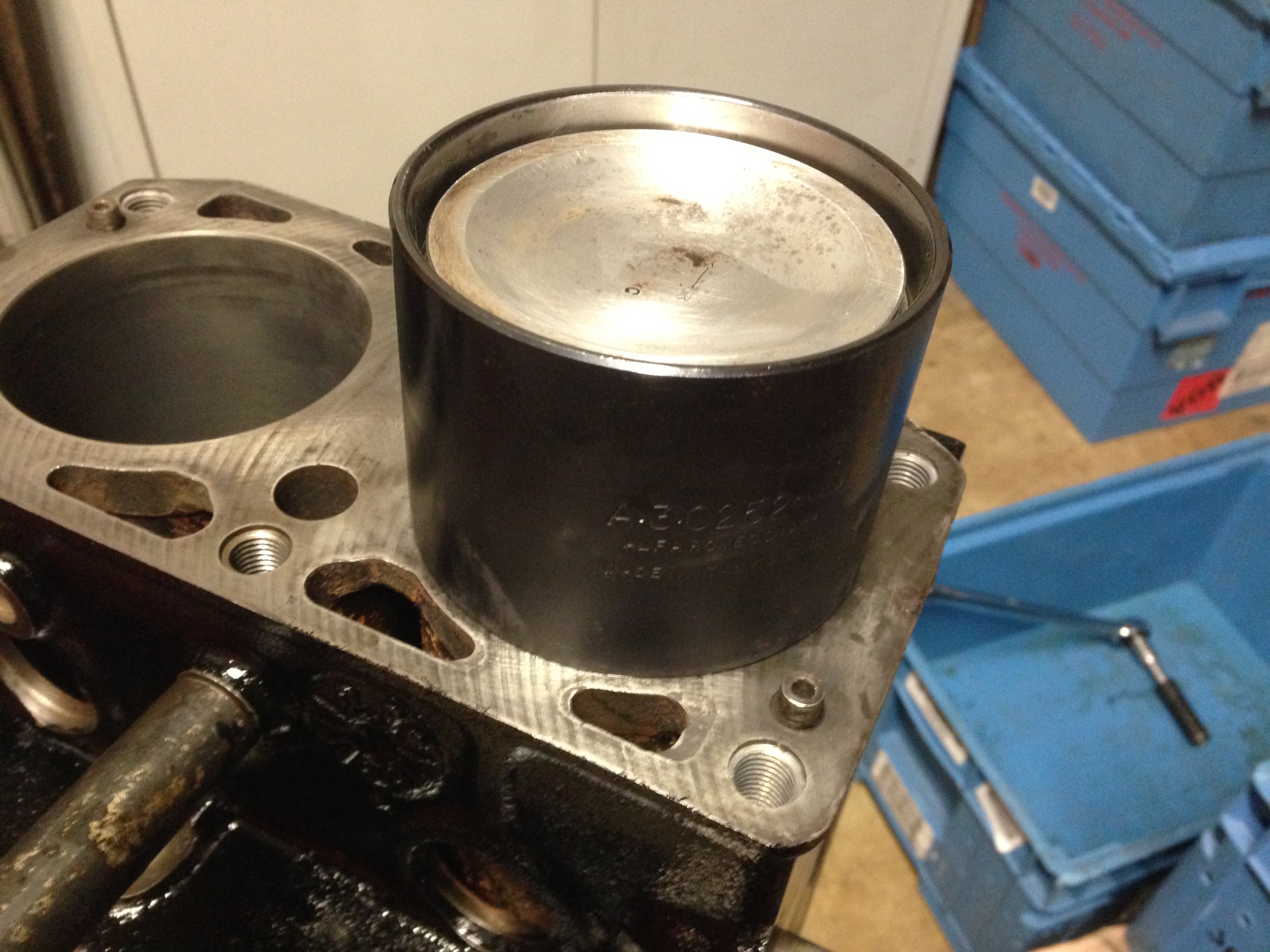

Bottom end of the engine is now fully stripped, all in good condition as far as I can see , slight wear marks on the big end shells but the main bearings and thrust washers are like new - I think these will be used again (will measure the wear fully but look ok to the eye)
Pistons and bores all look good , rings are getting near the wear limit so will fit a new set of them - apart from that just a good clean up and all new seals + gaskets
I did not expect to find any major faults as it had only done 33000 miles and sounded healthy before the car was stripped

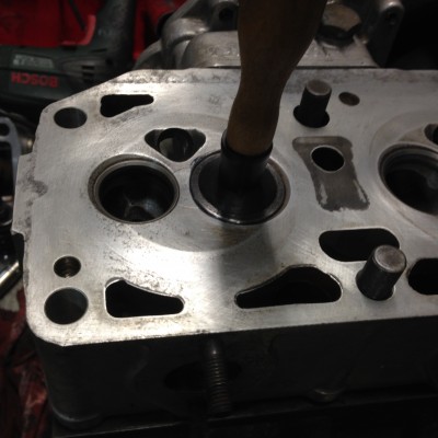

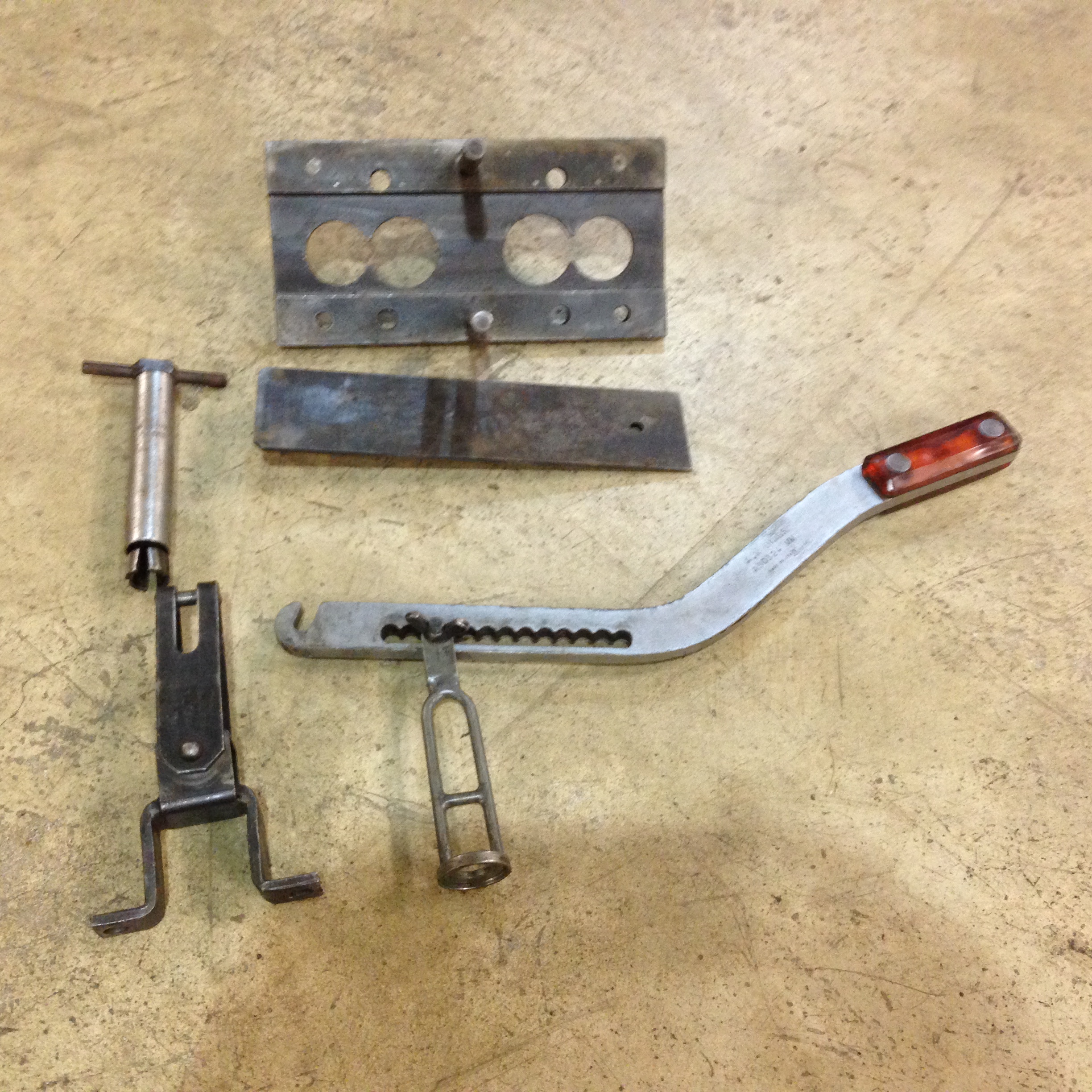

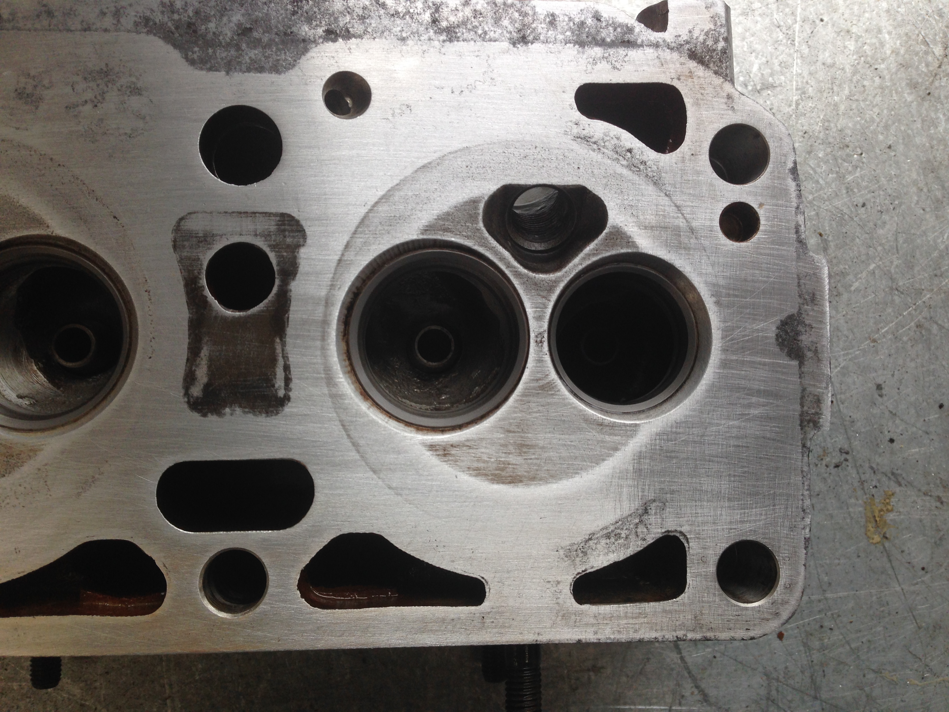

Started on one of the cylinder heads tonight - dusted off a few old Alfa tools to help - does make life easier
The heads look good too - no corrosion to the water ways etc. and the surface is nice and flat
Then spent a couple of hours with the valve grinding stick - a bit tedious but satisfying now the valves are all lapped in

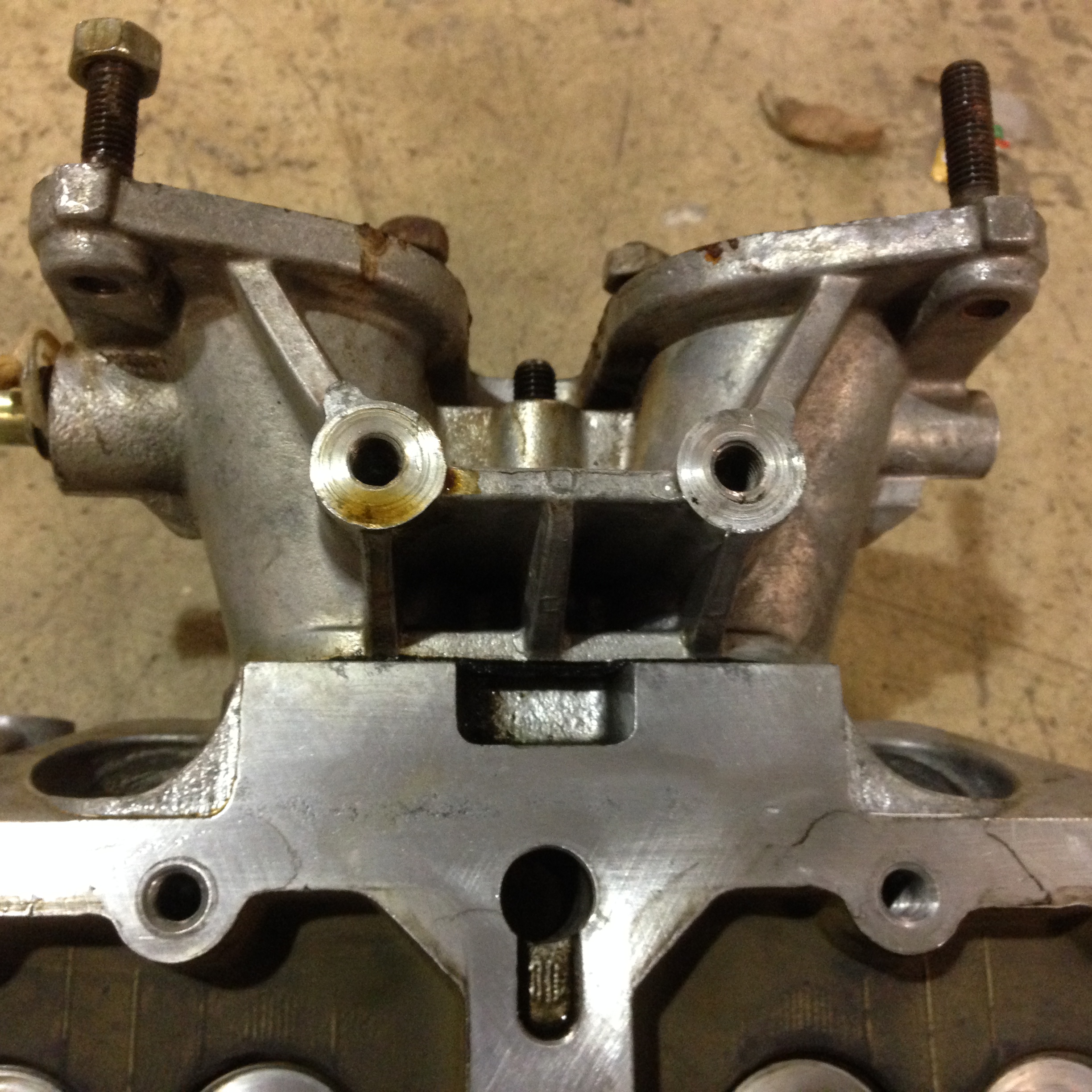

Another thing I am on the hunt for now is the engine lifting brackets that fix to the inlet manifolds - these always got taken off as it makes life much easier to check + adjust the valve clearances - I have thrown dozens of these away myself but can't find any in my collections of parts now which is typical
They fit in the upper holes as shown here with two 13mm bolts
Would be grateful of a pair now if anyone has them

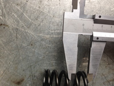

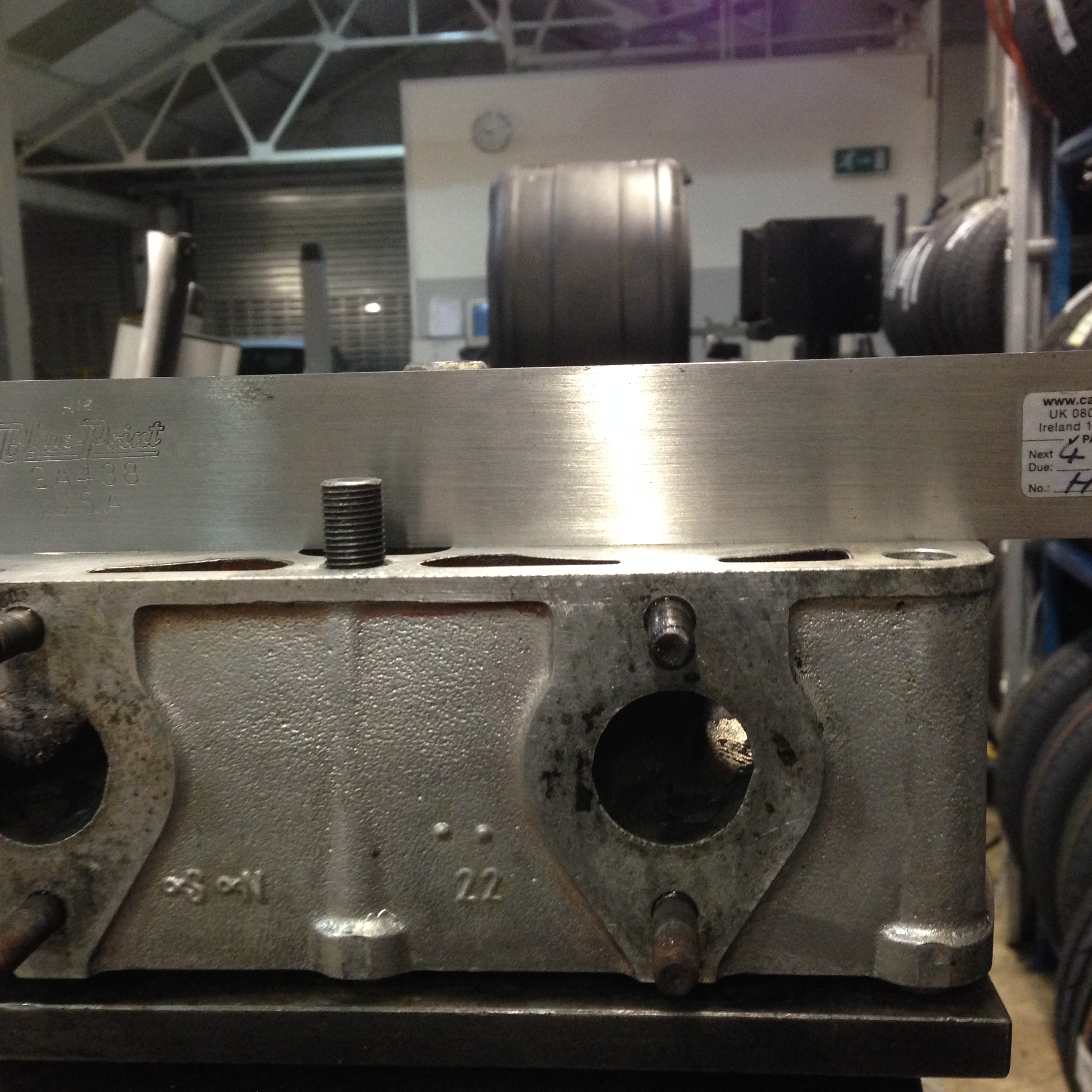

I checked the thickness of both heads to make sure they were both the same - head gasket failure was quite common on the 95 bhp veloce engine and I have known just 1 head to be skimmed which then gives uneven compression and also corrosion of the heads around the valve seats can occur from coolant getting into the cylinders - in this case all was fine. I don't think the engine had ever been apart before as it still had they grey head gaskets which were the ones that failed - new newer ones were brown
All the valves were fine after being lapped in and no wear in the valve guides

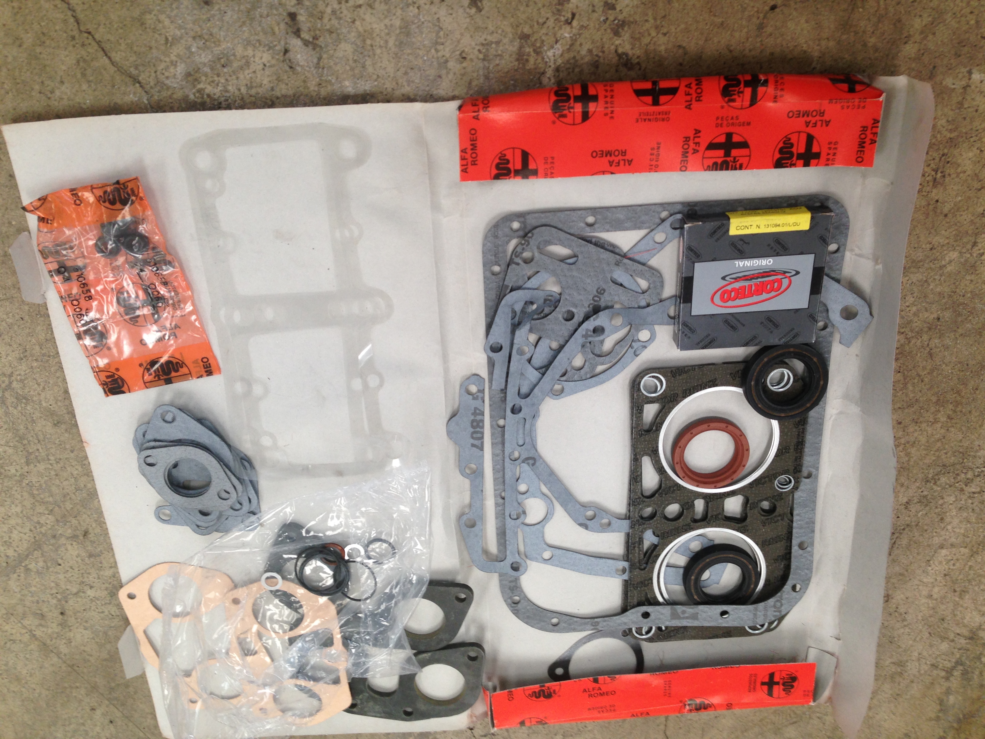

New valve guide seals fitted from the new gasket set

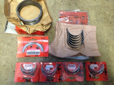

More of the new parts that I have been keeping for this project !

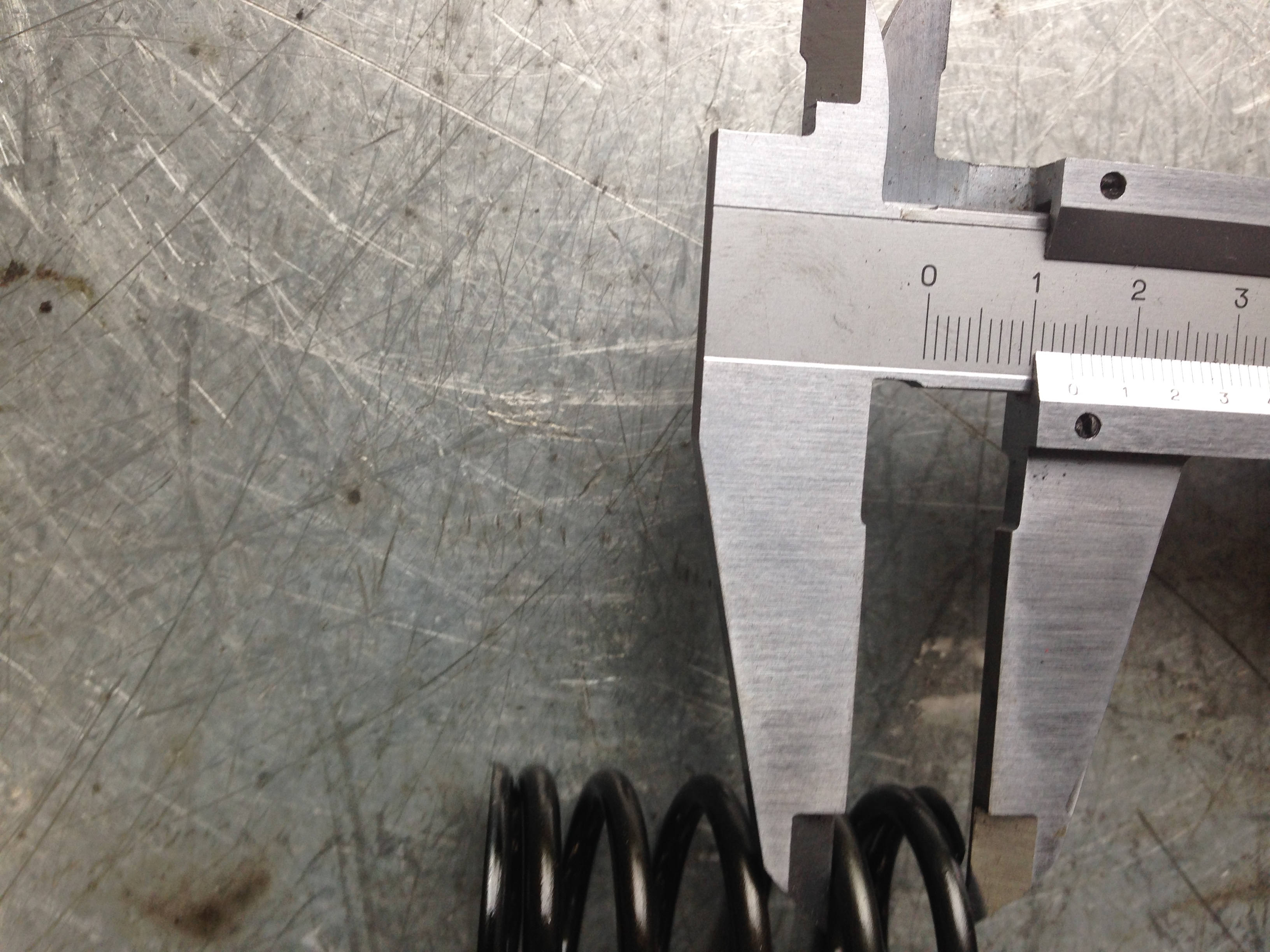

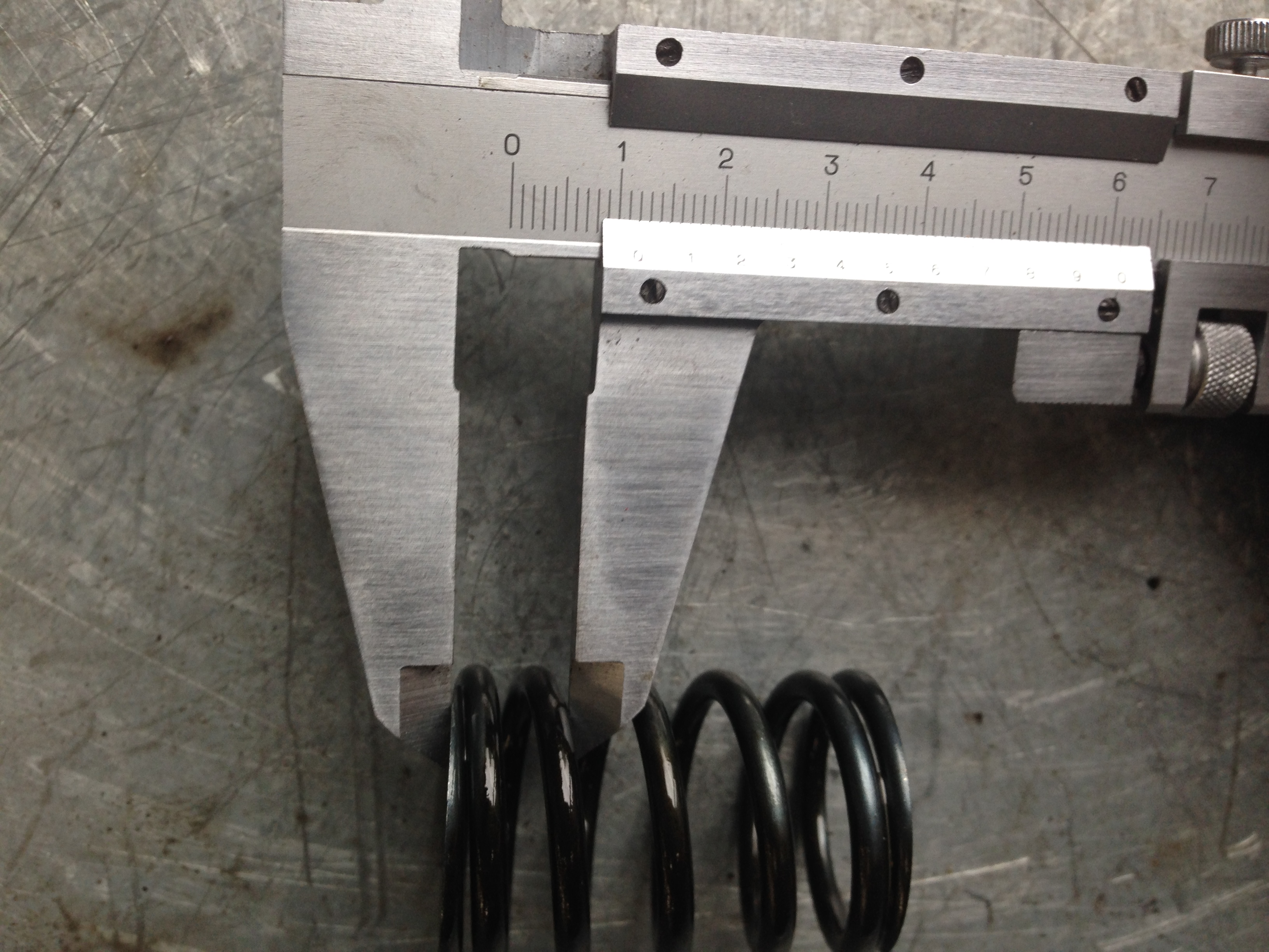

Hopefully this will show how to make sure the valve springs are fitted properly - the coils are slightly different at one end where they are closer together - the closer together end of the spring should be fitted at the bottom i.e. touching the head - not the spring cap.

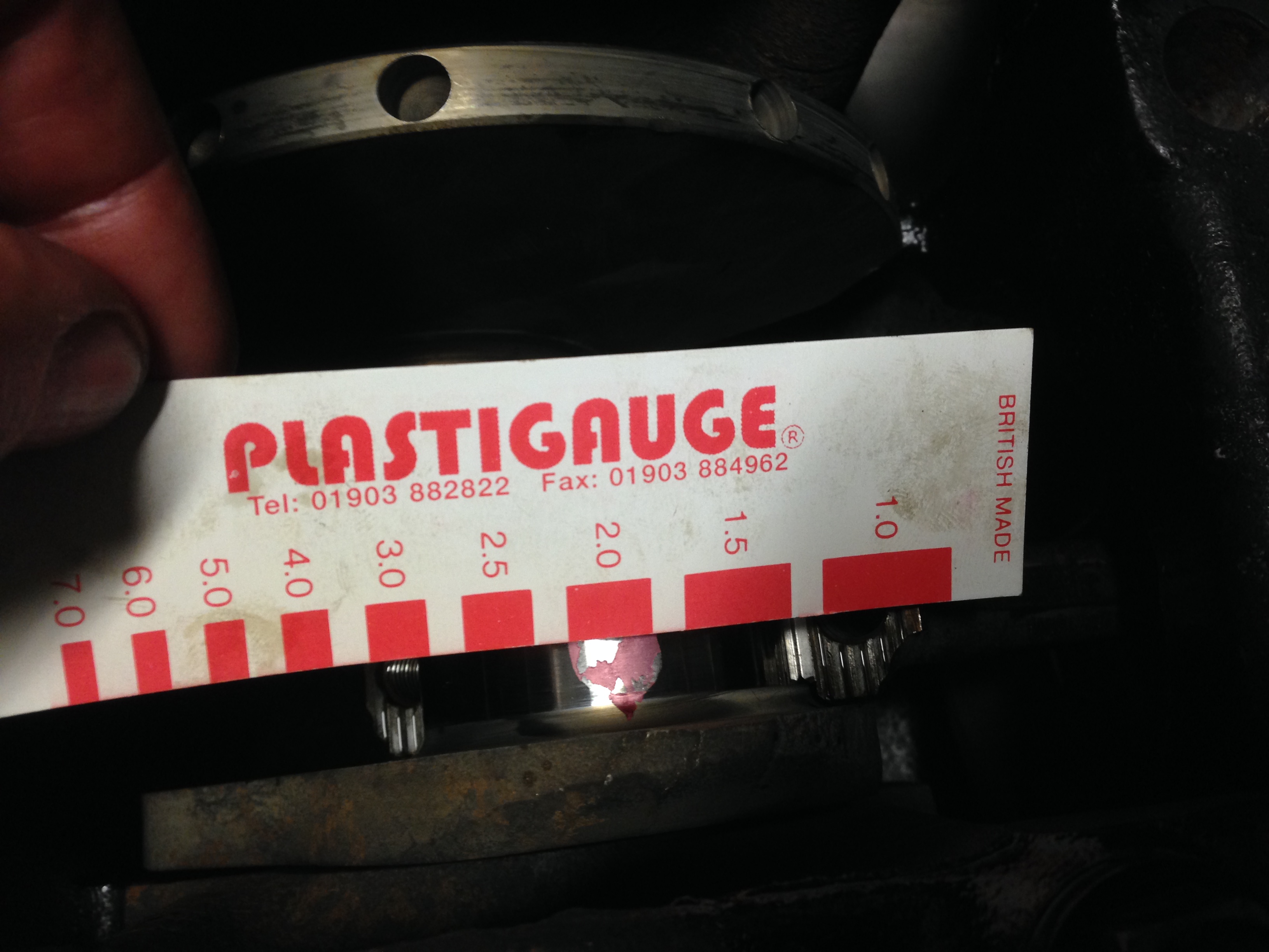

As the cooling system was a bit rusty inside when stripped I took all the core plugs out and then had the block hot chemically cleaned to remove as much as possible of the rust in all the water passages - also a "glaze buster" was lightly run in the bores to let the new piston rings bed in

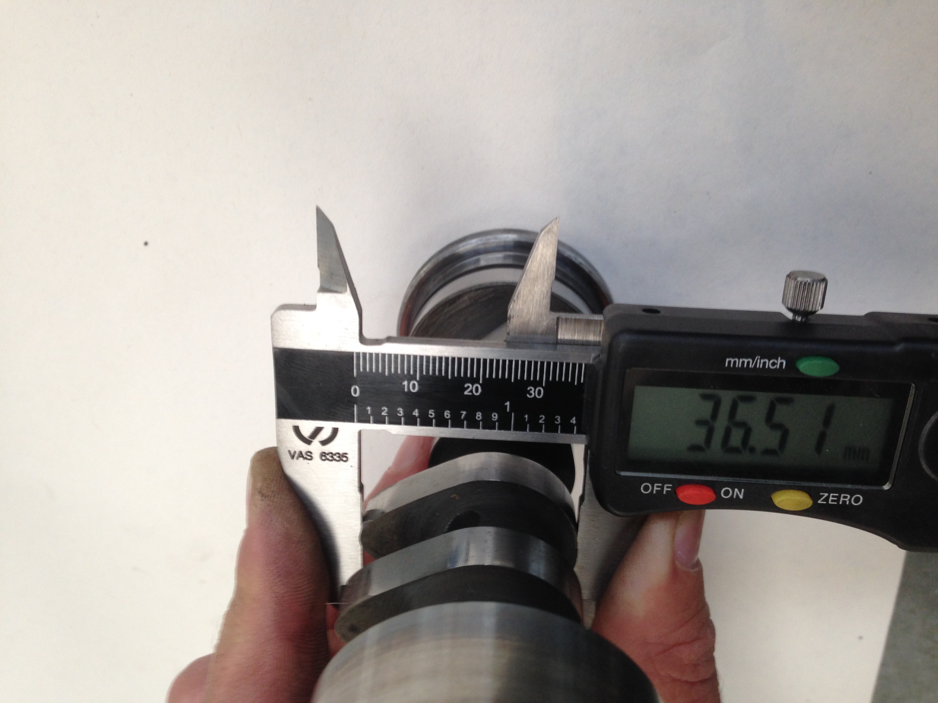

The bores and the crank were measured and found to be well within the standard wear limits so after a good clean up all new bearings,piston rings and gaskets were used for the rebuild

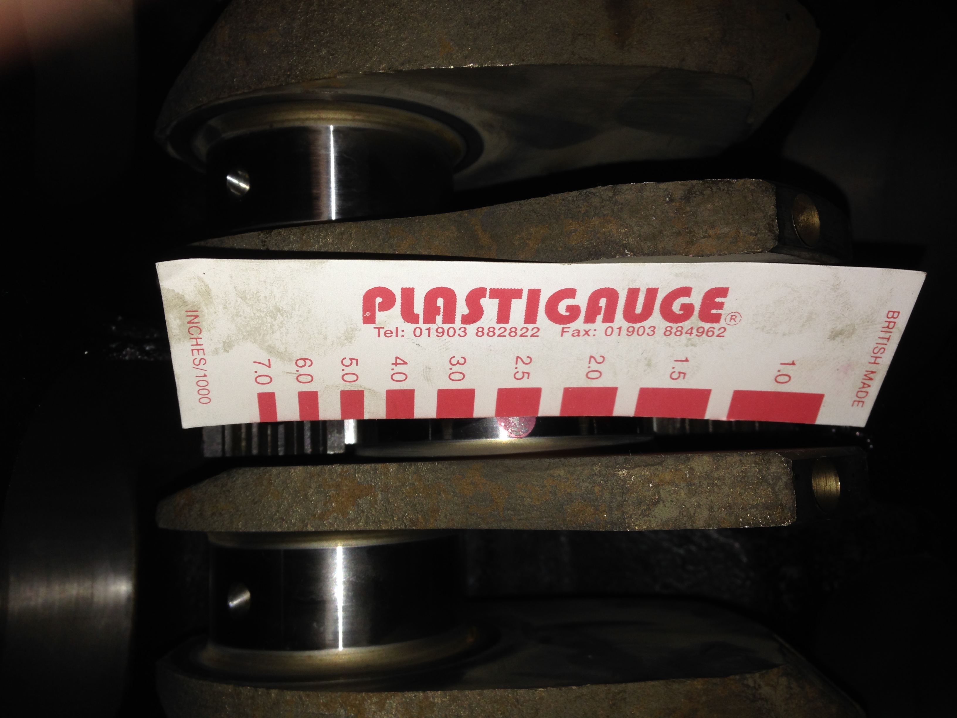

Even though they were genuine Alfa parts I always check the bearing clearances before fitting using plastigauge first - for those of you who have never used it all you do is put a strip of the plastigauge into the bearing - then tighten up to the correct torque without any oil and also without turning the crank - then you undo the bearing again and check how much the plastigauge has been squashed
The wider the plastigauge the smaller the bearing clearance - I find this gives peace of mind that the measurement of the crank was correct - I once had a crank reground and was supplied the undersize bearings to go with it which turned out to be wrong, I did not check and the first time the engine started it was making a knocking noise so ever since then I always have double checked.

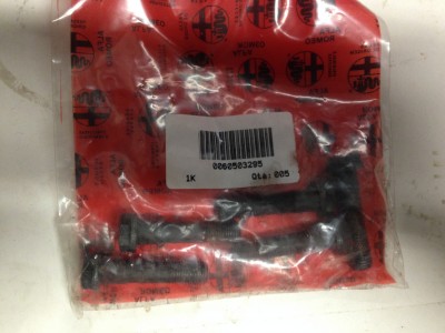

Not really needed but I also fitted a new set of big end bolts as I had some - if this was to be a competition engine then best to fit the 16 valve bolts or better still convert to take ARP competition type bolts as the originals are weak under load.

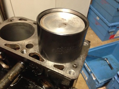

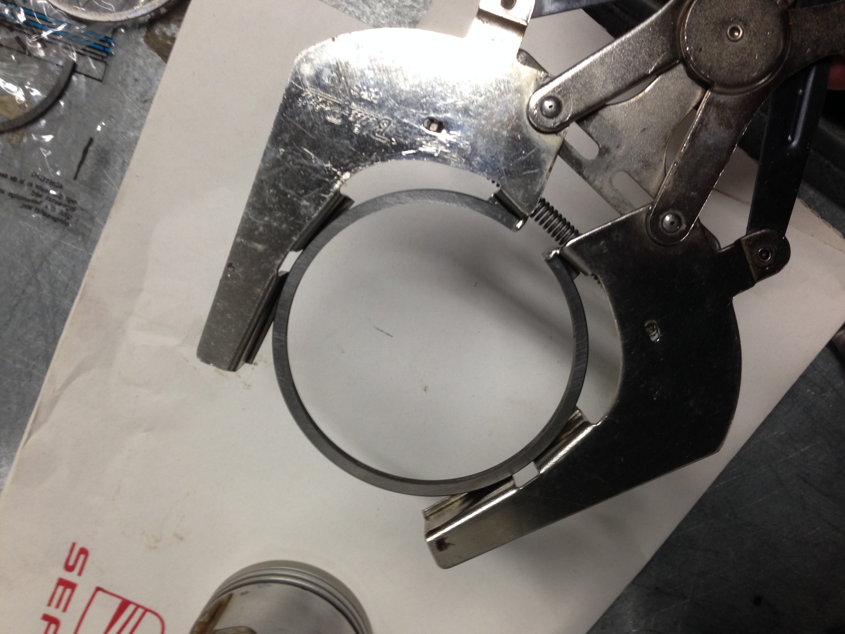

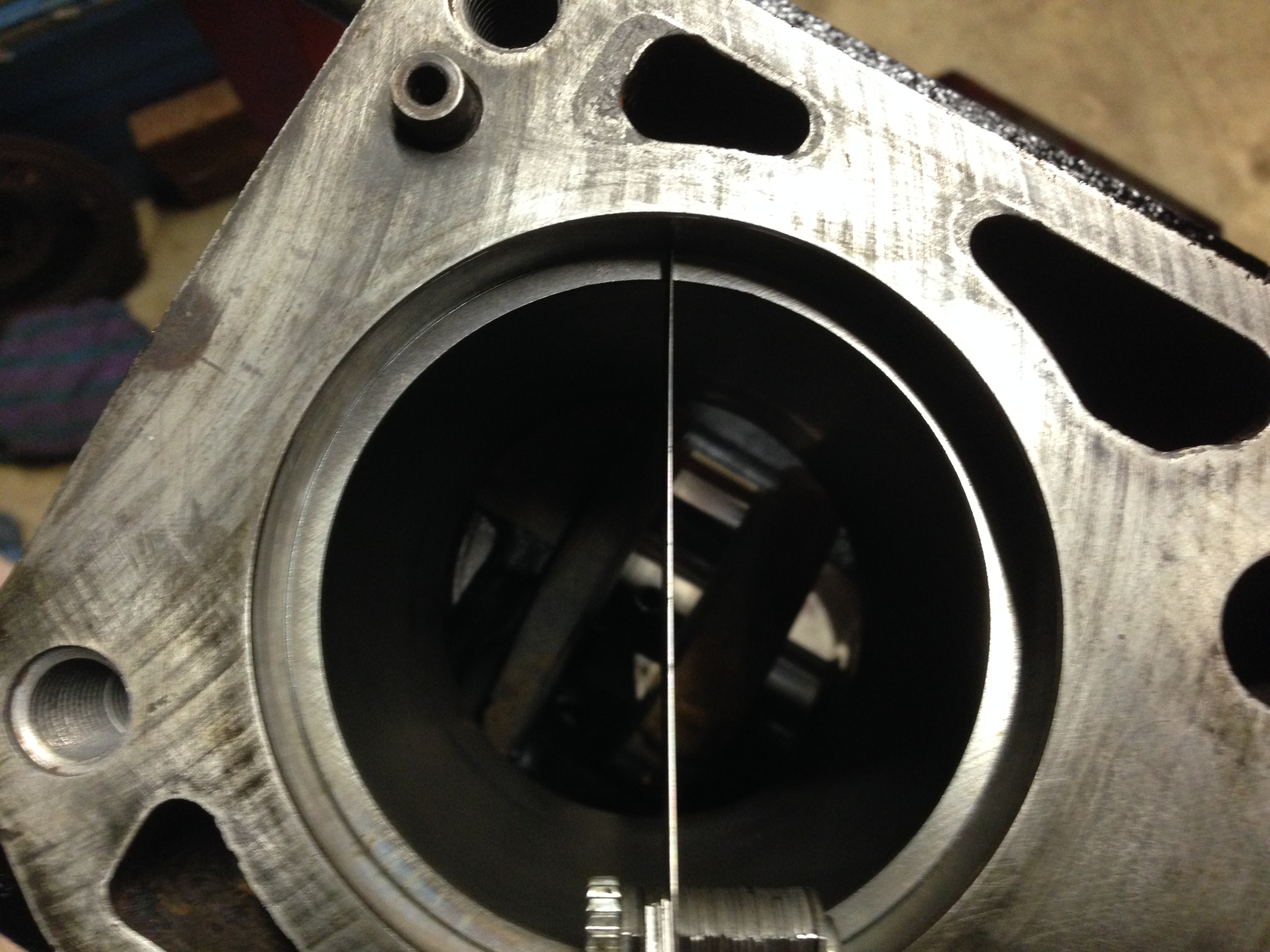

New piston rings end gaps were checked with a feeler gauge - insert the rings one at a time into the bore and with the top of the piston push down about 1cm keeping the ring square in the bore - the maximum gap is 0.50 mm for a new ring
Then the new rings were fitted to the pistons - a tool like this makes this much easier and less chance of any damage to the piston when fitting
Double check the pistons are fitted the right way onto the con rods - the arrows on the piston crowns go in the direction of rotation of the engine i.e. the right bank (cylinders 1 & 3) face up and the left bank arrows face down
Then stagger the ring ends, lubricate, compress the rings and fit the pistons - the picture shows the best type of ring compressor I have ever used - It is a tapered sleeve and makes fitting very easy - no good for oversize pistons but great for standard size

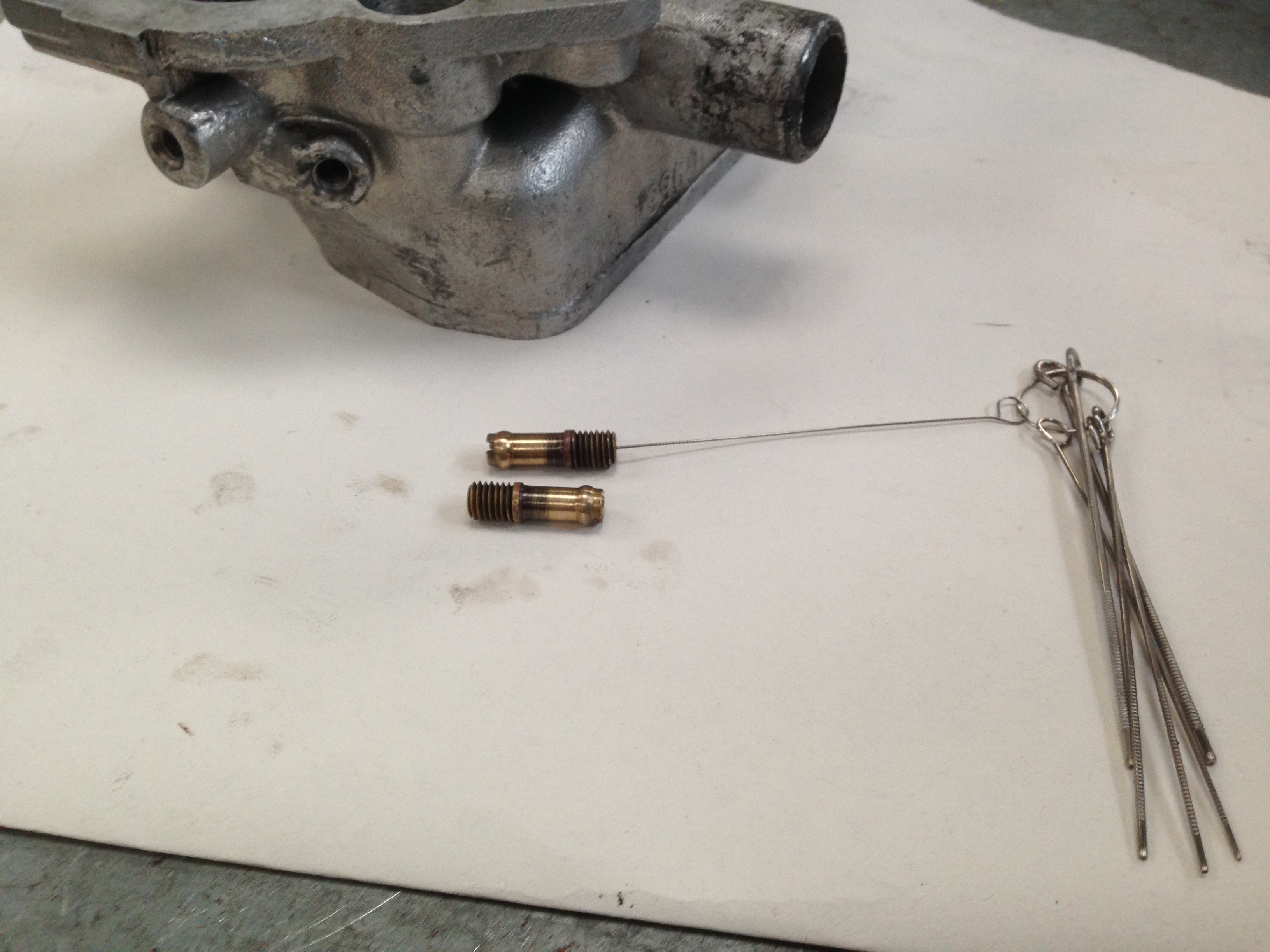

The hole in the end is very small but makes a big difference to how the engine will idle if they get blocked

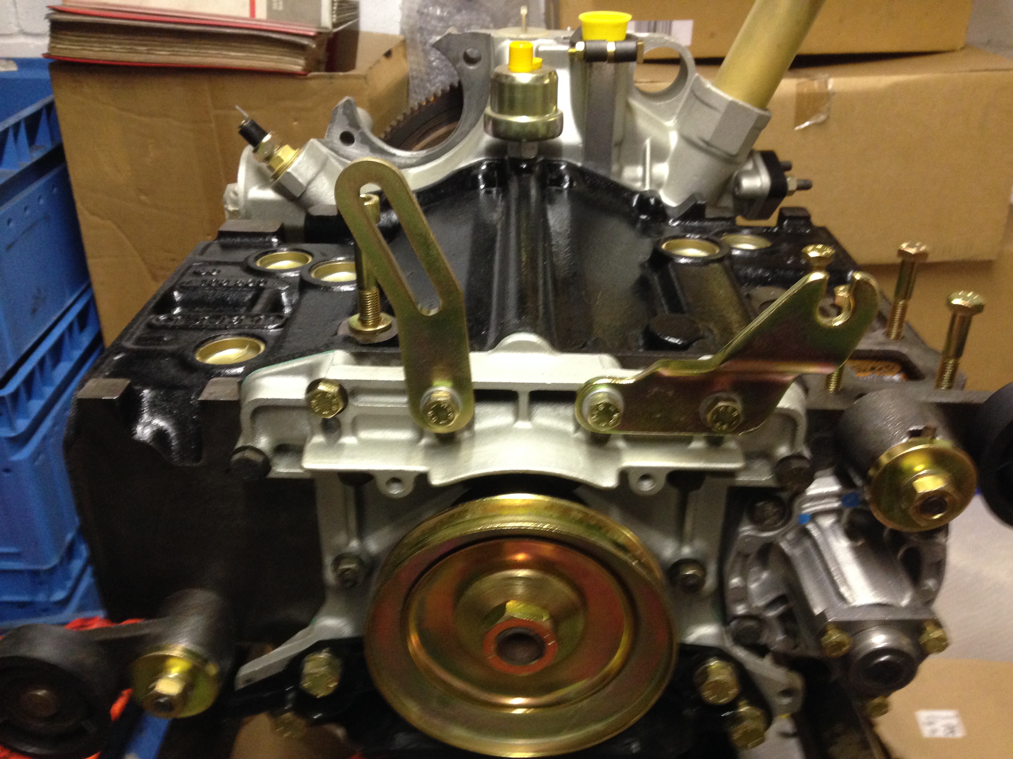

Got a big pile of bits back from being zinc plated a while ago so thought it was about time to get the engine finished over the holidays
I did find 2 engine lifting brackets in the end
Fitted the new water pump and pulleys onto the crankshaft yesterday
Then today fitted the rebuilt heads and put the timing belts on

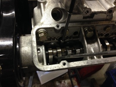

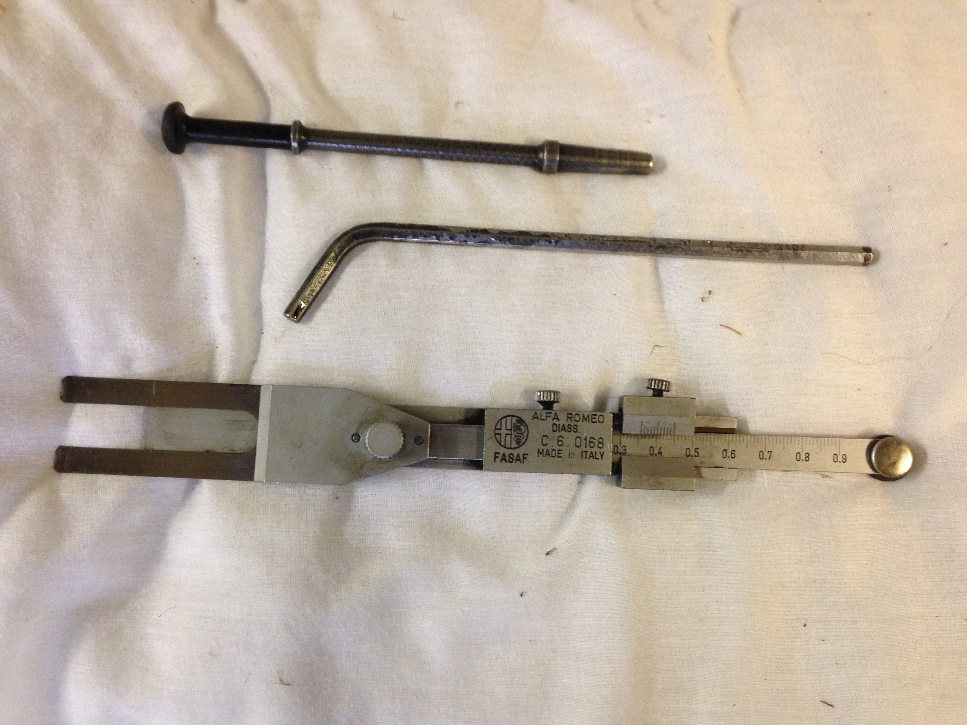

Then set the valve clearances and you can see why the lifting brackets get taken off as they get in the way when using the tool to check the clearances
Not too much left to do now but every time I put on a new or re-plated part it then makes some of the other original bits look shabby !

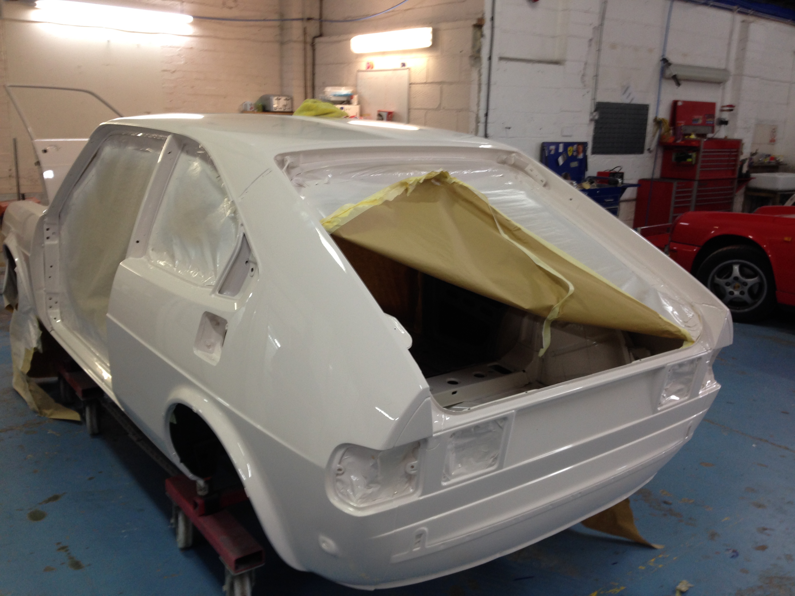

I spoke to the bodyshop this week - they say it should be done by the middle of Febuary so I how this will give me enough time to get it on the road this year

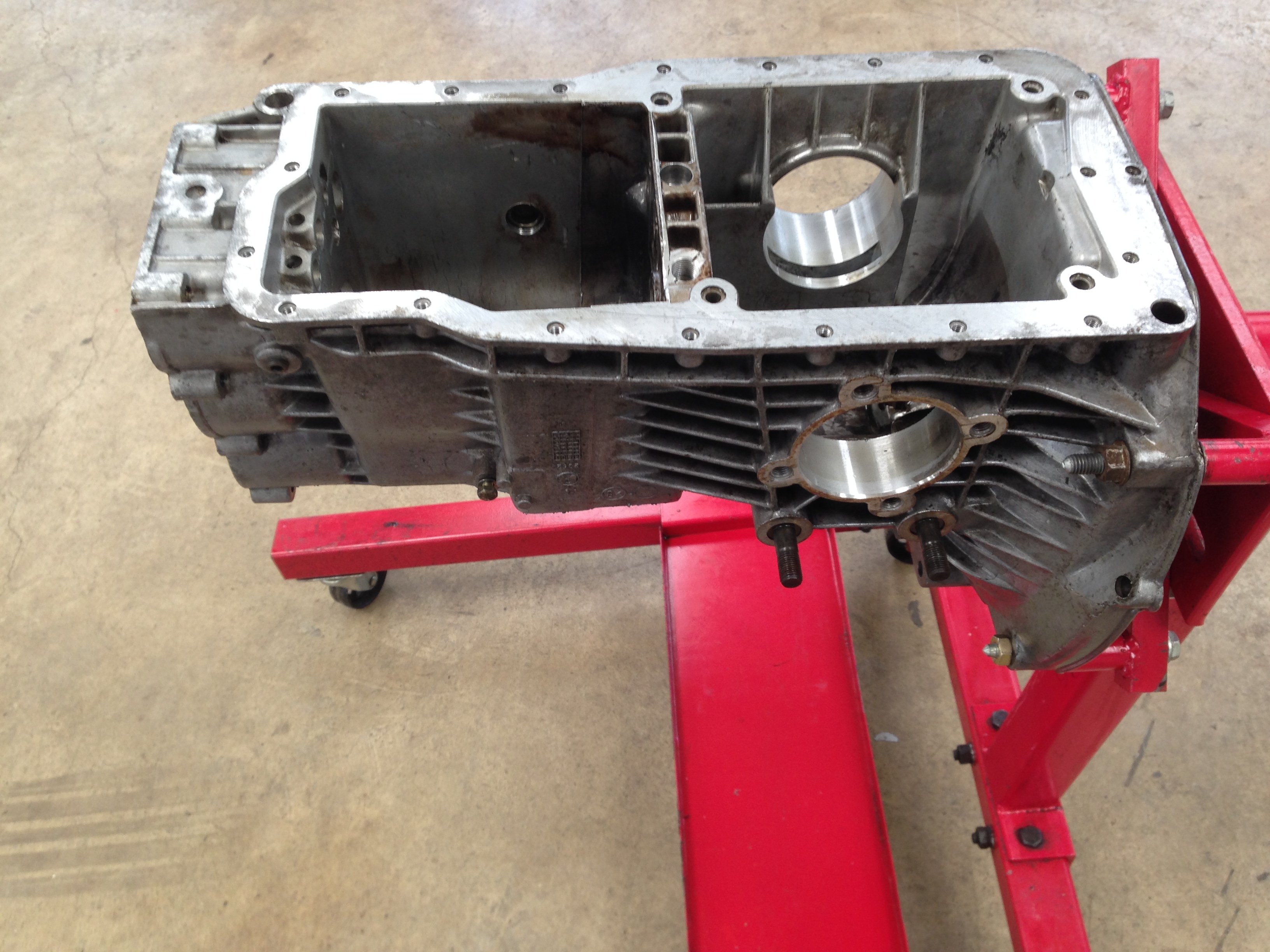

The gearbox is a bit like the engine - nearly finished !
Most of the job was done a few months ago now but need to fit the sump back on now that it has come back from being powder coated

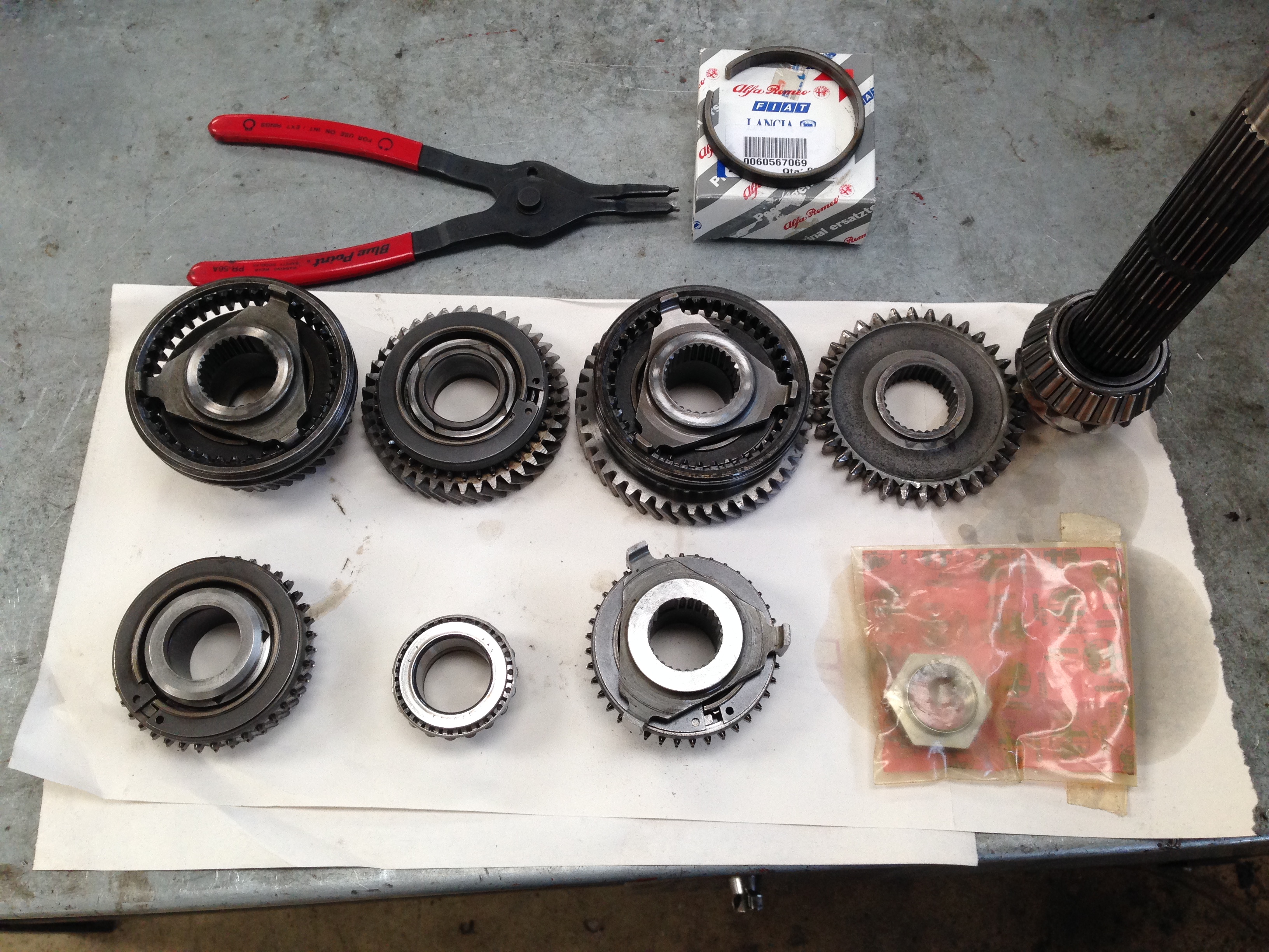

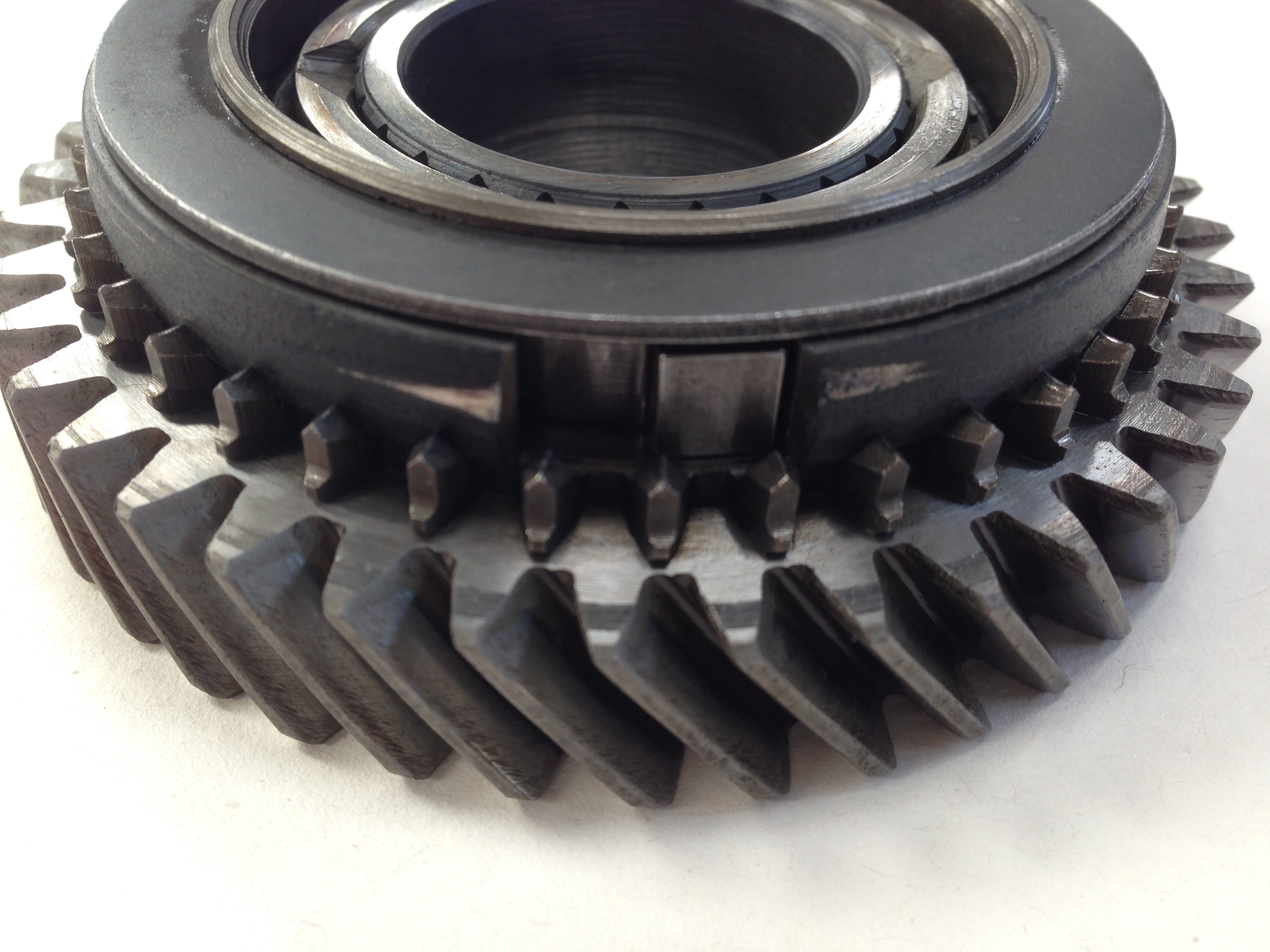

I wanted to renew all the seals and gaskets and have a look inside - did not expect to find many fault at the low mileage covered and that was the case
There was a bit of wear on the 2nd gear syncro so that was renewed but all the other syncros and bearings were fine
New syncro ring ready to be fitted
To fit the big circlip on the top of the gear has to be removed and then fit the new syncro ring - quite an easy job so long as you have a big pair of circlip pliers as the clips are strong !

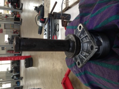

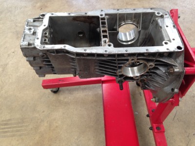

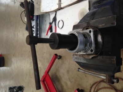

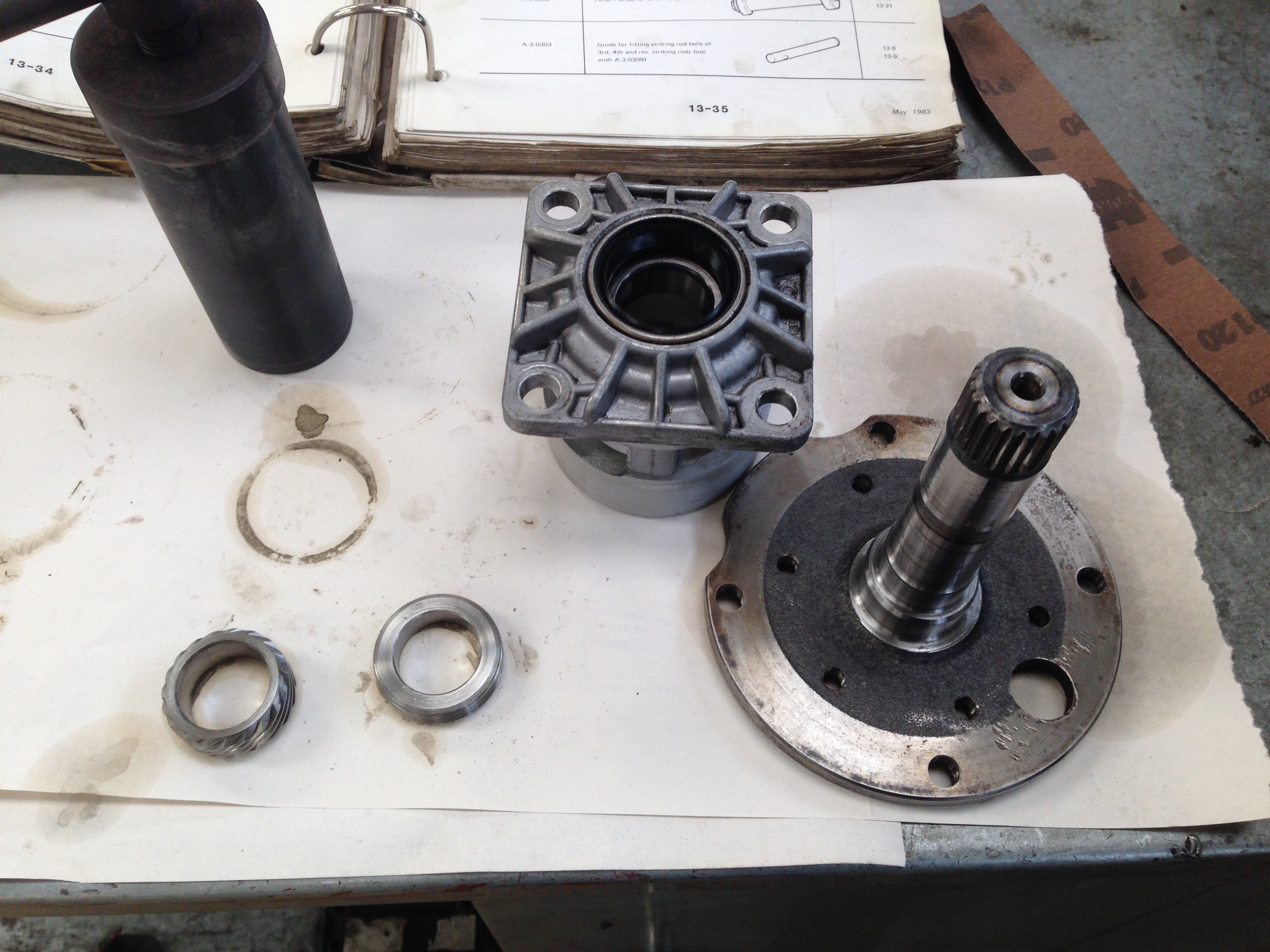

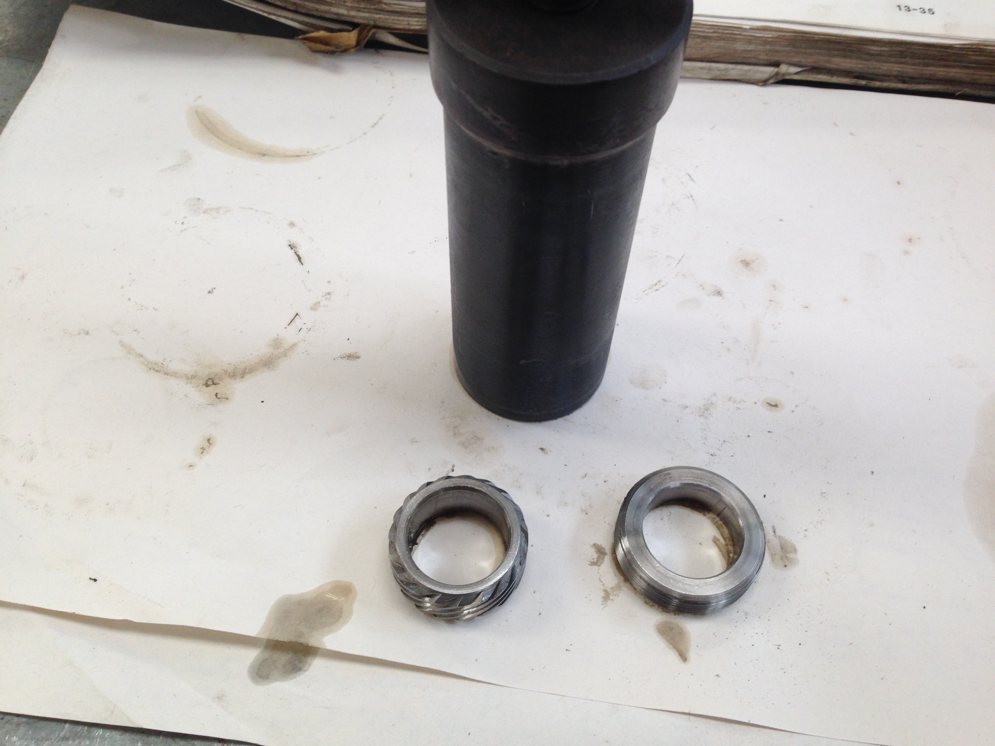

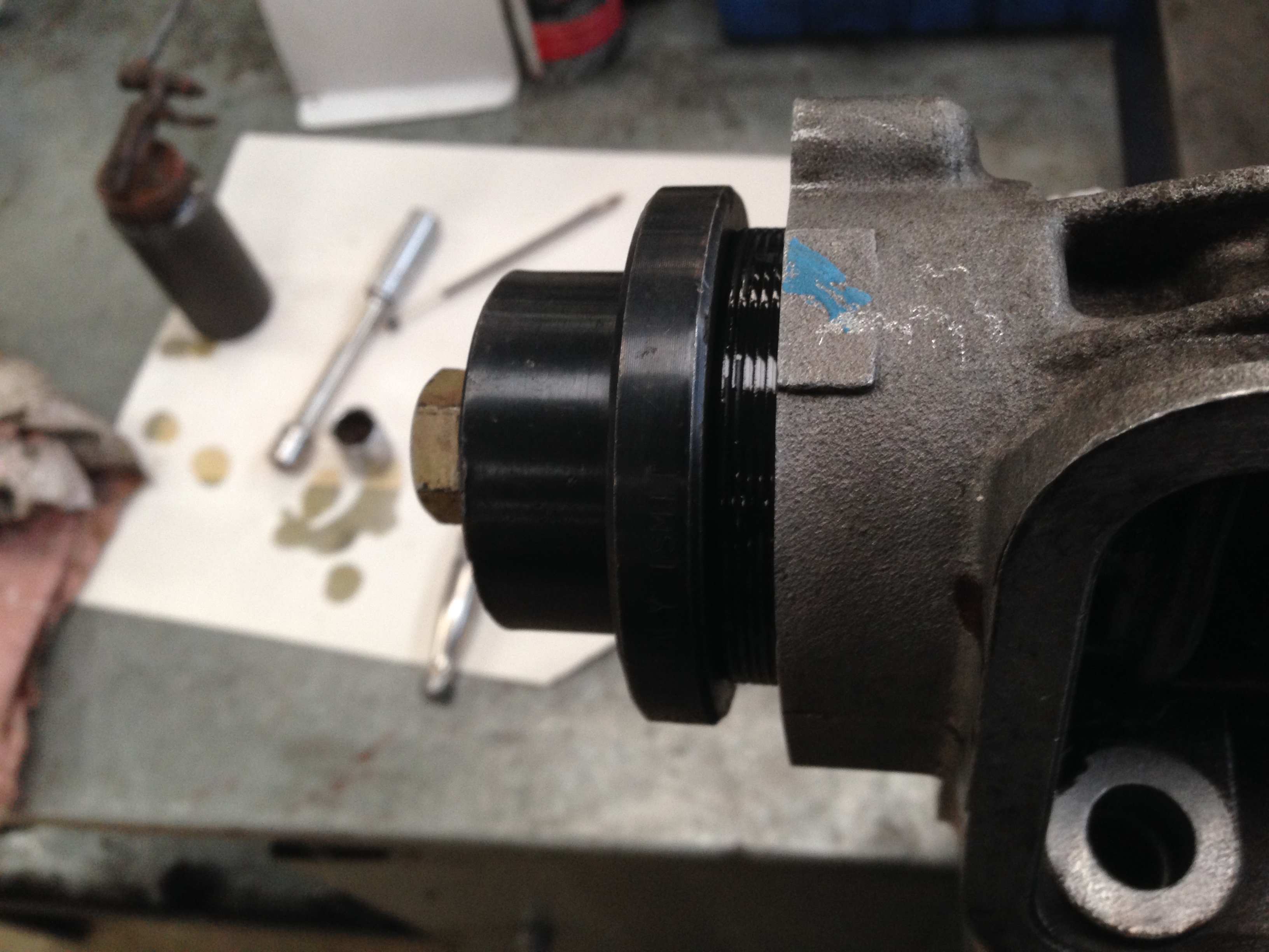

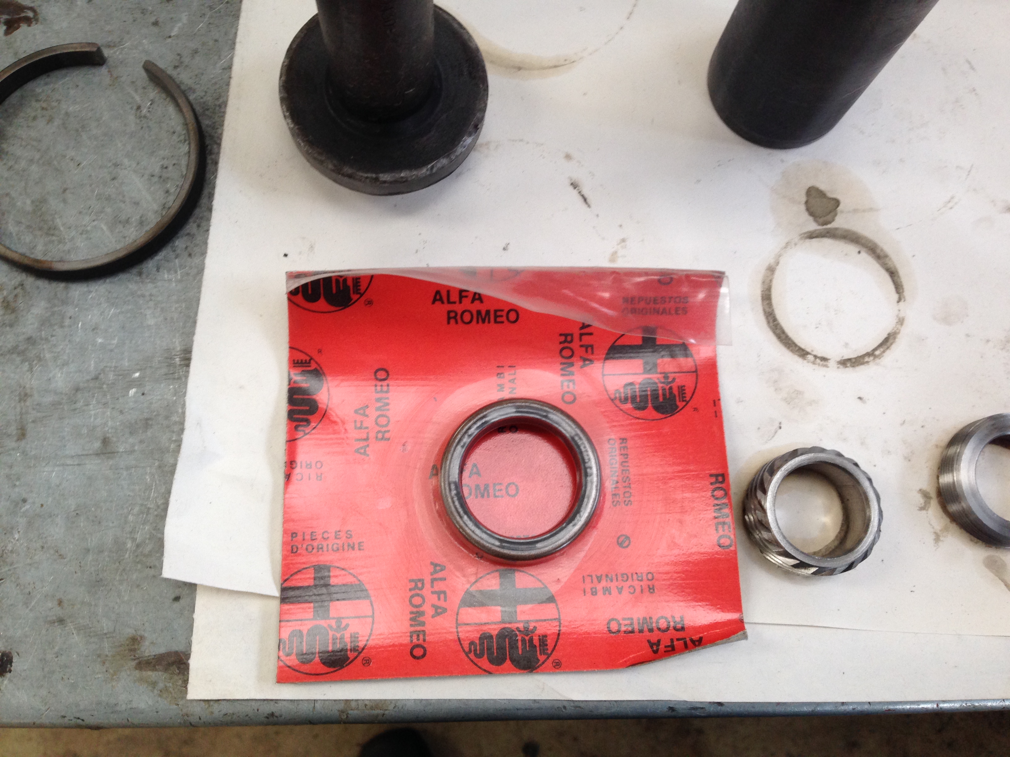

The output shaft seals were both replaced but to get the shafts apart you do need a special puller to remove the locking ring (and also the speedo drive gear on the right side shaft)
The tool screws onto the locking ring and then you wind in the handle to pull the locking ring off
The ring on the right is the locking ring and this is the right side shaft with the speedo drive which is the gear on the left
Stripped and cleaned/checked and ready for the new seal to be fitted
Then the new seal is fitted to the housing and then all fitted back together again using a press
Looking forward now to the body coming back so all these nice clean bits can start to be fitted back together again

At last some good news from the body shop !!
Today the shell was being flatted and polished - not too flat as I have tried to replicate the original factory paint with a bit of "peel"
All the shell and the doors are now painted - just the bonnet and the tailgate to paint now
Then all the cavity wax etc. will be done and then the fun bit of putting it all back together again
