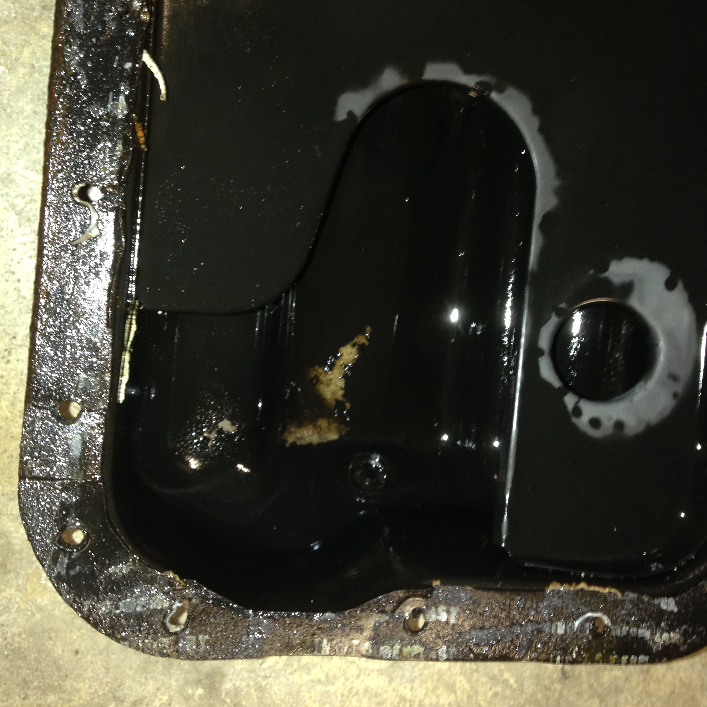

Had a couple of hours to spare tonight so decided to make a start on the engine - went from this To this quite quickly The inside of all the coolant passages look a bit rusty but no sludge or bits in the sump or on the oil pump foot and with a quick look at the bores and piston skirts all looks good so far
The inside of the sump has the paint coming off it a bit as you can see in the picture but is quite clean so looks like the oil had been regularly changed I will get the pistons and crank out next week and have a measure of all the parts - the block will be cleaned up inside by a local engineering company to get rid of all the rust in the waterways and the radiator was damaged in the original accident so that needs to be renewed - a new set of hoses and a water pump + a flush of the heater matrix should get to cooling system healthy again
