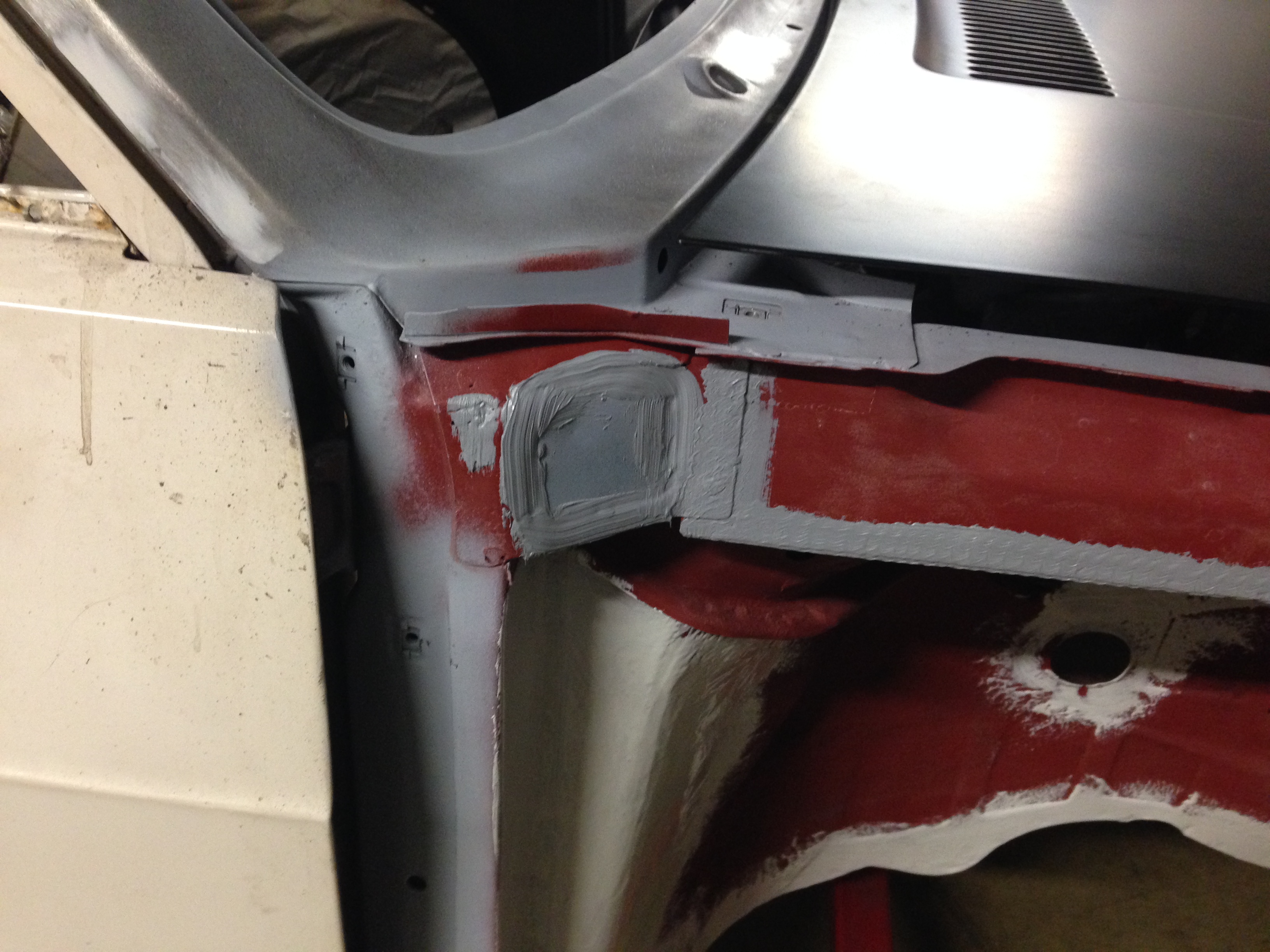

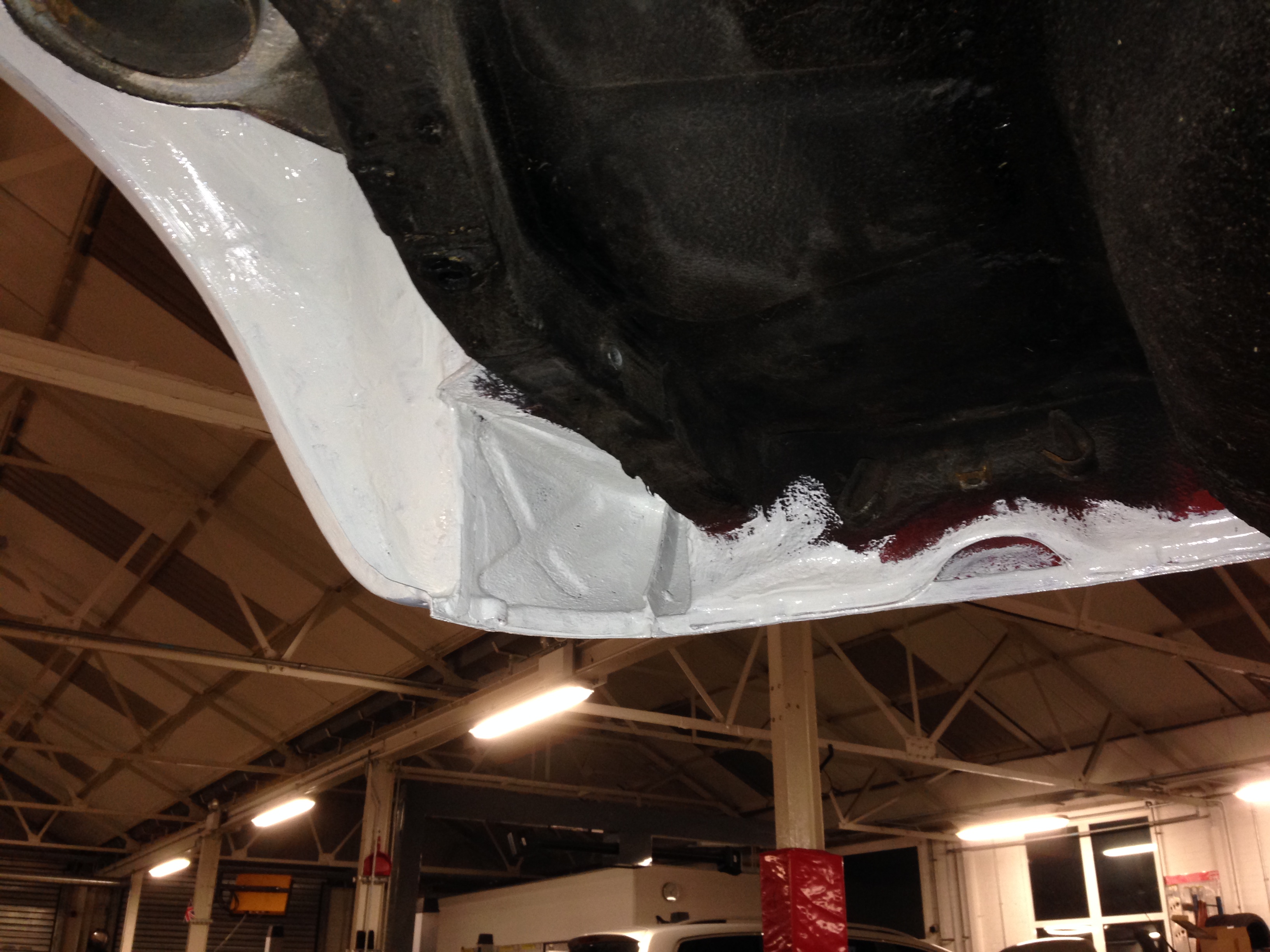

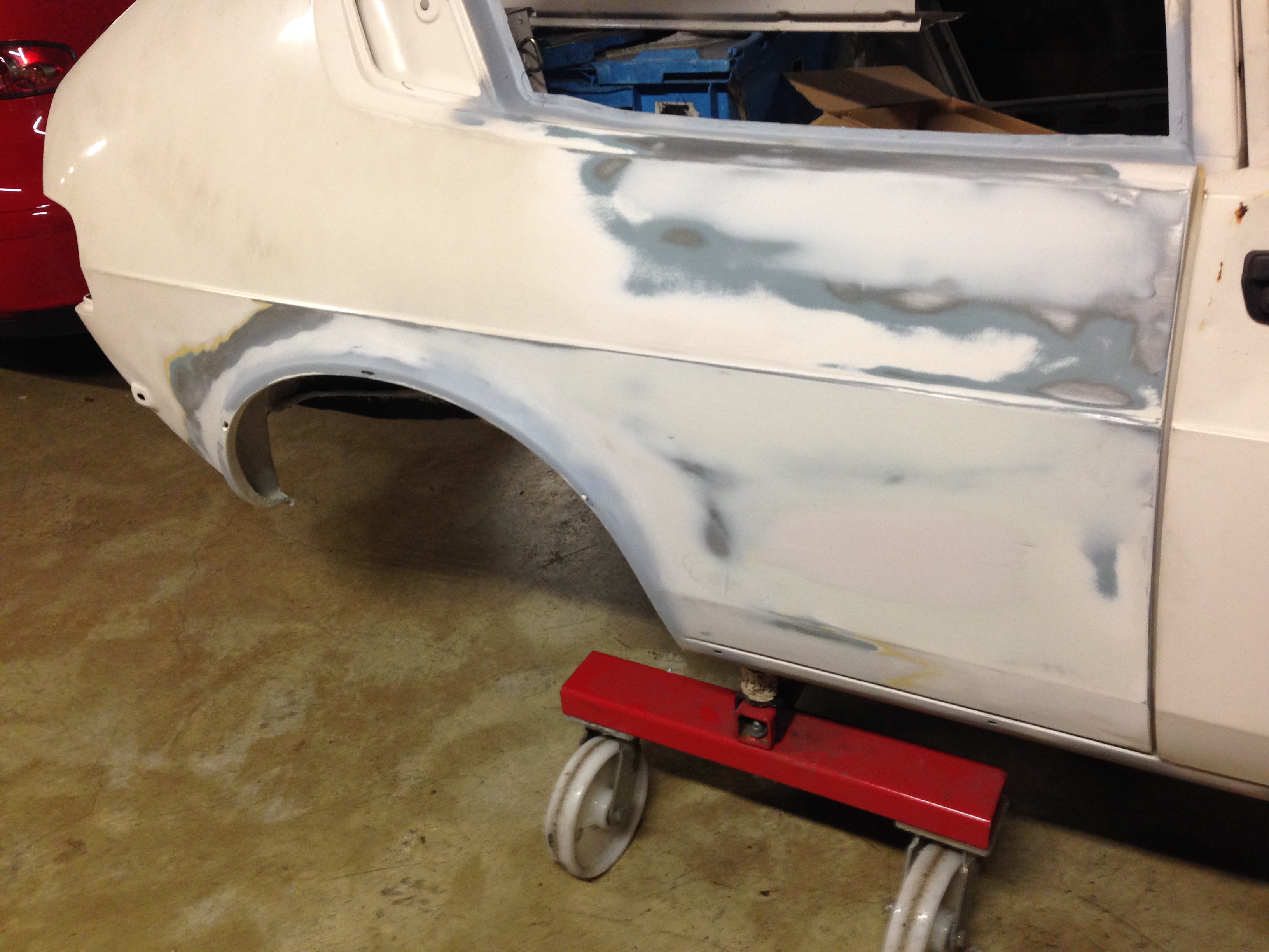

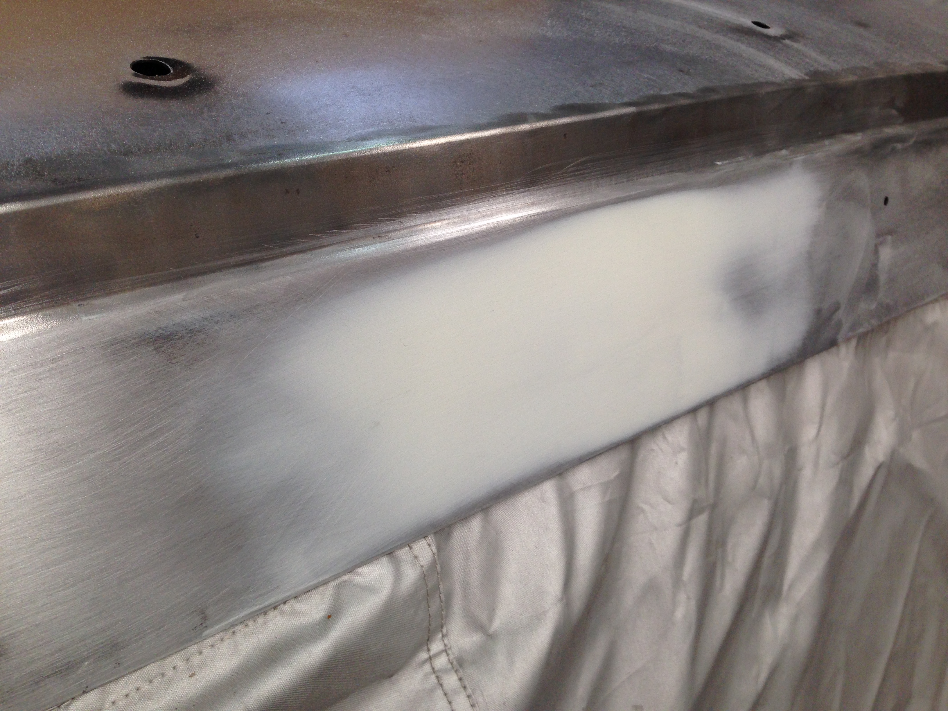

Very nearly there now with the prep. and corrosion protection before the shell goes off to be painted !!
The drivers side rear 1/4 panel has taken ages to get to profile back to the correct shape - the main reason for this was that the wheelarch repair (this was an old but good repair) was put over the existing panel rather that put underneath as I have now done on the passengers side - the drivers side also had accident damage to it to repair - after hours with the profile gauge (comparing to a new 2 door factory 1/4 panel) did get there in the end but with hindsight it would have been quicker to cut the arch off and start again (did consider this but the new inner arch had already been fitted !) The front inner wing boxed panels have been filled with wax and the closing panels all sealed up The next thing to finish up is coating all the areas that have been repaired or had the factory underseal removed with this stuff Rear end and sills have had a coat - need to finish up under the front inner wings next This will then get a coat of black stoneguard to try and replicate the finish it would have had when it rolled out of the showroom all those years ago but hopefully with the metal protected properly now !

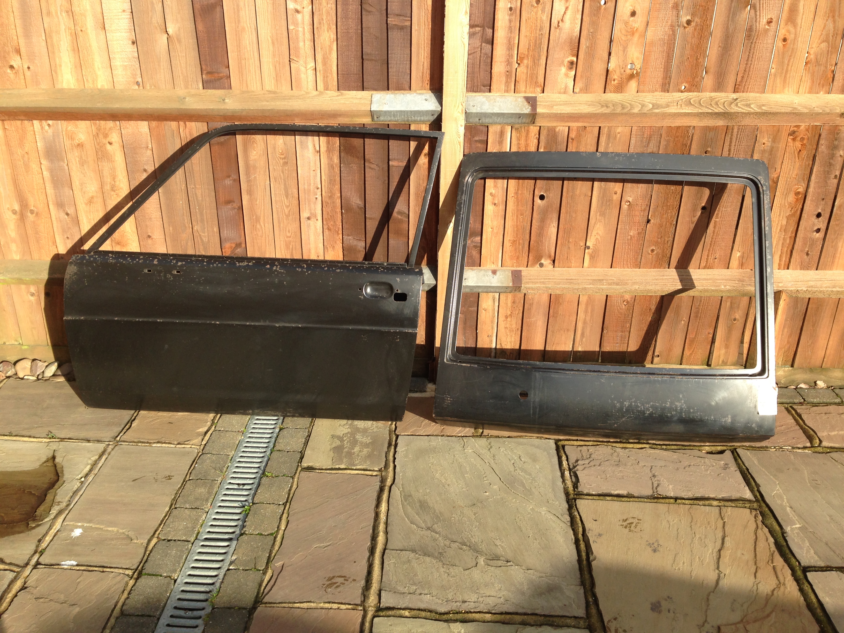

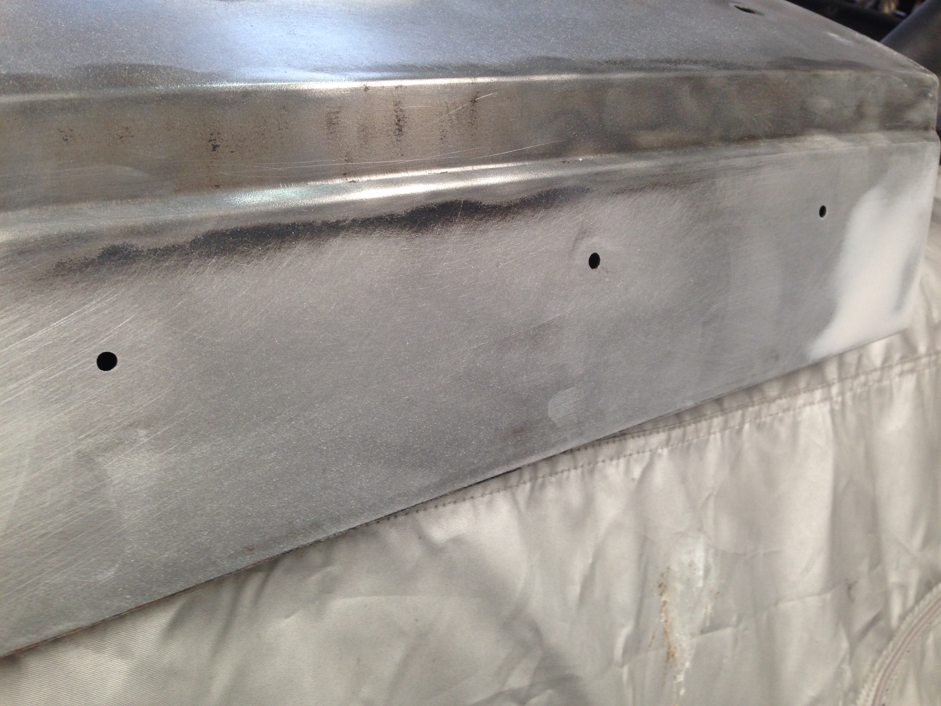

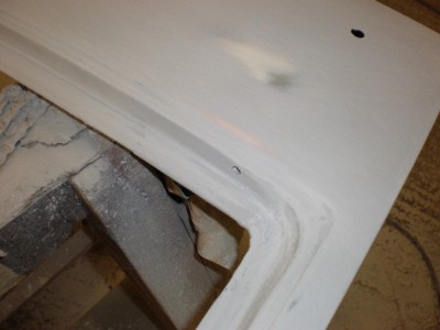

The new tailgate is ready to go on now
Bit of stripping back of the factory primer required due to surface corrosion in storage !
This tailgate must be from a later car than mine as it had the 2 holes in the middle of it for the big round Alfa badge where as mine has 1 badge each side of the tailgate so had to weld up the 2 holes and make 1 extra on the right side for the long badge and small repair to the corner where it was slightly bent The small dent on the roof has been repaired as well Coming along very well now

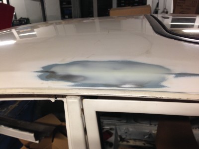

I noticed there was a dent or 2 in the roof, My car had the same problem and I have seen others with damage over the years, all down to the thin gauge of metal used as we all know.....
Another car saved which is great to see

Thanks for all of your comments and encouragement - not done too much for the last week or so !!
I guess the small dent in the roof is connected to the original accident

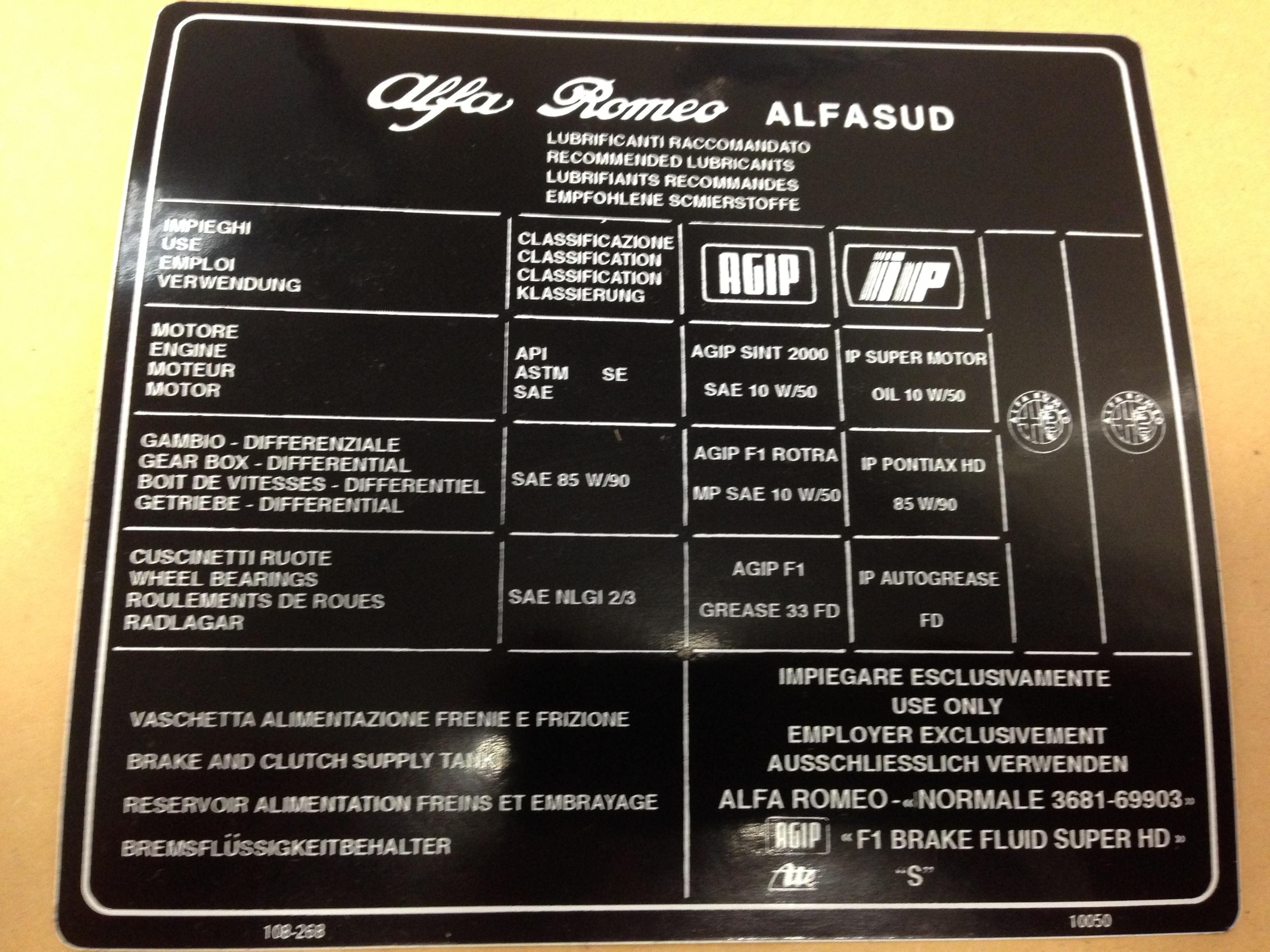

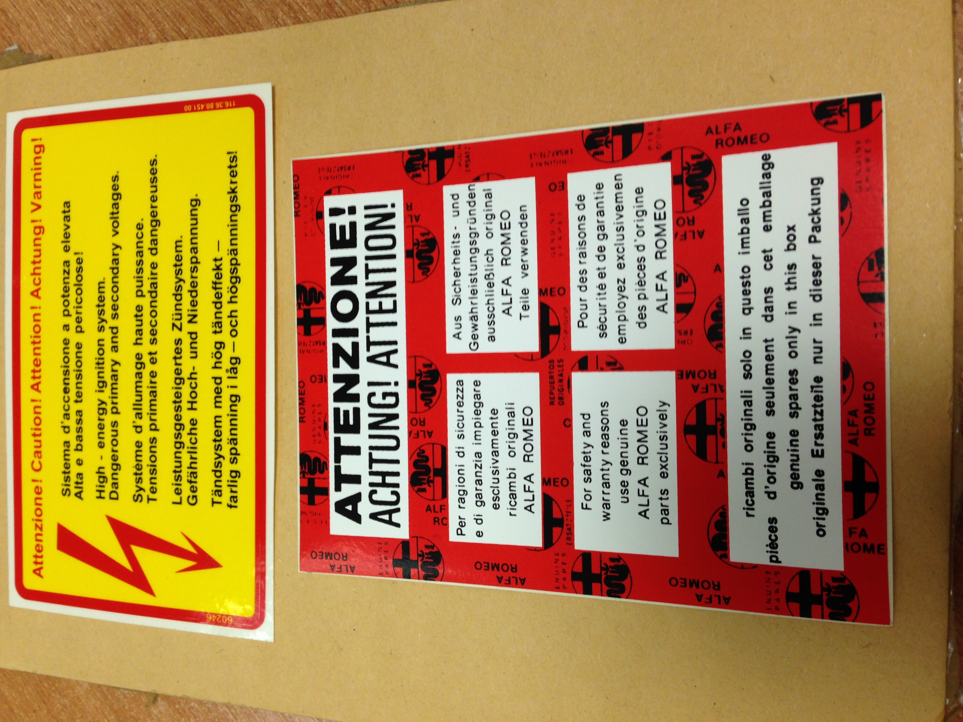

One thing that I have been doing is finding the stickers for under the bonnet
Got the oil one from Steve Parry (Mr Sud) on Ebay and the spare parts + ignition warning from Chris Sweetapple at Highwood Motor Co. Does anyone have a white paint code sticker as all I have from the original one is this ! I guess the last owner liked cleaning under the bonnet and it has all worn away
The paint code is 015 "Banco Capodimonte"

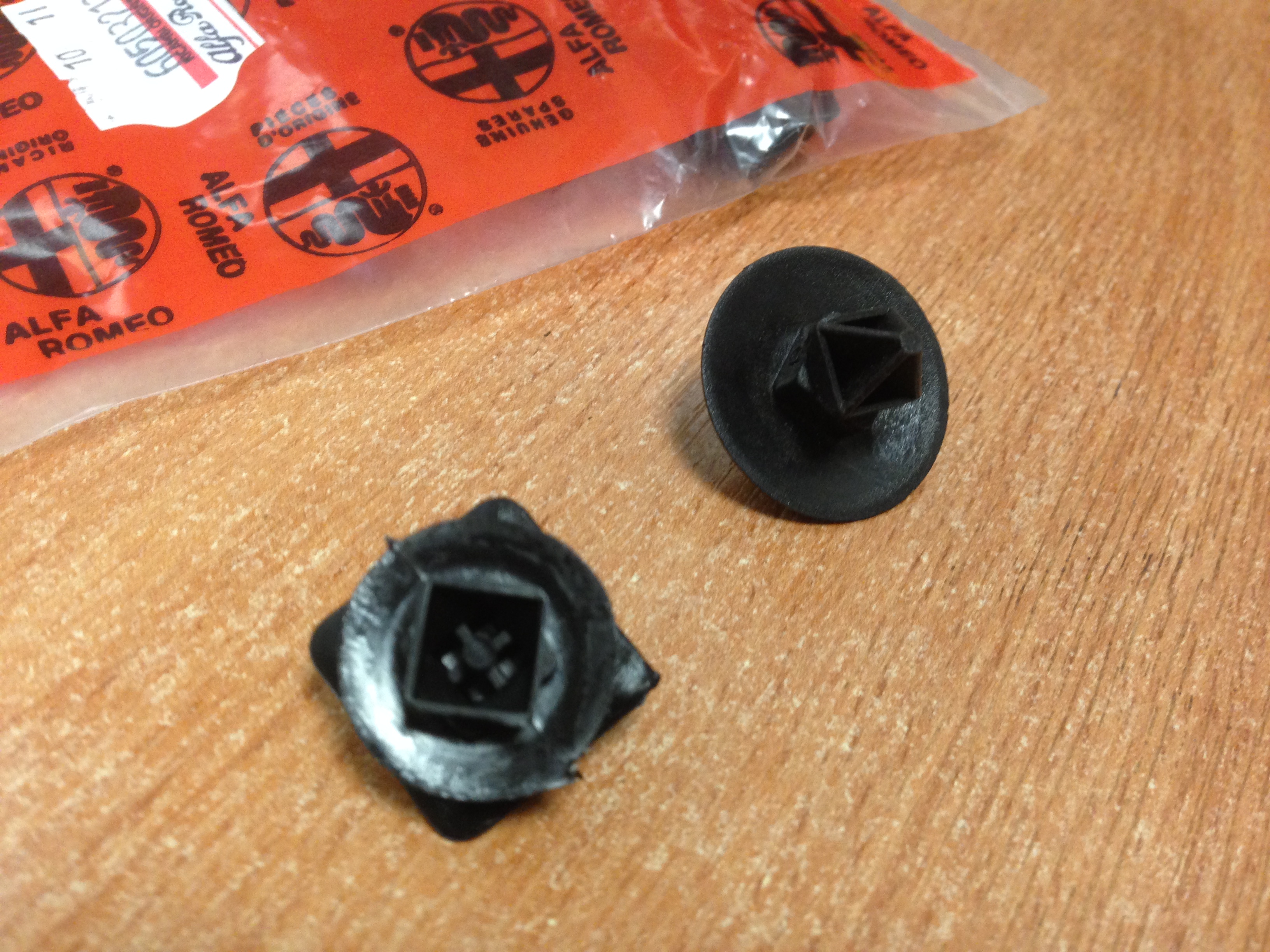

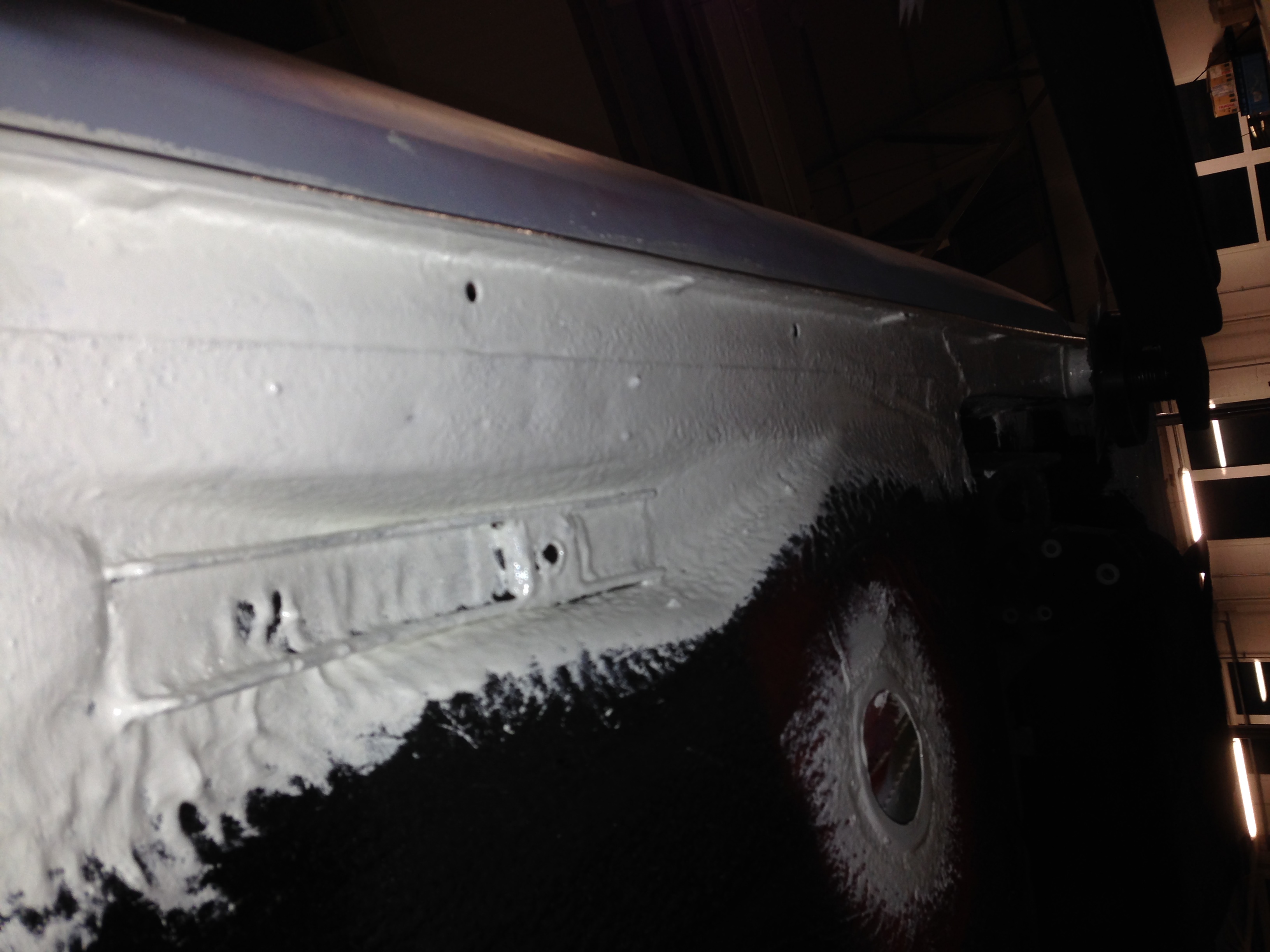

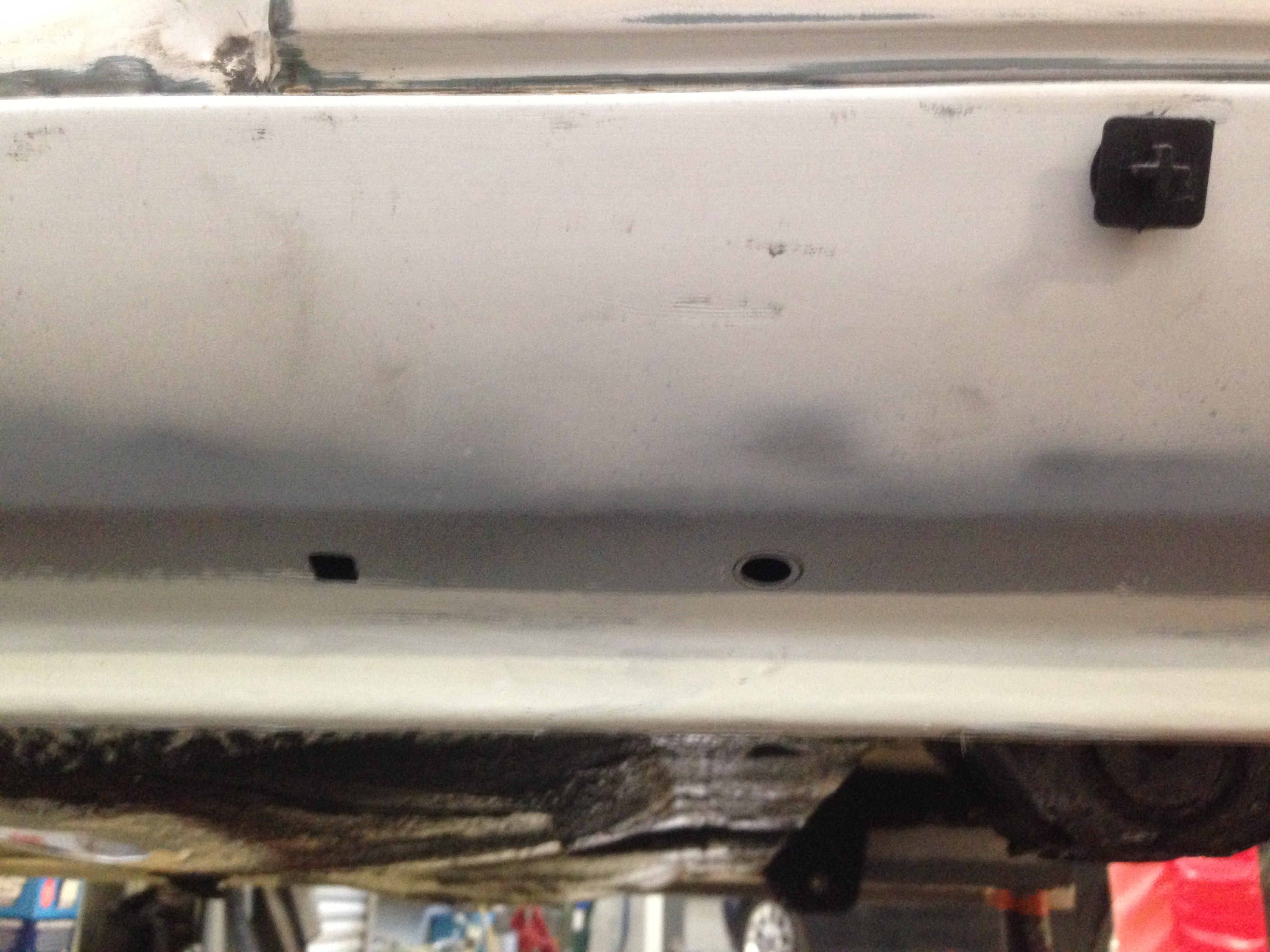

A small job done today was to make 10 square holes and 2 round holes in the new left sill panel for the sill moulding clips & wax holes
Did not think it would take too long but was nearly 2 hours in the end after lots of measuring from the other side and the remaining bit of cut off sill that I had kept so help with this job - another step closer to going to paint !
- Posts: 433
Re: TIx Restoration Project
....another job done, its amazing how long these smaller jobs can take to get right, better to have remembered to do it now than after paint though

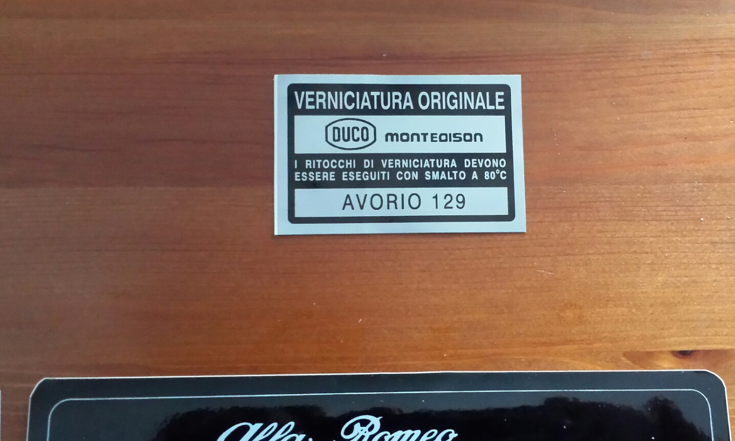

Gary,Gary Orchard wrote:One thing that I have been doing is finding the stickers for under the bonnet.
Does anyone have a white paint code sticker.
I guess the last owner liked cleaning under the bonnet and it has all worn away.
For the paint code decal, you might try Mount Carmel Spares:
http://www.mtcarmelspares.com
Alternatively, full decal sets for the Alfasud and plenty more cars are available here:
http://www.carclassic.biz/
I got a full set for my Sud Sprint from these guys and have got to say that the quality is good.
Only thing is that, as the decals are made overseas and to order for your specific model and its year of manufacture, you may find that the International postage isn't the quickest so you might have to wait a while to receive them.
Hope this helps.

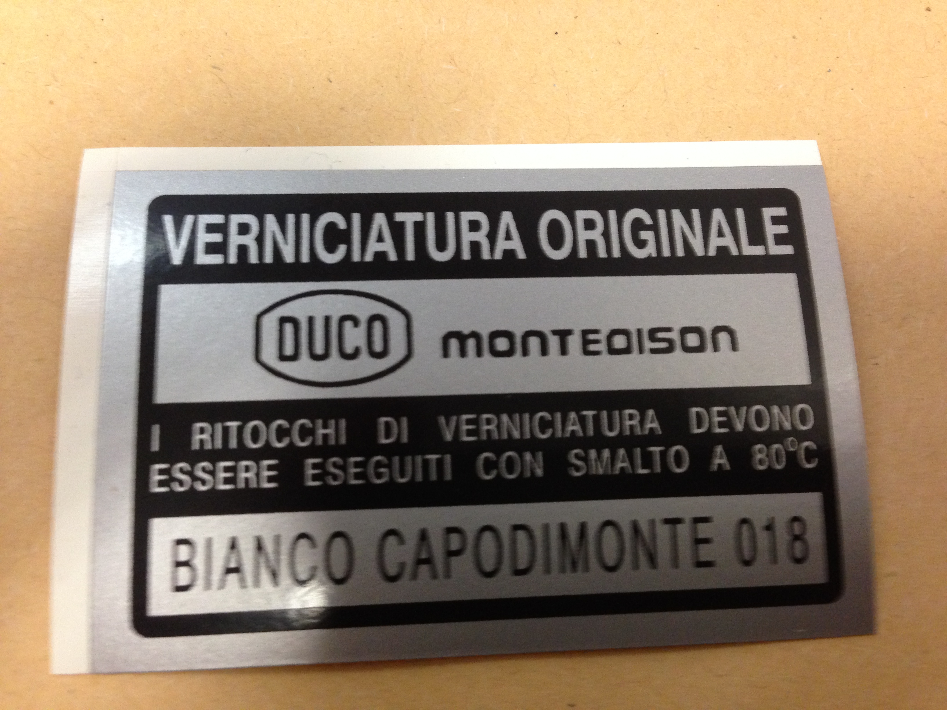

Hi Colin
Not seen that Mount Carmel site before so thanks for the link to that - it looks like this is where Highwood get the stickers that they sell from as they look exactly the same
I did buy a "Bianco Capodimonte" paint sticker from Highwood but it is not correct for a Sud - I guess it is for the 105 series cars This is what the one on my brown sprint looks like and I guess the one for the white Sud would be similar What did you get in the set that you got from carclassic.biz ? I have emailed them 3 times now since DickyB put up the link to them a while ago but never got any reply at all
Did you get the coil or alternator stickers in the kit ? How is Les's old sprint "ODE" coming along ? About time we had a build thread on here !!

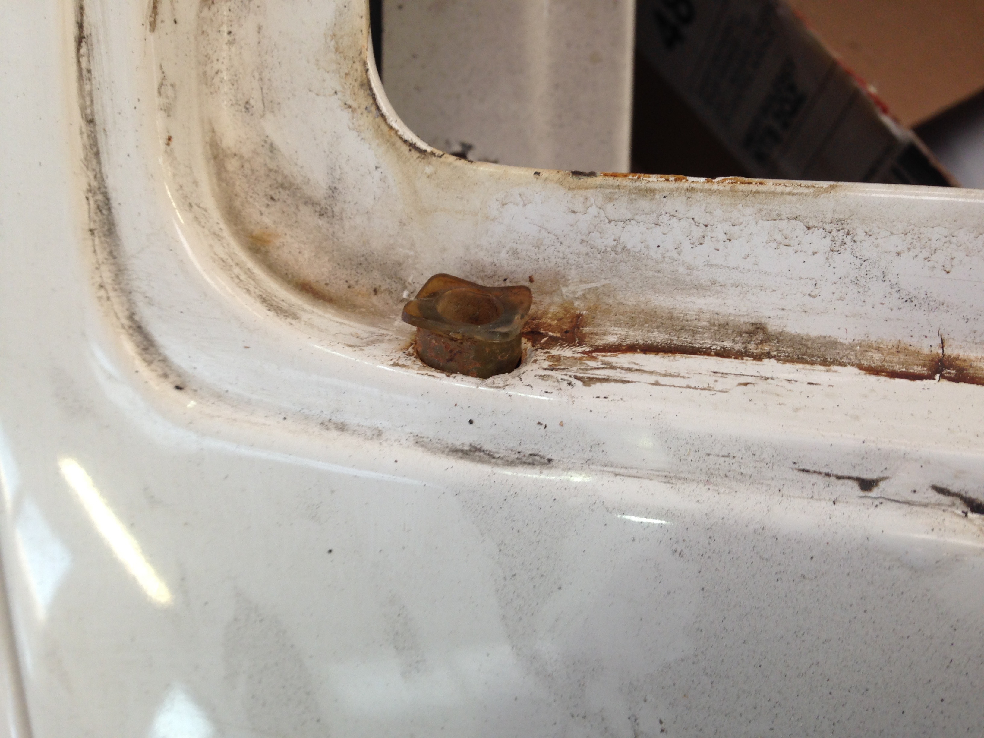

Hello Sud 145
My tailgate could be repaired but as I had a new one I have used that
Mine has also corroded from the holes for the plastic tubes
Not sure what to do with these tubes on my new tailgate - could weld the holes up and do away with them or fit them with loads of wax around them
I think the problem with the drain tubes is that they sit proud and the water has to be "Deep" before any drains out. The guy that restored mine formed the corners into a well with the tubes recessed. Jobs a goodun.

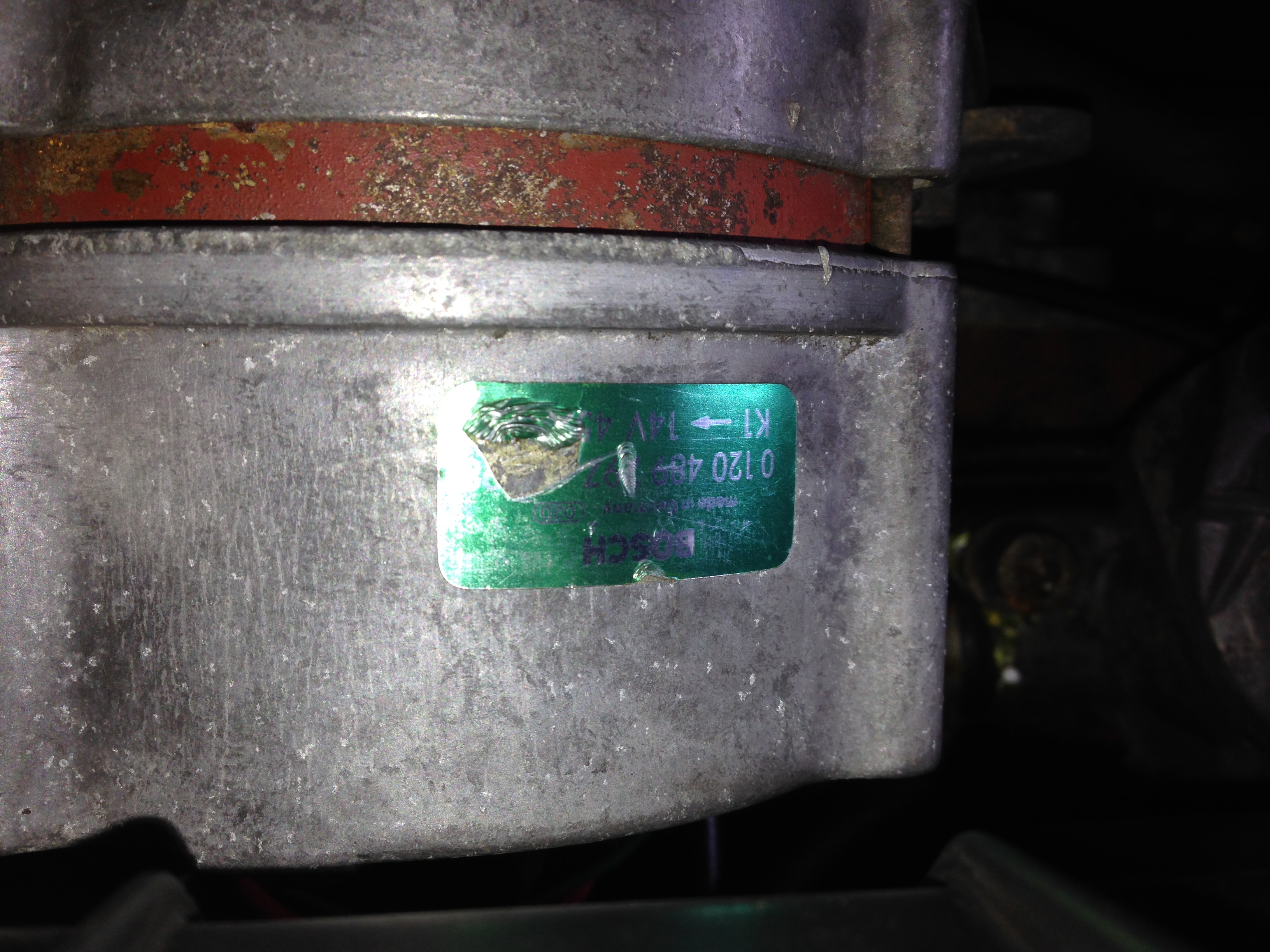

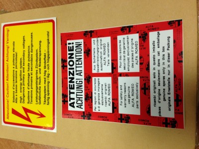

Hi Gary.Gary Orchard wrote:Hi Colin
Carclassic.biz: Communication isn't their strongest point I've found but the decals themselves are spot on. They're pretty comprehensive as a set and are of excellent quality. You can't really tell the difference from the originals. I'll try and get some pictures uploaded here later today to show exactly what's included in the kit.
After spending a good couple of months sourcing spares from all over Europe and beyond, ODE is now just about ready for her rolling restoration. I've spent too much time just driving her to be honest.
Plans though have been made so watch this space!

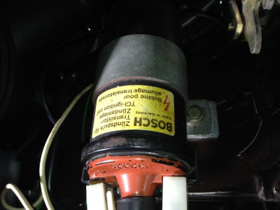

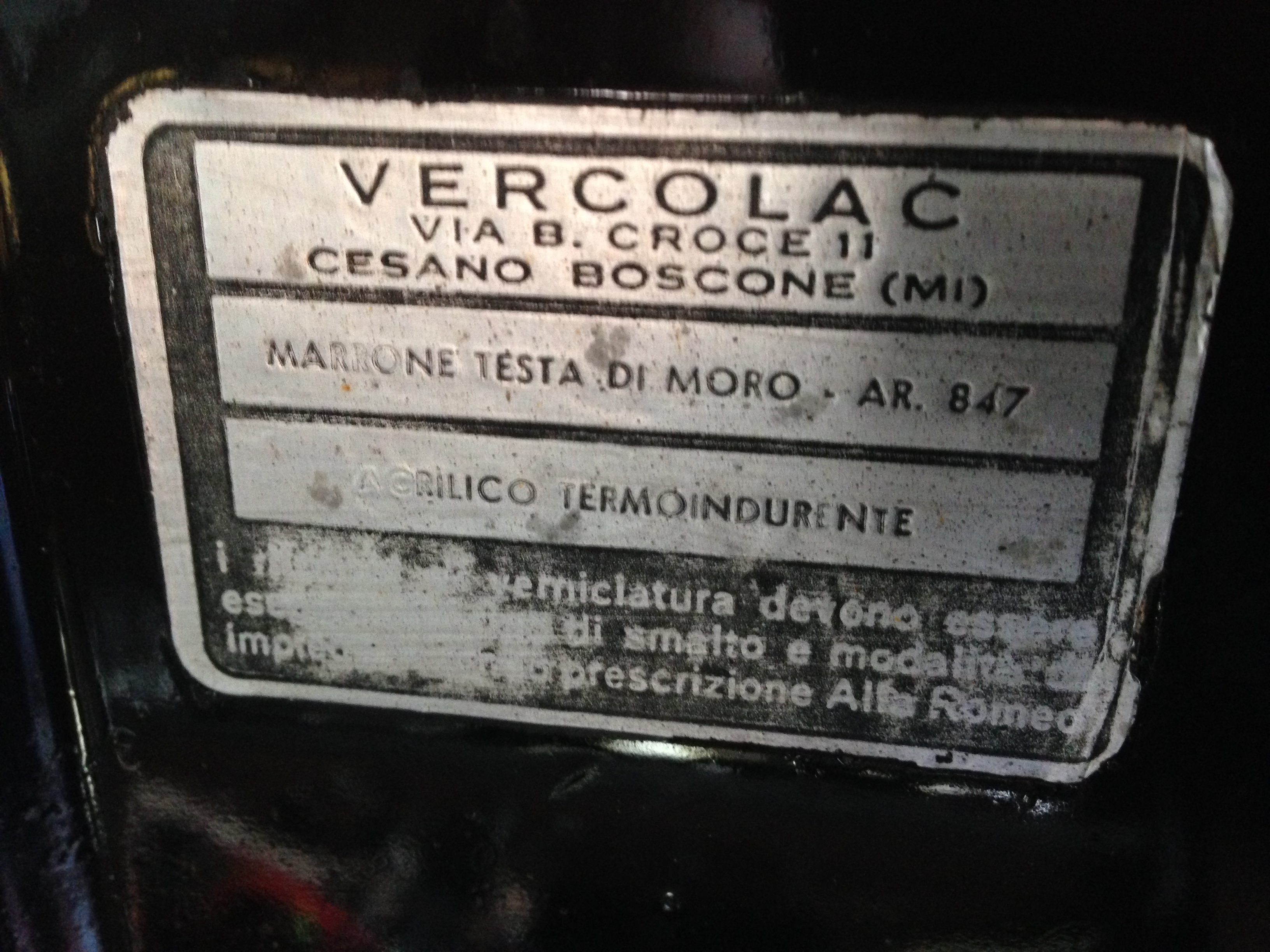

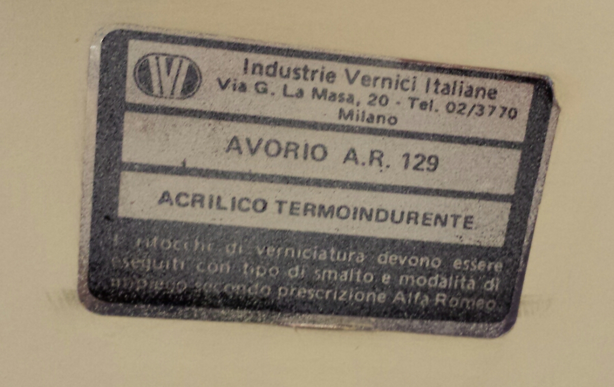

Thanks for the pictures Colin - I see that you do get the ignition coil sticker in the set, shame it says "Made in Spain" and not Germany !

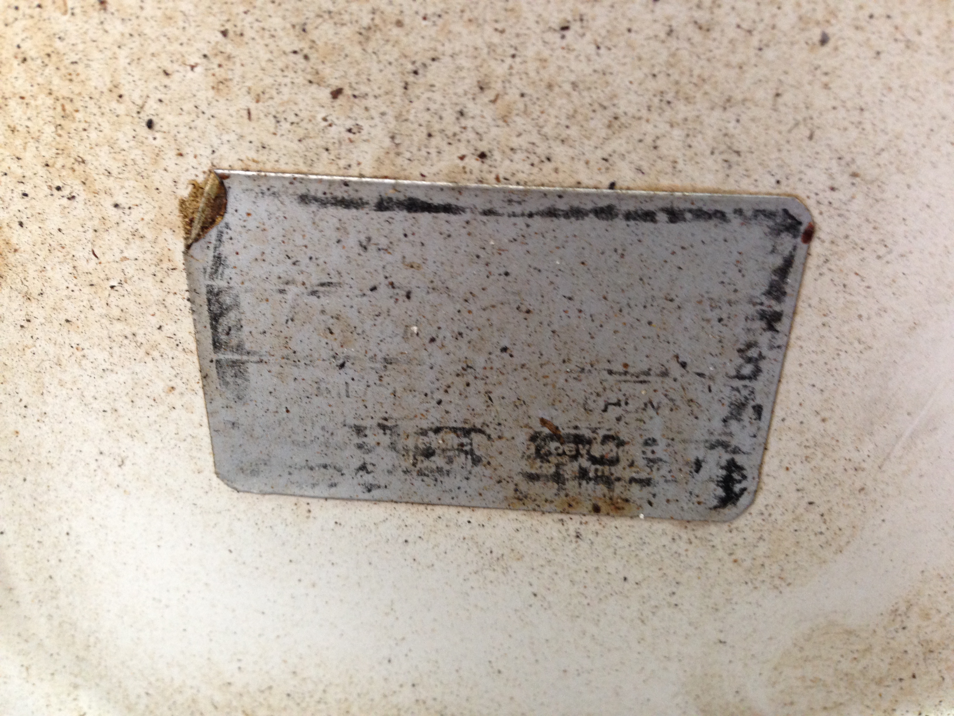

Does your sprint still have its original paint sticker under the bonnet ?
If so any chance of a picture of it
Also can anyone else with a Sud that has got an original paint sticker (any colours ) put a picture on here - just trying to work out if they all have the same basic layout - if so I wonder if we could get some made
Voilà...
First one i've ever seen.
Here is a photo of my old one.
This is a 1975 registered car .
Thanks for the pictures guys
Looks like there are a few different styles of sticker then !
Any more of you got an original one ? I have a feeling on the cars with a boot i.e. pre hatchback the sticker was in the boot
That is where mine was. You may notice the edge of mine has red paint on it.
It was re-sprayed red early in its life including inside the boot, but they left, and masked out the original colour sticker.
