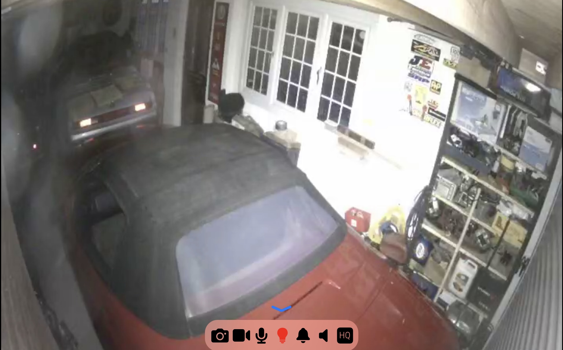

Same here Kev. We managed to have a shuffle round and managed to get the spider in the new garage. It’s now officially a 6 car garage. Stuff will have to come out for a couple of days next week as I’ve got the Sparkie coming to rewire the entire garage

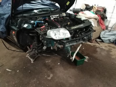

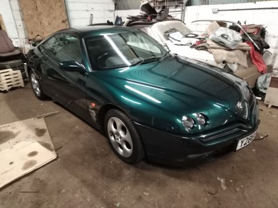

The car made it up to the unit as promised last month, all clean and shiny after a wash up there.
Over the Christmas period I got some time to get the drivetrain out so all the CF2 parts could be removed from the spare engine and fitted back to the original, now rebuilt unit.
Once the bumper and radiators are out there's a reasonable amount of space around.
With the engine bay cleared the subframe was simple enough to get out so it has been sent away to be grit blasted and powder coated along with a few pieces like the rad fan cowling and the lower rad support panel which suffers from location and heat from the rad so rusts quite a lot. Prevention of future issues better than waiting for it to be a problem.

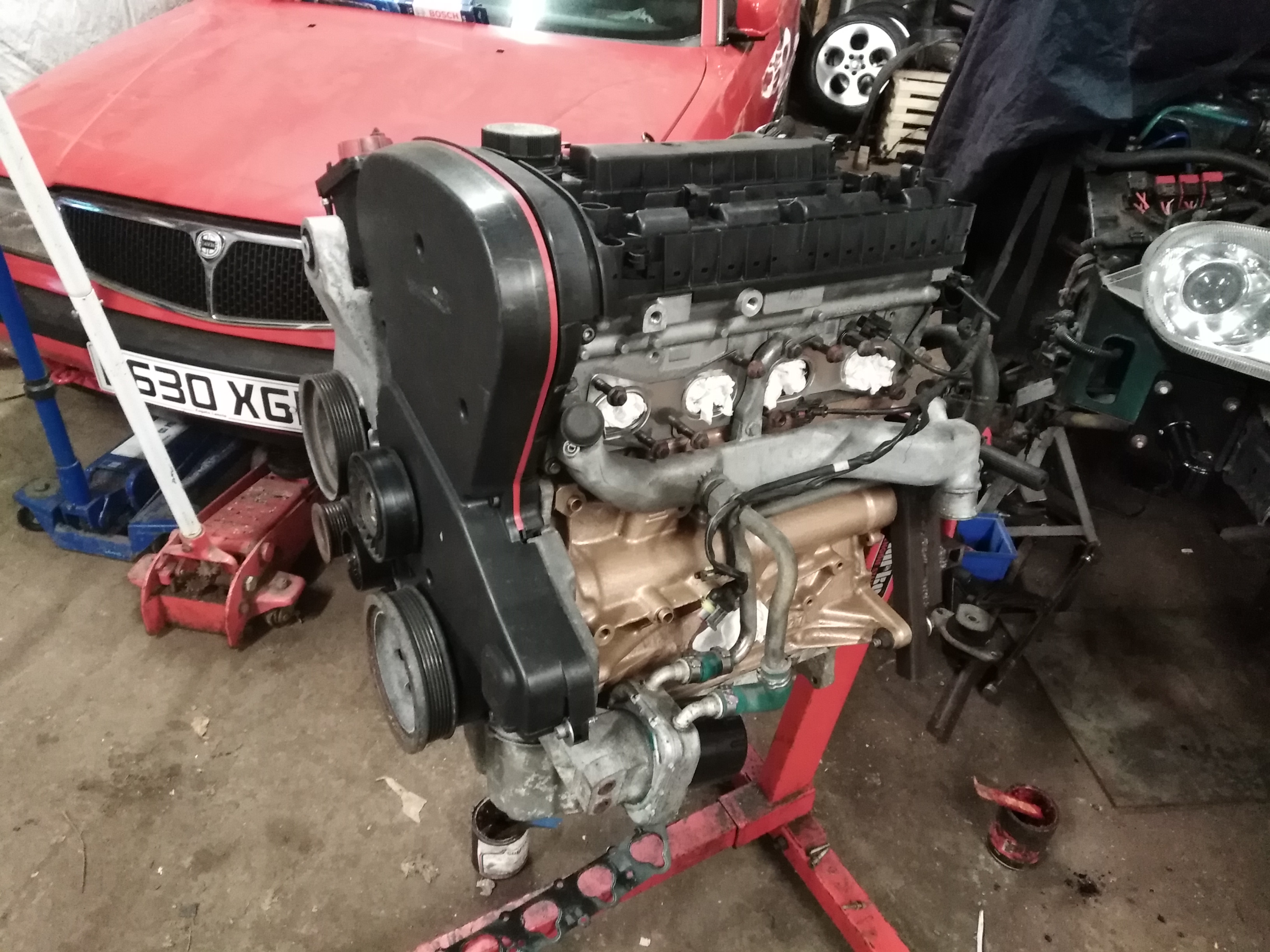

Engine now all but ready to be attached to the gearbox, still awaiting a new clutch so it can sit on the stand for now to be safe.
New belts, water pump, thermostat, cam sensor etc along with all the new internals... Hopefully it will last for longer than the original did!

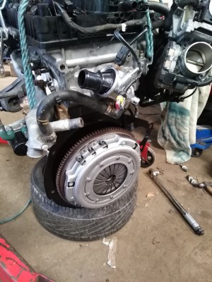

Had planned on getting the engine off the stand today to fit the flywheel & new clutch then re-attach to the original gearbox..sounded simple enough.
The gearbox had other ideas though, the clutch arm pivot was very stiff and the top bush seized to the fork so it was rotating in the gearbox rather than the arm rotating within the bush. There's a little detent on the bush which is supposed to stop it rotating which had long since depearted so had probably seized some time ago. It doesn't appear to have reamed the alloy out though so a new bush should solve it, a dab of loctite probably won't hurt. Meant though that it will all have to wait a while longer before being reunited. Haven't got the refurbished subframe etc back yet so no real drama.
I had given in to common sense and purchased a new Valeo clutch kit despite having what appeared a very serviceable one from the original unit, seemed daft to refit it despite the extra cost, but at least it will be all good.
The plate between the engine and gearbox I'd painted the other week to brighten it up.

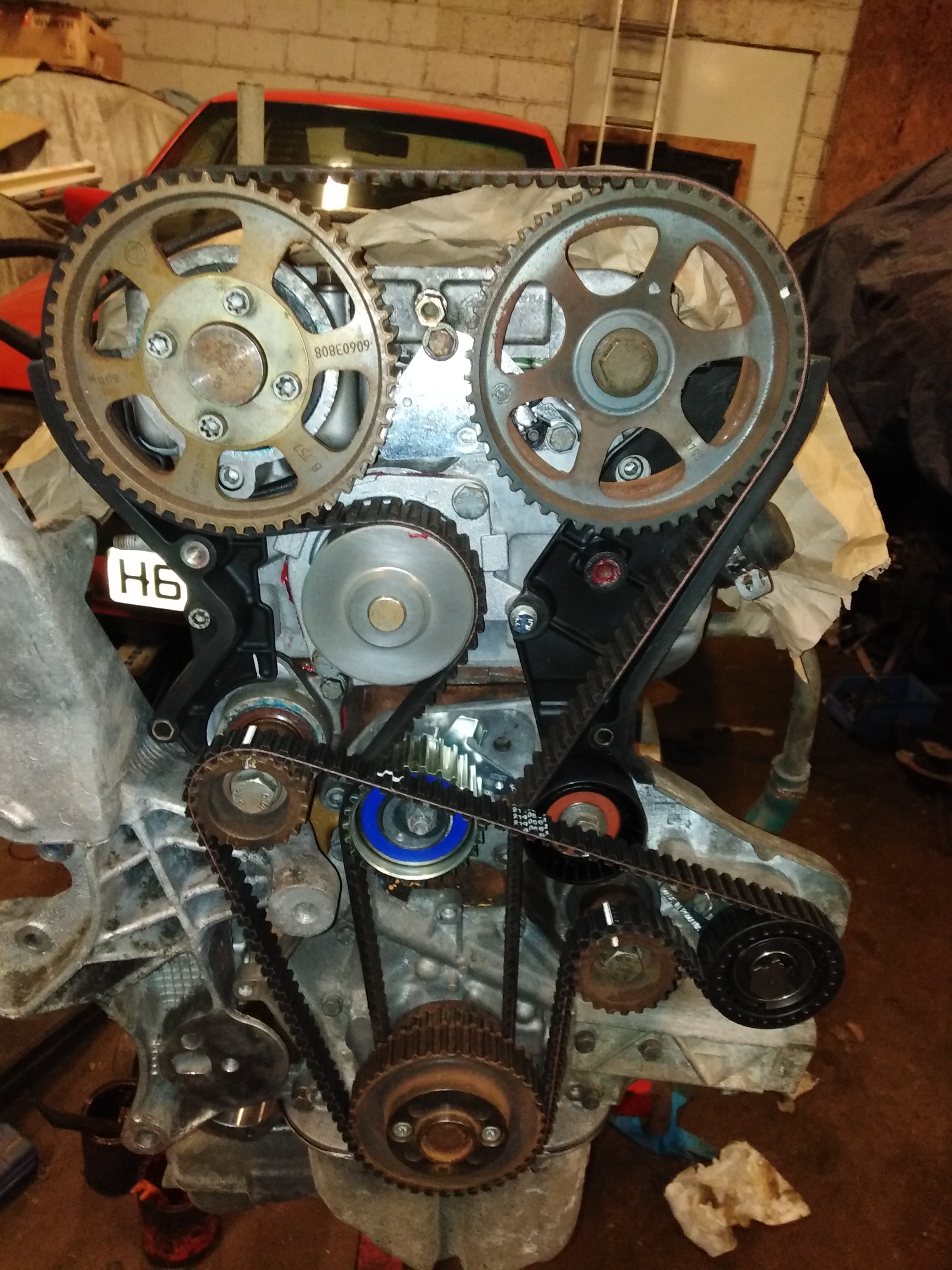

The camshaft sensor kept throwing an error code and the EML on. I'd fitted a new one in the hope of future proofing it as it's a PITA to get at, sits behind the exhaust cam pulley and the wires run behind the water pump housing and the inlet cam pulley. Also the power steering reservoir needs moving aside to get the cable out.
So that's belt off, again, and a fiddly job to refit the original one that had worked perfectly well before.

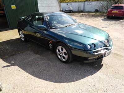

Last few jobs ticked off the list today and a quick ride around the block shows the gearbox is fine, having never used it I hoped it would be!
A wash and polish before SAD at Duxford once it's had a bit of running around and should be great for the summer.
