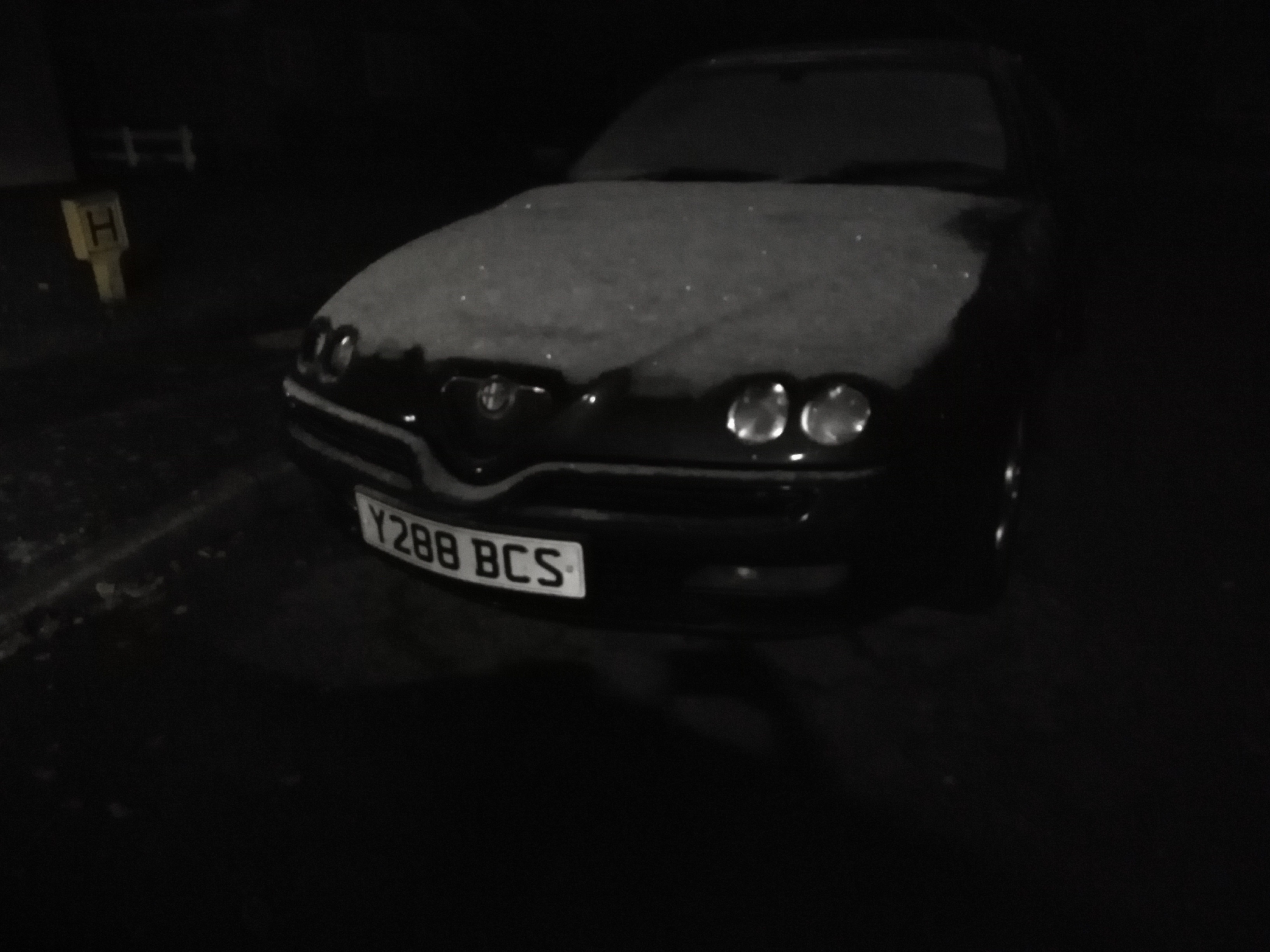

With the cold snap the poor car is now out in the frost, not ideal but didn't have room for it at the unit with the recent Flaminia purchase.
John though has insisted we take it up there and use what would have been space for his cars rather than have it sat outside, so this afternoon it's gone up there to sit with the 4 Lancia cars and John's 306 gti, soon to have his 405 T16 and his 308 gti, or his recent purchase of an MX-3 so quite a collection.
This does mean though with the shuffling we have done that the GTV is now in a position to have the engine etc removed ready for the rebuilt unit to go back in. Whilst that's happening I'll take the subframe off and get it blasted and powder coated. New bottom arms, bushes and links etc should set it up for a good few years.
All ahead of schedule as I expected it to be March before getting space.
At least it won't be sat out in the frost and snow to come!

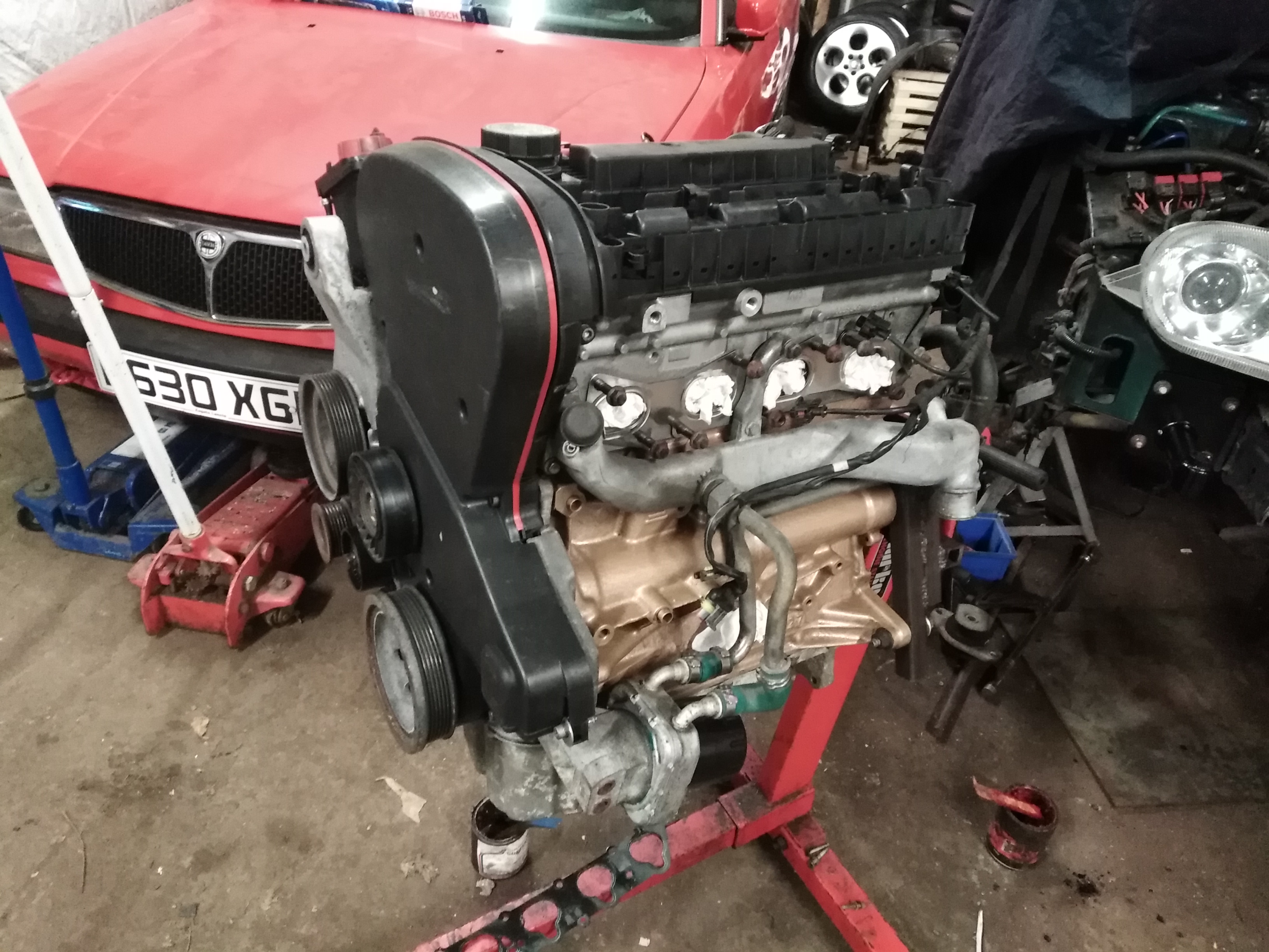

Engine now all but ready to be attached to the gearbox, still awaiting a new clutch so it can sit on the stand for now to be safe.
New belts, water pump, thermostat, cam sensor etc along with all the new internals... Hopefully it will last for longer than the original did!

Looking at your engine photo Kev, I can't believe I once replaced a plenum manifold on my GTV while the engine was still in the car.
