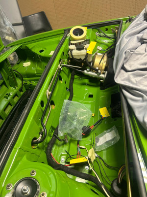

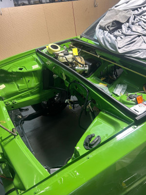

Engine & gearbox reunited. Wiring going in. The target is to have the car ready for display at Goodwood Revival, albeit incomplete & not moving under its own power. Inner CV joint covers away for plating. Seats back from trimmers at last.

Looking good Chris !
Posts: 1511
Re: SPRINT RESURRECTION
I can see your reflection in the paintwork!
Posts: 2891
Wow !! that is looking stunning.
Beautiful attention to detail. Love it.

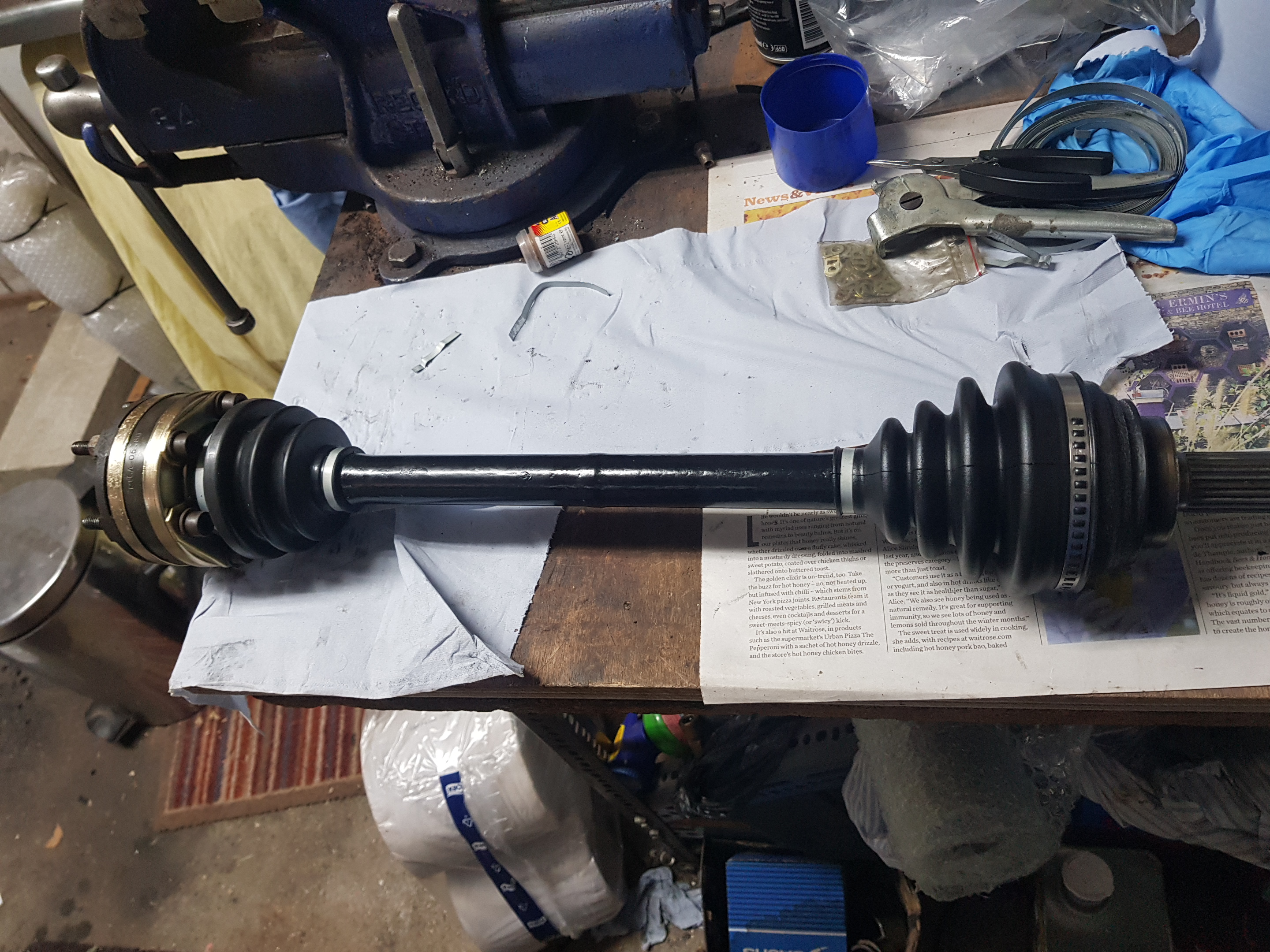

Gentlemen, thank you for your kind words. I have completed the filthy task of refurbishing the drive shafts. One of the joints decided to liberate its ball bearings, which was "interesting" to reassemble. As you can see, I indulged my fetish for yellow zinc plating :lol:

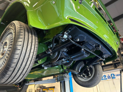

So I went over to Prestige with my son (RR tech). The Sprint was up on the 4 post lift. Comment was made about having to drop the brake discs to get at the bottom engine stud & nut (I can get at it with a thin wall 3/8 drive socket & long extension). Sprint was lowered to the floor & slowly rolled. Chris reached in and lifted the handbrake - no change. I couldn't understand it! I had set the brakes up so they wouldn't need messing with post engine gearbox refit. My son & I peered down at the brake caliper levers while Chris operated the handle.......yep the levers were moving to just over half travel, but still the car moved. The combined brain power of the three of us couldn't understand why no hand brake.
Meanwhile on the shelf behind us was a pair of driveshafts :oops: :oops: :oops: that I had taken over with me :roll:
Posts: 1511
I did notice the driveshafts were missing on the underside shot!
I was going to remind you, but thought that wasn't necessary!

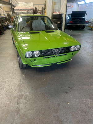

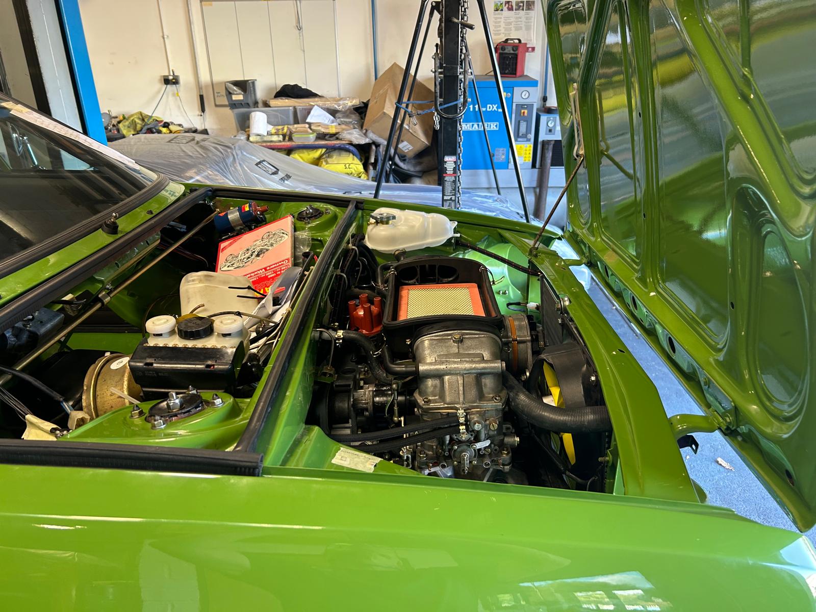

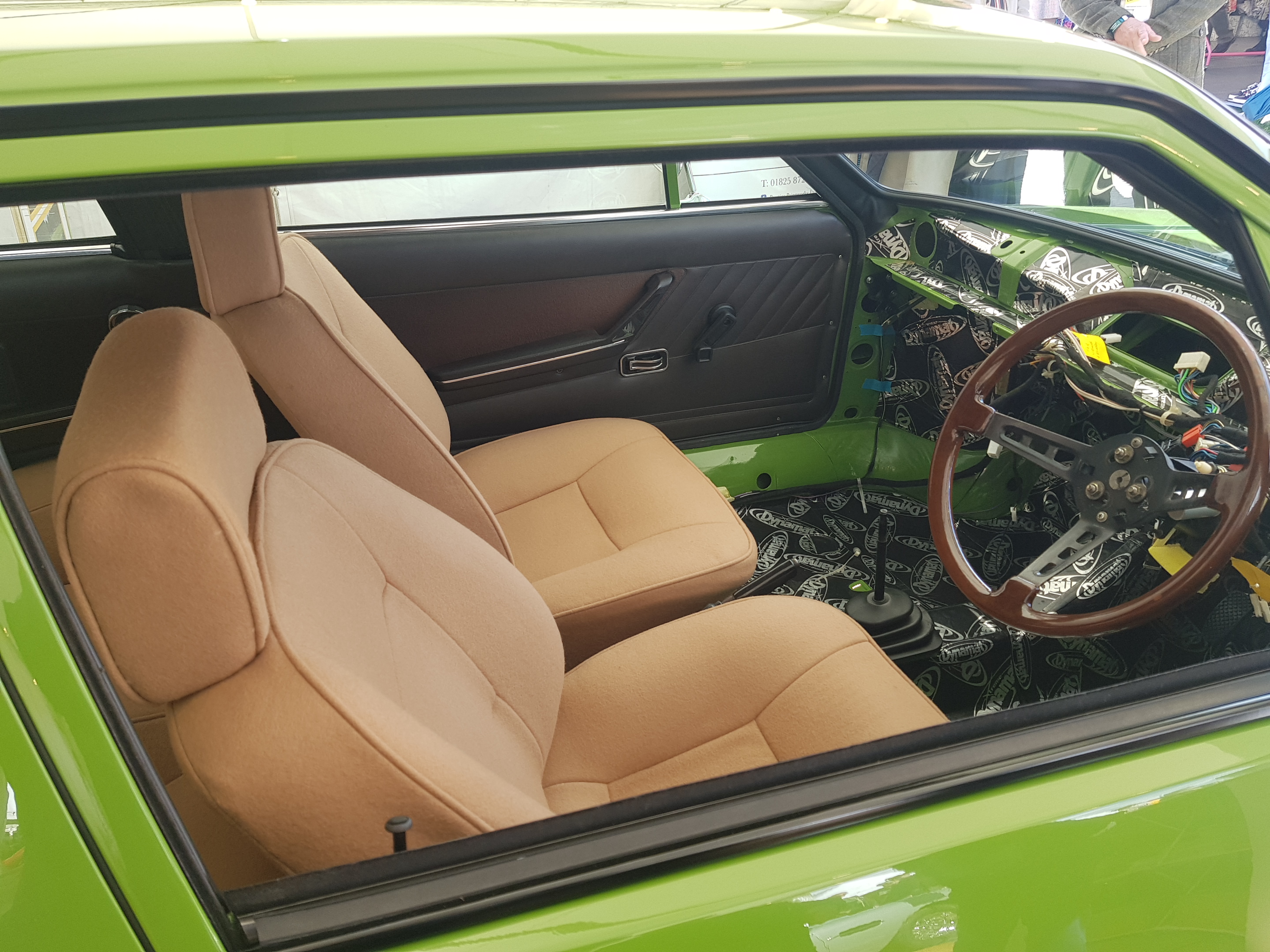

How many more pic of a green Sprint can you take? The seats got installed for Goodwood after all.......car seems to be riding a bit high at present.

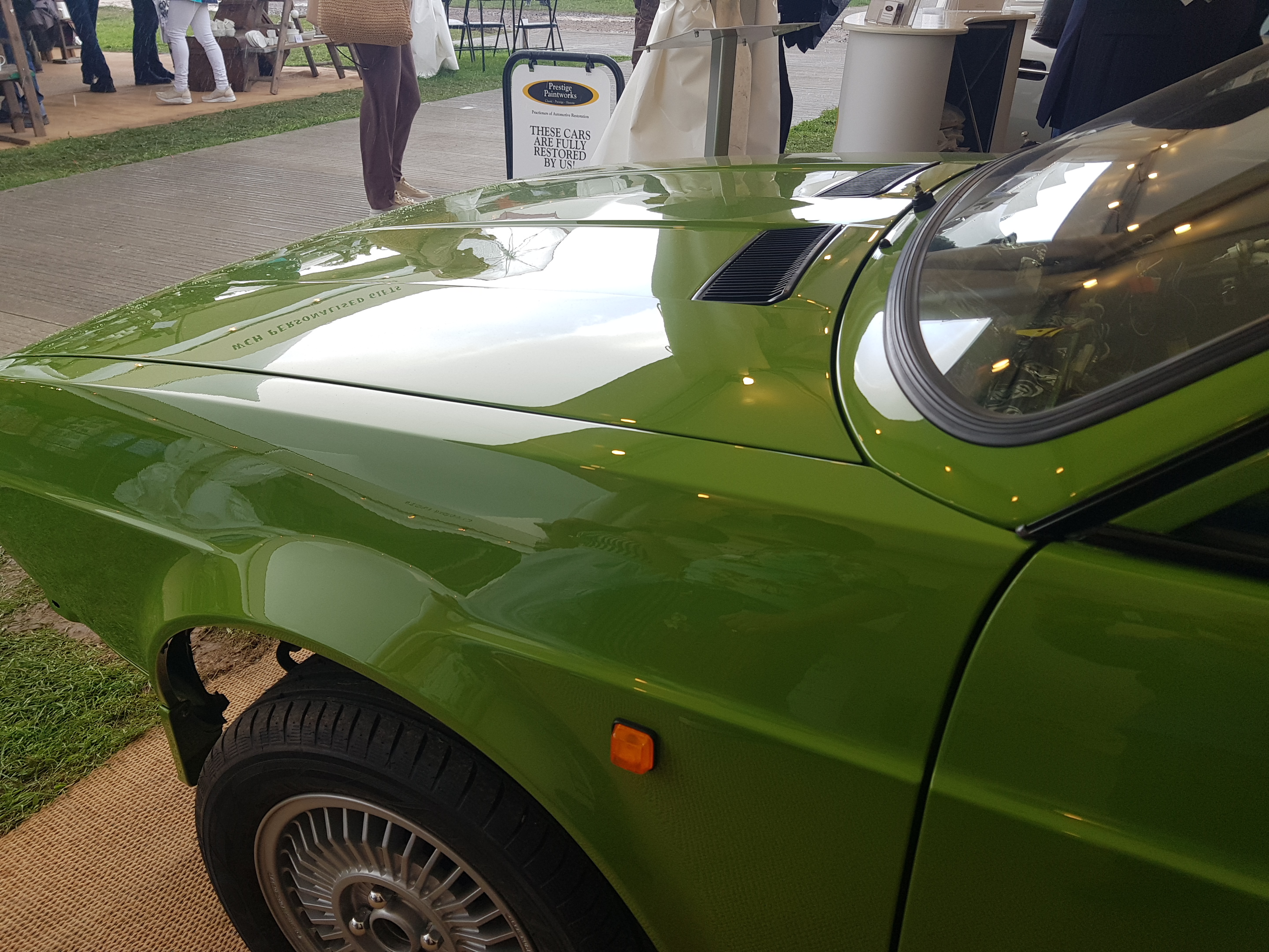

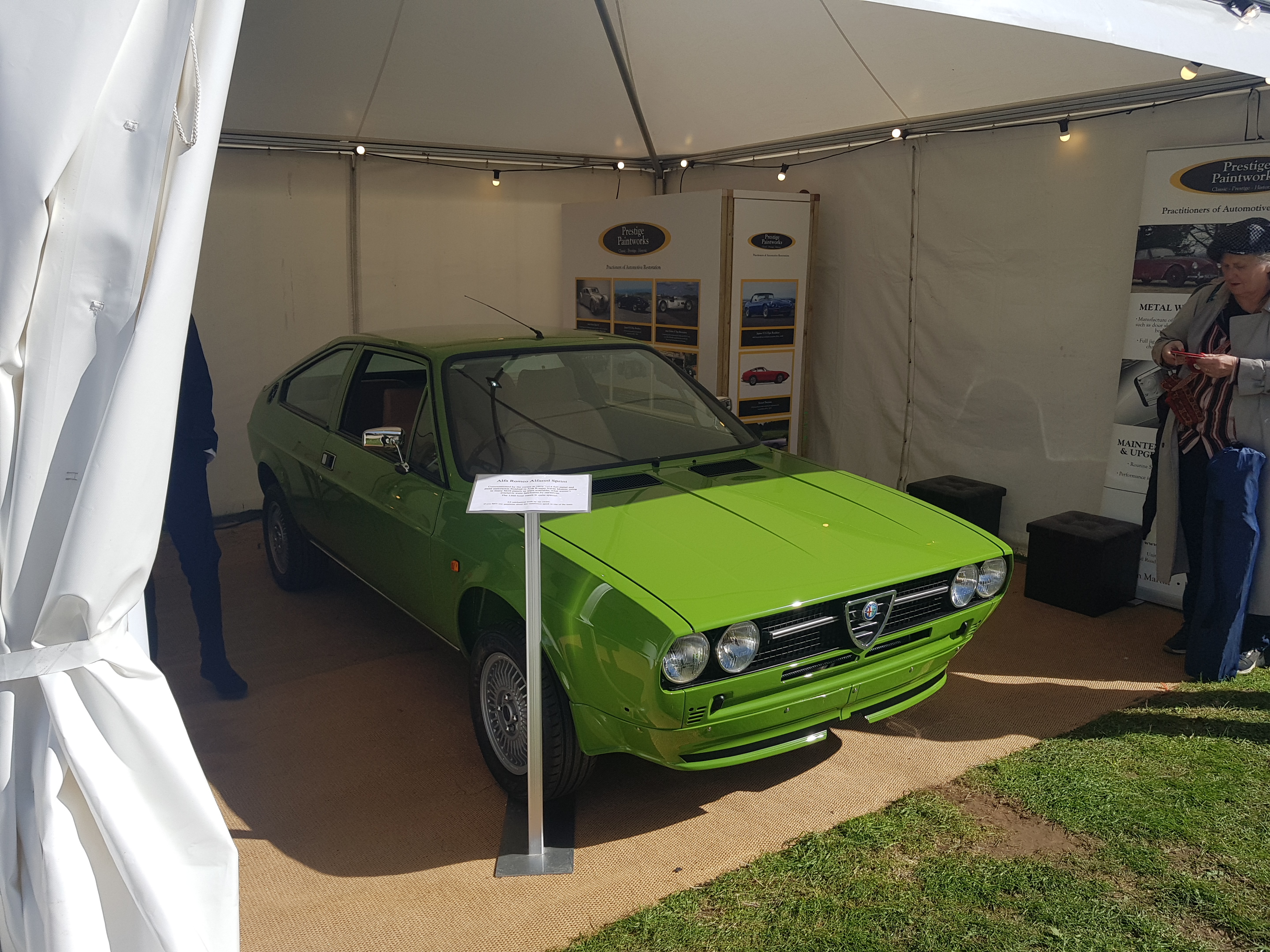

Final pic taken at the shop prior to transport to Goodwood. I do have a pic of the car description on the stand at the front of the car......but it states the man hours & if you see them it will confirm I'm a lunatic.
Alfamet

Posts: 2891
She looks beautiful and credit to the quality of workmanship that has gone it to her.
Credit to you as well for taking the restoration to this level. You may be a loony, but a good one.
