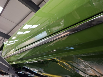

Engine & gearbox reunited. Wiring going in. The target is to have the car ready for display at Goodwood Revival, albeit incomplete & not moving under its own power. Inner CV joint covers away for plating. Seats back from trimmers at last.

Looking good Chris !
Re: SPRINT RESURRECTION
I can see your reflection in the paintwork!
Wow !! that is looking stunning.
Beautiful attention to detail. Love it.

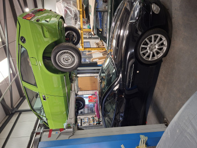

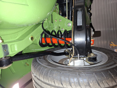

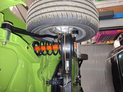

So I went over to Prestige with my son (RR tech). The Sprint was up on the 4 post lift. Comment was made about having to drop the brake discs to get at the bottom engine stud & nut (I can get at it with a thin wall 3/8 drive socket & long extension). Sprint was lowered to the floor & slowly rolled. Chris reached in and lifted the handbrake - no change. I couldn't understand it! I had set the brakes up so they wouldn't need messing with post engine gearbox refit. My son & I peered down at the brake caliper levers while Chris operated the handle.......yep the levers were moving to just over half travel, but still the car moved. The combined brain power of the three of us couldn't understand why no hand brake.

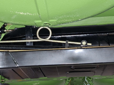

I did notice the driveshafts were missing on the underside shot!
I was going to remind you, but thought that wasn't necessary!
