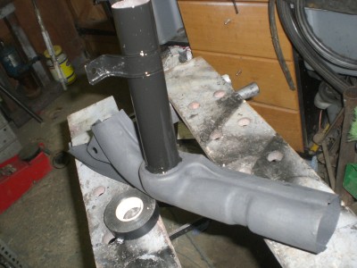

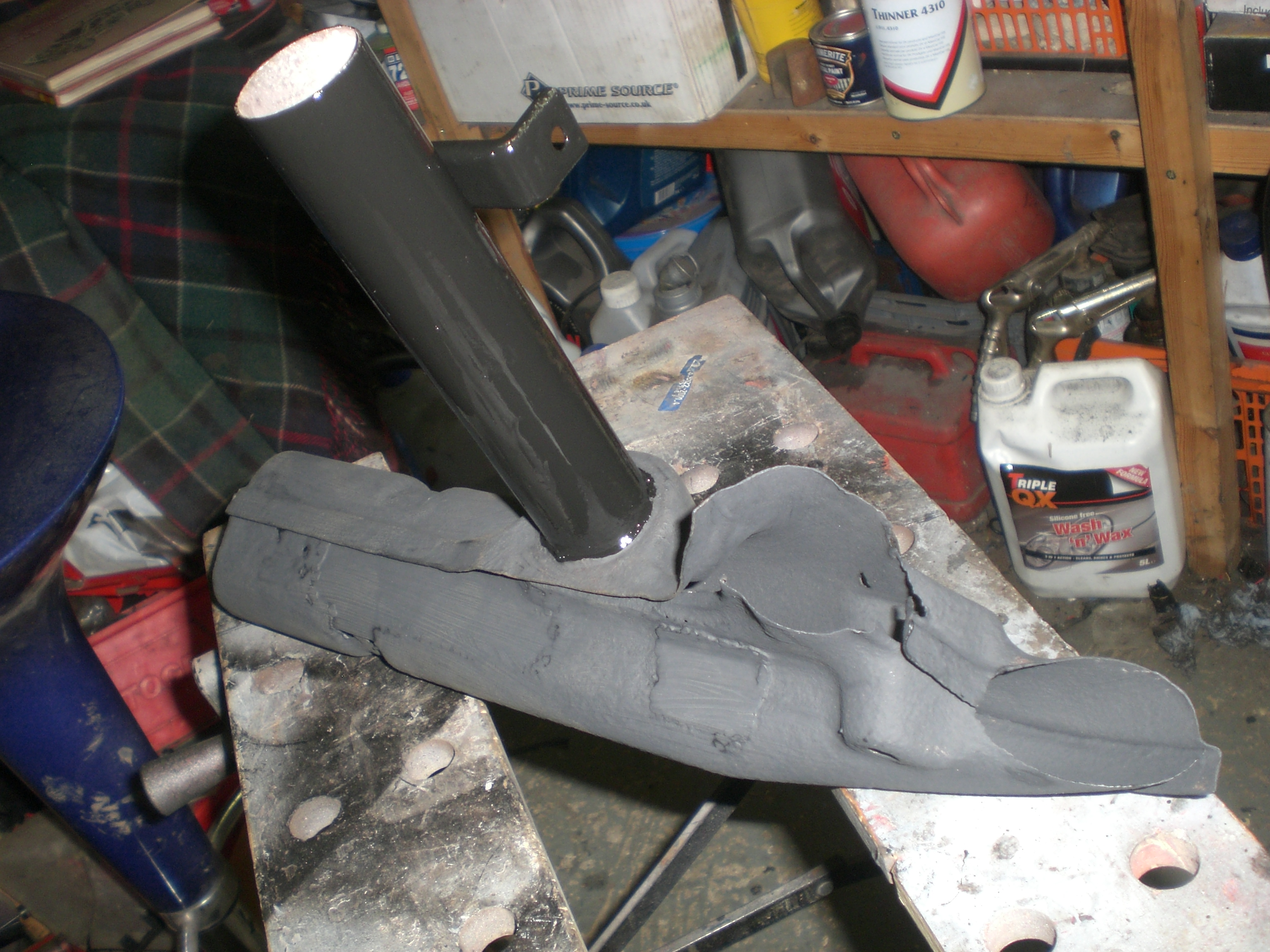

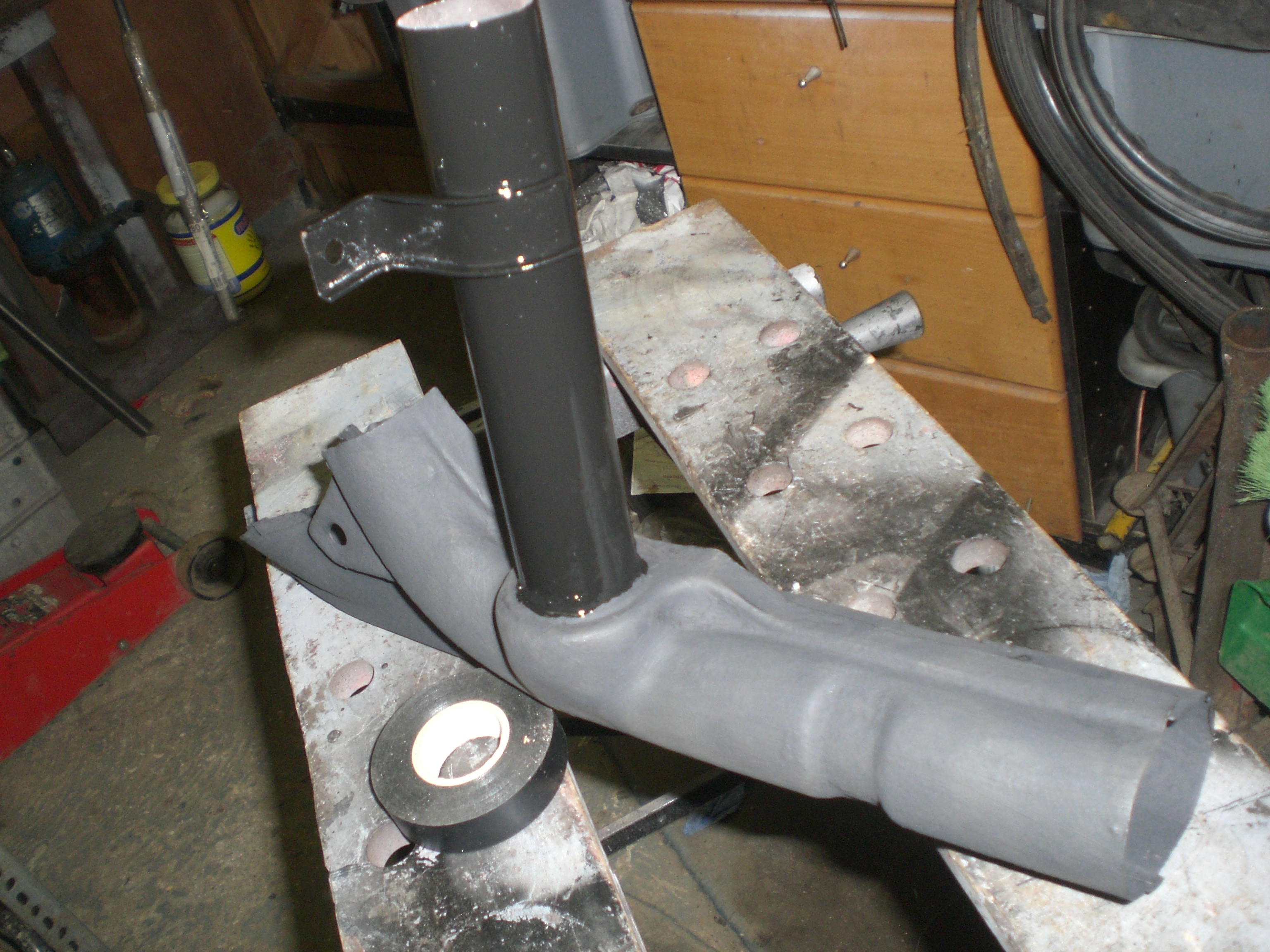

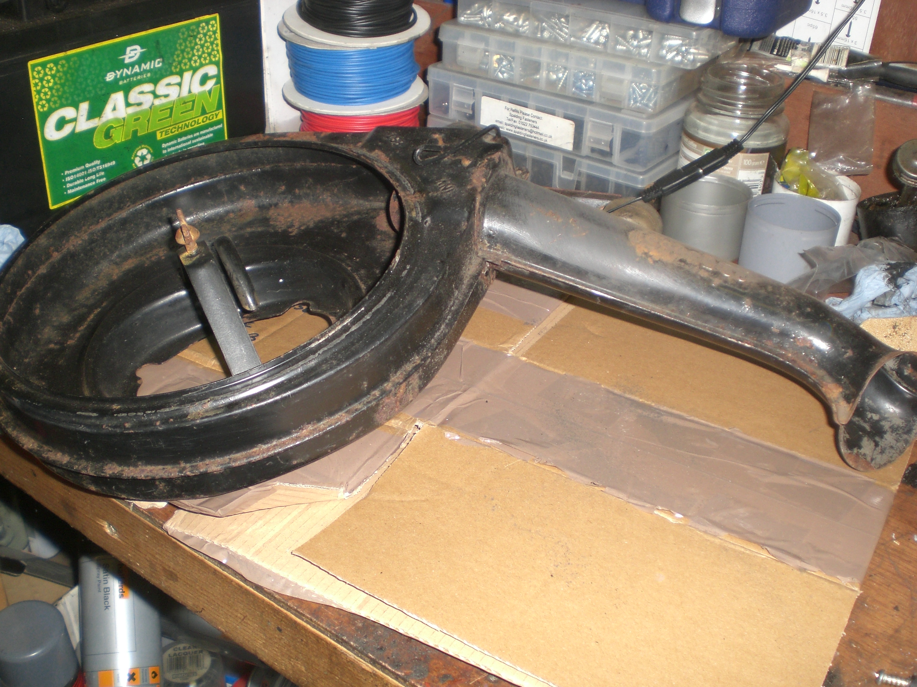

exhaust heat shroud for the air filter needed some repairs as was only about 75% complete but ready for fitting now

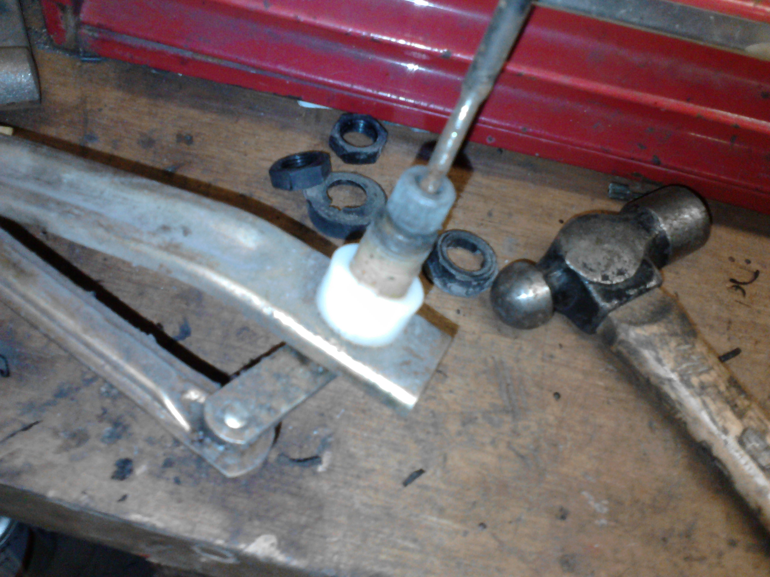

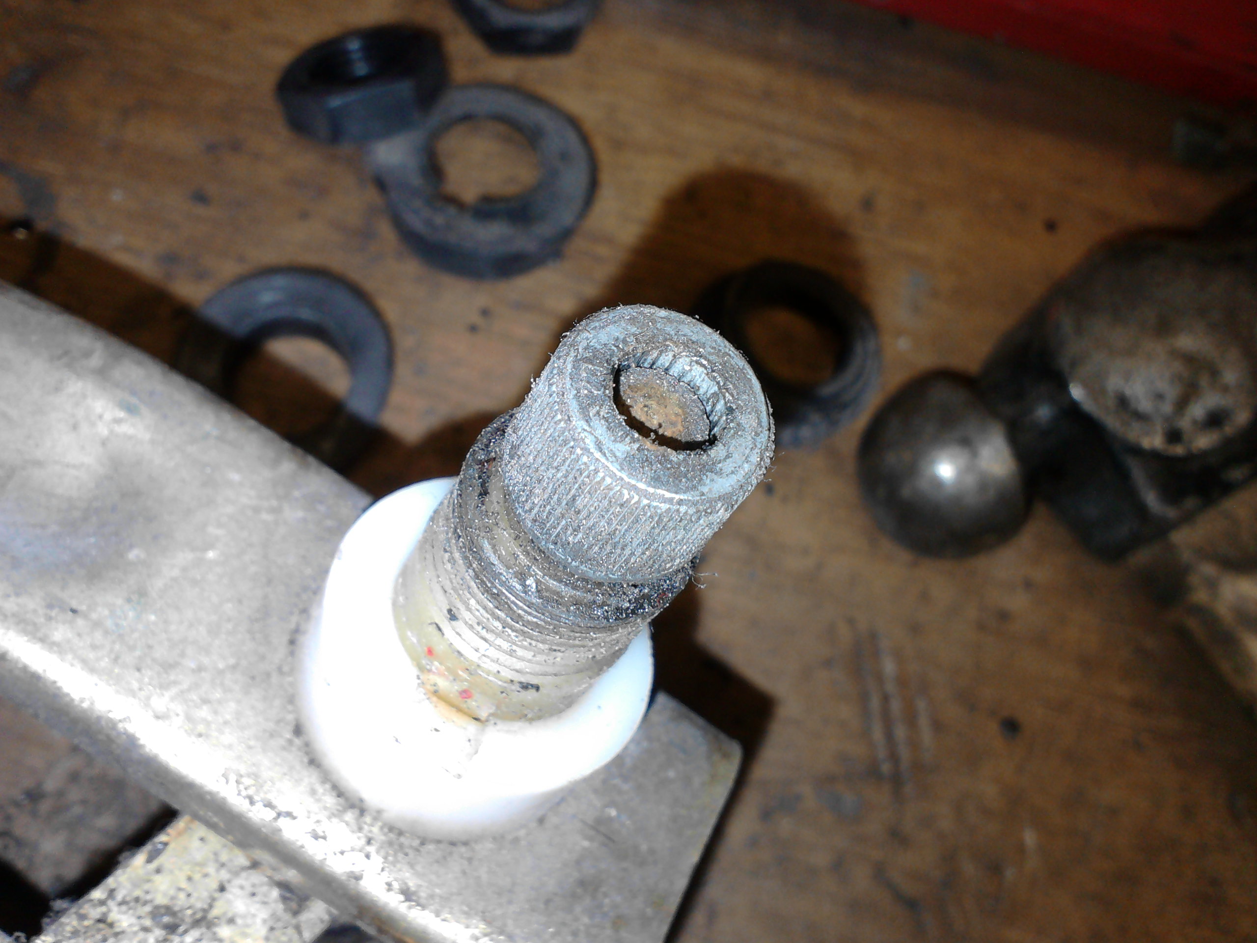

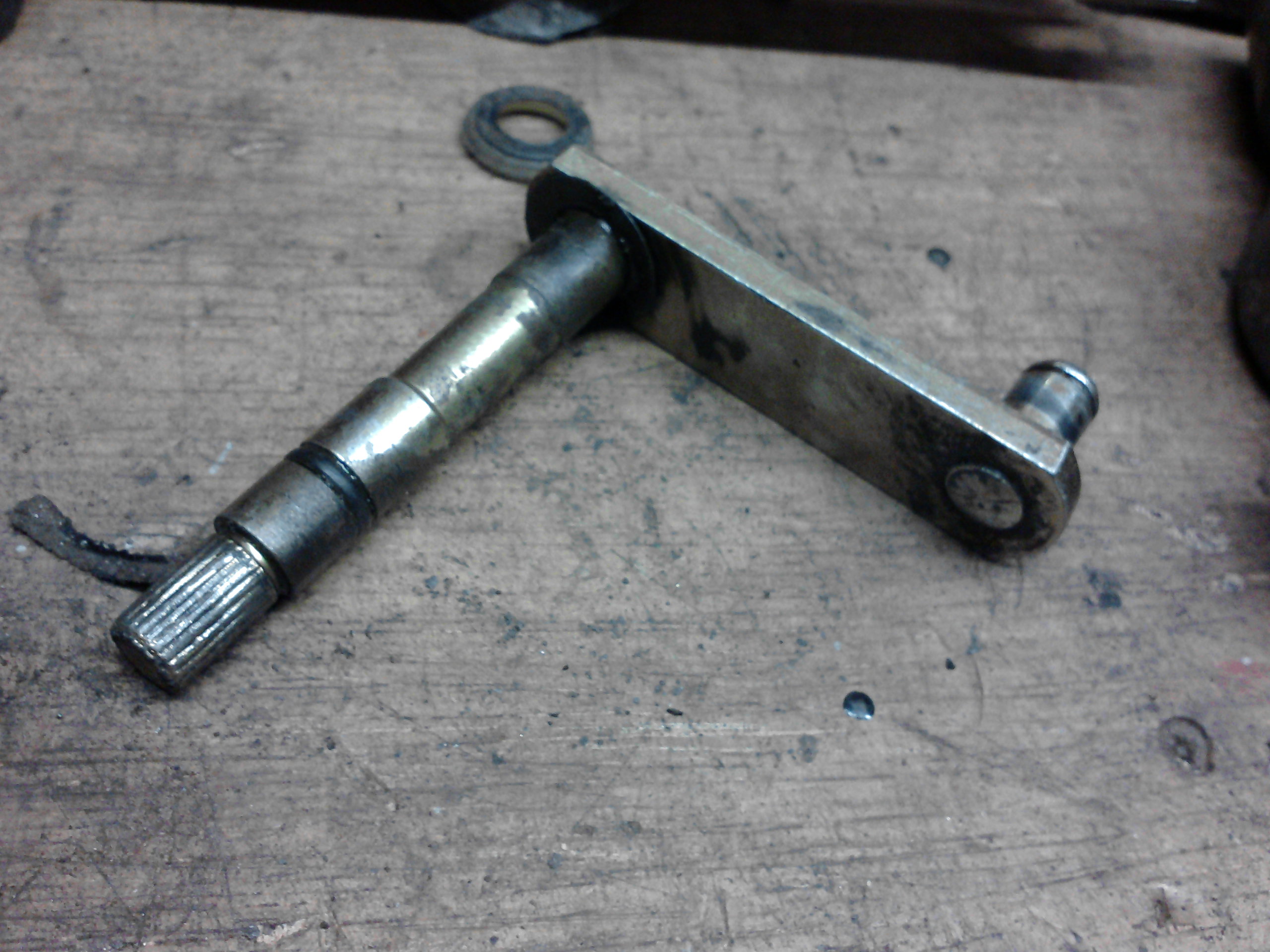

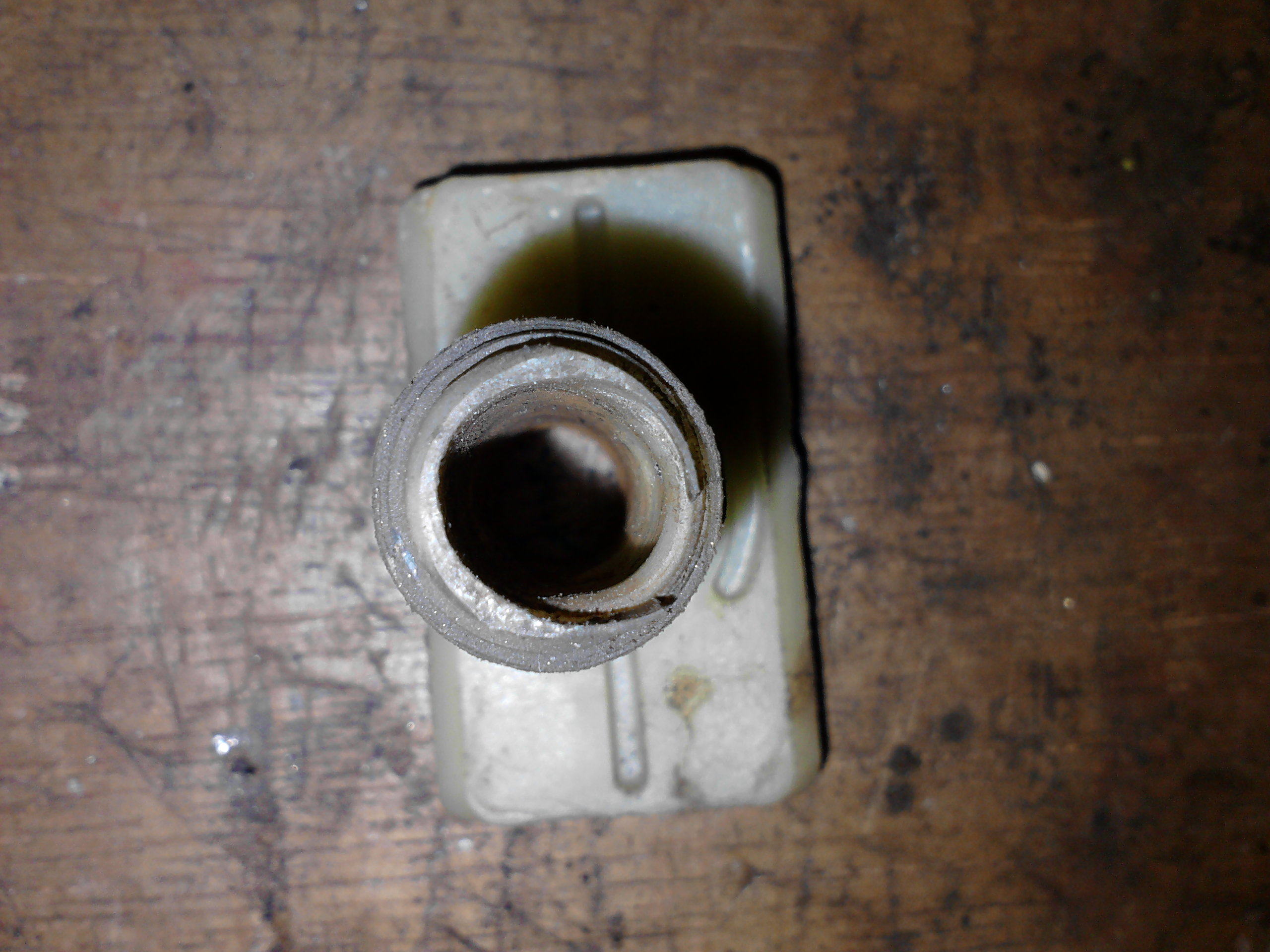

i also found the right combination of parts to make up a decent wiper motor & linkage.
most sets have badly worn wiper spindles by now being in plastic housings but finally i found a decent pair.
even though the spindles were free from any play it is crucial for the long term life to strip them down and grease it for the long term lastign ability.
here's a few simple steps that you can do on your own to prevent future failings.
once the linkage is off the car then heres how it comes apart.
the splined part where the wiper arms mount is just an interference fit so can be punched out, knock the spindle out through the hole
once this is through then the clean up can start. i use red rubber grease on parts like this as it won't degrade the plastic parts.

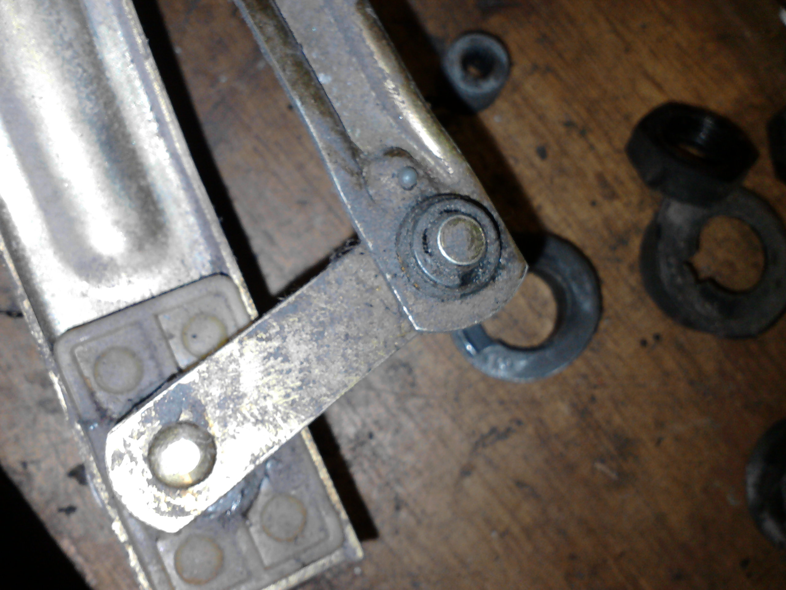

the linkages are held together by E clips, pull these out and the plastic bushes can be removed and cleaned then packed with the rubber grease.
Re: My S1 Sud Ti
you can see the difference here between a good plastic sleeve guide for the spindle and a fairly well worn one, i have seen worse though!

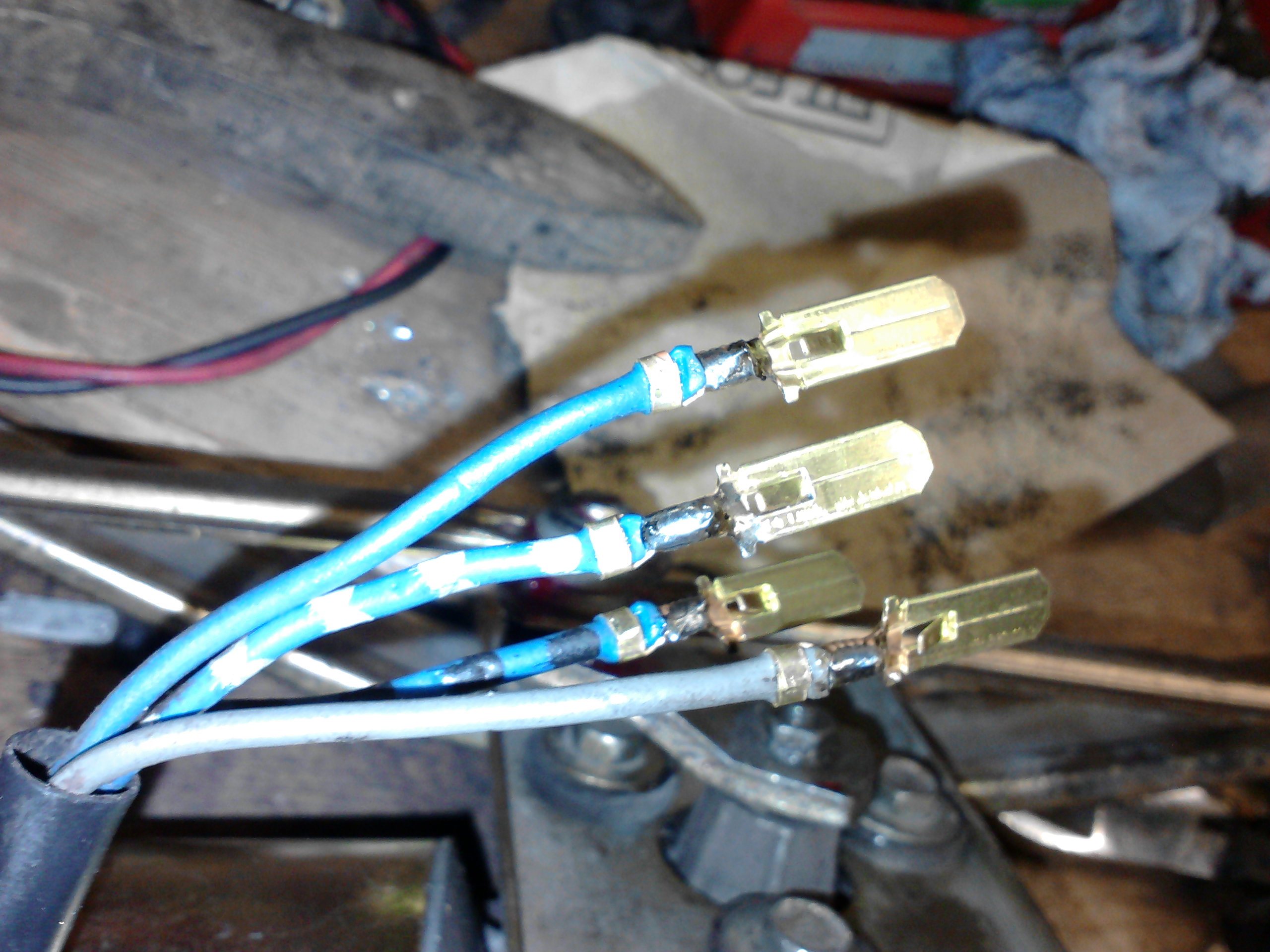

ready to fit complete linkage & motor. notice the wiring on these older motors how the blue/black trace wire isn't a line like the newer stuff but a series of dots. hope that didn't have to be done by hand :D
the new terminals are best off soldered as well as crimped as the heat travels down the wires and terminal which melts the outer coating of the wire and bonds it to the crimp of the terminal making it doubly difficult for a wire to pull out as well as sealing it a bit more

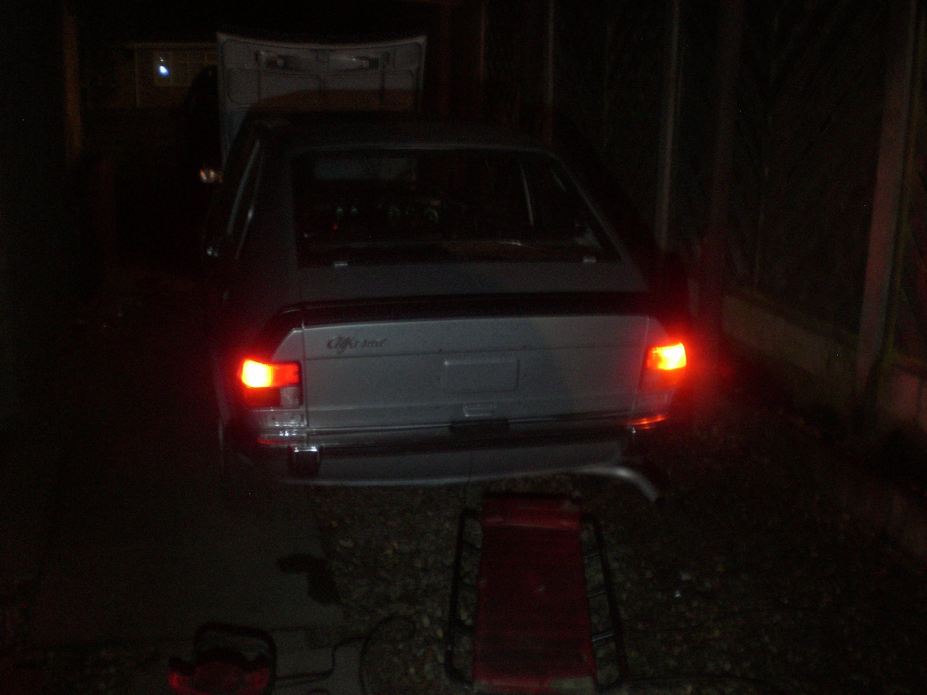

Re: My S1 Sud Ti
good afternoon really.
quite a few bits tidied up.
new horns fitted and wired in
front indicators wired in
front side repeaters fitted and wired in
wiper linkage fitted
battery clamped in properly
refurbished alternator & regulator fitted
n/s steering arm removed so i could route wires correctly :roll:
drivers seat base fitted
exhaust heat riser fitted
reverse light wiring fitted
cigarette lighter socket fitted, and working

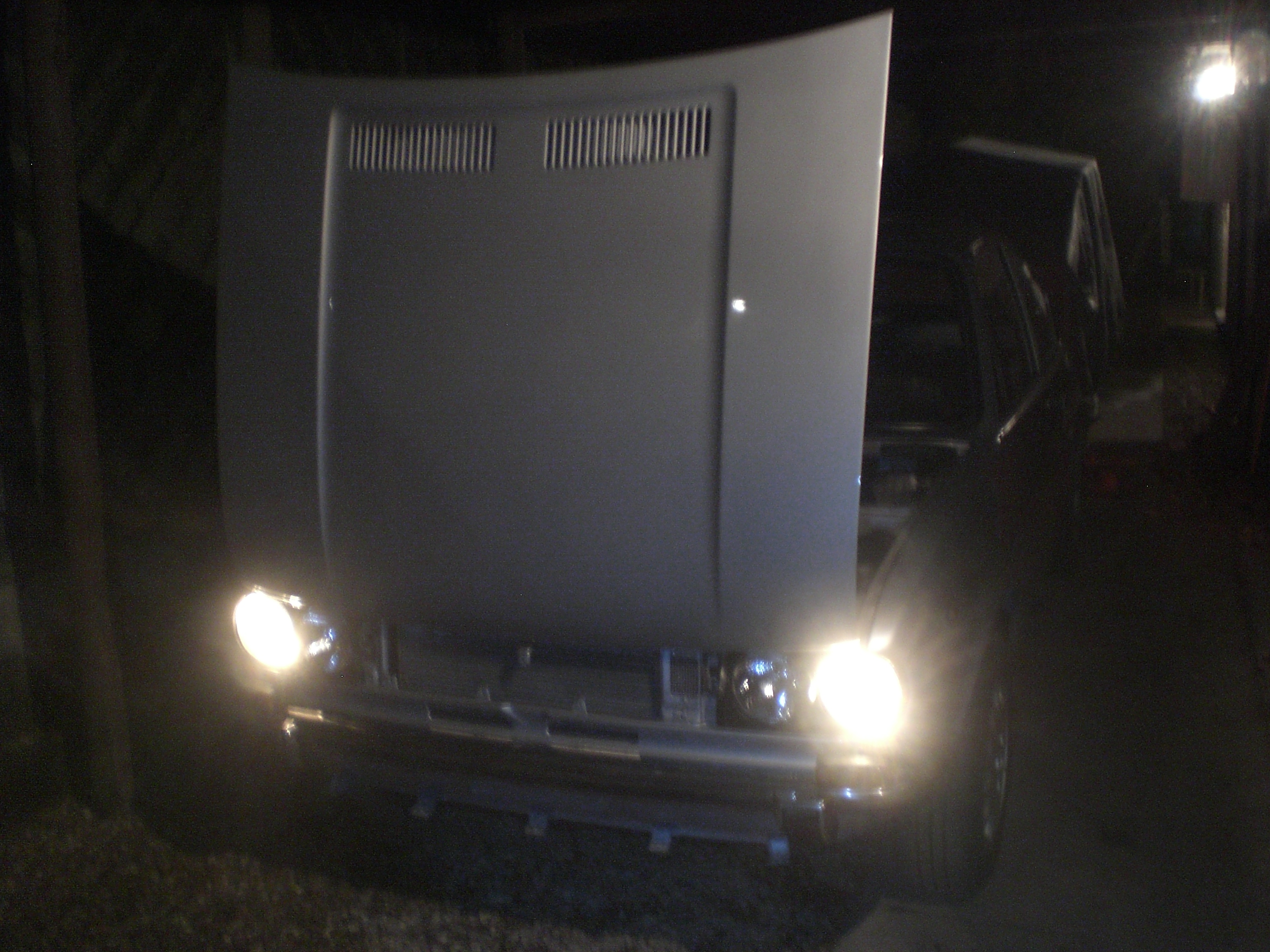

dark afternoons aren't a big help though, but at least the lights work.
this is just sidelights, proving that good wiring/new terminals & good earths are the only way to go ;)

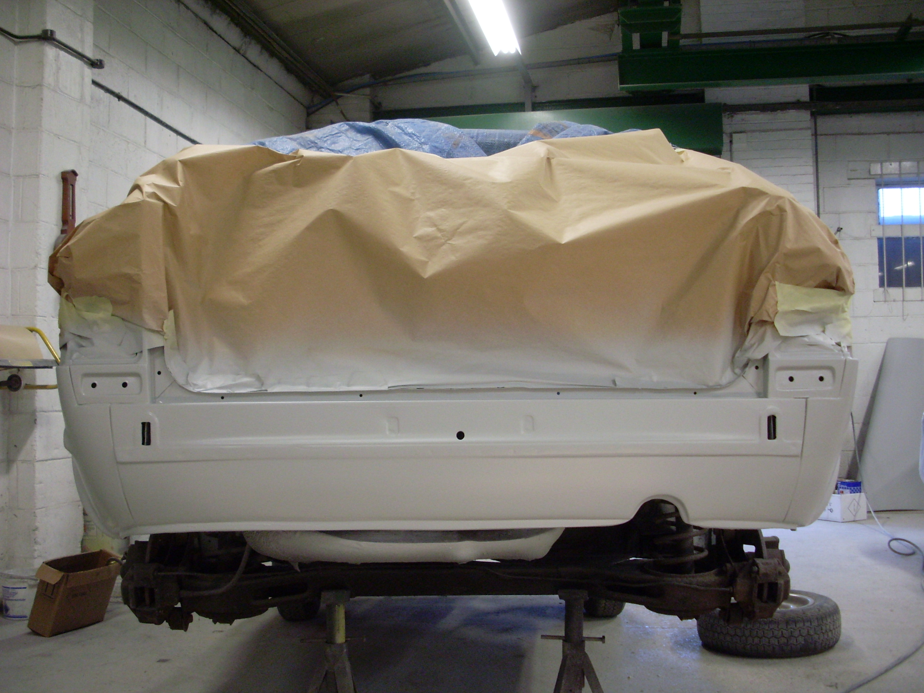

i have just got the rear number plate lamp to wire in then we are getting somewhere with the wiring, at last!
after having several discusions with myself i was convinced that making a hole in the back panel for the wiring to the number plate was neccesary :cry: i hate drilling holes after something has been painted but no way round it unless i ran wires through the bumper mounts which would bring it's own problems.
happy with the afternoons work, great to be able to put a few things on in one go ;)
hopefully a few shows will be on the cards next year, not sure about any concours event bluesuit, but we will see :)

That's a good tick list done there Kev, I know what you mean about drilling holes after the job is painted, this shows where my wire hole was if you need an idea.
Good feeling when you can put the lights on. 8-)

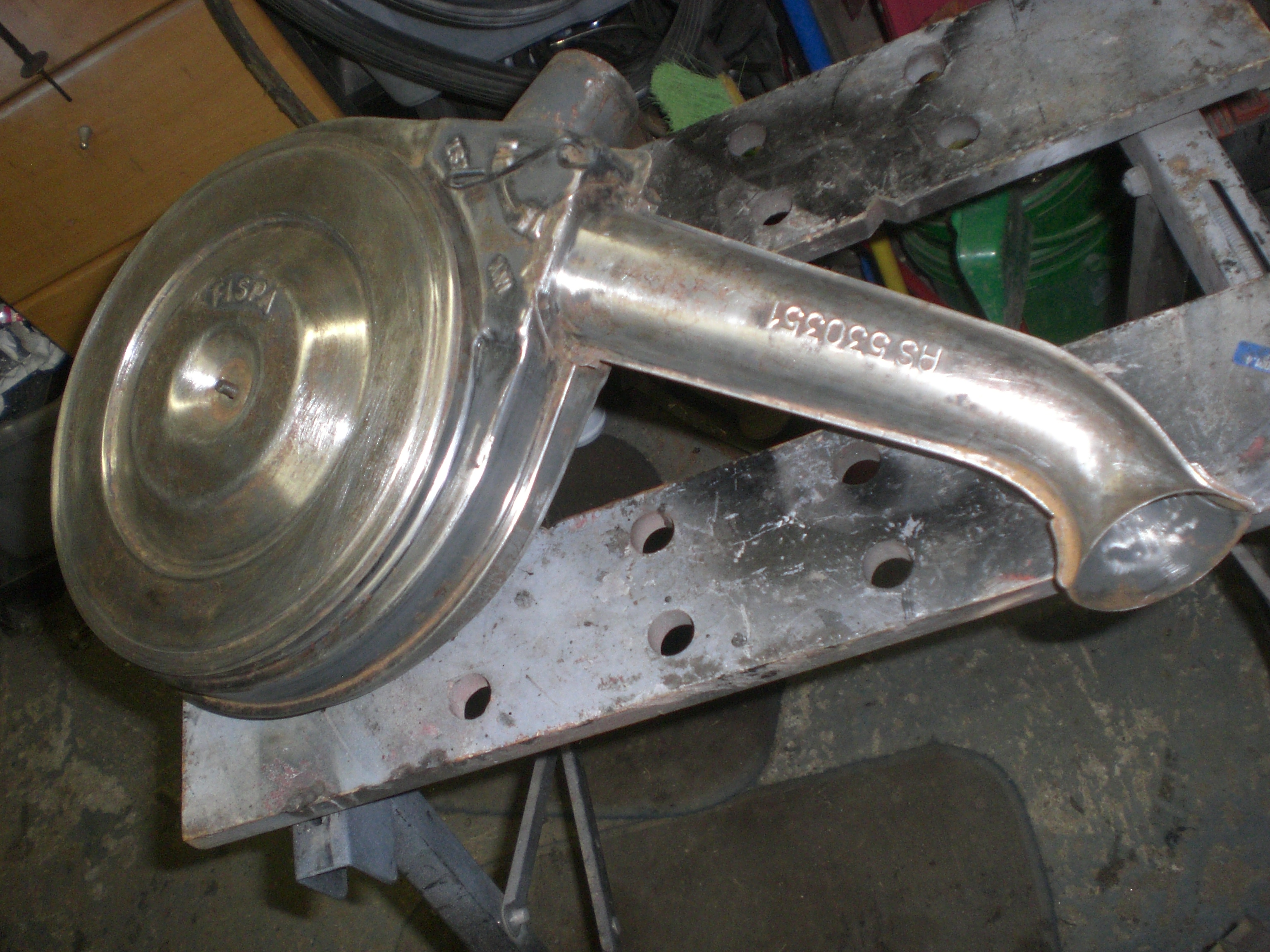

nothing much done this week save for me getting a new sticker made up for the air filter housing, I can now refurbish it.
if anyone else wants the great sticker then reply to the thread here ;)

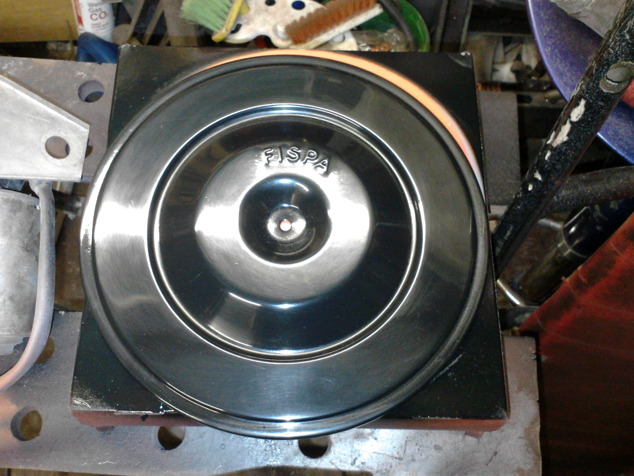

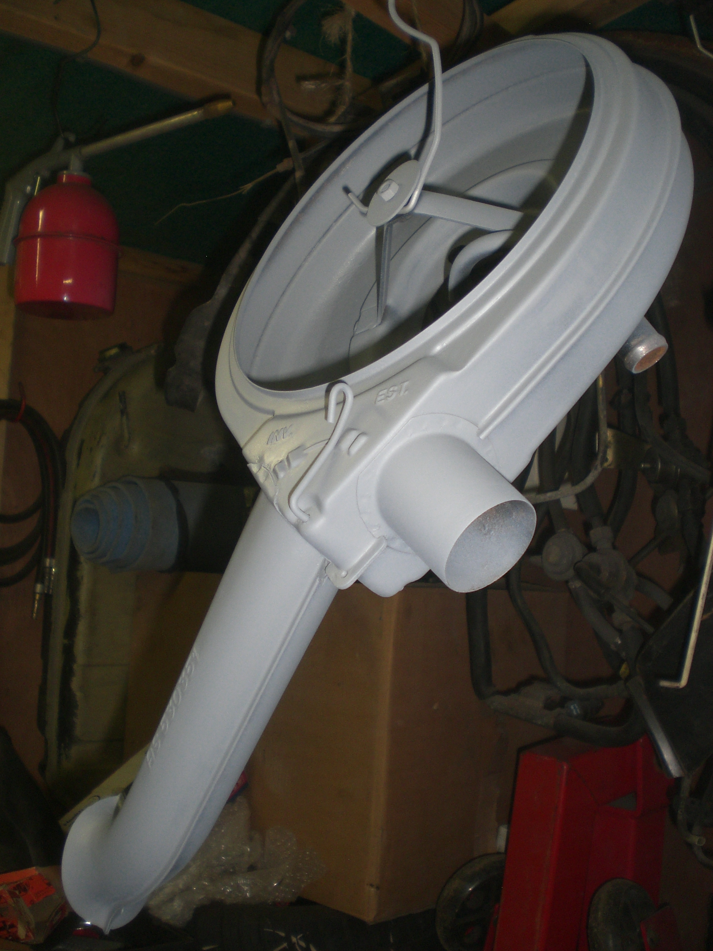

sanded and etch primed the filter housing now i know i have a replacement label available.
will prime it tomorrow then flat it sunday morning before the black goes on. busy saturday now so won't be a lot of updates to come this weekend

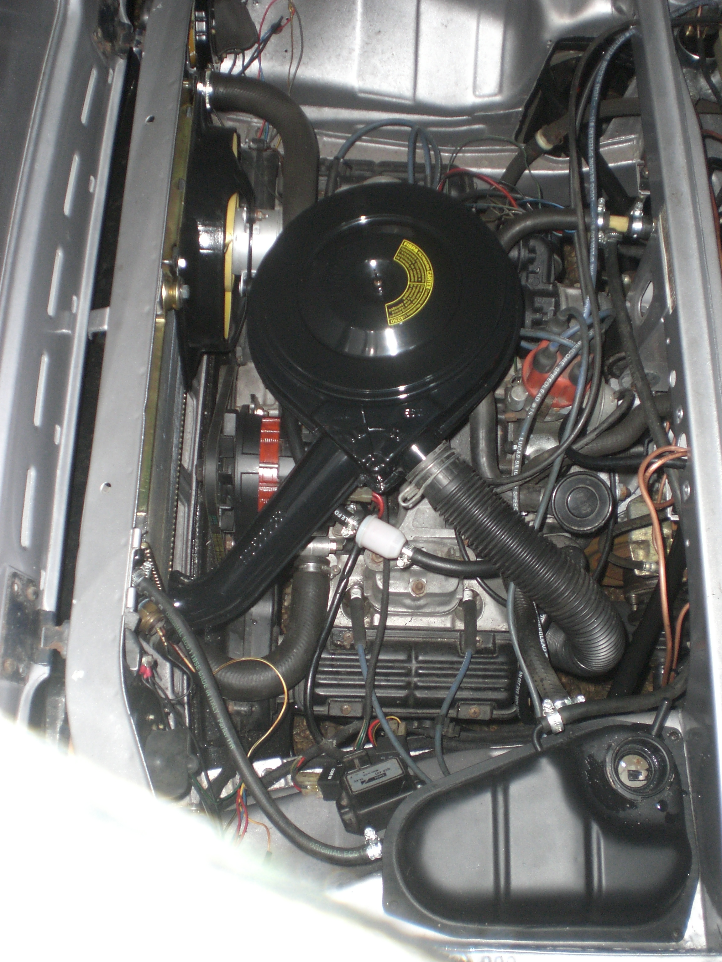

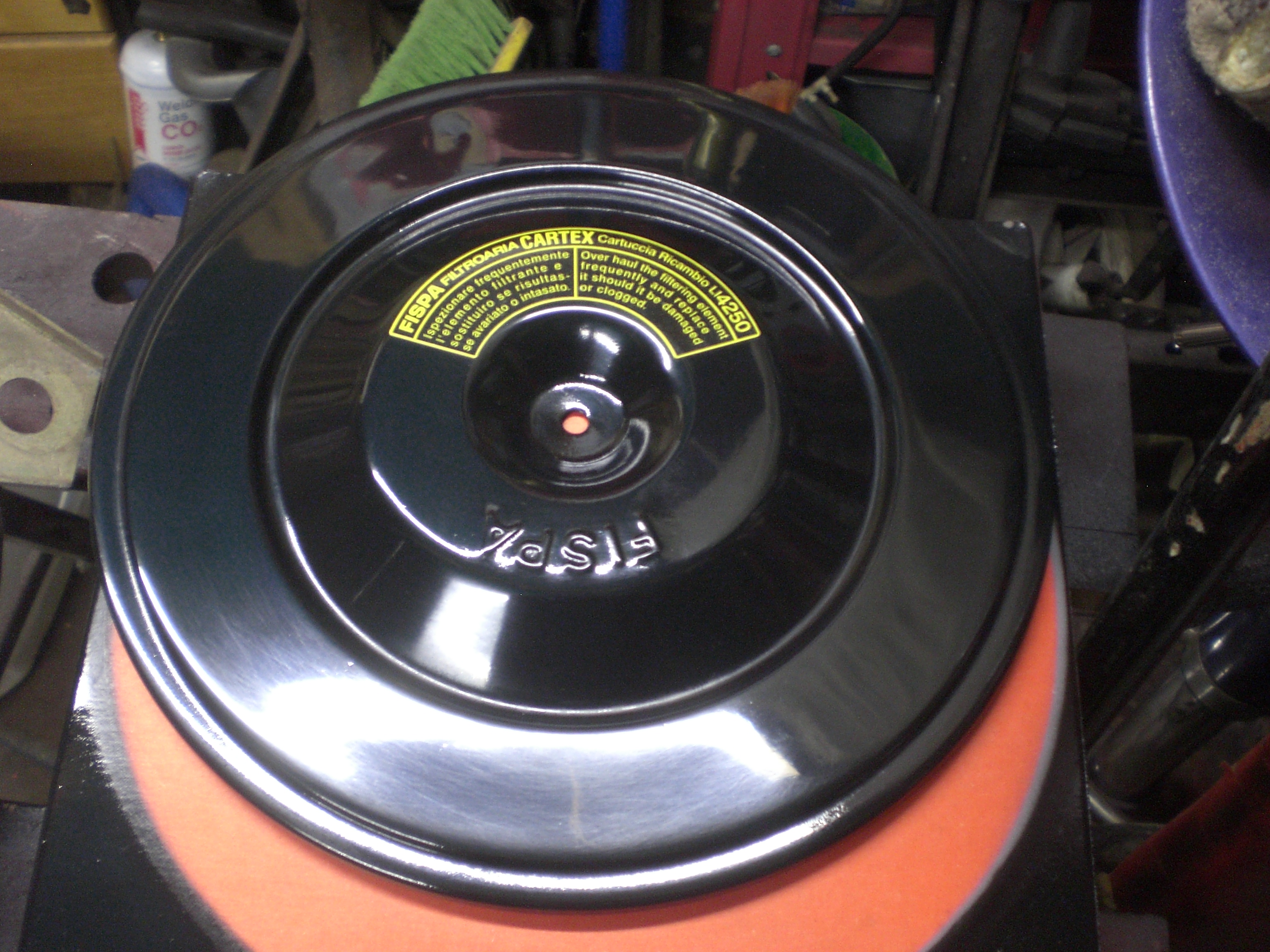

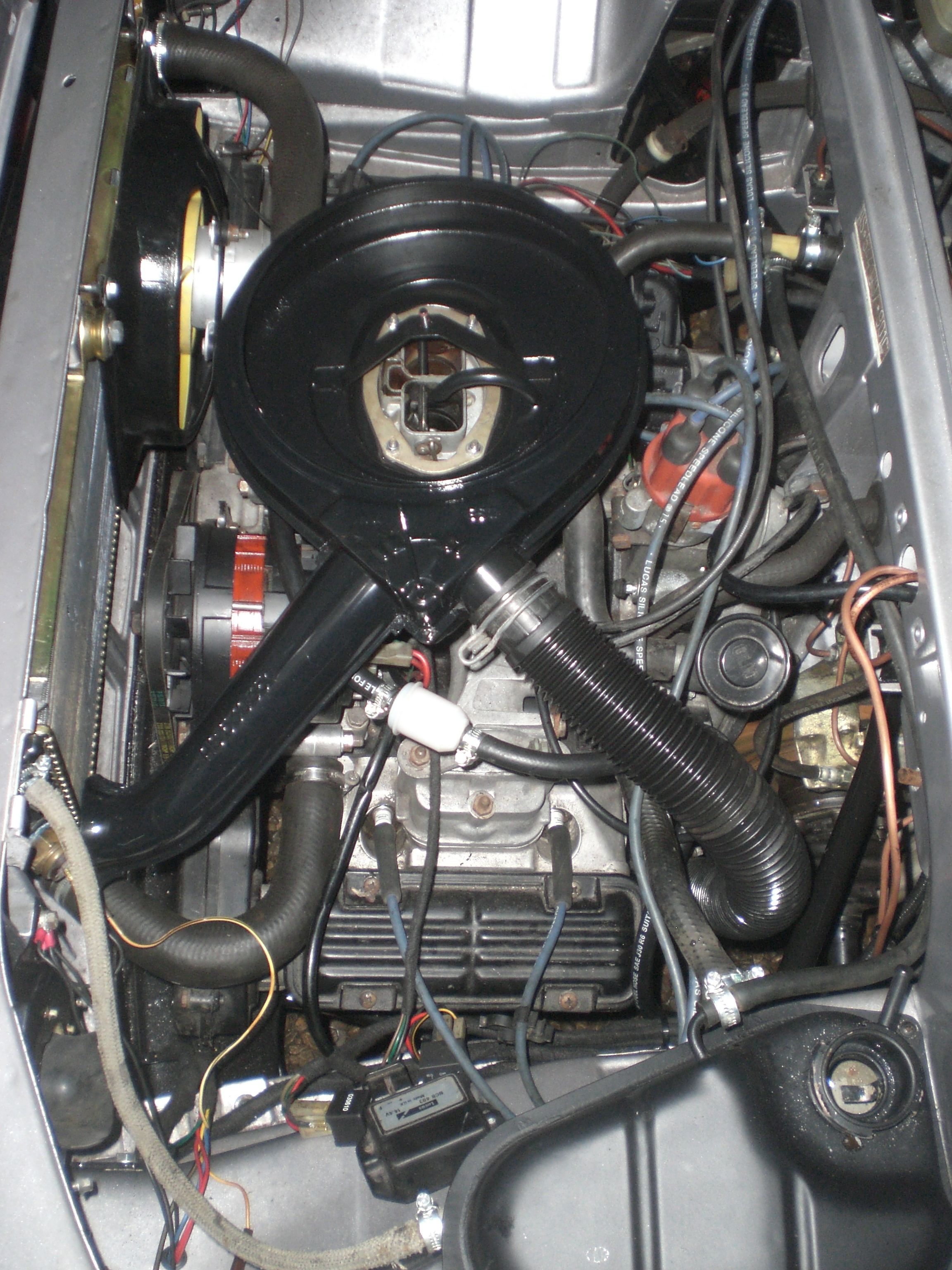

air filter housing all done now.
lid got flatted & G3 polished tonight so the sticker could go on, pretty happy with the results. curve of the sticker not 100% but a pretty damn good recreation

flushed the cooling system through 3 times with distilled water to flush out all the old stuff, refilled with blue anti-freeze/distllied water mix.
did manage to get the refurbed air filter housing back on before packing the car away again.
