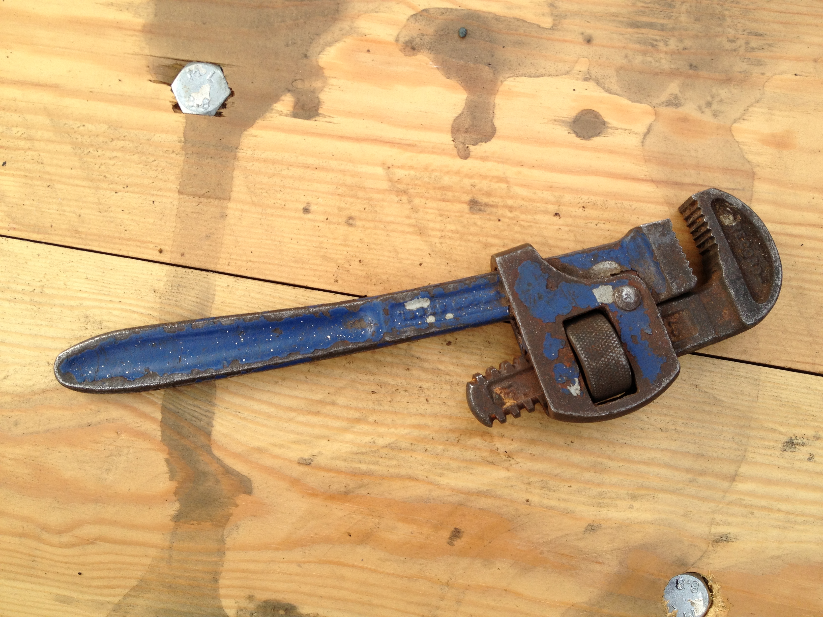

Life saving tool.......everyone should have one of these in the tool box....Stilson's

Back to the Stilsons ......why do people : (1) Over tighten nuts/bolts/studs to bonkers levels and (2) use (or cause in (1)) studs with a head that is starting to round off. :roll:
Changing the front engine mounting got off to a good start :
1. Decent spare mount found in the garage
2. Just alternator belt and fan to remove to get at the engine studs at the front
3. Above 4 studs came undone nice and easy
4. Next to the long studs up through the cross member.....doh! - bearing in mind these things are 13mm heads they are hardly meant to be holding the whole of the car together. One came undone with a bit of weight on it, the second was the offending 'semi' rounded head previously torque'd up by Dr David Banner when in and angry mood .... :mrgreenout
After trying the mole grips, bashing it with a cold chisel we started to get the grinder out and equally worrying about how we got the remaining thread out upwards into the engine bay - it was looking likely that the cross member was having to come off to do it.
Anyhow, the chief engineer decided to go to his tool stash and came back with the well used and probably 40 year old kit in the photo for one last go at it. You can imagine how pleased we were to hear the 'crack' that signalled that the stud had come loose and duly wound out from below. Such a basic looking tool that saved hours of work - its now in the top of my tool box !

stilsons are an awesome tool that so very often save the day, much MUCH more useable than mole grips. once they bite then they bite 8-)

Agree Kev, took a couple of goes to get the bite, but once gripped we stuck a bar on the end and I went for the old 'foot on bar' routine......safe to say the old stud is in the bin.
Luckily we also have a stash of studs of various lengths and thread.

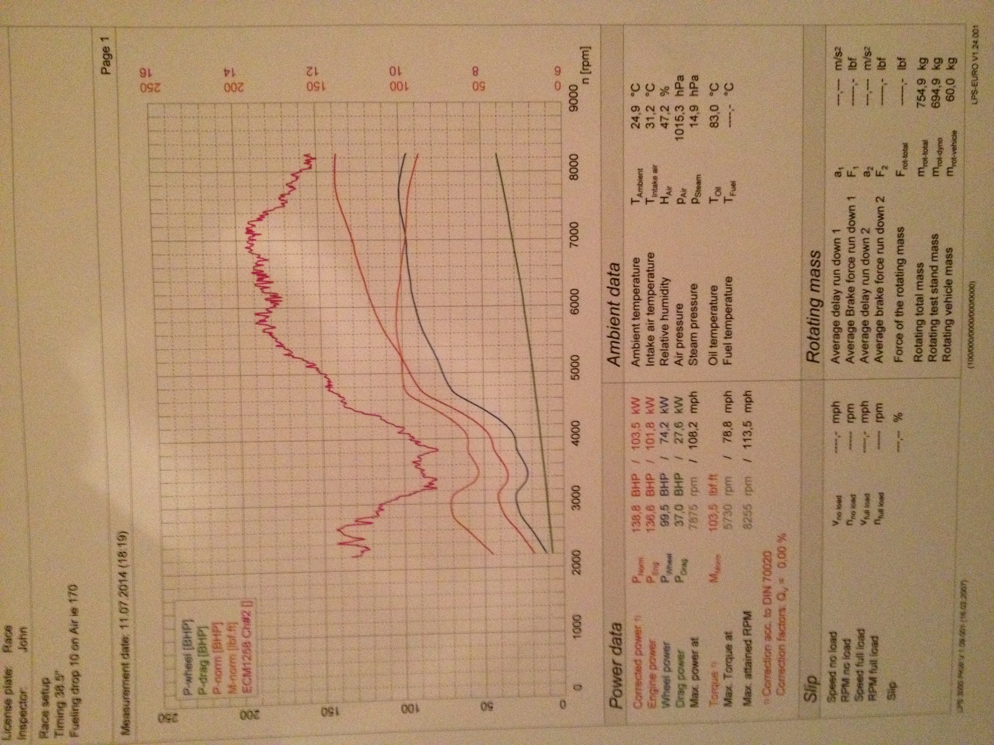

Talking about rolling roads on the other thread prompted me to dig this out from a rolling road session in the summer, and I thought I'd share it as I know we all like to see the facts and figures.
As Bryan reminds us quite rightly, rollers differ and its more a bench to set things up and track improvement.
The engine is a factory standard 1500 block/crank/rods/pistons, with reprofiled cams and some headwork (not sure of valve size but suspect the bigger ones). It has 40 webers and a hand made crossover manifold. you can see from the profile that the power only comes in at 5K, which I've found diffcult to get used to. However, for what it is, its a good engine and I cant fault it really.

Looks like a healthy one Tim! Very typical pair of curves for a cammy engine! :)
Re: Sprint racer
Thanks Bryan. We wanted to try the Dellorto 45's on it but ran out of time on the rollers. They might be a bit too much for it, but equally may figure in some future plans.

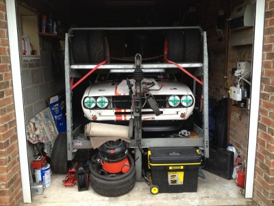

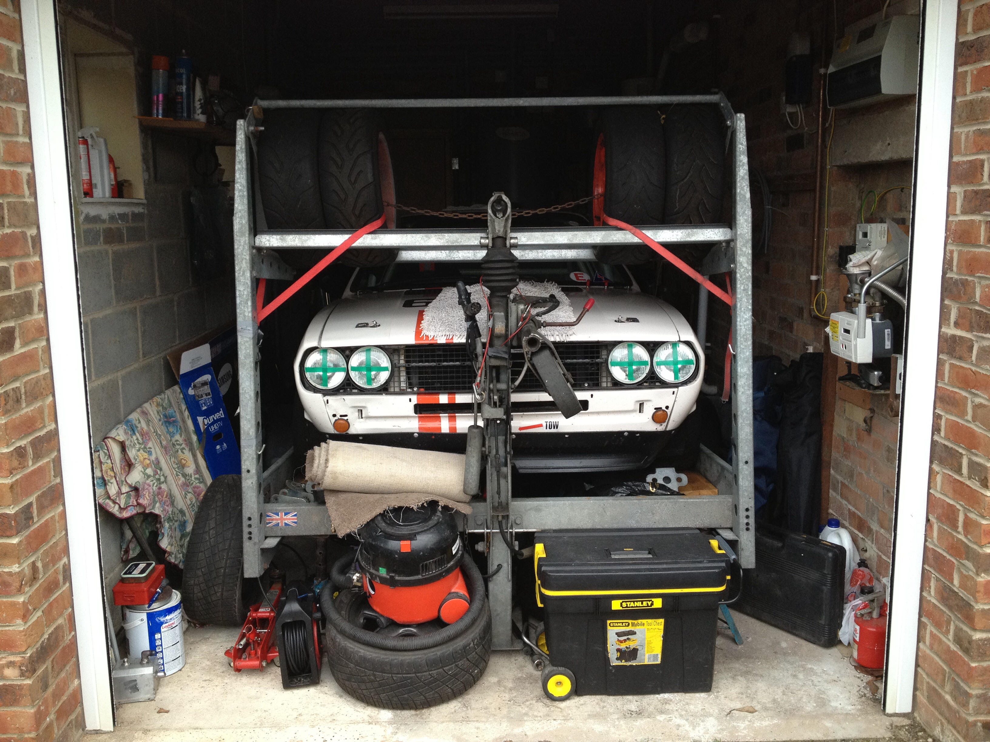

Well, probably overdue getting the Sprint out of hibernation for a checkover in prep for Silverstone, so a damp Saturday morning was spent checking things over.
Fitted some rear drums with threaded studs, checked all suspension, front brakes, fire extinguisher and all fluids and all looked good.
It's cosy in there.....

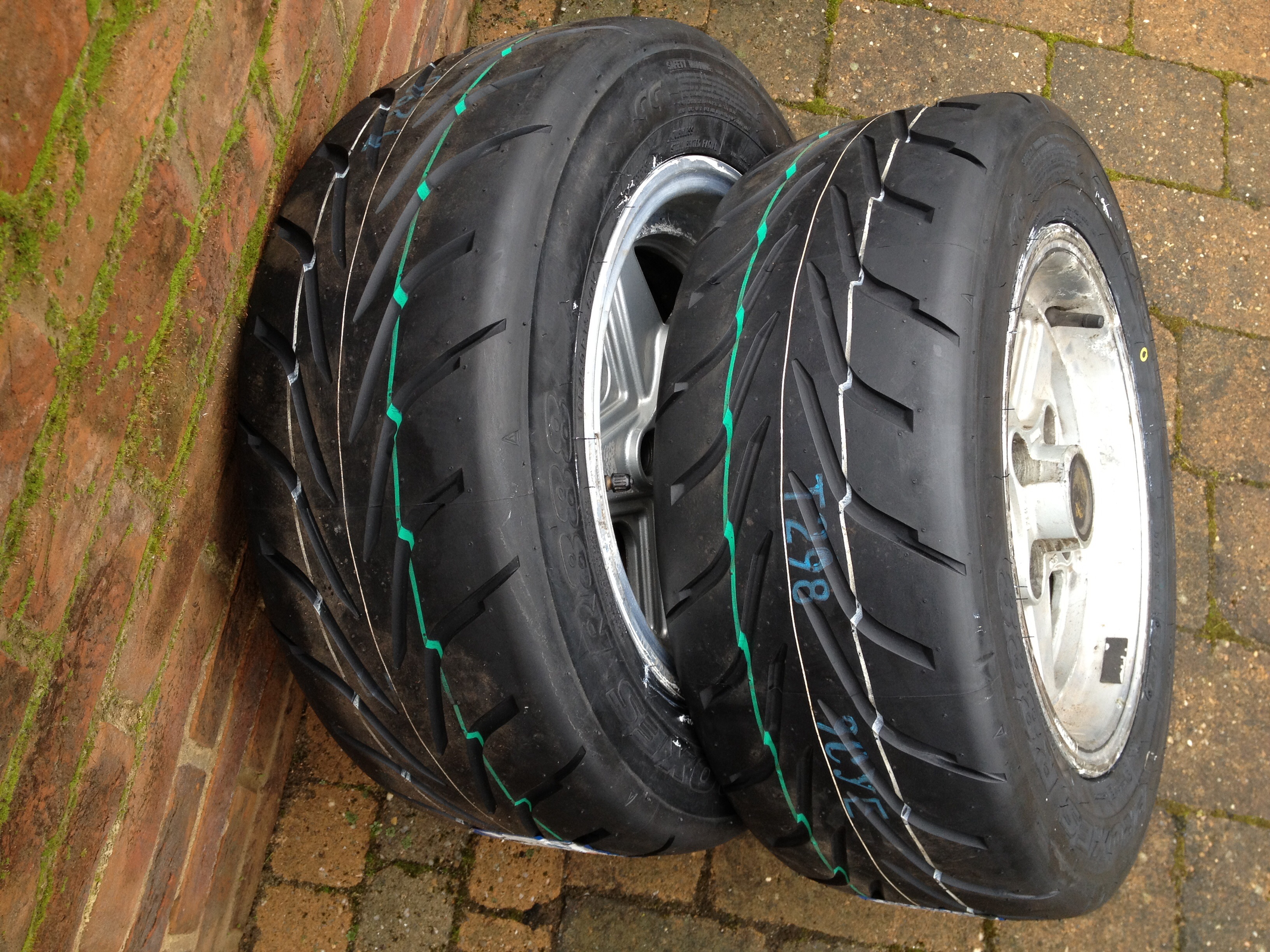

Had some new rubber fitted....
And then came to fire up the engine, primed the pump, consistently needs 7 pumps to prime the carbs, and it popped into life and ran lovely......
Until a bit of burning oil on the exhaust led to a close look at the oil filter, and a hair line 'weep' of oil identified in the alloy casting ... :(
Currently thinking about what to do on this one.....I've posted a question in Tech Help

Re: Sprint racer
Thanks Ian
The weep is minimal in terms of volume, a small amount of oil always looks worse than it is. However it is the risk of it getting worse.
Having looked and thought about it further, it doesn't look like a crack, more like a fault in the casting process, like a tiny pin hole, but that might just be my imagination.
If you look at the casing from the front of the car, there is a purposely cast 'flat' section about 1cm by 1.5cm and it is coming from the centre of that. The flat section is about 2 to 3cm below where the oil sensor screws in. The rest of the casting around the filter is rounded and rougher cast, the flat part is smooth.
Don't have a spare casing ready at this point, I have a knackered 1500 that has been under a tarpaulin for 25 years, plus a couple of good 1700 8v motors in storage if they the same.
Going to have a think and decide on next step....I'm still planning to be at Silverstone by whatever method I need to take.
