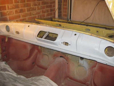

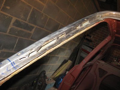

Next job on the old rust bucket.....

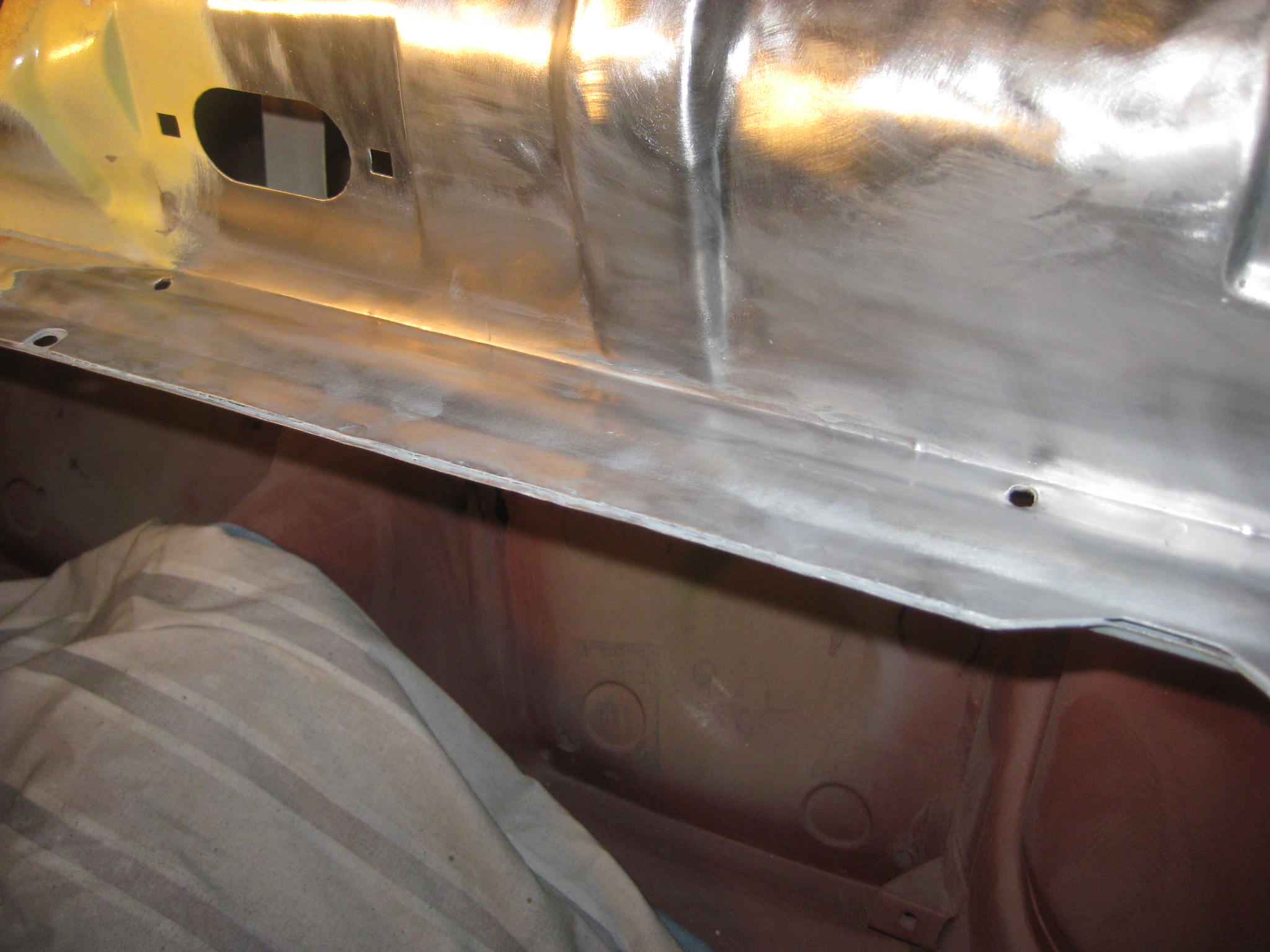

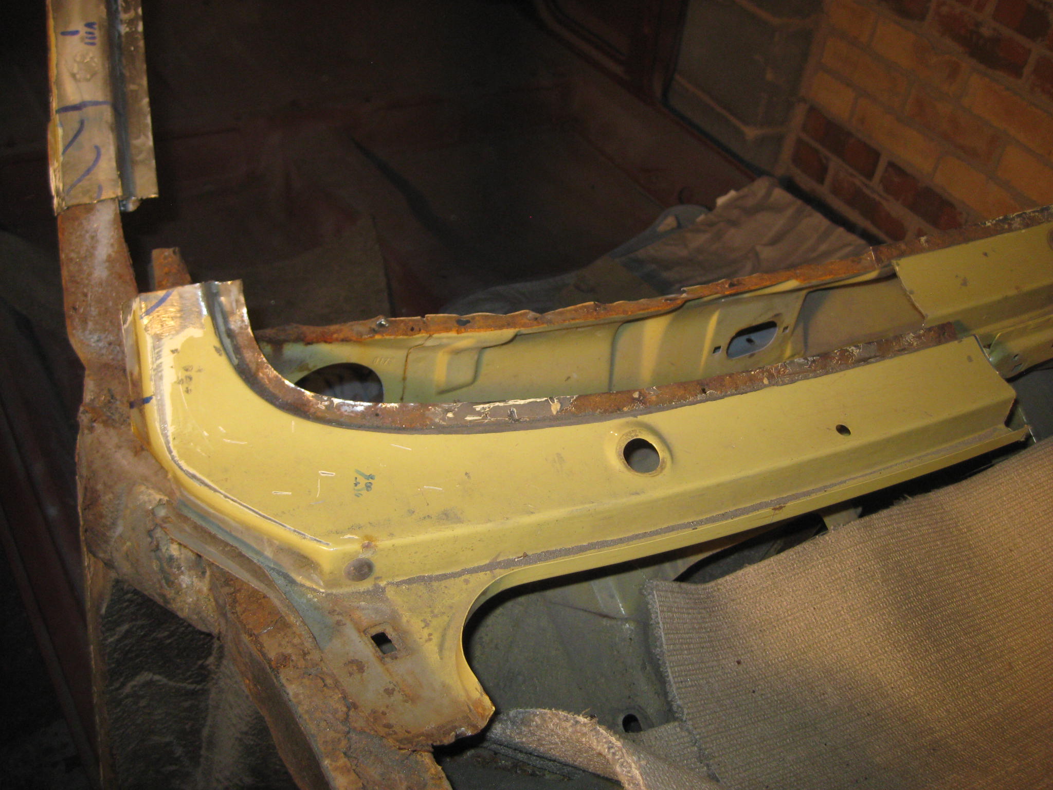

Dashboard mounting area...

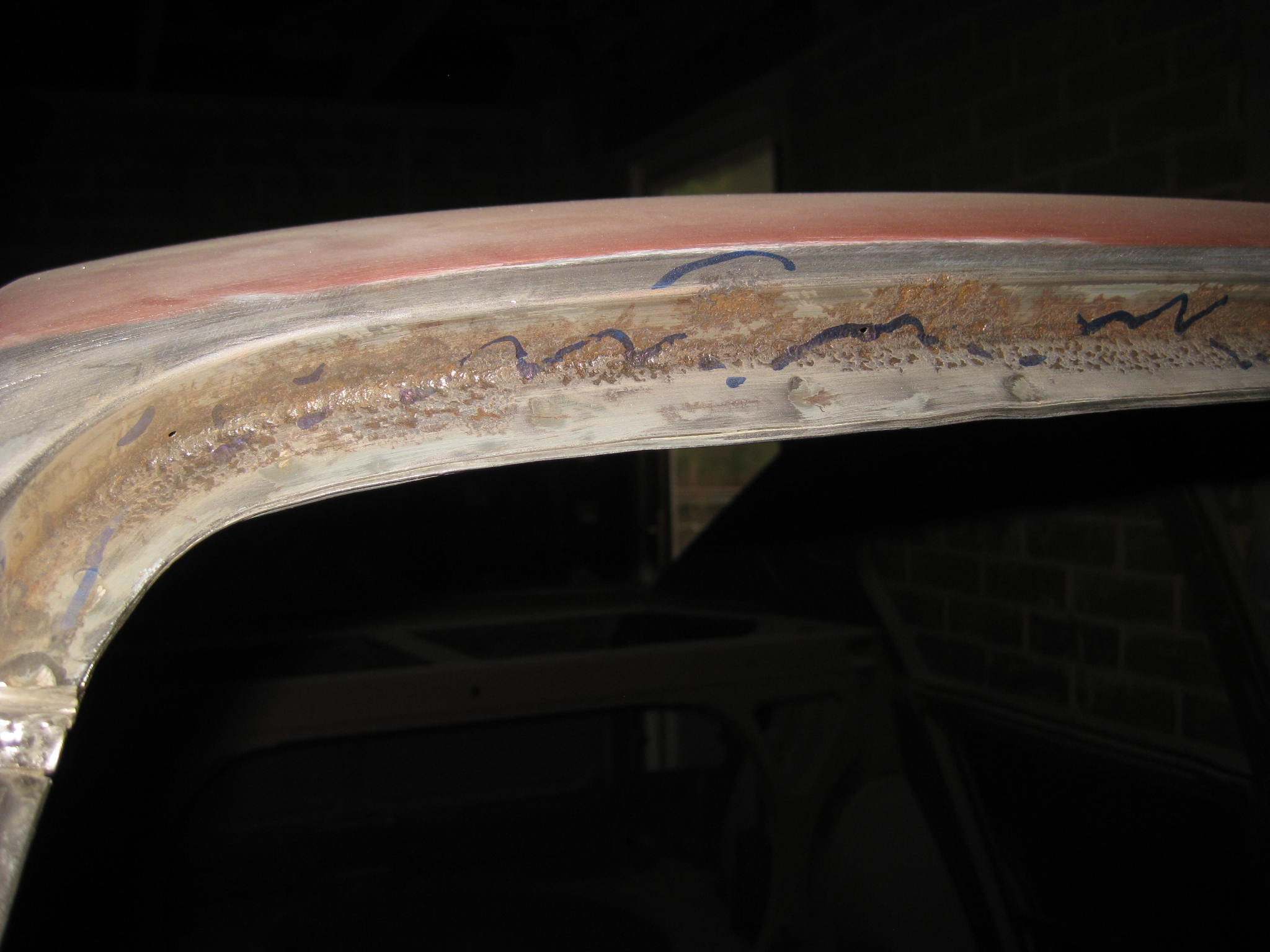

I cleaned all the original paint off and found rust in the seam, presumably due to the front screen letting water in at some point

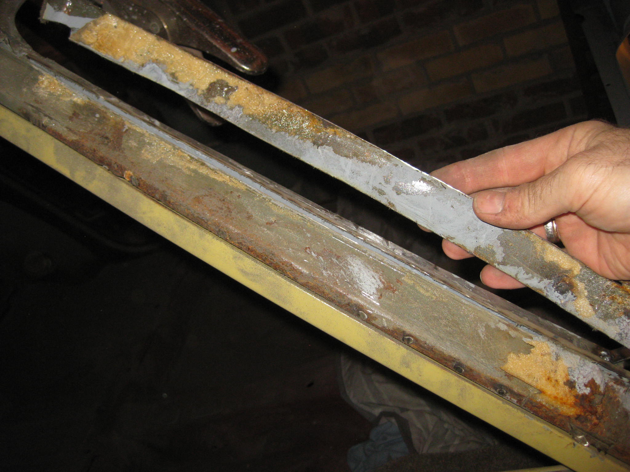

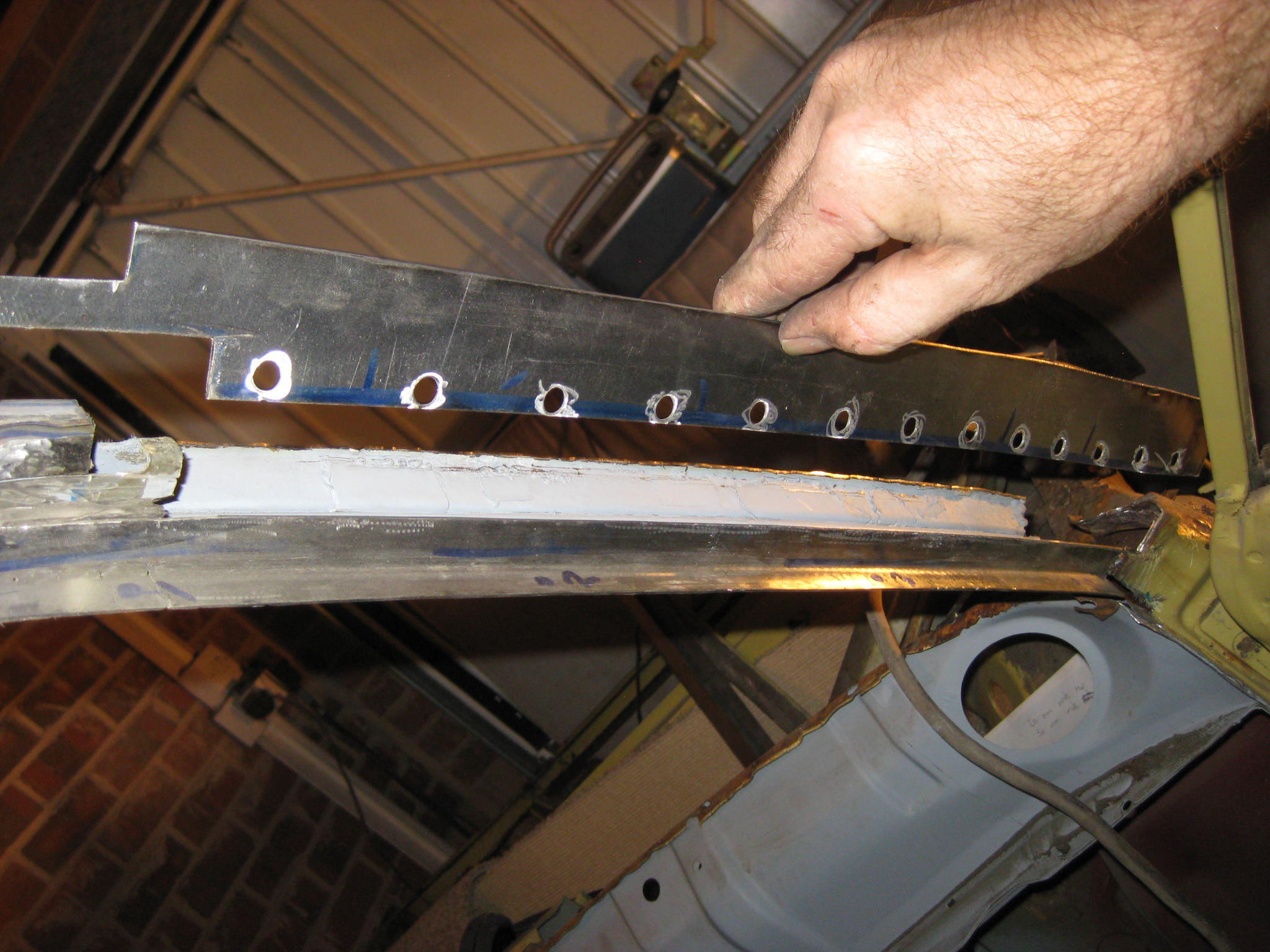

So I opened up the seam and cleaned all the rust out...

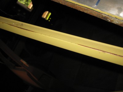

Then filled it with etch primer and closed the seam back up with the hammer and dolly...
vecchioalfa
- Posts: 433

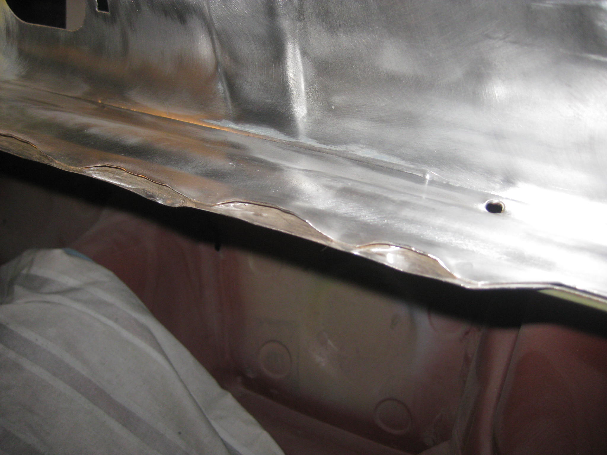

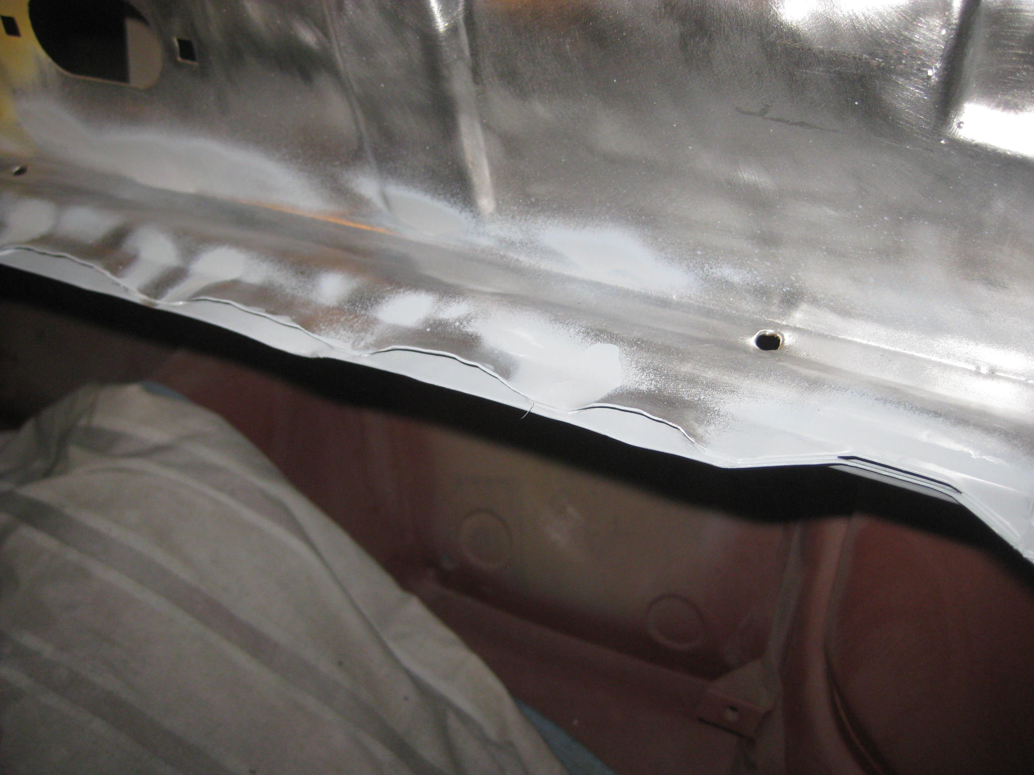

Then the whole area was given a coat of etch primer....

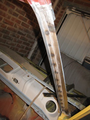

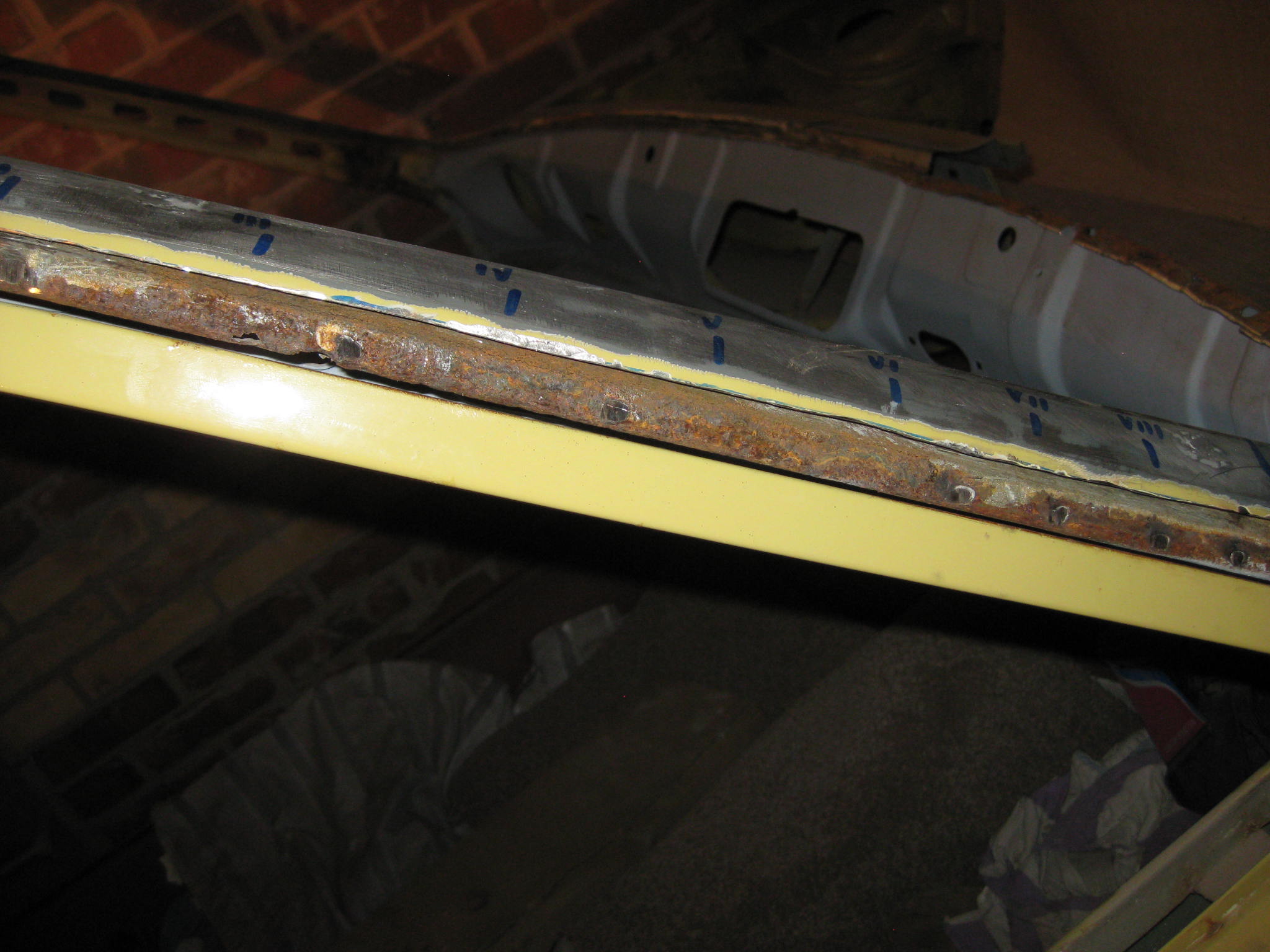

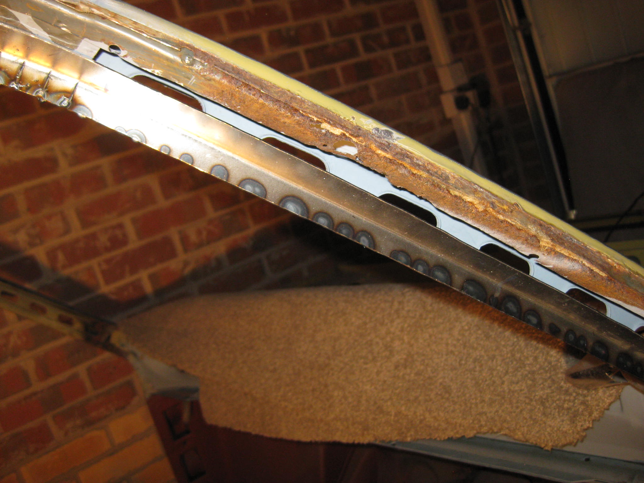

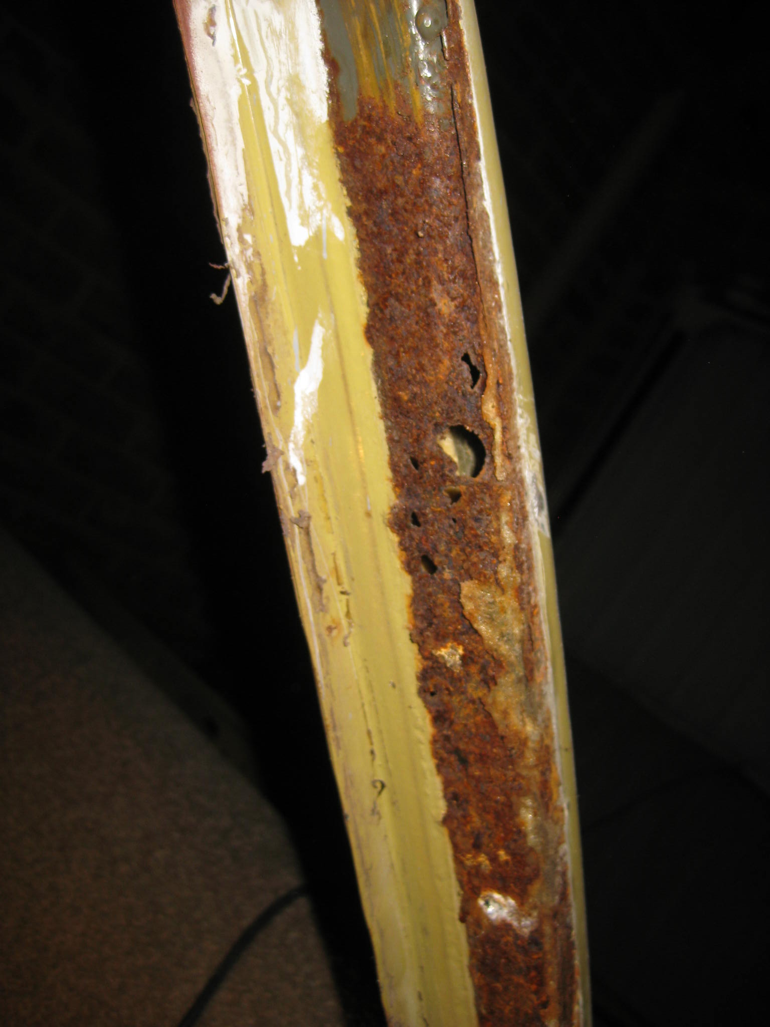

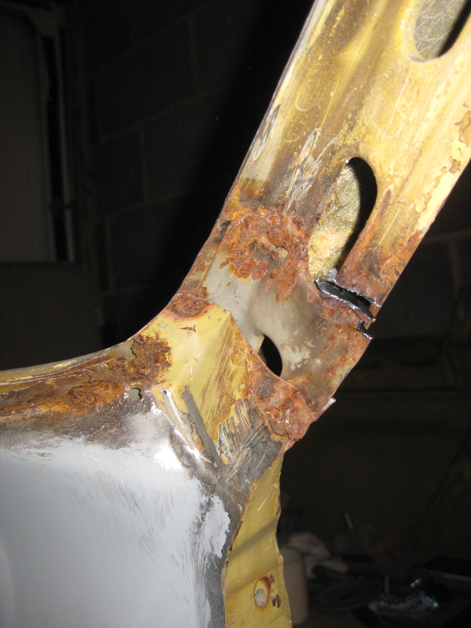

Next are on this car to be looked at is the front screen/scuttle area, I had to break the front screen to get it out as the last muppit had glued it in with no-nails
Major corrosion found in the 'A' post pillar and screen surround area.....
vecchioalfa
- Posts: 433

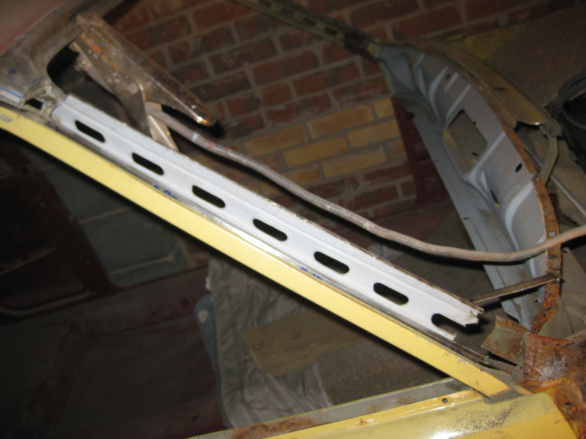

The car also had a new scuttle panel fitted back in the early 1990's and it was not done very well and is has all needed to be removed to gain access to all the rust and rot beneath and around it and the 'A' post has been bodged up at the bottom
vecchioalfa
- Posts: 433

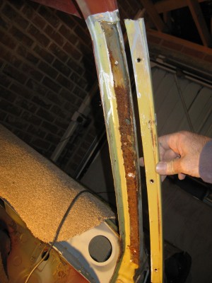

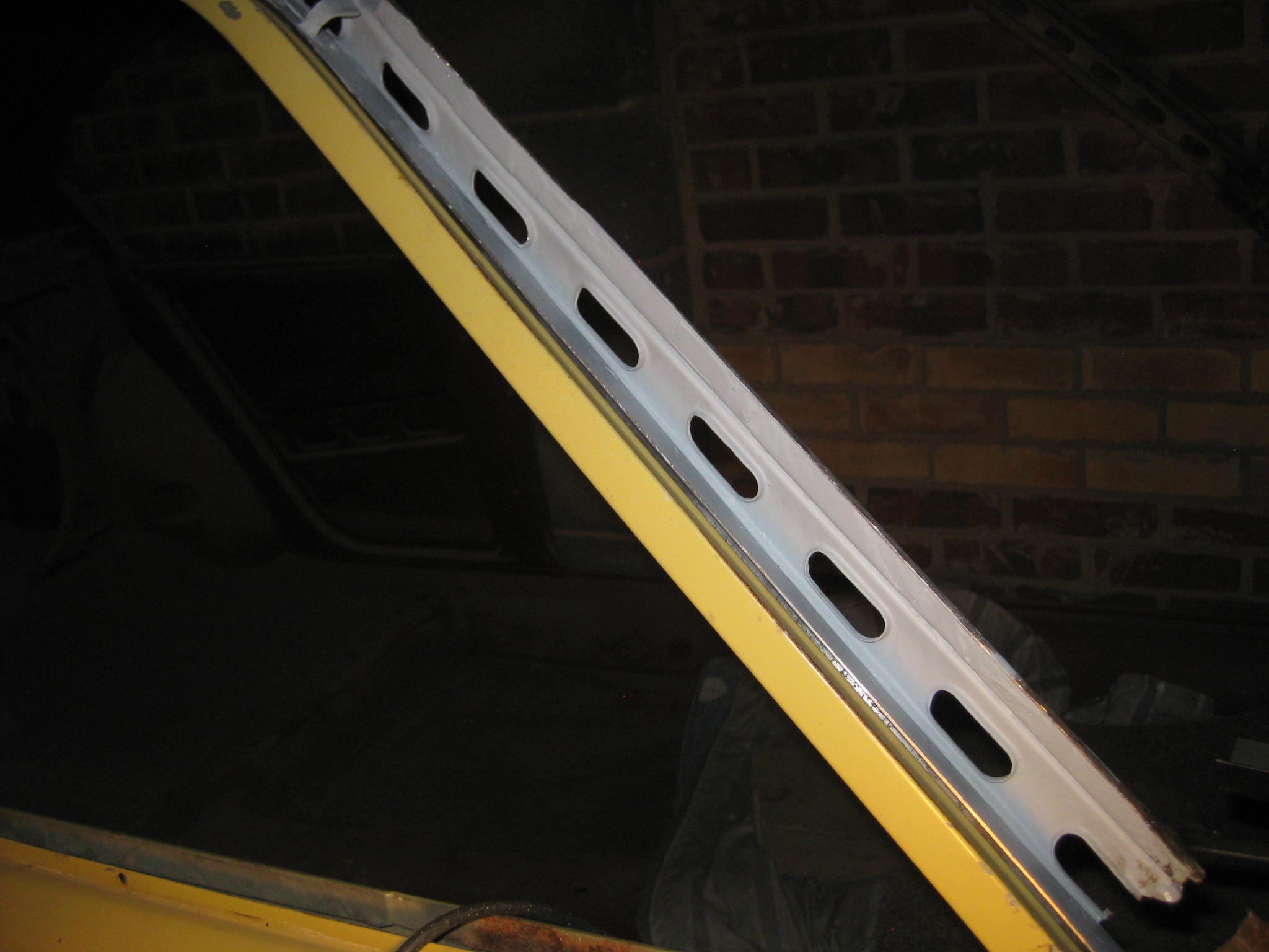

The 'A' posts on these cars are made up of 4 separate pieces and all welded together and then a closure panel pop riveted on. All sections are rotten and need major work.
The first job was to cut out the rotten and corroded metal from the windscreen channel area....
vecchioalfa
- Posts: 433
And weld in some new metal and accurately grind it back with the dremel tool.
Next I made up the next section with was completely rotten and welded it in place.

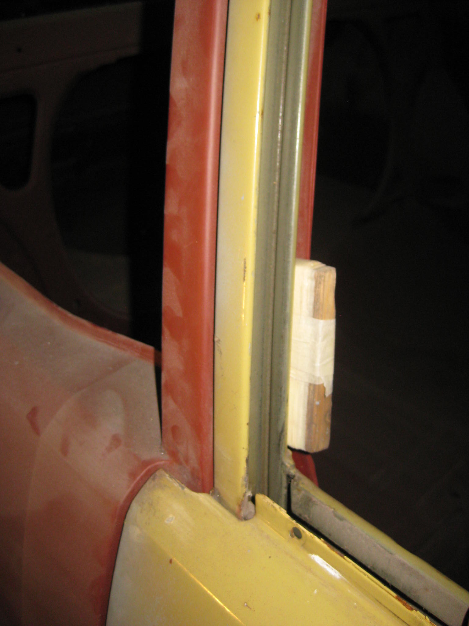

I also refitted the door and shimmed it to its correct position to make sure this pillar is correct as it is being re-built

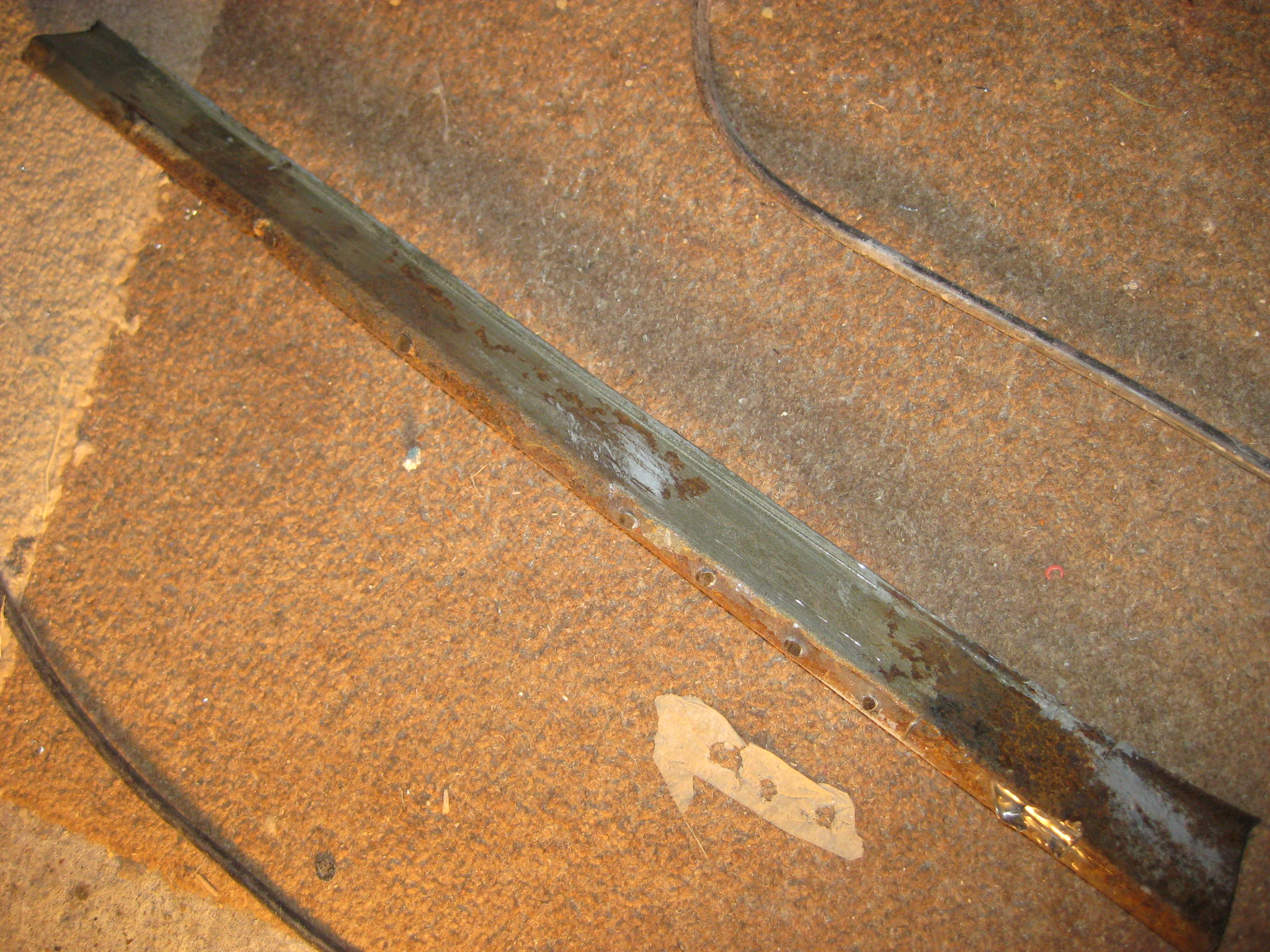

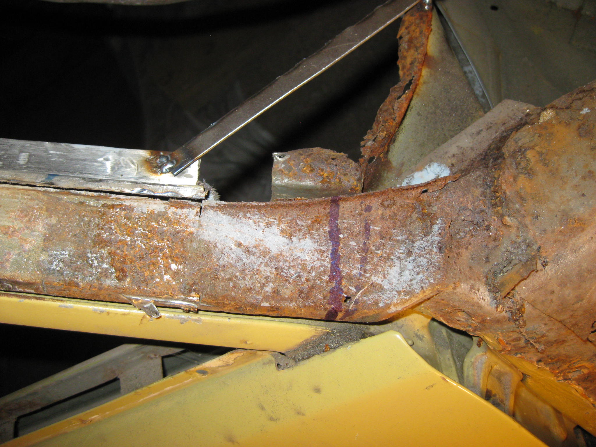

Outer skin of the pillar removed to reveal lots more corrosion....
This is a BIG job
This is a BIG job

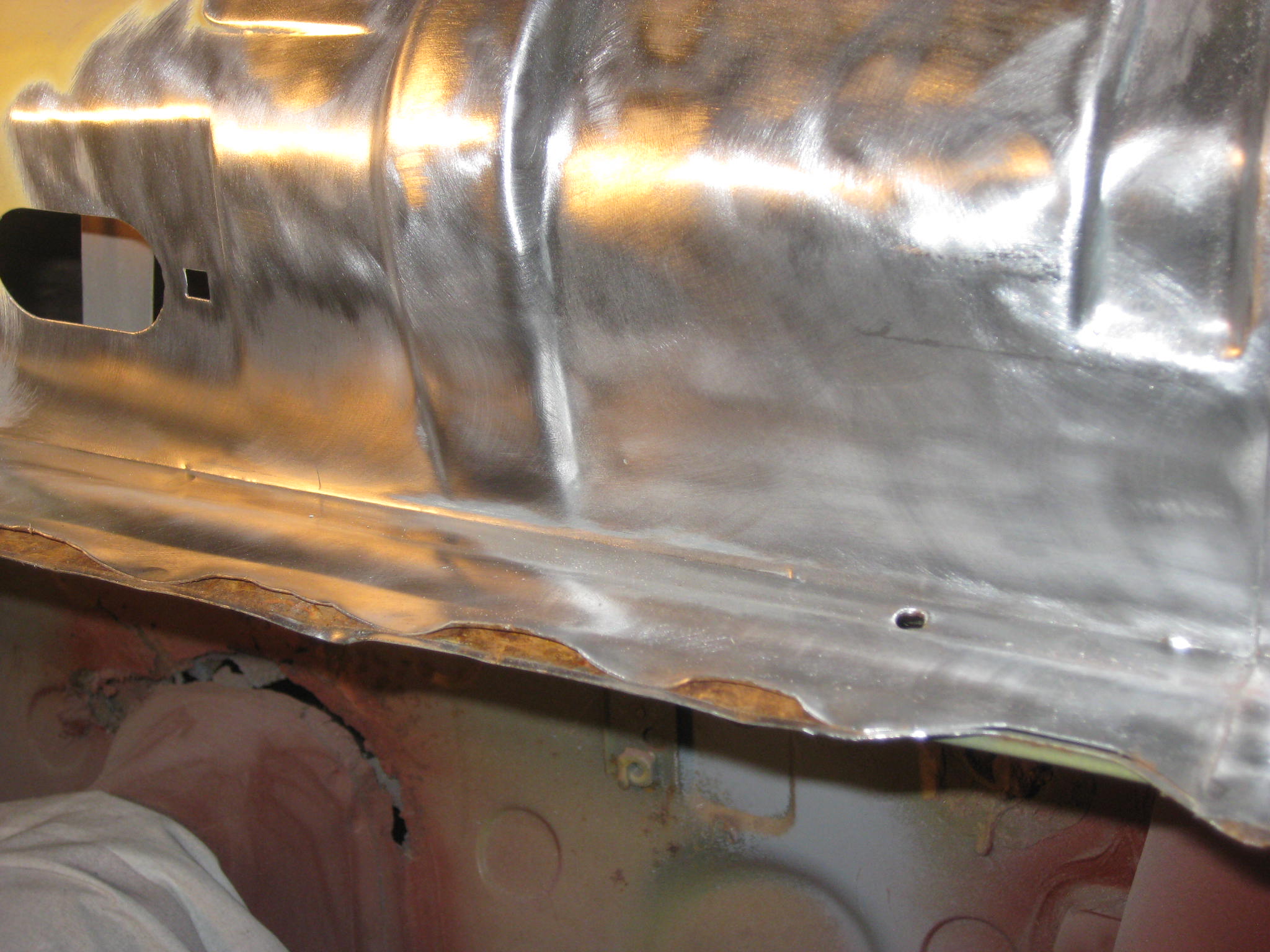

The bottom of the pillar is barely connected to the inner scuttle at this stage so I have had to add a reinforcing strap to hold it in place until I get some more metal back into it because as you can see there is not a lot left at this stage
vecchioalfa
- Posts: 433
Next panel made up and spot welded into place, the door gap looks better but needs to be checked all the time
vecchioalfa
- Posts: 433
The centre section was heavily corroded and offered no strength at all, glad I cut all this away but this area is going to take weeks to complete, made worse by the fact there isn't a straight edge on the pillar at all, compound curves everywhere...... and the other side of the car will be the same for sure, all hidden from view and only a few small scabs visible externally to begin with. More later in the week......
