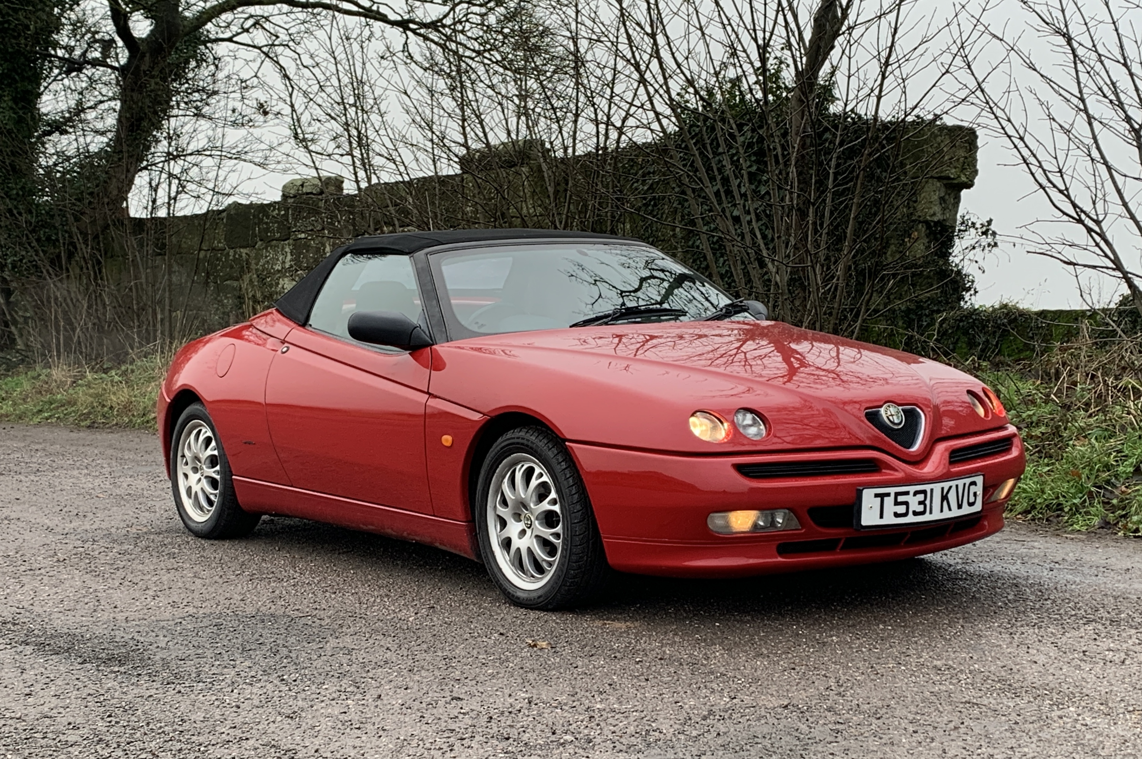

I know the pics probably don't do the colour justice Lou but what code is that red - looks similar to my "Tomato Sauce" Mito?

Sud 145 wrote: Tue Jan 04, 2022 10:02 pm I know the pics probably don't do the colour justice Lou but what code is that red - looks similar to my "Tomato Sauce" Mito?
Tony. it’s Alfa rosso 130

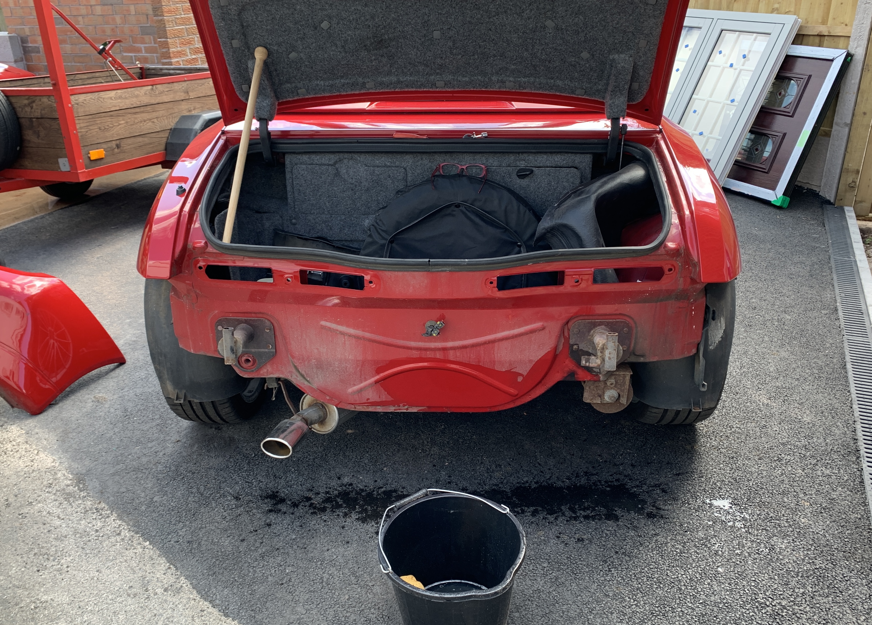

Time for the rear end to get some lovin !
Eventually I’ll get the bumper brackets powder coated but that maybe next winter during its hibernation
