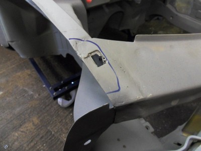

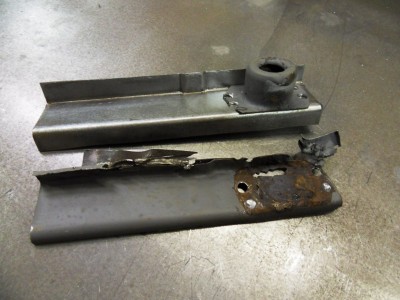

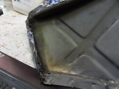

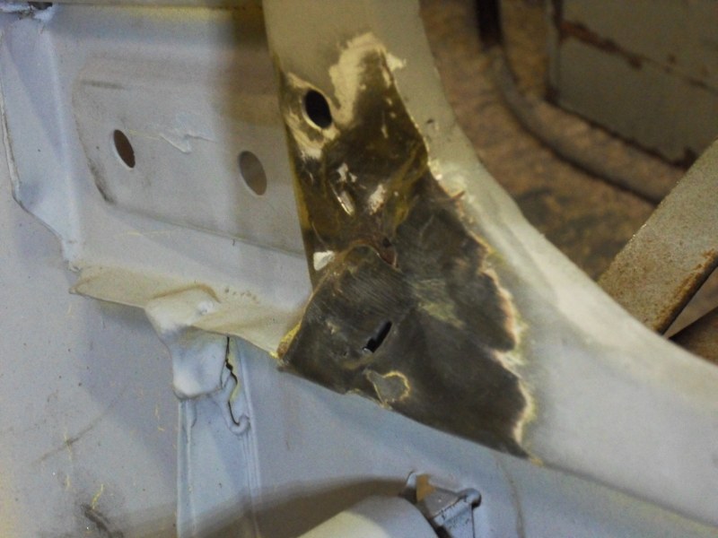

Starting with a couple of small repairs to the O/S front inner wing and front cross member flange:
Quite a lot more has been done.

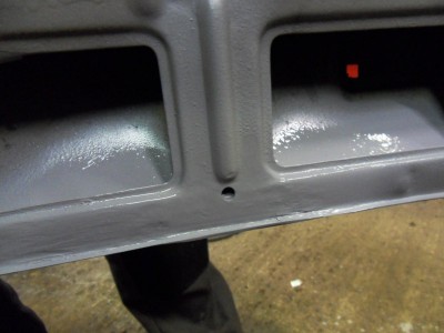

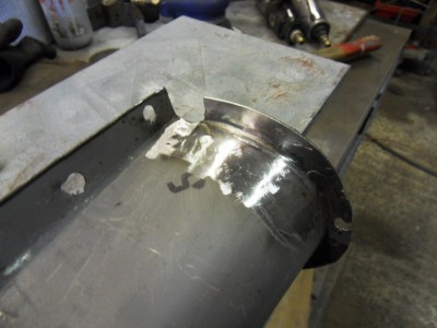

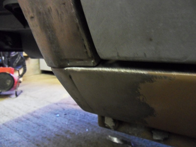

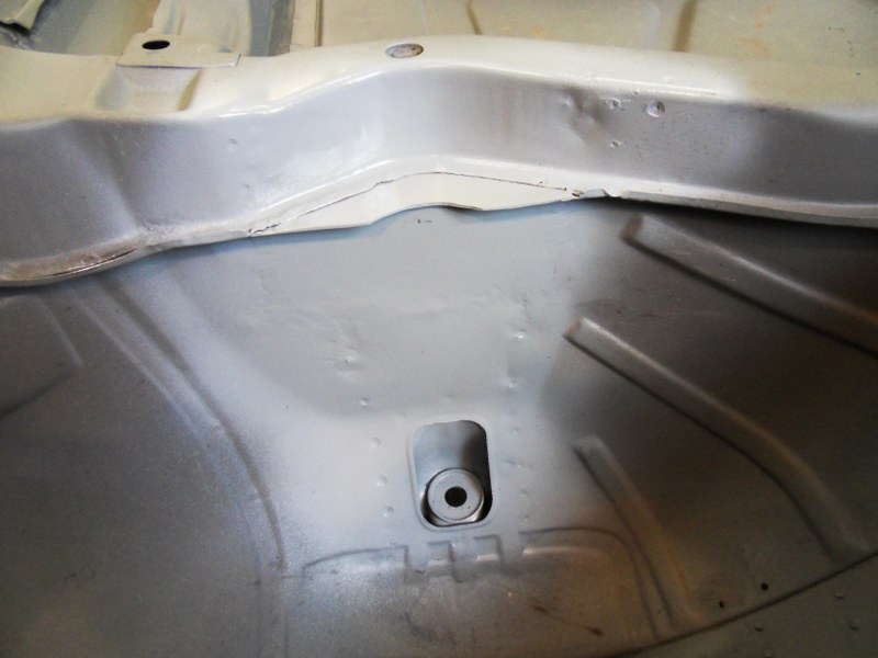

Another small repair to the bonnet slam panel end very nicely done. It is interesting for me to see how the fabricator goes through the process of accurately cutting back the area to be repaired, making the repair piece, welding it into place, finishing it off to make a near invisible repair.

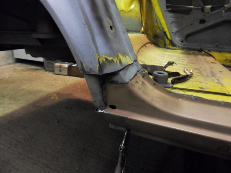

Re: My Sud Super restoration project

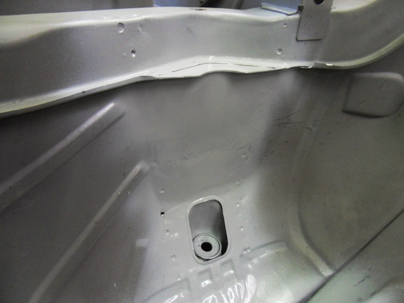

Once work on the front end was complete the fabricator moved on to sort out the rear jacking points and inner sills:

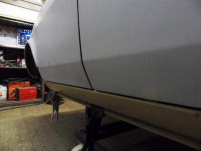

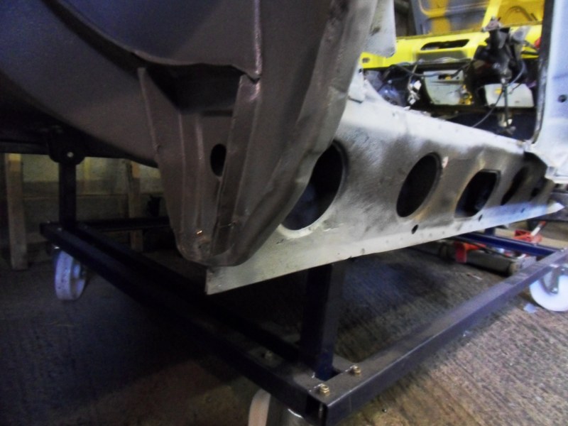

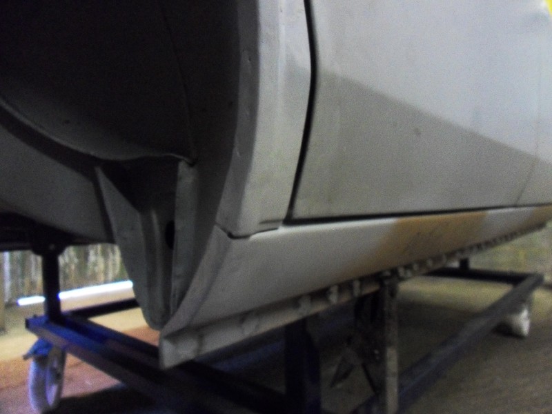

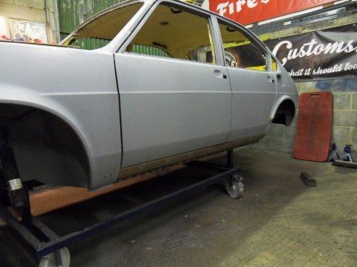

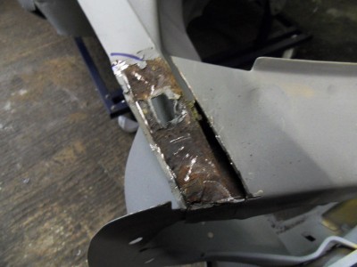

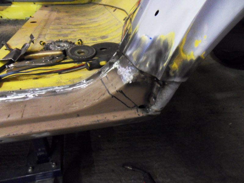

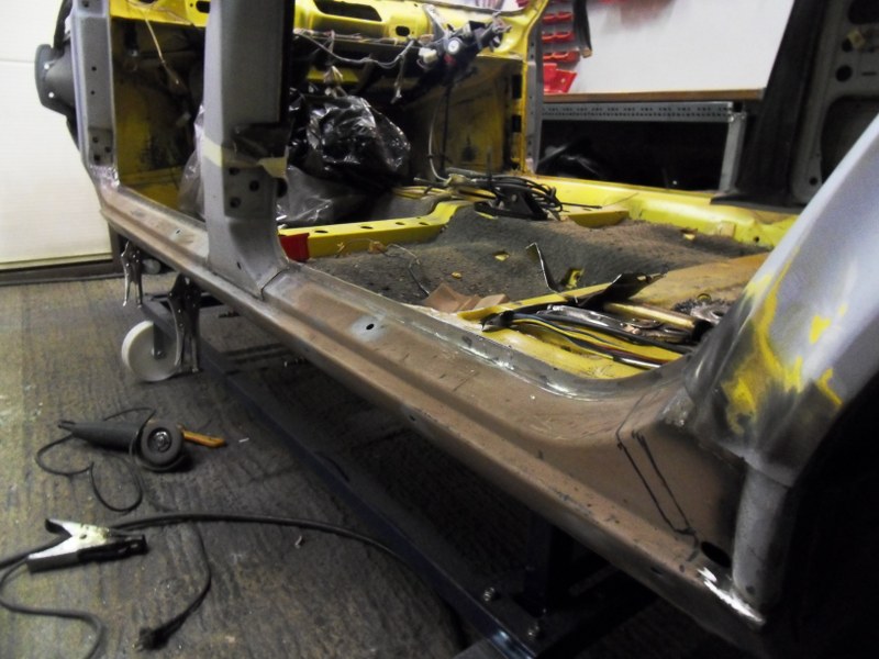

The outer sills have been replaced both sides because they had been repaired poorly at the front and rear ends in the past.
The inner sills were sound and only the small problems around the rear jacking points and lower rear inner arches had to be repaired before the new sills could be fitted.
Here are some more pictures of work progressing:

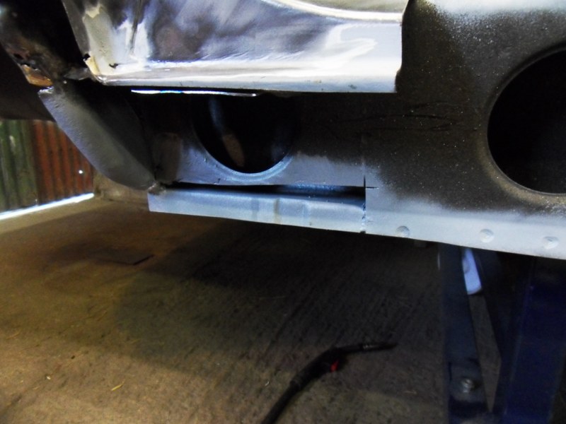

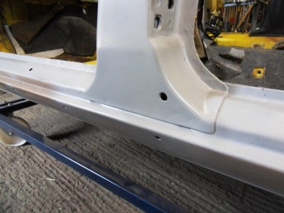

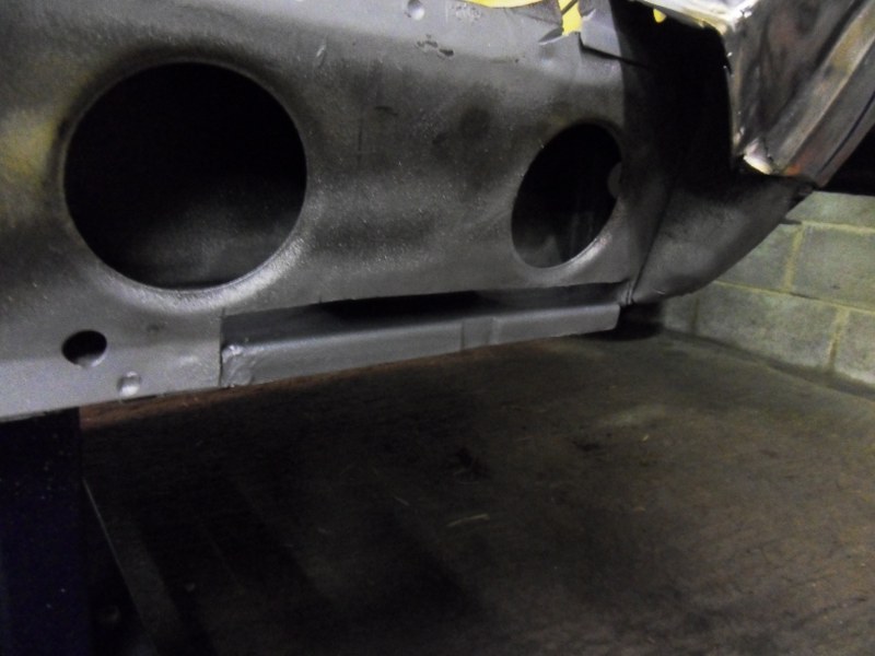

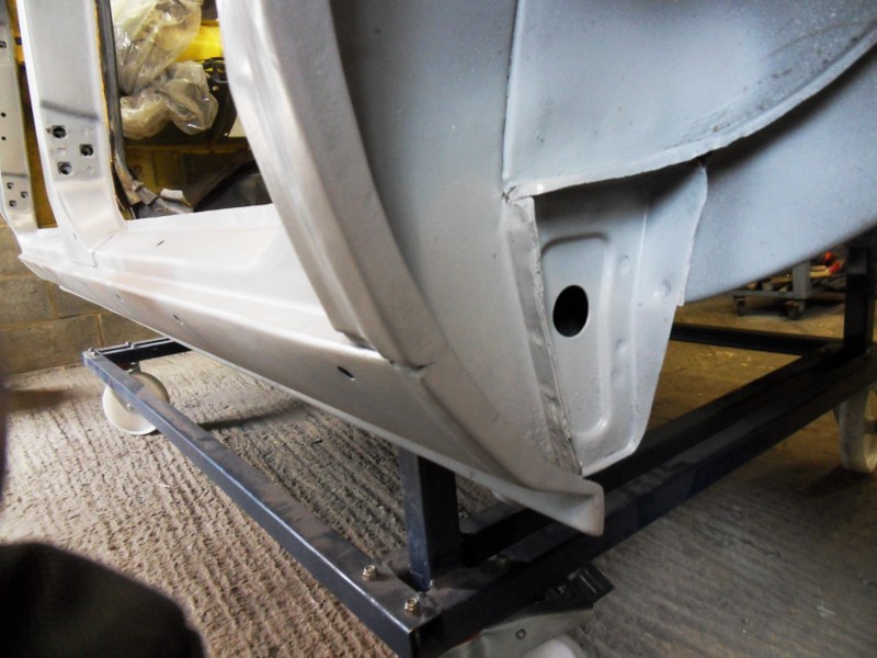

With the inner sill and lower inner rear arch repaired the new N/S sill panel was prepared for fitting. It needed a small modification as there is no rear arch flange return on the panel as supplied by Alfa Romeo. The fabricator has made up and added this feature to enable a perfect repair of the rear wheel arch.
More pictures of the new N/S sill:

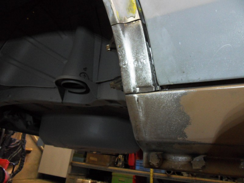

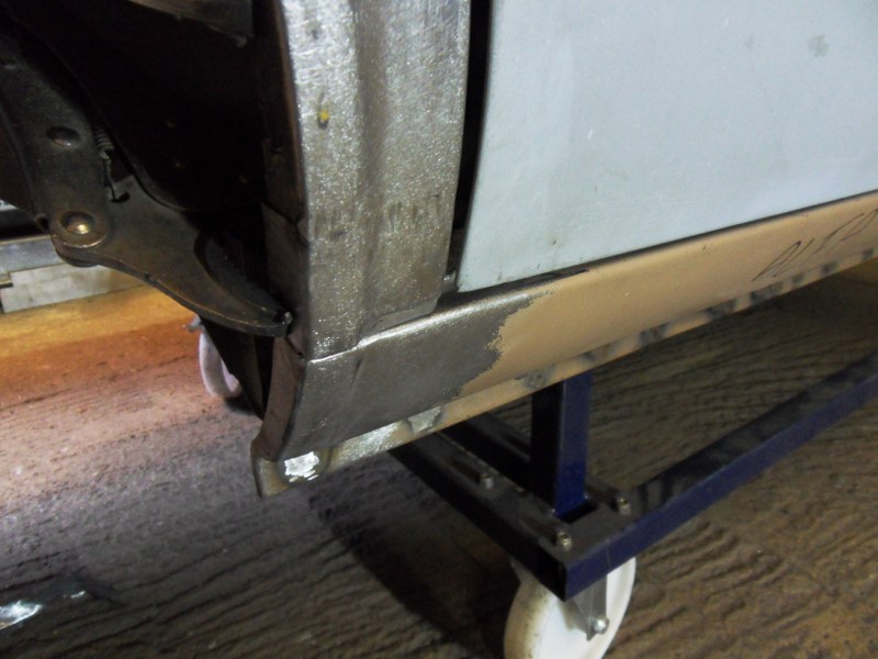

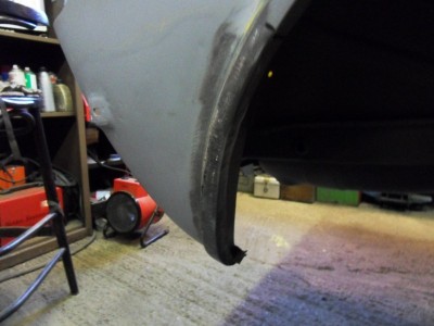

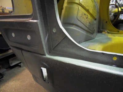

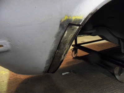

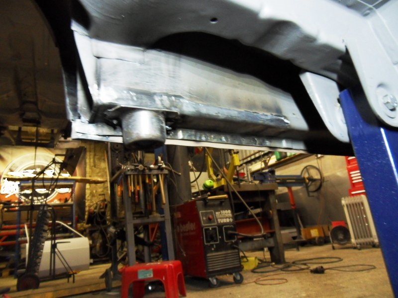

Fitting the outer lower rear wheel arch repair piece to complete the N/S sill:

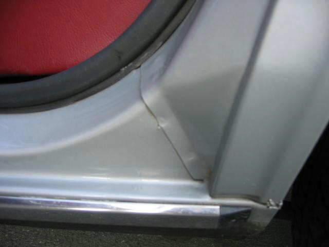

Here is the repair panel the fabricator has made and fitted to finish the N/S sill repairs: There is a small notch at the base of the rear outer wheel arch panel where it joins the top of the outer sill panel. The notch lines up with the door shut line panel gap and helps join the two panels in terms of their relative positioning to each other.
Here are a couple of pictures of factory original cars showing this important little detail: The finished repair on the Super and another factory original series 1 4 door showing that the fabricator has got it just right:

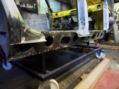

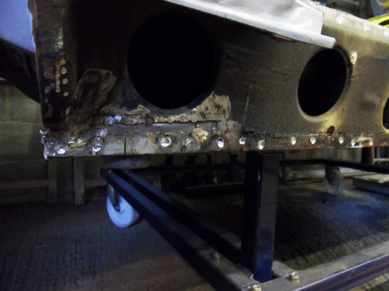

Work to the O/S inner sill and lower inner rear wheel arch underway:
More work to the O/S inner sill:
More work on the O/S sill and outer lower rear wheel arch repair piece:

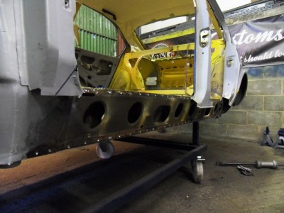

Two more pictures of work progressing on the O/S:

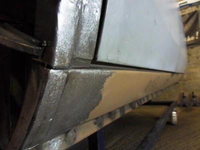

And the finished result - perfect!
The fabricator has made significant progress in restoring the Super body shell to as good as new condition. There are only half a dozen smaller scale repairs left to do now - in the N/S inner rear wheel arch around the fuel filler aperture and on the inner rear valance panel where it was poorly repaired after a minor accident in the early 1980's.

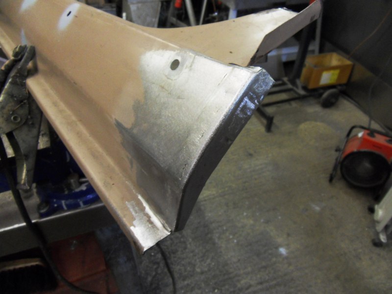

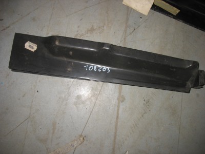

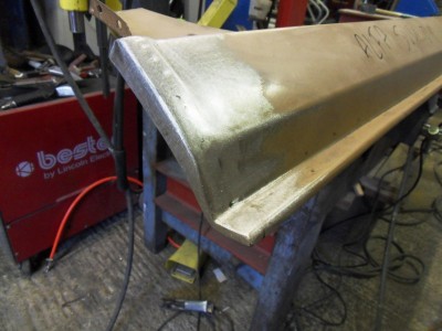

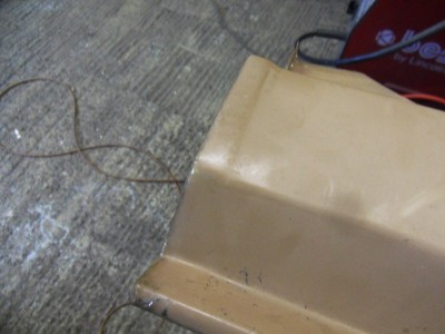

Here is an interesting set of comparison pictures: one is of an Alfa Romeo NOS Sud front wing rail (box section) outer panel sent to me by a friend in Italy who sold one a few years back. The other is of the same part the fabricator made up by hand to repair this area on the Super. The fabricator has achieved a high degree of accuracy in making up these panels. My friend in Italy tells me these fabrication skills are hard to find nowadays even in Italy and thinks I have been very lucky to find someone in the UK with the skills to restore my car to such a high degree of originality. I agree.
Here are the pictures of the panels:
NOS original The repair panels being hand made by the fabricator - including extra flanges on one edge for additional strength and easier fitting:

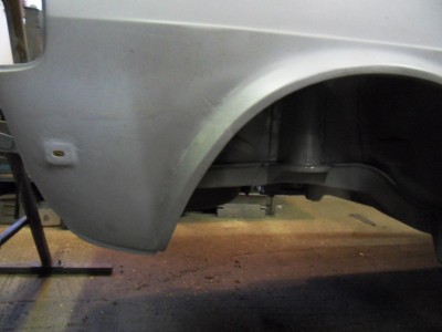

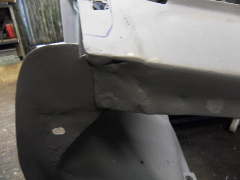

The fabricator has returned after 10 days holiday and work has continued apace this week.

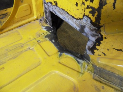

The O/S rear arch had been accident damaged in the past and poorly repaired with lead filling. This has been cut away and a repair section made up to fit the damaged area at the back of the arch.
The damaged area: Cutting out the damaged section: Test fitting the repair section: The repair section welded into place and protected with primer, the double curvature of the arch has been accurately replicated: The repaired wheel arch rim, another nicely executed repair

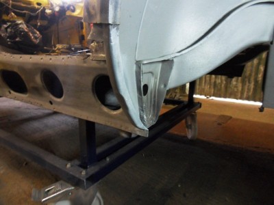

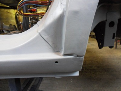

The body shell repair stage of the Super project has really pushed on during March. So much so, that the volume of work completed by the fabricator has outpaced my ability to find time to get back on the forum to report on progress over the last two weeks.
The Easter Holiday has provided me with a window of opportunity to catch up on the new repairs that have been completed - so here we go:

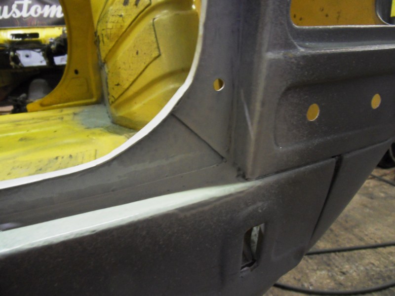

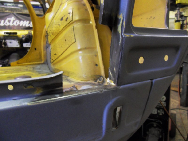

First up is some more pictures of the reinstatement of the lower rear wings where they join the sills. Of all the repairs completed so far this section has surprisingly been the most difficult to get right.
After making a repair section that he was not happy with the fabricator decided not to fit it and to have a second attempt at getting it exactly right. The challenge was to recreate the small cut outs or notches between the wing lower edge and the top edge of the sill panel and to have the wing rim stepped out about 2 mm proud of the top of the sill panel. This is how the Alfasud factory jigs seem to have set up the relative panel fit, not the precise flush fit that would look best, but all the cars we have examined have this little miss-fit between the panels, it is quite characteristic of the series 1 - 2 berlina's where this section is fully visible, so rather than correct it we have faithfully reproduced it!
The results of the fabricators intensive efforts to get this detail exactly right were illustrated in my last couple of posts at the beginning of March. Since then the fabricator has sent me some more pictures of the door jamb area which better highlight the difficulty he experienced in re creating the complex multi curvature panel contours in this area sufficiently accurately to make it look factory original.
Whilst on the subject of the replacement of the damaged original sills here are some more close up pictures showing the high standard of work the fabricator has consistently produced.

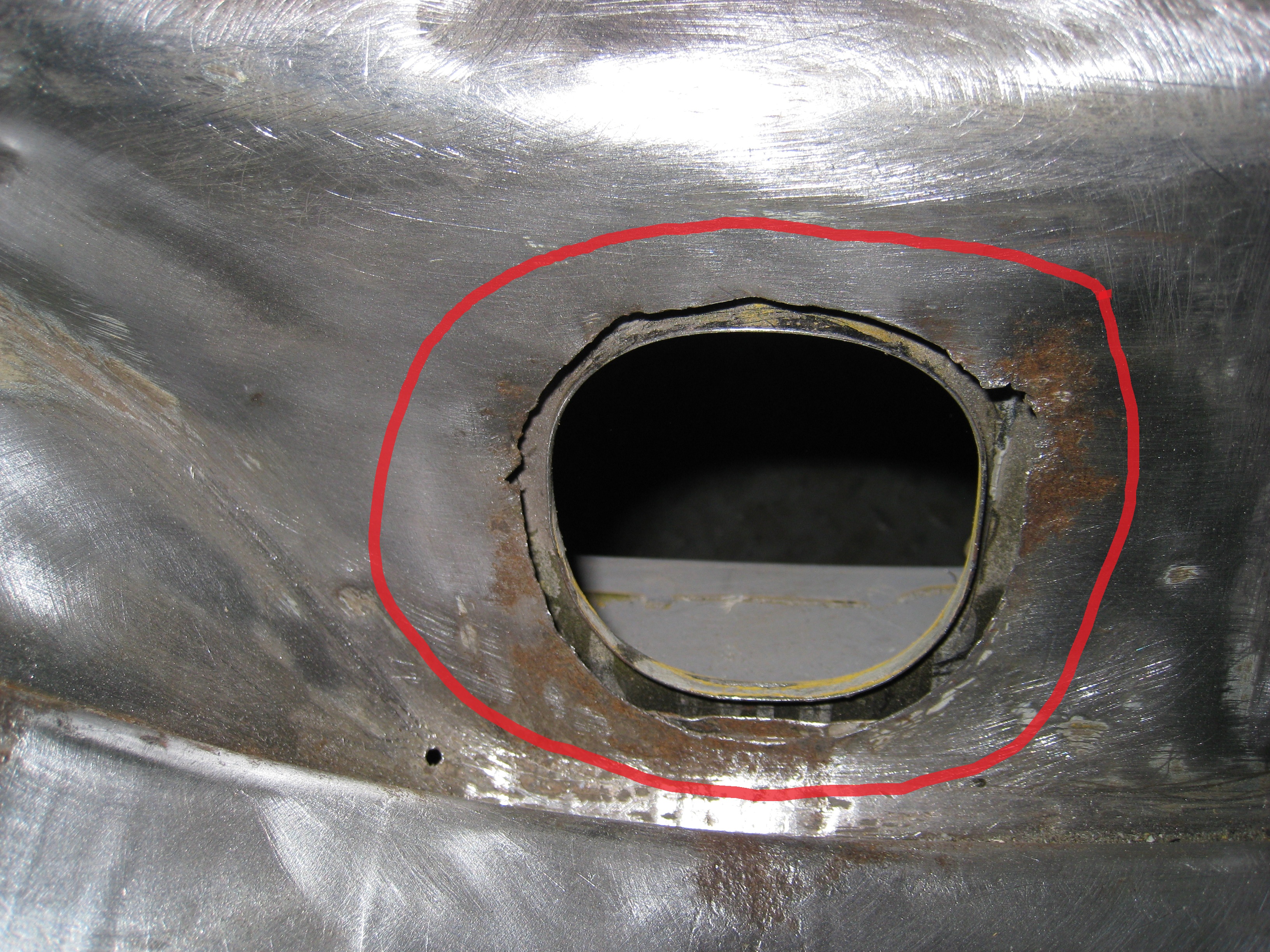

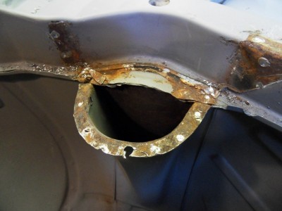

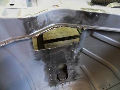

With the sill areas completed on both sides of the car the fabricator continued working towards the rear resolving a legacy of poor quality historic repairs and hidden rust damage. Superficially, the rear inner wheel arches looked quite good, but a rust hole in the offside rear shock tower was a clue that not all was well in this section of the shell. The fabricator drilled out the spot welds to reveal inter-panel corrosion damage that needed quite extensive repairs. Next stage was cleaning the area up and cutting out the section of the inner arch that was sufficiently rust damaged that the entire section behind the shock tower needed replacing with new metal.
Here is the rust hole in the shock tower: The fabricators work flow in investigating and repairing this section is shown in the next set of pictures:

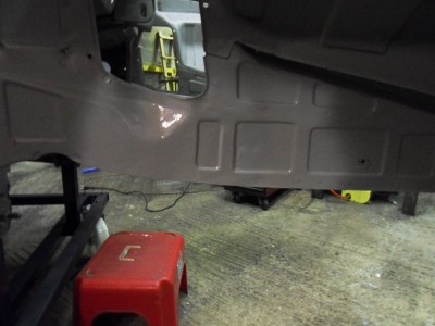

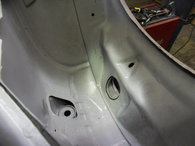

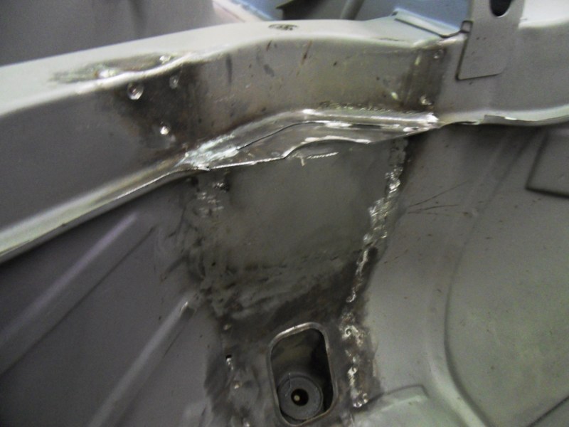

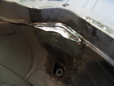

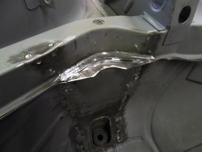

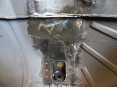

After cleaning both sides of the rear inner arch and preparing it for the repair sections to be welded in the fabricator sorted out the rust hole in the lower rim of the shock tower. He also cleaned up the main strut tower panel which is a separate part and painted everything with weld-thru primer:

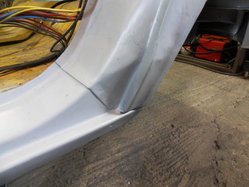

The rear inner arch, horizontal flange and shock tower pieces are welded back together, all welds are ground flush and a protective coat of primer is sprayed over the work area:
Looks factory fresh now:

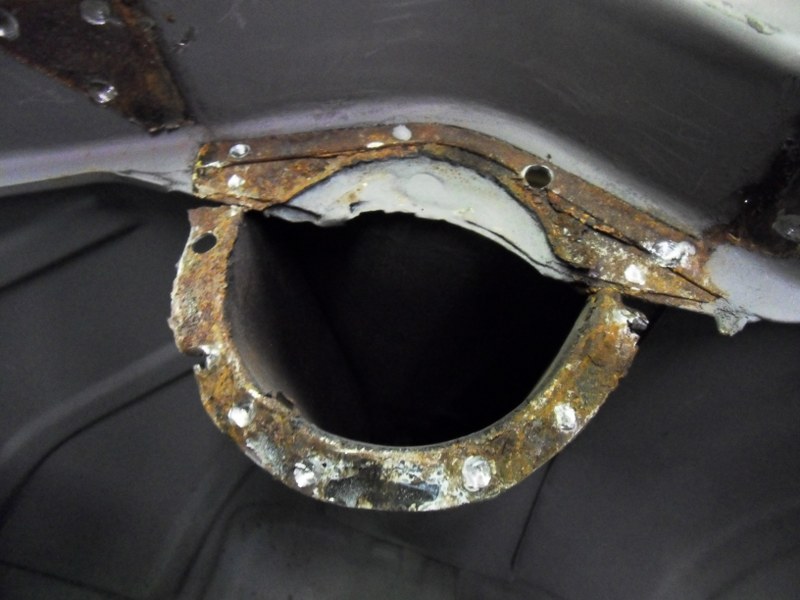

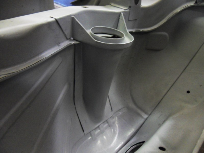

Whilst repairing the near side inner arch the area around the fuel filler neck aperture required rust damage to be sorted out. This is a difficult area to access as there is not much room for tools or welding equipment. It helped a lot in accessing this repair that the shock tower was removed first:
The finished repair to the fuel filler surround with the rest of the inner arch primer painted and ready for the reinstatement of the shock tower and flange piece: The finished near side rear inner arch and shock tower repairs:

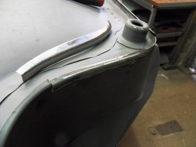

With some smaller repair areas completed the fabricator moved on to another difficult problem. The near side rear wing was replaced due to accident damage in the 1980's and the job was not well done. Very ugly welding was visible and the flange between the rear wing and rear valence was a nasty mess with terrible welding and corrosion visible. Radical repairs were going to be required if we were to sort out these problems.
Here are the problem areas we needed to deal with and the methodology the fabricator used to access them:
