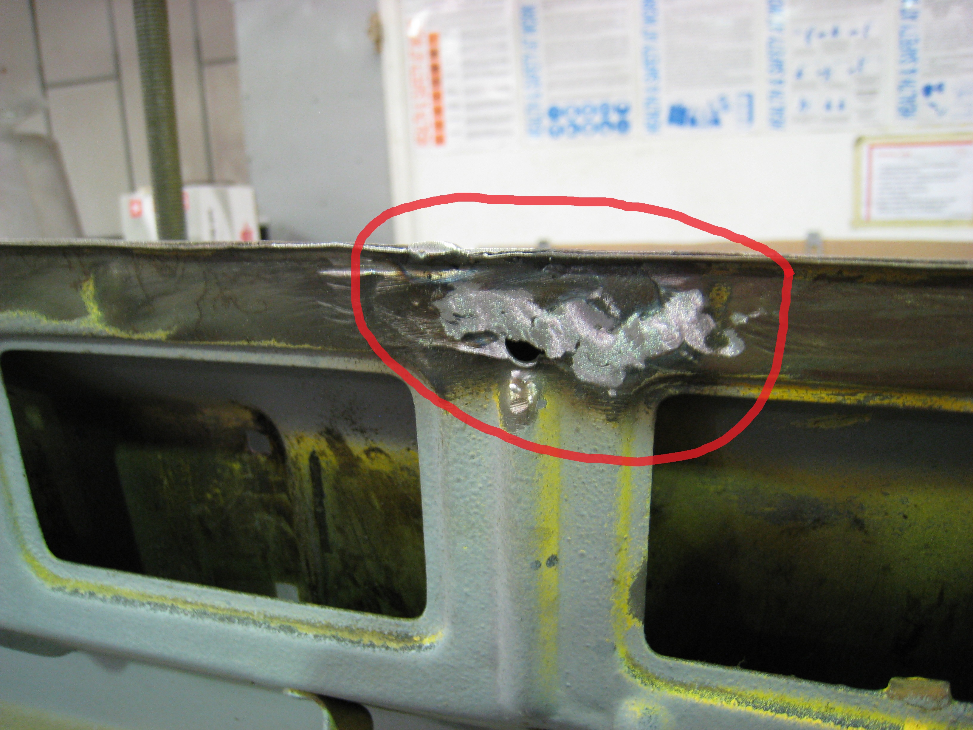

Once work on the front end was complete the fabricator moved on to sort out the rear jacking points and inner sills:

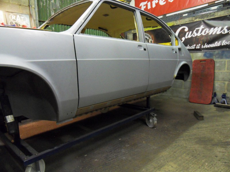

The outer sills have been replaced both sides because they had been repaired poorly at the front and rear ends in the past.
The inner sills were sound and only the small problems around the rear jacking points and lower rear inner arches had to be repaired before the new sills could be fitted.

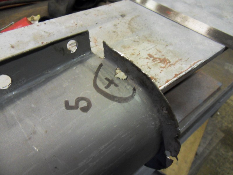

With the inner sill and lower inner rear arch repaired the new N/S sill panel was prepared for fitting. It needed a small modification as there is no rear arch flange return on the panel as supplied by Alfa Romeo. The fabricator has made up and added this feature to enable a perfect repair of the rear wheel arch.

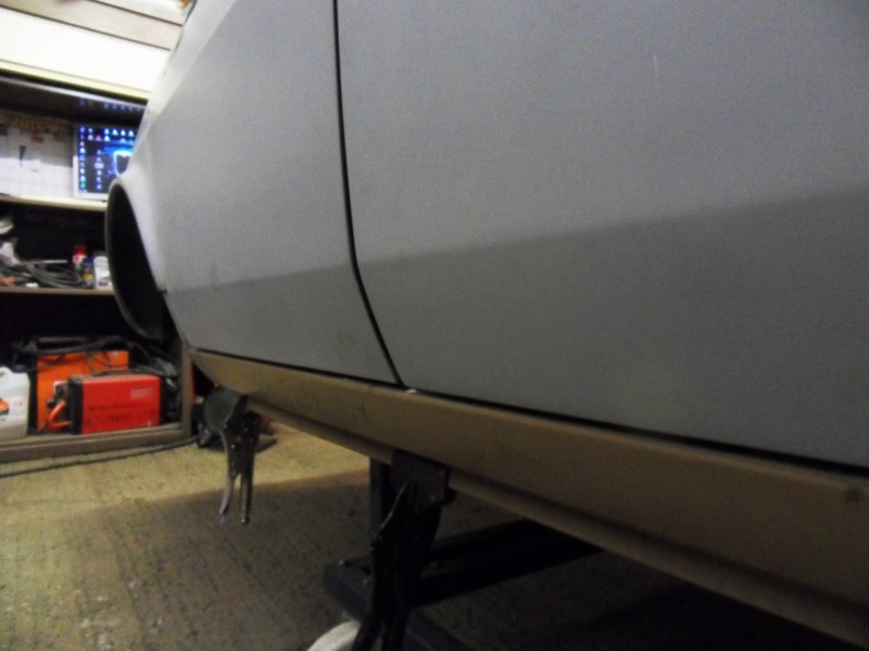

Fitting the outer lower rear wheel arch repair piece to complete the N/S sill:
Here is the repair panel the fabricator has made and fitted to finish the N/S sill repairs:
There is a small notch at the base of the rear outer wheel arch panel where it joins the top of the outer sill panel. The notch lines up with the door shut line panel gap and helps join the two panels in terms of their relative positioning to each other.
Here are a couple of pictures of factory original cars showing this important little detail:
The finished repair on the Super and another factory original series 1 4 door showing that the fabricator has got it just right:

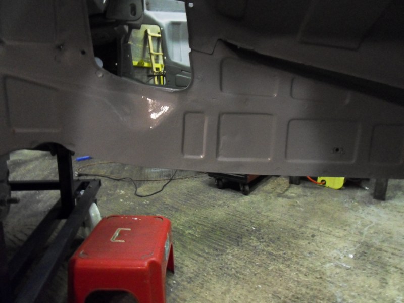

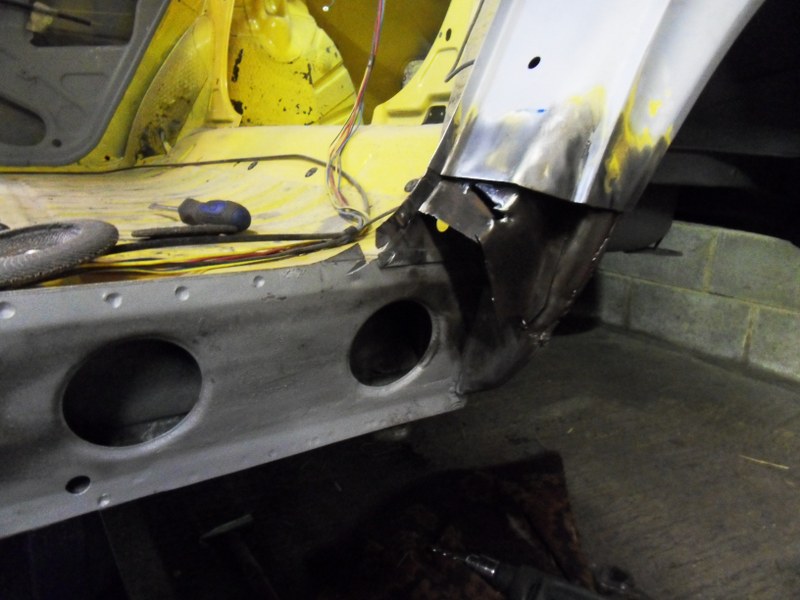

Work to the O/S inner sill and lower inner rear wheel arch underway:
Alfasam
Posts: 168
Re: My Sud Super restoration project
Post by Alfasam »
More work to the O/S inner sill:

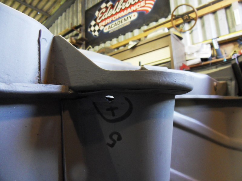

With the sill areas completed on both sides of the car the fabricator continued working towards the rear resolving a legacy of poor quality historic repairs and hidden rust damage. Superficially, the rear inner wheel arches looked quite good, but a rust hole in the offside rear shock tower was a clue that not all was well in this section of the shell. The fabricator drilled out the spot welds to reveal inter-panel corrosion damage that needed quite extensive repairs. Next stage was cleaning the area up and cutting out the section of the inner arch that was sufficiently rust damaged that the entire section behind the shock tower needed replacing with new metal.
Here is the rust hole in the shock tower:
The fabricators work flow in investigating and repairing this section is shown in the next set of pictures:

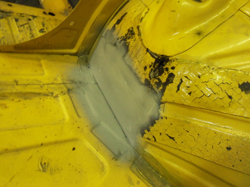

After cleaning both sides of the rear inner arch and preparing it for the repair sections to be welded in the fabricator sorted out the rust hole in the lower rim of the shock tower. He also cleaned up the main strut tower panel which is a separate part and painted everything with weld-thru primer:

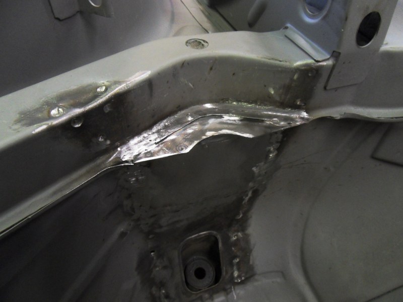

The rear inner arch, horizontal flange and shock tower pieces are welded back together, all welds are ground flush and a protective coat of primer is sprayed over the work area:
Looks factory fresh now:

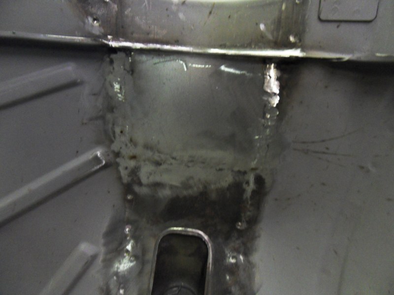

With the offside rear inner arch and shock tower sorted out a similar process of investigation and repair was applied to the near side which was not as badly corroded between the panels but still required some repairs to the seam between the inner arch and boot floor panels:

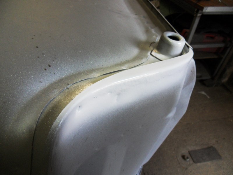

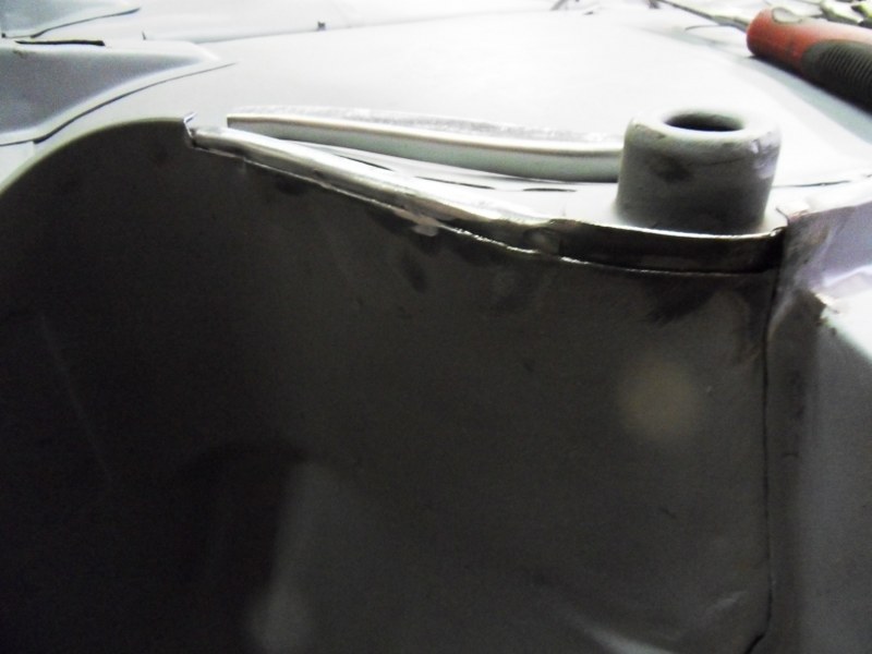

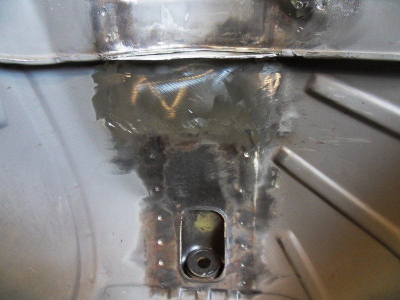

Whilst repairing the near side inner arch the area around the fuel filler neck aperture required rust damage to be sorted out. This is a difficult area to access as there is not much room for tools or welding equipment. It helped a lot in accessing this repair that the shock tower was removed first:
The finished repair to the fuel filler surround with the rest of the inner arch primer painted and ready for the reinstatement of the shock tower and flange piece:
The finished near side rear inner arch and shock tower repairs:

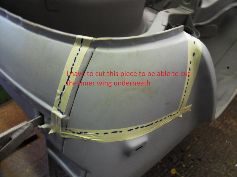

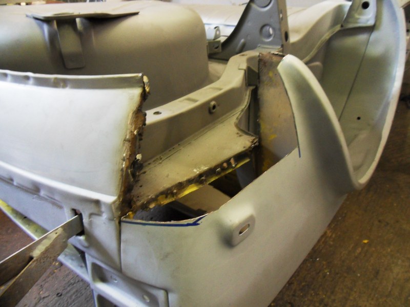

With some smaller repair areas completed the fabricator moved on to another difficult problem. The near side rear wing was replaced due to accident damage in the 1980's and the job was not well done. Very ugly welding was visible and the flange between the rear wing and rear valence was a nasty mess with terrible welding and corrosion visible. Radical repairs were going to be required if we were to sort out these problems.
Here are the problem areas we needed to deal with and the methodology the fabricator used to access them:

Post by Alfasam »
The various pieces are removed from the rear wing, inner wing and valence:
