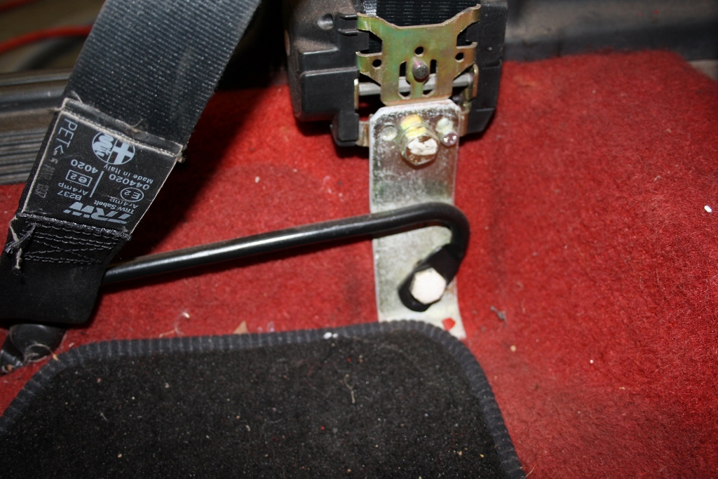

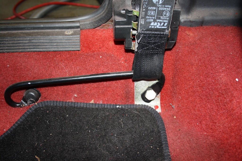

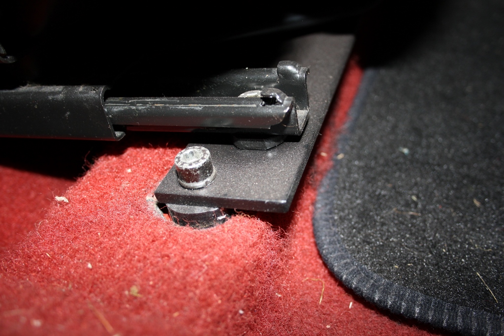

Re: 916 GTV seats for a Sud?
Here's how I did mine. I just used some 5mm thick bar at the back:
and for the front I used some wider bar just drilled in the right places:
I wanted to keep it simple so it was easy to reverse if I want to. For the seatbelts I used the GTV one's but you need to get some brackets for the bottom 'loop' to go through:
The metal bars were from a Nissan Micra ! http://www.ebay.co.uk/itm/NISSAN-MICRA- ... 4179391951
I used a spare set of Sud mounting brackets for the seatbelt reels and put a small bolt through to keep the reel in the right place, you can just see it in the last photo.
Just need to vacuum the car properly now and refit the plastic covers !

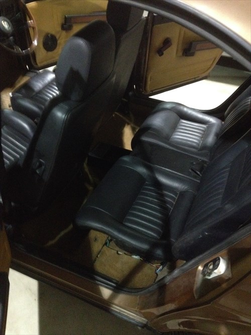

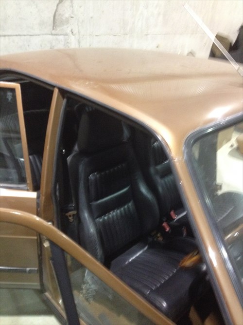

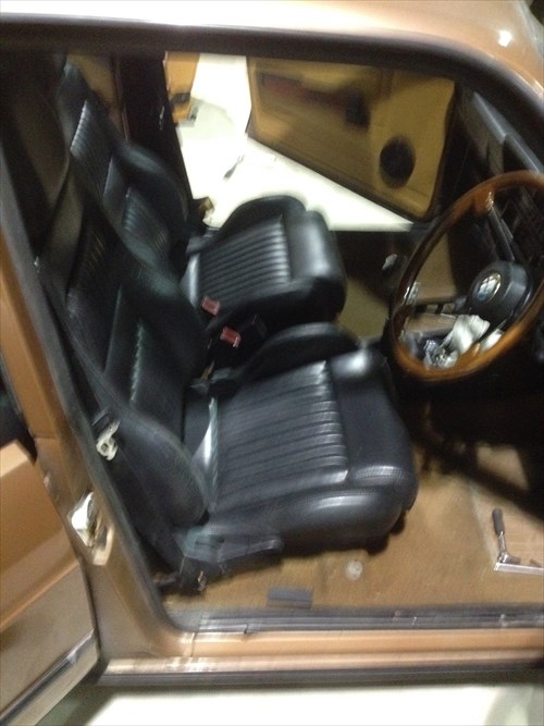

Took out Sud seats and 'rested' GTV seats in to have a look.
Also lifted carpets, a little welding will be required (surprise, surprise!)
Look pretty snug in there mate.
Will it be any easier or tougher than yiu first thought?
I was lazy and didn't check the fit of the bolts etc.
There appear to be two holes up the front of the front seats....
There will be headwreck but the fronts are very comfortable in a firm way so I do think it's worth the 'problem solving!'
The earlier post re the bars etc is very helpful.
I think the rears will be more trouble to be honest.
Progress will be slow but I will update...
