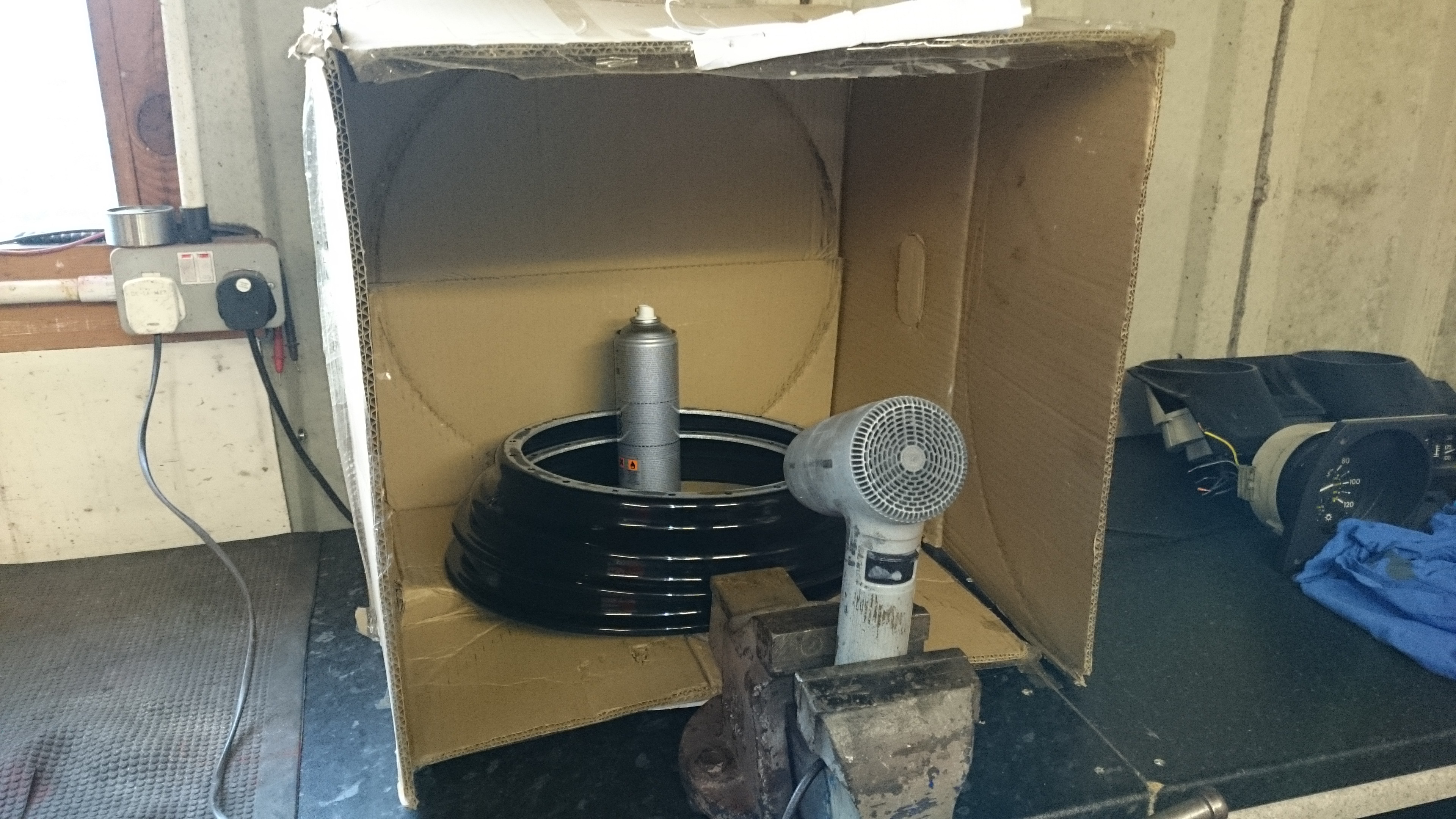

Put the oven to the test, and some otherwise useless device,
Worked very well, not sure what else i would use that tool for?
Answers on a postcard please to PO Box NG Bald!

Re: parts painting in winter
works a treat mate, doesn't it
great too that it's a useful tool that costs nothing to make
although like you, i've no use for the hair dryer nowadays either
