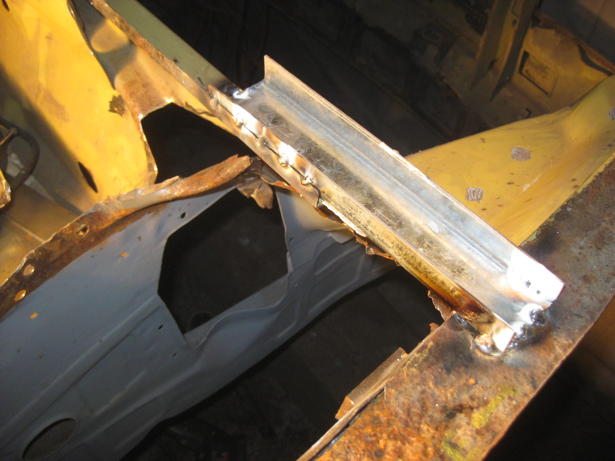

I decided to weld a couple of blocks to the existing wing mounting rail to give the new panel something to sit down onto so the correct height would be guaranteed....
As some of you can remember I had already repaired all the lower areas of the inner wing and I didn't want to undo all that work so a decision was made to join the panel with a jodelled overlap joint, seem welded both sides for strength
The panel had a bit of surface rust on it due to its age so I carefully ground all that off after cutting it and preparing the lower edges with the jodelling tool

The wing mounting rail was now about to fall off so I had to weld a reinforcing bracket to it :D

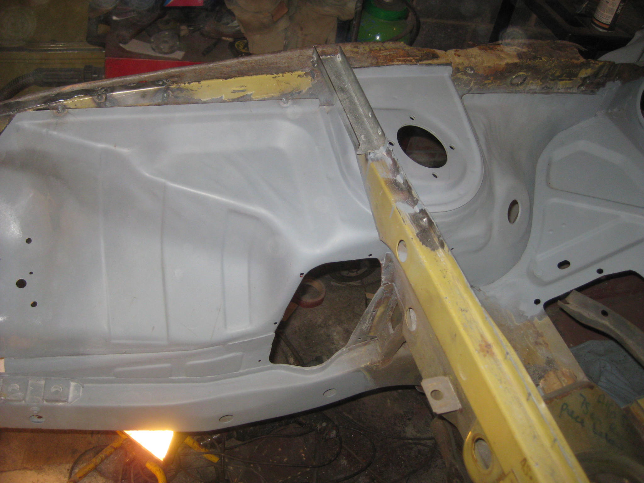

After much messing around I got the panel to fit and I could begin welding it into place
the seam welded joint was carefully ground back to allow for an invisible repair but retain its strength
......then some etch primer
vecchioalfa
Posts: 433
Post by vecchioalfa »
Some sealant over the lap joint from the other side....
I sanded this down after 24hrs and added some coats of brush on zinc phosphate primer, this was then sanded down and now looks neat and hardly noticeable
I also seam welded around the turret

Now the front section...
and the job is almost done.....
There is a little area to do beneath the bumper mounting area and new captive nuts to fit and then make a new section to the edge of the centre bulkhead to take it back up to the wing mounting rail

Thanks :) The other side will be easier I guess as I already have the panel so I will replace the whole panel in one go
I rechecked all the dimensions as I was doing it and all of them are within 1mm - 2mm even the one from the other side of the car so I am very happy with it
